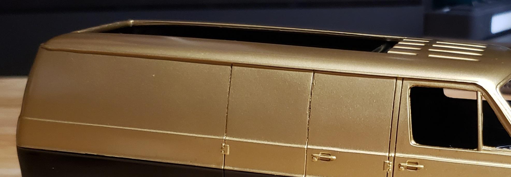

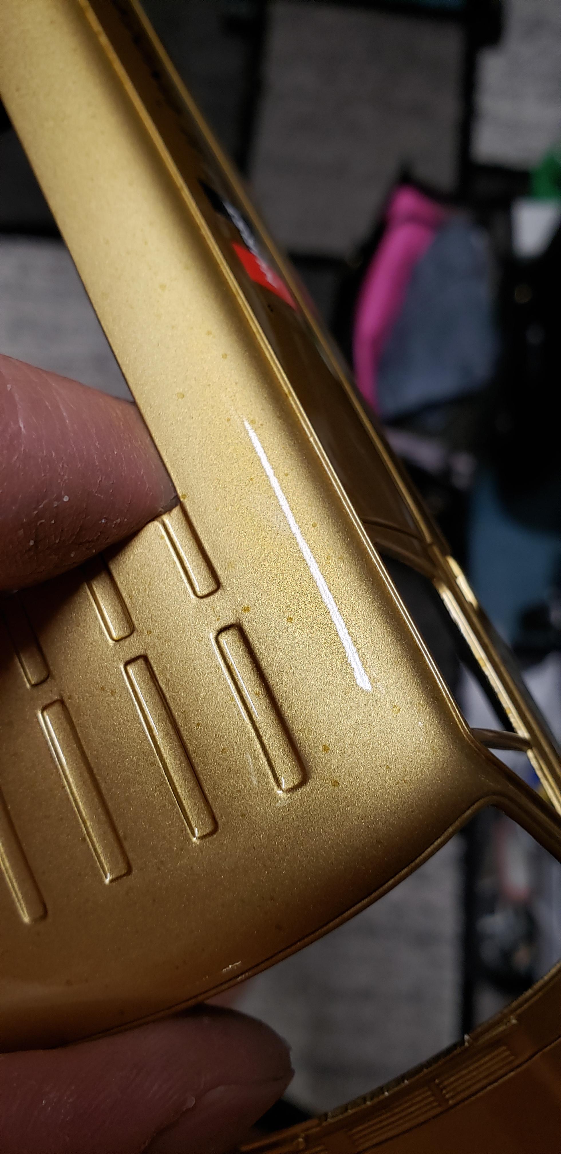

Anyone know why I'm getting these reactions with gold cars? Doesn't matter what brand paint. This is Tamiya rattle can but its happened with Rustoleum too. The only thing in common is Mr Hobby clear. I think the gold may be tarnishing.. I would spray color, let it dry. Wash with dawn and clearcoat, wet sand and more clear. It looked perfect for a day or two at the end and these came up
Kinda bummers but I'm not gonna redo it

To me it looks like the spray nozzle might be partially blocked causing small droplets to form and be propelled onto the model's surface. The other possibility may have to do with your humidity levels. Hawaii is a beautiful place but is also known for high humidity.

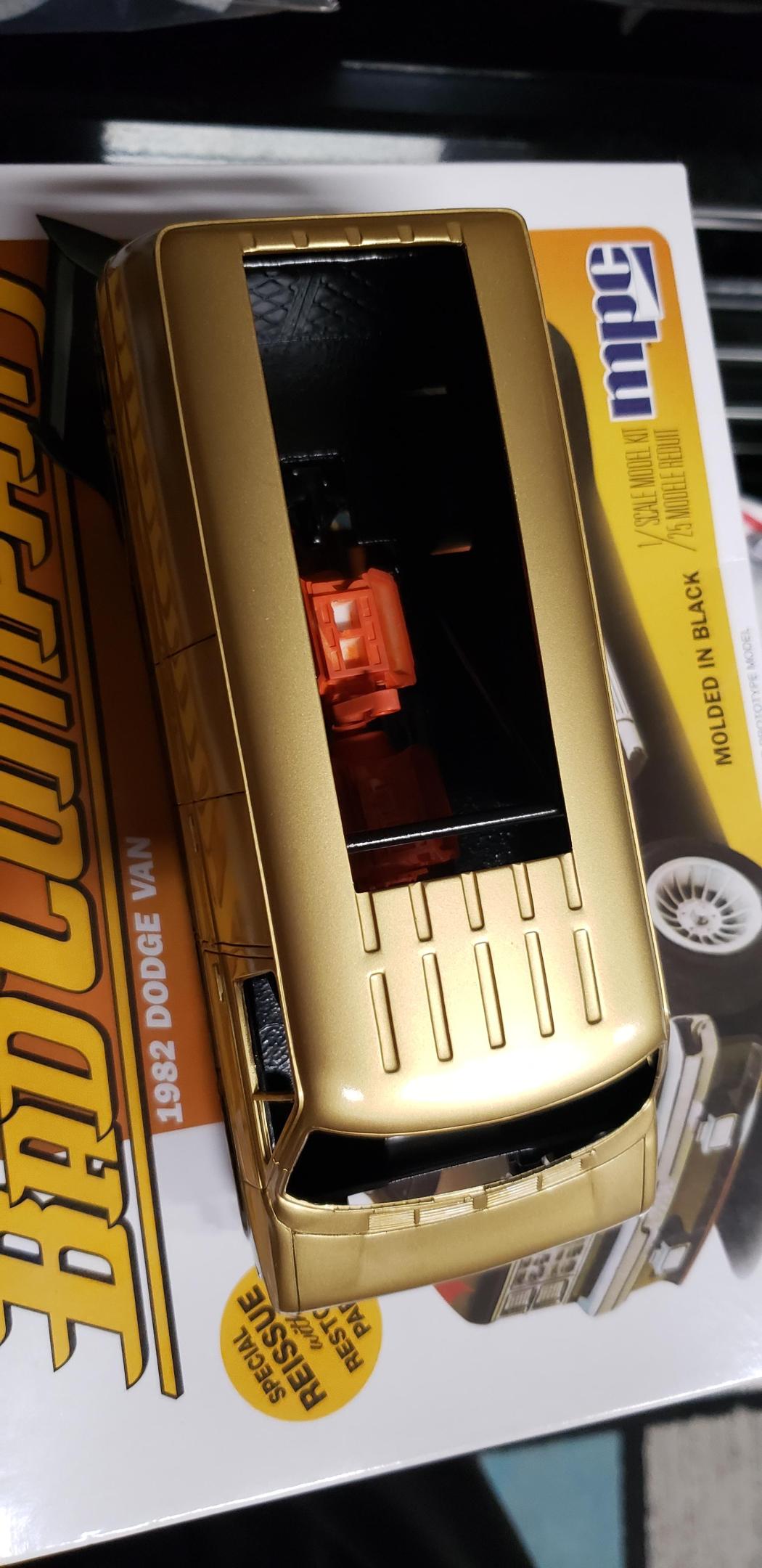

These are some pictures from a few days before, with the first coat of clear. It looked really good and the spots came out afterwards. Also using a food dehydrator
I only think its tarnishing because back when I was a kid my gold cars would tarnish because I didn't use clear
Wondering if I should clear the car without washing it beforehand. I always wash and use hair dryer to remove dust, etc. If there's a better way I'd love to try. This is why I rarely 2 tone cars too
Edited by Hondamatic

Try spraying your clear as soon as the last coat of paint flashes. I've sprayed two coats of paint one day. Then sprayed a coat of paint and a coat of clear the next day. Whichever paint you use, make sure your clear is the same brand.
The spots on your paint looks like the clear has spit out. Droplets can can effect the paint because they're thick at the moment they hit the paint which can make that spot wet again.

You should apply your method too a spoon without using the dawn and see if the same thing happens.  If same thing happens try a different clear doing same method on a different spoon.
  • Like 1
4 minutes ago, Sandboarder said:
I also think it because of the washing. Either step this step or shoot the clear coat closer to the last colour coat.

You could spray your clear coat 30 minutes after your last colour coat depending on paint thickness and it it’s the same paint that’s flashed off (normally won’t taken more then a few minutes) That would reduce the time/chance that dust has to settle on your model.
  • Like 1
If my base color coat gets a hair or lump of dirt I scuff that, then shoot a final base coat,just a single coat to even things up. Once dry I go right to the clear, no washing. I just blow it off with the airbrush ( air only) then shoot the clear.
  • Like 1
Thanks for all the replies, guys. When I used to build 15 years ago I would let the color flash and put down clear, and I just got back into the hobby last year and read some stories that if I didn't let the base dry enough, the clear could crack over time ( I'm guessing due to different drying rates, and I do have some older cars that did this) so I've been being a little cautious. But now I'll have to take a better look into my methods, and I'll post if I figure out what happened to the gold paint
