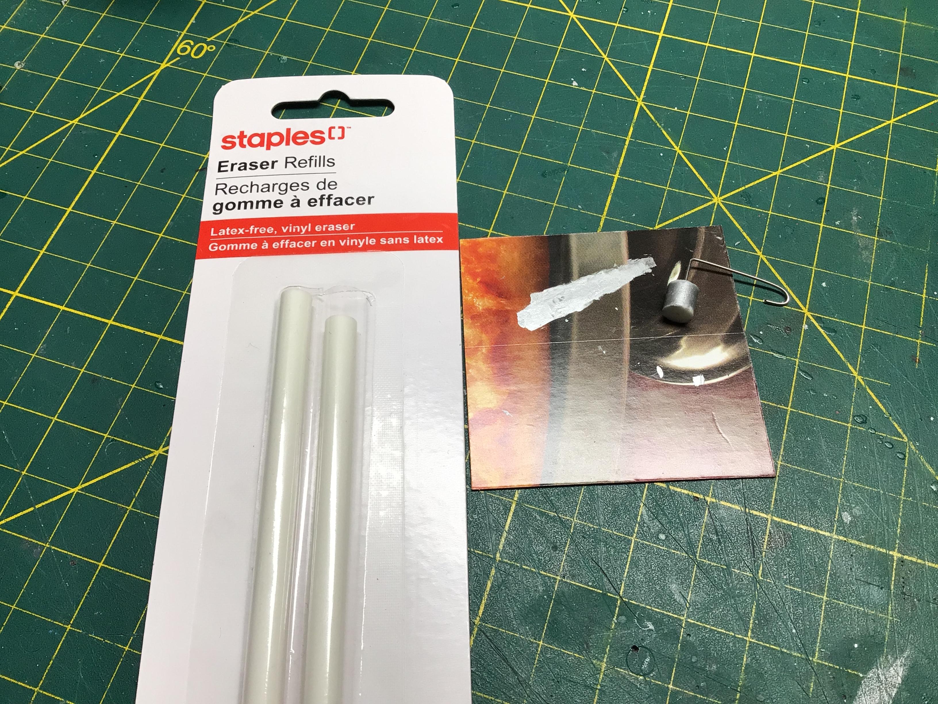

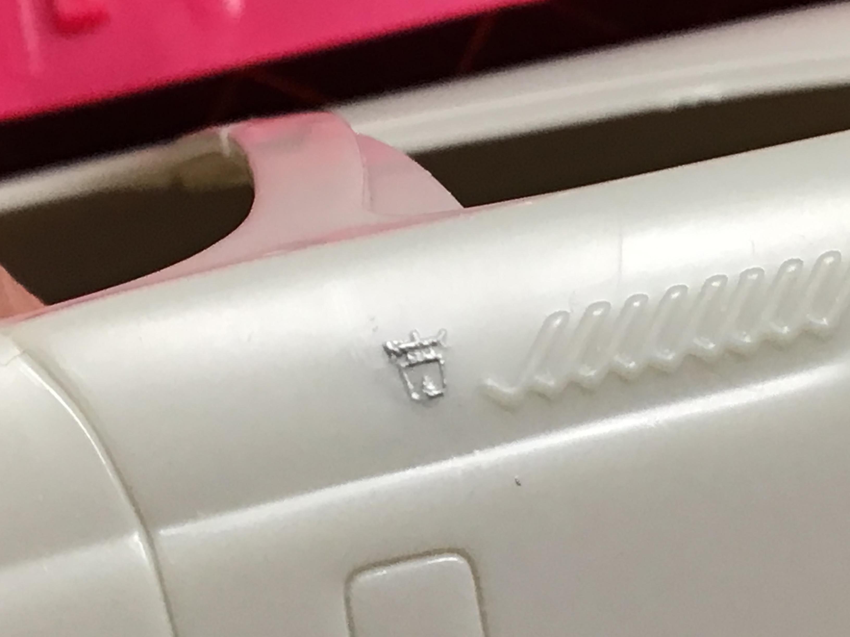

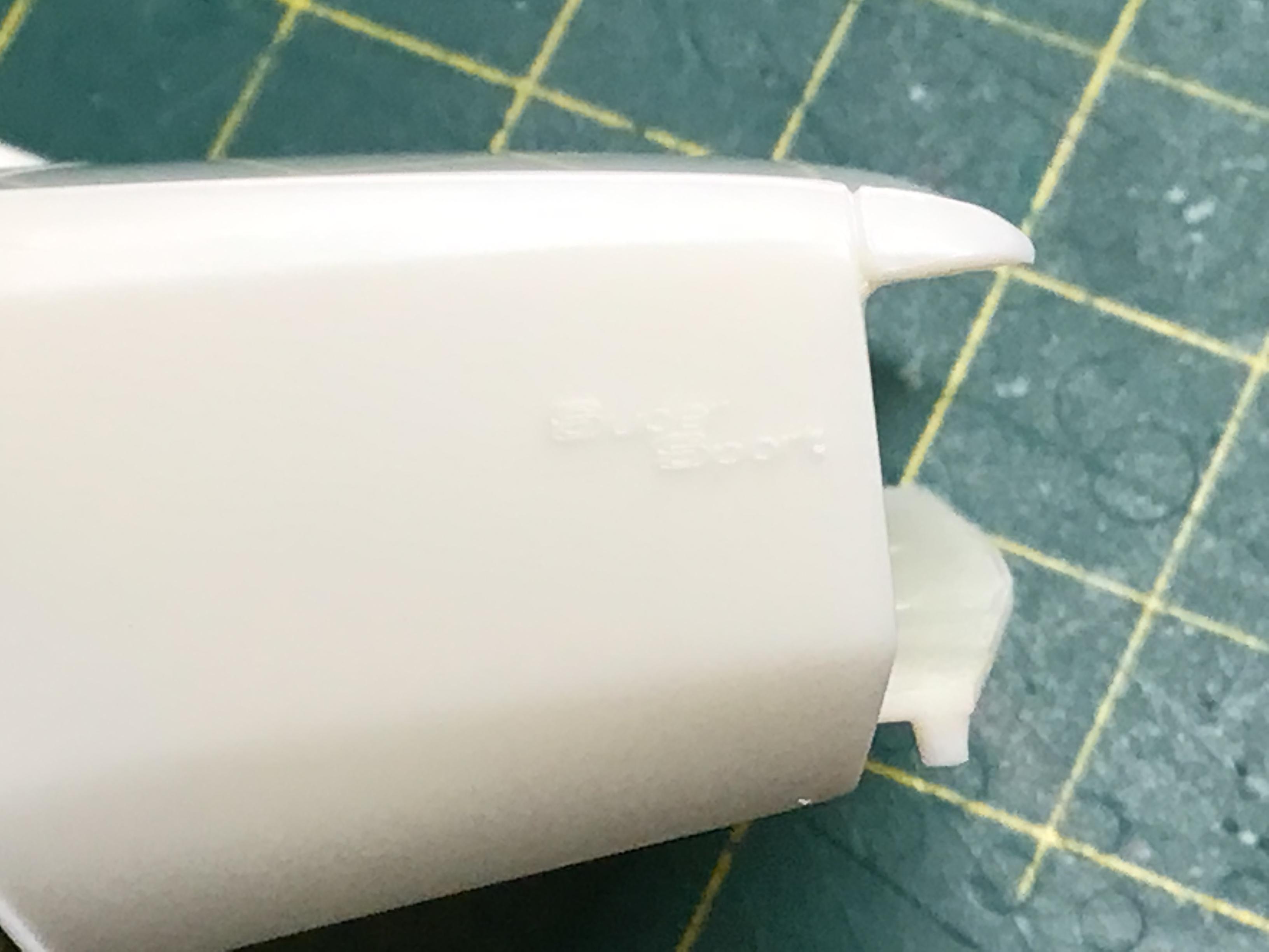

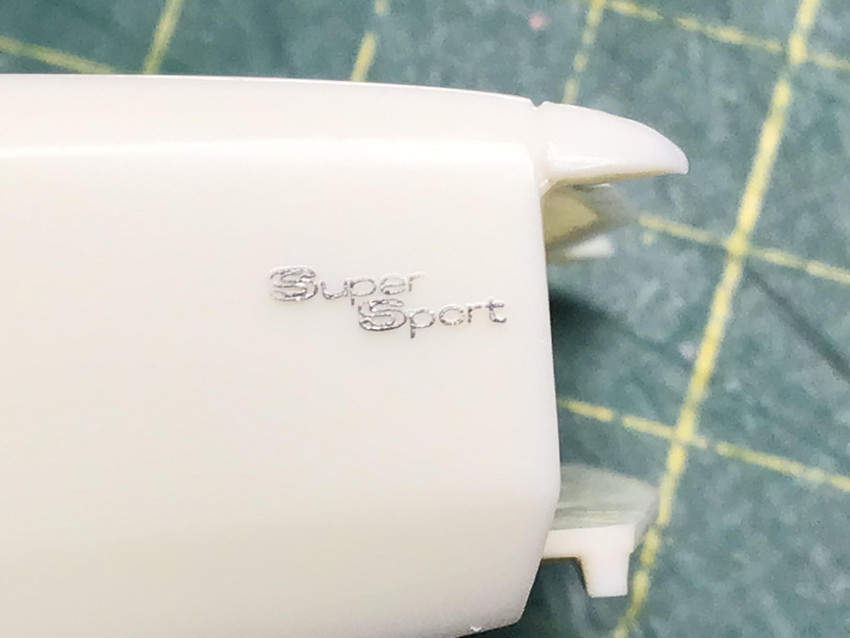

I was wondering how I was going to paint the script on my AMT Nova since it is very fine detail. I have tried pad printing raised detail using an eraser before with semi-ok results. Then I thought of this idea using a round refill for an eraser pencil. Just stick a piece of bent wire through a short chunk and you have a mini-roller. The paint is Model Master chrome silver enamel, but I think any paint should work. The first few tests look encouraging.?

Very promising result, Greg. I think this is a great idea and it seems to work very well. Like the others, my 'go to' method for scripts is foil under paint. However, I think this is a viable option, and there are lots of other applications for this method. Just a couple nights ago I was trying to expose the very fine chrome script from a chrome cam cover painted black. I damaged the chrome plating on three of the very small letters, and had to try to dry brush silver paint to restore them, with lack-lustre results. Your method would have worked much better. Thanks for the tip.
The results you have achieved are very promising.  I especially like how the letters are not filled with silver paint. But as mentioned by Peter and Charles what will be the results once the body is painted?
