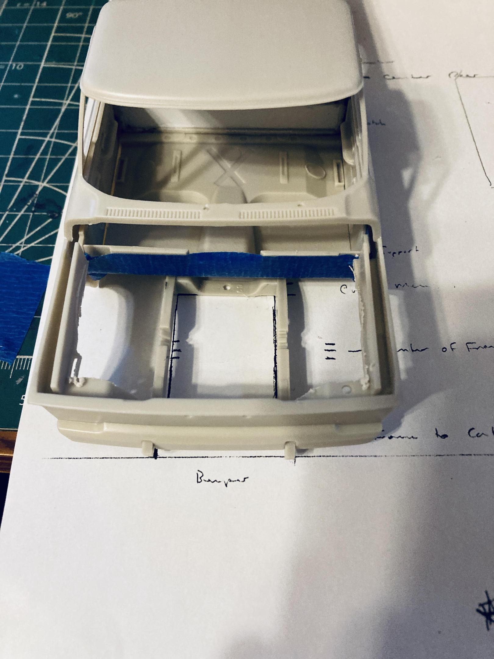

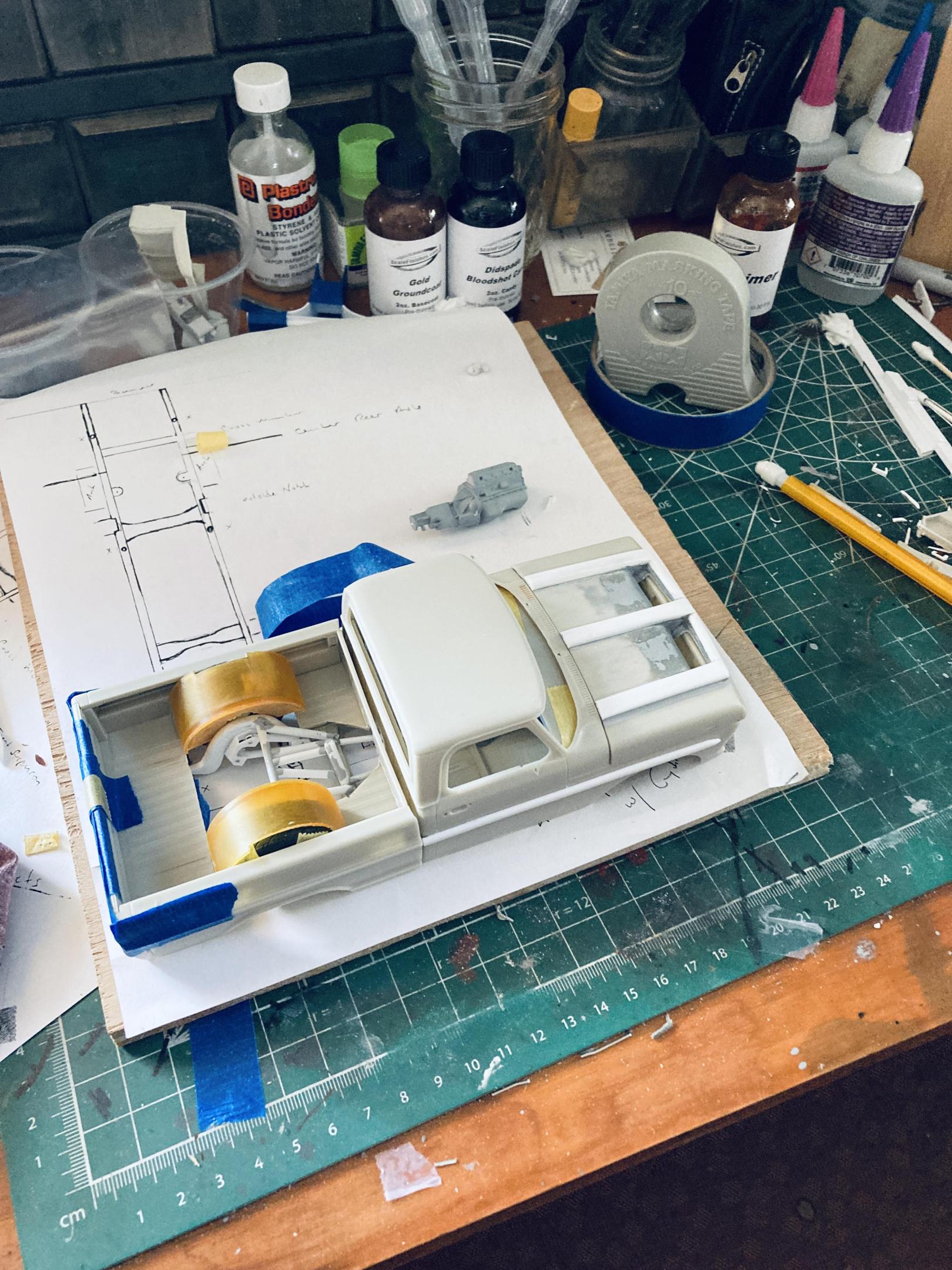

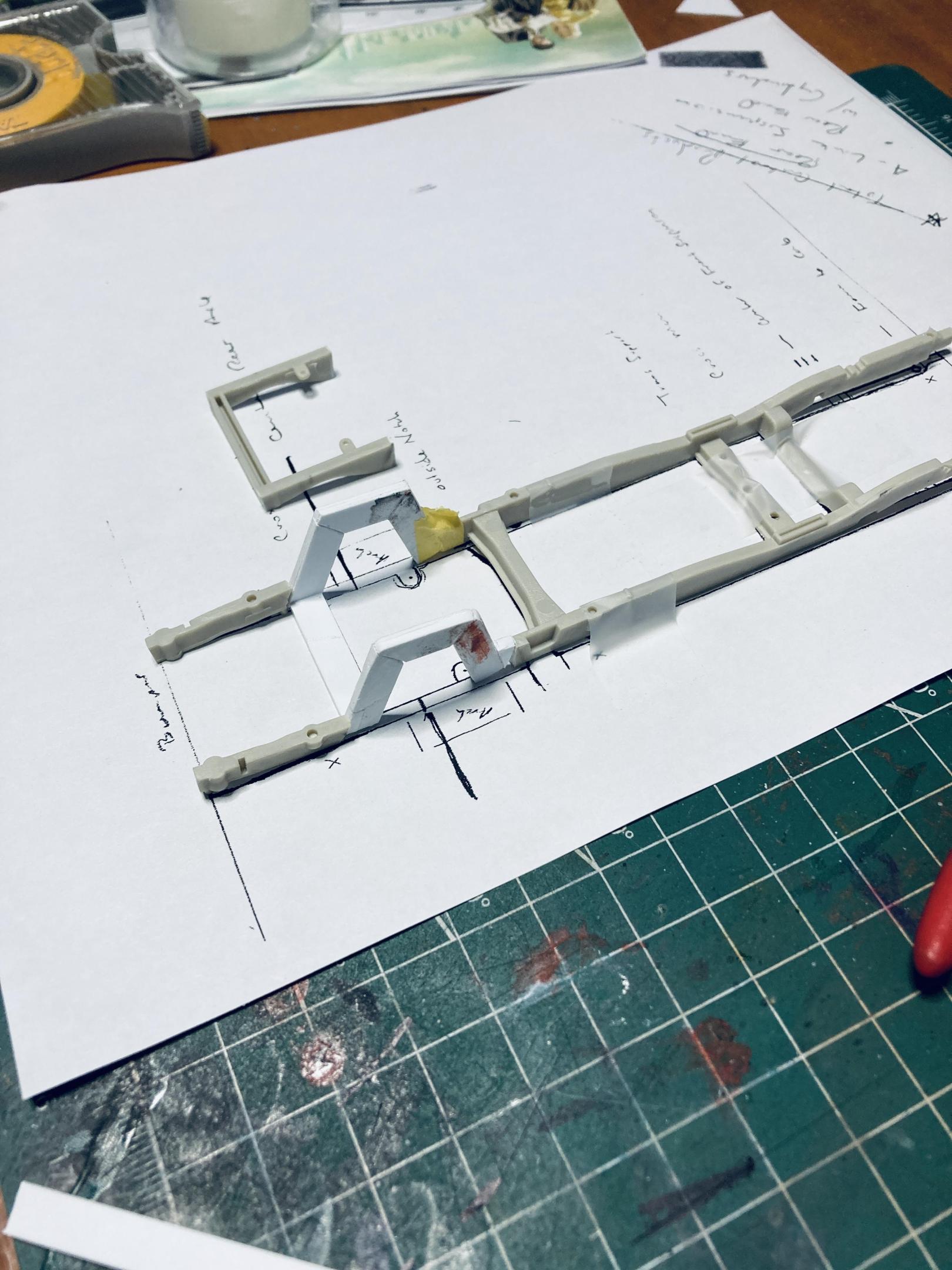

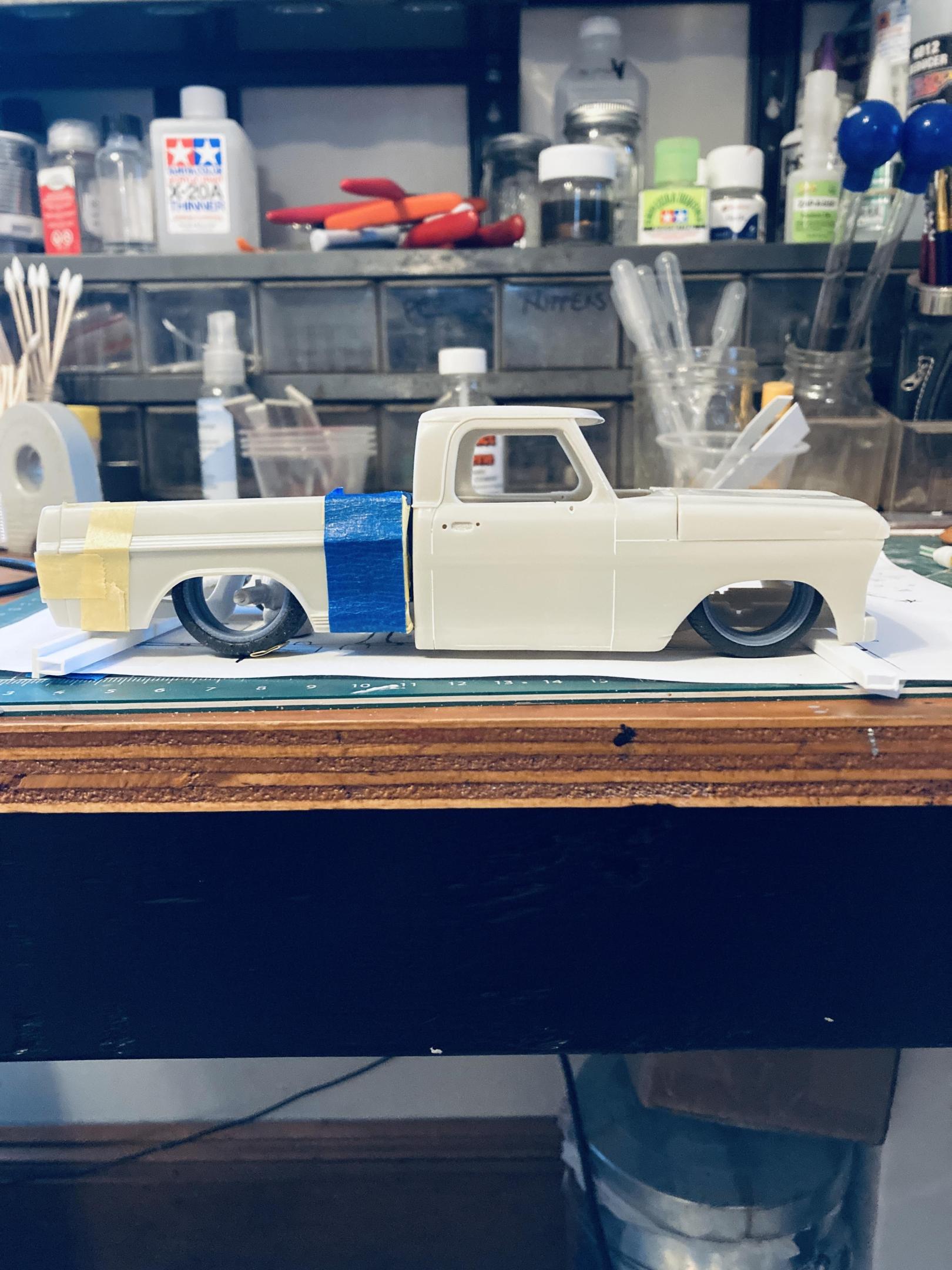

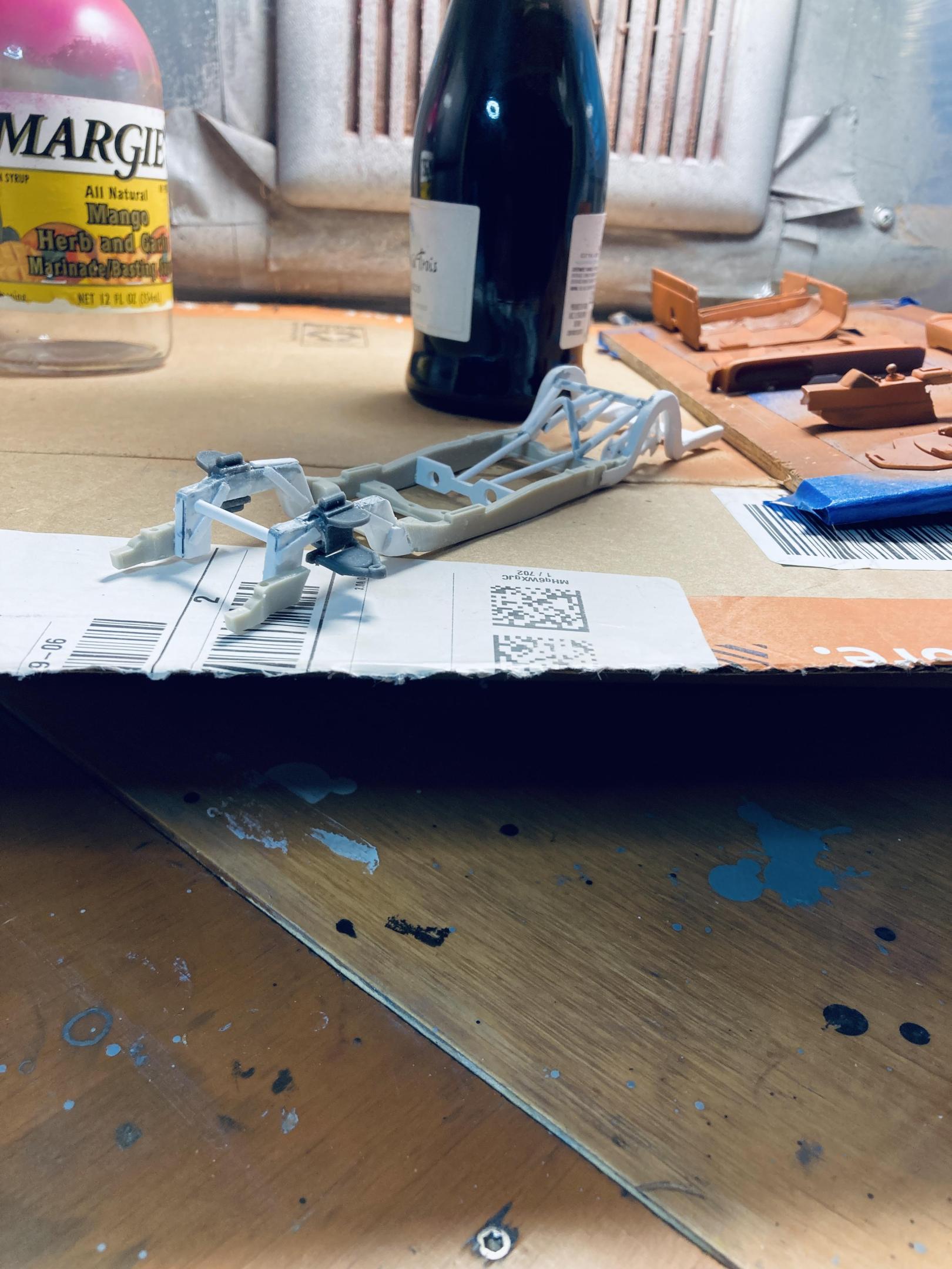

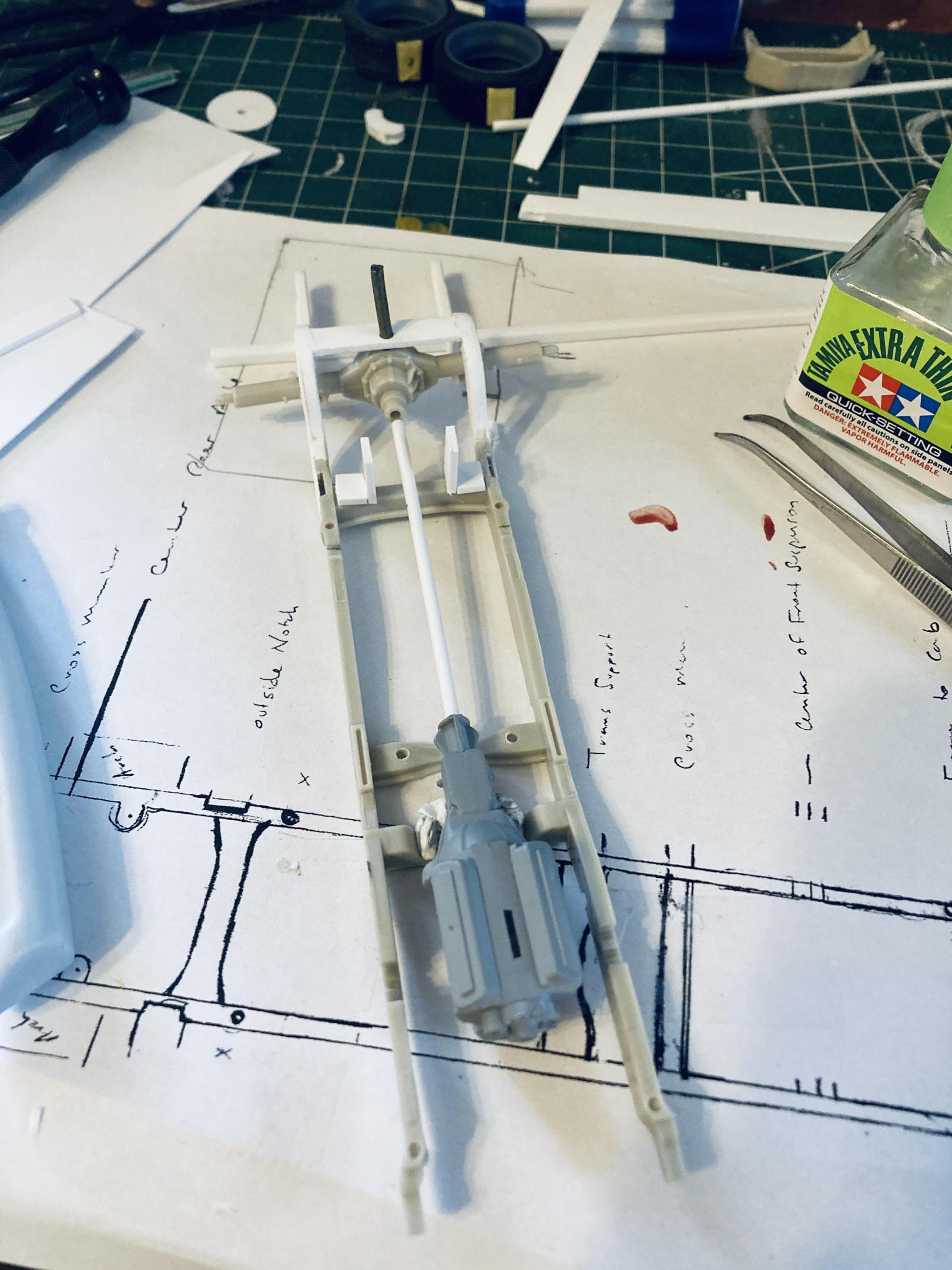

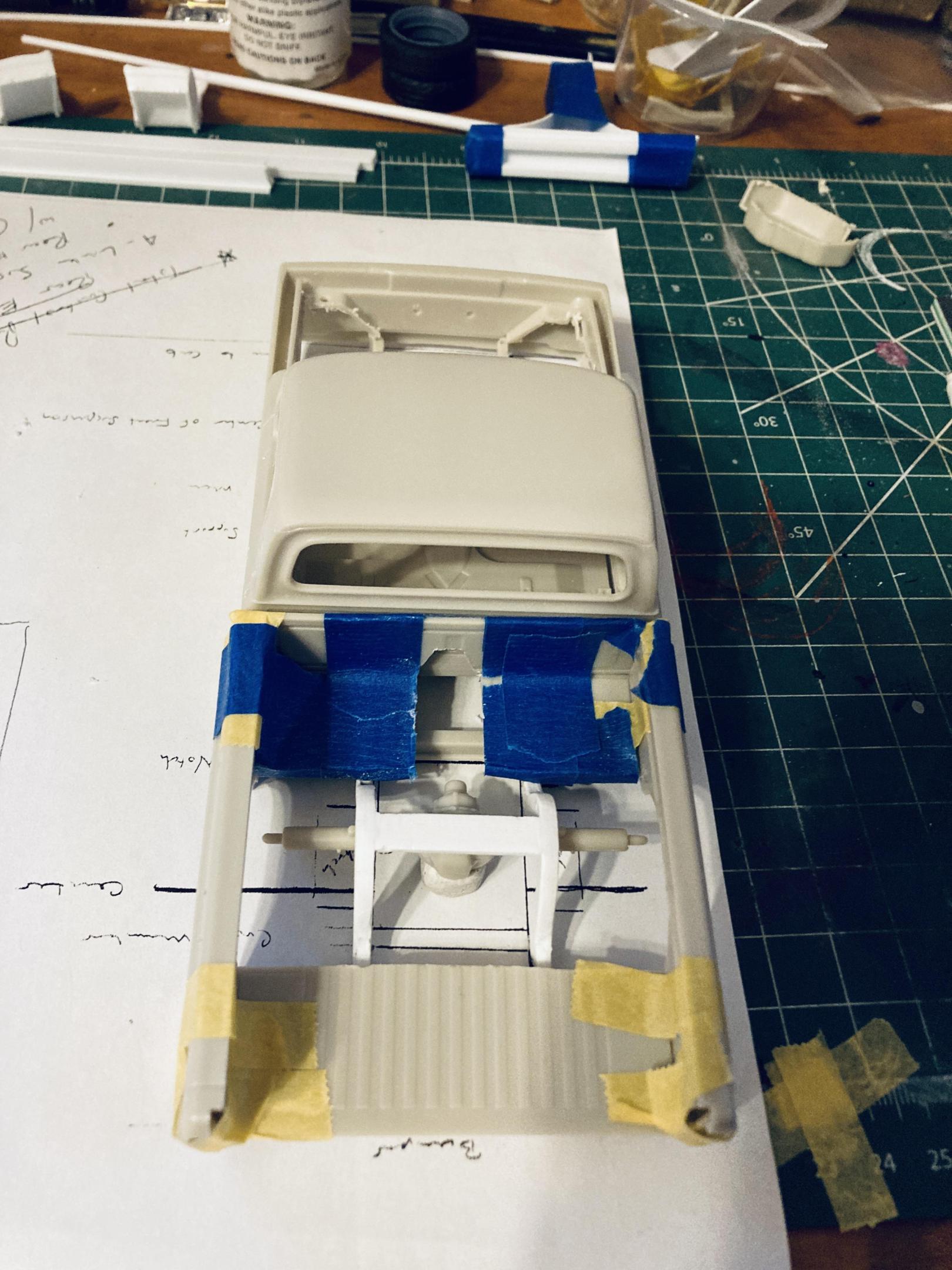

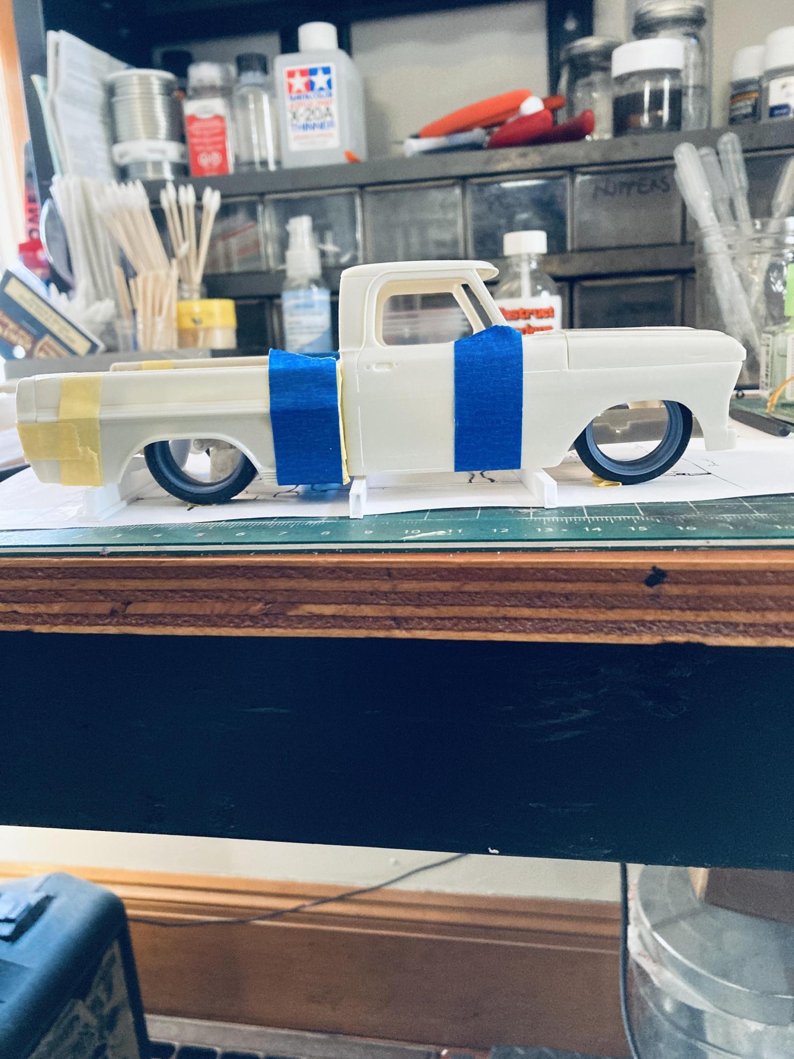

I’m lowering it to about 2mm from the ground, as going from 15-16 inch tire to a 22 inch tire. I started by tracing the frame on a piece of paper, making notes of mounting locations for body & bed. I mocked up a rear end with styrene, making sure it fell within Frame parameters, etc. cut and fabricated rear end o the frame. Not the cleanest looking, but I’m happy with it. I put some supports so I could set the diff/axle in place to mock up stance. Cut out the bed to fit tires. Cut out small areas as needed, as didn’t want to cut anything, if not necessary. I Fab’d the cage for the drive shaft and notched the cross member, in order to allow travel between parked and ride height. It’s obviously not going to go up & down, but trying to make it mechanically correct for once. I had to notch the bottom center of cab and open up the floor of the cab/tub. This will allow for the driveshaft to clear as it goes up & down.

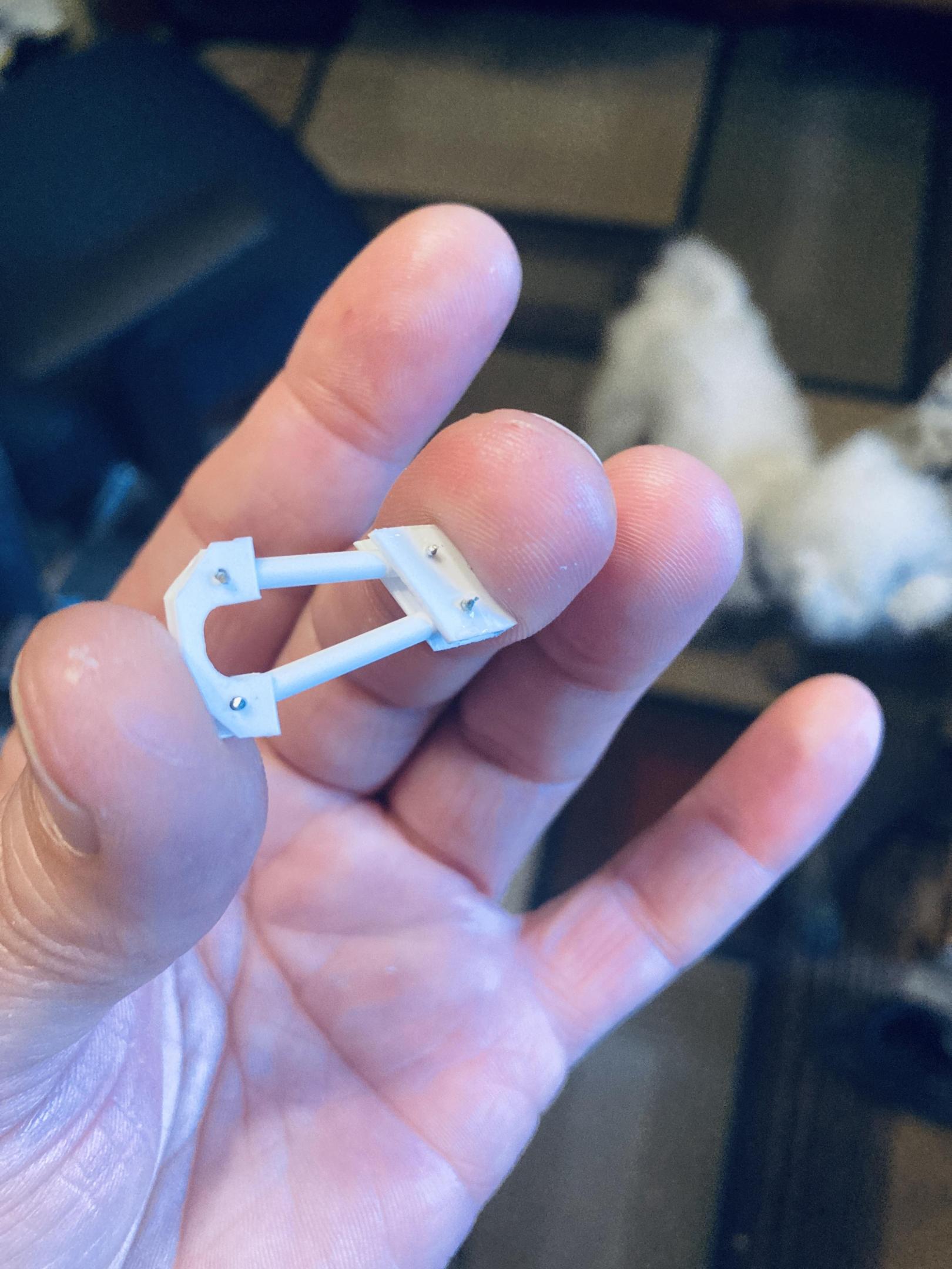

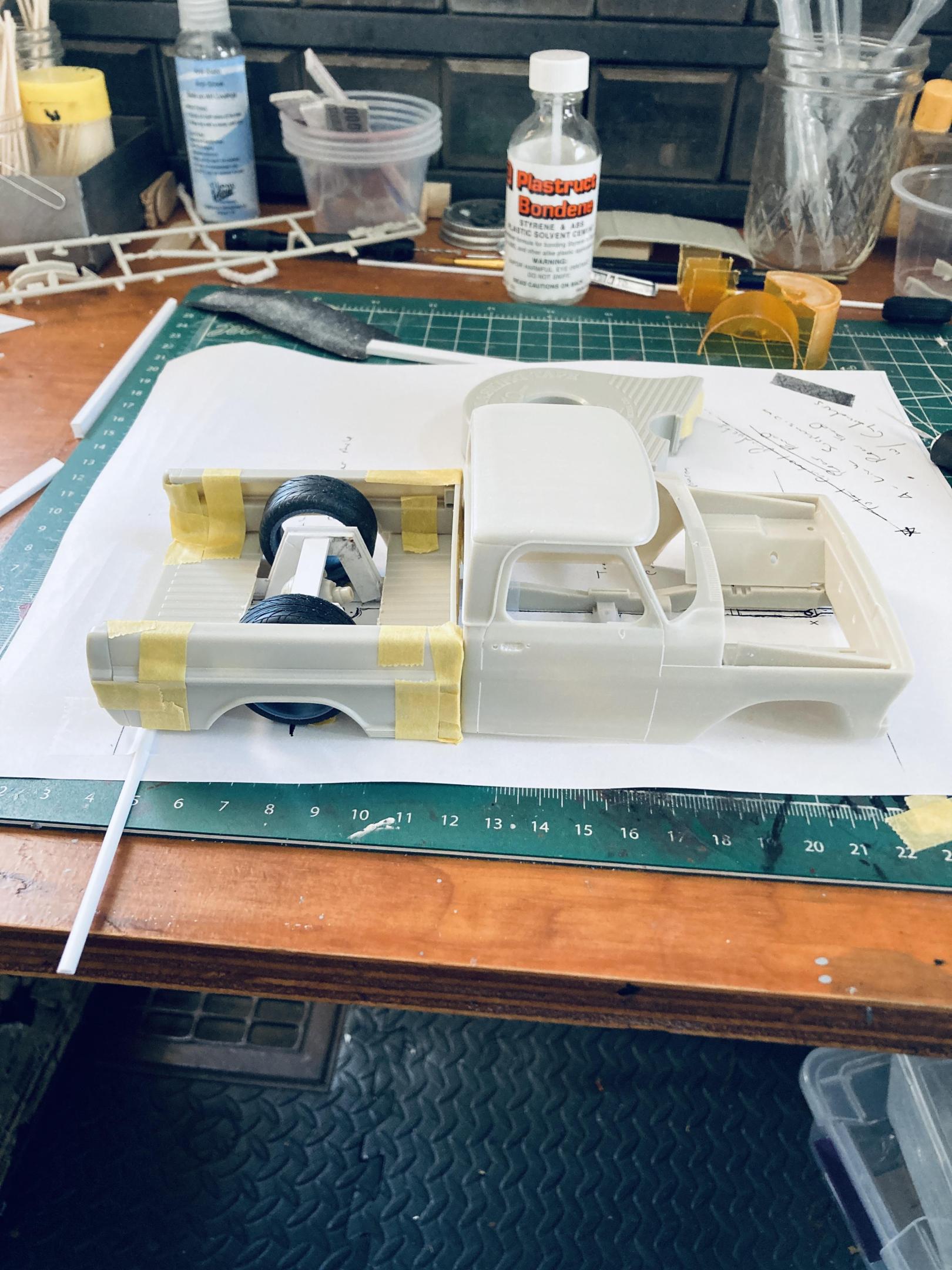

I was planning on doing a 4 link suspension with air pads/cylinders and all the fixings that go with it. I have looked around and thought I could build it myself, so I did. I think it’s to scale and it actually moves, as I drilled and used paper clips to pin the stabilizing bars & the slot where it mounts to rear axle. Got an idea to make cylinders and will mount to rear axle. That’s all for now, thanks for looking, constructive comments encouraged.

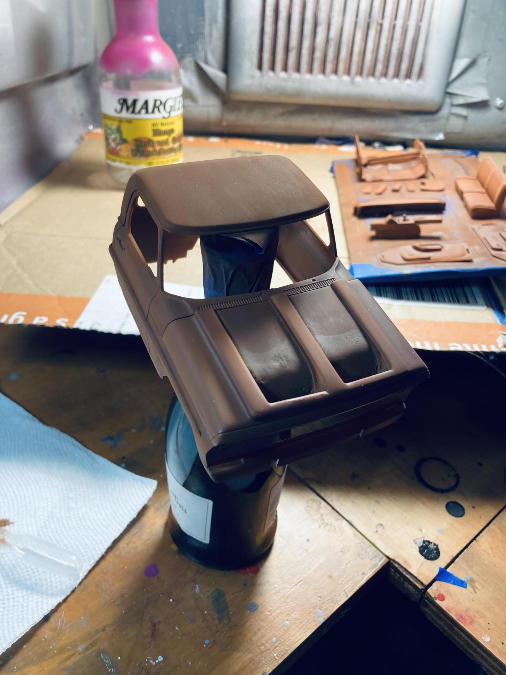

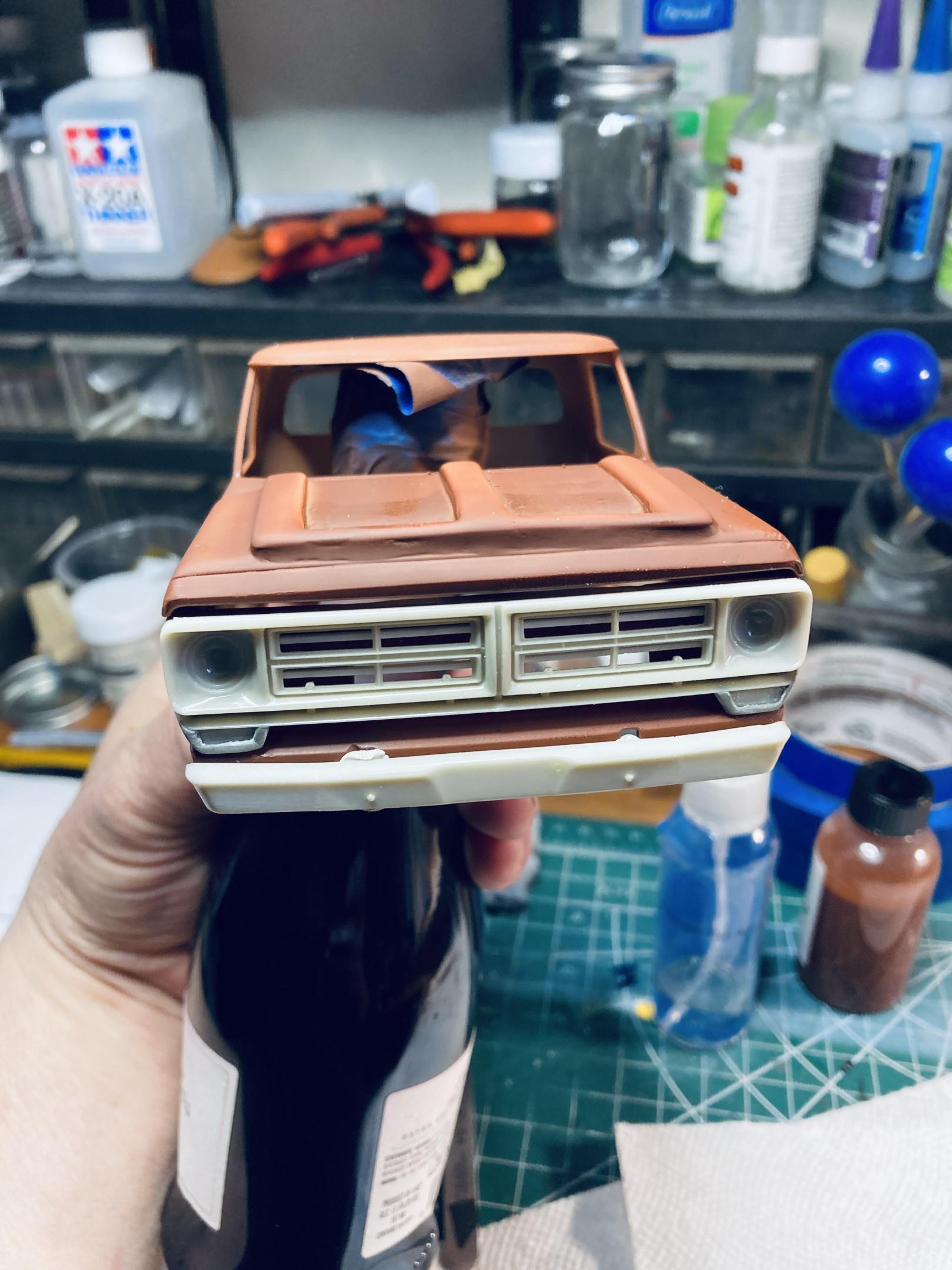

Sooooo, here is my latest update on my project. I have gained a whole new appreciation for scratch builders. I guess I’m doing some scratch building, modifying for sure. I never realized the time that goes into this hobby. I have made some progress, but it’s SLOWWWWW. I’m cautiously working and spending a lot of time just looking at it and getting my plan set in my head. I’m not a fly by the seat of your pants kind of guy, so trying not to have to do anything twice. This is very satisfying, but anxiety filled when making some cuts to certain important parts of the truck.

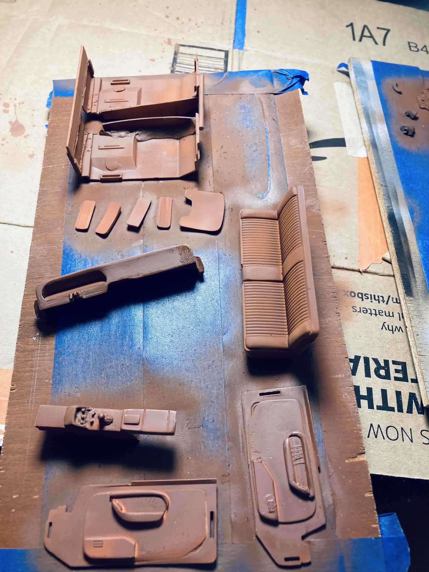

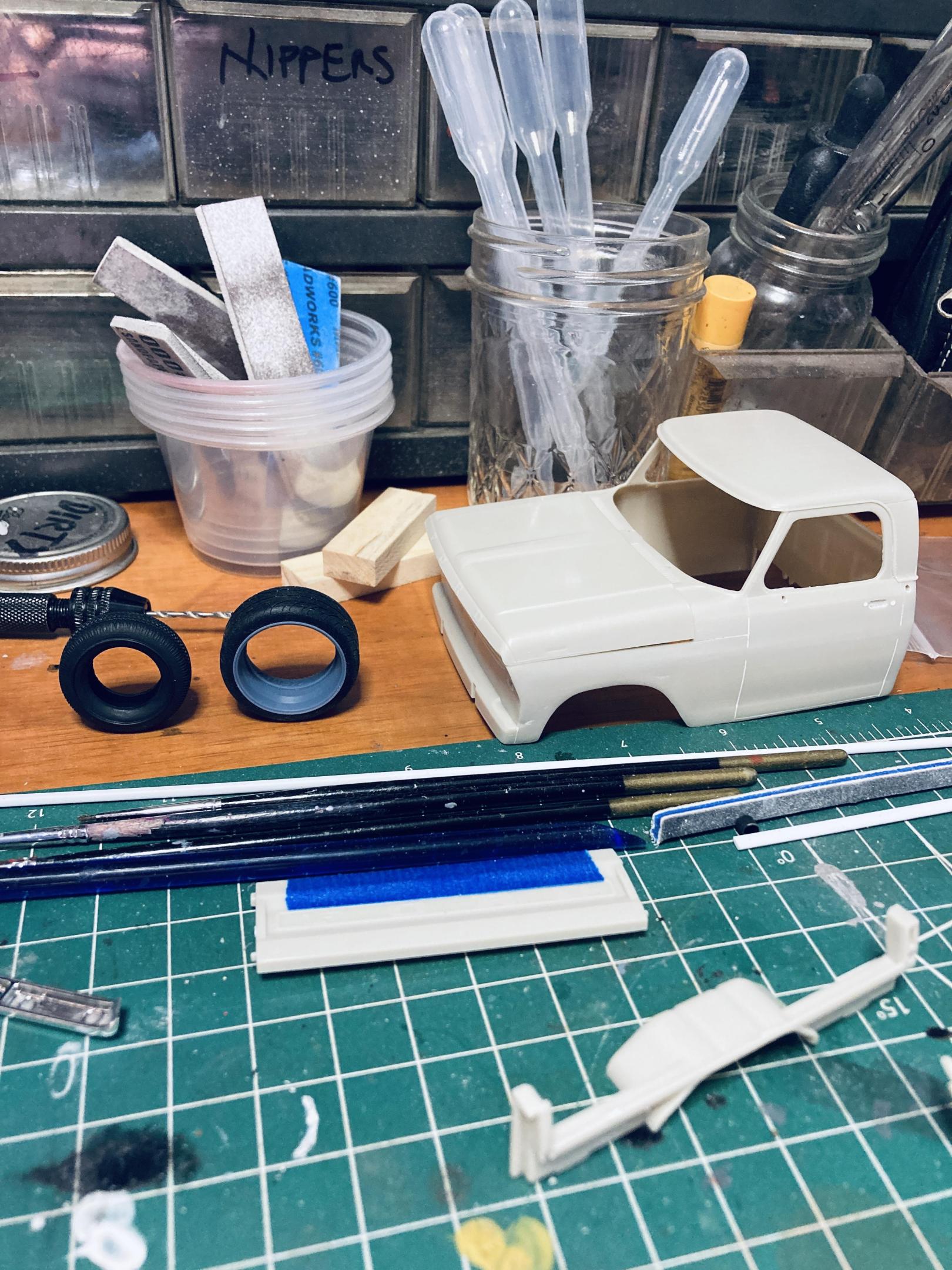

anyways, got the front end of the truck modified. Narrowed bumper, made grill and light one piece. Cut out the hood vents and added hood supports and primed( Going to frame out grills for the vents & install metal mesh). I have Fab’d the interior center console, dash and made door panels. I am using the bucket seat from kit and adding the center & seat cushions & vent grill. Embossing will go down for carpet, painted Italian red. Interior is going to be Ferrari red leather by gravity colors(Spain).

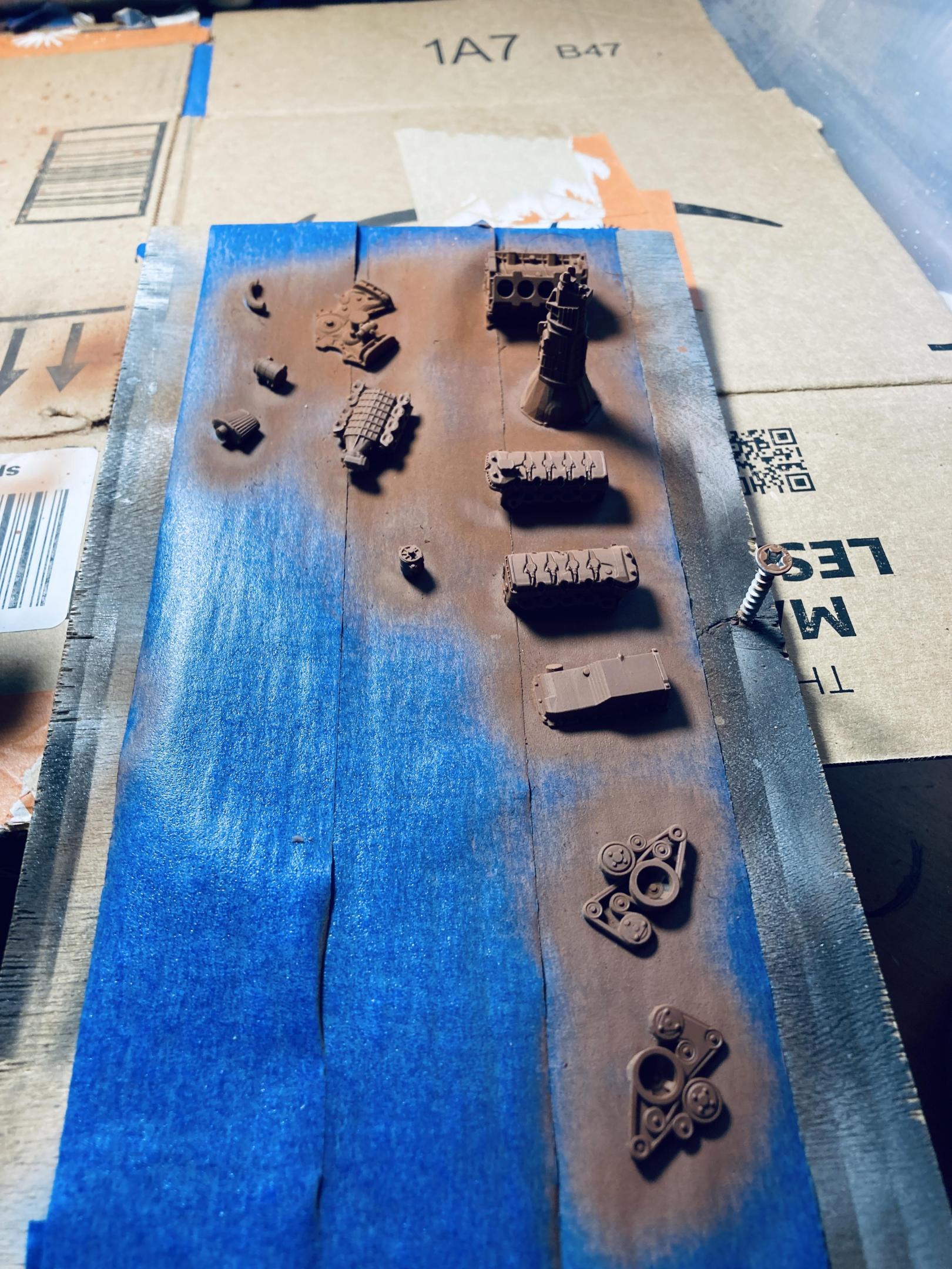

primed the 5.2L ford voodoo engine and will be cramming it into the engine compartment. Couldn’t find the Coyote engine in the 1:1, as I the whipper blower I foundwouldn’t fit right. Had this for a GT4, so said WTH and putting it in.

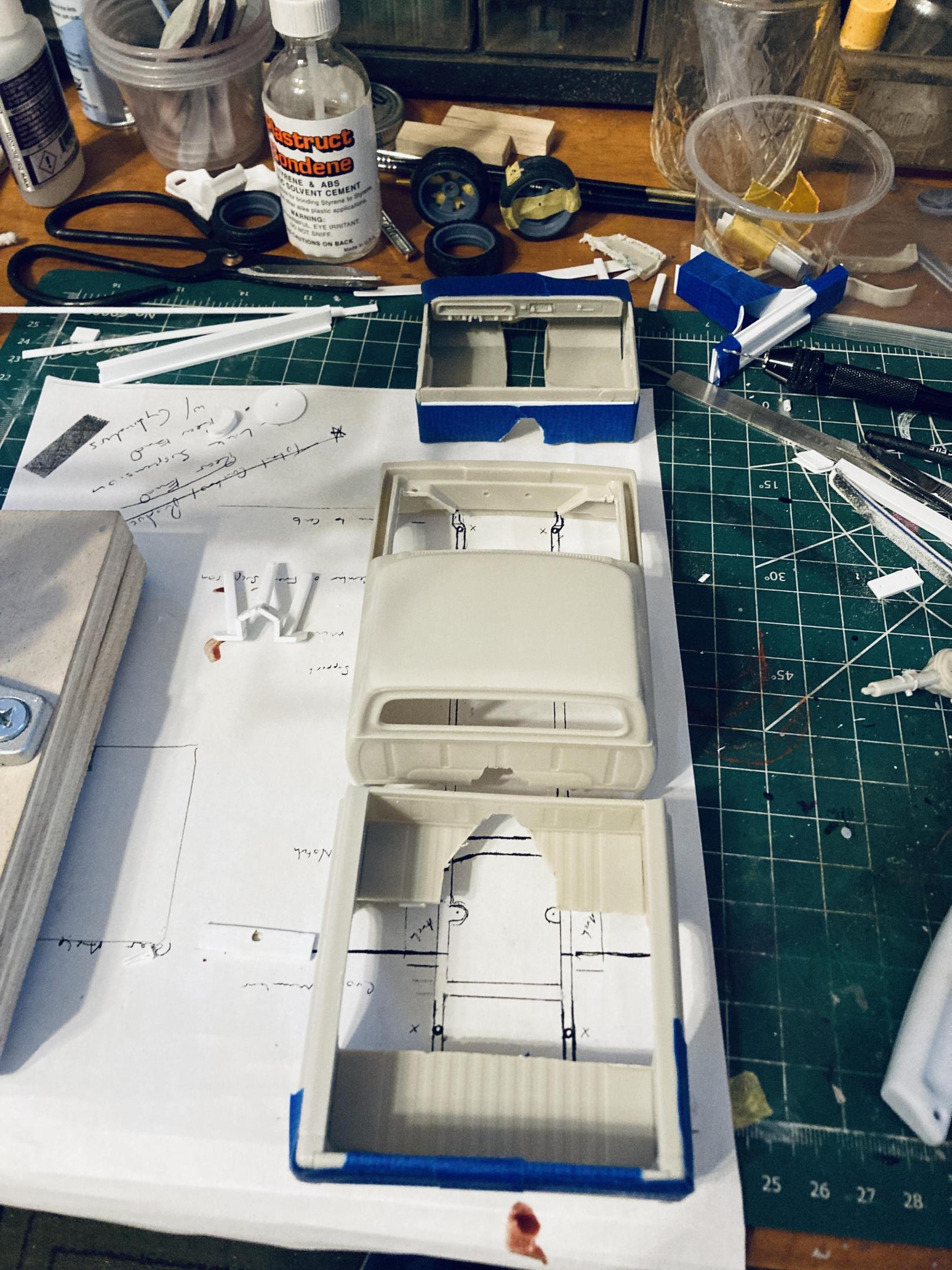

The rear tubs are done, just not welded in place. The bed is not going to follow the 1:1, as I want tho try to incorporate a real wood bed. Got the air ride kit accessories and will be installing. Finally got the front end frame notched and ind air ride mounts  set. Got some play to get stance just  just right, but that won’t be done for a bit.

Ok so I have been seeing this on a bunch of scratch built pieces.  But my question is what are you using to pin the 4link together?  I'm assuming that it has movement to it still?  I'm going to be starting a custom Ford as well and wanting to make sure I have some ducks in a row.
I just used a paper clip and snipped it  on each side after sliding thru the drilled holes and the loop at top of the stabilizing bar. For me, it allowed me get it set and move a bit to set, to anchor to the frame. The ones I did were my first attempt, so I think they could be done a little cleaner, but not going backwards.
