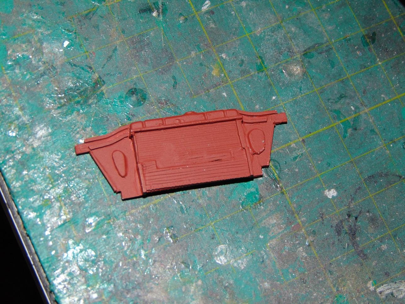

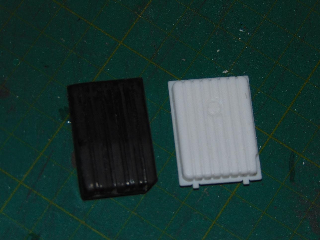

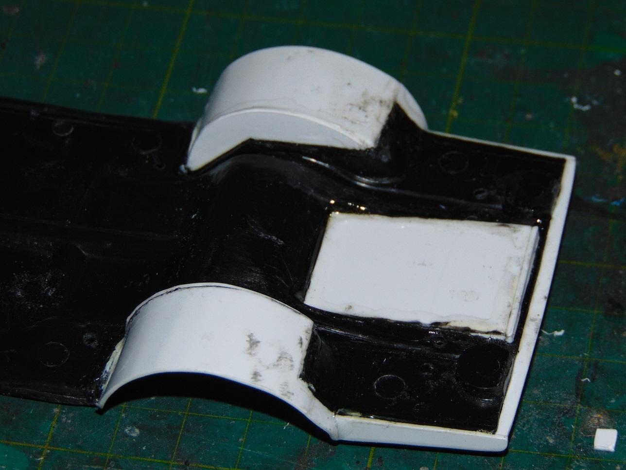

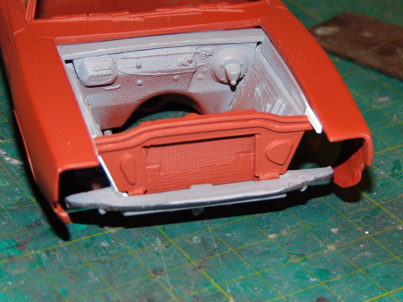

Made some inner rear wheel tubs and cut out the fuel tank. The fuel tank had very little detail and I'd normally just leave it, but I had a nicely detailed tank in my spares I've been trying to find a use for, and it fits perfectly after filling the hole that was left.

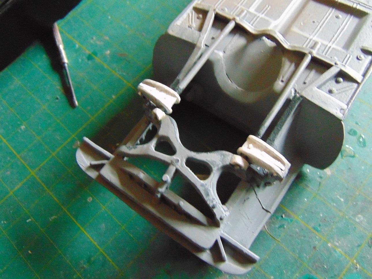

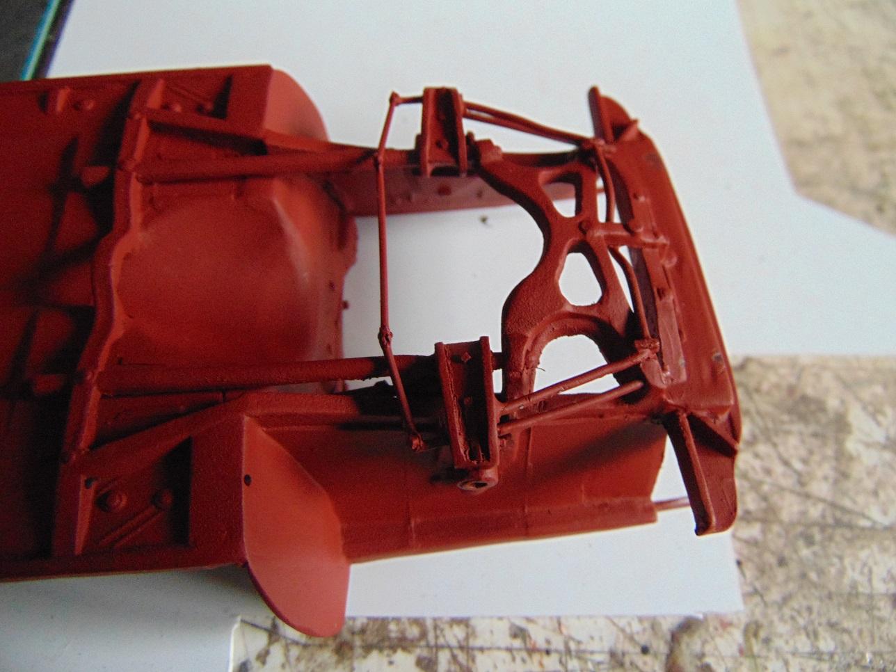

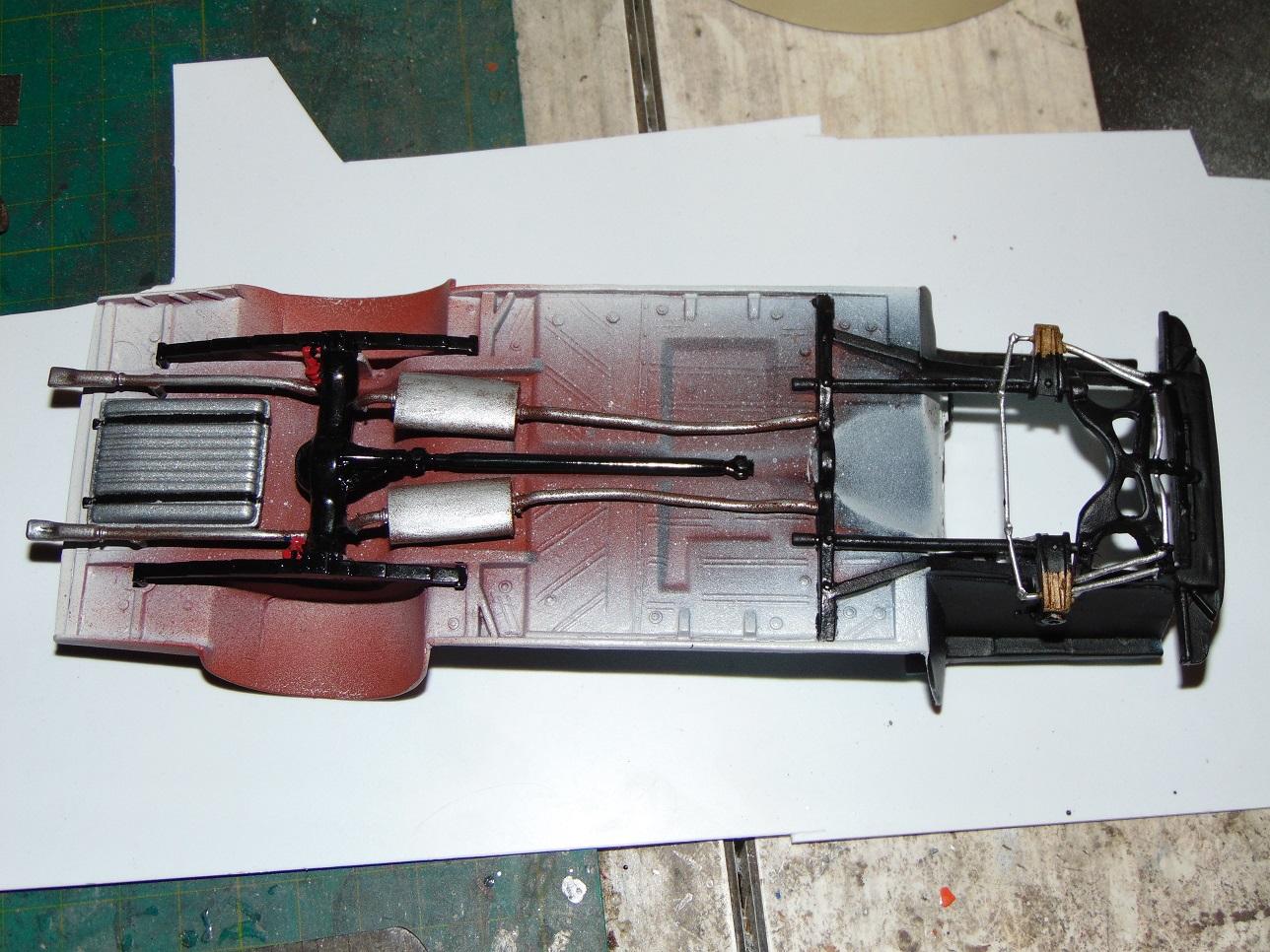

Moving on to the front suspension and steering. I cut off the blocks of plastic for the front wheel locations as both axle holes really aren't in the right place for the right stance. After you correct the firewall and inner fender rails it gets the chassis sitting nice to the rockers, but this messes up the ride height again if using either of the original axle holes. The rear is fine and can be left alone. I made some control arms and a simple looking shock absorber so I can position the wheels exactly where I want them. With enough work you could actually make all this functional including the torsion bars!

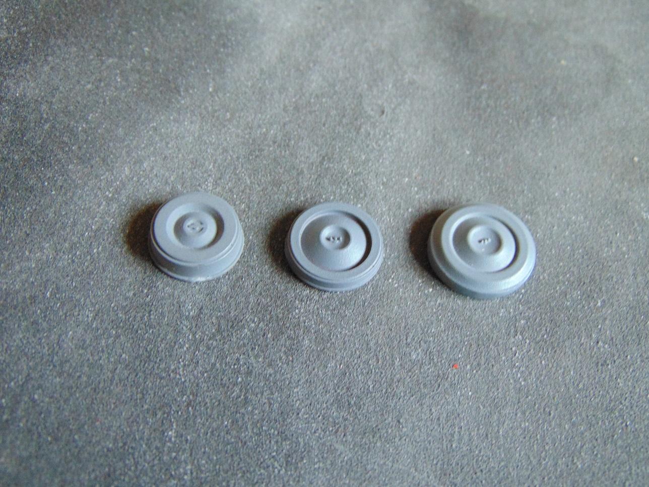

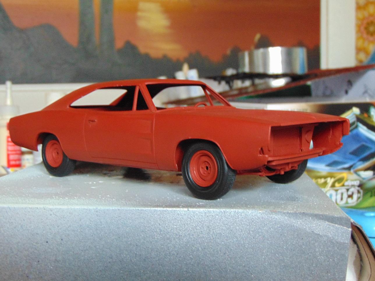

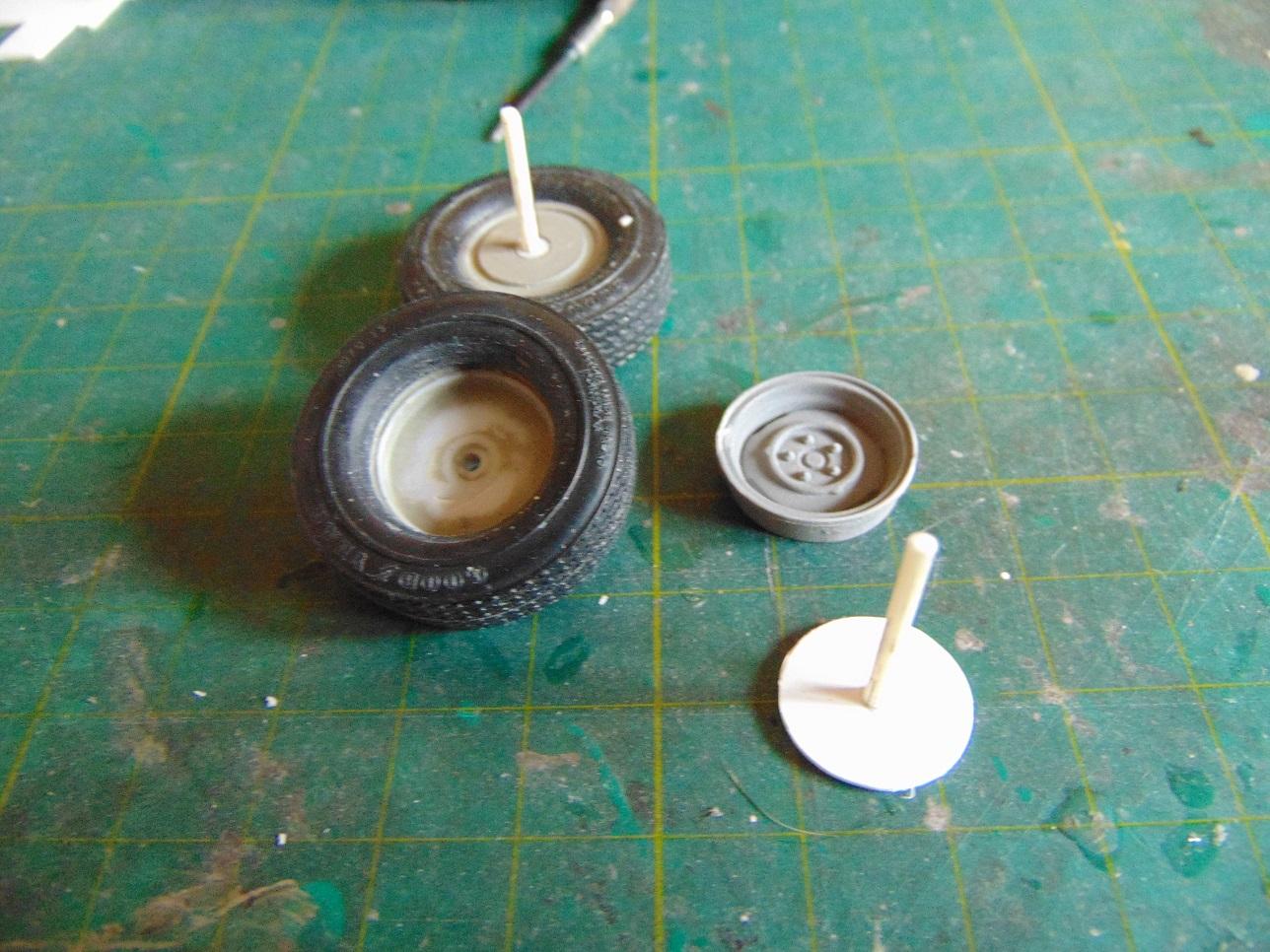

After the suspension mods, I was unable to use the wheels that come with the kit. I had to make up my own from various different wheel hubs and axle pins. I could just glue them on solid, but where's the fun in that?! Lol

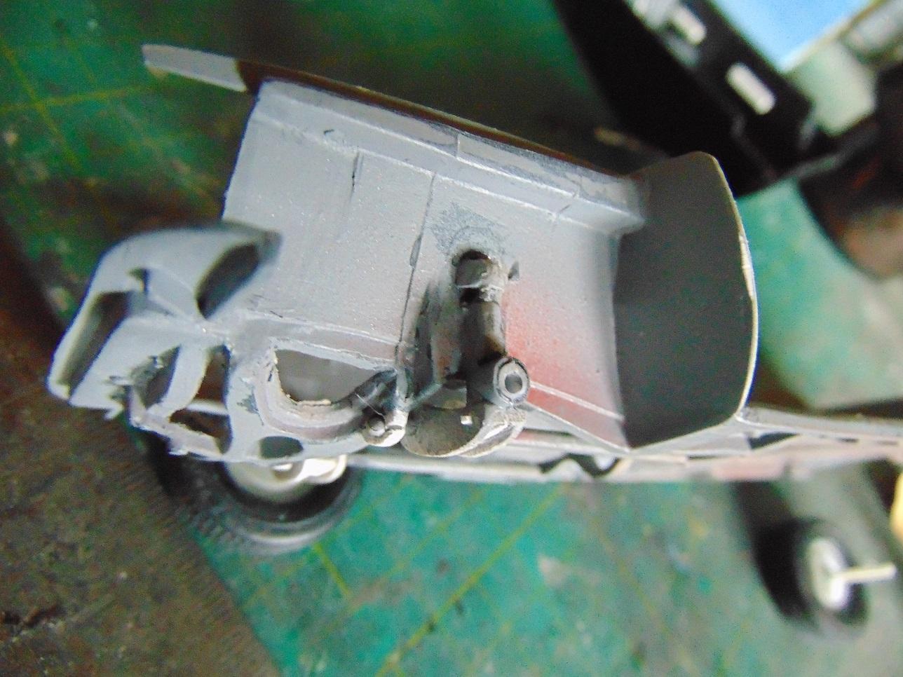

Found some air cleaner housings and an auto gearbox. Which of the air cleaners looks more suited to the 440? Not sure what car the gearbox is from. I'd like to go automatic with this one but the starter motor is on the wrong side but I could cut the bell housing off.

Thanks Greg. I've still the rad support and steering rods to fabricate but I run out of styrene, lol! I've ordered more but will take a couple days. I think there's about as much Evergreen styrene on this build as there is of the kit itself!?

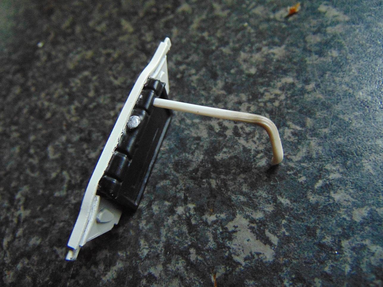

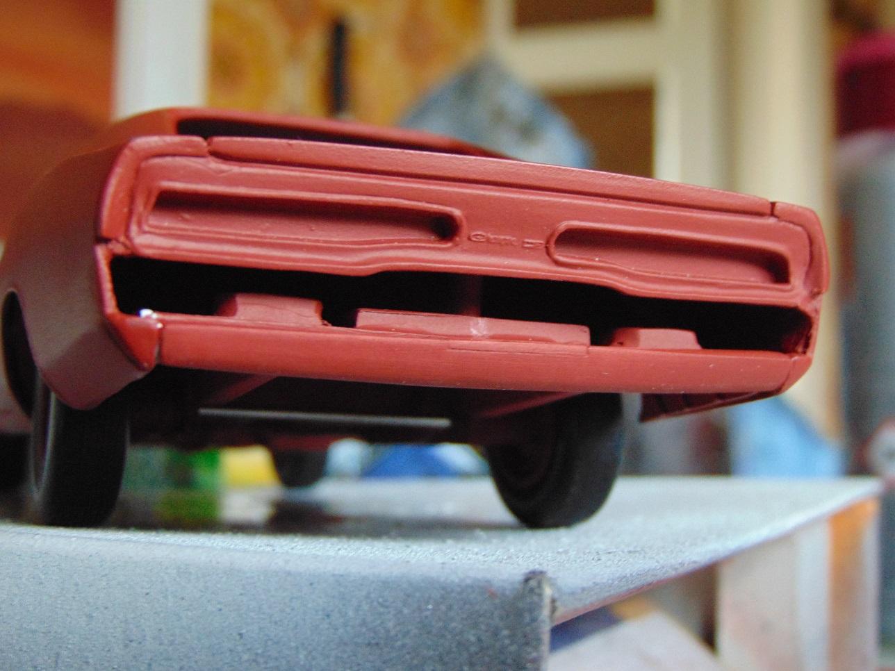

Got the steering and front suspension done today. Got rid of the flimsy rear valance halves and replaced it one complete piece, just need to do a set of reverse lights. I think that's it regarding the mods and upgrades. On to paint!

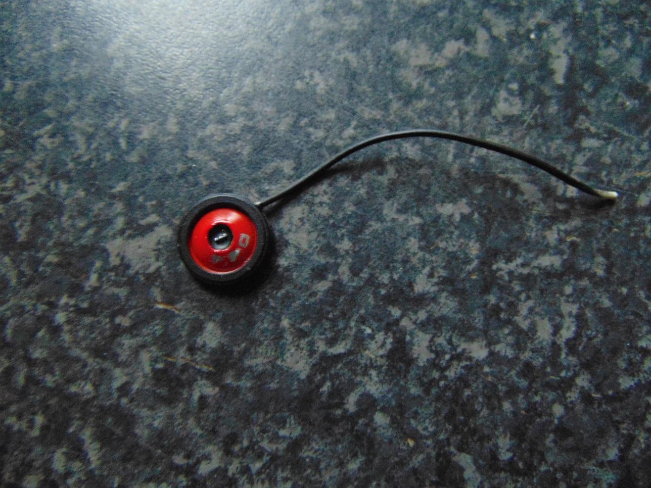

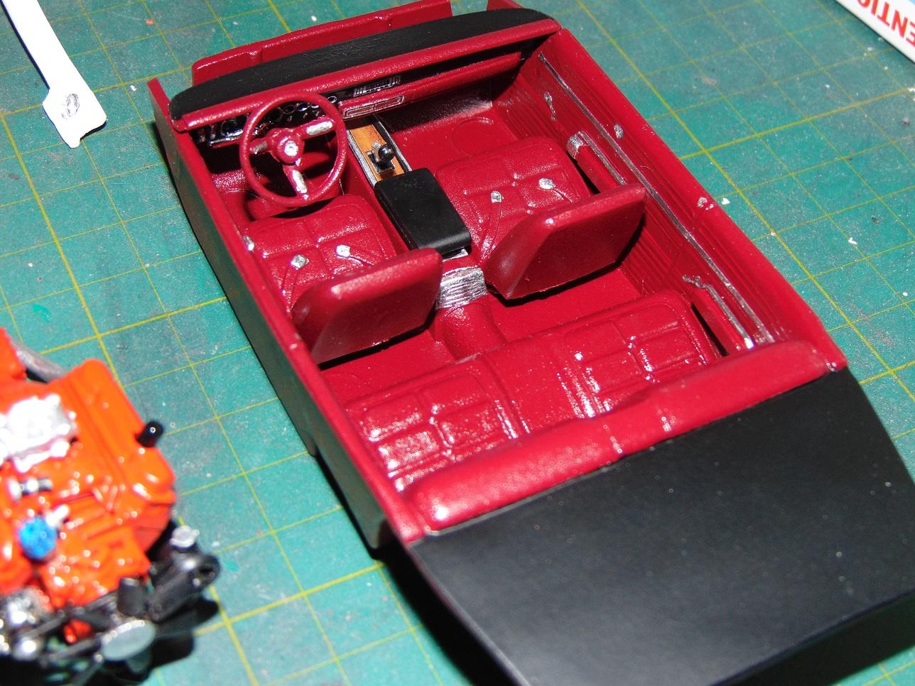

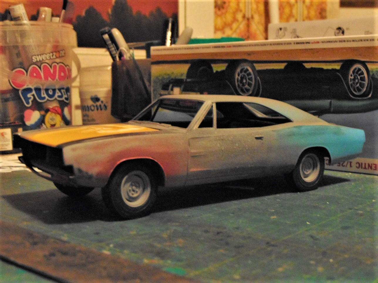

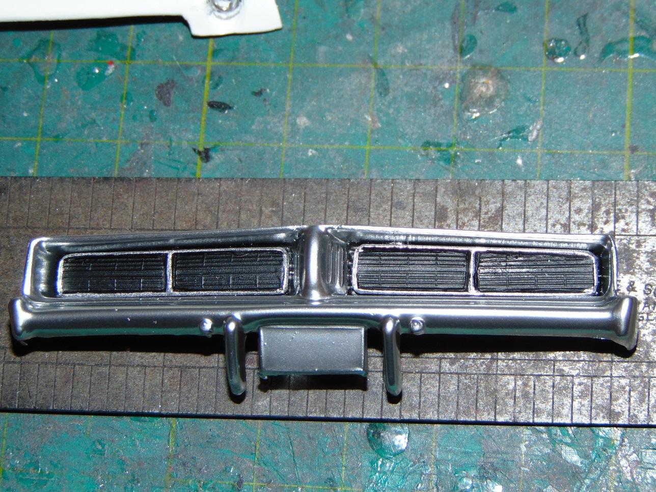

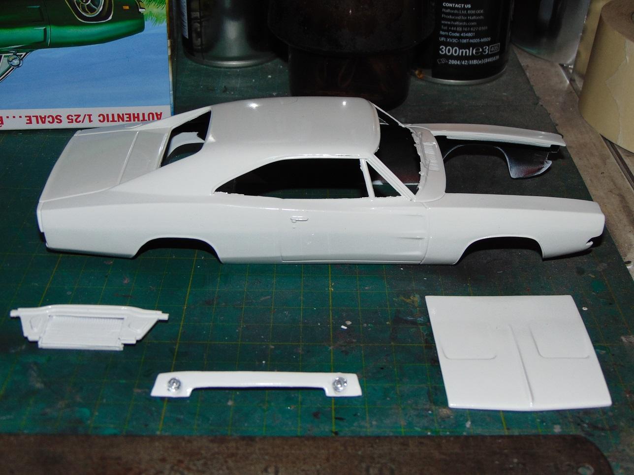

Some more progress. Got the body painted and the chassis detailed, also finished up the interior. The chrome came off the front grille so I had to use chrome paint, which doesn't look too bad to be fair. I also trimmed down the headlight covers and added some trim around them.

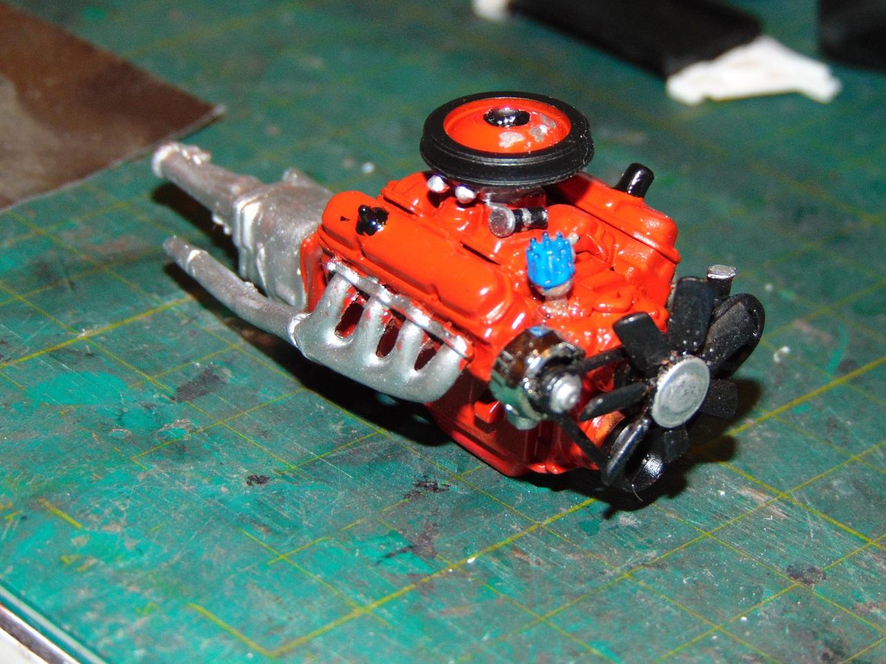

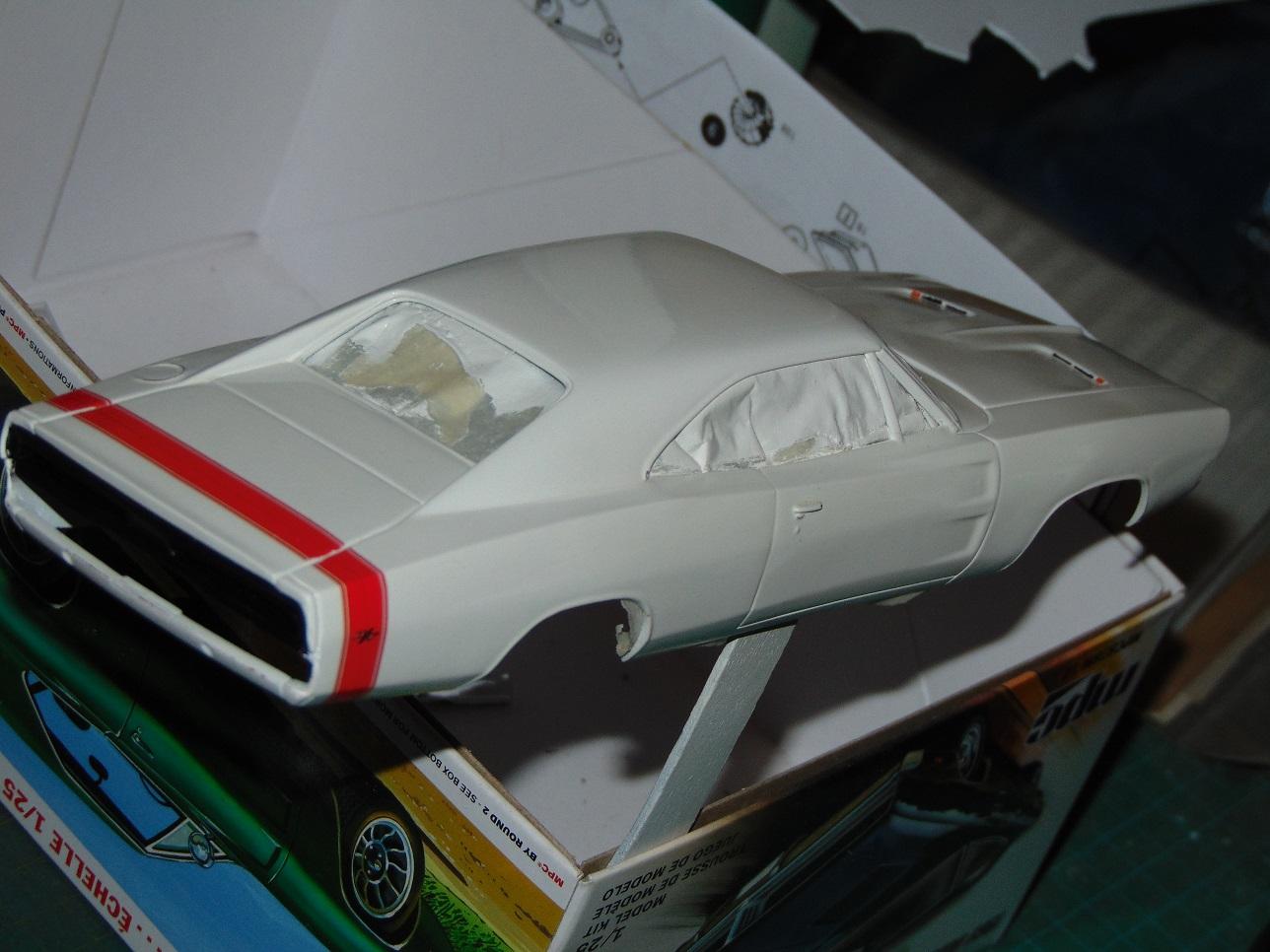

Engine near completed, just the wiring to do. Rear light panel painted and trunk stripe added. The trunk stripe is from the Revell '68 Charger, I split it down the centre line of the two halves and placed them together to make the '69 stripe.

On 5/2/2022 at 2:50 PM, doorsovdoon said:
The interior in this kit doesn't look half bad, considering the butchered mess they started with in the original General Lee/K&K Insurance Daytona aberration. You've improved the chassis a lot with the details you've added and corrected.
Hard to believe it's the same kit!
Edited by Oldcarfan27
Yes, the interior is not bad for such an old kit, at least the front seats don't look like blocks of Lego! lol. Dash has some decent detail too.
