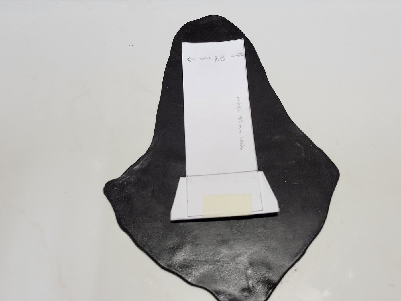

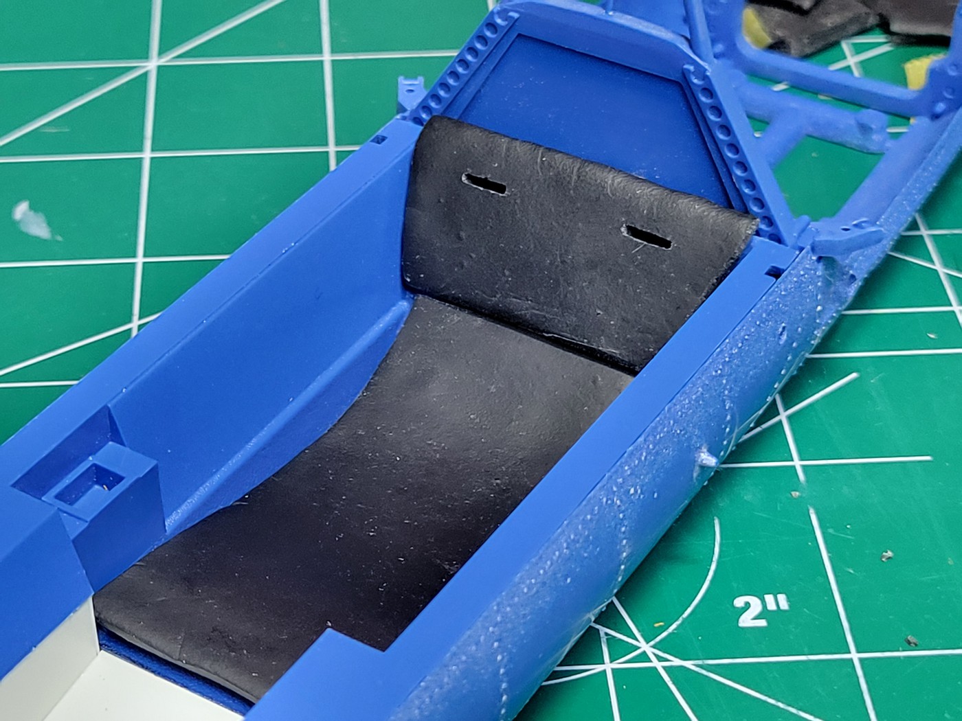

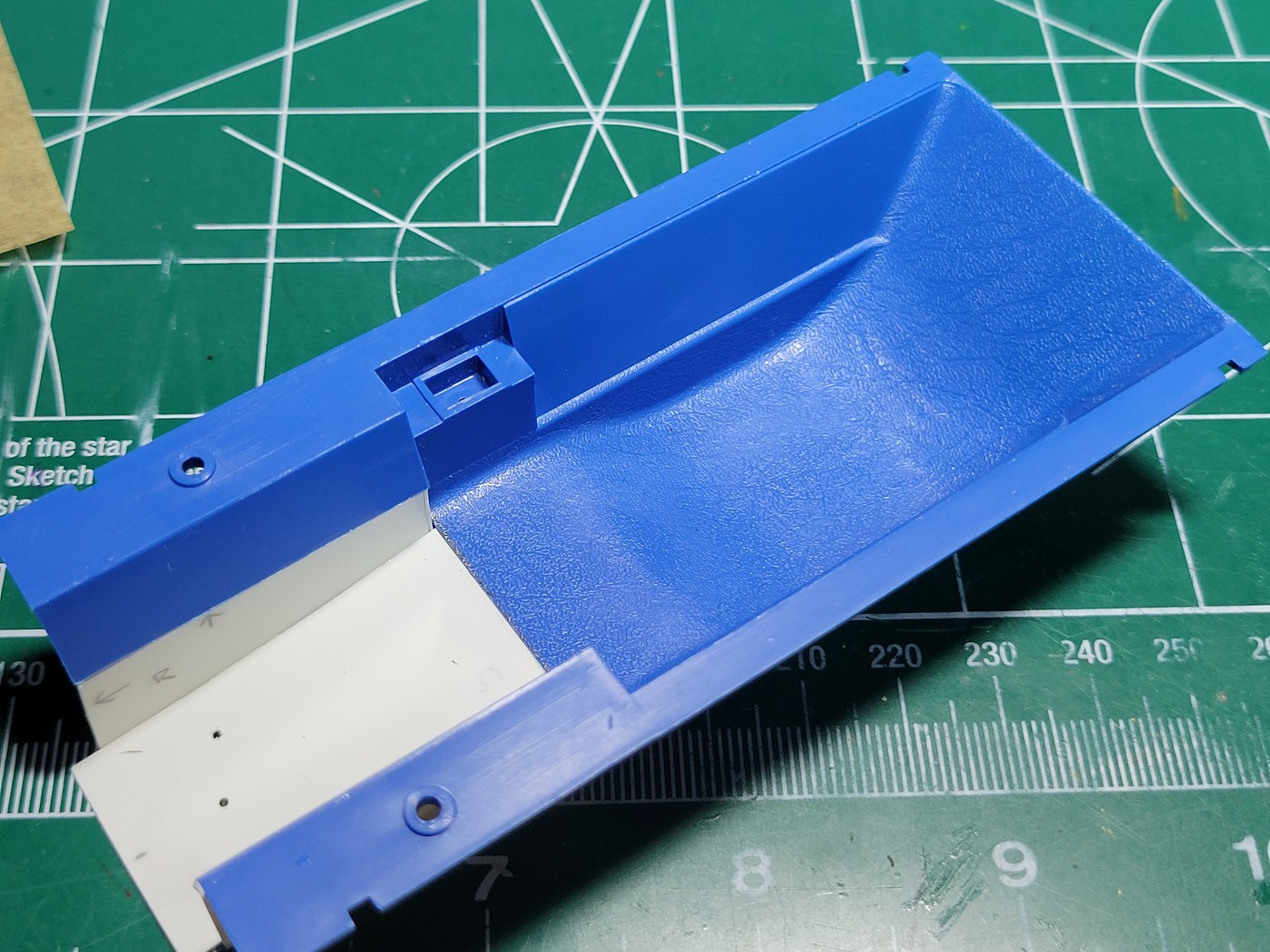

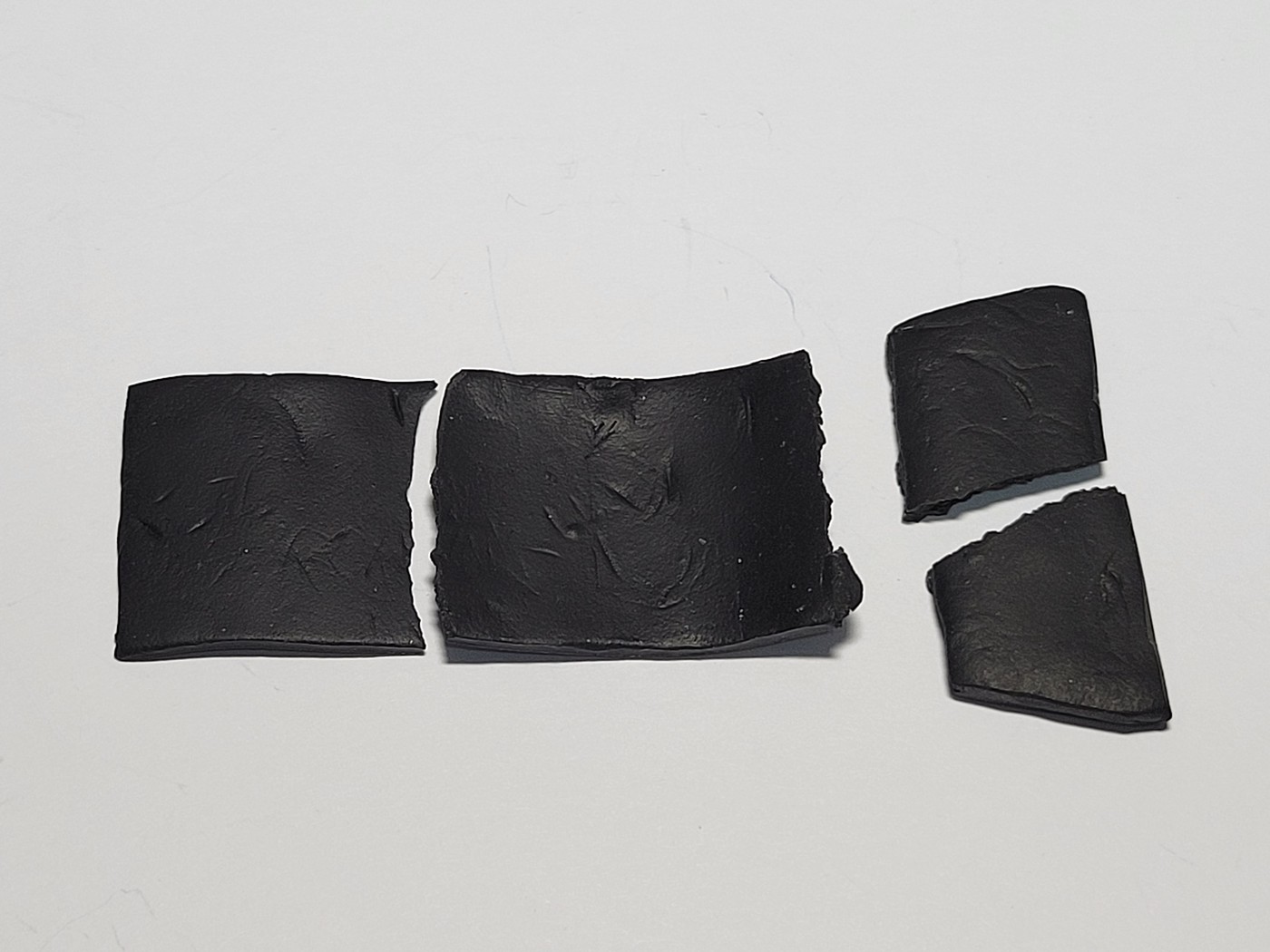

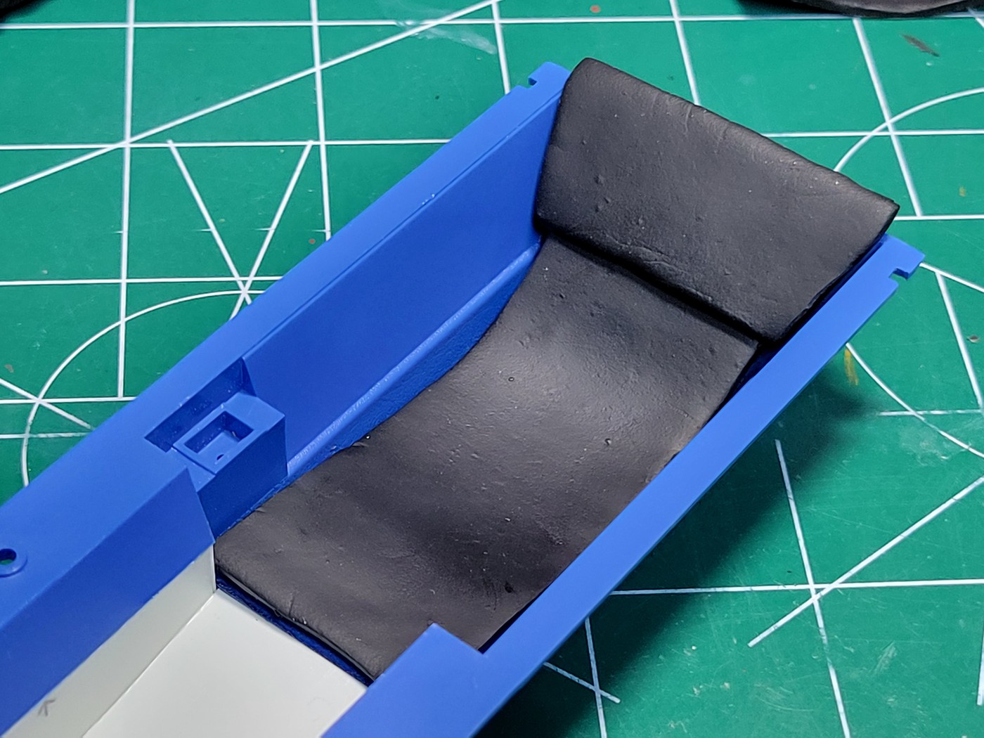

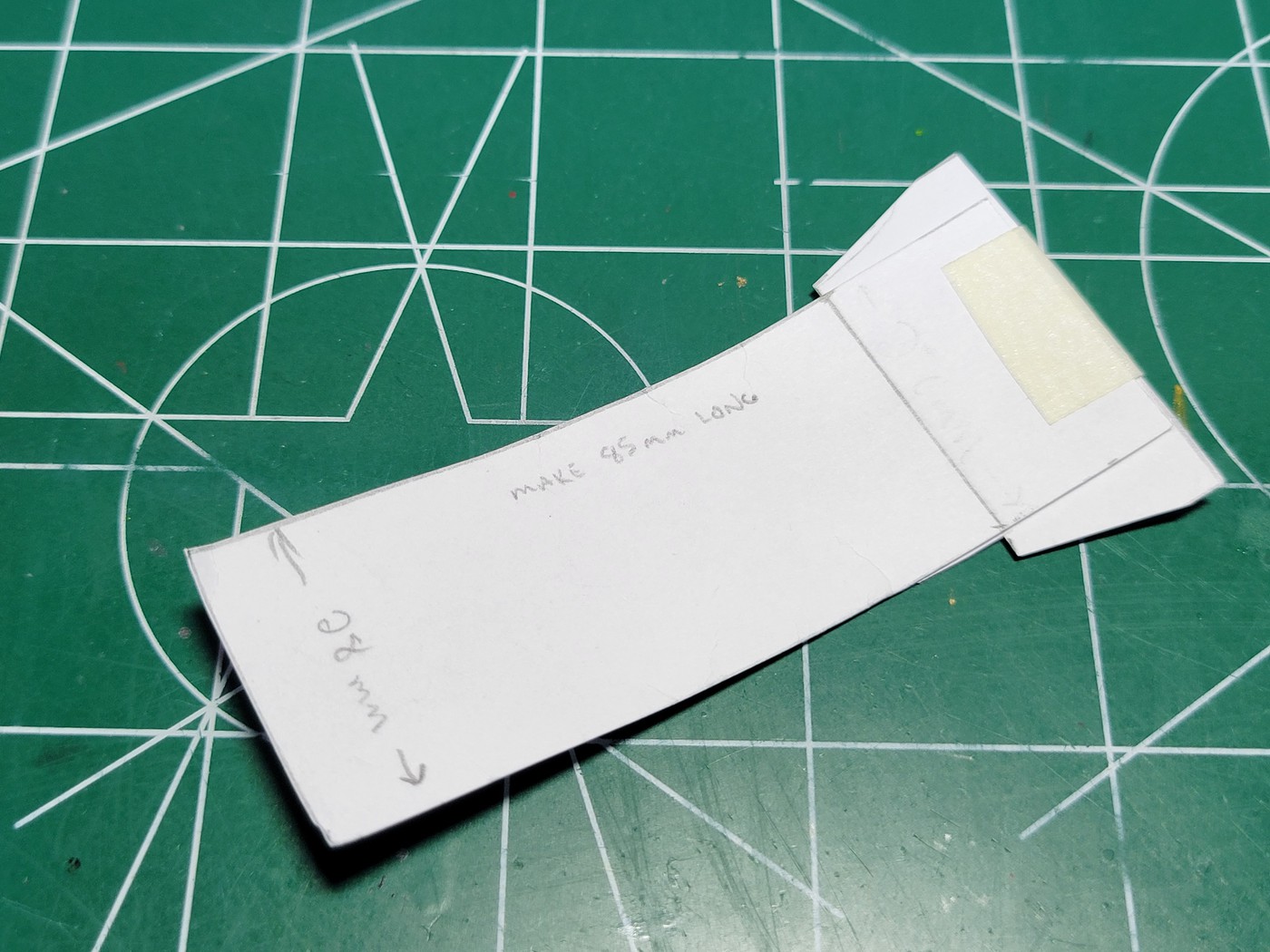

Nacho Z Posted January 31, 2023 Author Posted January 31, 2023 I see that September 26th was my last update. I assure you that I have been busy working on this model. I will try to get caught up on my progress. I also realized that I haven't been all that active on MCM. I'm not sure what happened...lol. This update will concentrate on the cockpit. The real car's cockpit was very sparse and the model's cockpit is worse. Because of it was designed to have a driver figure installed in it, Tamiya did not provide much seat detail. I wanted to add what little seat padding the poor driver had. Here is what I came up with. This is the kit part, (in blue), along with what I added for the footwell and pedals, (in white). There is some molded texture but there is no depth to the seat area. I had an idea of trying to make the missing seat padding out of clay. I made an index card template of the textured seat area. My wife was kind enough to let me use one of her rolling pins. A plastic fondant rolling pin with rings to be precise. Actually, the rings are important because they allowed me to roll the clay out in exact, even thickness. I laid the template on the clay and cut it out. After I cut out the seat padding I doubled up the padding for the driver's back, just like the 1:1. I wore nitrile gloves while working with the clay and used the gloves textured fingertips to add texture to the clay. I formed it to the kit seat and then baked the clay per its instructions. Although hard to capture in a photo, the clay's finish really looks the part. Time for full disclosure. My first attempt did not go well. I believe my clay was old and a little dried out. The first attempt at shaping the clay went sideways and then the clay cracked and broke on me. When my second attempt was finished, I realized that I did not add slots for the shoulder belts. I very carefully put them in. There are some exciting, (at least to me), updates just around the corner. I'll see you then! 2
MarkJ Posted January 31, 2023 Posted January 31, 2023 John, thanks for opening my eyes to the use of clay. I did not know that was a possibility. I might have to try it someday. Looks great for your seat.

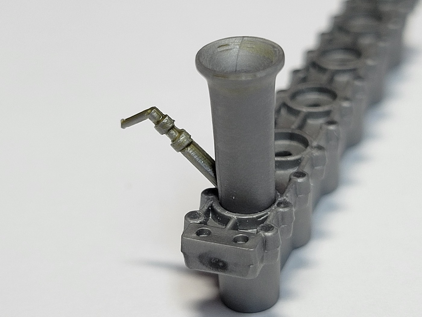

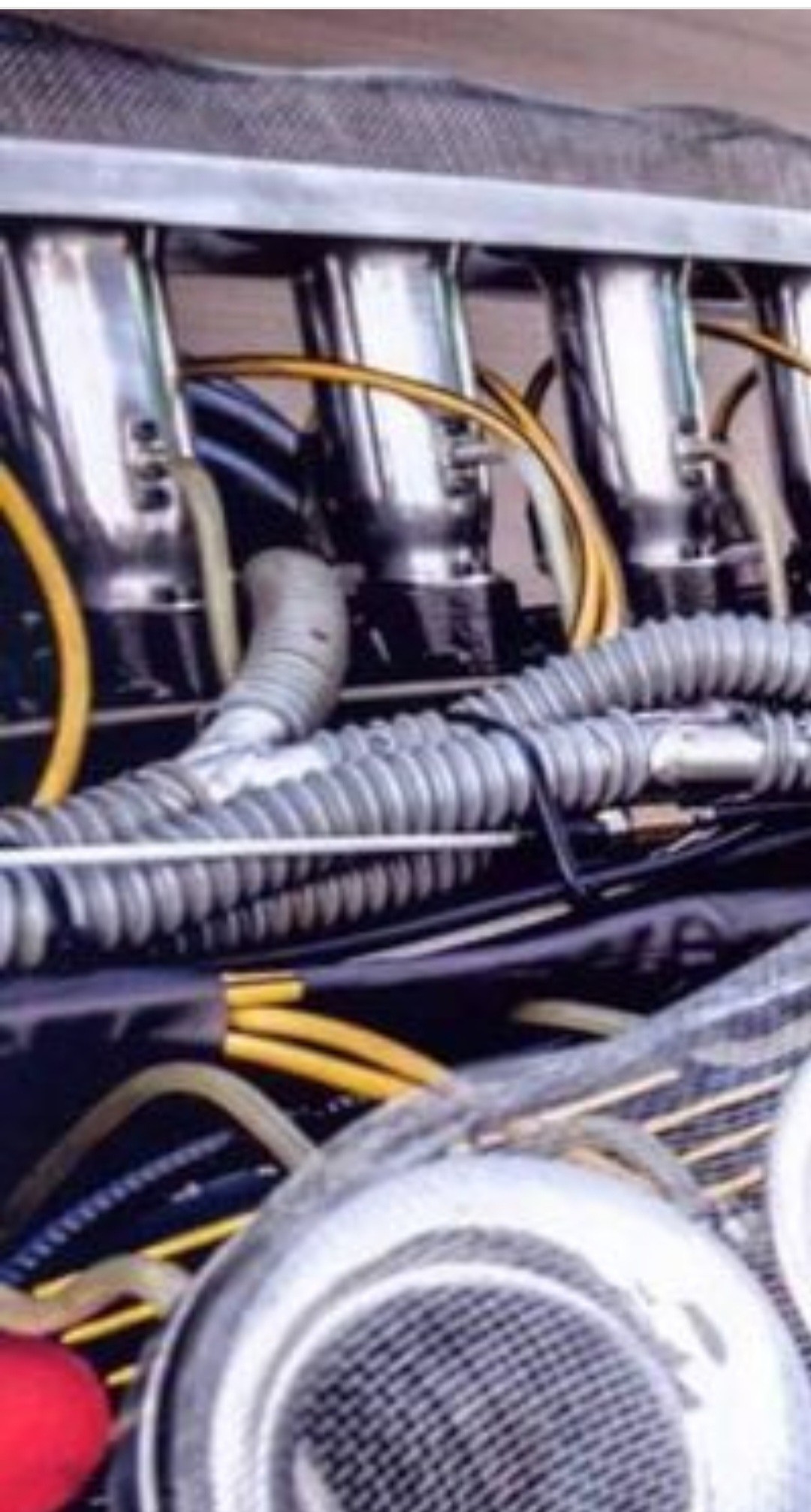

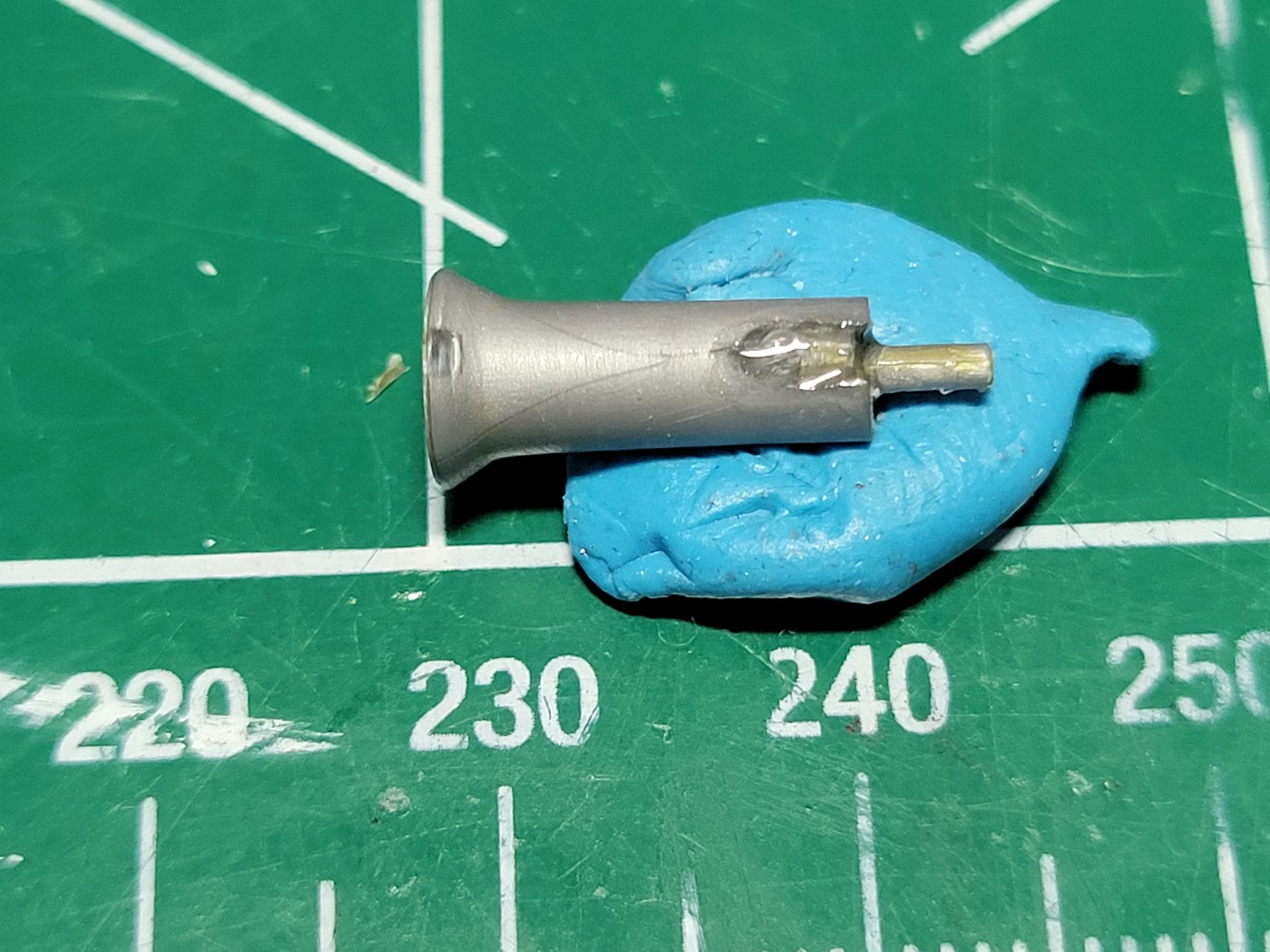

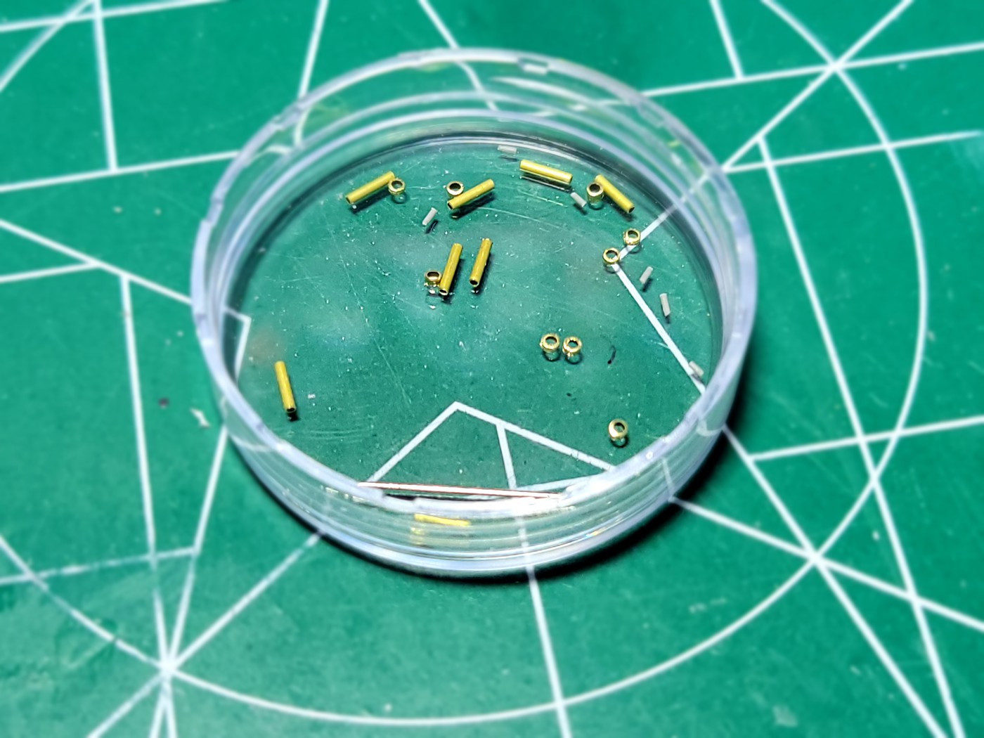

Brudda Posted January 31, 2023 Posted January 31, 2023 On 5/23/2022 at 9:54 AM, Nacho Z said: Keeping on the subject of air funnels and injectors. I have been concentrating my efforts and work on these. At this time they are not finished but are close to being done. I will share the progression of my work. I will keep repeating that I am not the world's best scratch builder. I have a general idea of what I want to accomplish and then it takes me several tries to figure out how to make it. The kit supplied injectors are incorrect for any Matra engine that I have seen. The kit supplied injectors are also poorly molded and would have taken a lot of work to make them look presentable. Here are two pictures from the internet of what the 1:1 look like. This is what the kit supplied setup would look like. I came up with a basic game plan of how to make new ones and how to correct the existing air funnels. I glued the incorrect injectors into place on the funnels. I cut off the injector "arms" and then filled the leftover gap with CA glue. I hit the CA glue with accelerator and sanded the area smooth. I tried to create the base for the new injectors by hand but quickly realized that I would never get 12 uniform bases. My wife cut them out for me on her Cricut. They are slightly oversized. I wanted to be able to add the injector nozzle and two bolt heads to each one. I cut two different sizes of brass tubing to represent the nozzle and its base. I used .7mm MasterClub bolts. Here is the first mockup. Nothing is glued into place yet. WOW

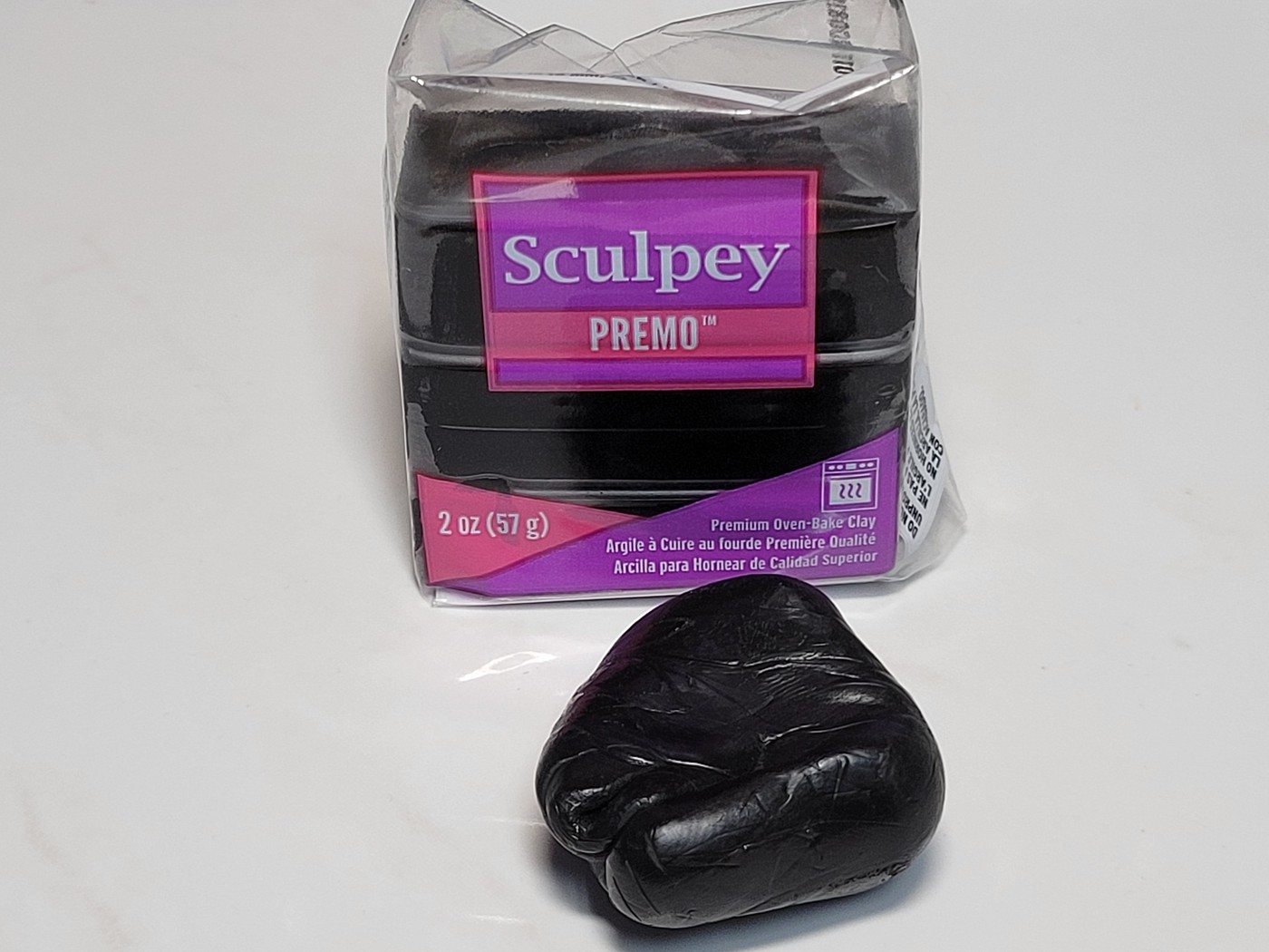

Nacho Z Posted January 31, 2023 Author Posted January 31, 2023 8 hours ago, MarkJ said: John, thanks for opening my eyes to the use of clay. I did not know that was a possibility. I might have to try it someday. Looks great for your seat. I am definitely pleased with how it turned out. The clay that I used, Sculpey Premo, actually has a date on the package. My assumption is you want the newest, freshest package you can find. I found that the clay was very easily marred so it is easy to put dents and creases in it.

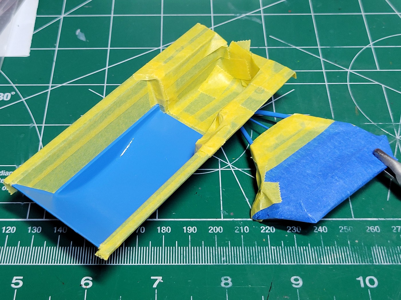

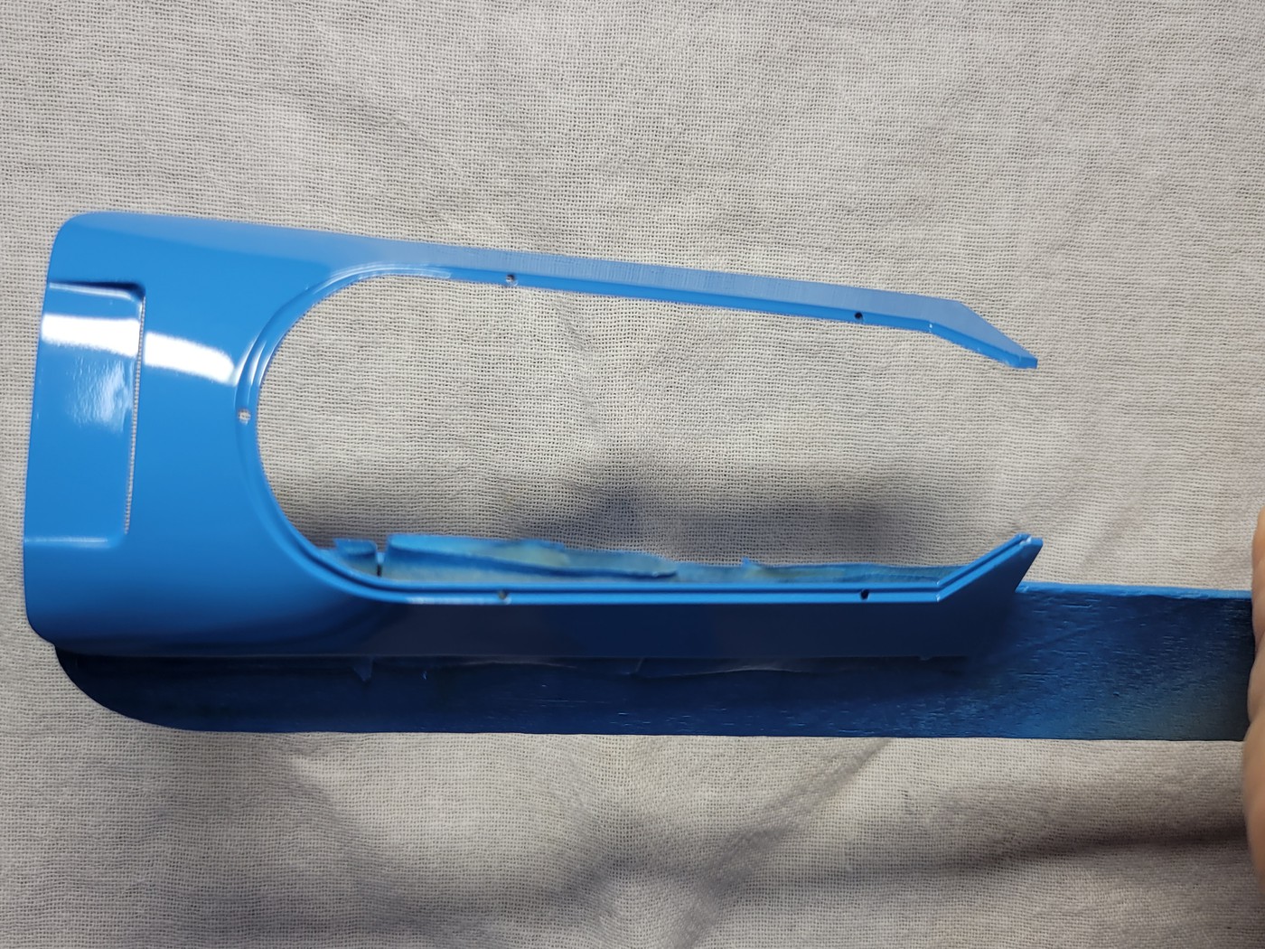

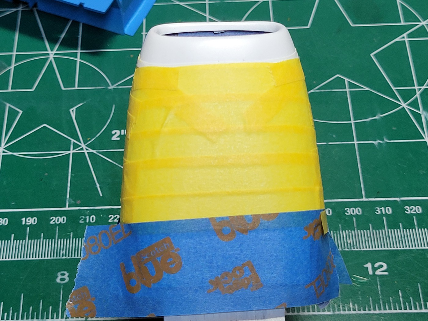

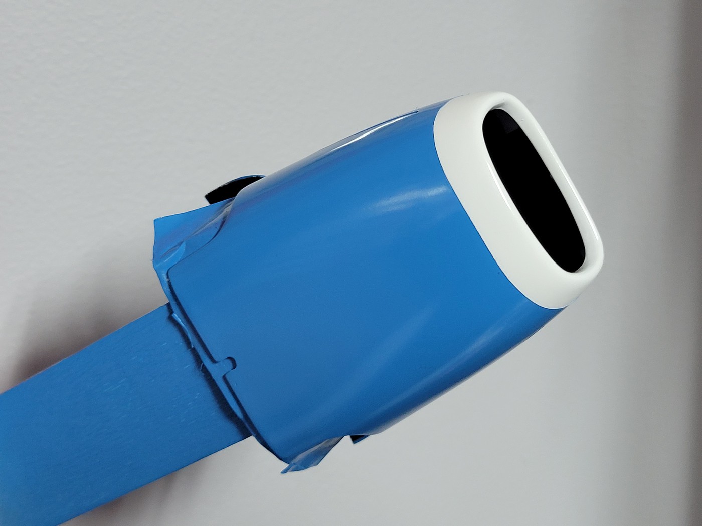

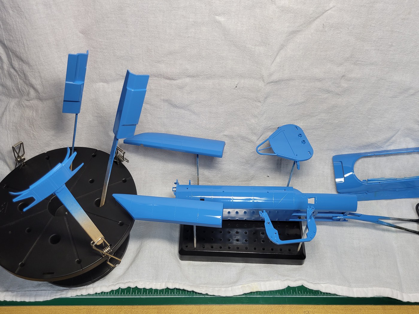

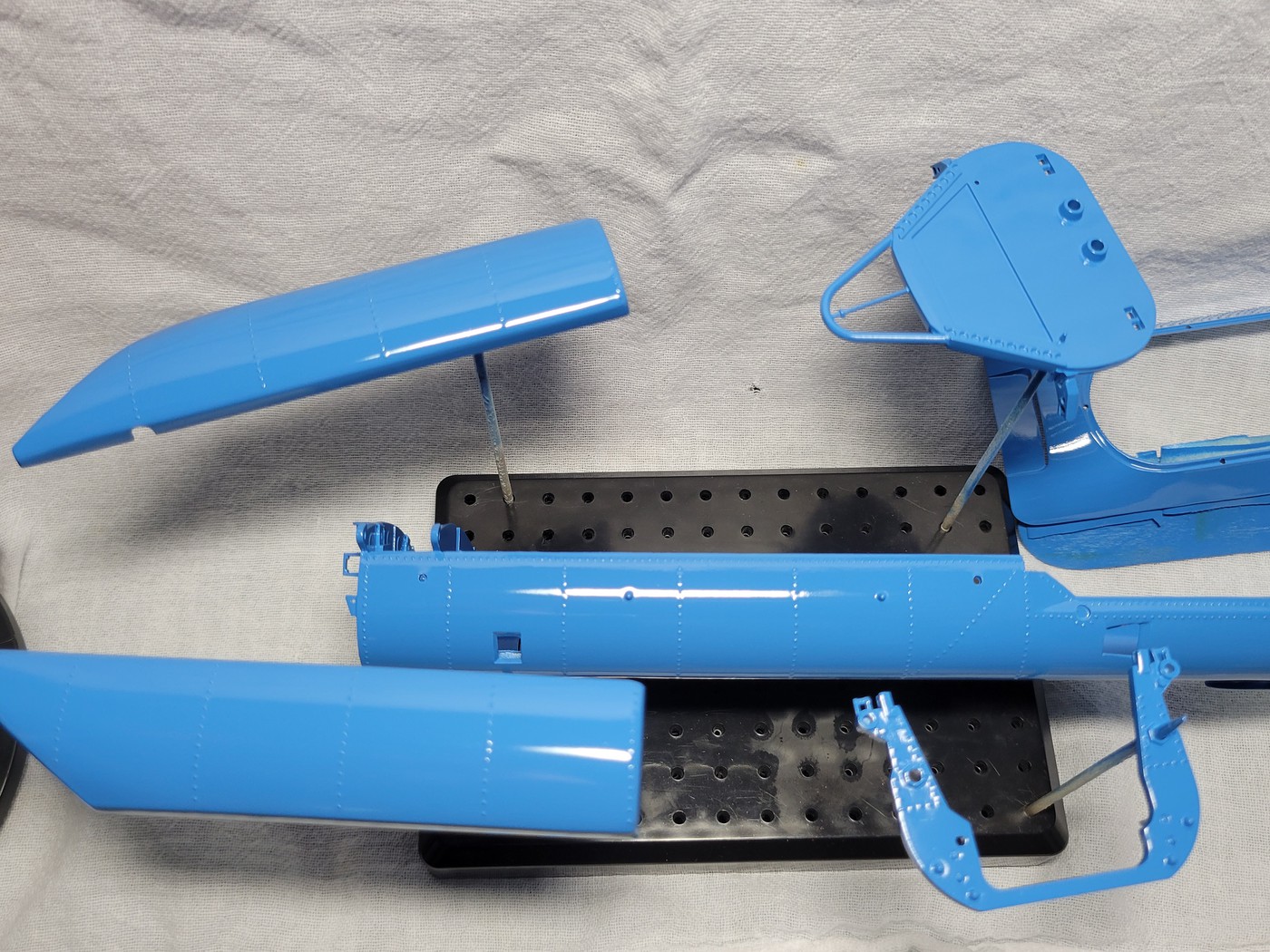

Nacho Z Posted February 7, 2023 Author Posted February 7, 2023 I have a good amount of sub-assemblies completed on this model and it is getting time to get the body pieces under paint so that I can begin to assemble the car. There are a total of 13 pieces that need to be painted body color. Due to the amount of paint needed for this, I used Tamiya TS-10 French Blue right out of the spray can. I applied 3 coats. What you see in the following pictures is the paint after it had cured for 24 hours. Nothing has been polished. 3
Belugawrx Posted February 7, 2023 Posted February 7, 2023 Paint laid down real nice for you John ? Love the seat treatment too. Cheers

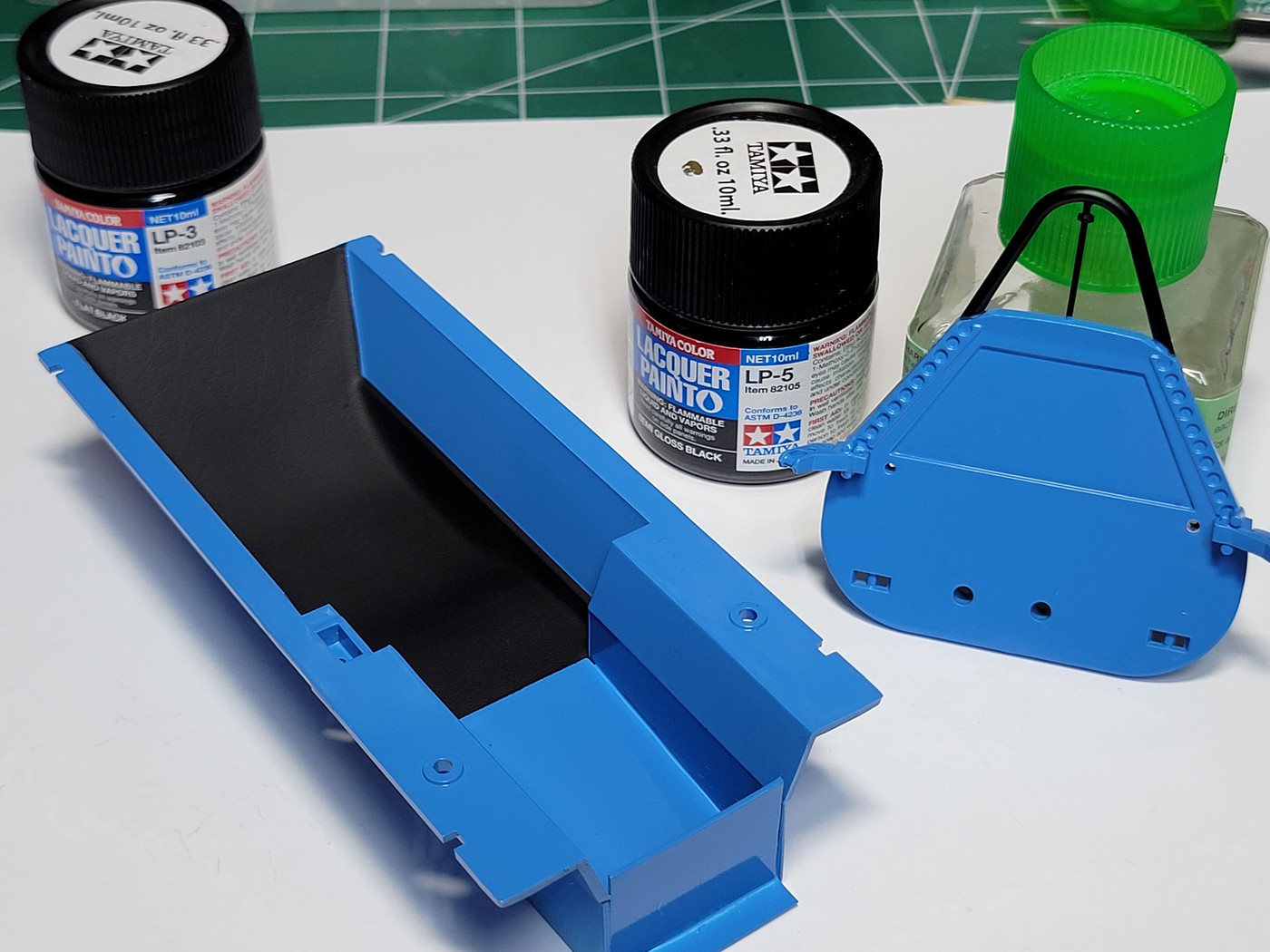

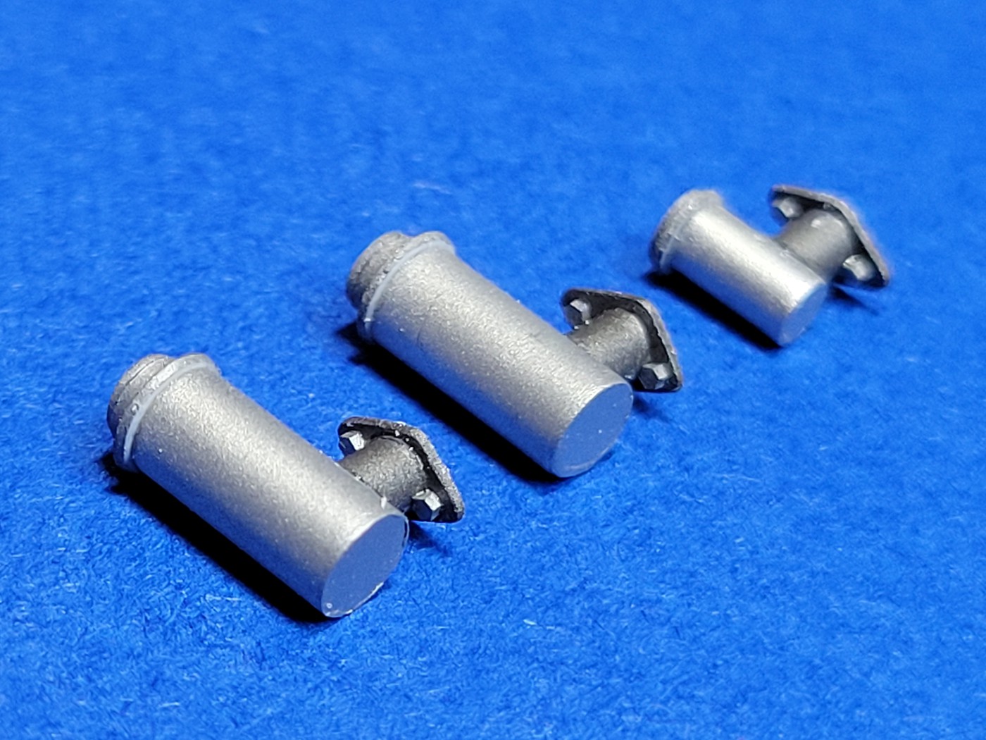

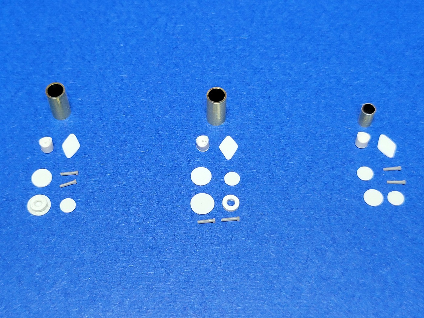

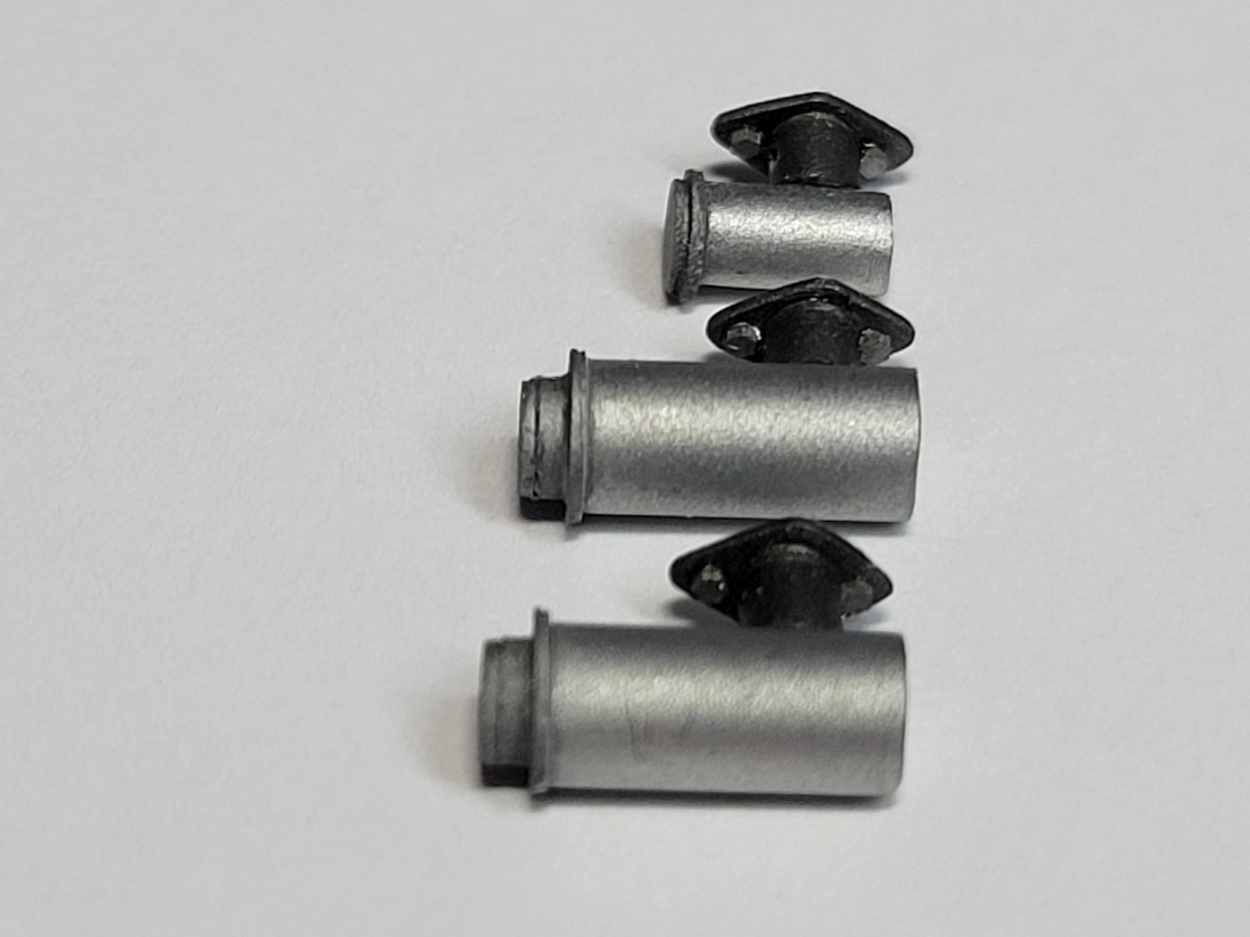

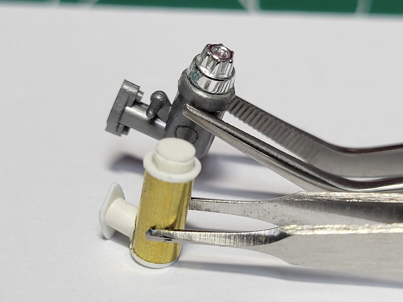

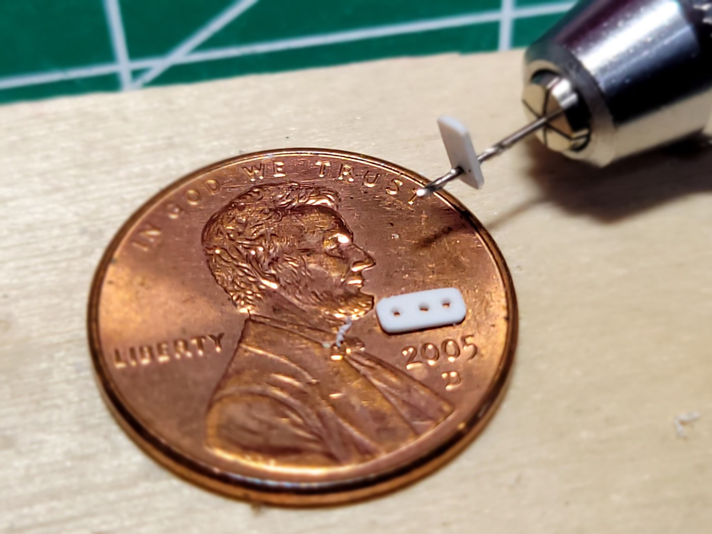

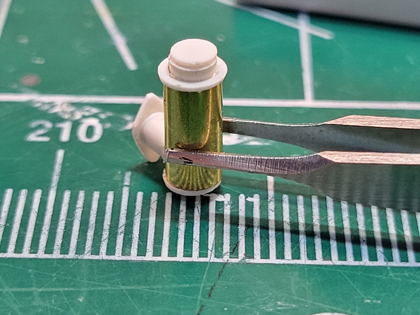

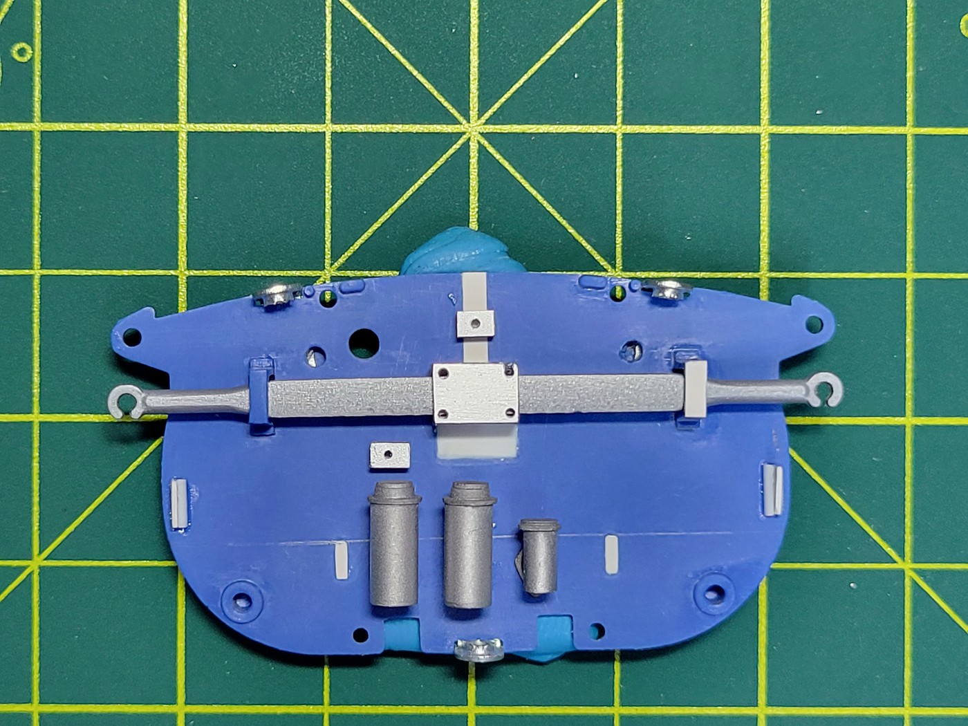

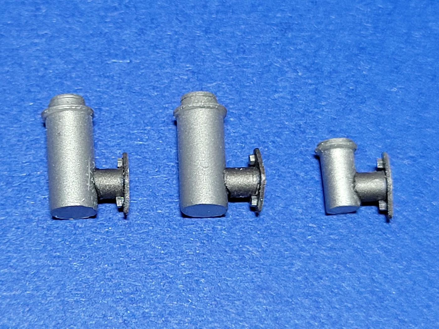

Nacho Z Posted February 14, 2023 Author Posted February 14, 2023 It is Monday night, time for another update! The next two or three updates will concentrate on the front bulkhead. The model kit provides no detail whatsoever. The only thing provided is the steering rack. To be fair to Tamiya there will be a water tank and a radiator that will cover everything up anyhow. However, this are was just begging for some detail, and well, one thing led to another. I'll start with the brake and clutch reservoirs. I will caption each photo as needed. Here is a photo of the real car under restoration. I scratch built front and rear brake reservoirs from 9 separate pieces and the clutch reservoir from 8 pieces. A reservoir mocked up. I patterned mine off of a kit part from another kit. I had to make mine a very specific size. It had to clear other items that I will be adding and yet be low enough to fit under the water tank. Hard to tell but there are 3 different shades of metallizers on these. I also add bolt heads to each mounting flange. A different background shows the colors a little better. A quick mockup. I also added two mounting brackets for the front brake lines. 1

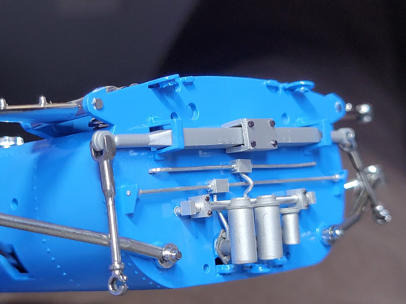

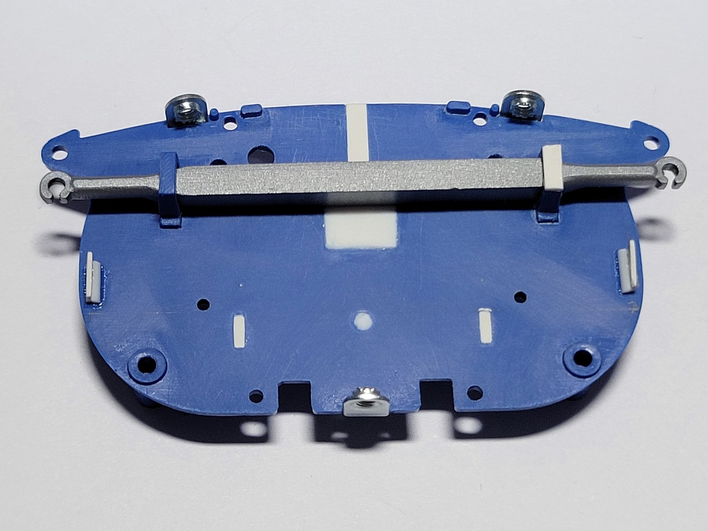

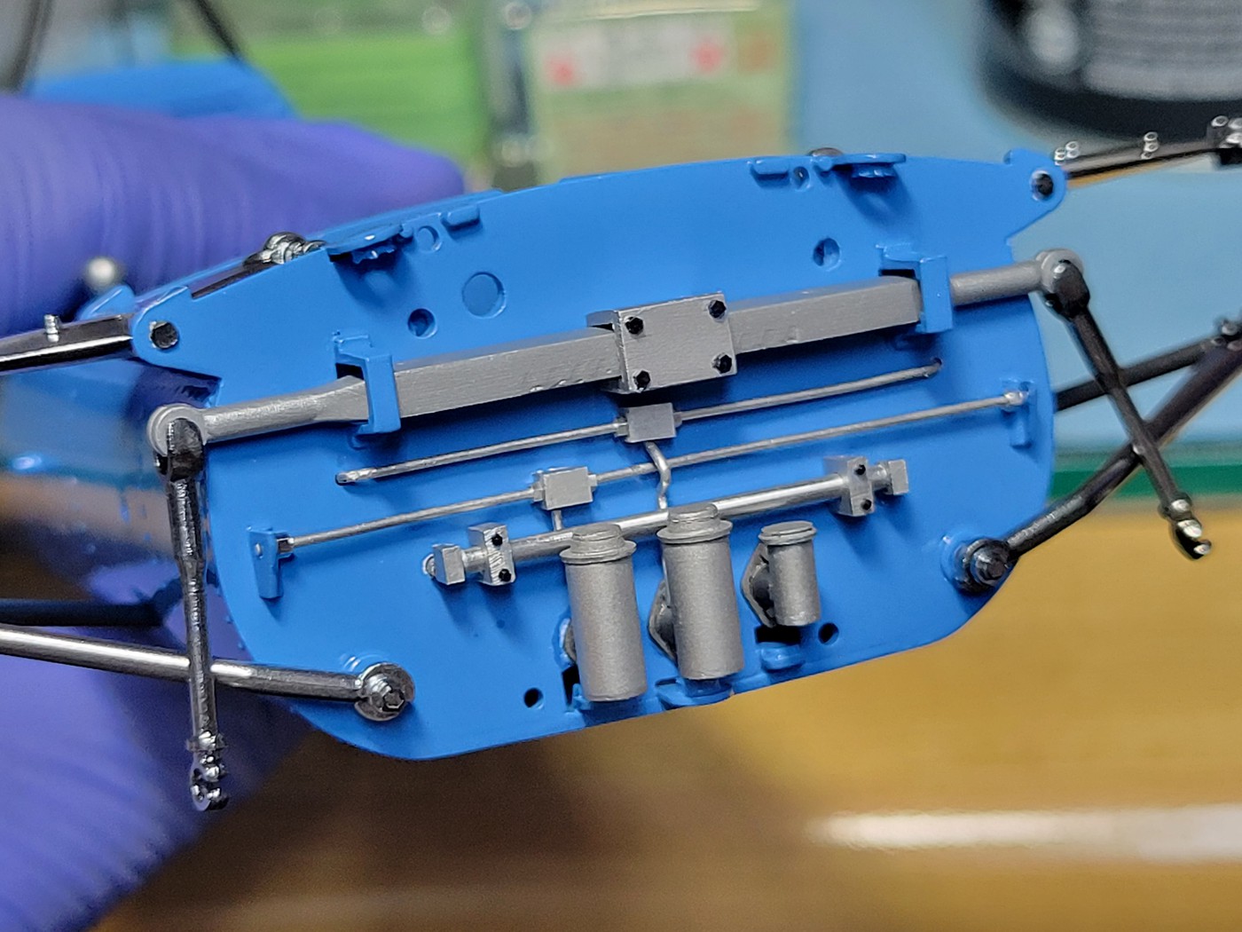

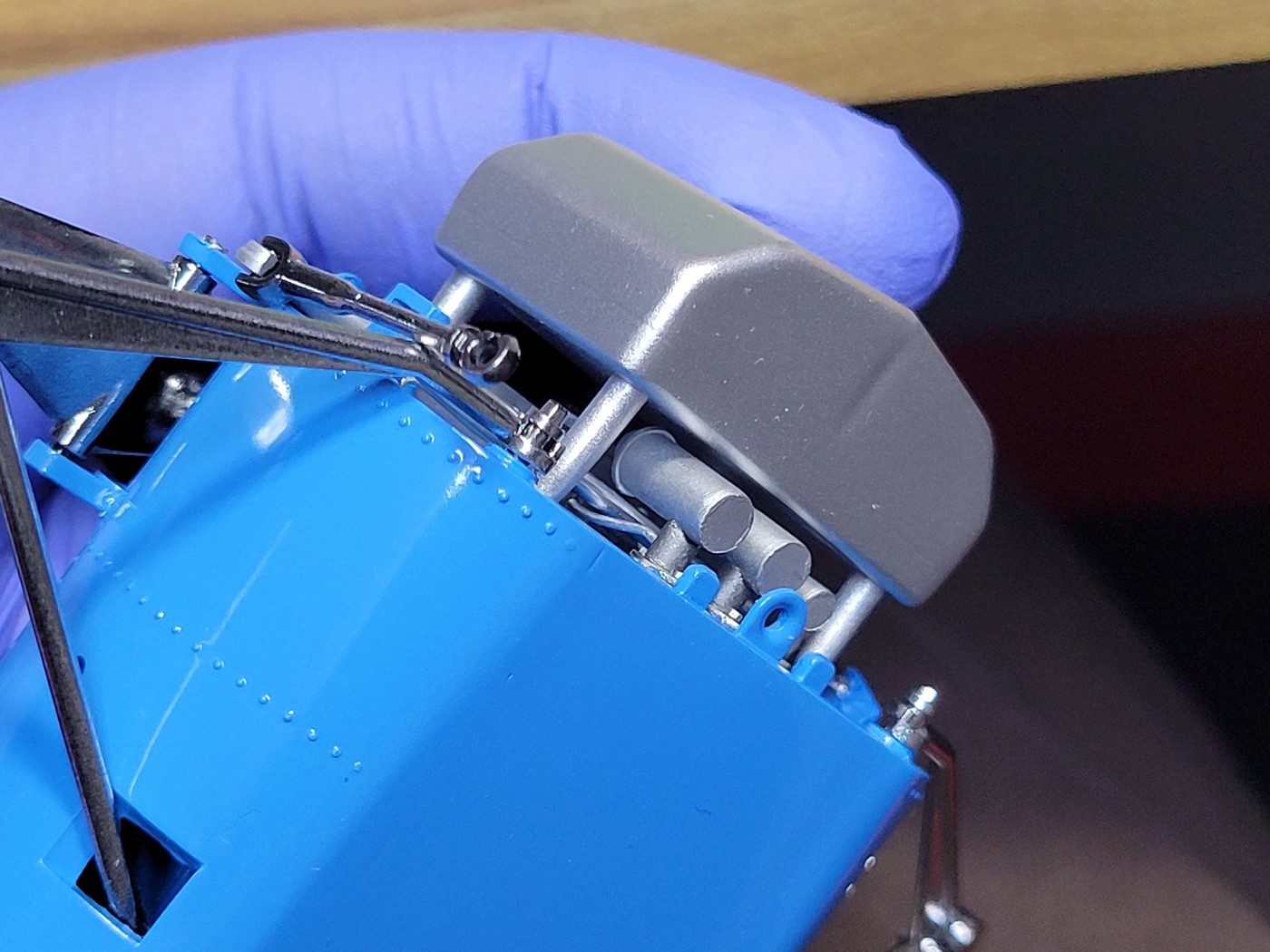

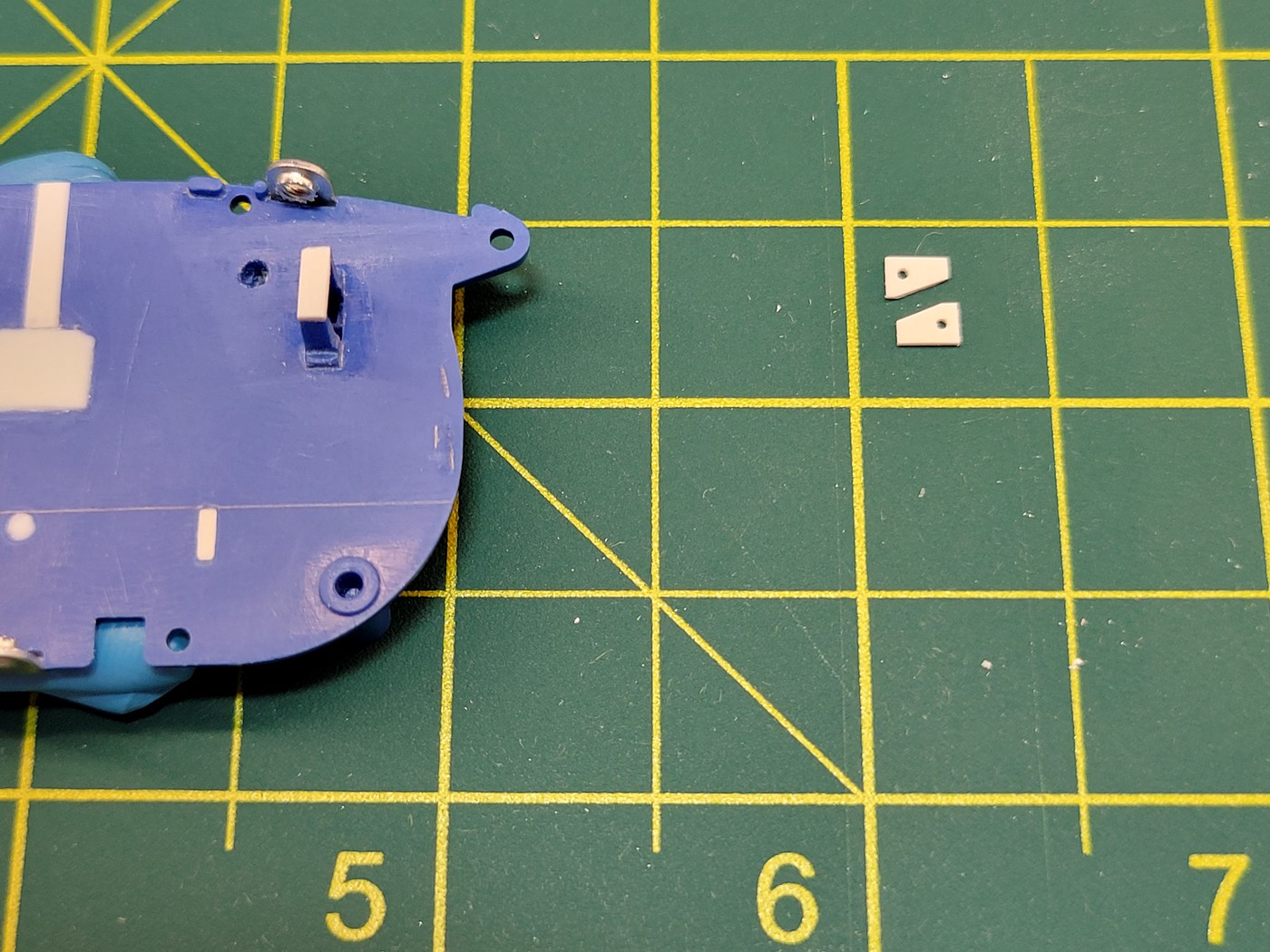

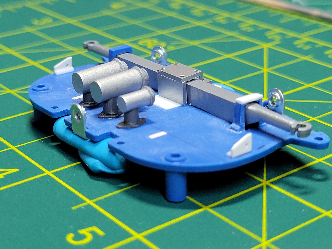

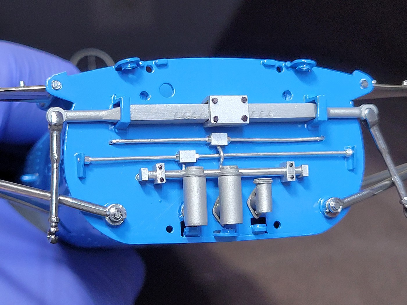

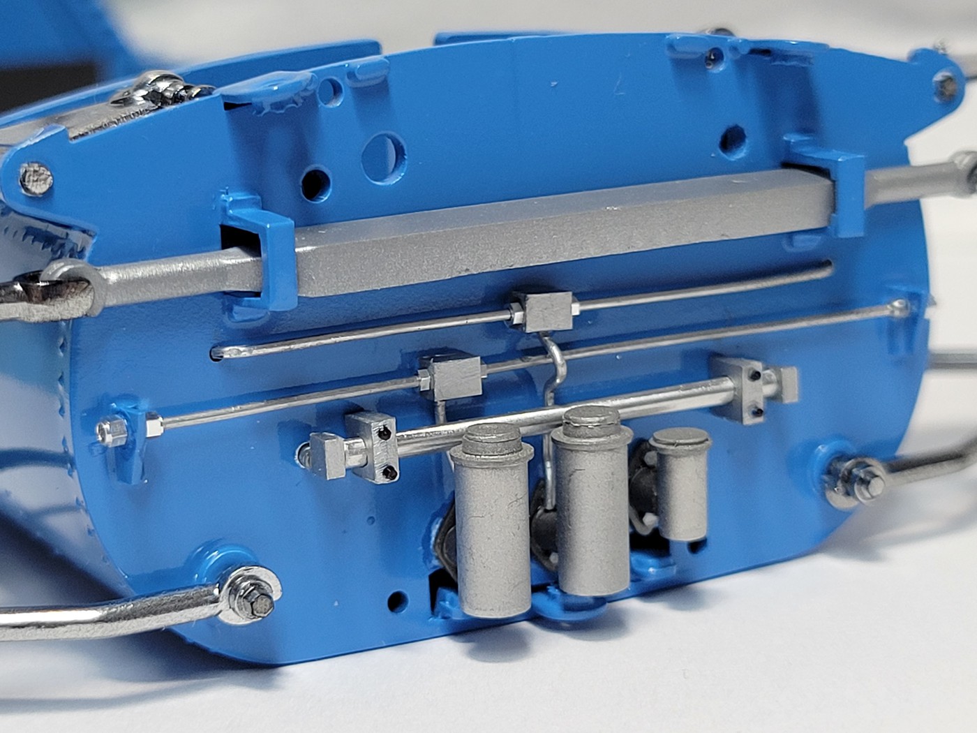

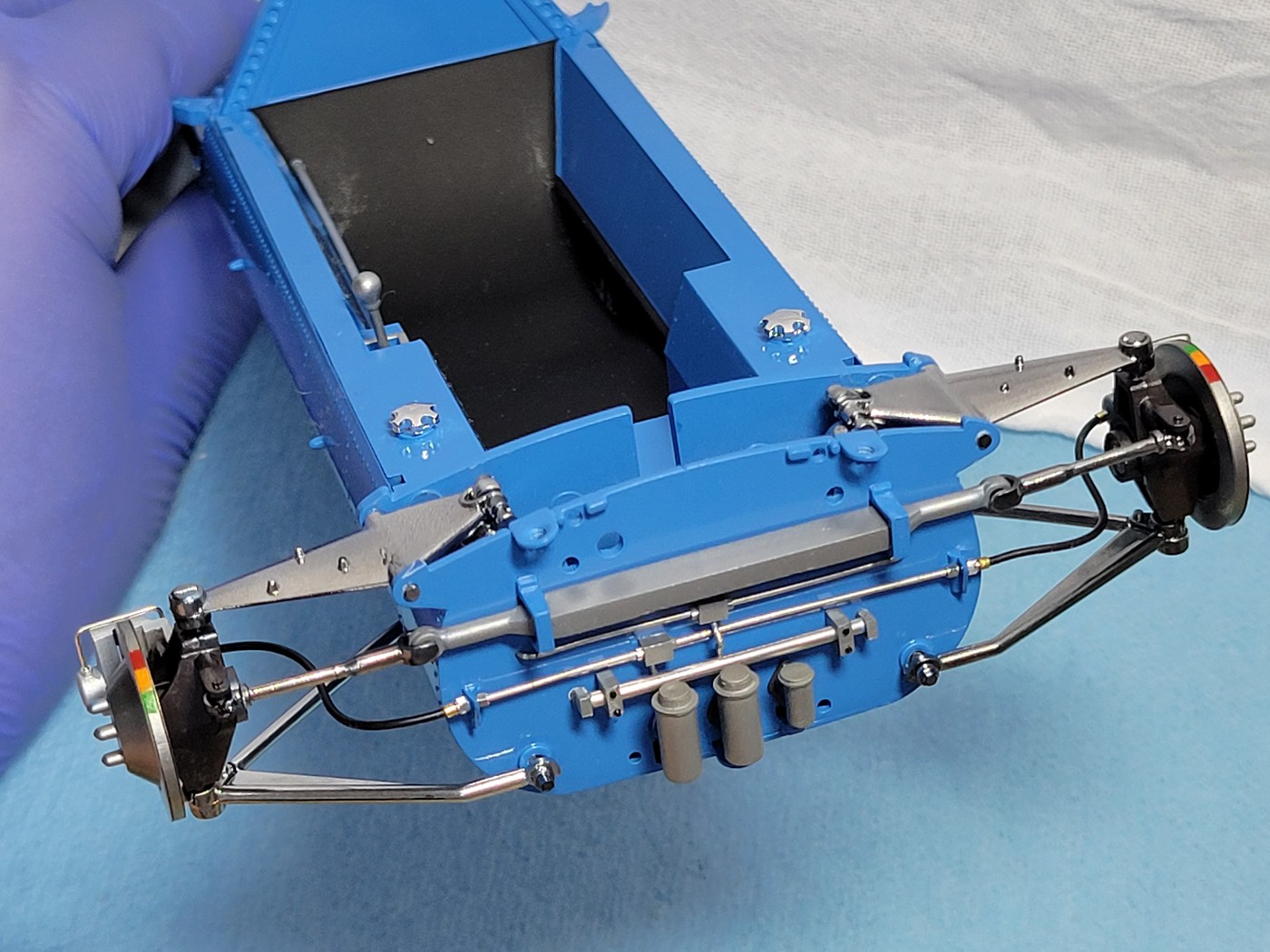

Nacho Z Posted February 22, 2023 Author Posted February 22, 2023 Big update this week!! This will be the second update of three that concentrate on the front bulkhead. As mentioned last week, Tamiya provide no detail whatsoever on the front bulkhead. Again, it will be covered by a water tank and a radiator but I just couldn't help myself, I had to add a few details. This is what I started with. I filled in various openings that were not used. I made small brackets for the front brake lines. The silver steering rack is all that is provided in the kit. Here you can see the openings that I filled in and others that I created. I made an anti-roll bar from aluminum tubing and styrene. I also made a bracket to go over the steering rack. The brake and clutch reservoirs, (from last week), clear the anti-roll bar. I fitted the bulkhead to the body and filled in the seam all the way around. Here is mounted. I made what I assume are some type of proportioning valves for the brakes, front and rear. Although it probably will never be seen, I actually plumbed the reservoirs to the proportioning valves. It was ridiculously hard to do. All of the planning, measuring and test fitting that I did paid off. Everything fit perfectly! The reservoirs cleared the anti-roll bar and fit under the water tank. More updates next week! 2

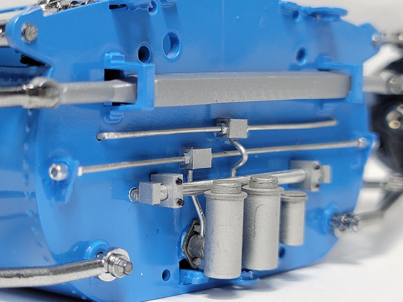

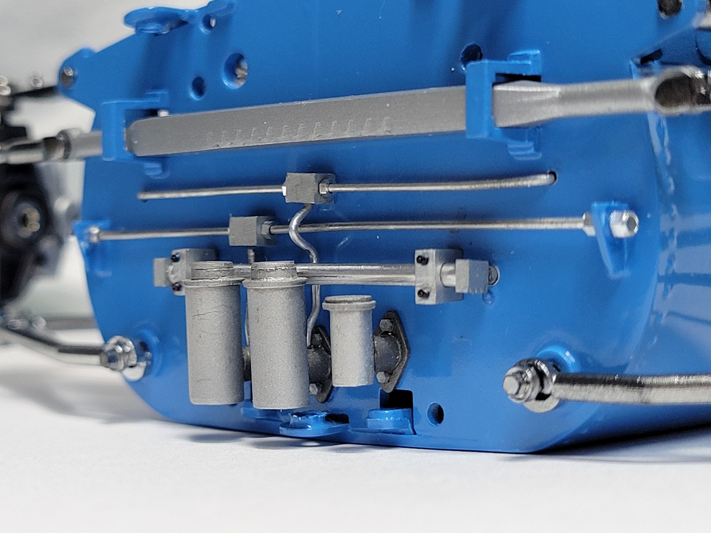

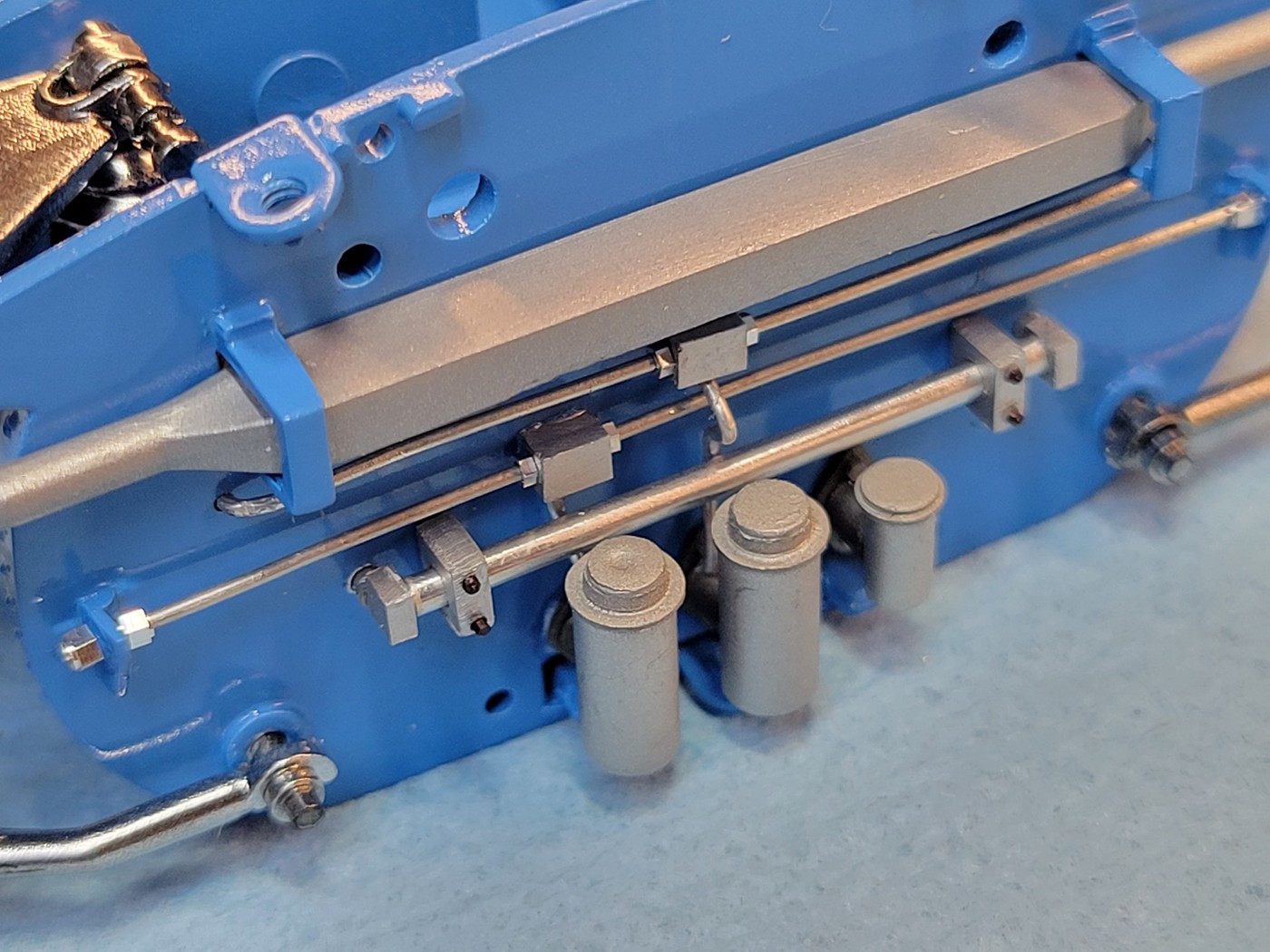

Nacho Z Posted February 28, 2023 Author Posted February 28, 2023 This will be the third and final update concentrating on the front bulkhead. As stated previously, the kit provides no detail whatsoever, only the steering rack. Let me know what you think. Here you can see that I've added fittings to the hard lines for the front brakes. Slightly different angle. From the other side. And from above. Here is a photo of the real thing. And a photo of my brake line and fittings. I am pleased with the overall results. I understand big scale, foreign, open wheel race cars don't garner a lot of love but I would like to hear some feedback on this one. I'm open to comments, advice, critiques or just some plain old discussion on this one. Thanks! 2
Belugawrx Posted February 28, 2023 Posted February 28, 2023 Coming along nicely, the reservoirs look great. I always add alot of details to these big scale kits, and sometimes it gets hidden behind or under more parts, but I know they are there. Filling voids and empty spaces just adds to the realism of the build...keep it up? Cheers
Pierre Rivard Posted February 28, 2023 Posted February 28, 2023 Lovely work John. Almost too bad that the nose cone will cover this. The beauty of these 60's F1 is that a lot of the mechanicals are visible even with the body panels on and that's why they provide such opportunity for scale modeling. A lot of your gorgeous detailing will remain highly visible. Pure joy to follow this build.
Randy D Posted February 28, 2023 Posted February 28, 2023 You should be pleased John, that whole front end looks awesome!!! Everything very precise and to scale. Randy
