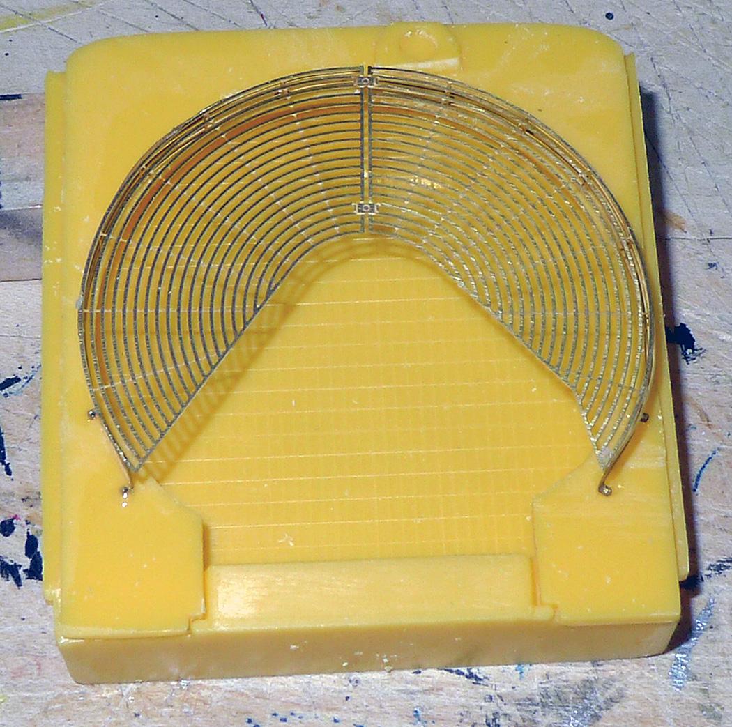

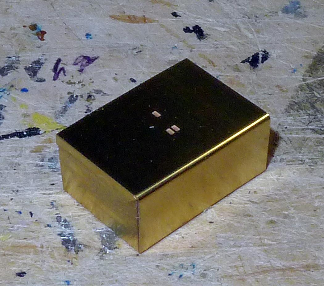

Warren D Posted May 20, 2022 Author Share Posted May 20, 2022 Some progress with the PE. I removed the molded on fan shroud before mounting the PE one 1 Quote Link to comment Share on other sites More sharing options...

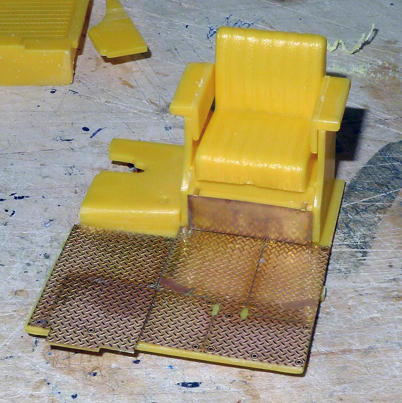

Warren D Posted May 20, 2022 Author Share Posted May 20, 2022 Other PE work, the floor of the cab. I ground off the molded on diamond plate prior to mounting the PE. I also got the battery box done. The CTM instructions seem to indicate that the radiator screen should go on the inside but I put it on the outside as it will probably be seen thru the grill. 2 Quote Link to comment Share on other sites More sharing options...

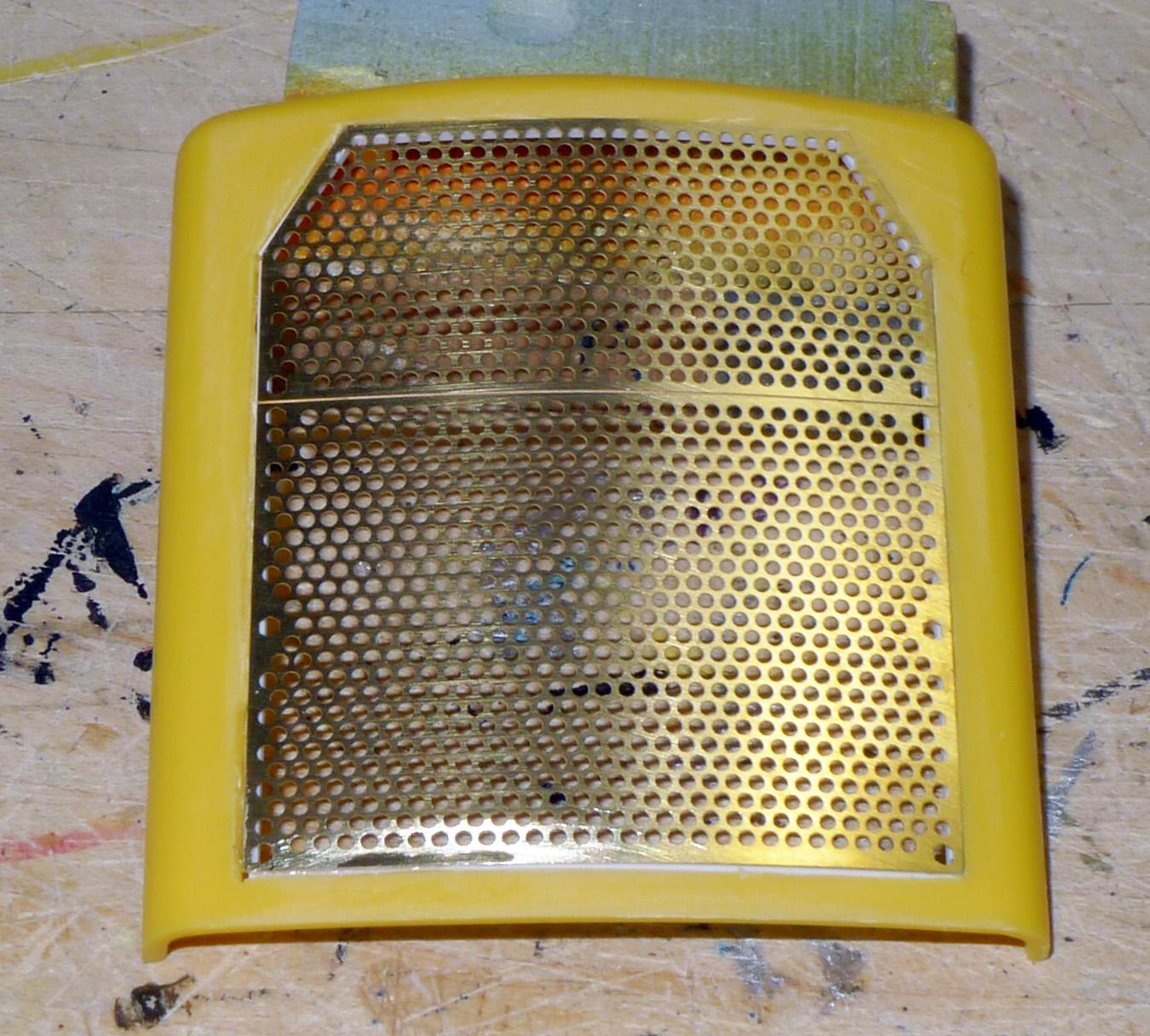

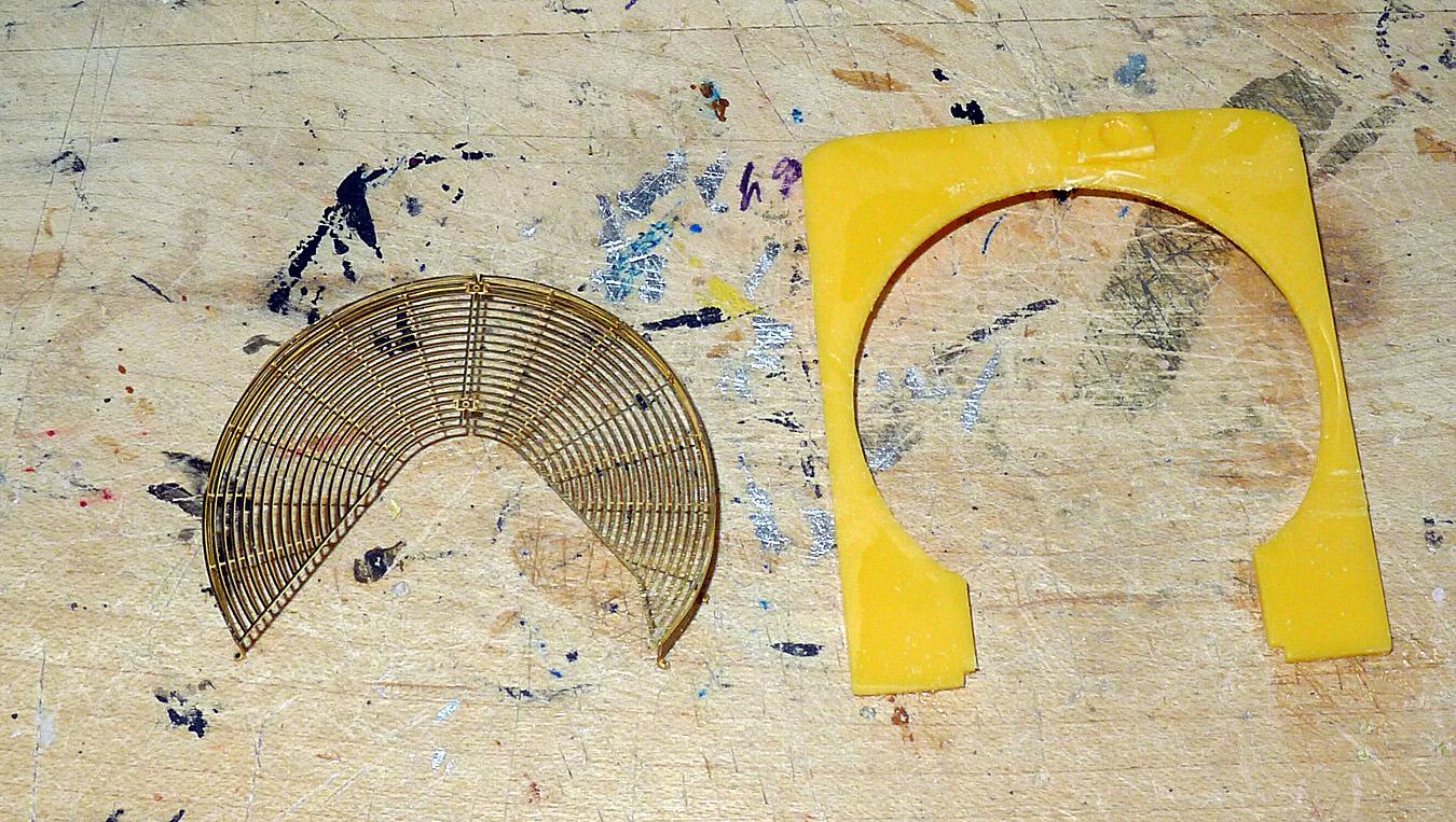

Warren D Posted May 28, 2022 Author Share Posted May 28, 2022 The tractor body is coming along, got the floor and fuel/hydro tanks installed. At some point very soon, I'll need to start painting. As for the grill, I decided I wanted the PE grill to sit flush with the surroundings as I've seen in photos of the real thing. That meant precision removal of the center section. I taped the PE grill over the nose and scored around the perimeter with a new #11 blade. I removed the PE and used very fine toothed saws to remove the inner section. I then used 0.30 square stock as a backer. I'm generally pleased with the result, I have to add the bolt head detail. It isn't quite perfect, but I'm satisfied. Quote Link to comment Share on other sites More sharing options...

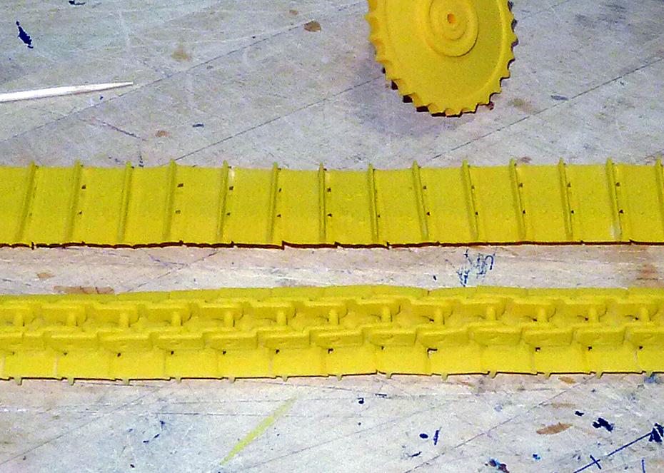

Warren D Posted June 5, 2022 Author Share Posted June 5, 2022 Started working on the tracks, these are aftermarket. I started by painting them yellow, holding an arc as if they were going around the sprocket. I did this to get paint into the joints. I use Polyscale, the tracks are 3D printed and don't need primer as the Pollyscale sticks to 3D prints and resin as good as any primer I've used. Next, I laid the tracks face up and flat and sprayed them with Testors chrome in a rattle can. A quick touch up on the backs with more yellow and I ran some steel wool over the chrome to "scratch it up". When the tracks are on the sprocket, you'll see the yellow paint between the grousers. The look I'm going for is a newer (or newly repainted) unit with some light use. Quote Link to comment Share on other sites More sharing options...
