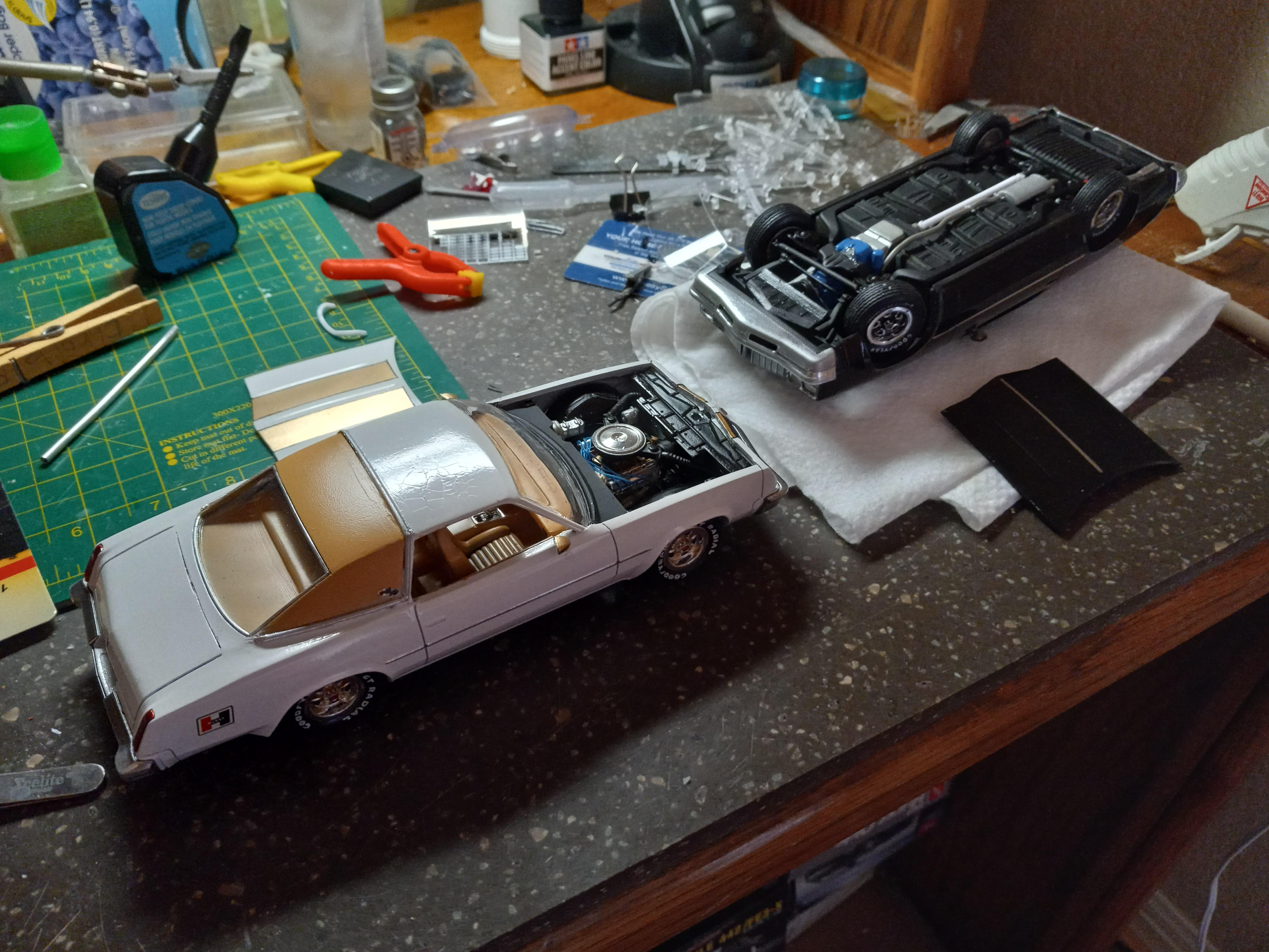

carl63_99 Posted March 9, 2023 Author Posted March 9, 2023 I'm Baaack! Been so busy with business, holidays, severe storms and taxes. But I did get some time to start working on molding windshield and back window. I found some picture frame inserts made of plastic at Hobby Lobby and will be seeing how that heats and molds over the templates included in the 3D kit. 1

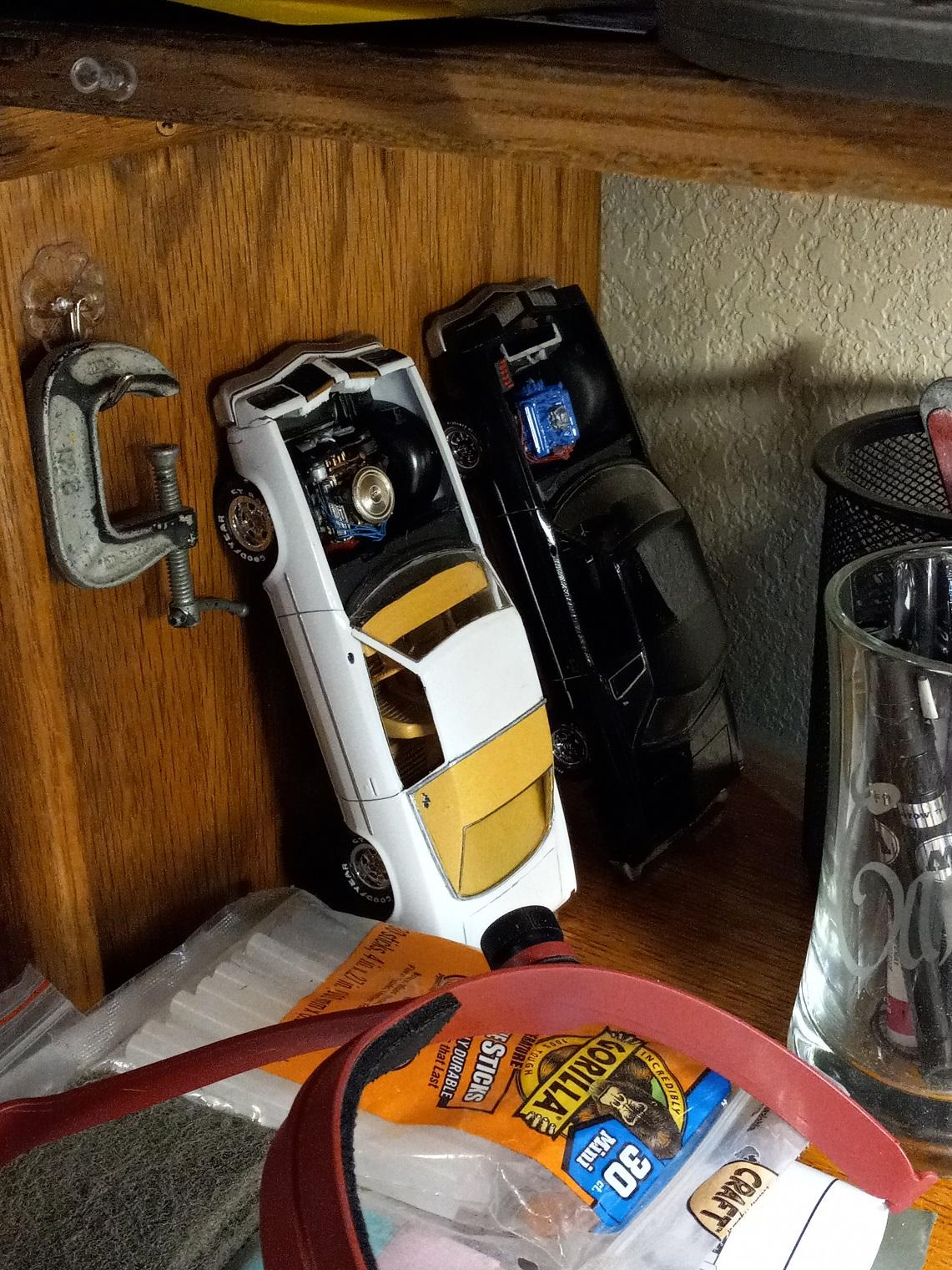

carl63_99 Posted March 13, 2023 Author Posted March 13, 2023 Using air-dry clay and the tenplates that came with the kit, I've been experimenting with a few different kinds of plastic for the windows. Replacement photo frame glass from Hobby Lobby seems to provide the best clarity when heat molding the windows. I may make several more to get them perfect, but as far as proof of concept, I know I can make them. 2

ubermodel Posted March 18, 2023 Posted March 18, 2023 (edited) On 3/13/2023 at 5:15 PM, carl63_99 said: Using air-dry clay and the tenplates that came with the kit, I've been experimenting with a few different kinds of plastic for the windows. Replacement photo frame glass from Hobby Lobby seems to provide the best clarity when heat molding the windows. I may make several more to get them perfect, but as far as proof of concept, I know I can make them. Expand What's the method you use to shape the new windows? Do you used a vacuform machine to pull the glass over the mold, or just heat it with a hot air gun and pull down by hand? Edited March 18, 2023 by ubermodel
carl63_99 Posted March 19, 2023 Author Posted March 19, 2023 On 3/18/2023 at 7:53 PM, ubermodel said: What's the method you use to shape the new windows? Do you used a vacuform machine to pull the glass over the mold, or just heat it with a hot air gun and pull down by hand? Expand No vacuform machine, so I did the squish method. I had the molds at the ready, heated the clear plastic over a heat gun and when it was really flimsy, pressed it down over the mold. I made between 3-5 versions of each window until I got one that was good enough to use. One problem is that the plastic got hot enough to melt the 3D printed window mold, so I had to work fast. If I do this again, I will make a clay mold of the 3D printed one and mold over that. As I am not going for contest winning, just building for my own fun, I am happy enough with the results. Building one of these perfect would cost a lot more time and money. 1
carl63_99 Posted March 20, 2023 Author Posted March 20, 2023 Doing wheelies! Seriously, filled in the front turn signals with white glue, have them sitting like this overnight so the glue dries level. I like how you can see the difference between the two cars, particularly the engines in this pic. 2
