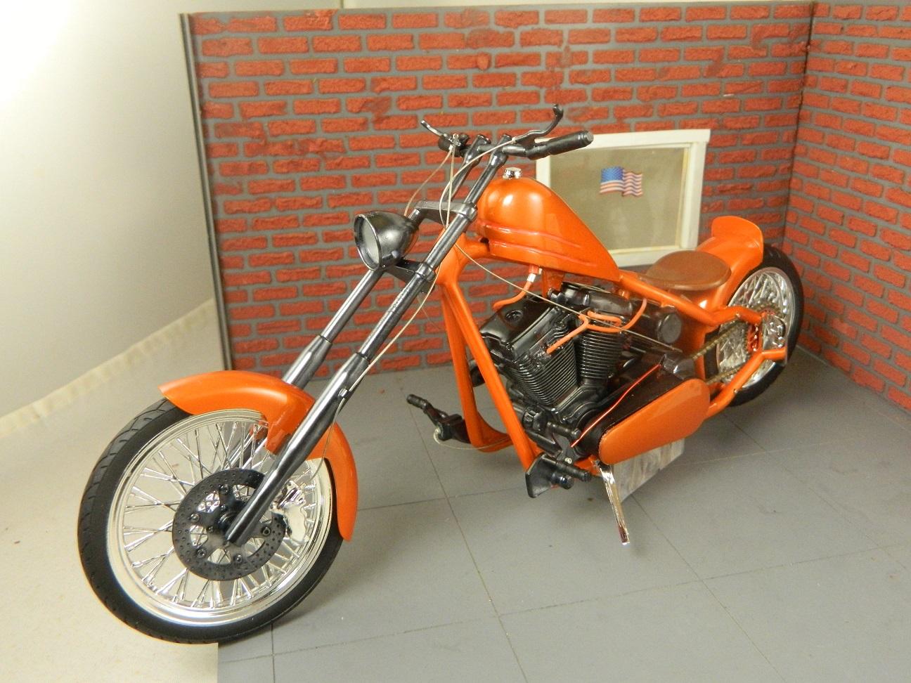

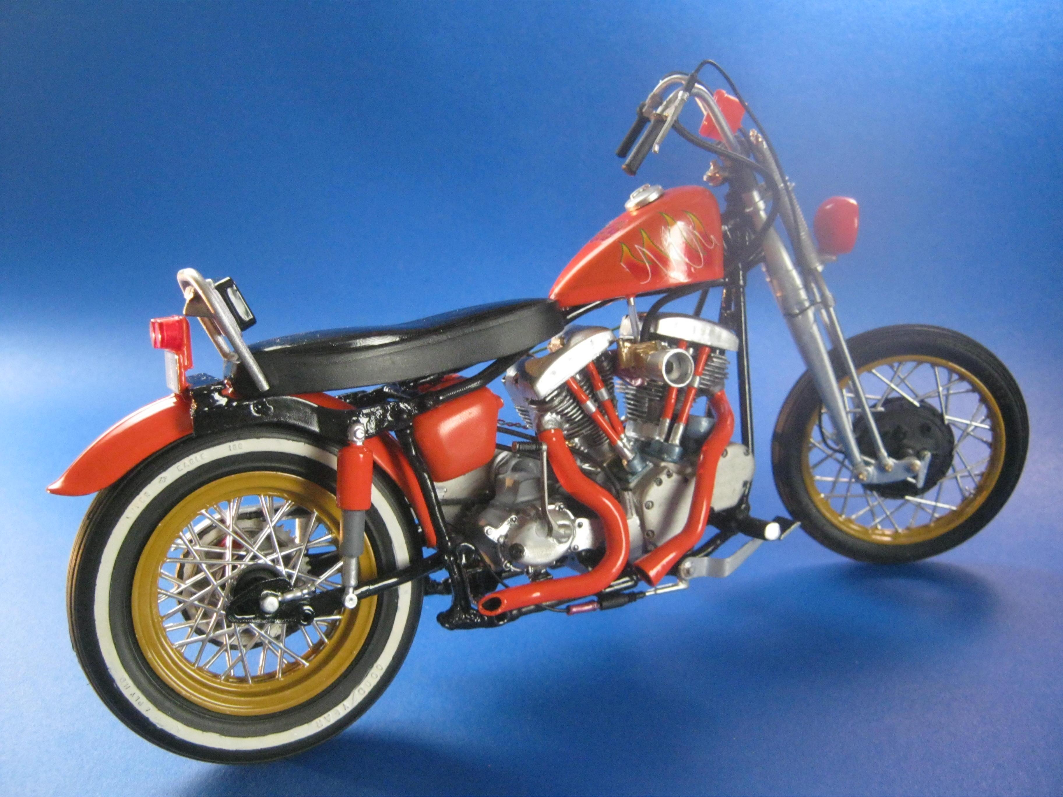

crazyjim Posted July 22, 2022 Posted July 22, 2022 I've been using chrome beading ends for cable fittings on my bike builds but they're 1/12 scale. 1

OldNYJim Posted July 24, 2022 Posted July 24, 2022 On 7/22/2022 at 4:28 PM, crazyjim said: I've been using chrome beading ends for cable fittings on my bike builds but they're 1/12 scale. That’s a killer looking build
