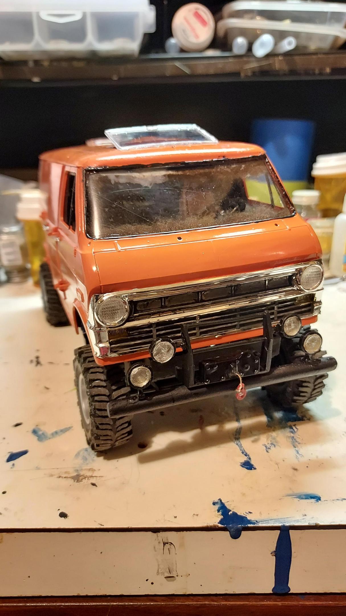

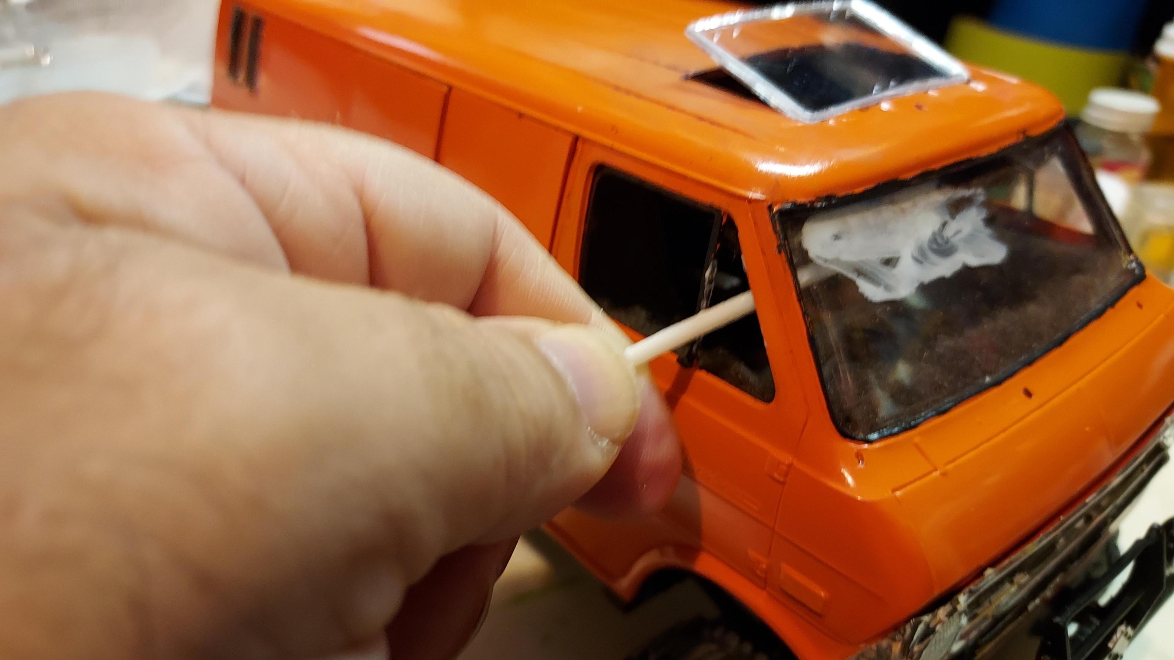

Mike C. Posted August 1, 2022 Posted August 1, 2022 I'm using that Testors glue that's supposed to be specifically for clear parts (i.e. windshields), and no matter how careful I think I'm being, I always manage to get an unsightly smudge or haze of some kind after its all over. What would be the best way to remove this smudge without harming the clear plastic?
Fat Brian Posted August 1, 2022 Posted August 1, 2022 That glue is supposed to be water based so I would run it under warm water and used a toothpick or something equally soft to try to pick it off. For applying the glue in the future try a paint brush. I sit my glass in place and then dab glue around the edges with a paint brush.

Mike C. Posted August 1, 2022 Author Posted August 1, 2022 As you can see from the picture the windshield is already installed and there is very limited space. There is no way I'm getting any sand paper or polishing cloth in there. The glue is on the inside so I'm thinking I will need to go in with a q-tip with something on it.

StevenGuthmiller Posted August 1, 2022 Posted August 1, 2022 (edited) If it’s just the Testors “Clear Parts Cement” it’s not much different than Elmer’s. It just tacks up a little faster. In any case, it’s a water based glue, so as others have said, get it wet with a Q-tip, let it soak for a few minutes, (maybe even let the wet Q-tip sit on the affected area for a while) and then try rubbing it off with a Q-tip before resorting to a tooth pick, or anything that could scratch the plastic. In the future, try using a few thin strips of a fairly easily removed tape like Tamiya to tape the window into position in a few key areas. Then, using a tooth pick, or other thin applicator, apply something like an epoxy glue around the perimeter in the areas that are absent of tape. Once the epoxy is solidly set, remove the tape and fill the remainder of the perimeter with more epoxy. Your glass will be permanently and very strongly fastened in place, with little possibility of smudges or finger prints. Steve Edited August 1, 2022 by StevenGuthmiller

StevenGuthmiller Posted August 2, 2022 Posted August 2, 2022 Try the Q-tip to soak the smudge, and then maybe try one of the small conical Tamiya type swabs to rub off the glue. They’re smaller and harder than a regular Q-tip. Might be just the ticket. Steve
Mike C. Posted August 2, 2022 Author Posted August 2, 2022 Whell, I used the Meguiars stuff on a Q-tip with minimal results. I guess I'll have to just live with it now. At least I learned a valuable lesson for next time ad that bottle of "clear parts specific " glue went straight into the trashcan.
