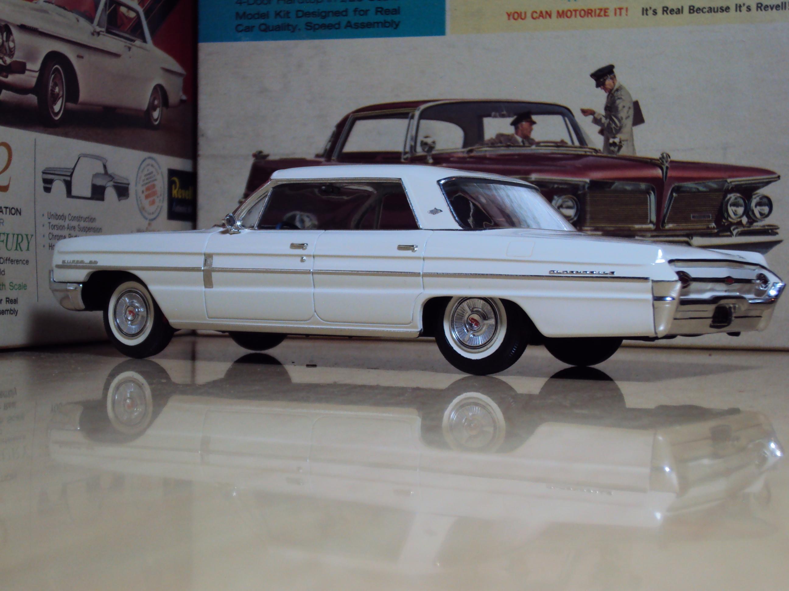

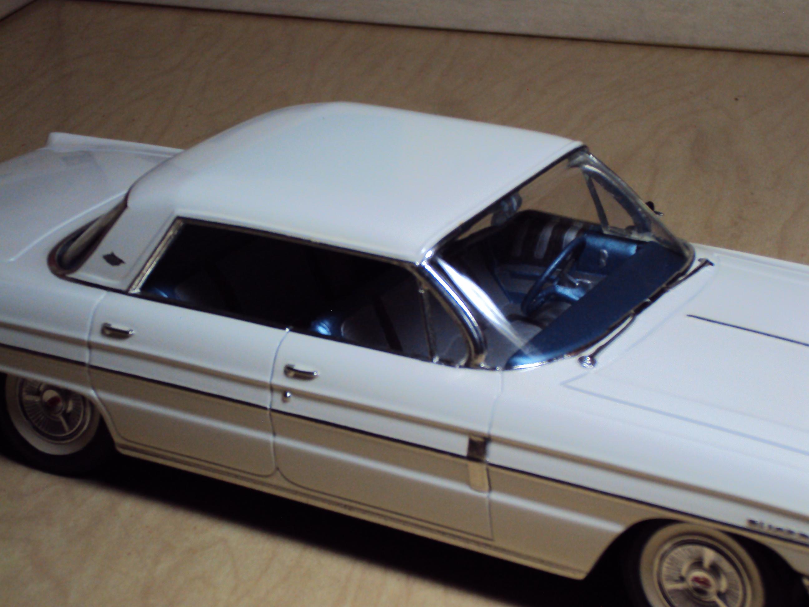

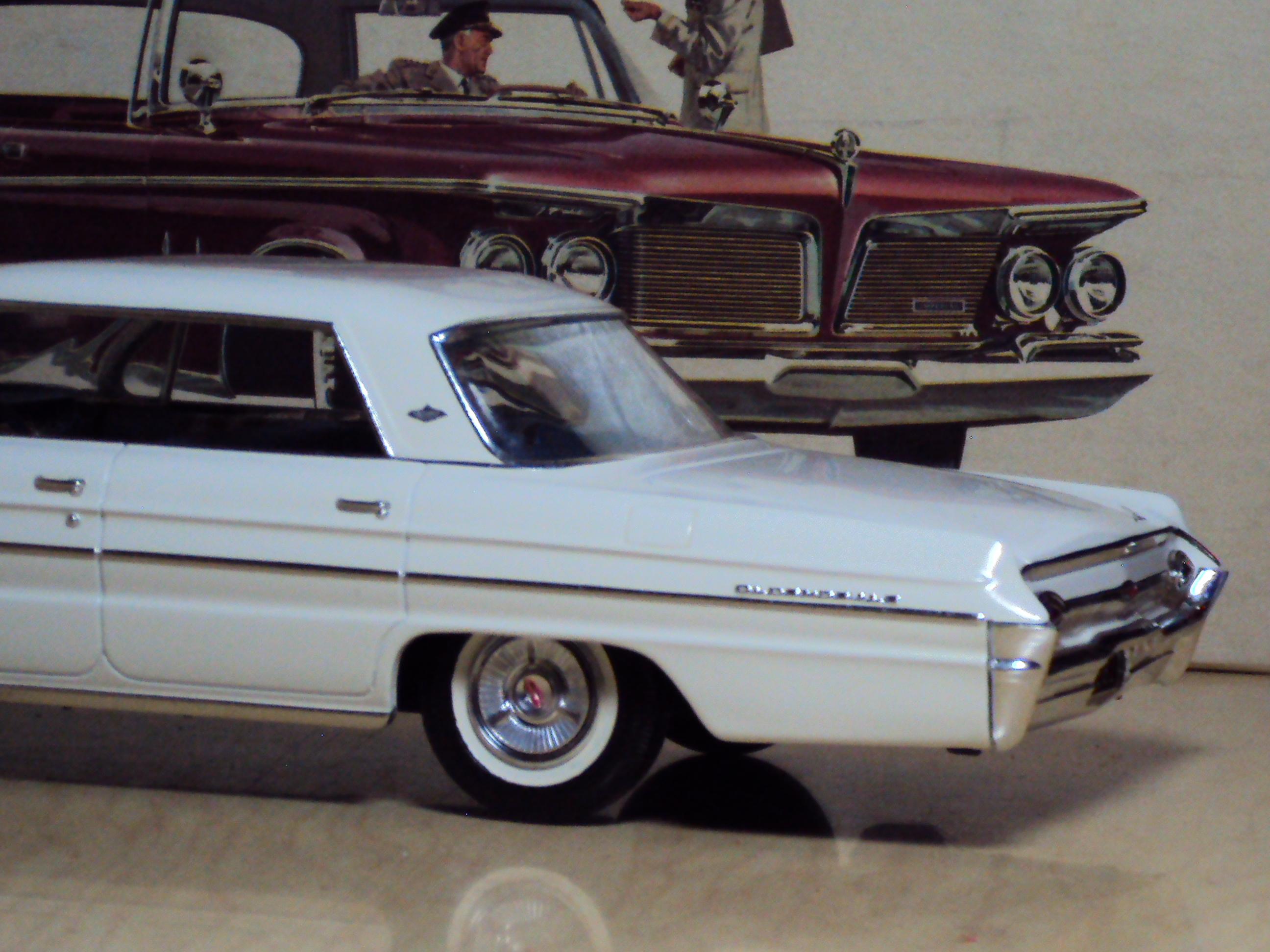

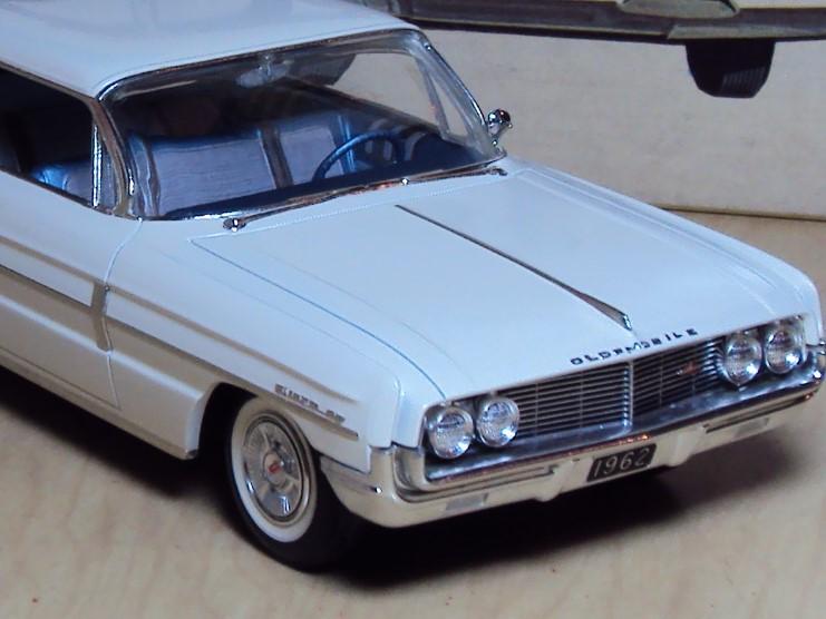

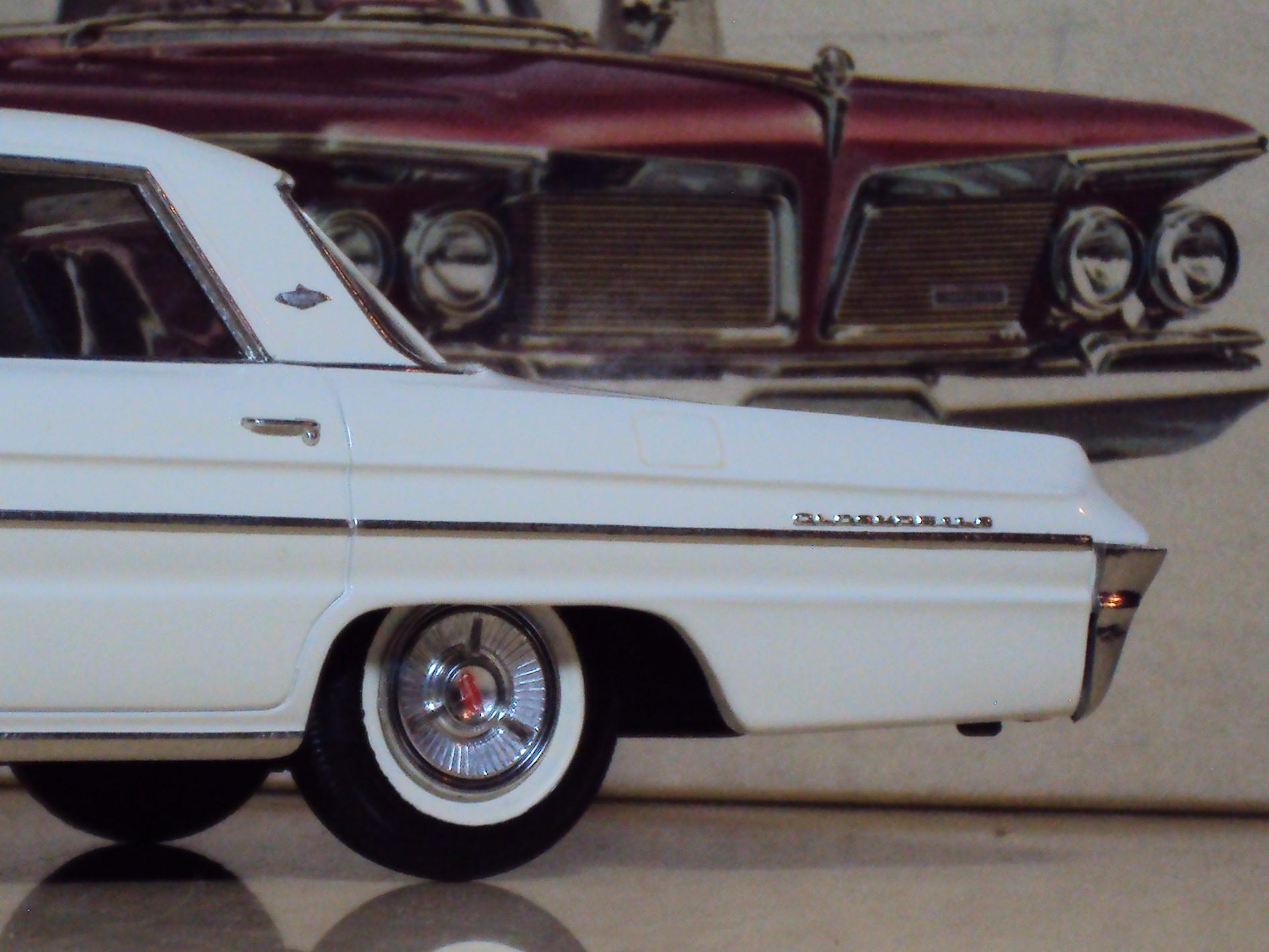

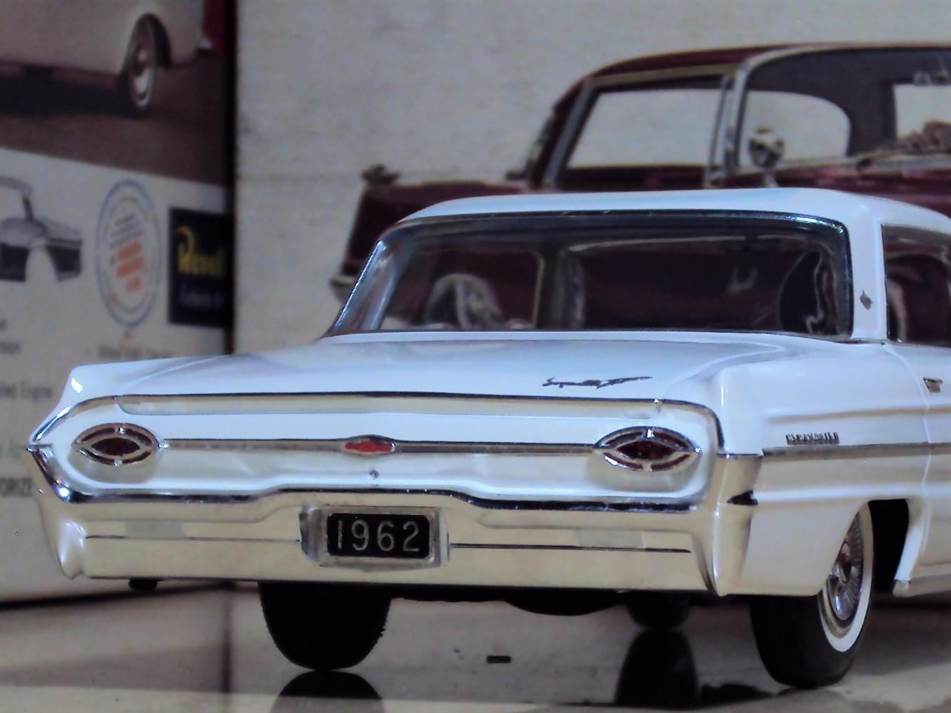

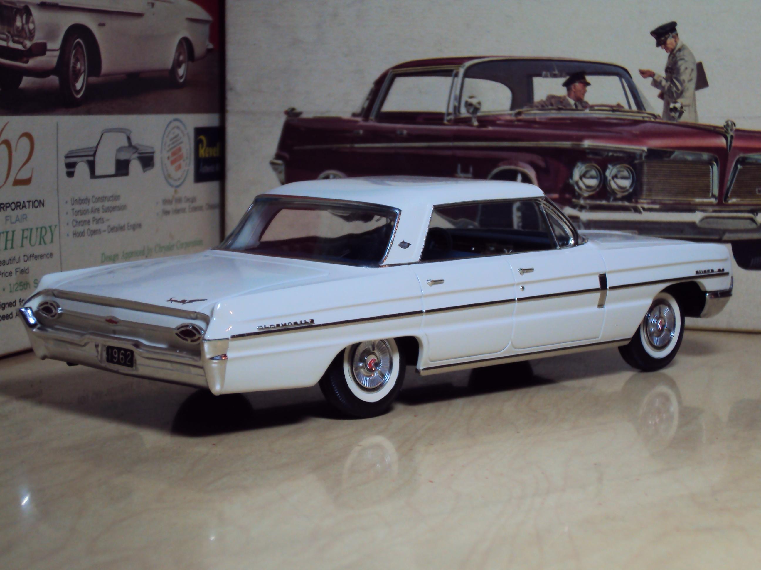

Here's another one I used an NOS kit to build. I like Oldsmobiles and have quite a few. My first car in 1967 was a 63 Super 88 and my dad had a white 63 wagon. One of my 1:1 cars now is a 63 Dynamic 88.
I have one of my 59 kits painted and in progress so it will be coming at some point.
This one is box stock including the original tires. All the trim is Bare Metal Foil, the grille, interior, hubcaps, etc. are detailed. I also widened the track a bit.
I noticed in some of the photos that a couple of the tires are crooked.  They are not glued and must have shifted as I moved the car around.
Thanks as always for taking the time to look. All comments are always appreciated.
I was set up to take photos of the 62 Imperial I finished today but decided to post this one first.  -Rich

That's a beauty, especially that blue interior! This one scores extra points with me for being an early 60s Olds 88. I recently picked up an actual 1961 88 4-door hardtop as a long term project; maybe this winter or next summer. No engine or tranny, so definitely going to be a resto-mod kind of project.

SWEET !!
Thanks Ray
2 hours ago, oldscool said:
Beautiful! Very precise trim work.
Appreciate it Gerald.
1 hour ago, Kah puts said:
That's a pearl, the white looks right on and attention to detail is off the chart.
Glad you like it Glen
1 hour ago, happy grumpy said:
A really nice and impressive model. the trim is really clean and precise.  ?
Mario, thank you.

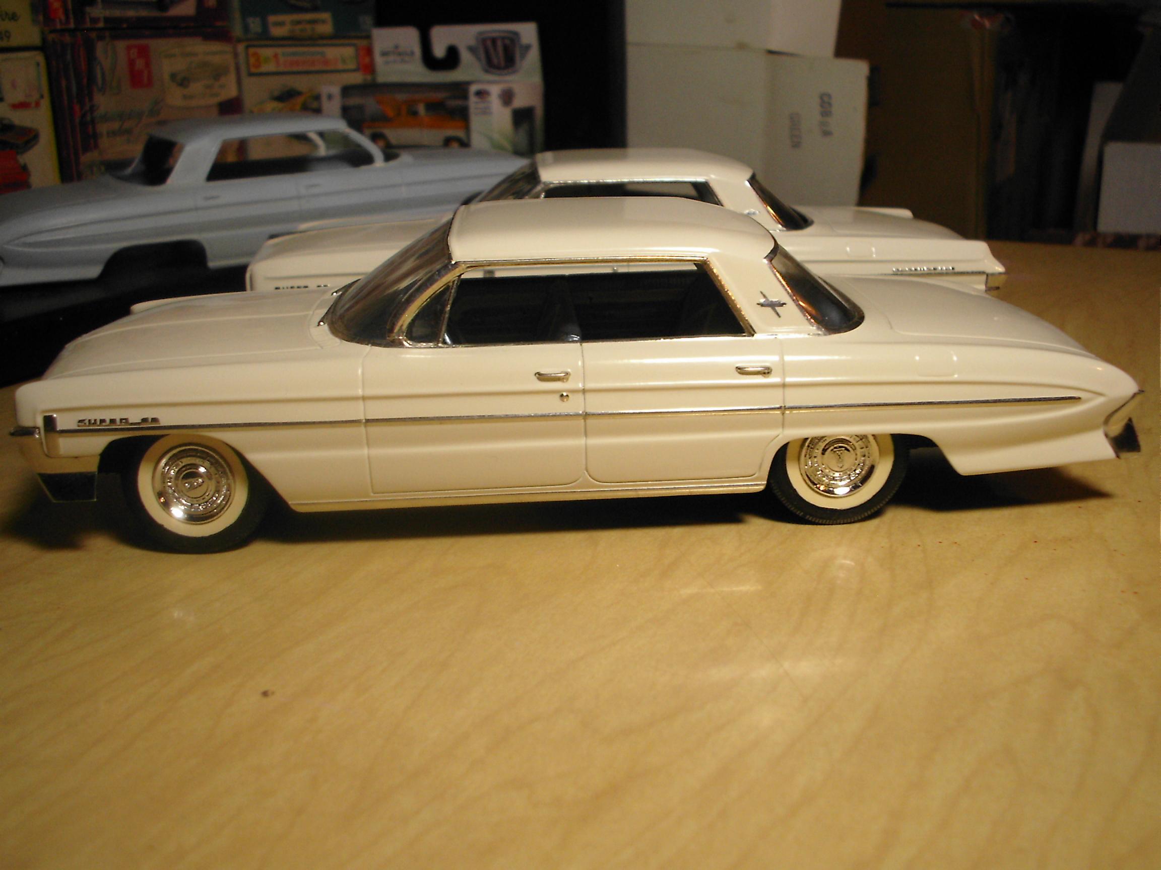

Hi Rusty, I really like the 61-63 Oldsmobiles. Here's a photo of one of my built  61's before detailing the hubcaps. I posted a blue one a few months ago. And here's a shot of my unrestored (besides paint) 1:1 63 Dynamic 88  Holiday Hardtop. I'd love to see your 61.

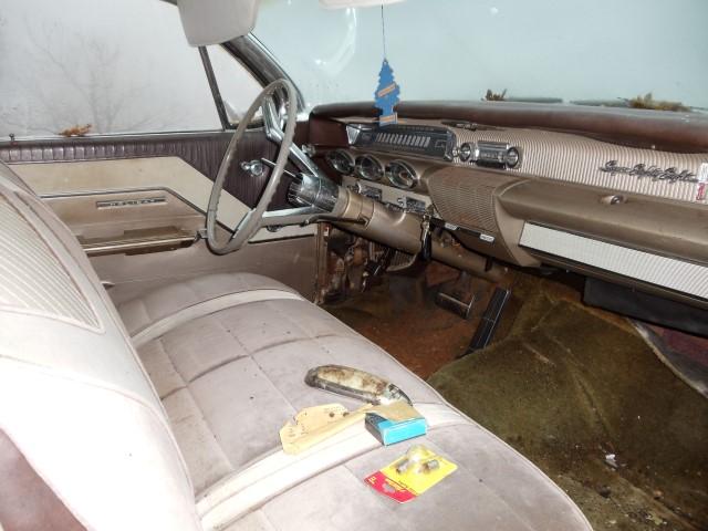

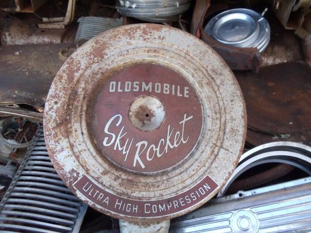

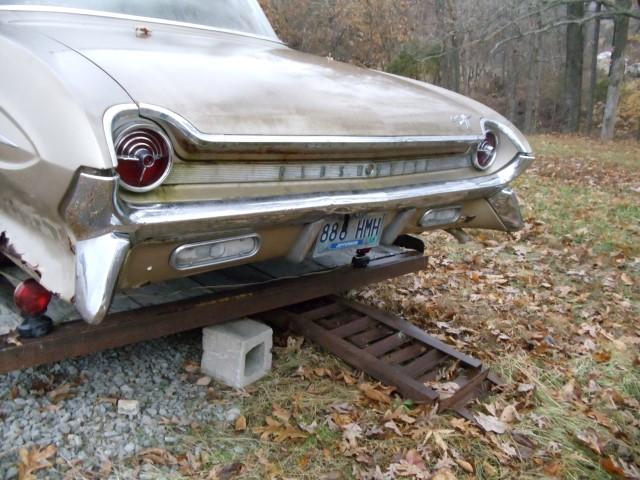

Wow, that '63 is one handsome ride. Now I have Olds envy! Mine has some typical lower body rust, but nothing catastrophic, worst is the left rear skeg, and that's an easy shape to deal with as far as making a patch panel. Interior, faded but complete and still sits well. LOVE those Olds dashes and steering wheels, and the over all design of the upholstery work. I will keep the interior close to these stock colors when I get around to it..

Absolutely beautiful Super 88 and it looks perfect in white !  Your foil work is so precise especially the emblems and script , excellent work !
Thanks Bob, I appreciate it.

Rusty, thanks for the photos. It really looks pretty complete (minus engine)  without too much rust.  It should be a good project. I've always wanted to a project like that but never had the space.
GM had some great dashes back in the day and you can't beat those Olds steering wheels! My favorite dashes are the 61 Pontiac and 63 Olds. The 63 Olds dash looks very similar in design to the rear bumper on the 60 Olds. With factory air (my first one had it) the left and right dash outlets even look like the backup lights on the 60.

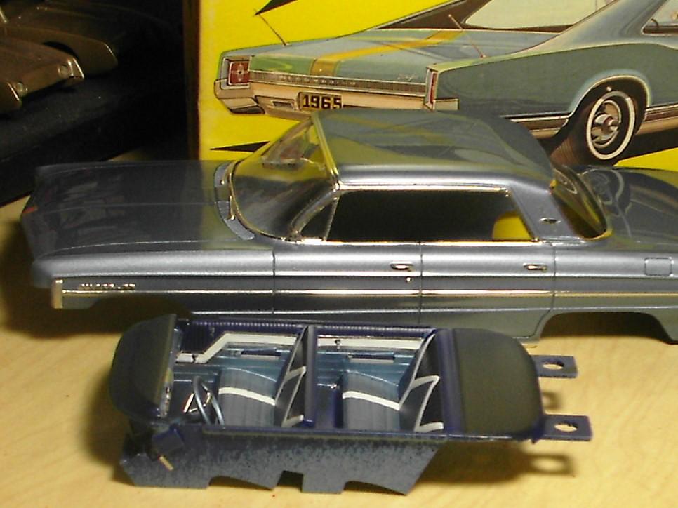

Here's a couple more of my present 63 and one showing the interior of my blue 61 Olds. Johan did a pretty good job on it.  -Rich

The guy that owned my '61 had the 394 out for a rebuild, and the shop folded and his engine just came up missing somehow. All the accessories (breather, pulleys, etc) are still in the trunk. Don't think mine, if I had it, would have liked regular...
The missing 394 could be a blessing since it might direct you to a newer engine/trans and that way you will replace the horrific Slim-Jim Roto Hydramatic.

Clean build!
If the wheels aren't glued yet, I'd like to make a suggestion:
Here's my '62 built from a Promolite (Tom Coolidge) resin kit. In order to get rid of the typical JoHan too-narrow wheel track, I used brass tube for the axles (.047" I think) cut at lengths that brought the wheels and tires out - closer to the body. So that the wheels/tires/axles wouldn't flop back and forth on the narrow chassis, I made four spacers from Evergreen styrene tube that had an ID to allow them to slip over the brass tubes. Painted black, one spacer was slipped onto the tubes/axles before the wheels were attached.
