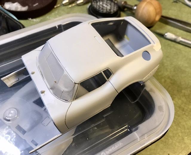

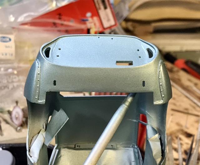

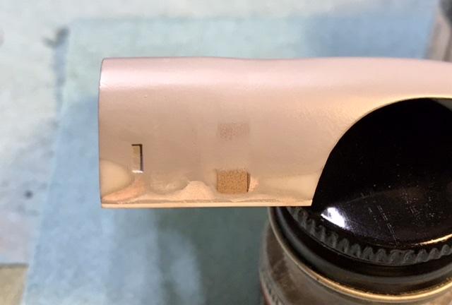

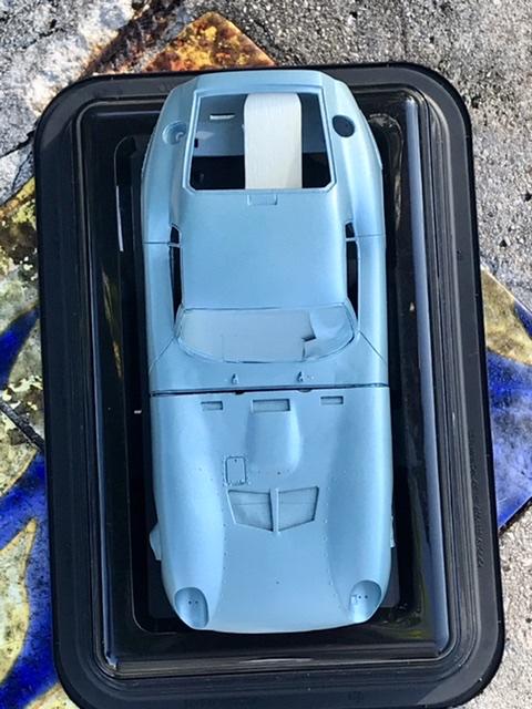

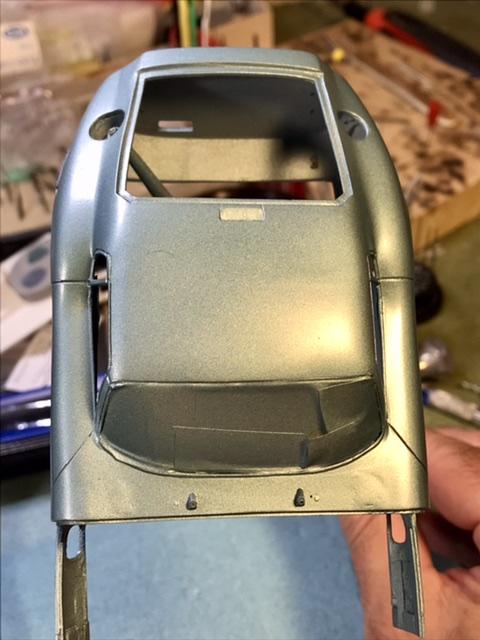

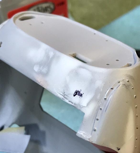

absmiami Posted December 20, 2022 Author Posted December 20, 2022 Some more primer on the body - need a smoother transition fr the fender to the deck - where the tail used to be .. 1

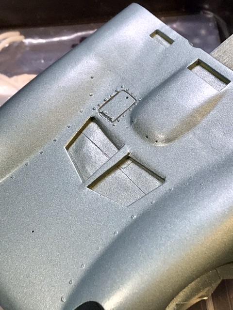

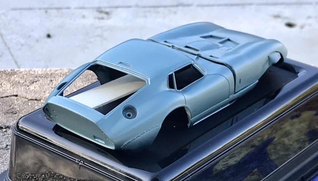

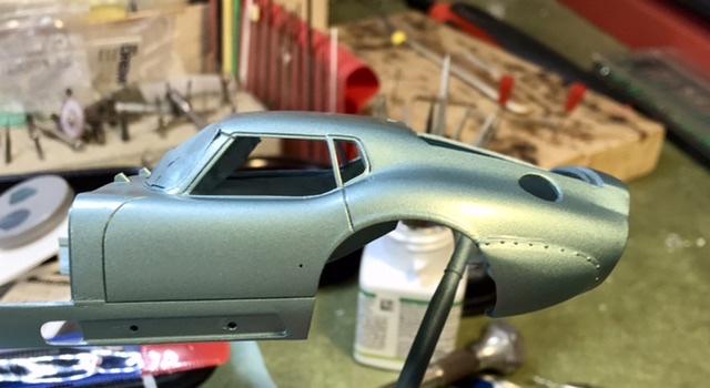

absmiami Posted December 20, 2022 Author Posted December 20, 2022 And some minor tweeks to the surface of the bonnett …

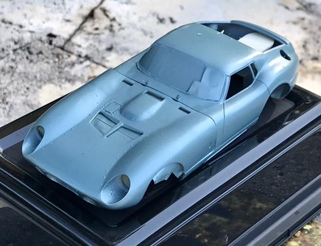

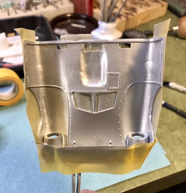

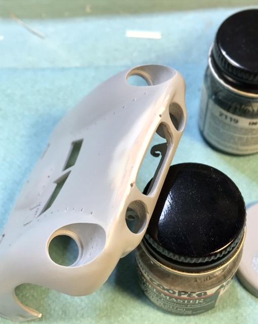

absmiami Posted December 20, 2022 Author Posted December 20, 2022 Model Master beat out Zero paints for the color coat - but I’m impressed w the Zero aluminum paint …. Looks good under the bonnett - i’ll use it on the interior and the bottom of the car too … similar to alclad - mite be a little easier to use …

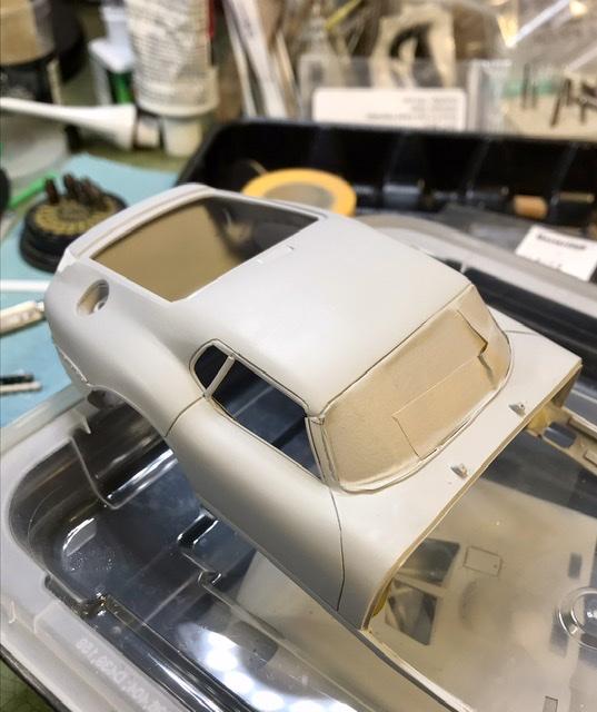

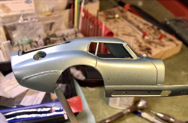

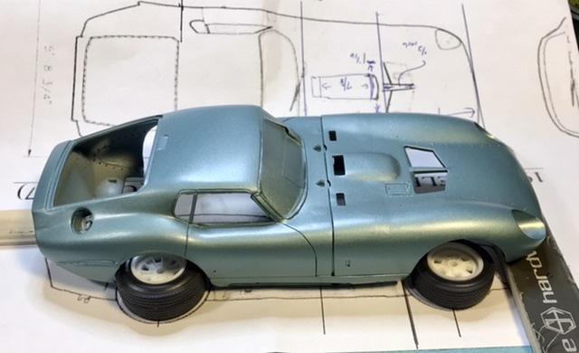

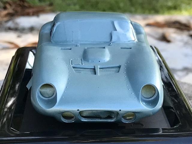

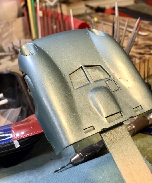

absmiami Posted December 22, 2022 Author Posted December 22, 2022 Time for some paint - im pleased with the color ….

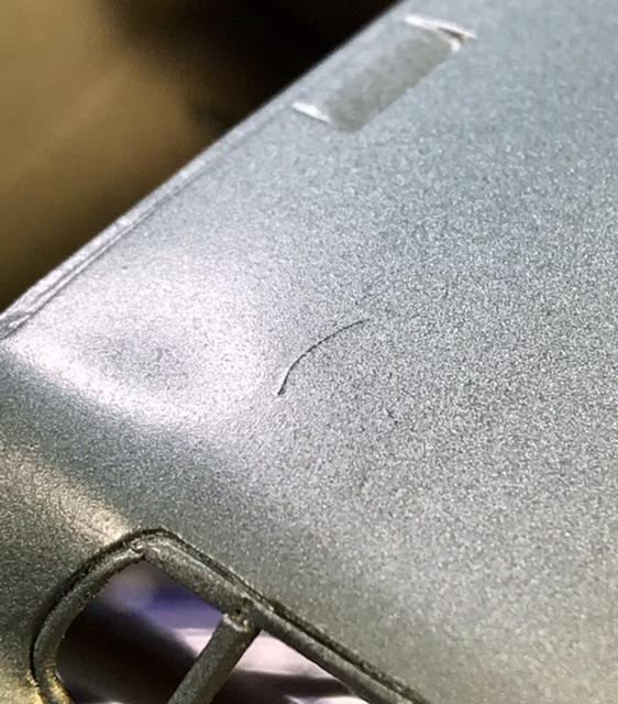

absmiami Posted December 22, 2022 Author Posted December 22, 2022 The kit directions specifically said to not leave body hair on the roof when you spray the color coat - but I’m directions-challenged - so i may need a re-do on the roof- we’ll see …

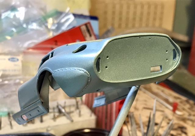

absmiami Posted December 22, 2022 Author Posted December 22, 2022 This is basically two light coats - the second sprayed within five minutes of the first - very little grain and smooth/consistent - thinned Model Master air brushes very nicely - might be able to polish it without sanding. - I don’t have much stock- I’ll miss it - 1

MarkJ Posted December 22, 2022 Posted December 22, 2022 9 hours ago, absmiami said: The kit directions specifically said to not leave body hair on the roof when you spray the color coat - but I’m directions-challenged - so i may need a re-do on the roof- we’ll see … Andrew, join the brush painter's society and you will never have a hair in the paint problem again.
absmiami Posted December 22, 2022 Author Posted December 22, 2022 4 hours ago, MarkJ said: Andrew, join the brush painter's society and you will never have a hair in the paint problem again. What are the dues ??

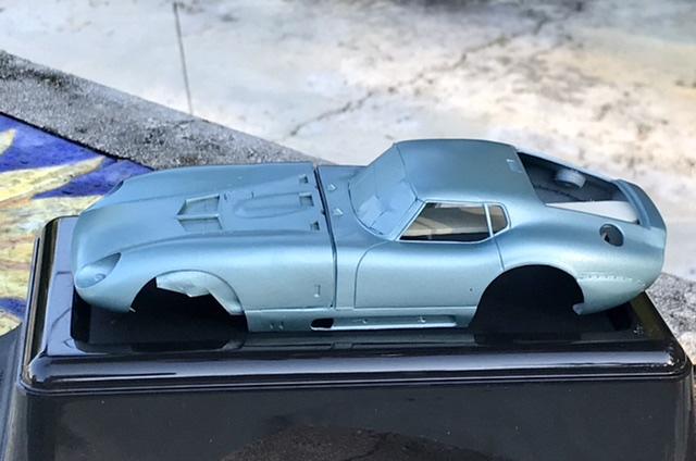

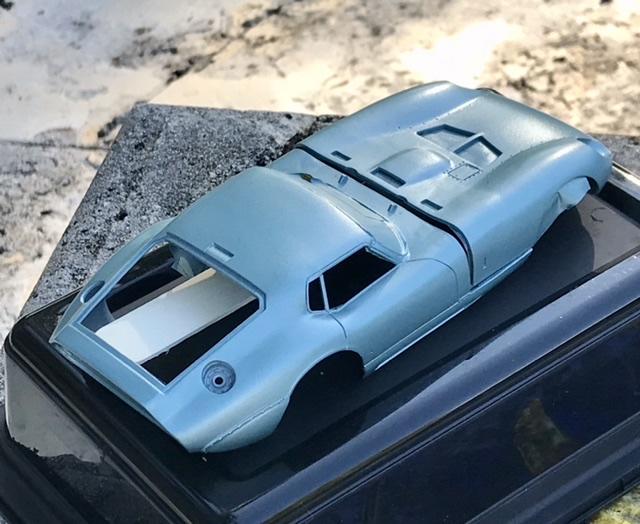

absmiami Posted December 22, 2022 Author Posted December 22, 2022 I noticed that the desk lamp light effects the photo color - when the Cobra was wheeled into the sun light this AM and photographed w the same device - I phone - the blue is much bluer …

MarkJ Posted December 22, 2022 Posted December 22, 2022 4 hours ago, absmiami said: What are the dues ?? It's free. But you have to buy a bunch of paint in dropper bottles sold by Vallejo and some high-quality artist brushes to get the paint to flow on properly. But you never have to worry abought orange peel or grainy paint or any of the other things that can happen when you are spraying. Thats why Pierre's paint jobs are always perfect. He has figured it out completely. i'm still working on it.
Pierre Rivard Posted December 23, 2022 Posted December 23, 2022 Color looks good Andy. Which of the paint did you end up using. Anyhow it looks mighty good, more grayish blue than the mix I did for Miles' Cobra. I think you got it right!

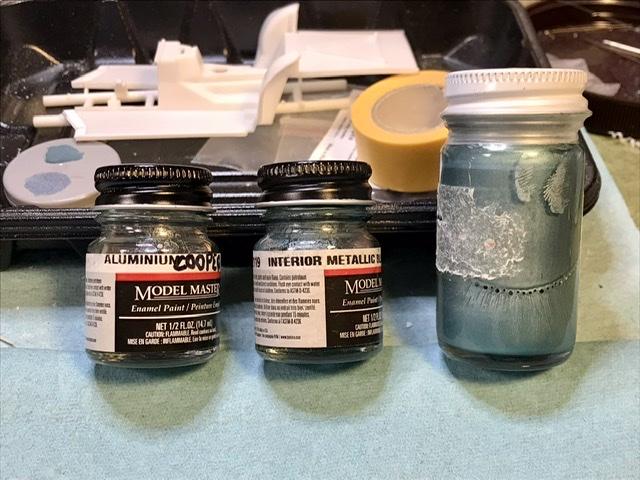

absmiami Posted December 23, 2022 Author Posted December 23, 2022 Hard to find/get now - but a small local hobby store had some left over Model Master paint stock - i mixed the interior blue metallic w some aluminum …. Didnt measure but its about 3 to 1 - the blue is close to a Mecom blue - then thinned w enamel thinner - enough to get it out of my Pasche air brush … still laughing about the roof hair - i realized that I painted about 6 hours after getting a haircut - note to abs - no haircuts on the days that you paint !!
