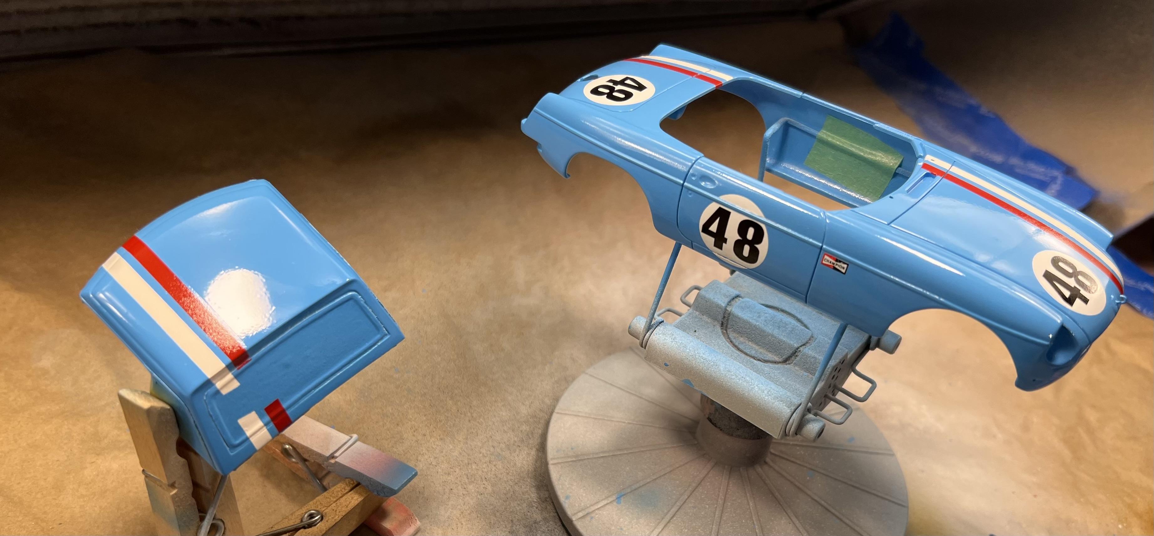

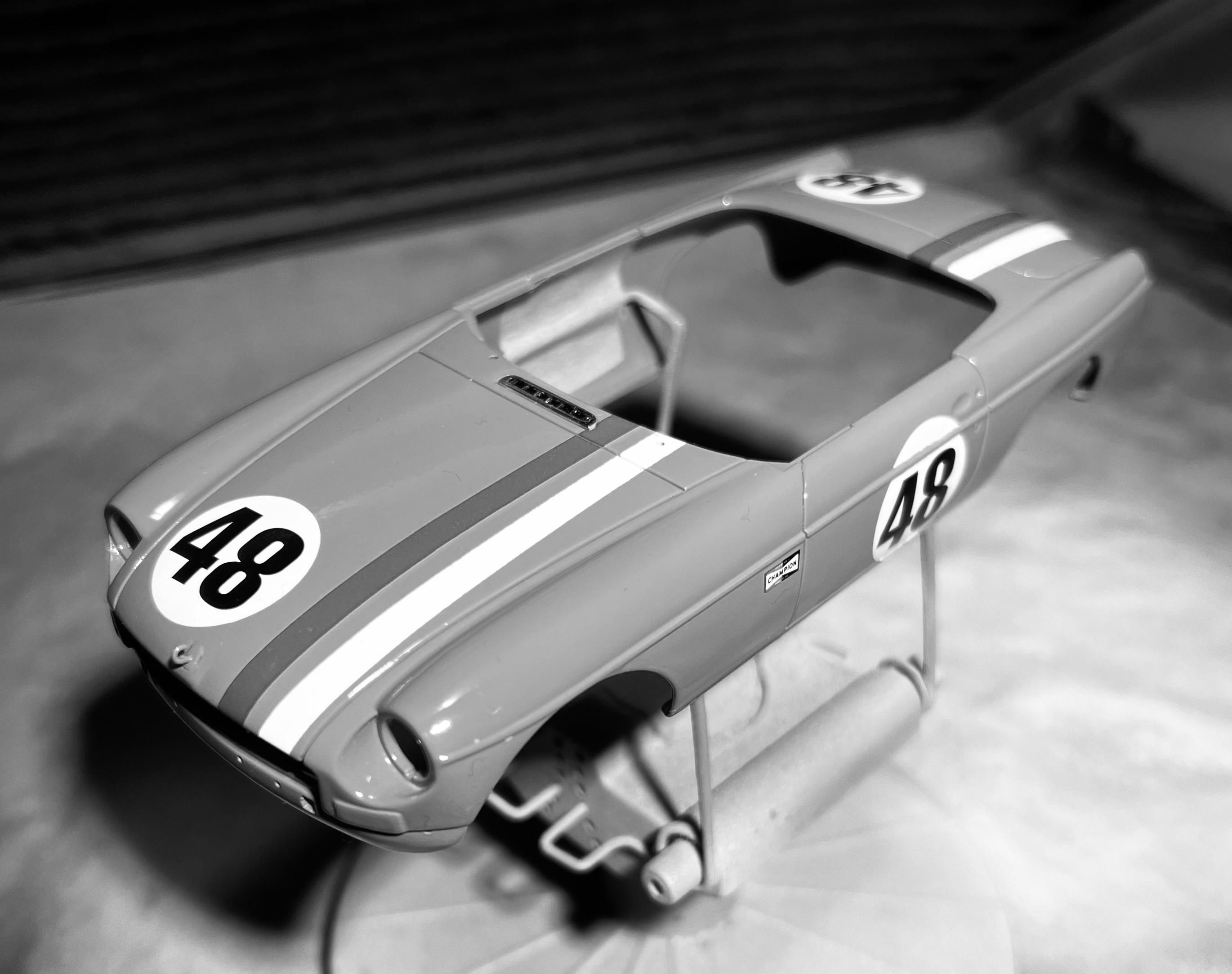

Finished with the decals!

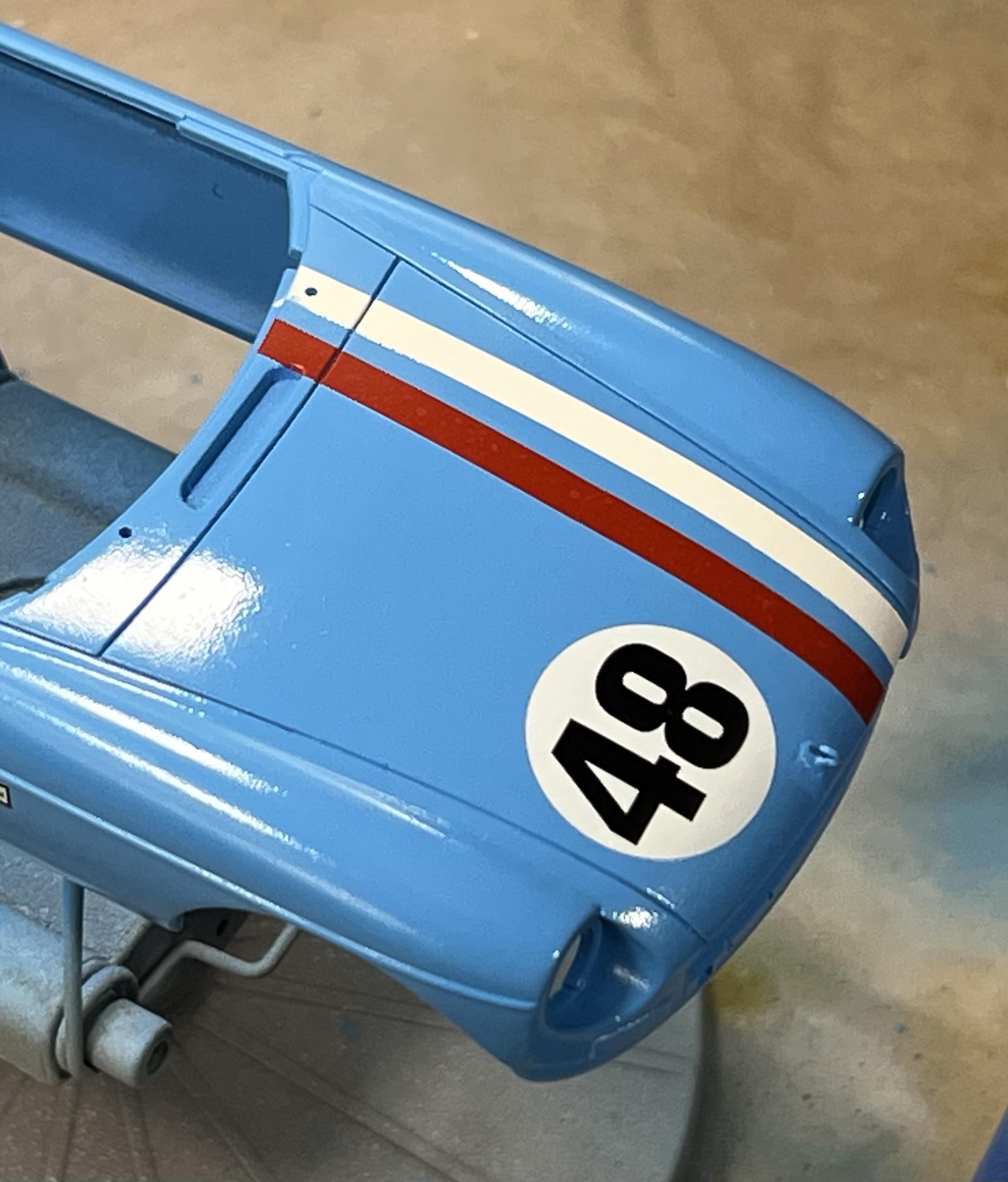

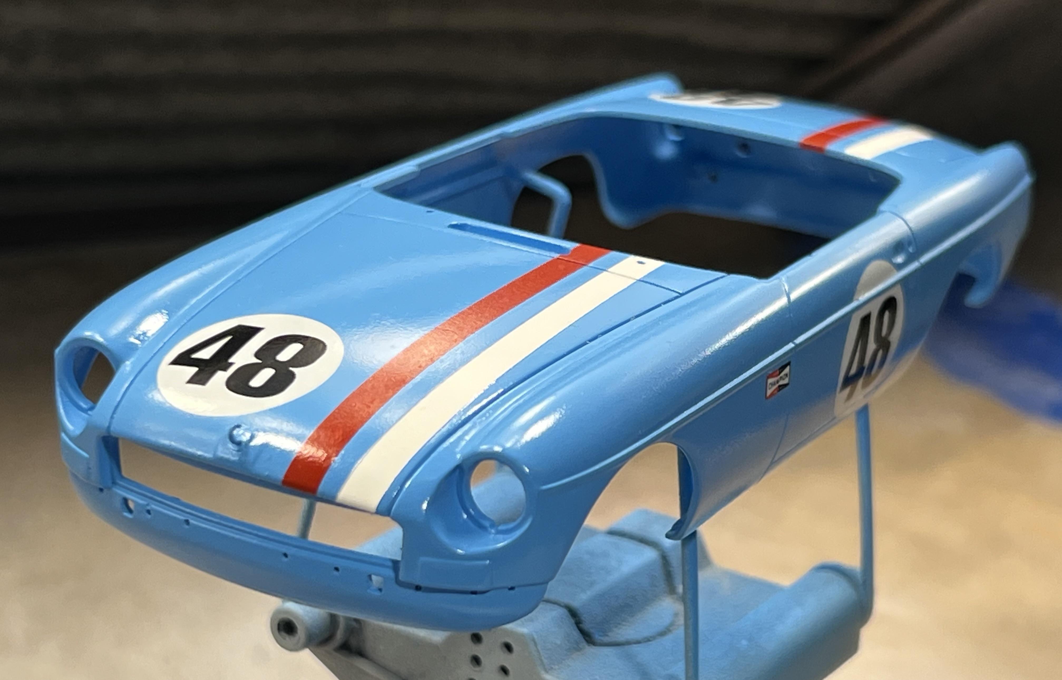

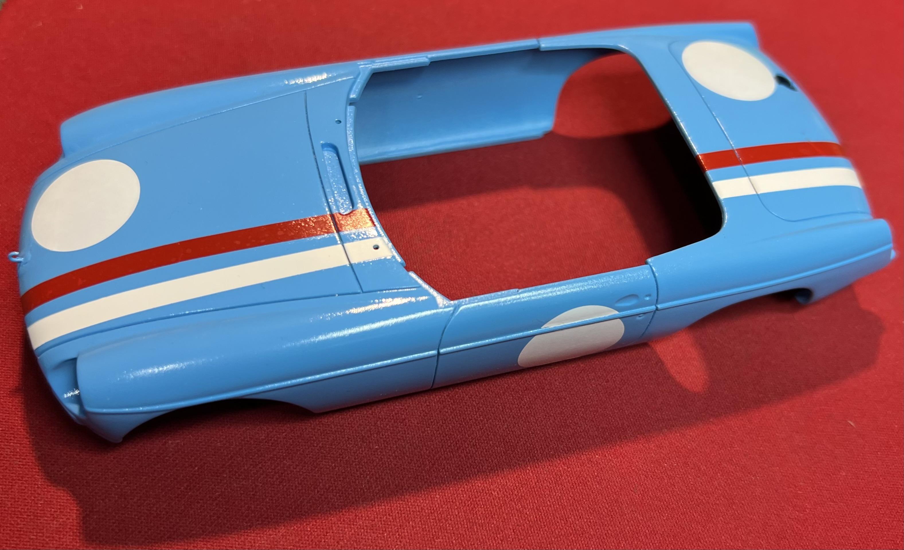

This was quite the task involving 27decals including the hardtop, all requiring close alignment. Overall it worked out well, especially in light of the difficulties. Most of which were decals breaking and needing careful repair. The red stripes were from an old sheet of Super Scale and the meatballs and numerals came from Cartograph in Italy.
To begin after the red stripes had been laid down was to apply the blank white meatballs, splitting the door ones for the chrome trim.
A discovery was made in realizing that the proper location of the fuel inlet needs to sit a bit lower than where I located it. As a result, the white meatball just squeezed onto the trunk lid!
The numbers were each applied individually, a total of eight that required alignment with my shakey hands & so-so eyesight.
Over all, it’s close yet no cigar. The numerals are rounded, not sharp edged as on the prototype. The omission of the drivers’ lettering on the front fenders is another reason for having a decal sheet custom made.
Once dry I’ll clean up the decal solutions used and prep the body and top for the clear coats with TS-13.
That’s the latest… thanks for looking in. Always interested in comments…
Cheers Misha

Hi Mark, Thanks for your comment, when it comes to racing vehicles I tend to avoid the high gloss show rod finishes and rather go for a more utilitarian look. If all goes well with the clear coat I plan to wax it without any of the polishing compounds.
Cheers Misha

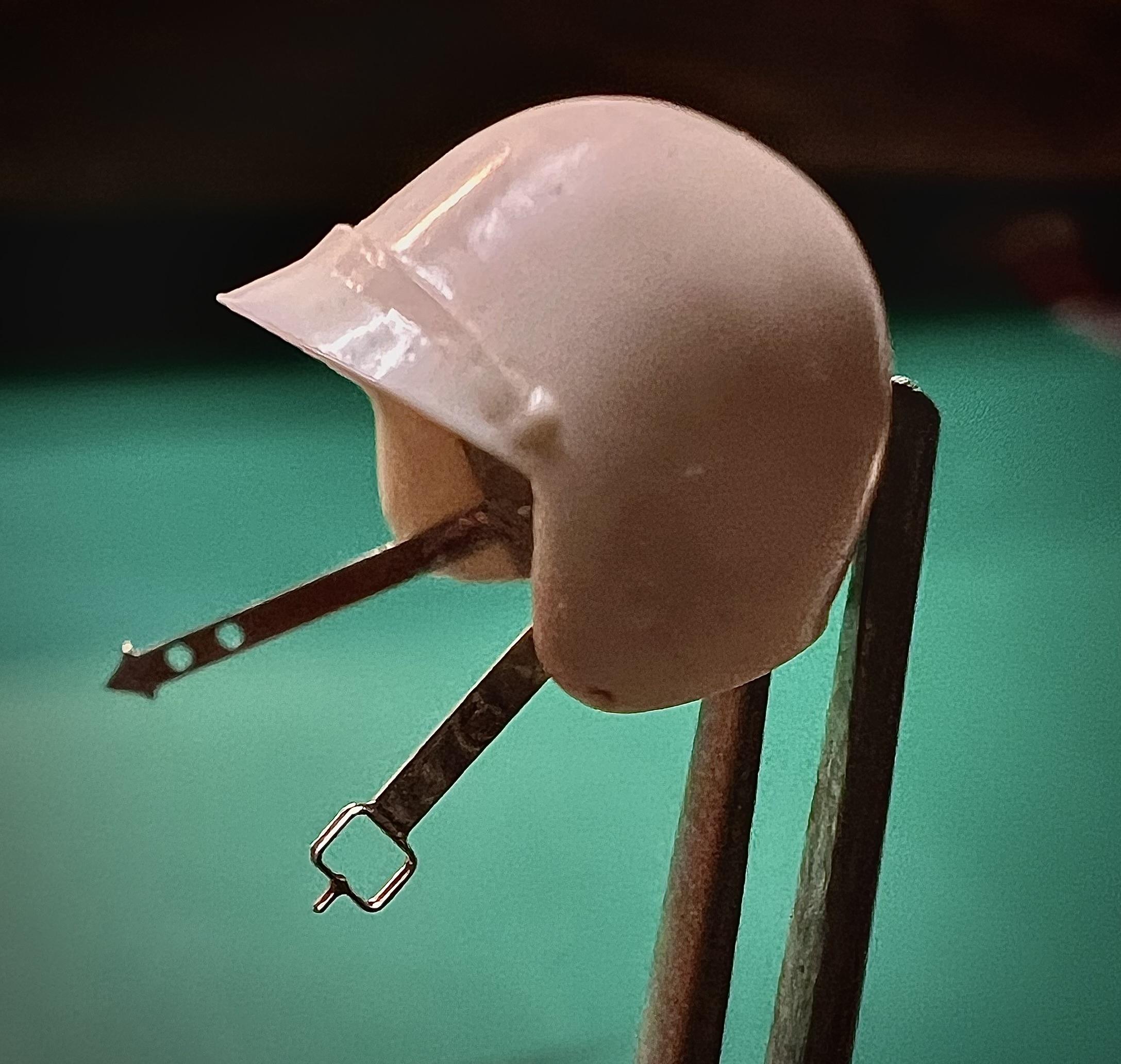

With the clear coat curing over the next few days I’ve turned to completing other components. The helmet is a Super Magnum from Bell, now a vintage item from the sixties. It comes from the AMT 63 Corvette annual which survived through a number of reissues to which I’ve added the textured P/E chin straps. Next step is painting and placement on the driveshaft tunnel, completing the interior.

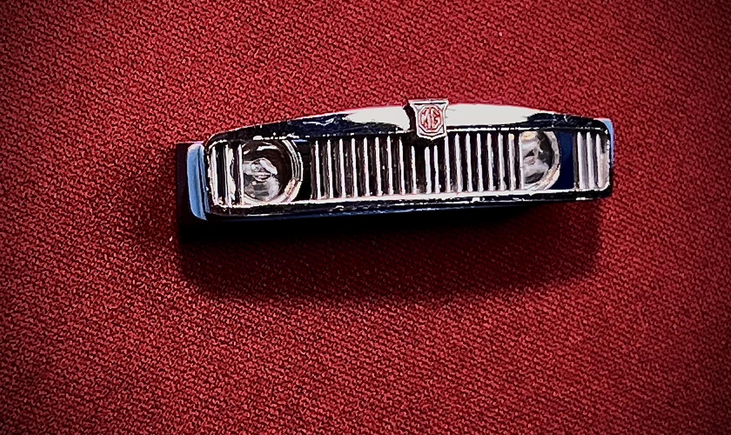

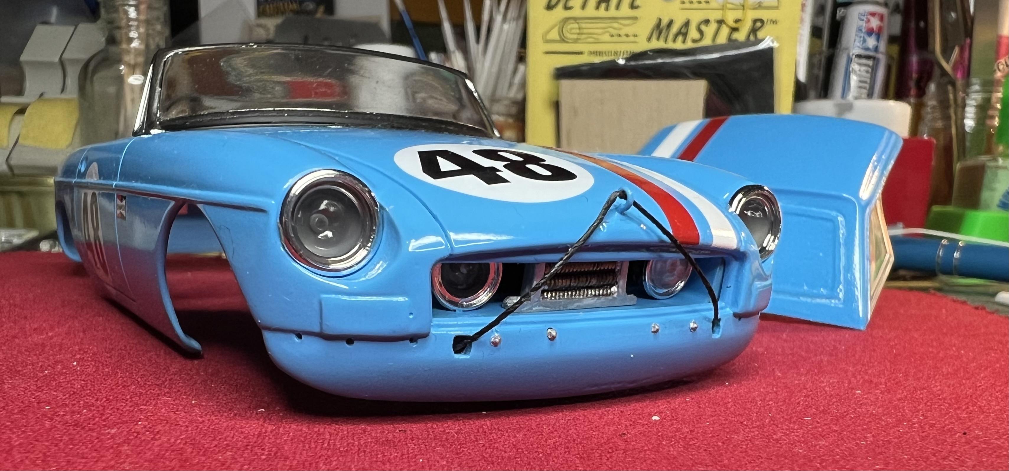

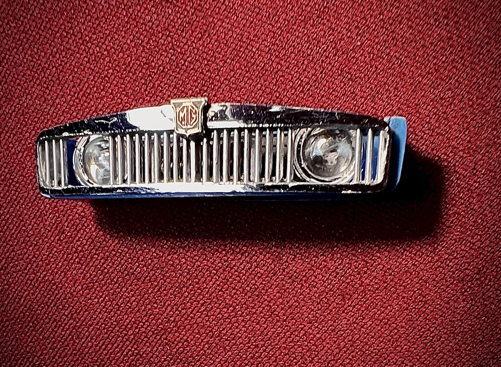

Finished off the front grill with the installation of the photo-etched MG badge using Future as an adhesive followed by a few drops on top to give the clear enamel polish to the badge. The grill has had a number of vertical bars removed for the twin Marchal driving lights. In addition the remaining bars have been treated to an aluminum shade, setting them off against the chrome surround. The scratch built enclosure also houses the engine oil cooler with the radiator in behind it.

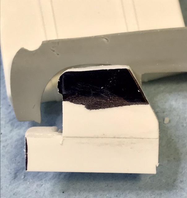

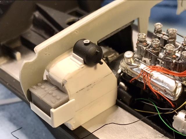

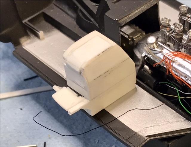

This is - i think - a Dave Friedman photo - thank you Gramps - the first two coupes : including 2287 - were built with the battery mounted in a tray on the right side of the passenger foot box - the batteries for the remaining Coupes were mounted on top of the footwell - and 2287 received this mod too - but i think not until after Sebring : when the car went to Europe and was prepped for Lemans and the remainder of the ‘64 race season …
  On 1/8/2024 at 9:14 PM, absmiami said:
So the Simeone 2287 - which has received only a  very limited restoration : carries its battery on top of the footbox - which was its location at the end of its competition life …
Expand

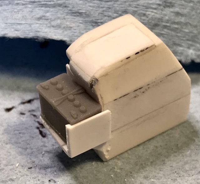

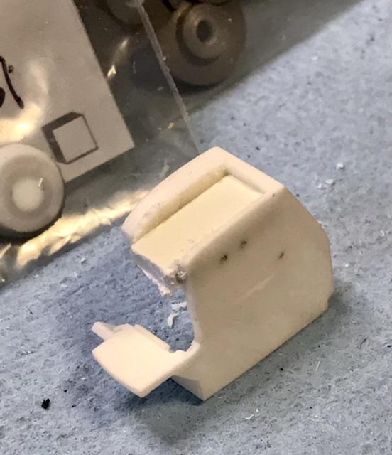

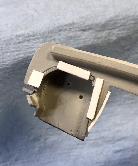

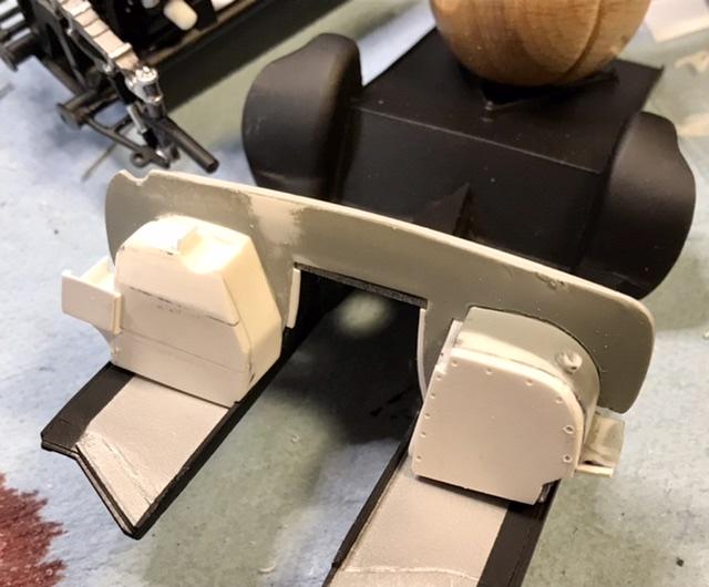

The footbox was deepened and re-shaped with a bunch of different Evergreen strip  -  and a 3D printed battery that I bought recently - is in its initial location - the tank on top of the box is - i think - the expansion tank for the radiator …
Very good multi-part interview of Mr. Brock in U Tube world - 2287 was prepped in Europe for the ‘64 racing season AFTER Sebring - there were a number of changes - so we know that 2287 sported orange plugs at Lemans - Shelby was still a car salesman - but at Daytona and Sebring ?  We dunno … the first bl wh photo does show that 2287 had its brake and clutch reseviors mounted on the side of the driver’s side foot box - so that’s another change to make …

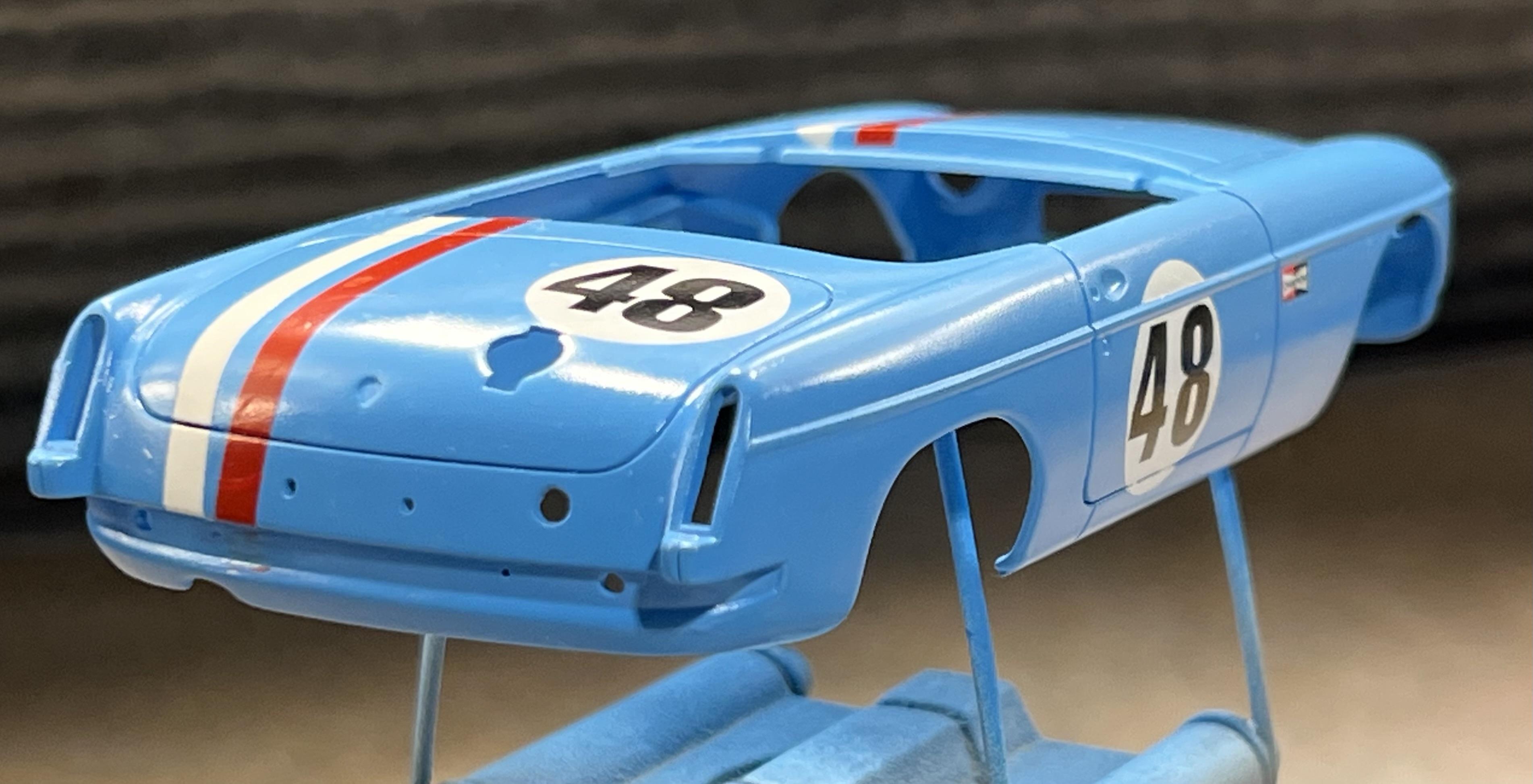

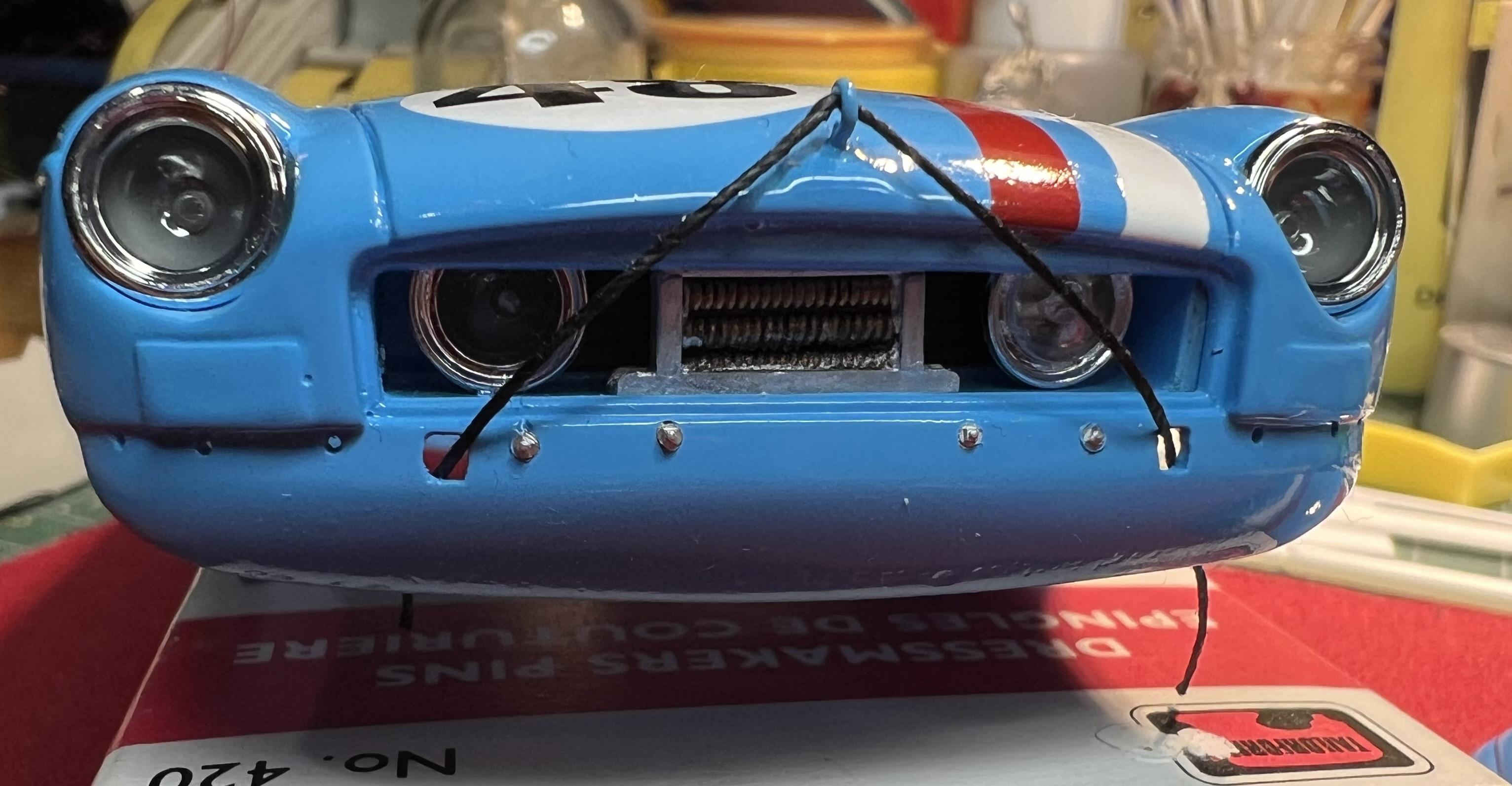

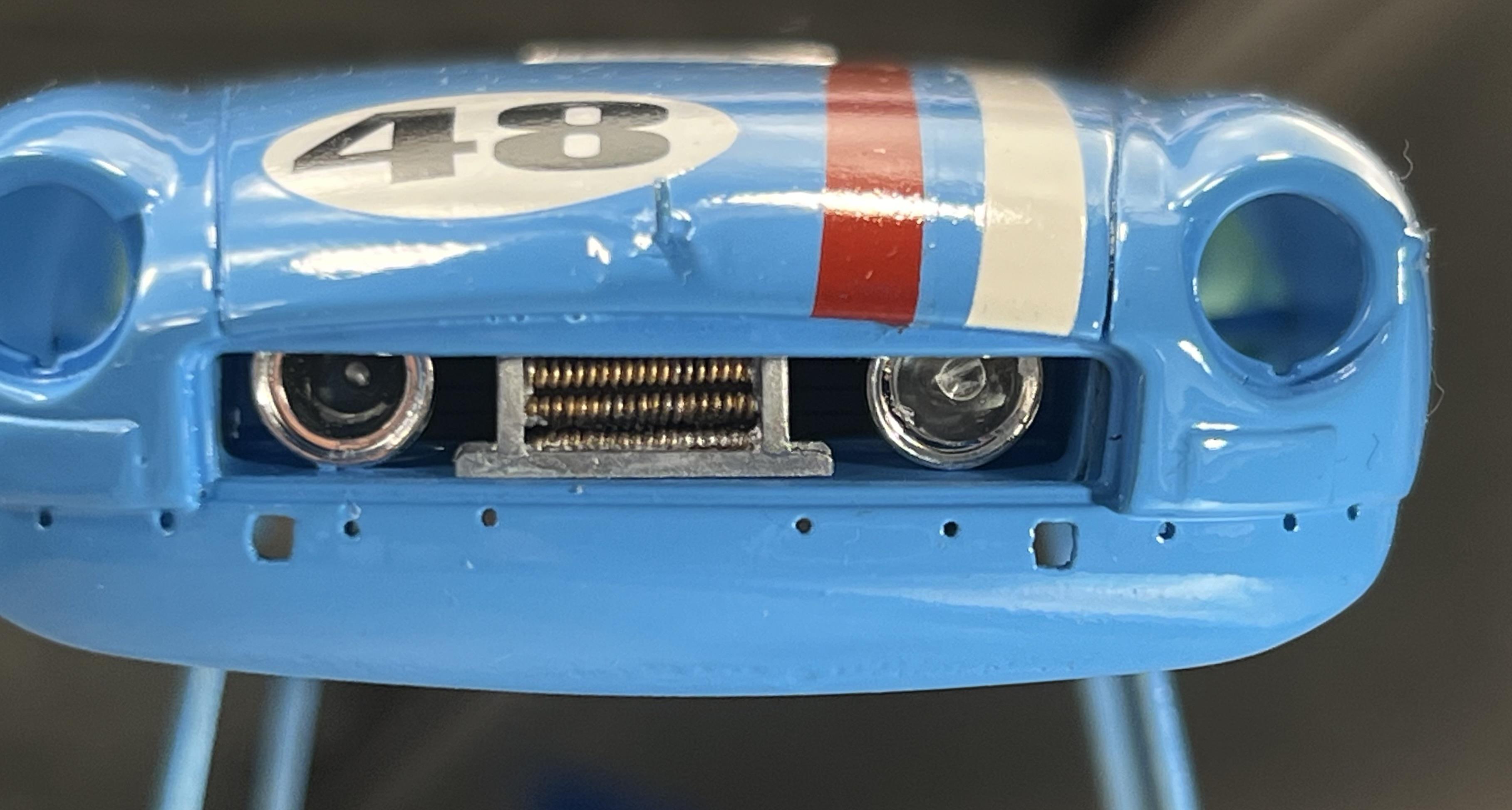

After a few days of spraying the clear coats the body was safe to handle allowing me to prepare it for assembling with the interior and chassis. To mount the body to the chassis a number of body details need to be attended to such as the gas filler and bungee cords.
The structure behind the grill was fitted first from behind that houses the oil cooler and driving lights. As a result of many mockups this scratch built item fit without issues. The result resembles a 67 Shelby somewhat…

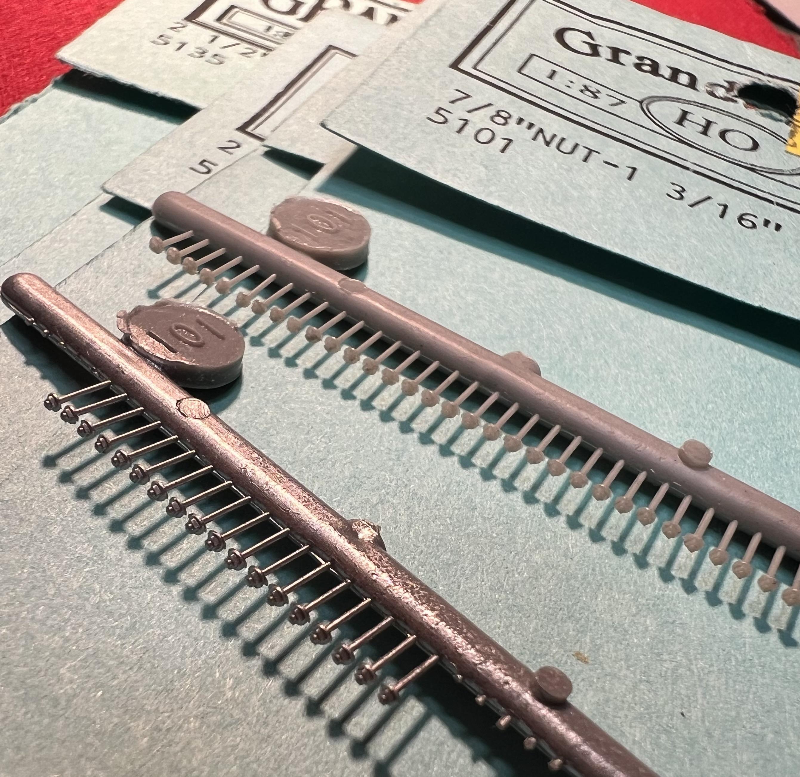

The added holes in the lower front panel is what holds it and the grill to the body. Using Grandt Line bolt heads the grill ones along the centre have been installed. I mocked up the assembly with the bungee cord in place for a look.

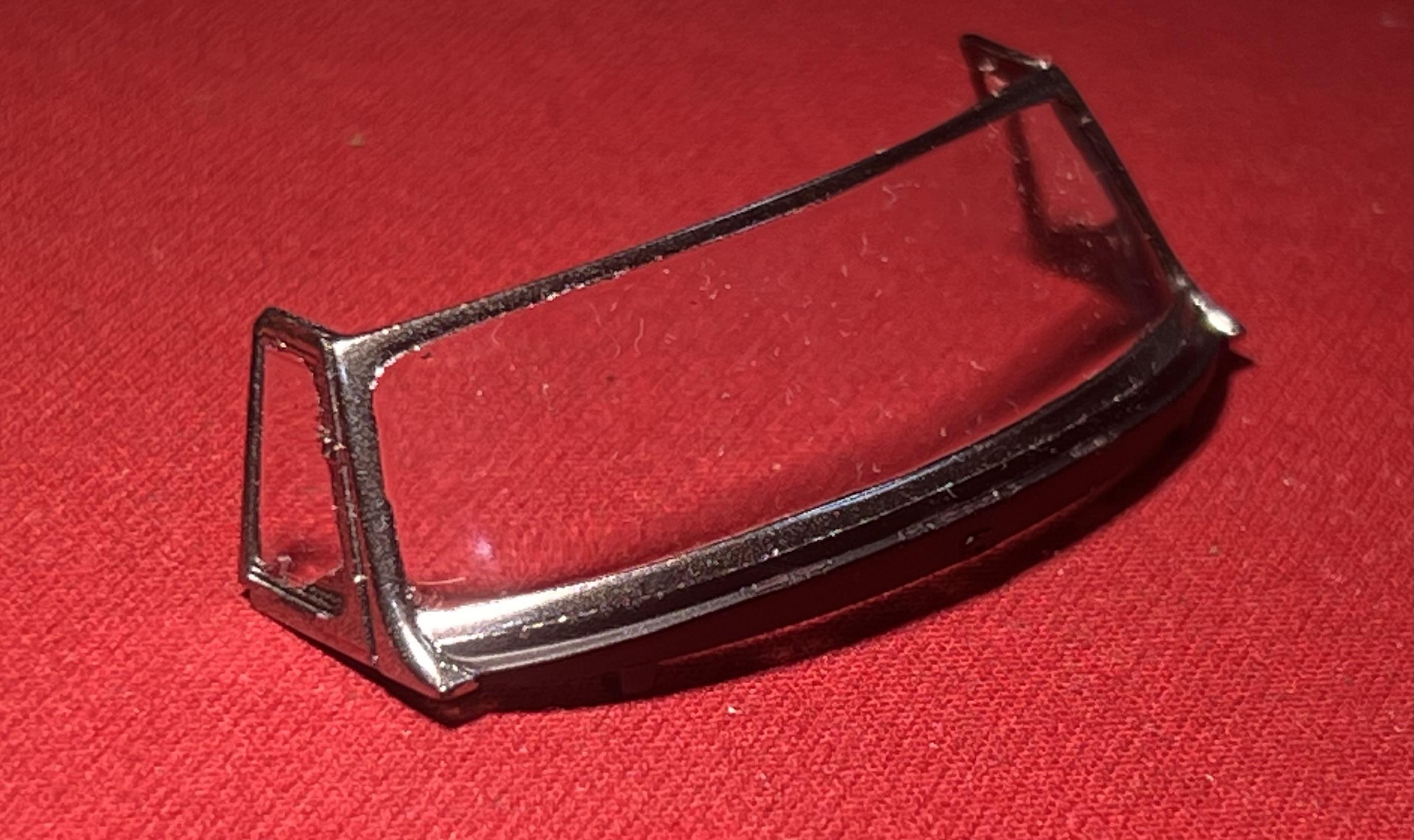

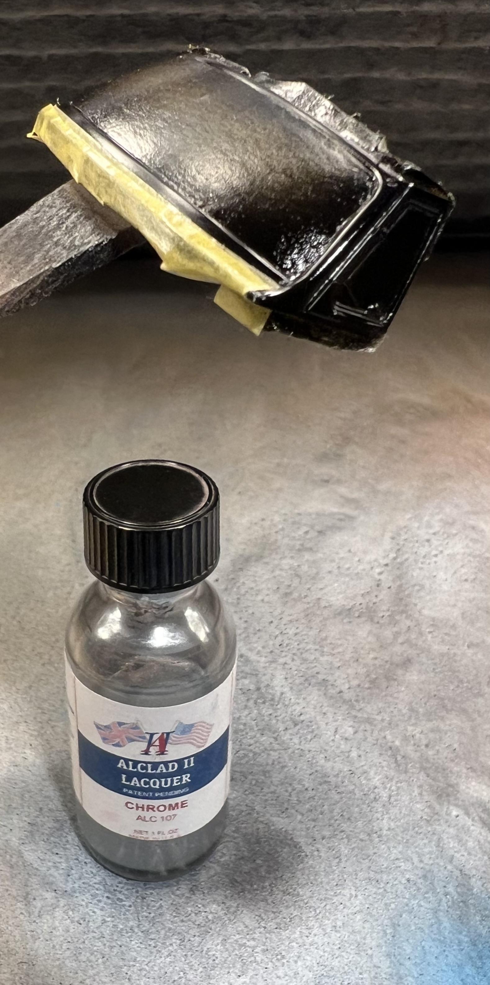

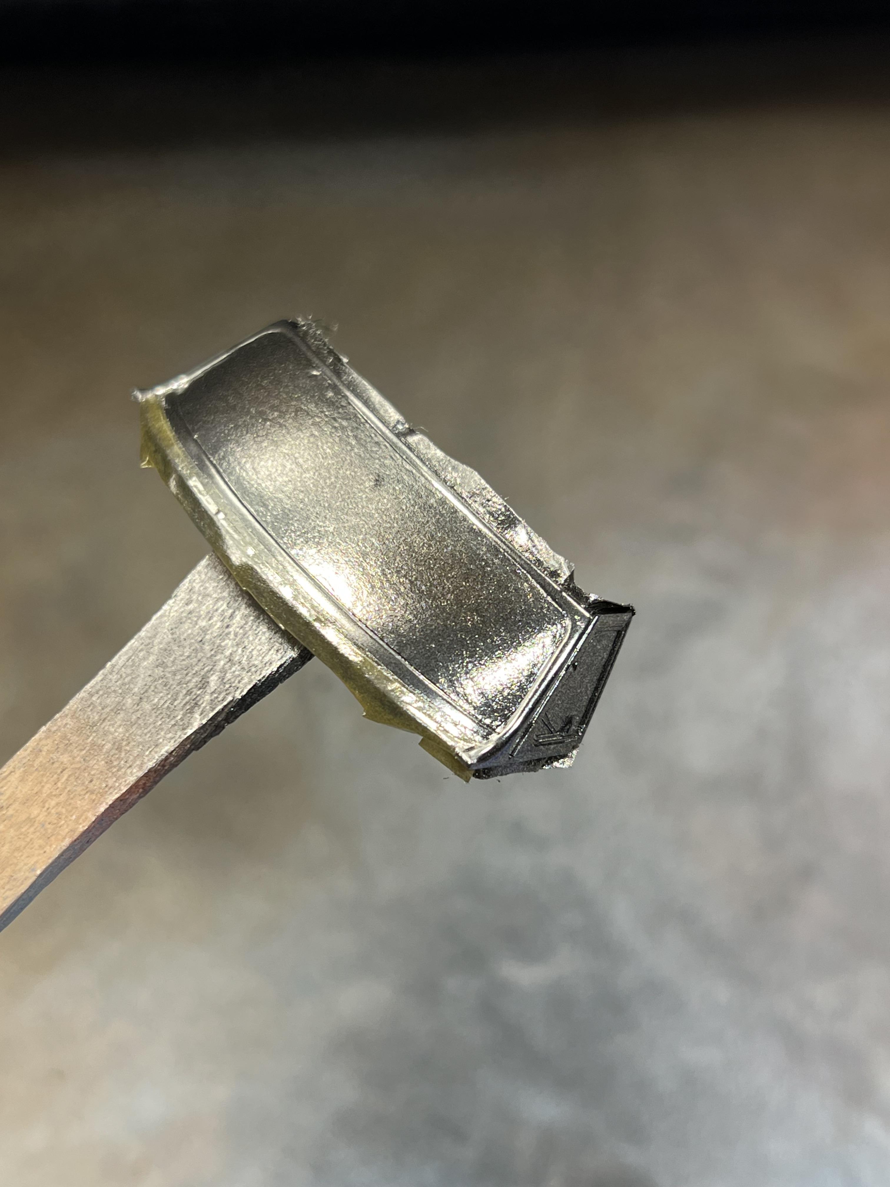

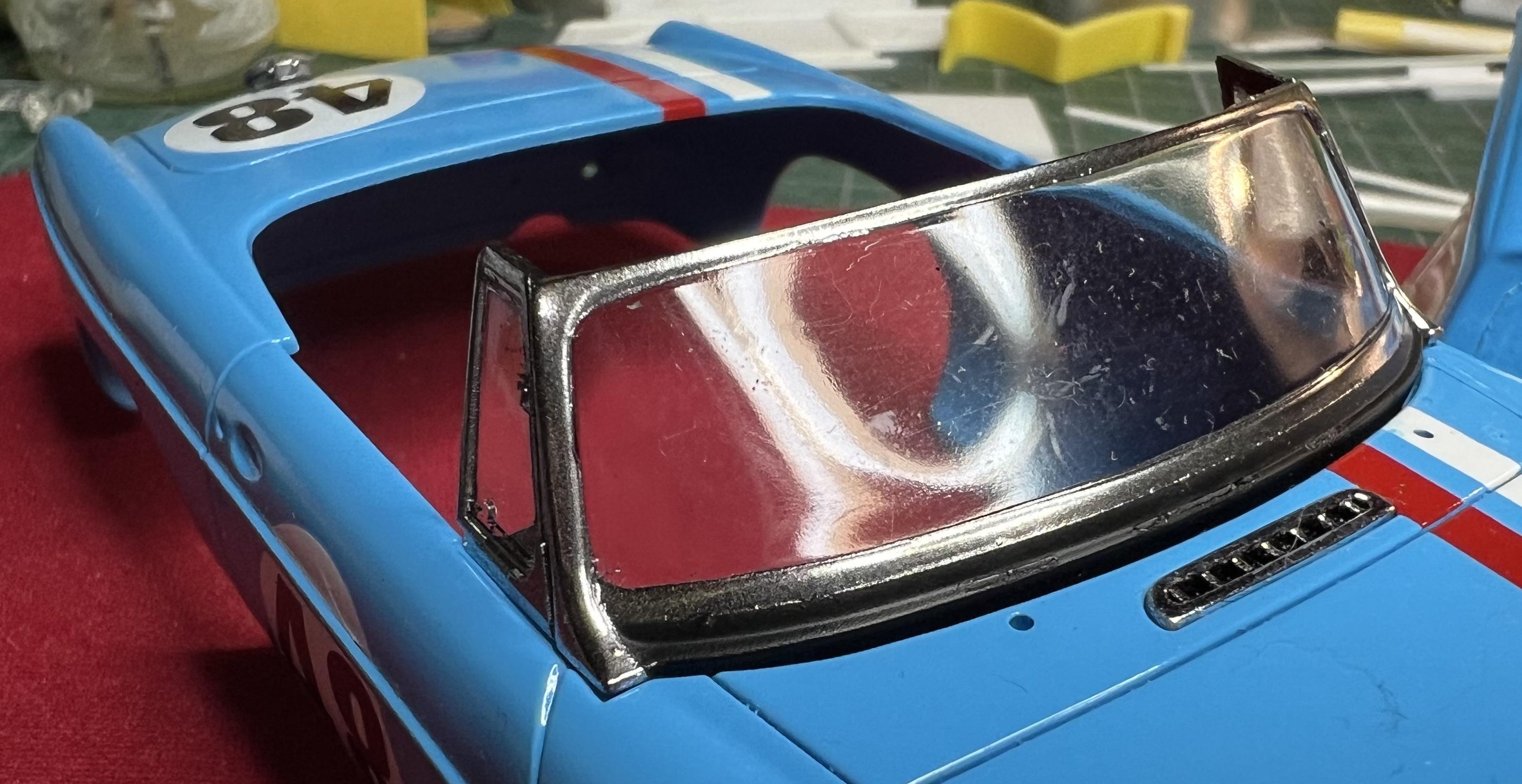

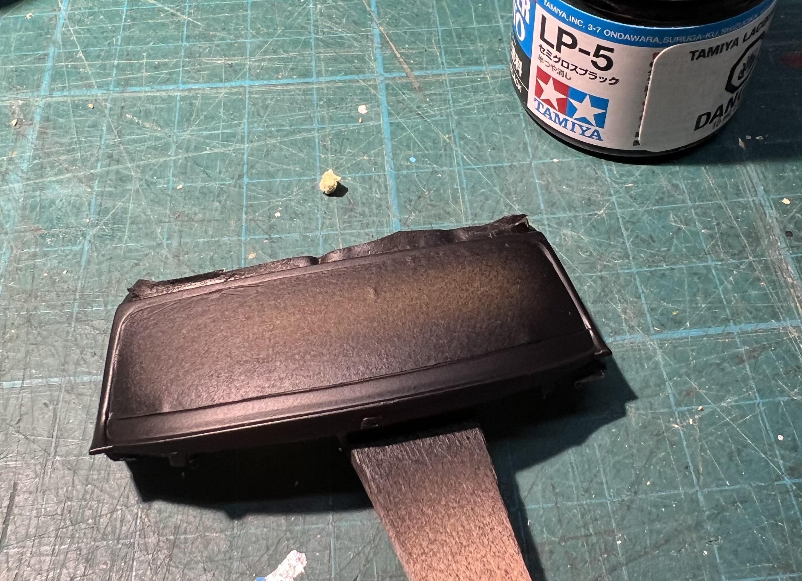

Having masked the windshield before, I applied LP 5 semi-gloss black as a base coat and to provide a black interior frame. After masking the rubber seal at the bottom of the frame it was sprayed with X 13 gloss clear in preparation for the Alclad chrome.  I have yet to find anything else that is better than Alclad for chrome metallic finishes.
The resulting windshield turned out well with the masking tape removed and mocked up on the body.

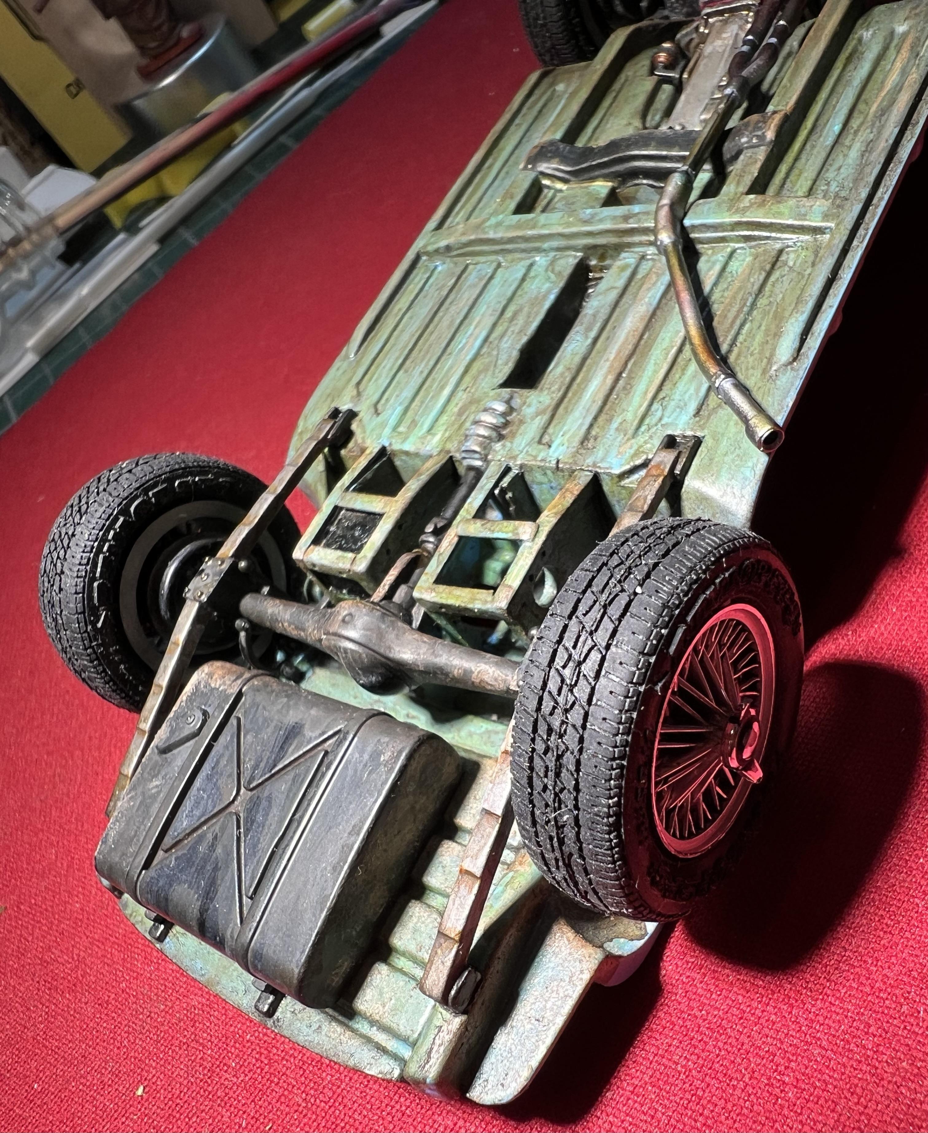

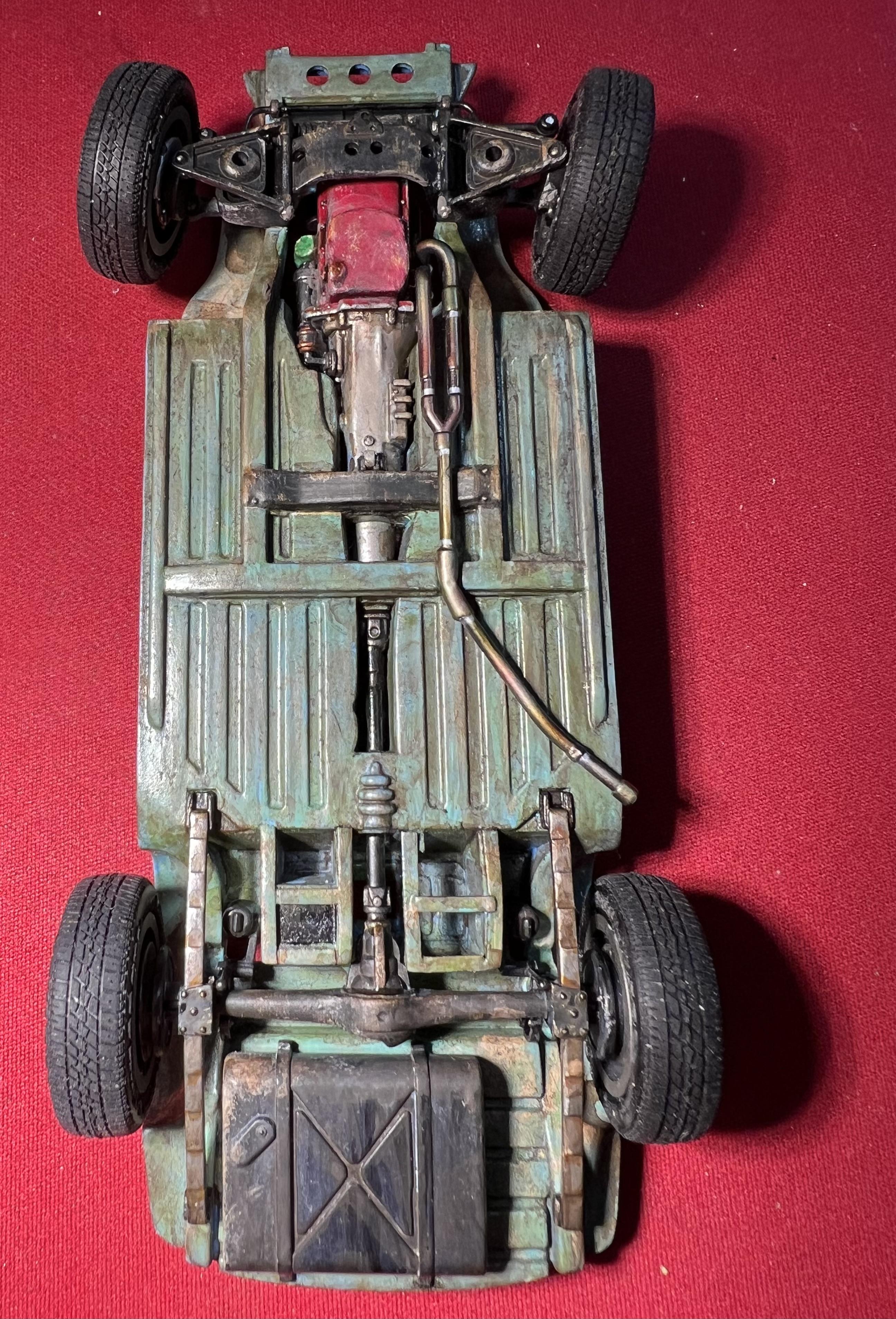

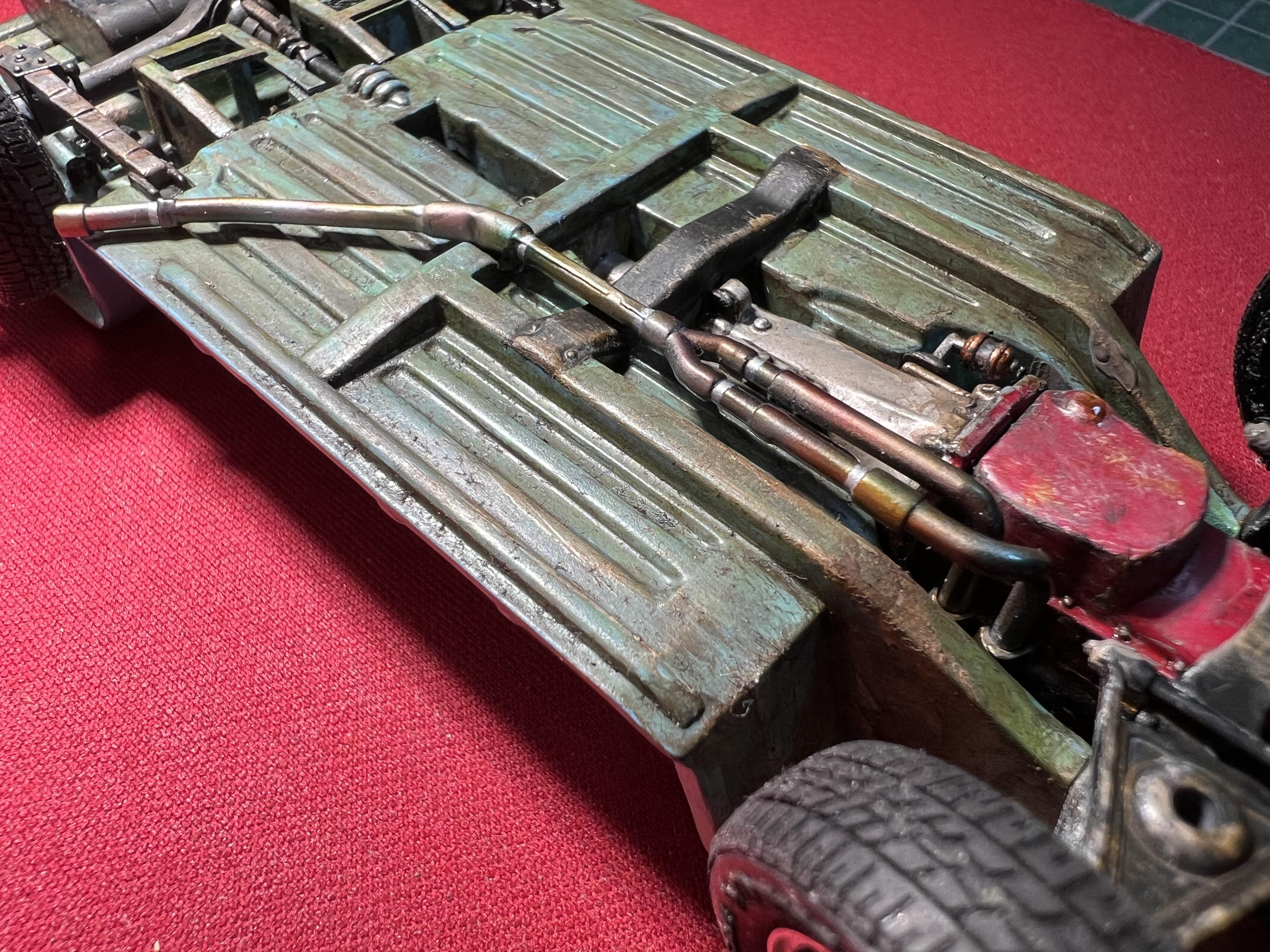

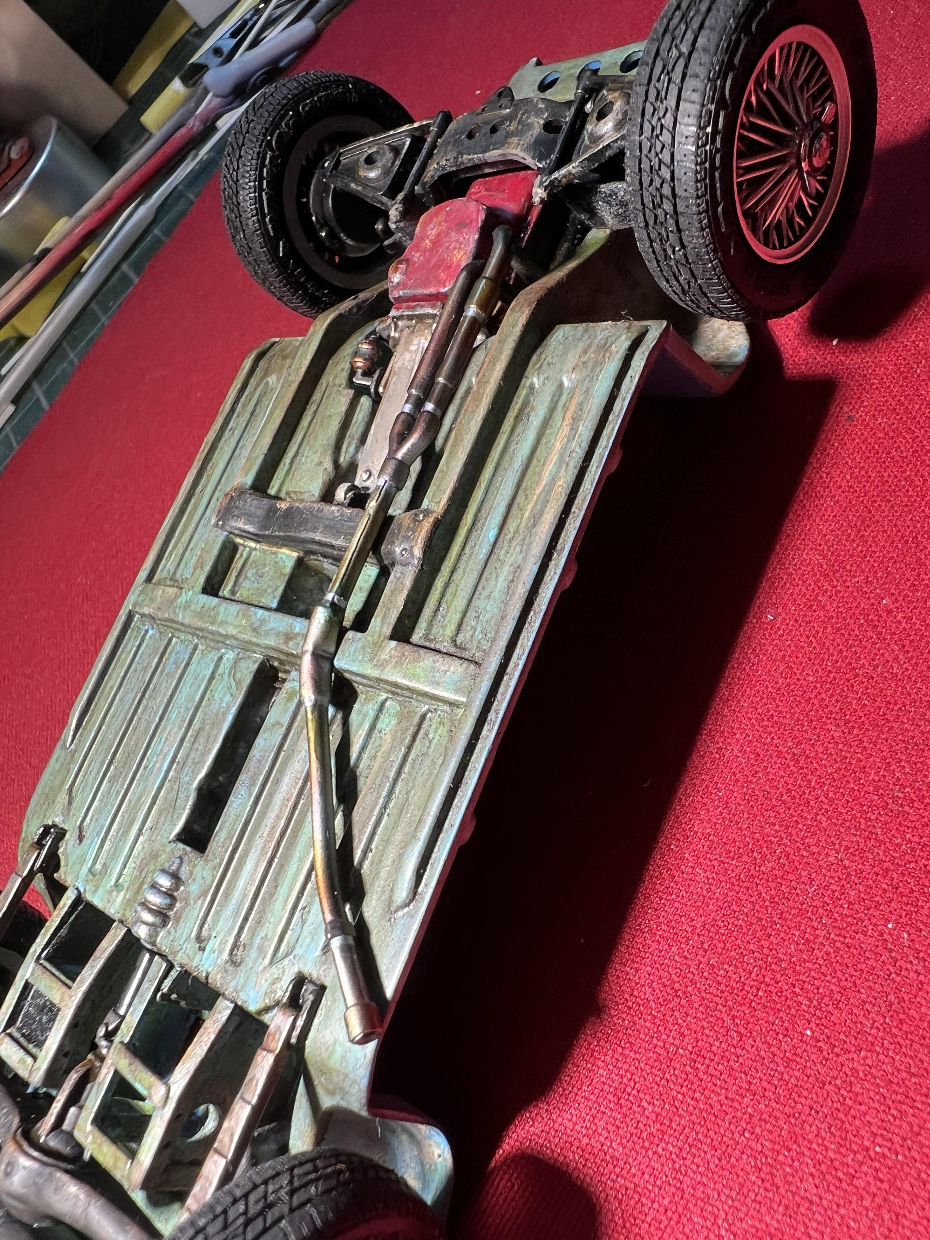

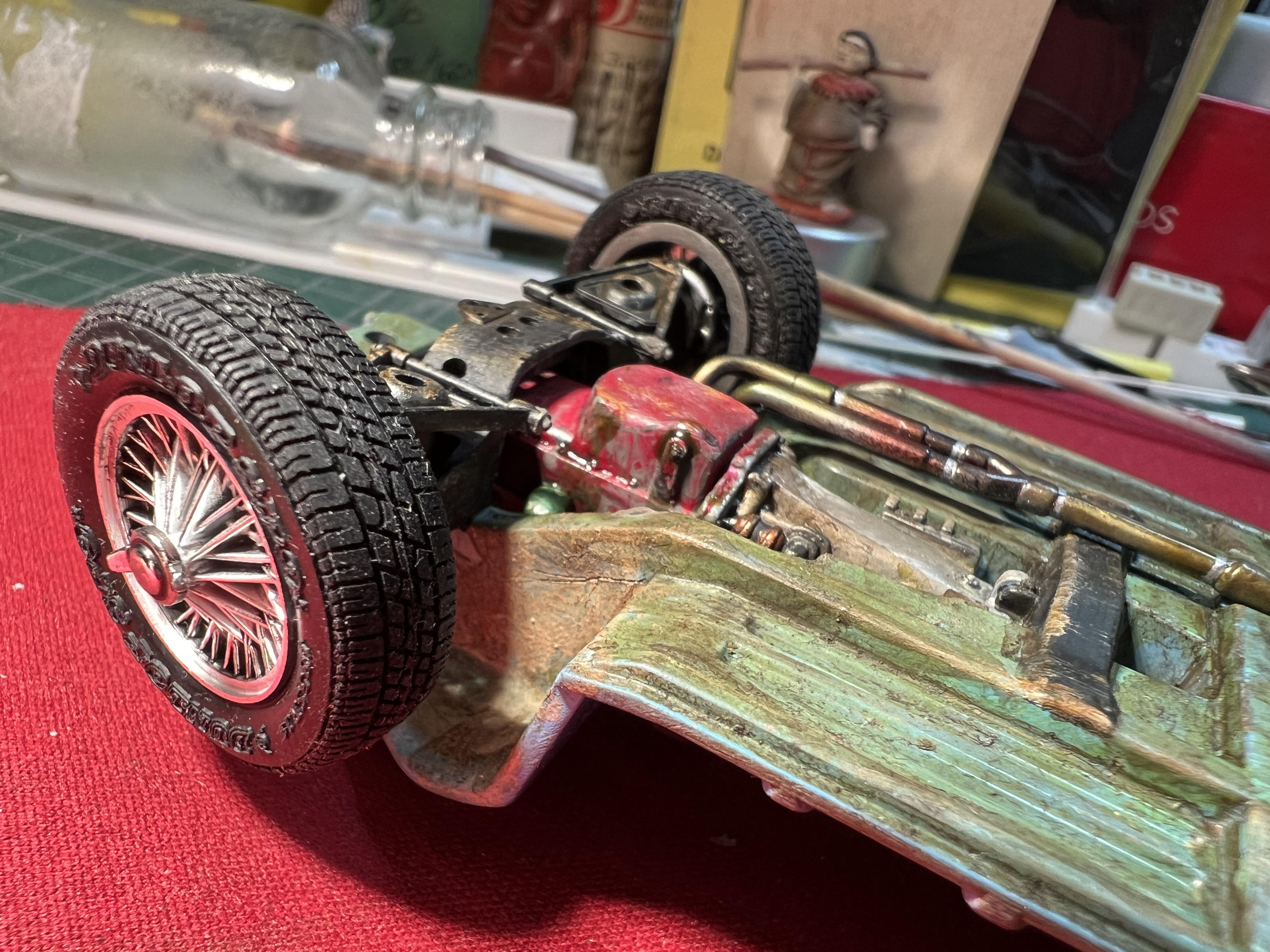

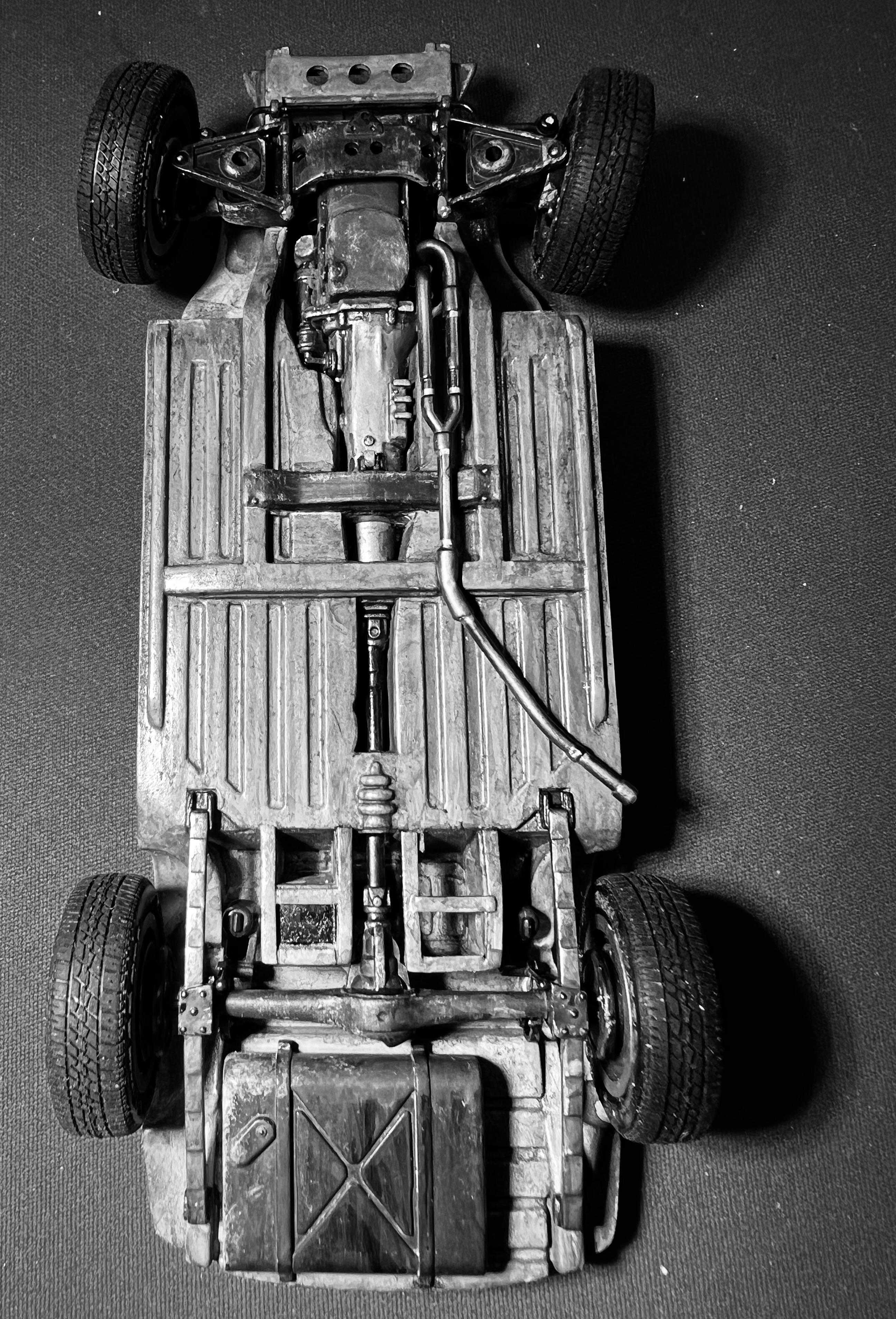

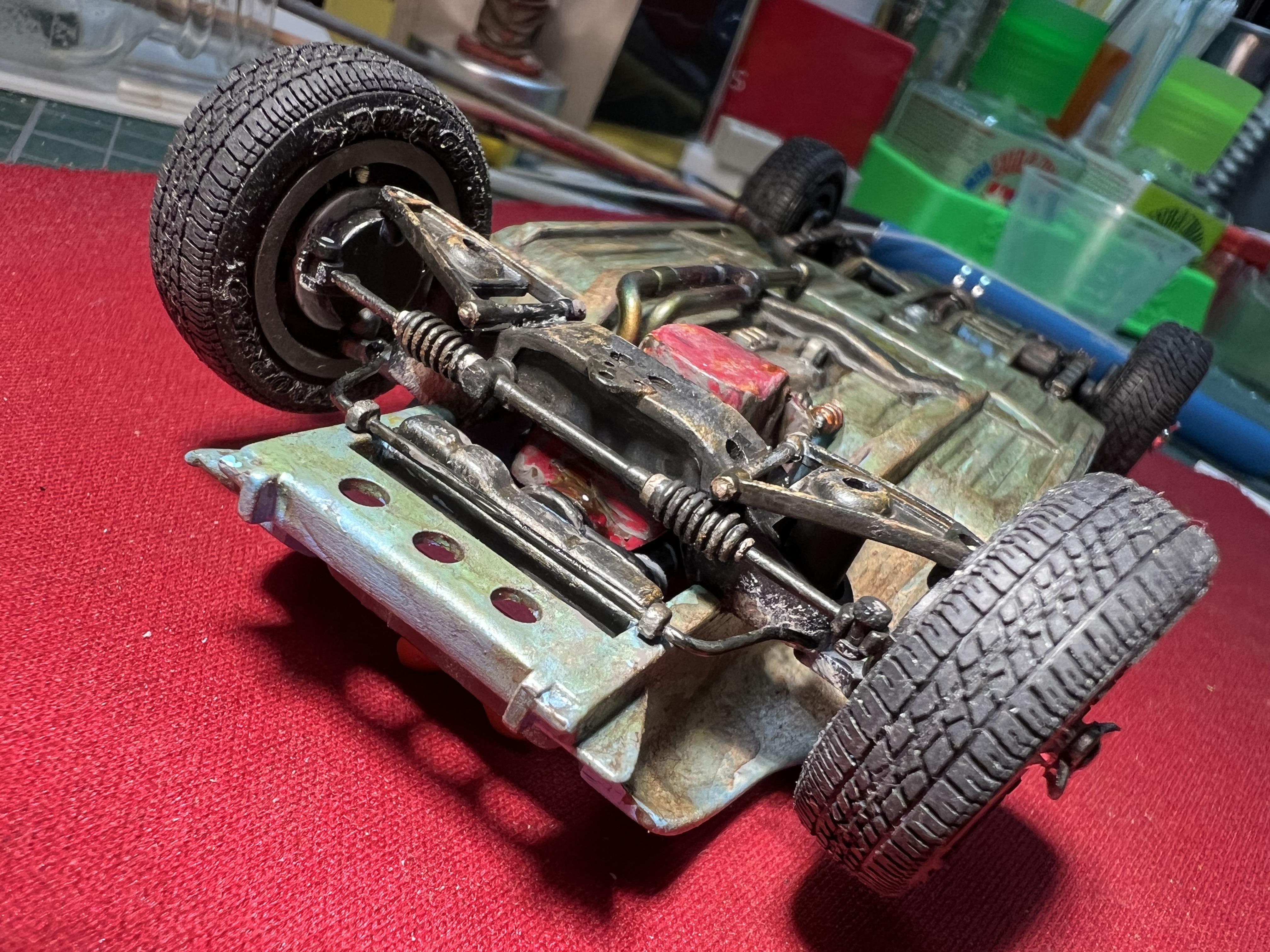

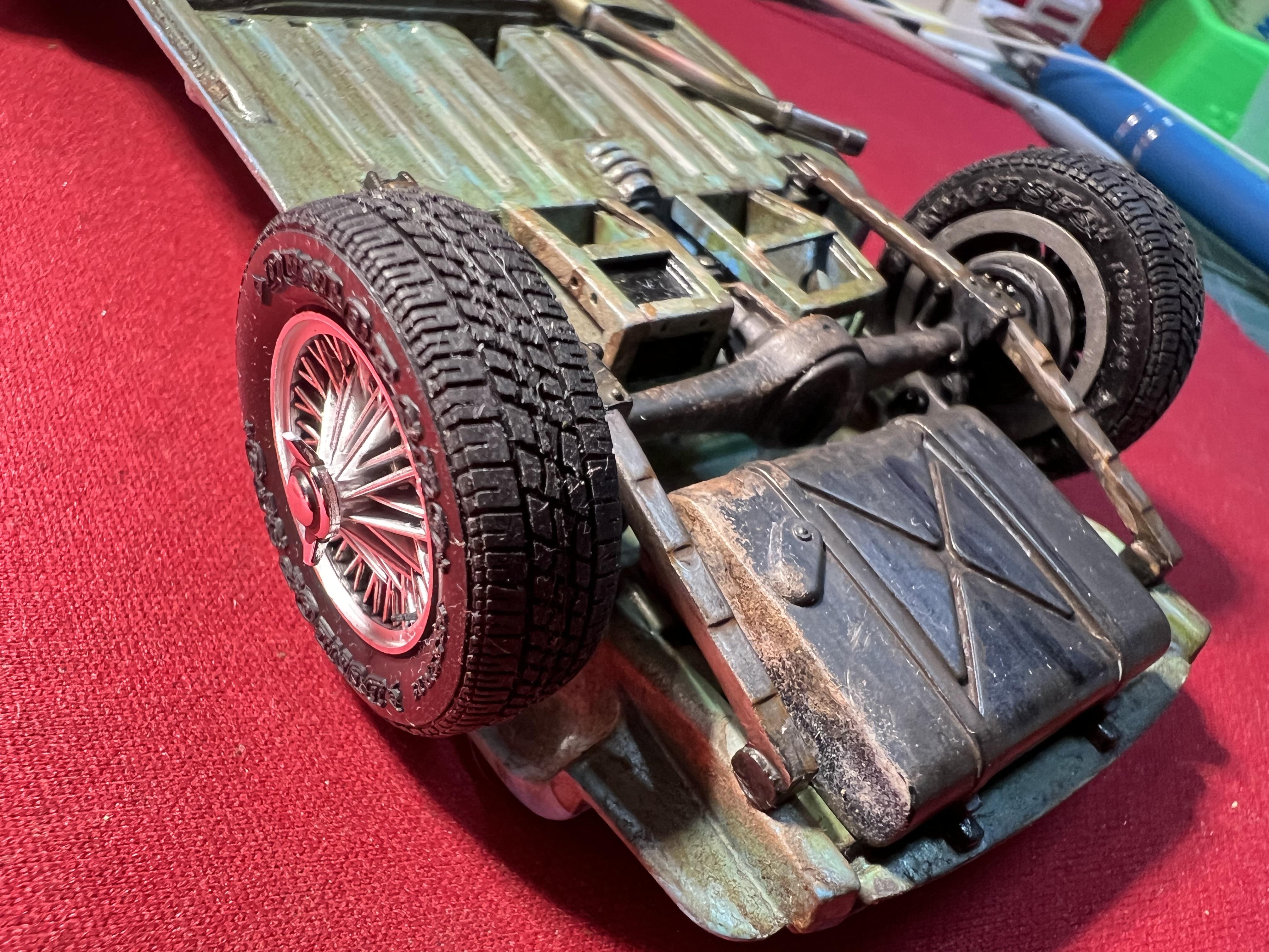

The next job was to apply the final level of weathering on the chassis.  For all the weathering washes and effects I used a variety of Vallejo products. It is a treat to have prepared washes available rather than mixing your own concoctions back when I was building aircraft.

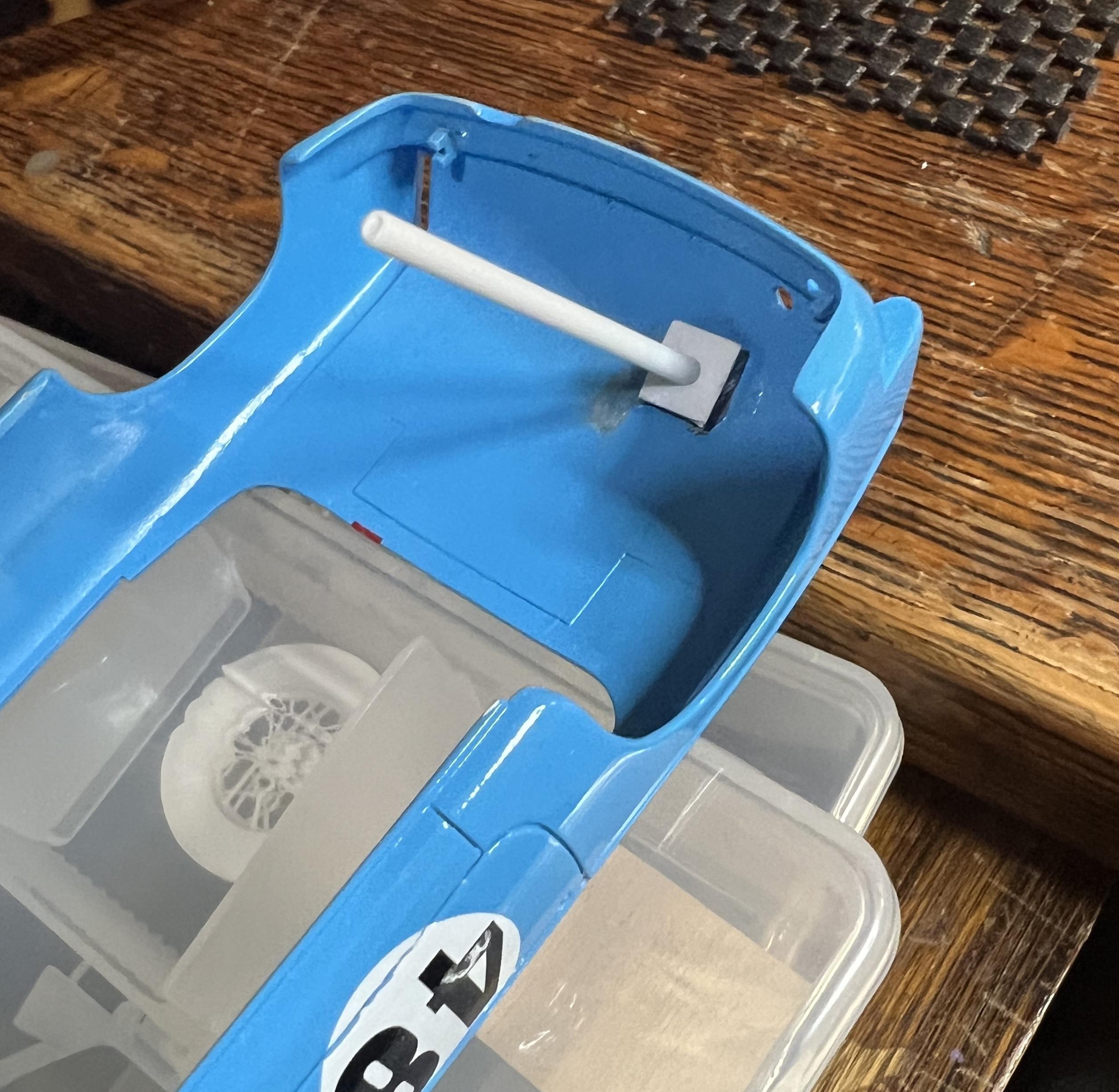

The above photos show the exhaust mocked up for the shots. It still requires the exhaust hangers to be installed once the body is in place. Also completed a couple of detailing parts such as the tail lights, comp-style gas cap, and wipers.
The underside showing the gas cap mounting with the positioning stick untrimmed to length. I neglected to take a photo from above showing the cap in place, it will appear in a future posting.

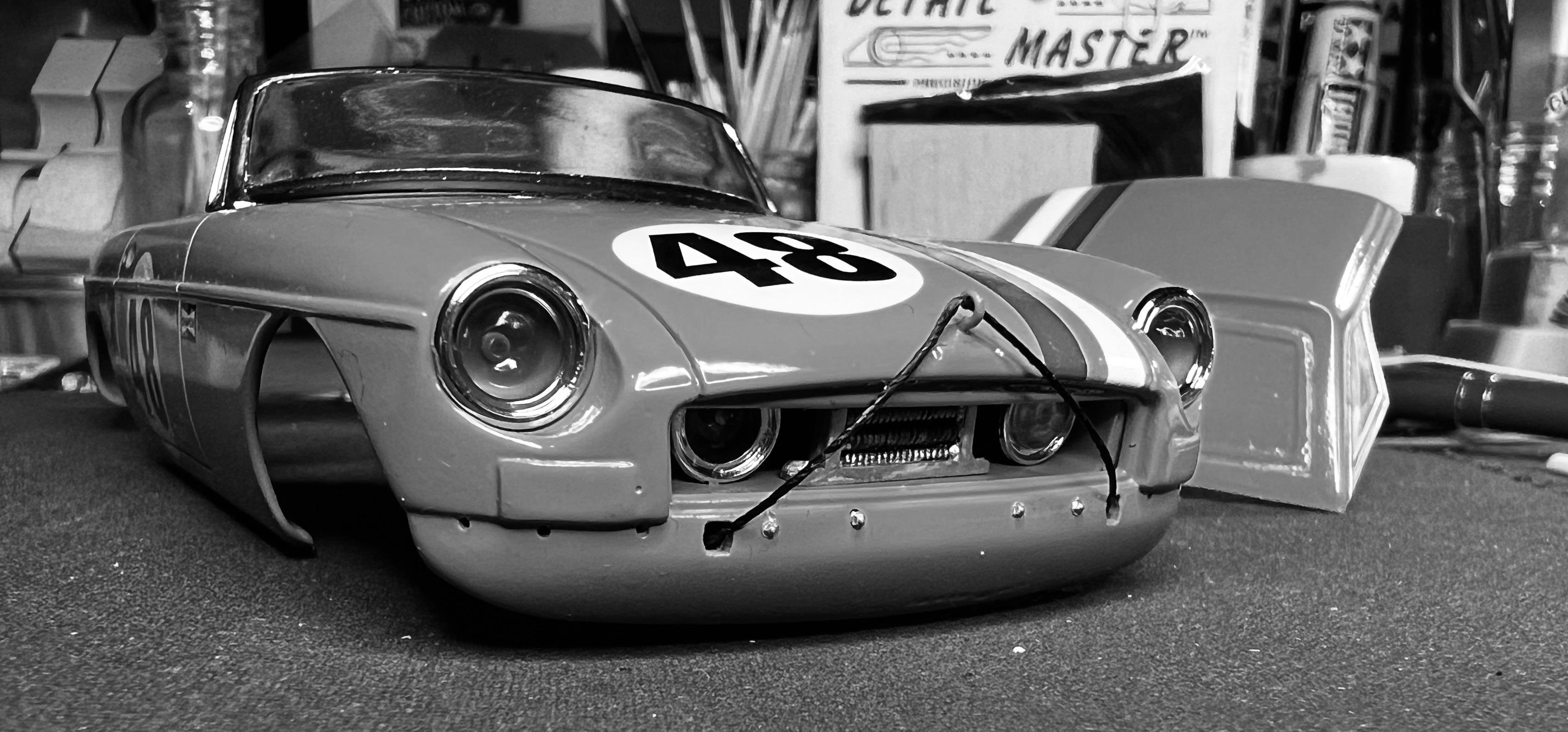

Here are some “vintage” style shots reminiscent of the 1964 Sebring black & white photographs of the time.

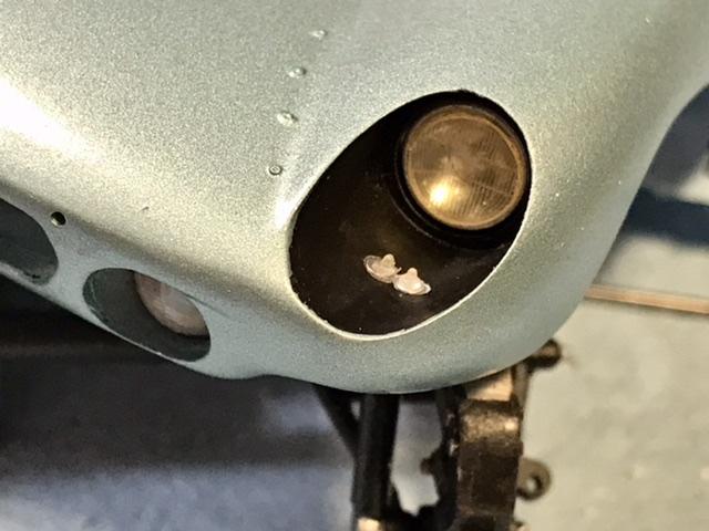

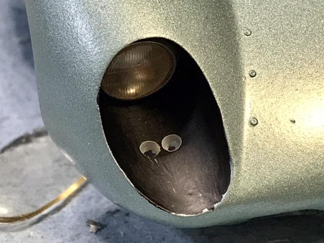

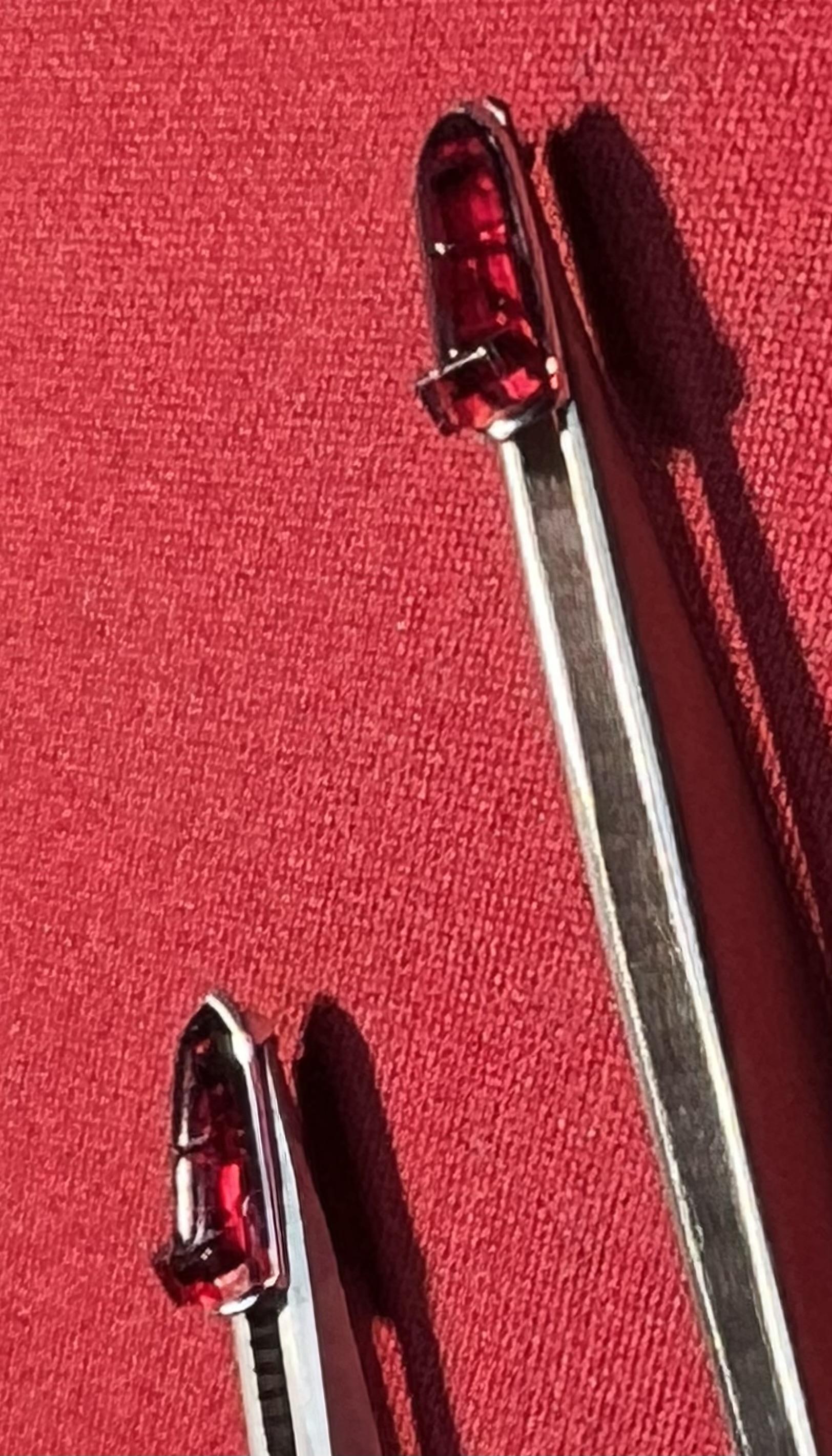

There are 4 tiny clear castings in the clear parts bag - these are  - turn signal ? lights located in the  head light buckets - i glued them onto bezels made fr 1/16th alu tube - well i got 3 out of 4 on - number four leaped off if the workbench into “tiny parts orbit” - fun fun fun -
