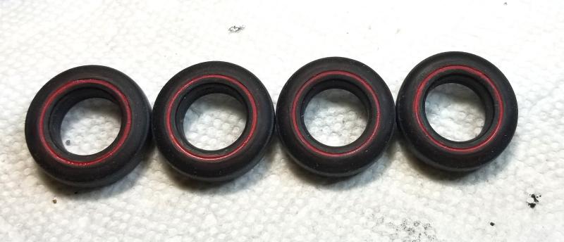

StevenGuthmiller Posted September 3, 2022 Posted September 3, 2022 18 hours ago, TransAmMike said: Still wanna get a few more coats on (already likely 8 to 10 coats to get it red enough) This is why I didn't want to thin the paint when I did them. Depending on the paint, thinning can affect the coverage qualities quite a bit. I preferred fewer coats with a little bit of clean up. Steve
TransAmMike Posted September 3, 2022 Author Posted September 3, 2022 1 hour ago, StevenGuthmiller said: This is why I didn't want to thin the paint when I did them. Depending on the paint, thinning can affect the coverage qualities quite a bit. I preferred fewer coats with a little bit of clean up. Steve Well of course, yours look great. These tires are a different set than the ones you used...not that that makes any difference, just sayin'. I'm sure I would have had a better look with a more glossy paint. As you know craft paints (at least the one I used) dry flat. Now, did you use any sealer coat over the tires?? Don't need the tires to be glossy but need the red to stand out a bit more.
StevenGuthmiller Posted September 3, 2022 Posted September 3, 2022 1 hour ago, TransAmMike said: Well of course, yours look great. These tires are a different set than the ones you used...not that that makes any difference, just sayin'. I'm sure I would have had a better look with a more glossy paint. As you know craft paints (at least the one I used) dry flat. Now, did you use any sealer coat over the tires?? Don't need the tires to be glossy but need the red to stand out a bit more. The flat will be fine as long as it's covering okay. If the tires have any age to them at all, they would look pretty much flat any way. I didn't use any sealer or anything. They came out exactly how I was hoping that they would. The craft paint shouldn't need one either. Once thoroughly dry, it shouldn't go anywhere. Steve
Brutalform Posted September 3, 2022 Posted September 3, 2022 1 hour ago, TransAmMike said: Well of course, yours look great. These tires are a different set than the ones you used...not that that makes any difference, just sayin'. I'm sure I would have had a better look with a more glossy paint. As you know craft paints (at least the one I used) dry flat. Now, did you use any sealer coat over the tires?? Don't need the tires to be glossy but need the red to stand out a bit more. Just as Steve stated, mostly all tire lettering, white walls, red stripes are flat on the 1:1 cars. If I decal, use gel pen, or paint, tires, I usually mist the finished tire with dull cote to take away some of the sheen, if it doesn’t appear flat enough.

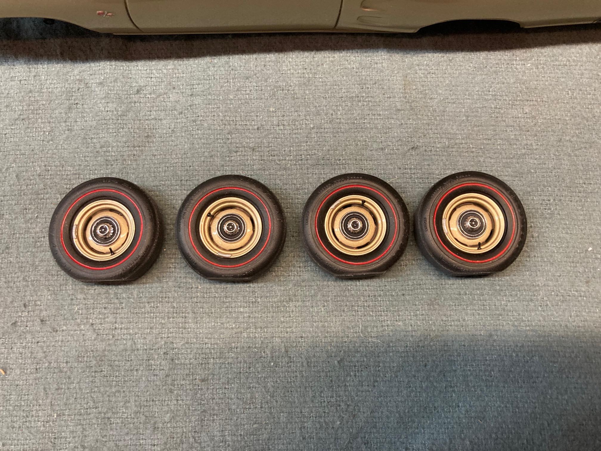

TransAmMike Posted September 8, 2022 Author Posted September 8, 2022 I believe I finally got them presentable. Waterbased white base, MM Chevy engine red acrylic, overcoated, just the red, with dullcoat. 3
Zippi Posted September 8, 2022 Posted September 8, 2022 15 hours ago, TransAmMike said: I believe I finally got them presentable. Waterbased white base, MM Chevy engine red acrylic, overcoated, just the red, with dullcoat. Those tires look pretty good there Buddy. Nice job.
