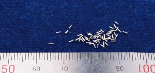

I'm mulling over how to make the riveted panels that actually hold them on. Embossed aluminum tape, maybe.
I would imagine a strip of the tape or chrome foil painted black would serve nicely for the panel and then drill and mount some of the KA Models small rivets.
