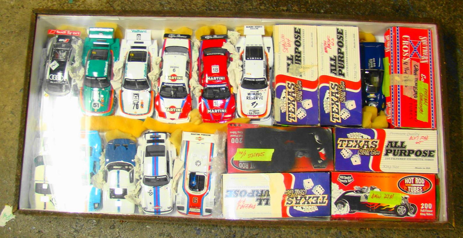

Rich Chernosky Posted November 28, 2022 Posted November 28, 2022 Paul.. every year in May I do a model show at the Watkins Glen Motor Racing Research Center. I have 6 custom made display cases (only take 4) and usually take about 60 models of various scales. Below are two of the three cases I took last year. You can see how they are packed. Those empty cigarette paper boxes hold the more delicate cars. I use latex foam and crushed up paper towel to seperate them. I take tools and glue to repair any thing plus some small zip loc baggies to store parts that fall off. I suffer very few casualties from the 35mi one way trip. I take these pictures of the cases loaded so after the show I can pack them back the same way. Its very effective and I have been doing it this way for close to 20yrs now. Hope this helps.
