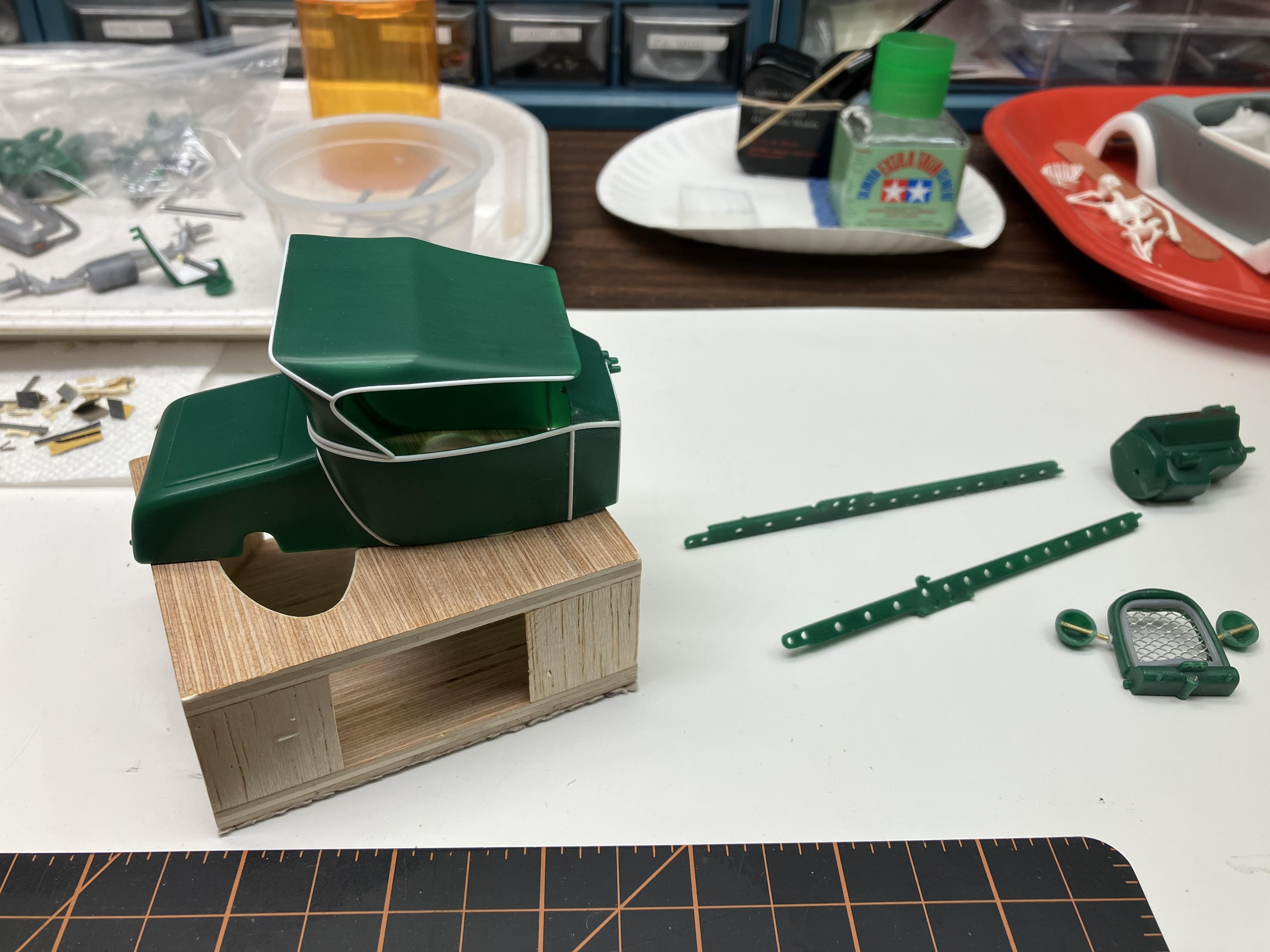

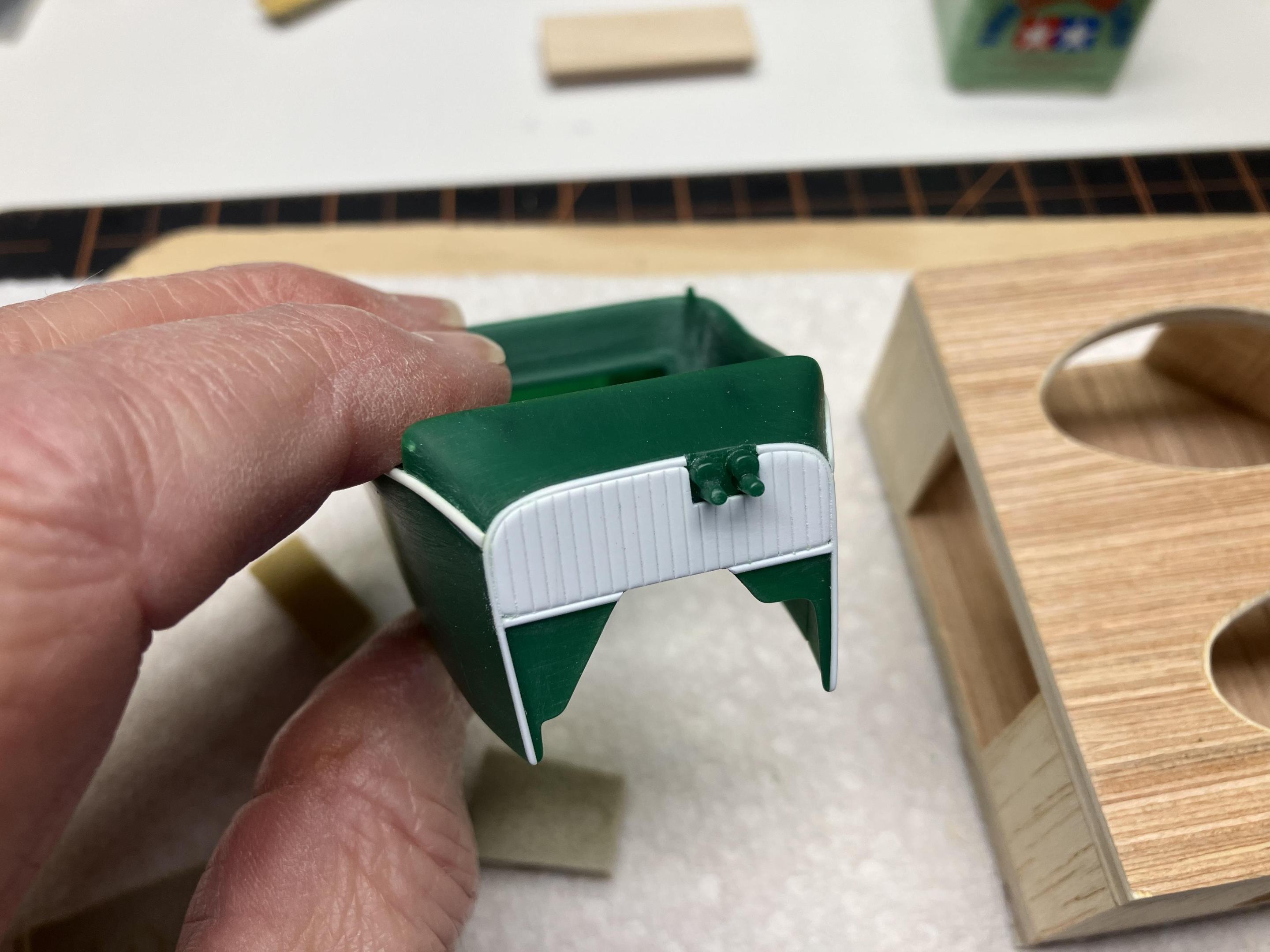

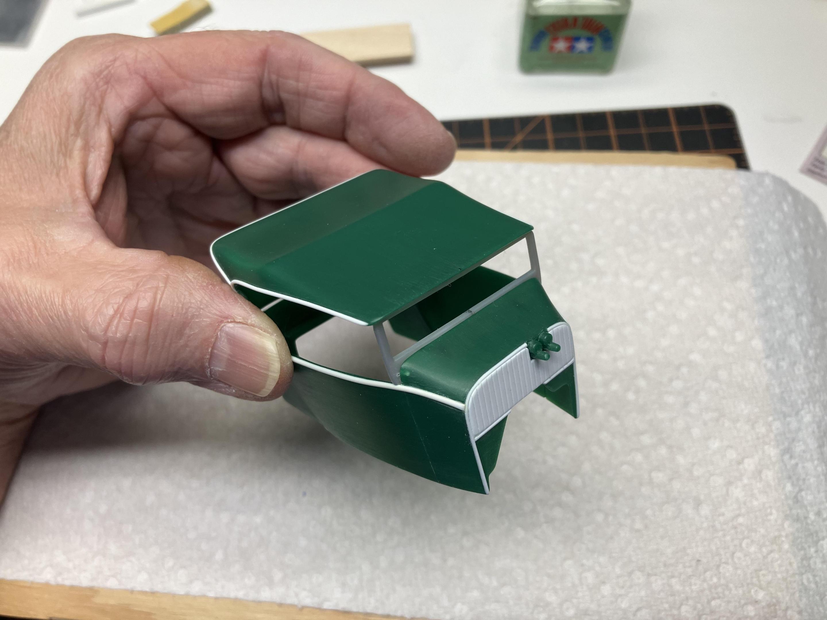

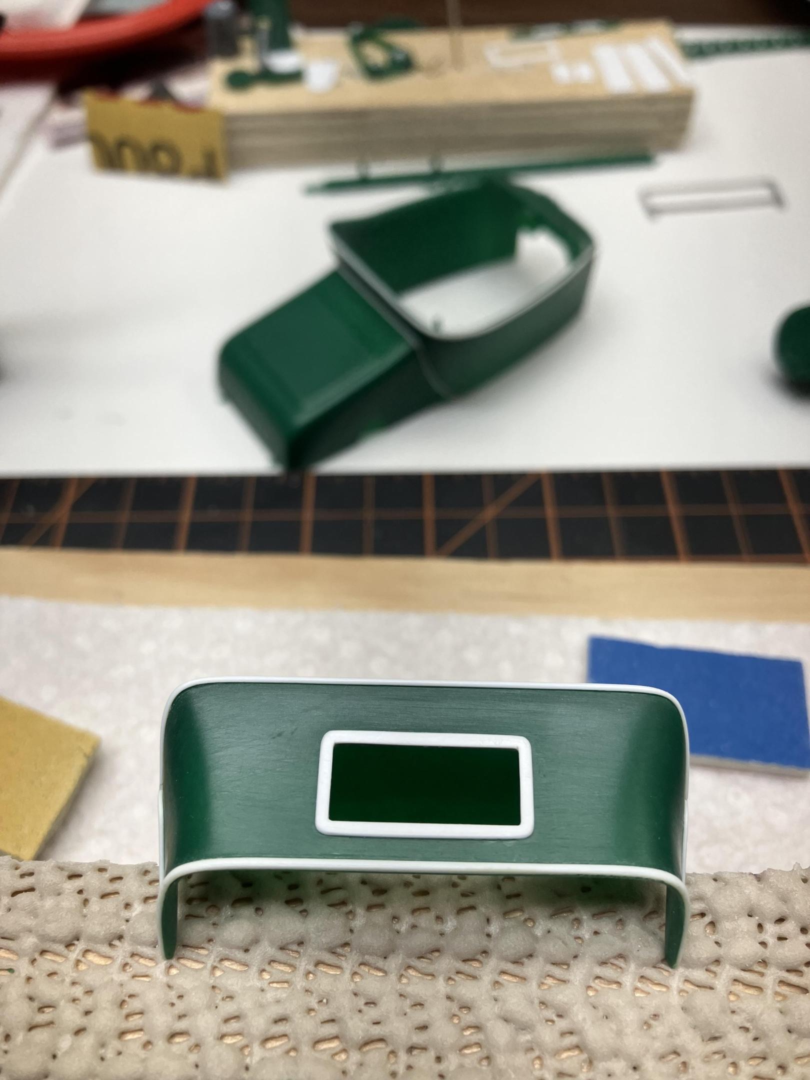

Joe Nunes Posted January 25, 2023 Author Share Posted January 25, 2023 (edited) A bit more fun at the model bench today. Added the rear window surround to the outside of the top and the firewall padding to the body. Joe Edited January 25, 2023 by Joe Nunes 3 Quote Link to comment Share on other sites More sharing options...
Joe Nunes Posted January 27, 2023 Author Share Posted January 27, 2023 Today I put some paint on a few parts so that is a start in the right direction. Decided not to glue the inside rear window surround to the top as it looked too clunky when I looked at it. Sanded the outside window surround flatter and now it looks better. Am gluing the knobs to the dashboard and getting it ready for primer. Will be spraying white primer on the top piece, the dashboard, and the inside of the body. After the top dries it will get a spray of Testors Dull Cote; nothing fancy while staying with the original model idea somewhat though it should end up simulating an off-white convertible top. And onwards we go...😉 Joe Quote Link to comment Share on other sites More sharing options...

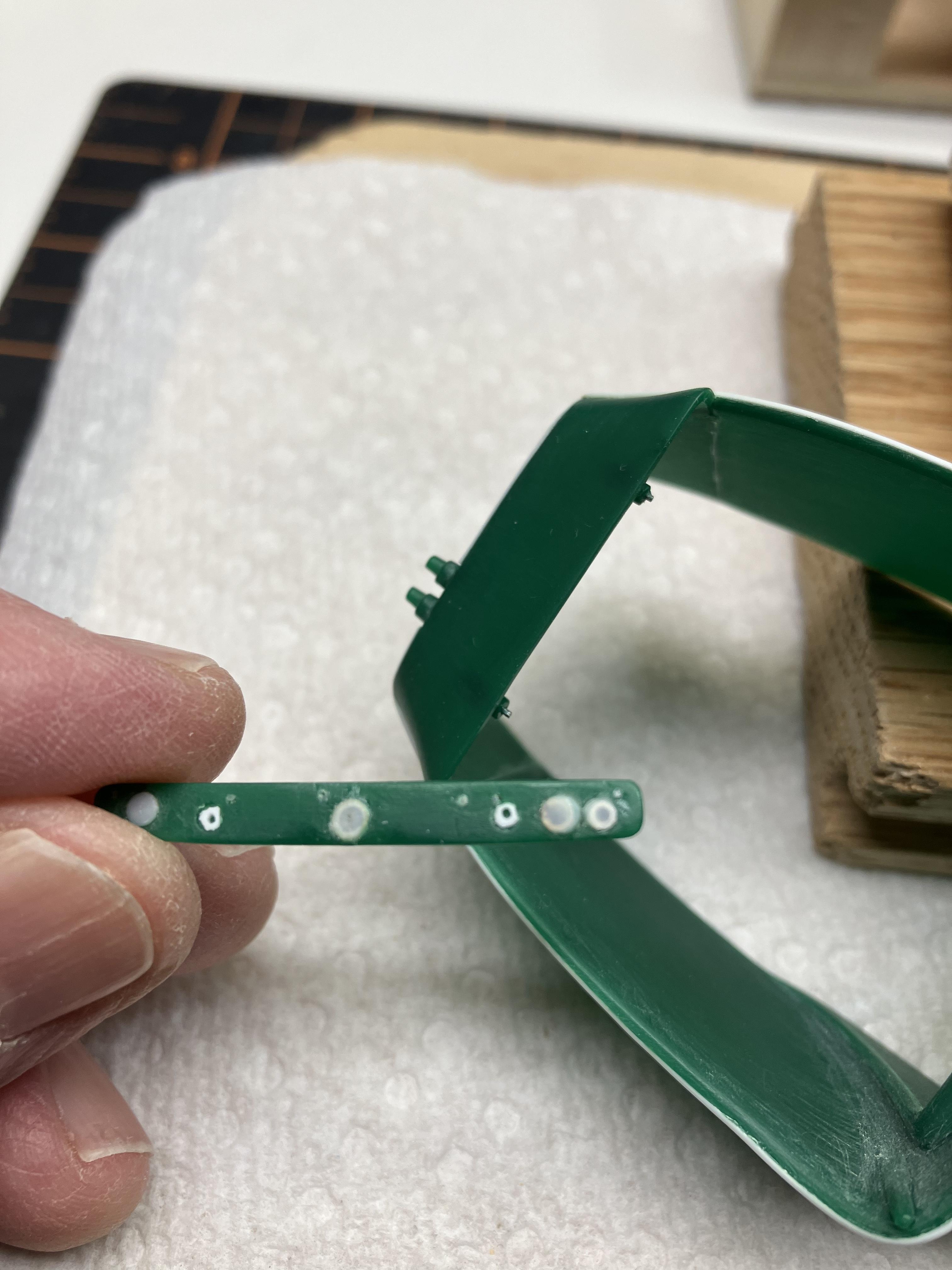

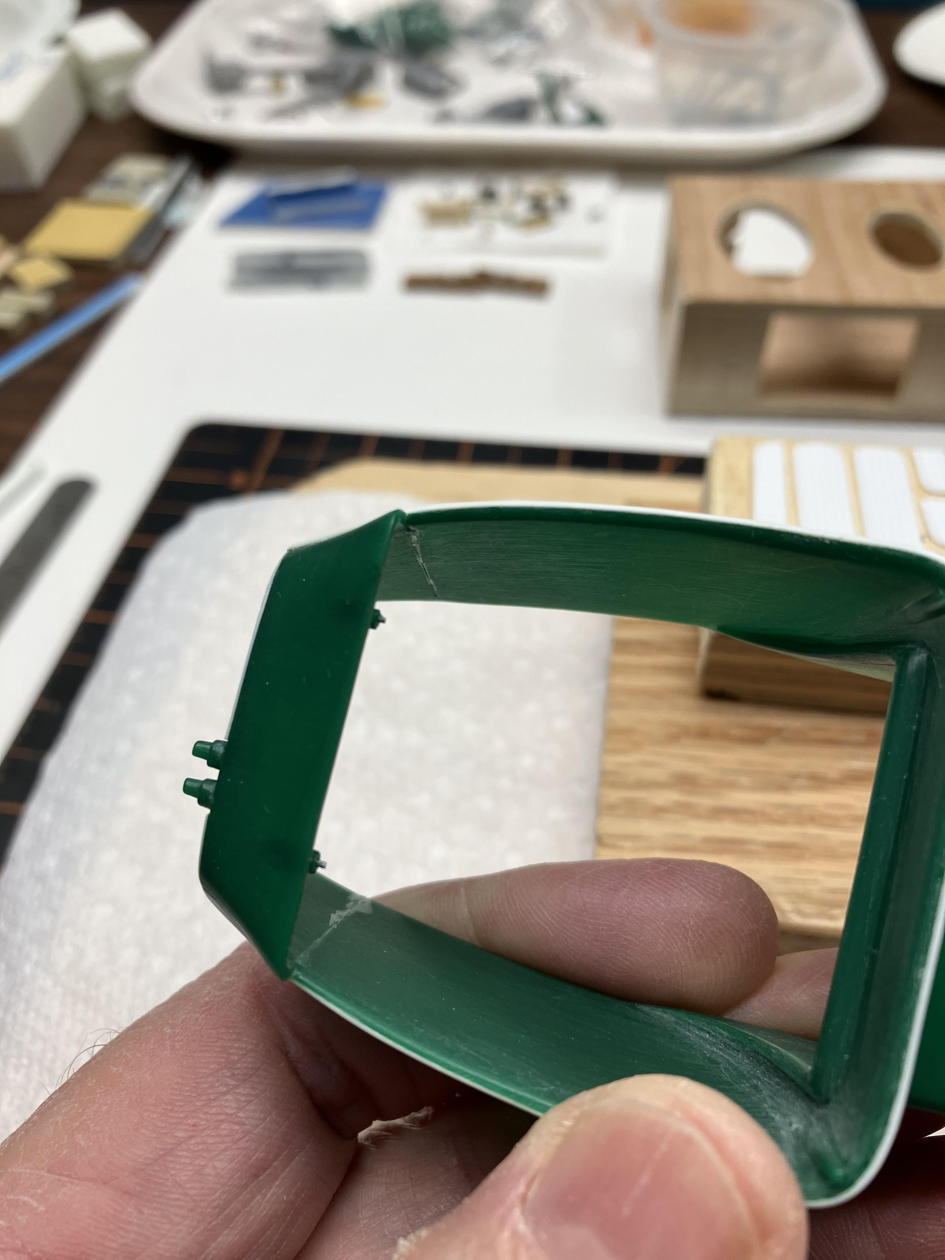

Joe Nunes Posted January 30, 2023 Author Share Posted January 30, 2023 Added the two outside welt pieces to the side body at the cowl/body junction. The dashboard is now about as ready for paint as it is going to be, and I added location pins to the inside of the cowl for the dashboard. The front window glass was in a badly scratched condition out of the kit box so I am getting the “glass” scratch marks cleaned up with fine grit sanding pads. Also, I decided to model the front window glass in an open position just for the fun of it. 😁 Joe 3 Quote Link to comment Share on other sites More sharing options...

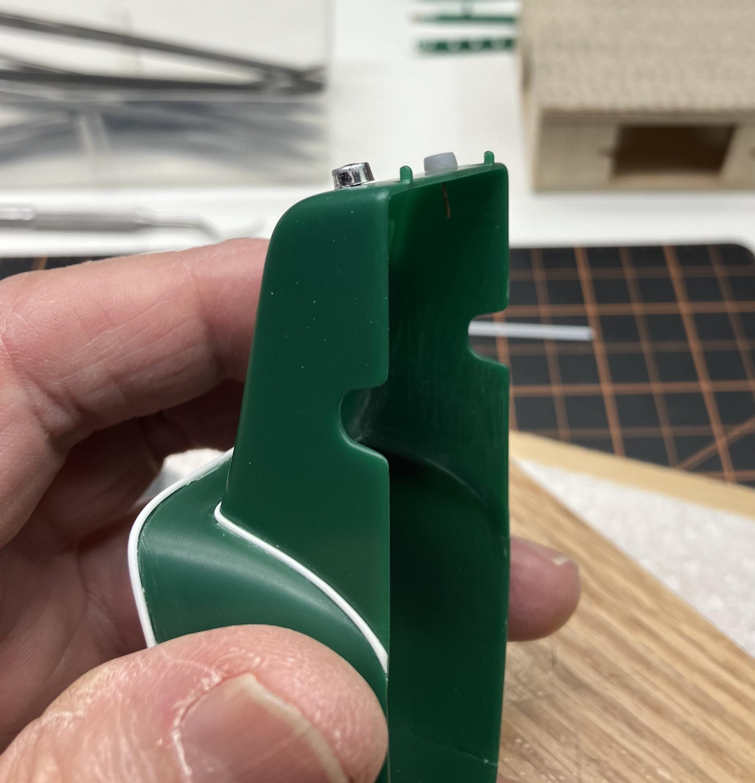

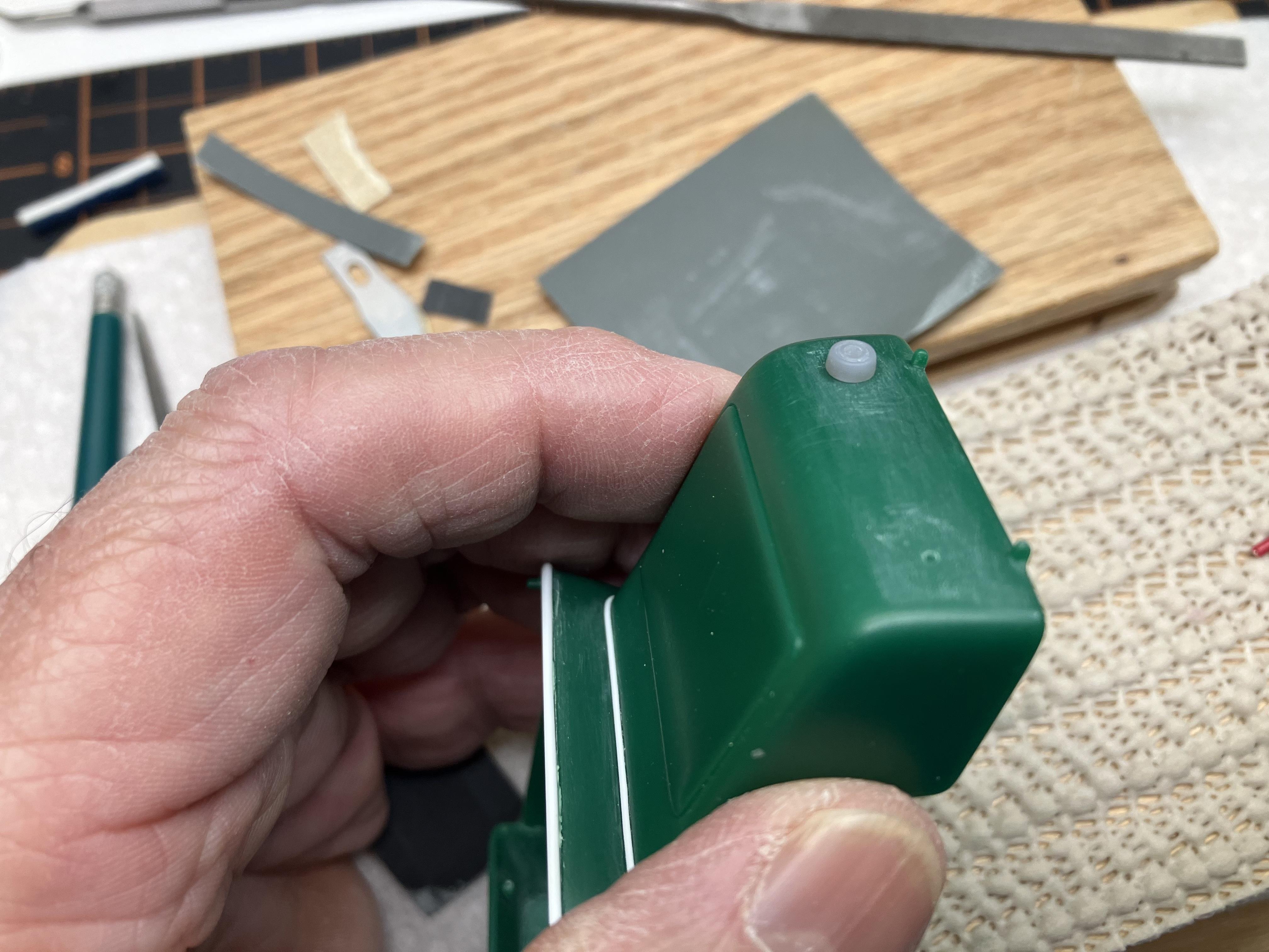

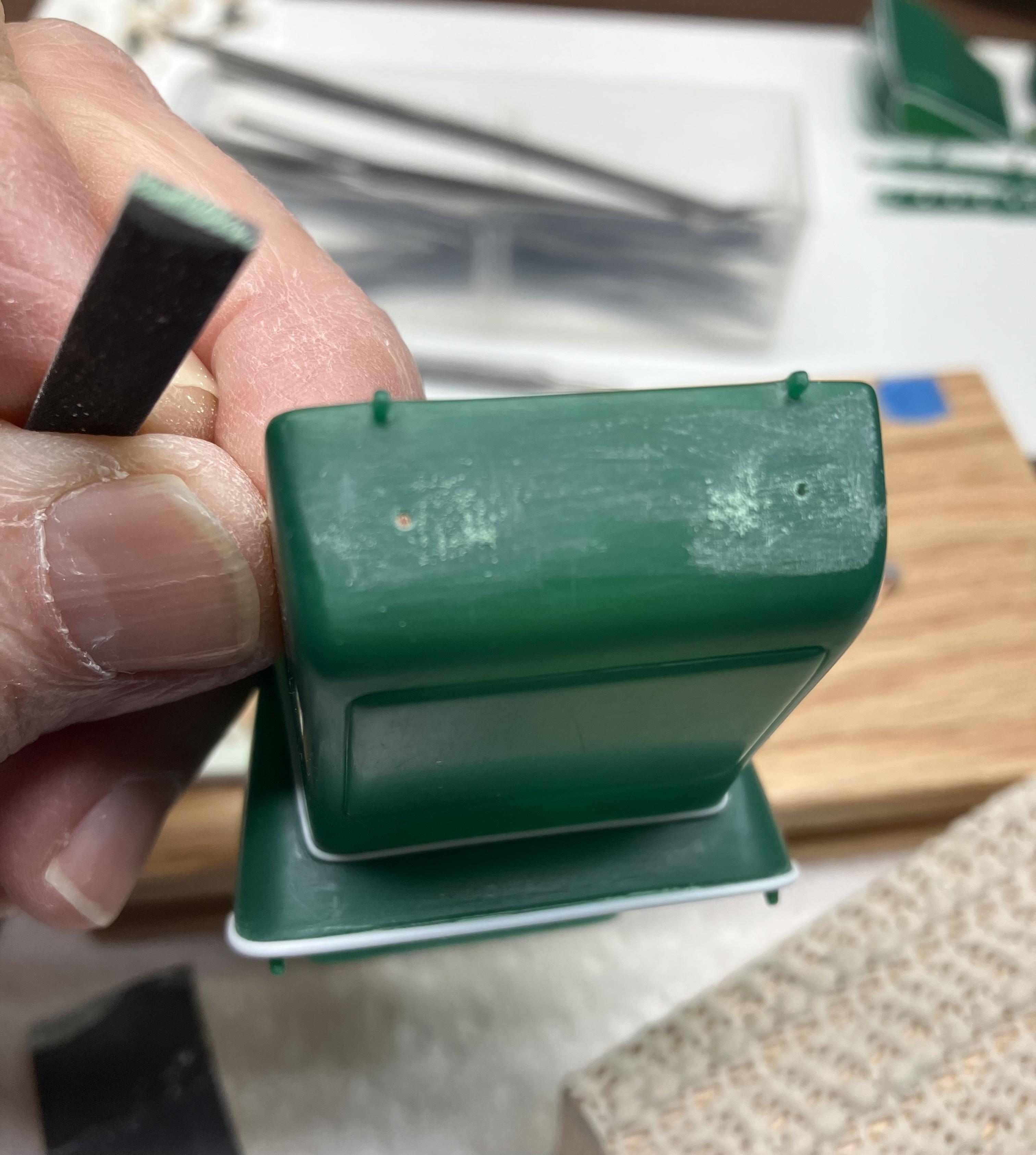

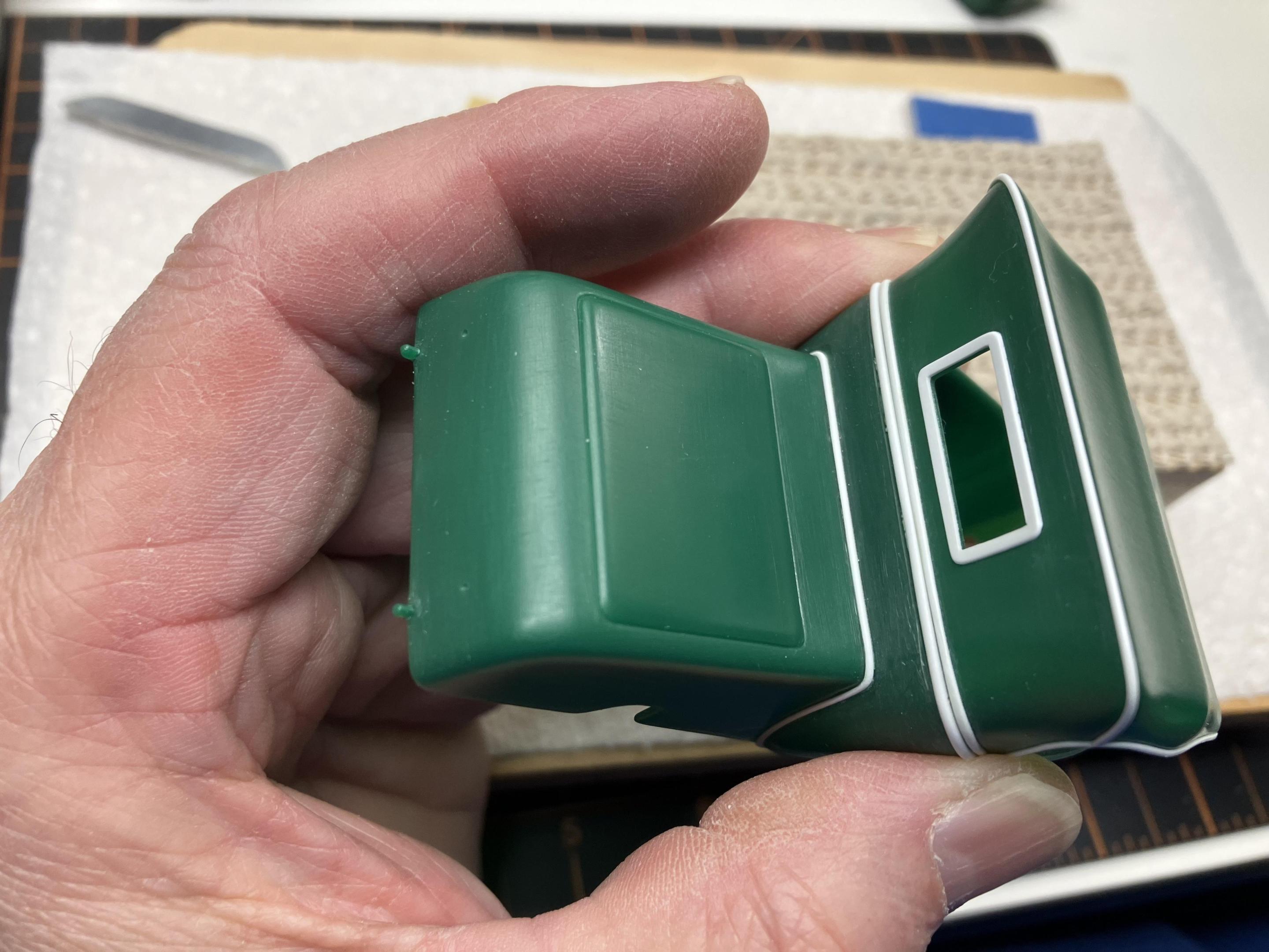

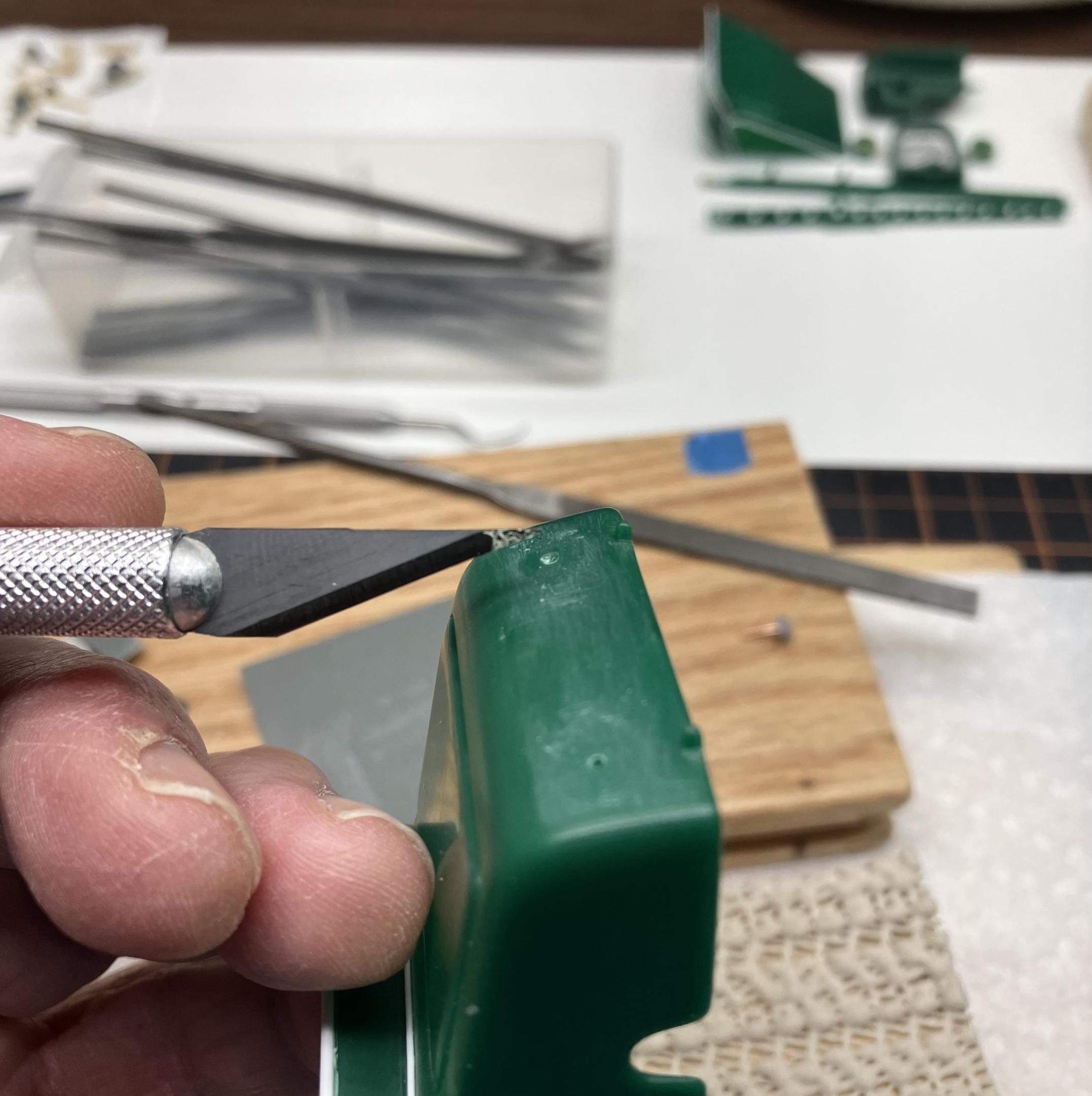

Joe Nunes Posted February 6, 2023 Author Share Posted February 6, 2023 The tail light area on my kit part had a slightly rounded surface running vertical. This keeps the tail lights from sitting flush on the body surface, which I thought left an unsightly gap around each tail light. I could foresee the glue wanting to ooze out when the lights were put in place. Also, I wasn’t pleased with my previous work on the tail lights so I made the decision to redo the lights. First, I carefully removed the clear red paint and the blue sequin dot from the light using dental tools and the like. This allowed me to open up the area in which the clear red paint will again be applied. The light was sanded smooth and I took the opportunity to drop the height of the tail light so it would not stand so proud off the body; I think this looks better to my eyes. Second, I made up a couple of wire pins for the lights to help keep the lights on the body during the work. Then the mounting holes were drilled through the body to match the wire pins. Thirdly, various metal hobby files, a #11 blade, and various sandpaper grits were used to flatten the surface where each light will be mounted. Each light location was outlined with a graphite pencil lead so I could keep the work localized to each tail light. Finally, some careful sanding should remove the work scratches and get the body cleaned up again. I am pleased with the results. A fiddly little thing perhaps, however, now I feel better having made the change. Joe 2 Quote Link to comment Share on other sites More sharing options...

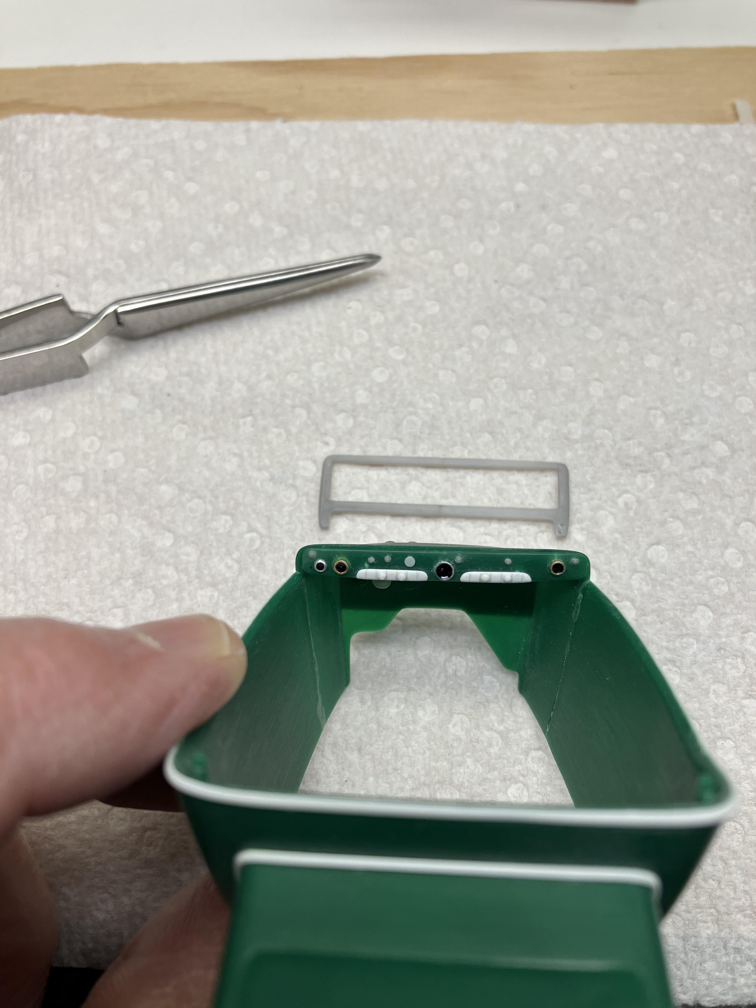

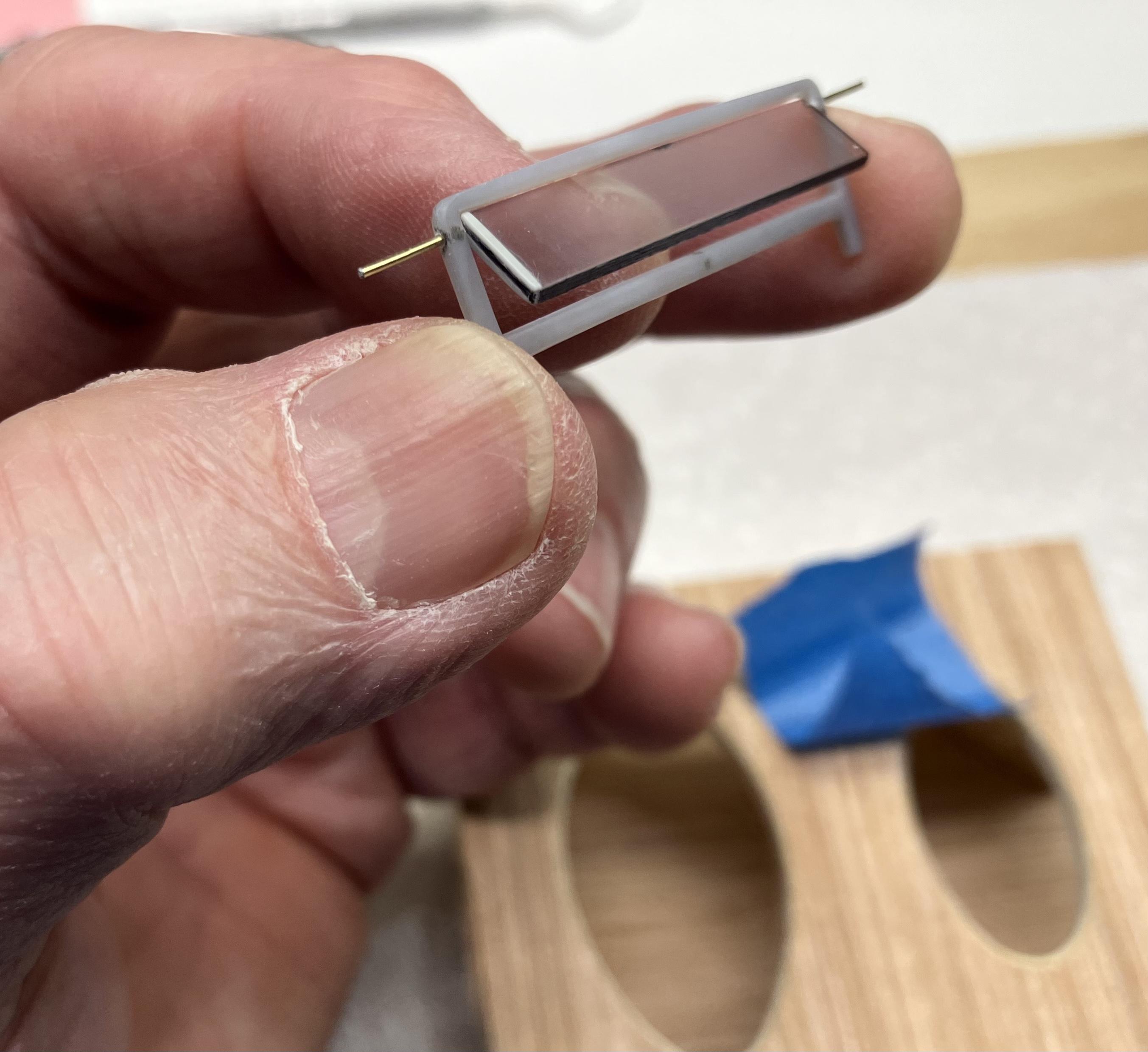

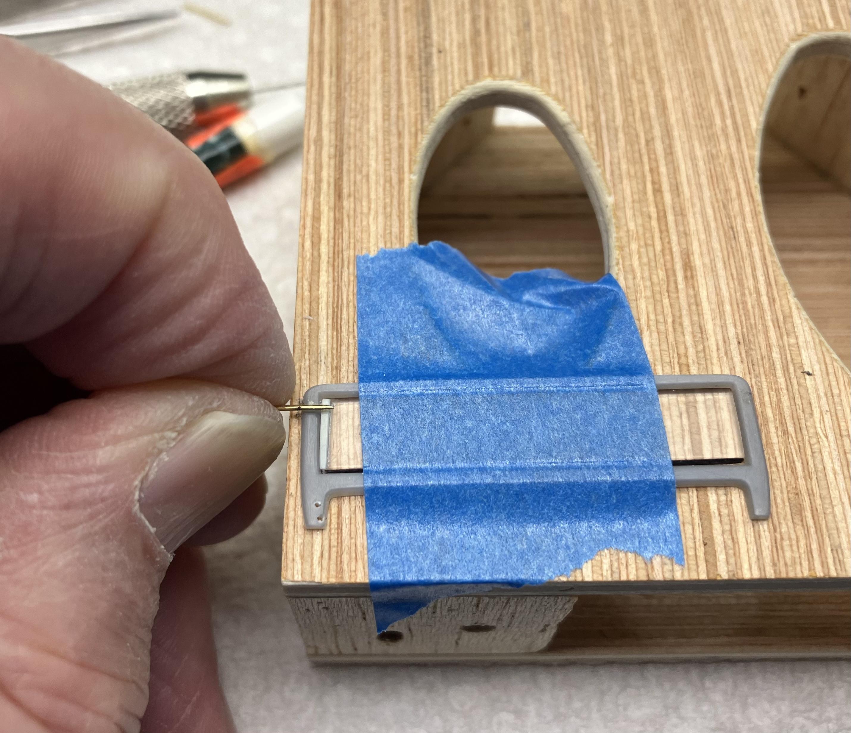

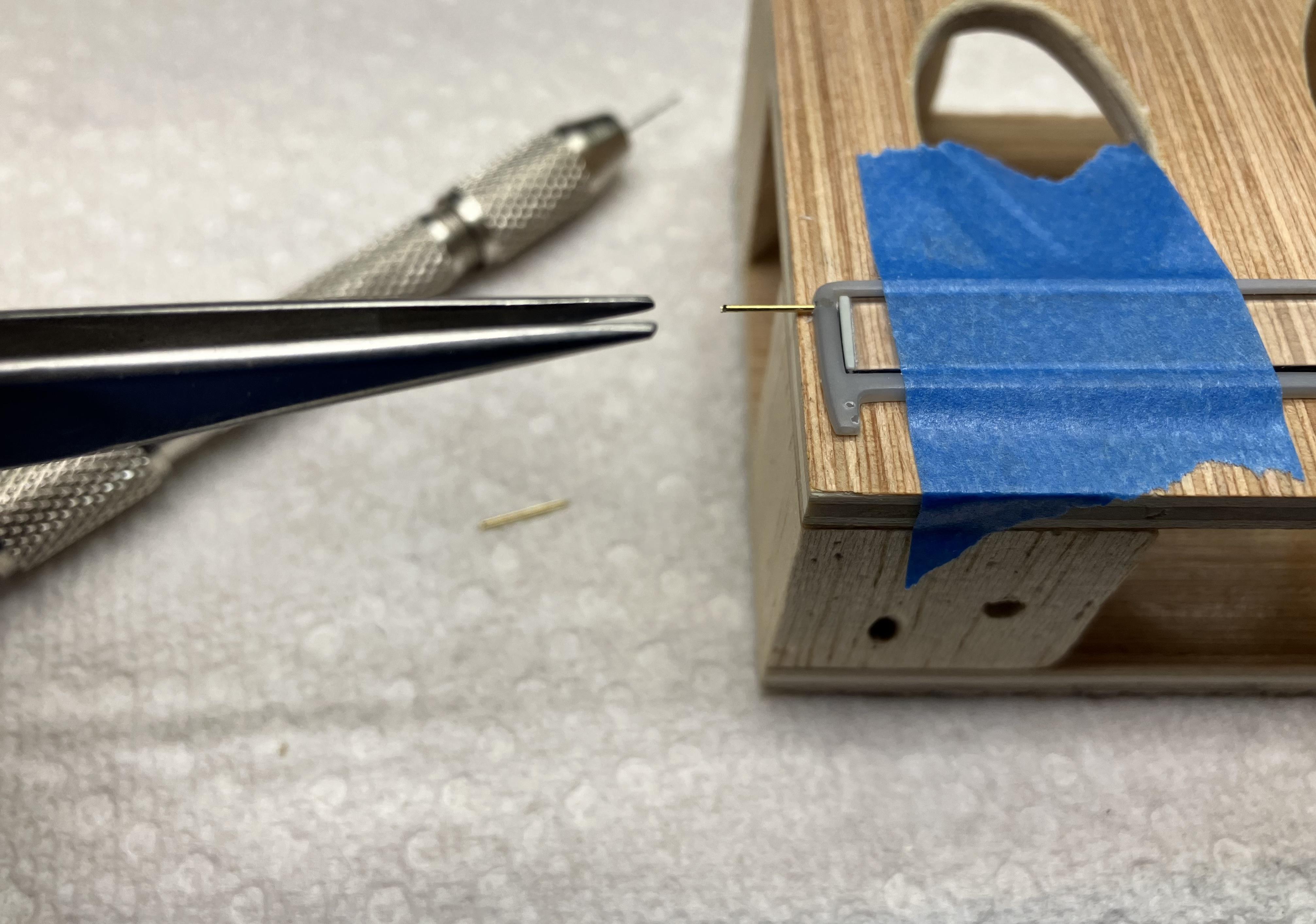

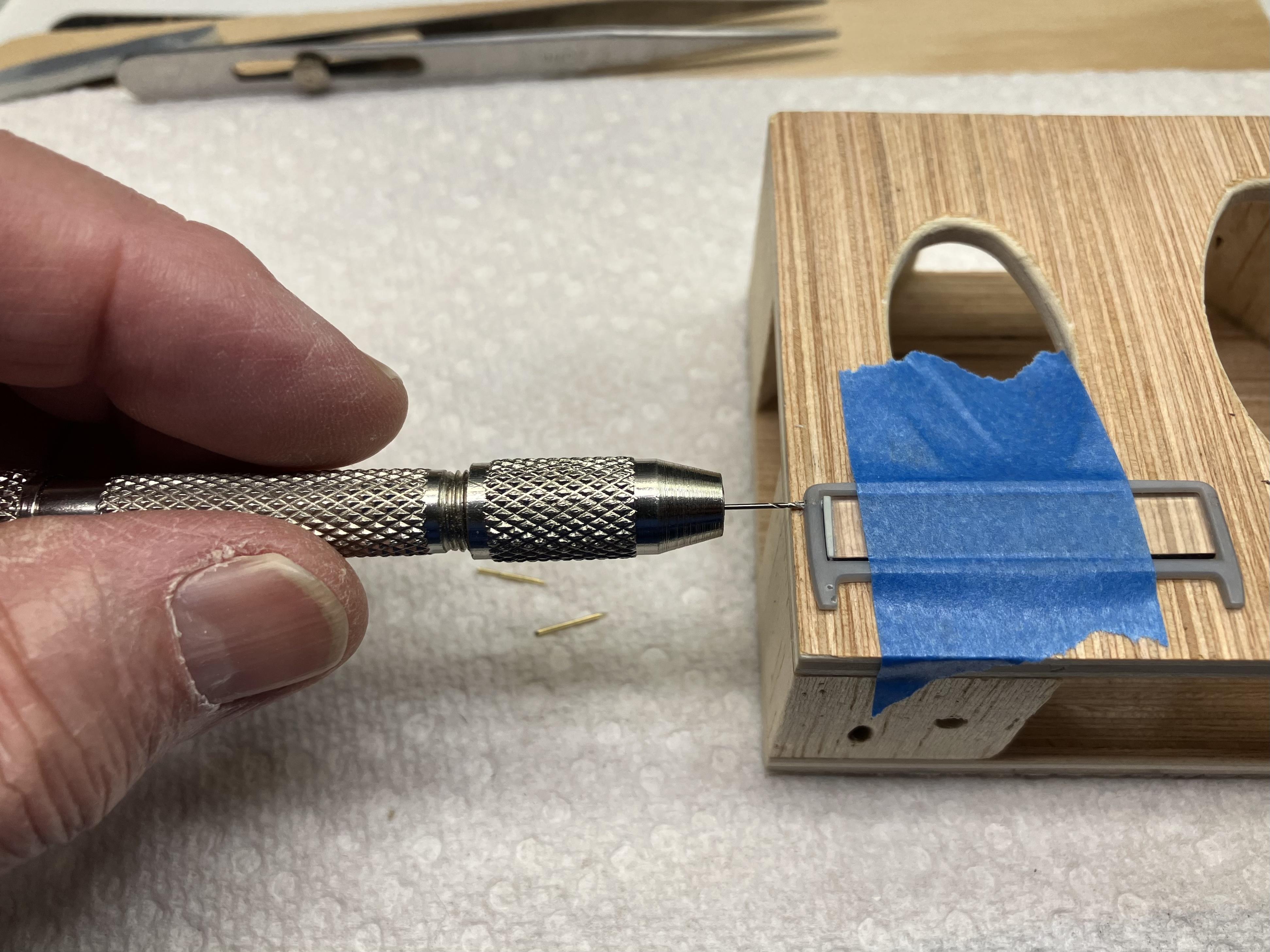

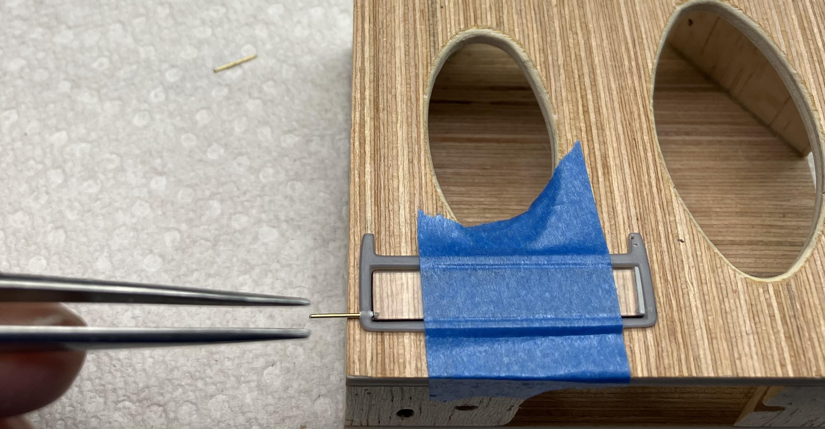

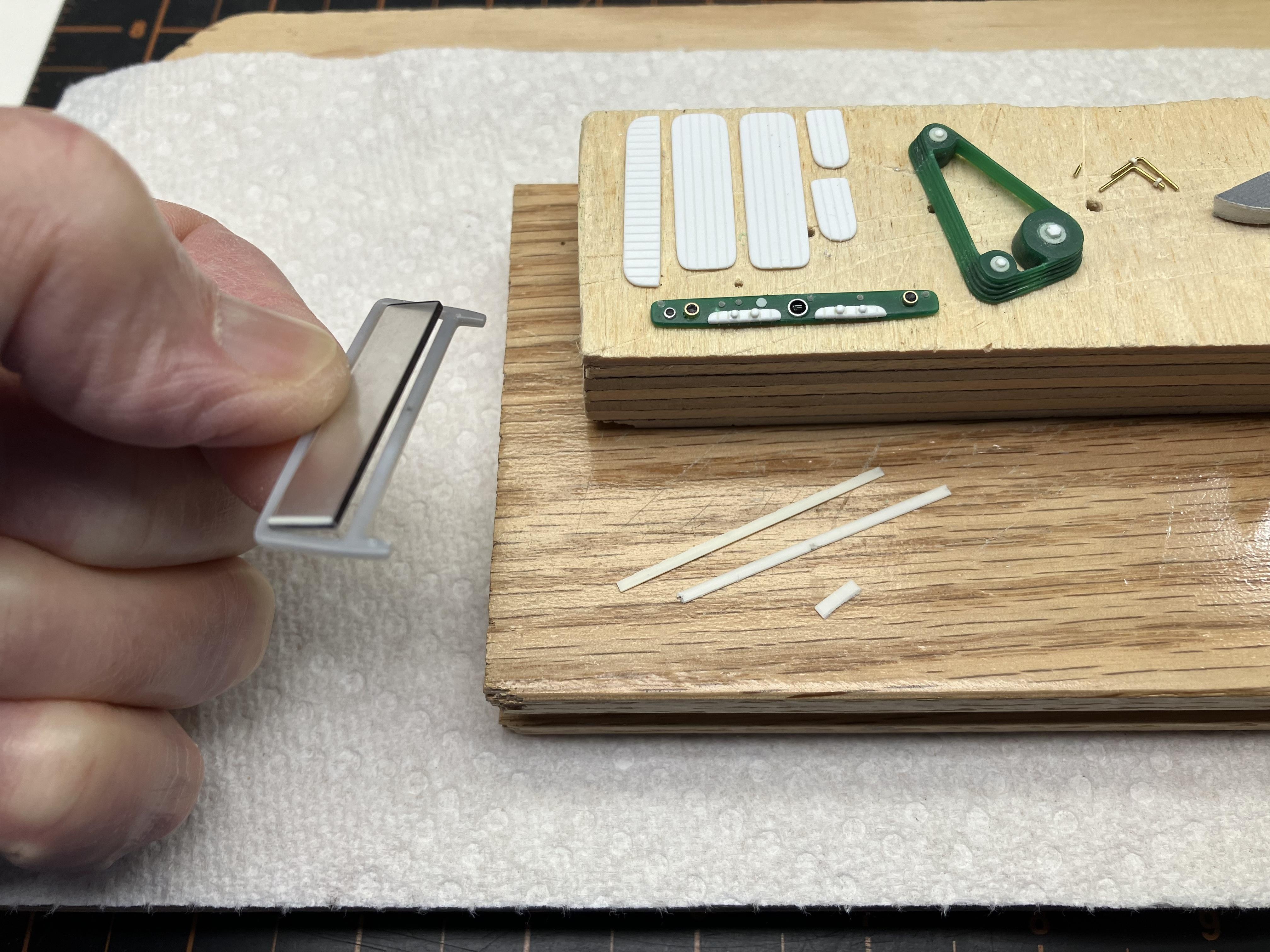

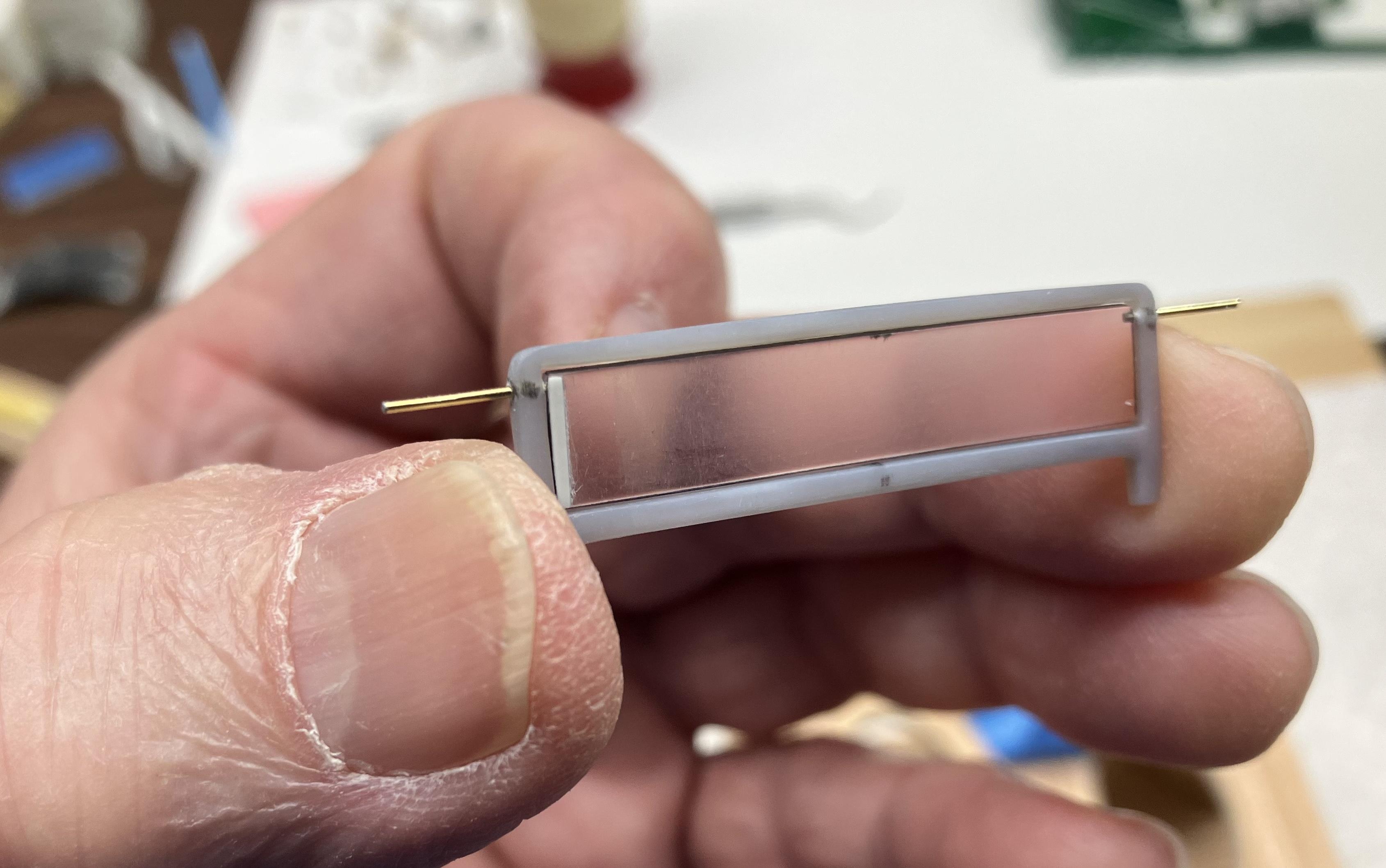

Joe Nunes Posted February 7, 2023 Author Share Posted February 7, 2023 This afternoon I worked on the front window a bit. Decided to pin the “glass” before finishing the glass cleanup, glass surround and windshield frame. Now I have an opening front window that I can pose open or closed as desired. So, onward we go as I continue avoiding paint time! 😂😁😉 Joe 4 Quote Link to comment Share on other sites More sharing options...

TooOld Posted February 8, 2023 Share Posted February 8, 2023 Well now that's just about the neatest windshield mod I've ever seen , definitely going to be one nice Green Hornet ! 1 1 Quote Link to comment Share on other sites More sharing options...

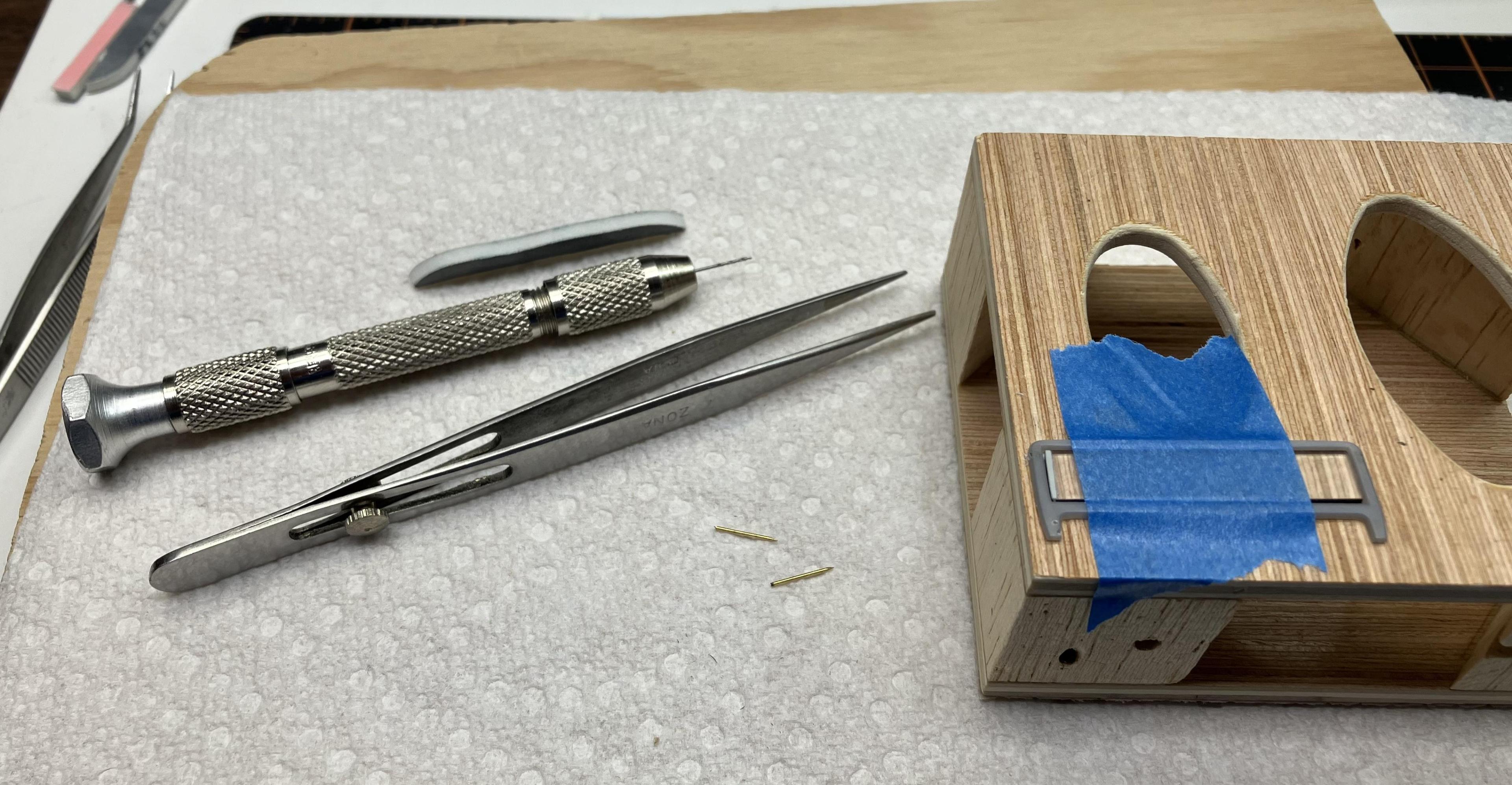

customline Posted February 16, 2023 Share Posted February 16, 2023 Real nice work on the windshield, Joe. Thought about it but ......no stones 😔. BTW, where'd you get those adjustable tweezers? They're awesome 😮I 1 Quote Link to comment Share on other sites More sharing options...
customline Posted February 17, 2023 Share Posted February 17, 2023 I didn't see this build until today so went straight to page 4, made a comment and decided to read from page 1. And I saw this: On 11/10/2022 at 11:43 PM, Joe Nunes said: After looking at more of the absolutely fantastic builds displayed by model makers who know what they are doing, and then coming back here and looking at what I put on the forum as a WIP, I can only say I am embarrassed that the build thread was started. Joe Joe, you've seen my stuff and I have enjoyed your input on my threads. You should not feel embarrassed, especially after looking at my stuff. You are meticulous, methodical, and inventive and this is quite obvious. You are an example for all of us. Keep doing what you are doing because you are definitely doing it right. 👌 1 1 Quote Link to comment Share on other sites More sharing options...
Joe Nunes Posted February 17, 2023 Author Share Posted February 17, 2023 (edited) Jim, thank you for the vote of confidence; you are much too kind! As for the tweezers, I bought those quite some time ago when I was building RC model aircraft and do not recall where I got them. They are perfect for holding/changing small strips of sandpaper while working on a model project. Joe Edit: The tweezers are a ZONA 7. Edited February 17, 2023 by Joe Nunes Adding information Quote Link to comment Share on other sites More sharing options...
customline Posted February 17, 2023 Share Posted February 17, 2023 Found 'em ! Excell makes them. It looks like a very handy tool, Joe. I live and die by my tweezers. And, of course, my Excell Magni-visor. Without these things, nothing would be possible 😶. 🙂 1 Quote Link to comment Share on other sites More sharing options...
Joe Nunes Posted February 17, 2023 Author Share Posted February 17, 2023 33 minutes ago, customline said: Found 'em ! Excell makes them. It looks like a very handy tool, Joe. I live and die by my tweezers. And, of course, my Excell Magni-visor. Without these things, nothing would be possible 😶. 🙂 Added information to my above post: found the tweezers to be ZONA 7. Glad to see you found some of similar style as they are definitely useful. 👌 Joe Quote Link to comment Share on other sites More sharing options...
