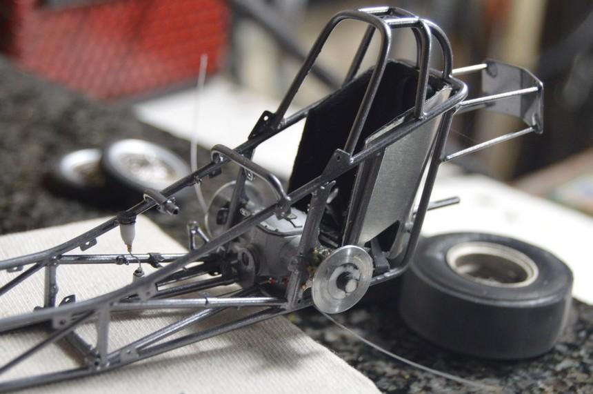

Straightliner59 Posted March 13, 2023 Author Posted March 13, 2023 10 hours ago, Ian McLaren said: Great work, it's coming along nicely. Thanks, Ian. I got the third member installed, today! There are a couple of little things to do, before I install the axle stub ends, but, this is almost done! I made the nuts for the rear end mounts on the lathe, with .040" hex stock and painted them with Testors MM Jet Exhaust. I've since trimmed off the excess length of the bolts. I'll work my way out of the cockpit, installing cables and wiring, as I go. I think I have decided on a color combo, as well! As always...and, thanks for looking! 3

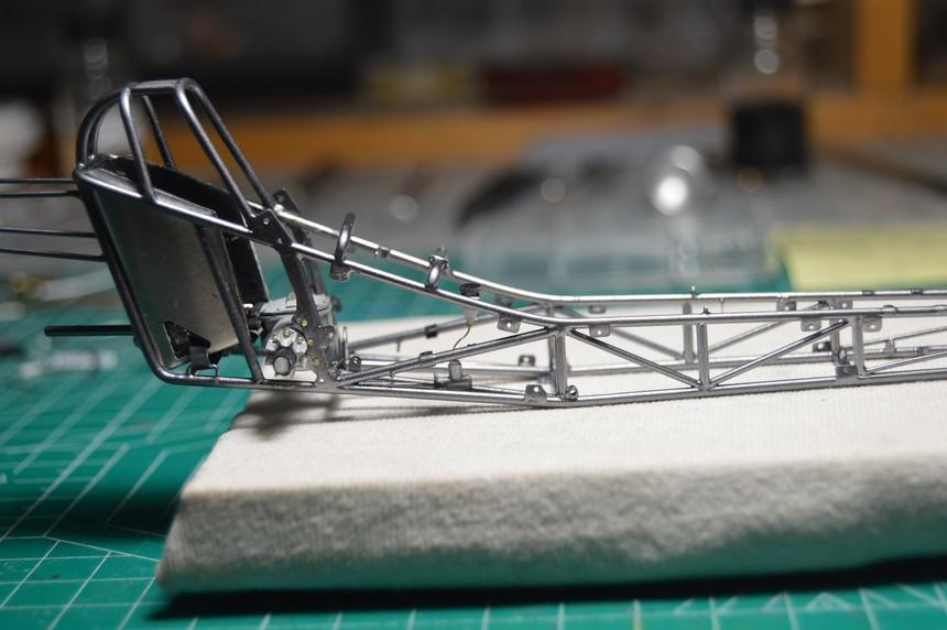

Straightliner59 Posted March 14, 2023 Author Posted March 14, 2023 Rear axle is installed, completely. I painted the spindles, so I could stand it back on its wheels. I may just go ahead and finish off the installation of the steering at the front axle, before doing the brakes. This is exciting! Thanks for looking! 2

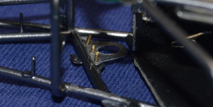

Straightliner59 Posted March 16, 2023 Author Posted March 16, 2023 6 hours ago, Straightliner59 said: I'm really beginning to think this will see the light of day! Had this been virtually any other time in my modeling "career", those likely would have been famous last words. While I was installing the tie rod, I somehow managed to snap the right side spindle eye from the axle. That would have put it back on the shelf, in earlier times. This time, I cut a new eye, cleaned up the axle end and sanded off some of the paint, in order to create clean contact point for the electrodes. I then soldered the new eye on, cleaned up the axle again, and re-shot that corner of the chassis. I used kitchen plastic wrap to mask the tie rod, and the rest of the chassis, behind the axle. It worked well, because it clings without sticking. Within a couple of hours, I was repaired, and had the tie rod installed! I'd like to say it was fun, but...? I am happy with myself, for getting it fixed,, and not pushing it aside. Questions, comments and critiques are welcome. Thanks for looking! 4

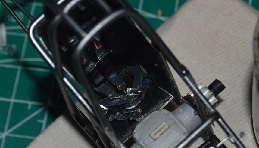

Straightliner59 Posted March 19, 2023 Author Posted March 19, 2023 Harness installed! I usually use wine bottle foil to make my belts. The slots on Detail Master's harness sets are super-narrow, and persnickety. This time, I used strips of foil, cut from a disposable aluminum baking sheet. They fit through the slots, much easier, and don't look any differently. The Simpson decals came from a Slixx sheet. Viewing the photos, I can see some touchup that needs doing. Thanks for looking! 3

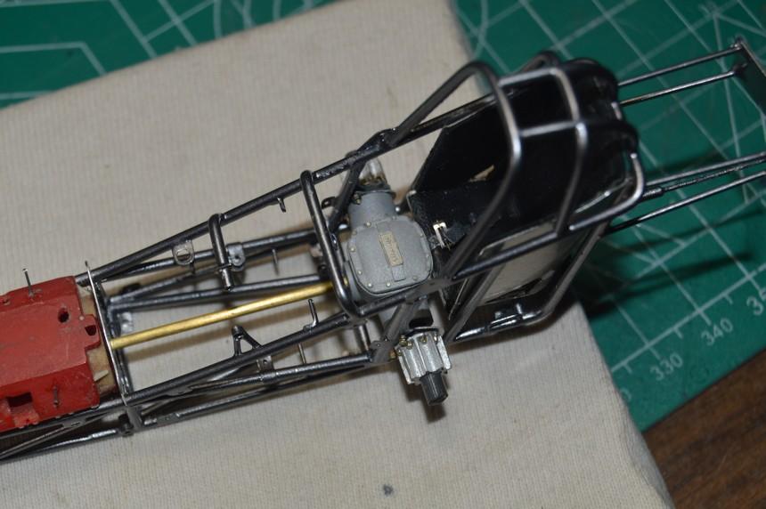

Straightliner59 Posted March 21, 2023 Author Posted March 21, 2023 I made a new brake fluid reservoir, and installed it, and the master cylinder. The new reservoir is made from a white plastic coat hanger. The original part was too opaque, for my taste, and the coat hanger provides a more translucent look. It's hard to believe I'm doing some finish work on this thing! I think I've decided on a color. It's a mixture of Humbrol Brass, and Humbrol #55 which is a kind of bright copper colour. It will be paired with black. It really goes well with the wheels, too. As always, questions, critiques and comments are welcome. Thanks for looking! 3

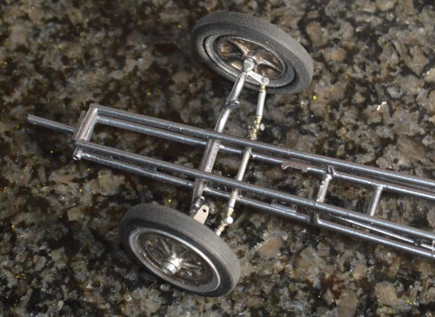

Straightliner59 Posted March 23, 2023 Author Posted March 23, 2023 Thanks, man! I got some more work done to the brakes. I mounted the rotors. The dark center is based on a Strange catalog photo I found--this looks pretty much just like it! The "braided" lines are stranded bead wire. I'm working on the rest of the fittings. I should have these done in a couple of sessions. Then, I'll see what mischief I can get up to, next. As you can see, I didn't bother with doing proper "anchors", for the belts. They will never be seen, once the tail, body and floor are installed, so I could see no reason to spend that time, when it could be better spent, elsewhere on the project. Questions and comments are always welcome. Thanks for looking! 2
