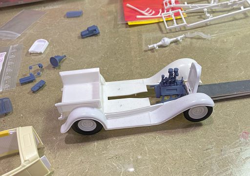

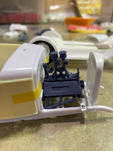

Here you can see the Texas 3D Custom flattie dropped between the rails. I pinned the headers to the block. It's a tight squeeze between the rails, but it fits. You can also see I shortened the bed from a Revell 29 Ford pickup (shorty). This frame/fender set is a piece I have sitting on my bench at all times just to drop bodies on and throw wheels under (that's how much I love 32 Fords, who else does that?) Once I get another set of fenders I'm going to try my hand at bobbing them in the rear.

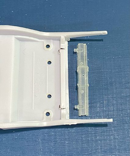

Wanted to use the sweet quick change rear end from Maple Leaf Modelworks under the rear since it will be visible with that short bed back there. Chris does make a set specifically for the Revell 32 frame, but when I placed my order he didn't have those yet, so I'm adapting the first set he created for the 32 frame in Revells new Model A kits (which are slightly narrower in the rear area). He did a great job designing this because you can friction fit it together for mockup purposes and it doesn't come apart. I set about removing the rear floor and gas tank, while taking care to leave stub portions of the kit molded in crossmember for the new spring crossmember to marry with. You can see I marked just outboard of the molded in shock mounts.

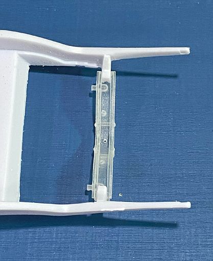

After removing the floor I was ready to see how the new crossmember fit. Like a glove.

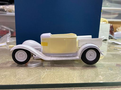

I cut out a bit of the bed floor to allow the bed to sit down where I want it. The rear crossmember is now permanently in place.

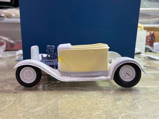

And here she is mocked up on all 4's for the first time. With the stance locked in I can start finessing other aspects. You can now see the successfully bobbed rear fenders as well. And I grafted in the cowl from the new roadster so I can use the Duvall windshield. Out of the 2 of those new kits I've bought one windshield was perfect, and the other was warped. If you buy one open it up right away and if you have a warped one get your request in to Revell, they are aware of the issue. I'm going to make mine work by pinning it to the body. Fingers crossed during final assembly.

Here you can see the new motor mounts I scratched up from  evergreen C channel and tubing. Don't mind the gap between the block and the intake, that's me not making sure everything is where it belongs before I snapped the pic. Flatheads can get lost in a 32 engine bay, especially with fenders, so I want the engine sitting up high.
1672948158541
The new motor mounts necessitated small notches in the lower edge of the fender so it sits flush on the frame. And now you can see the effect of mounting the engine higher up.

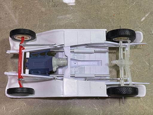

Forced myself back to the bench after nearly 3 months of inactivity. Still lots of ideas stuck in my head, but need to get the juices flowing again. Took me a little while to figure out where I left off and what I still needed to do. I fitted suspension arms and brakes for the front and rear and made a up a simple exhaust. I think I'm ready to start prepping parts for paint.
