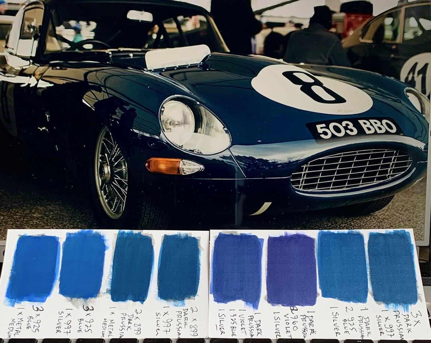

Not sure yet when I will paint the body but I felt like playing with color formulations this morning. Pic 1 is the actual race car in the pits in 62, thanks to Gramps for providing this rare period color pic of this race car. Pic 2 is the restored car at Goodwood in 2018, not sure about that color. Pic 3 is a production car painted dark opalescent blue.
  • Like 1
I'm loving the very top picture if you could duplicate that. That really pops to me, as they say. I know you will get it right. You always do.

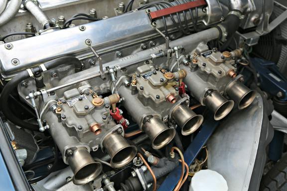

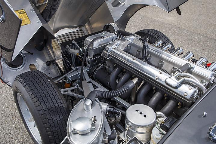

Starting work on the engine. First pic is mock up of kit parts to see how everything generally fits and experiment with assembly sequences. The Revell sequence sometimes contradicts with what I'd prefer to do for assembly and painting steps.
Second picture is one of the many ref pics I will go by. This one is a continuation lightweight. Again I have questions about how my race car was restored as it does have Weber carbs nut a wet sump oiling system. The Cuningham car has a dry sump, The D types before did and the Lightweight did. So that' s it, I will try to scratch build some of the visible componentry as well as Weber carbs, fuel delivery and a few other details to get the look that I want.

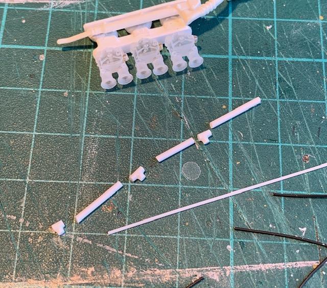

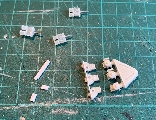

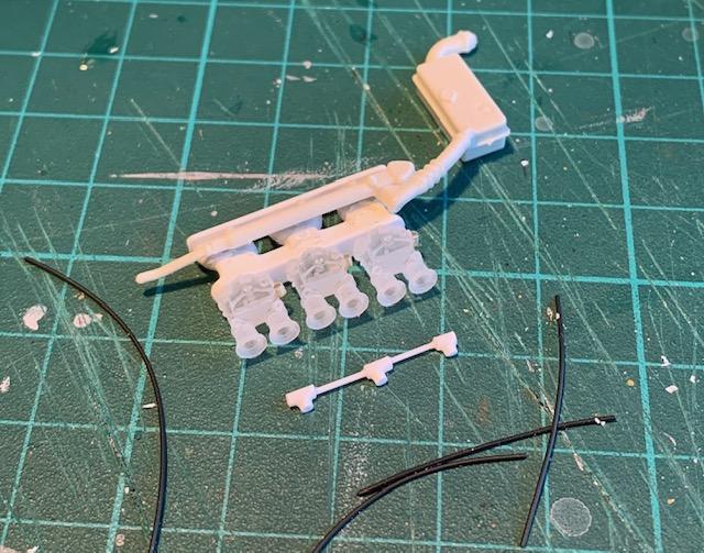

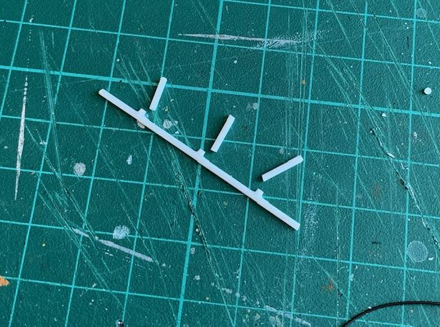

Fuel delivery to Webers. This is where RB Motion stuff would help but since my last purchase still needs time to get here I will try to scratch build it using styrene 0.5 and 1,2 mm rod and some ignition wires...

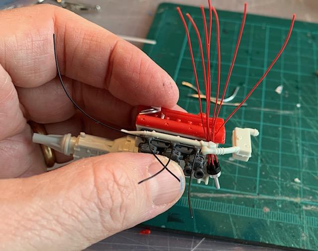

Distributor and feeding wires to the plugs is a tight fit with the distributor sitting at an angle at the front end and somewhat under the first Weber carb, then wires feed between the coolant run and the head, wrapping over the cover held by a bracket. Location of the bracket is critical to clear the hood. It's tight but doable. Connkur distributor (the best), the rest scratch built.

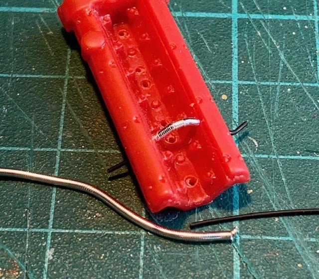

Found this hollow wrapped wire lace at the jewelry department at Michaels. It is 0.75 mm diameter and matches well to a scale 3/4 inch reinforced hose. I'll be using it for the oil breather hoses.
Using cheap 0.6 mm wire for the leads at both end or the runs. The wrapped wire slips right on
Stop me if this is to much details...

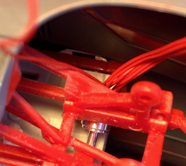

All good
in fact, all very good
consider re-doing the upper A arms - they are less than great  - not as precise as the rest of the forward compartment … show the age of the kit …
