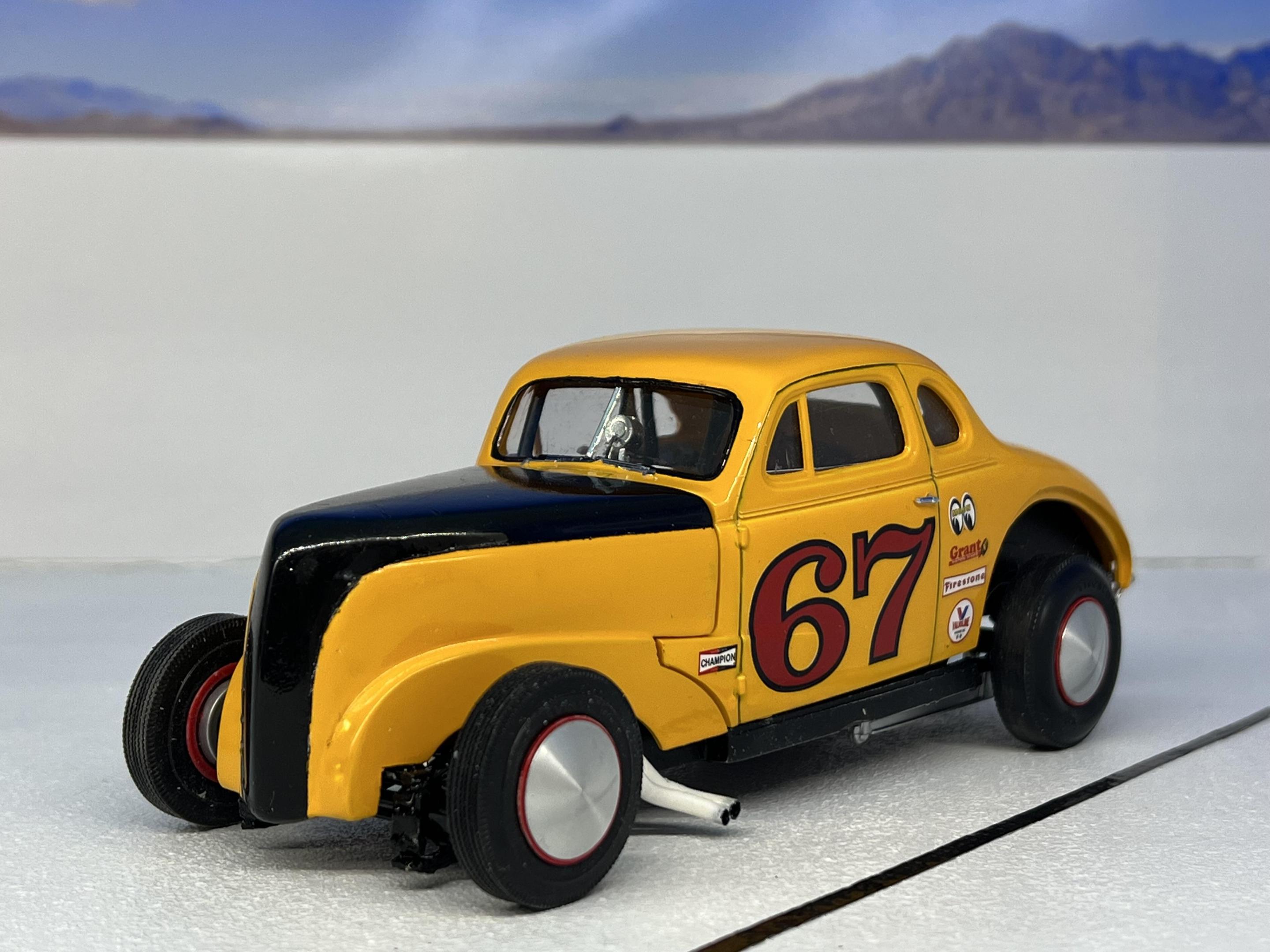

I had never owned this version of the AMT 37 Chevy coupe and was always inspired by the box art showing Tim Boyd's model.  It reminded me of a beautiful Tom Daniel centrespread on salt cars in a mid seventies issue of Rod & Custom magazine. When this version arrived in a local hobby shop I thought it was time to rectify the situation and it was actually completed less than three months after I purchased it - unusual for me.

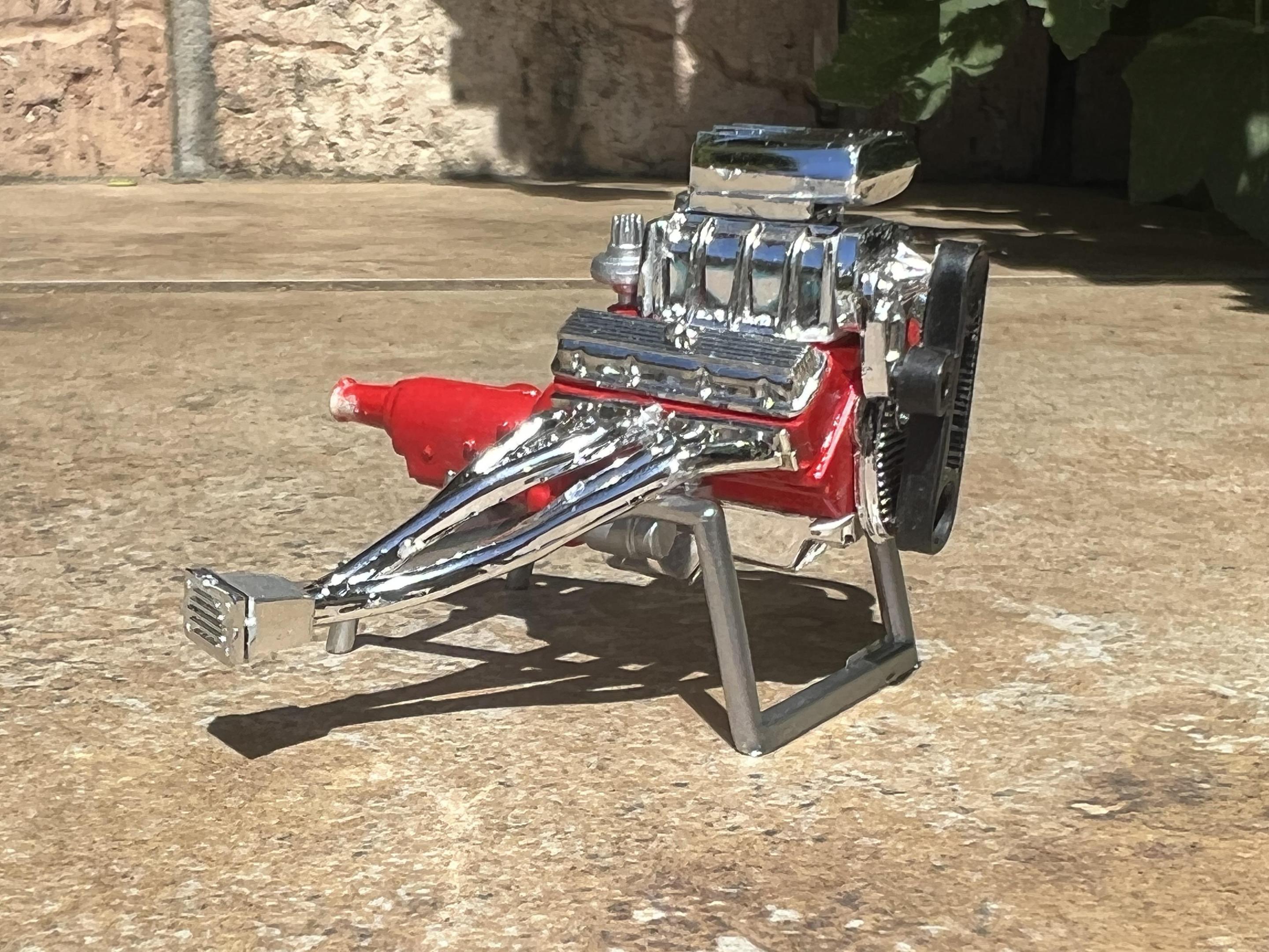

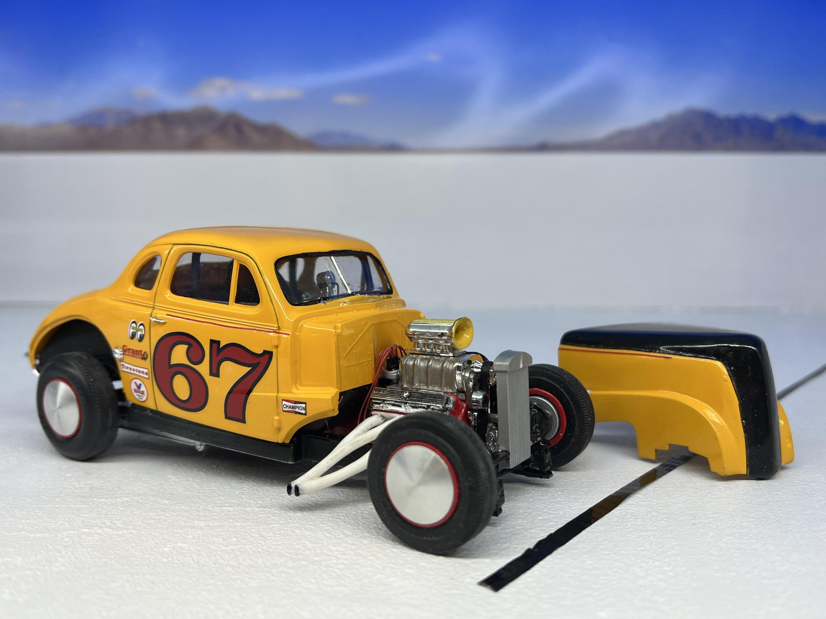

I had good intentions of doing it box stock but that didn't last long! I decided to make a one piece nose using the custom hood, custom grille and salt lake fender fillers, just to give it a more competition look.  The big block in the kit is not the greatest of all time but at least it fits!  I couldn't live with the funky bugcatcher so replaced that with a Revell Willys Hilborn scoop.
The toughest part was getting it low enough - the dropped axle is a good start but it was still nowhere near low enough for a salt car so I glued the springs under the axle instead.  It has almost no bump clearance but I wasn't going to drive it anyway!

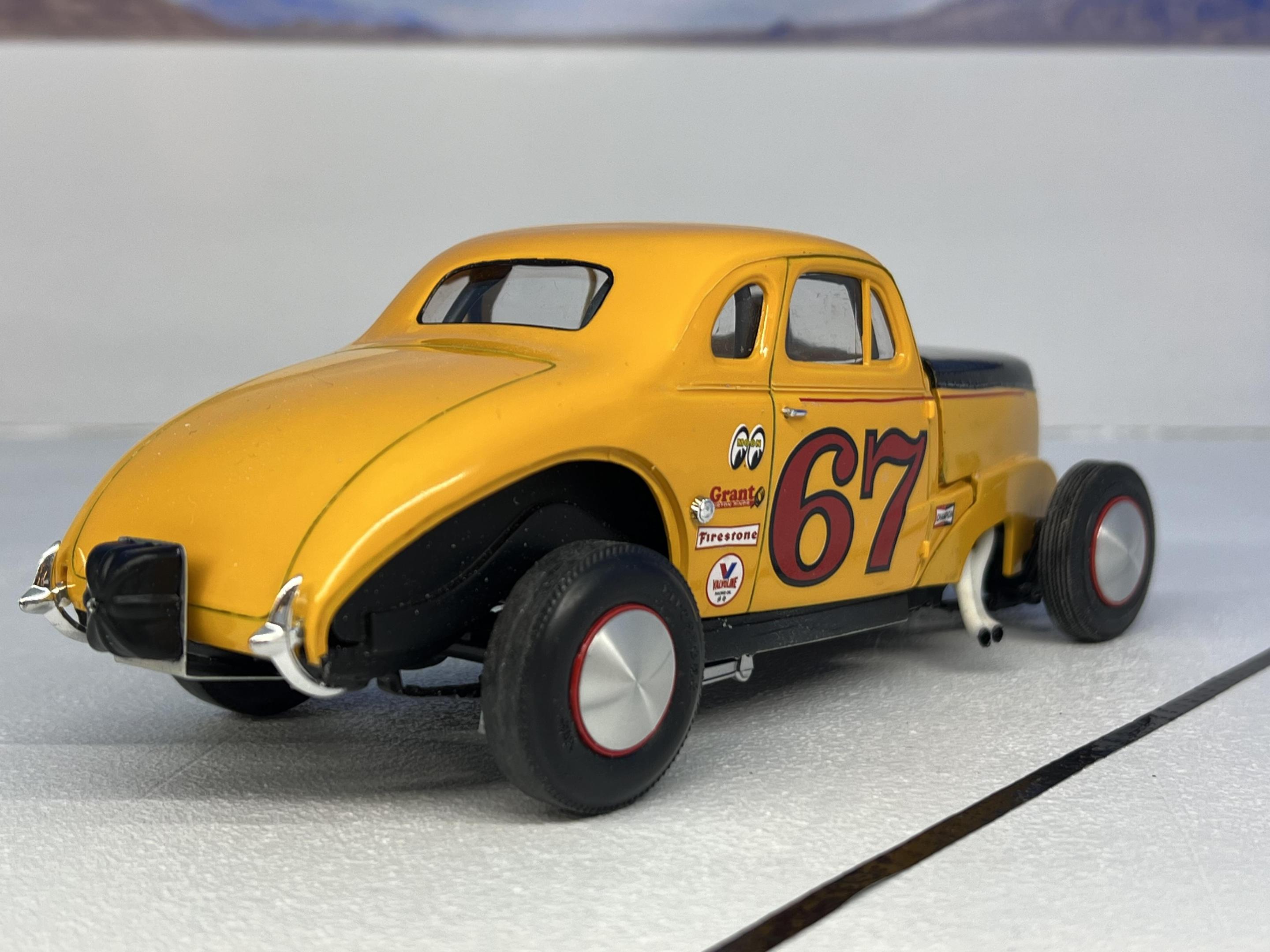

The supposed Moon discs were very unattractive plastic discs so I replaced them with the very best aftermarket Moon discs I have ever seen, from Darryl Pipcorn of Parts by Pip in Victoria Australia - they are flawless!

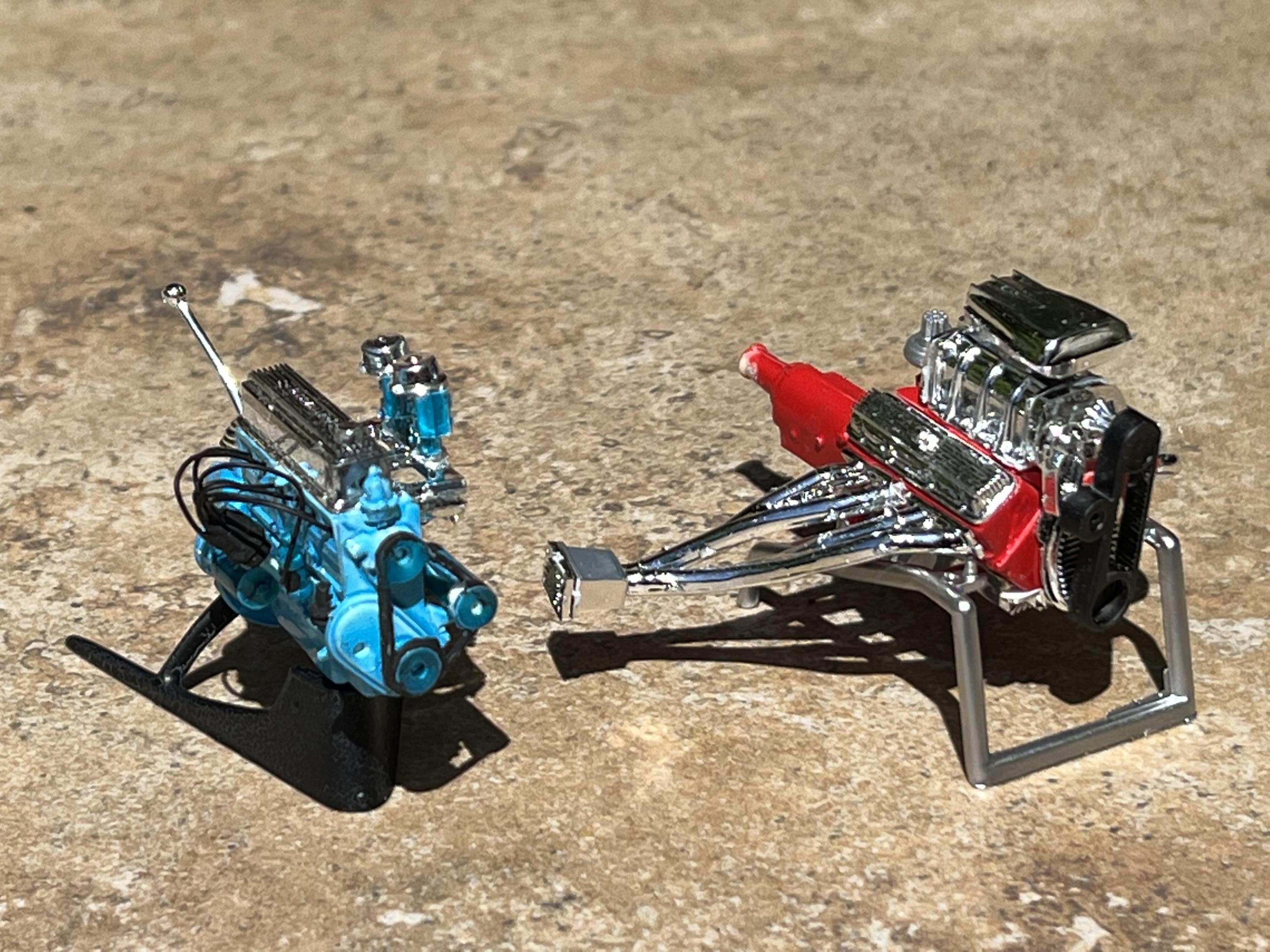

I'm saving the Stovebolt 6 for a 32 Chevy roadster salt project.

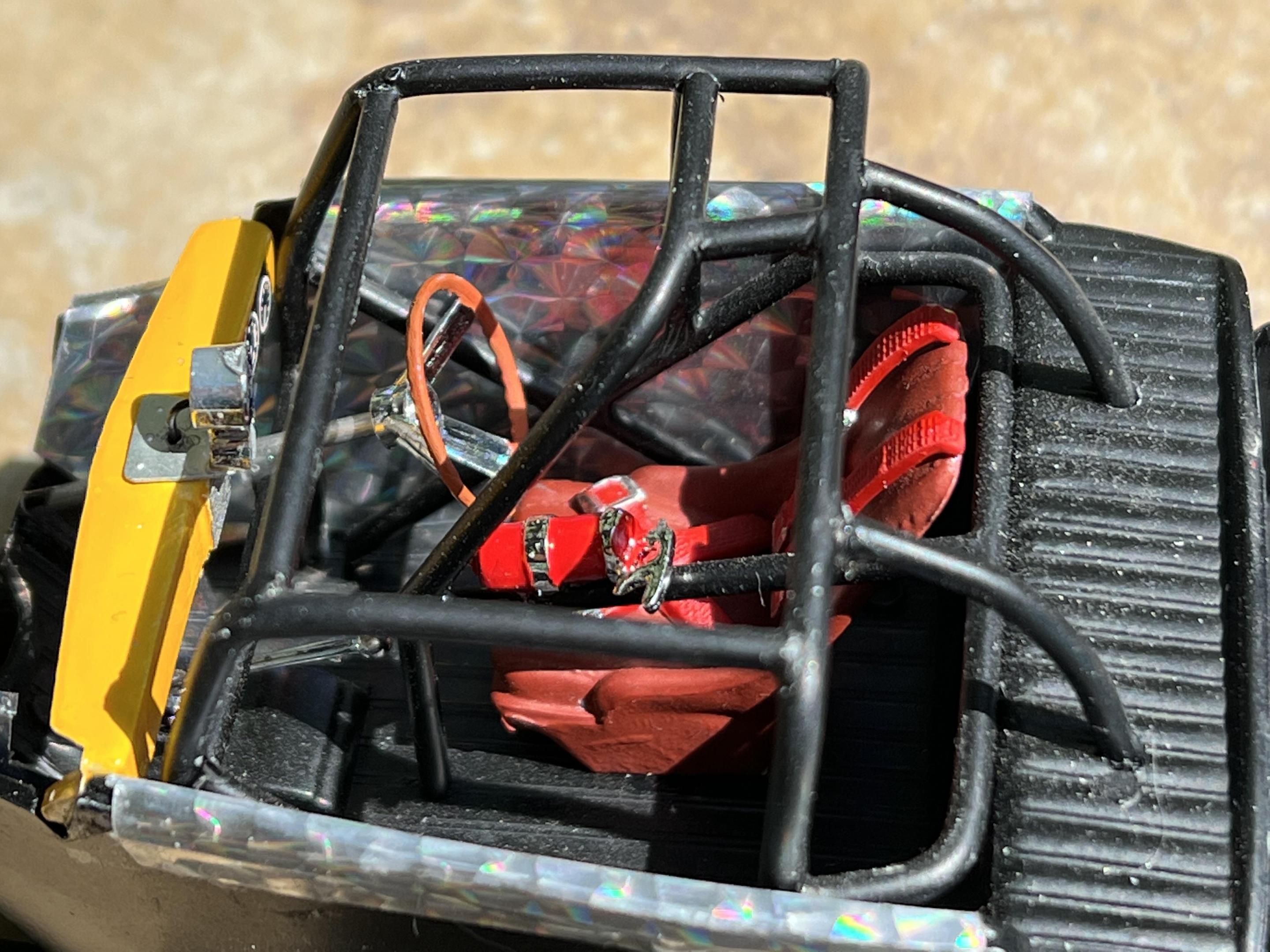

I built a contemporary rollcage of sorts for the interior but to be honest, with full glass installed it is almost invisible.  And for a bit of a flashback, I used the shimmery self adhesive material from an ancient Cruisin USA series 49 Merc kit to give an engine-turned aluminium look to the door panels - again, almost invisible!
