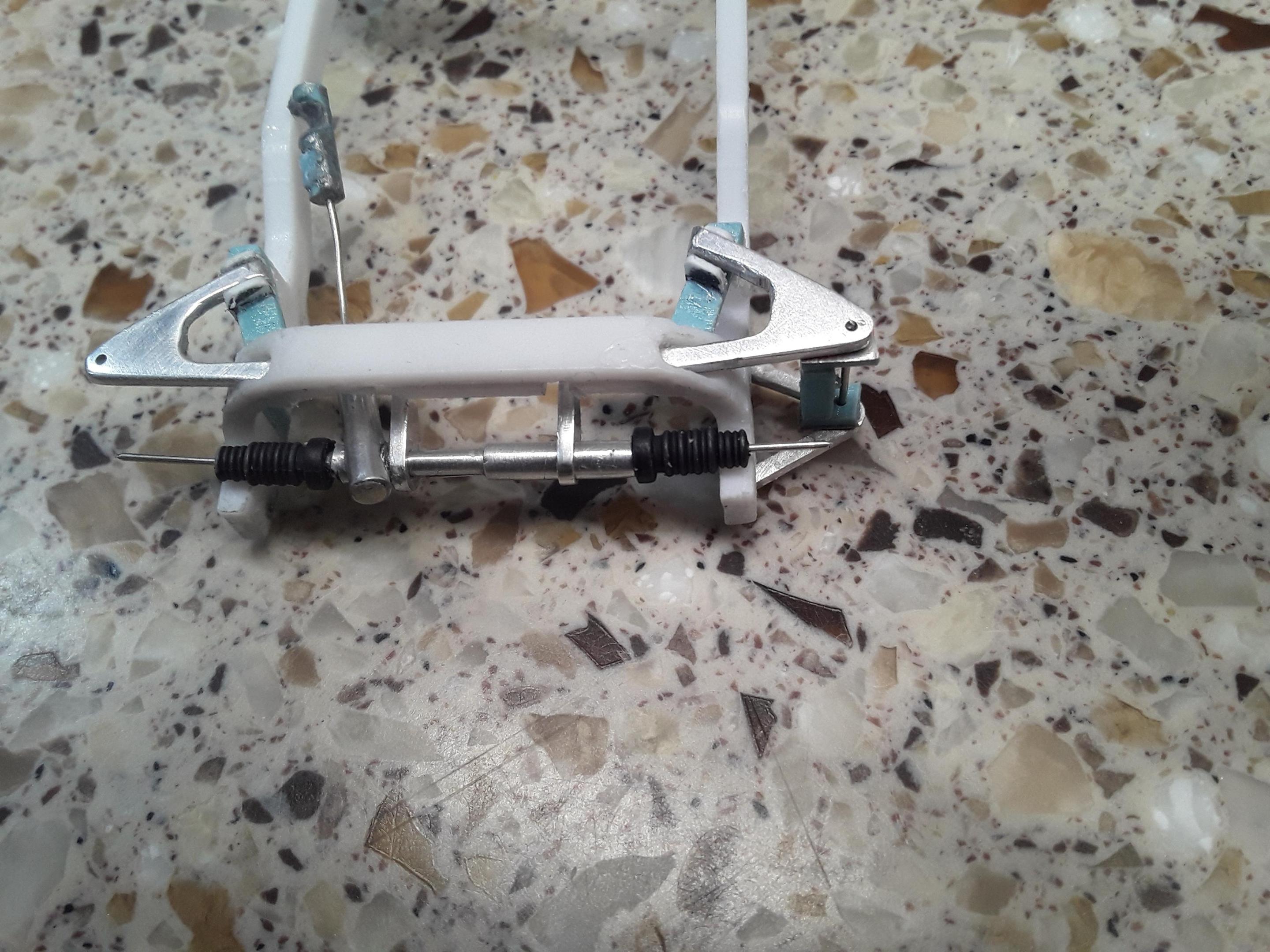

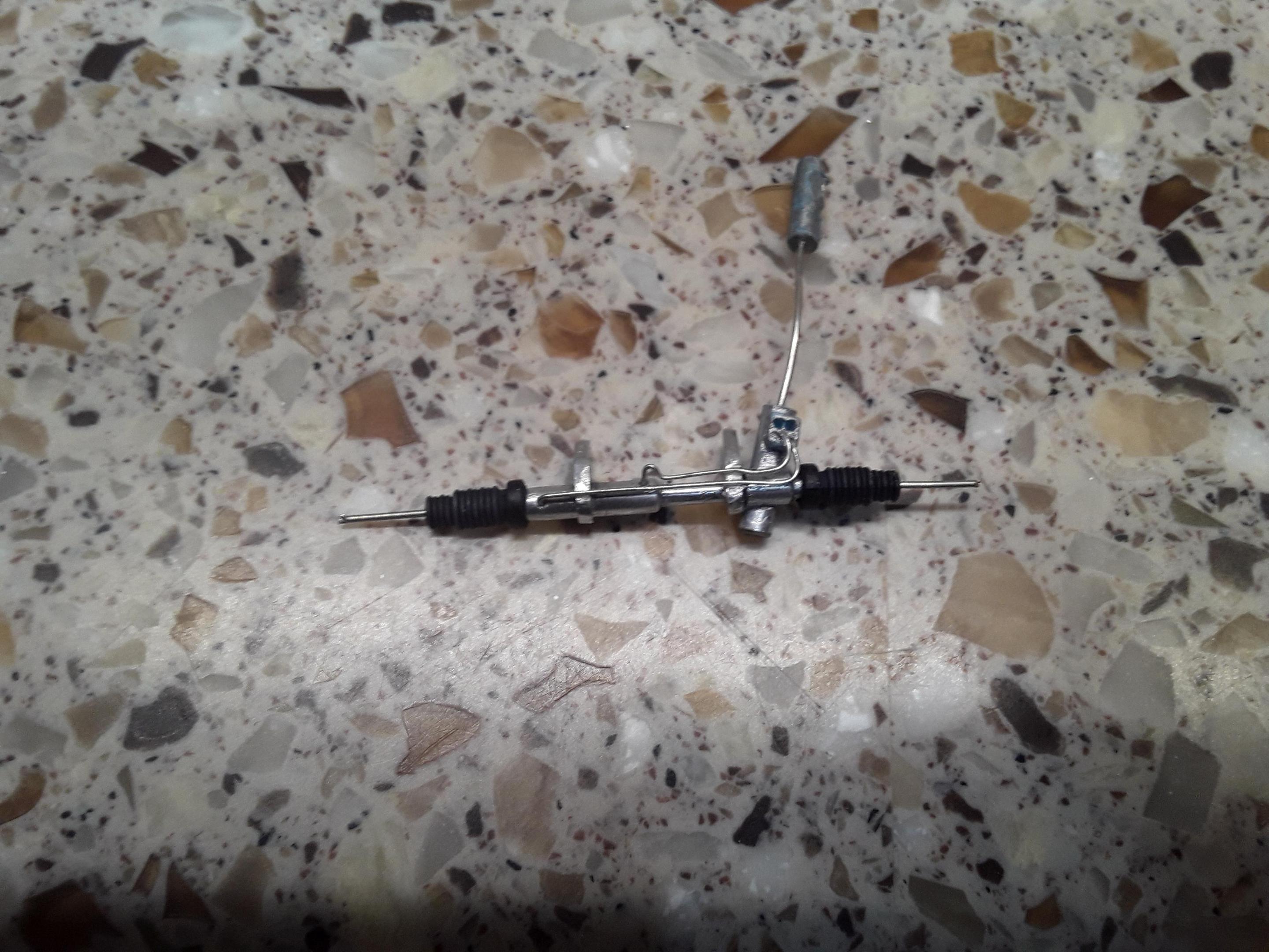

11 hours ago, dino246gt said:
I'm still stunned by how cool that rack and pinion looks, fantastic scratch building!
Hi Dennis. Thanks for the feedback on the rack.  I wasn't sure if it was good enough so I appreciate the positive feedback from you.

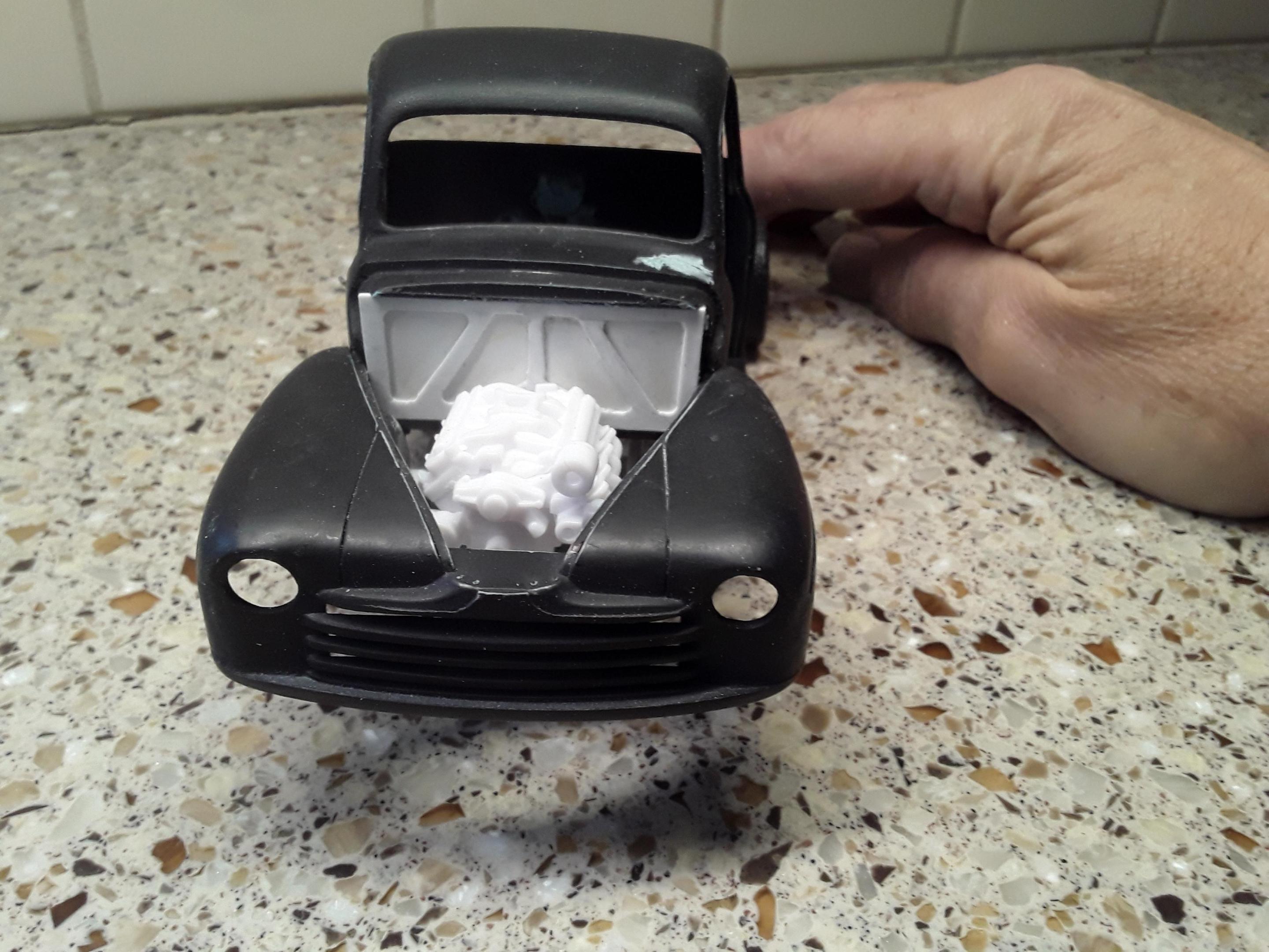

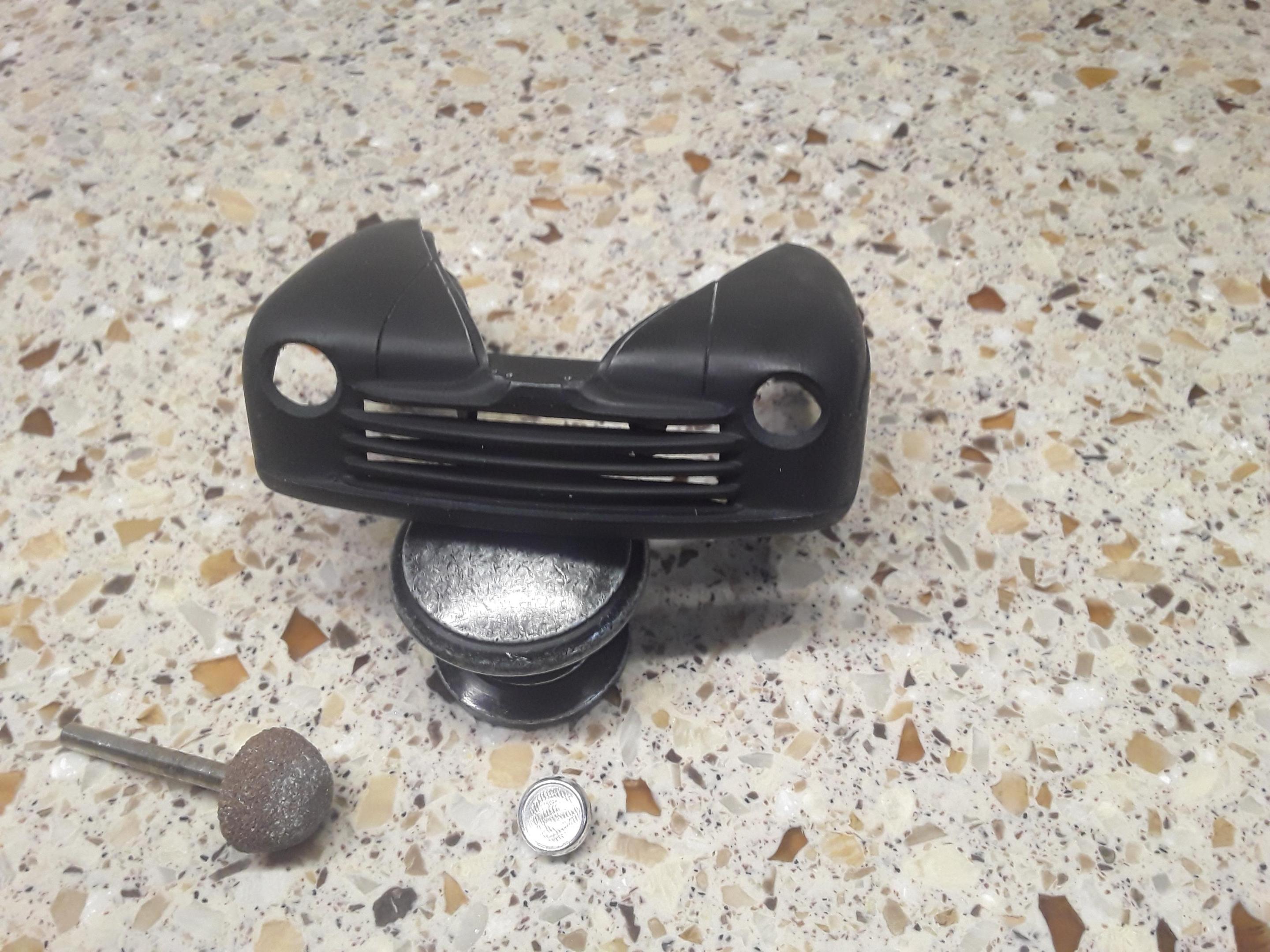

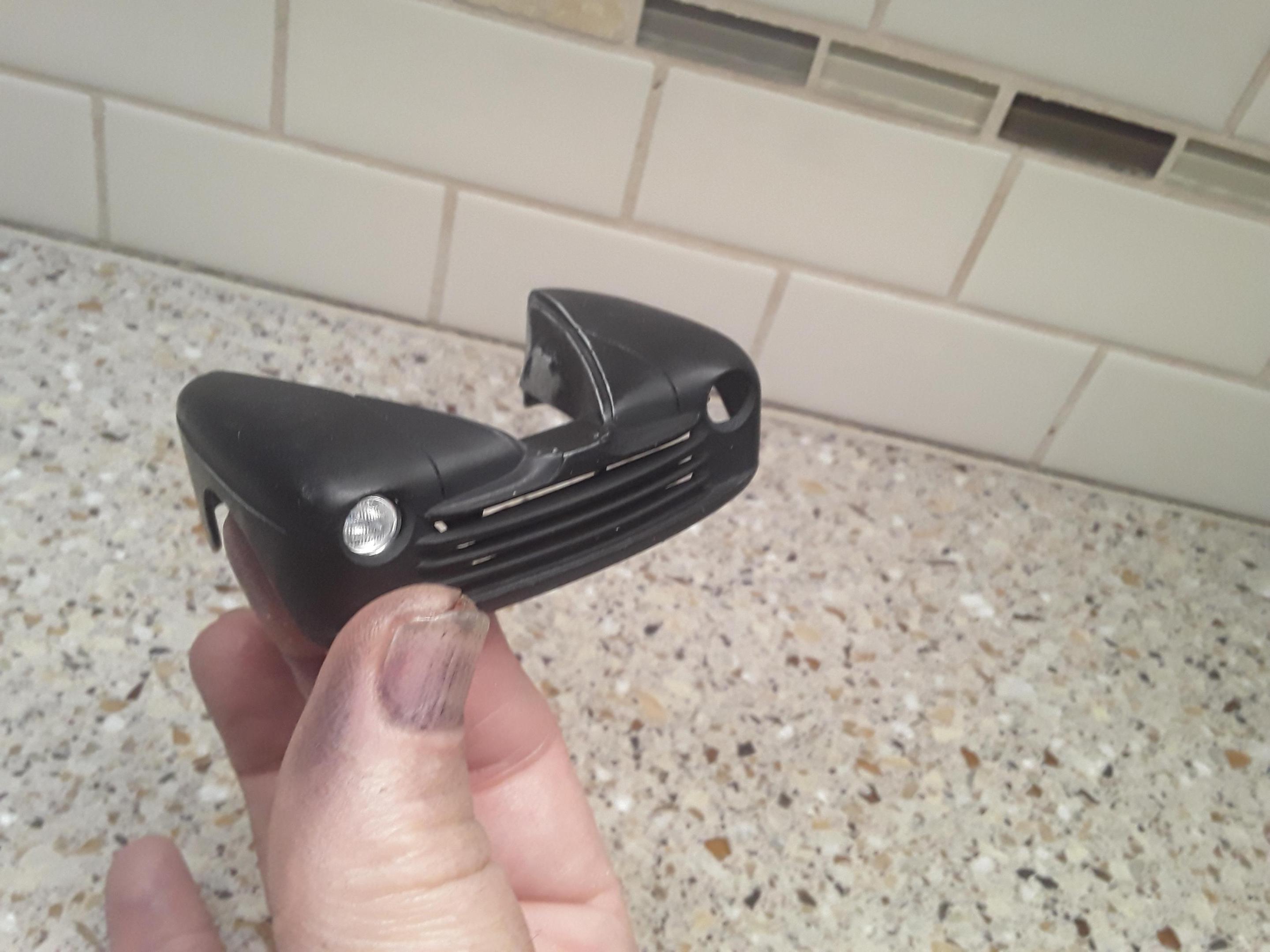

Figured out my headlights.  Created frenched headlights by hogging out the front side of the headlight holes with the Dremel bit shown and placing headlights from an Ertl 40 Ford behind the hole.

The way I made this was to sketch out the idea on .2 plastic, add straight guide pieces of .2 plastic around the perimeter and the inside angle piece of one half of the sketch, drilled holes at each corner. I took that template and placed it on the .2 plastic sheet that would become the outer skin. I drilled out all the holes on one side of the outer skin piece, flipped the template over and drilled out the other side so the 2 sides would match, and "connected the dots" with a straight edge and #11 blade. A little filing and sanding and I glued it to a second .2 plastic sheet to create the indentions.
Nice touch on the headlight Ron, very nice improvement!
I have always found the headlights on many models to have a toy-like (or fake) effect and what you have done will lend a lot of credibility to the final product. ?
Thanks for the input Frances.  If they look right to some one like you with a great ability to build realistic components then I have the look I want to achieve.
