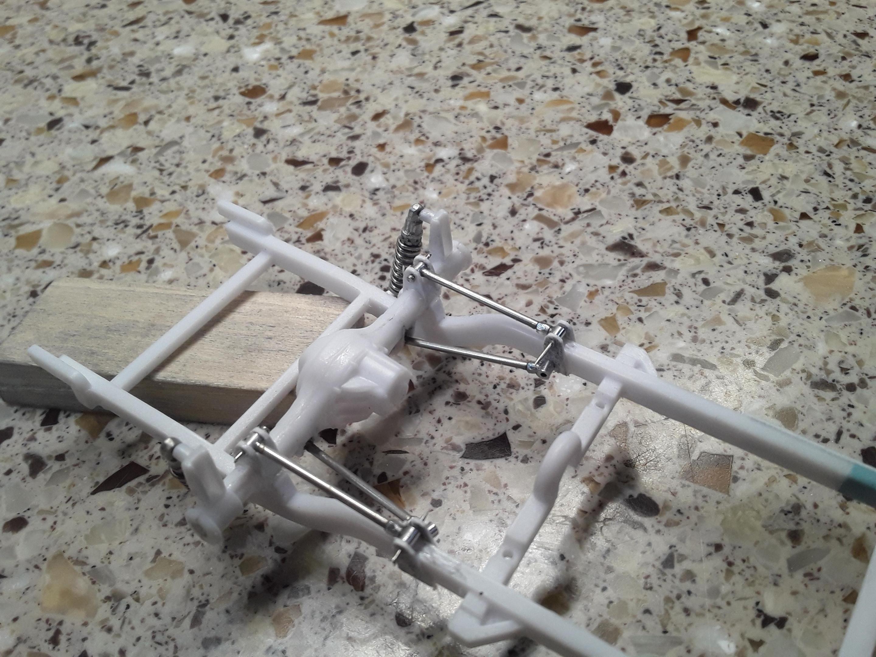

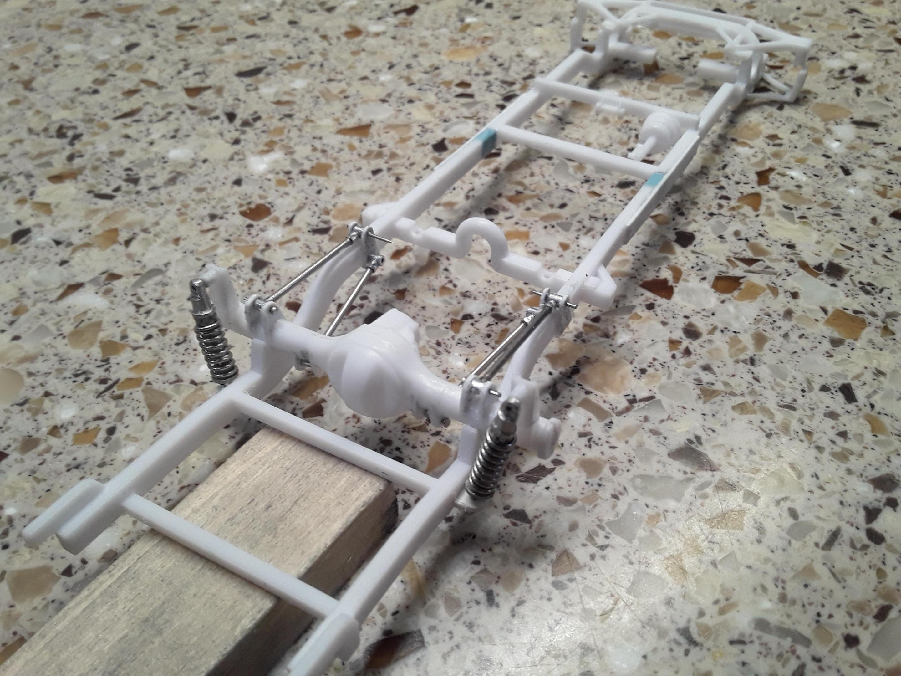

Butter 1 Posted February 15, 2023 Author Share Posted February 15, 2023 The rear suspension is roughed together. Stainless tubing, aluminium tubing and modified RD Unique coil overs. 5 Quote Link to comment Share on other sites More sharing options...

NOBLNG Posted February 15, 2023 Share Posted February 15, 2023 (edited) Nice clean looking rig, and great work on that 4-link rear.🙂 How did you make the connection on the tee fittings? Is that just super glue? Thanks. Edited February 15, 2023 by NOBLNG Quote Link to comment Share on other sites More sharing options...
Butter 1 Posted February 15, 2023 Author Share Posted February 15, 2023 4 hours ago, NOBLNG said: Nice clean looking rig, and great work on that 4-link rear.🙂 How did you make the connection on the tee fittings? Is that just super glue? Thanks. Thanks for your comments. I stuck a pin into the stainless tube so about .75 mm stuck out. I drilled a hole in the side of the aluminum tube and inserted the end of the pin into the hole drilled in the aluminum tube. I used lok tite liquid super glue to hold it together. Quote Link to comment Share on other sites More sharing options...

AmericanMuscleFan Posted February 19, 2023 Share Posted February 19, 2023 Great work on the 4-Link Ron. Your solution for the rod ends is excellent and the pictures speak for themselves! 👌 Quote Link to comment Share on other sites More sharing options...

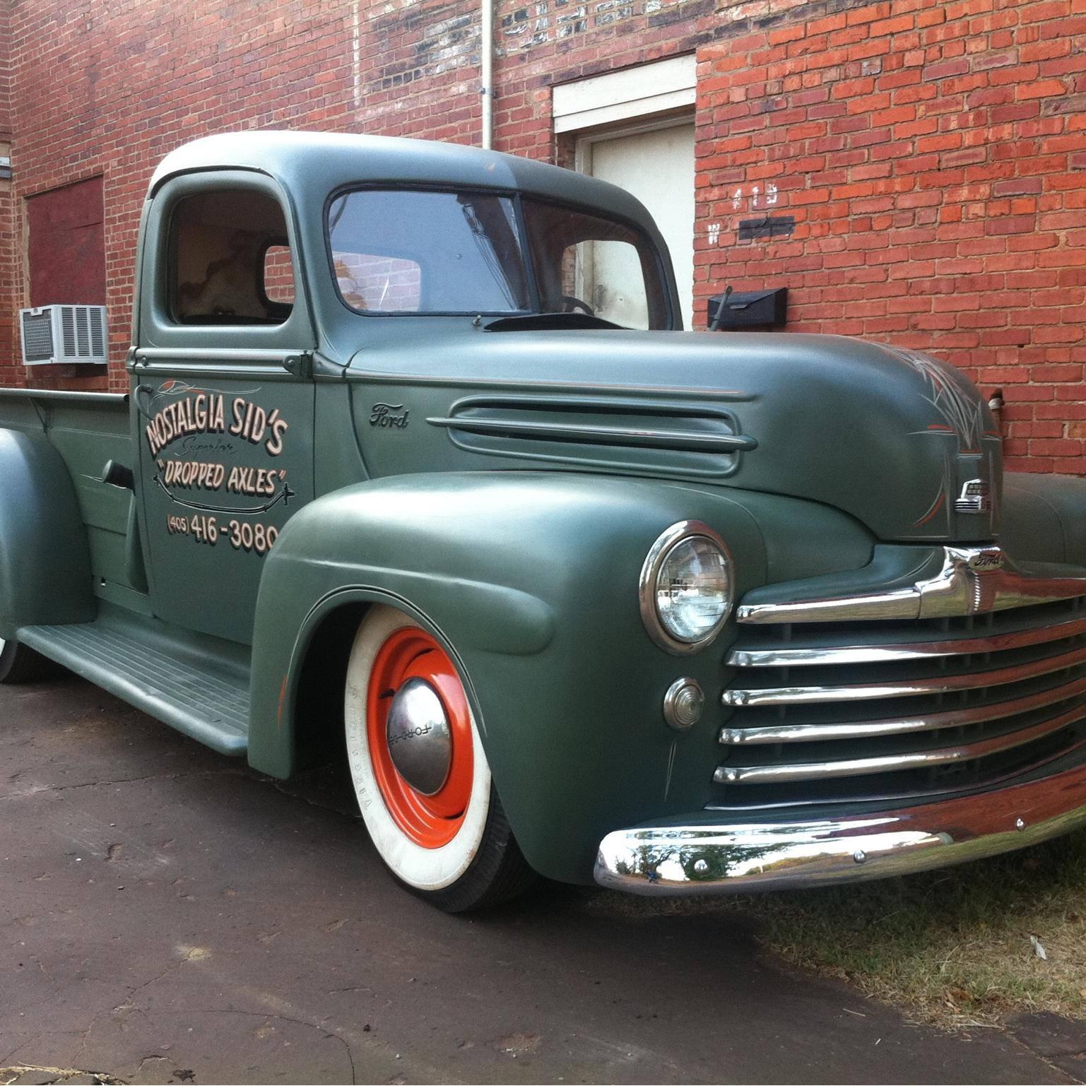

Dan Hay Posted February 21, 2023 Share Posted February 21, 2023 (edited) A friend of mine Sid Drapal built one of these, using a 40-47 cab, 46-47 hood and the 48 passenger car grille, with a couple extra bars at the bottom to add height. Edited February 21, 2023 by Dan Hay 2 Quote Link to comment Share on other sites More sharing options...

Butter 1 Posted February 22, 2023 Author Share Posted February 22, 2023 23 hours ago, Dan Hay said: A friend of mine Sid Drapal built one of these, using a 40-47 cab, 46-47 hood and the 48 passenger car grille, with a couple extra bars at the bottom to add height. Hey Dan. Thanks for sharing this pic. Very cool truck. Quote Link to comment Share on other sites More sharing options...

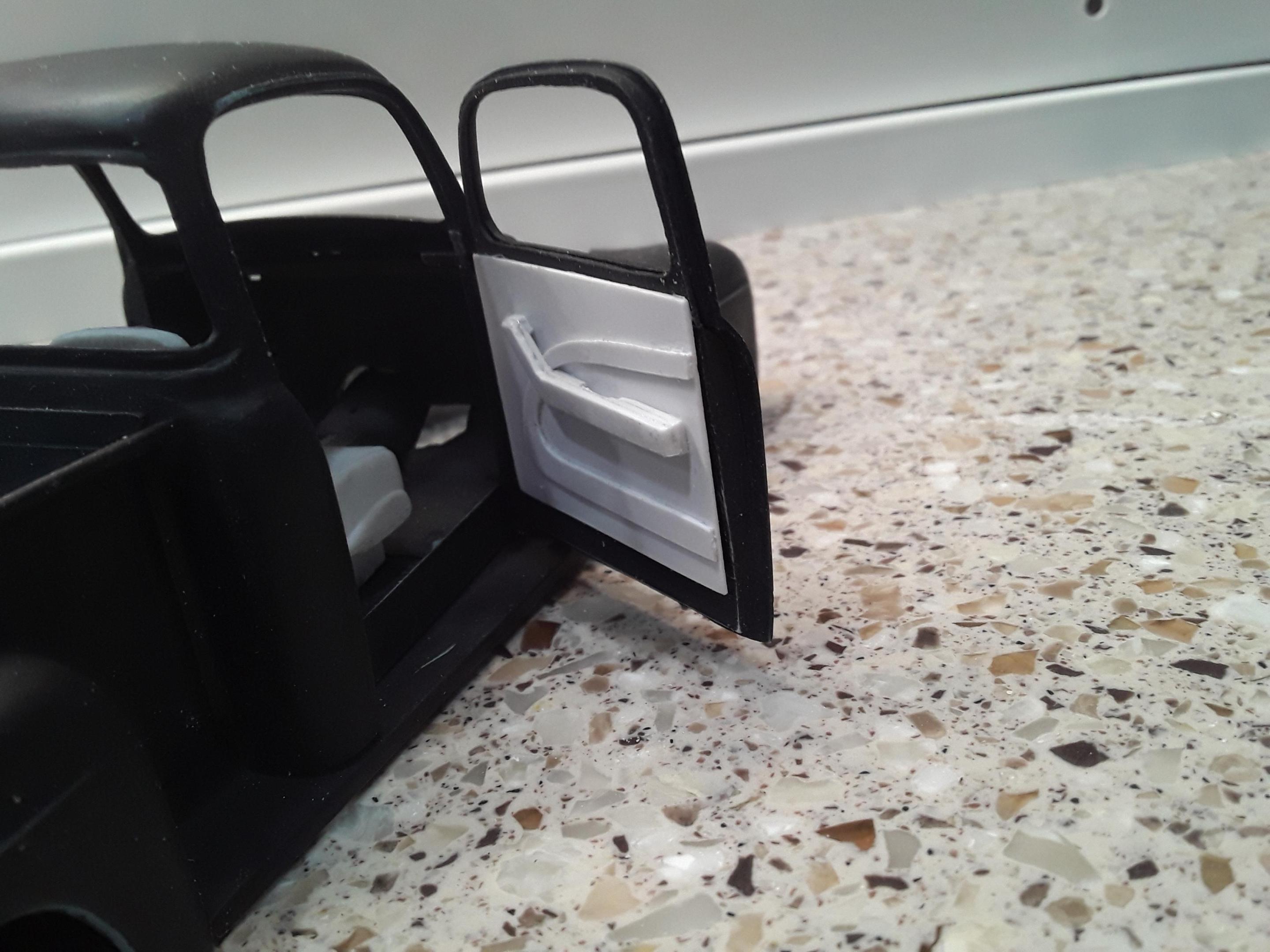

Butter 1 Posted February 22, 2023 Author Share Posted February 22, 2023 I carved the front a arms out of aluminum. Roughed together door panels and I think I know what I will do for seats and a center console. 7 Quote Link to comment Share on other sites More sharing options...
