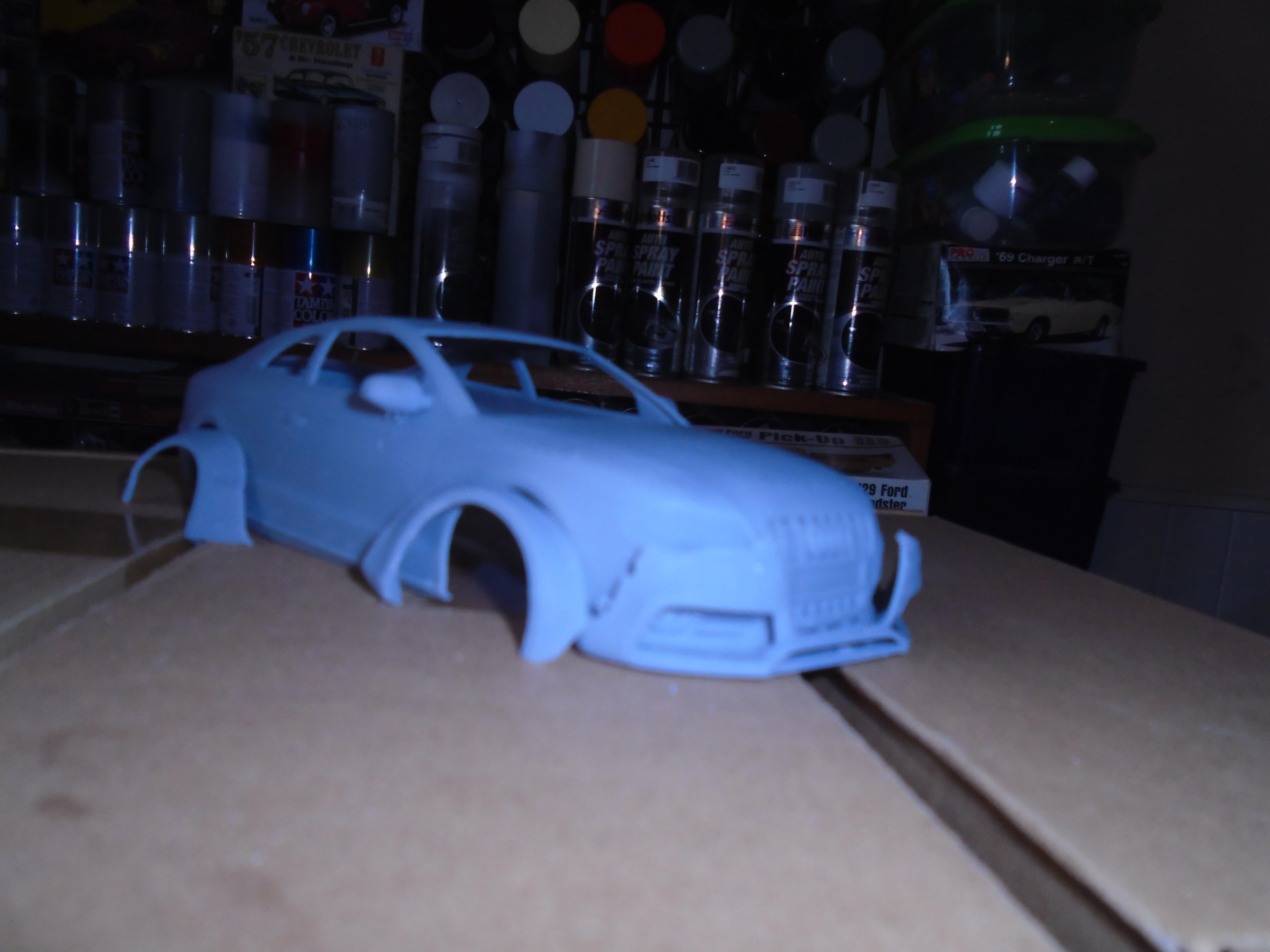

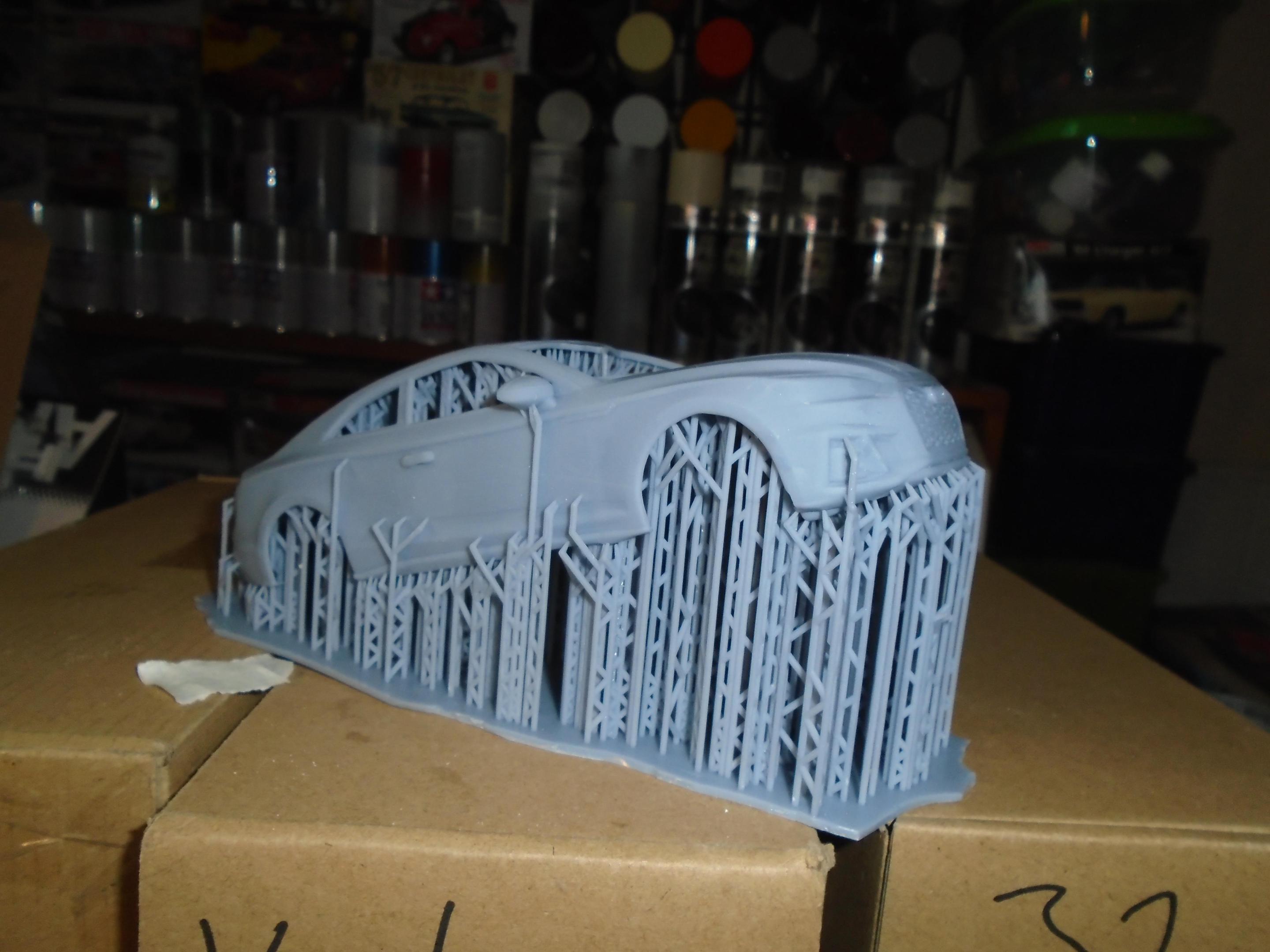

As you all know by now I'm a big vw fanboy, and i also have a fondness for the more unusual cars which has led to me printing out a load of south american vws. I'm still trying to get the passat, parati and saveiro g1 to print at 1/24 but everything elde is 1/24 exceprt the 2020 audi rs5 which is scaled to fit a drag chassis so i can build daddy daves new no prep car. I have everything to build it and printed 2 bodies so i can cut the front off to show the engine. First up is group of files from various places to build a liberty walk audi a5. I have an interior file for this too but it needs a lot of work to print well so this build is a while away.

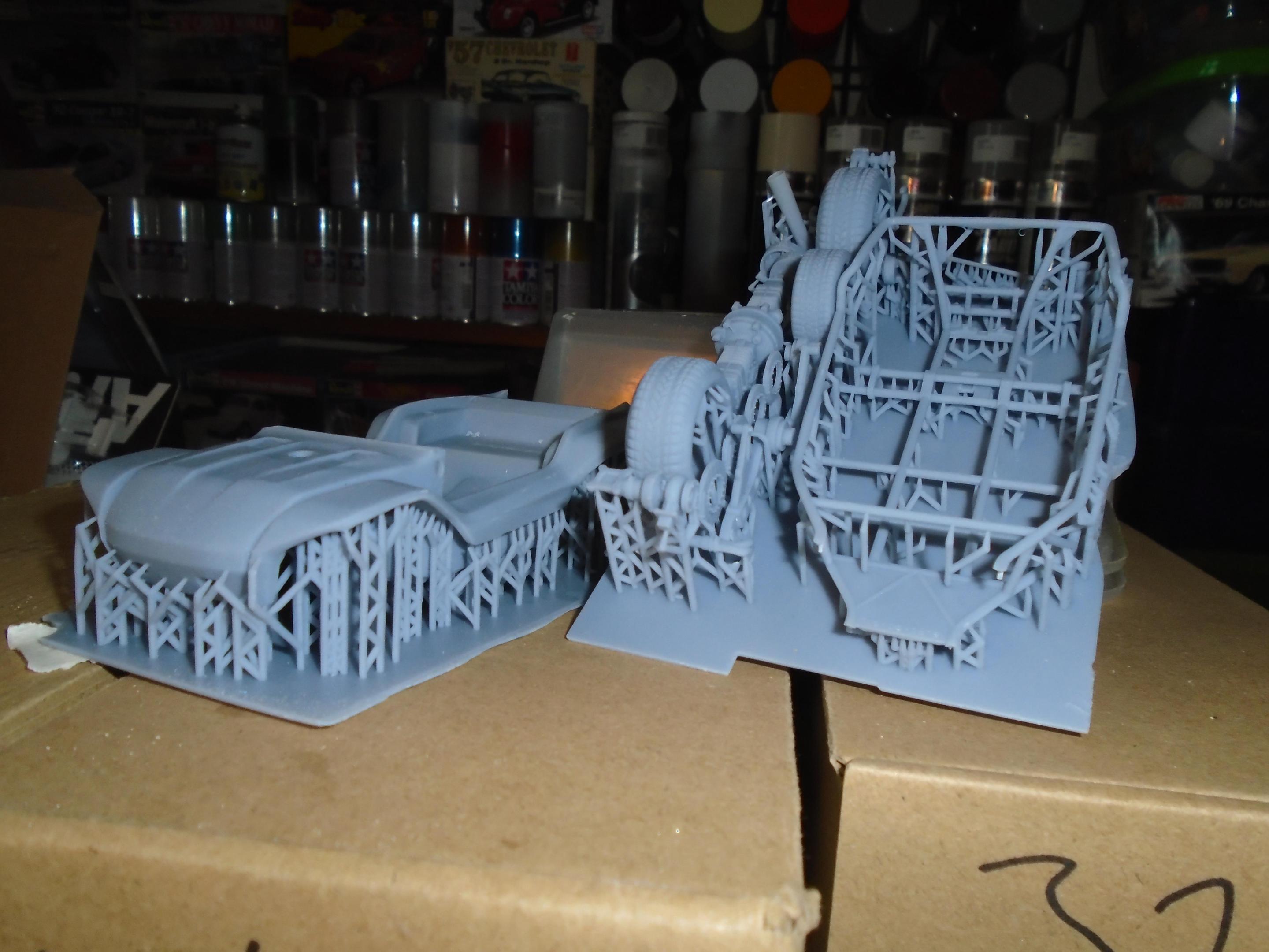

next is a blackboxstl beach buggy. as I'm never satisfied I've also printed out the drag parts to fit the engine and a set of small tyres

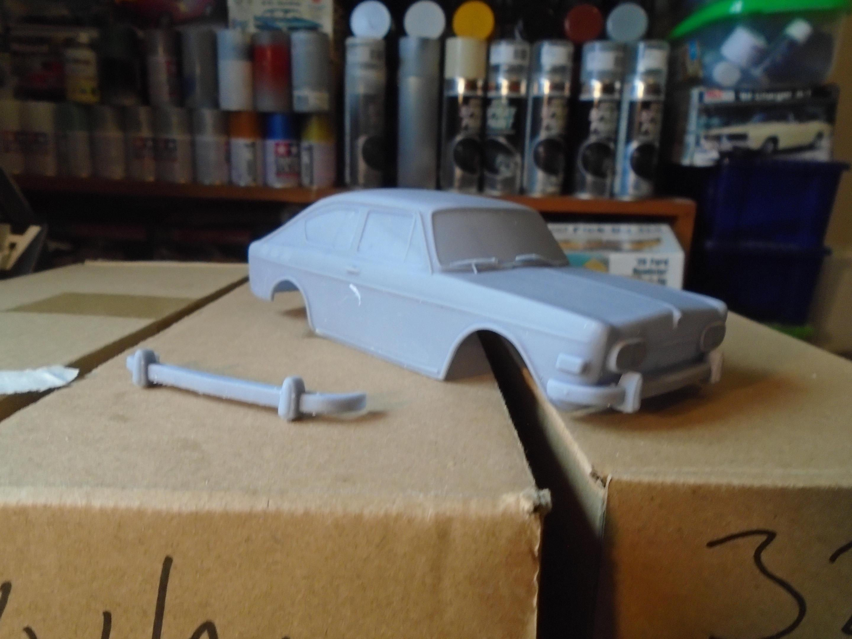

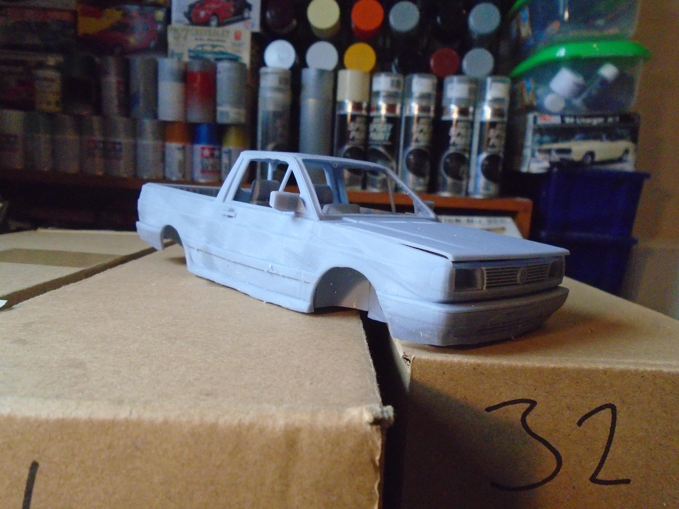

this one is a south american vw but versions of it were available in europe. Isn't it ugly? should look sweet slammed on some suitable period style rims

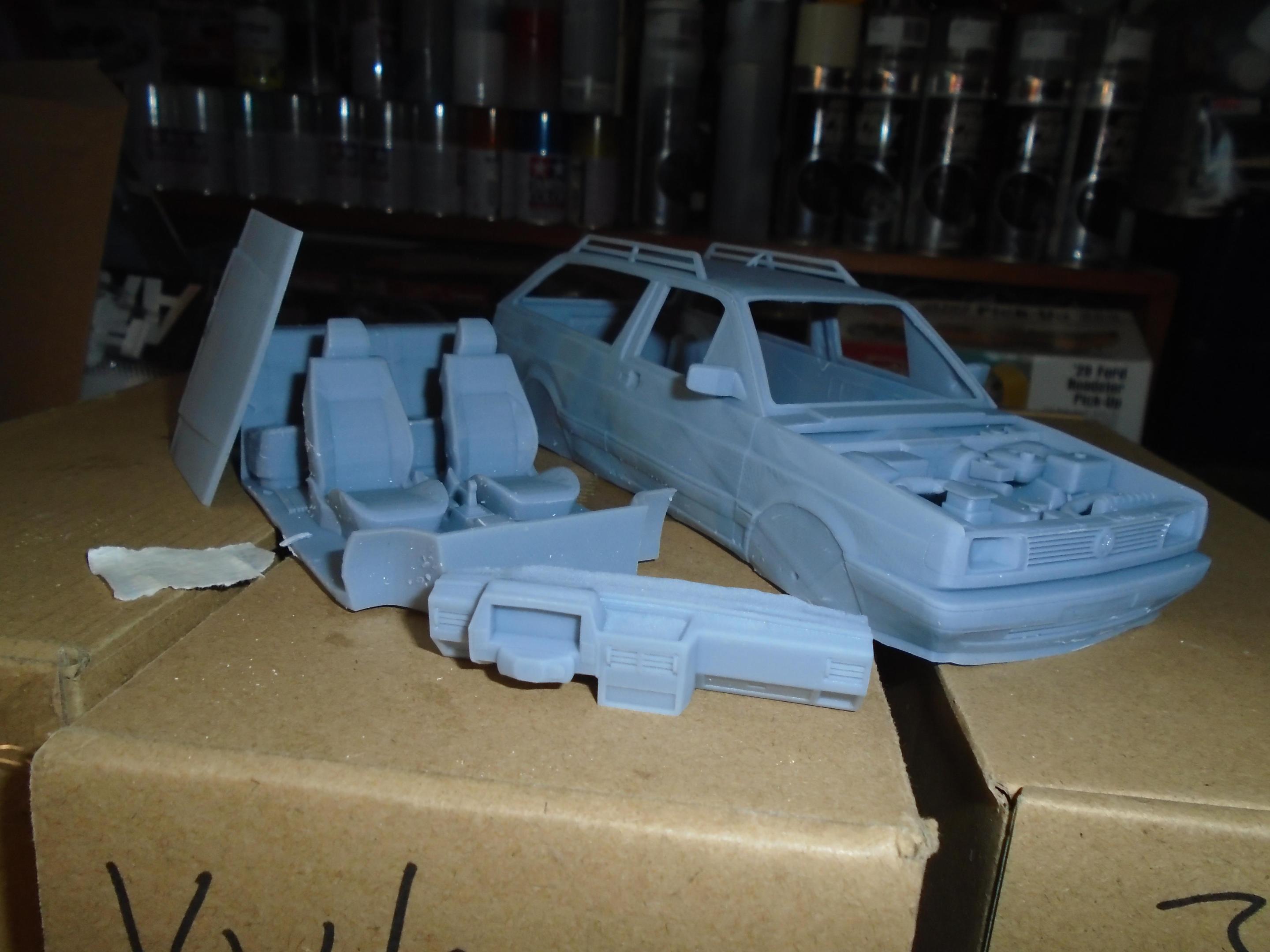

this is a facelift mk2 vw passat. it needs rescaled as its too big just now. this one has an interior also

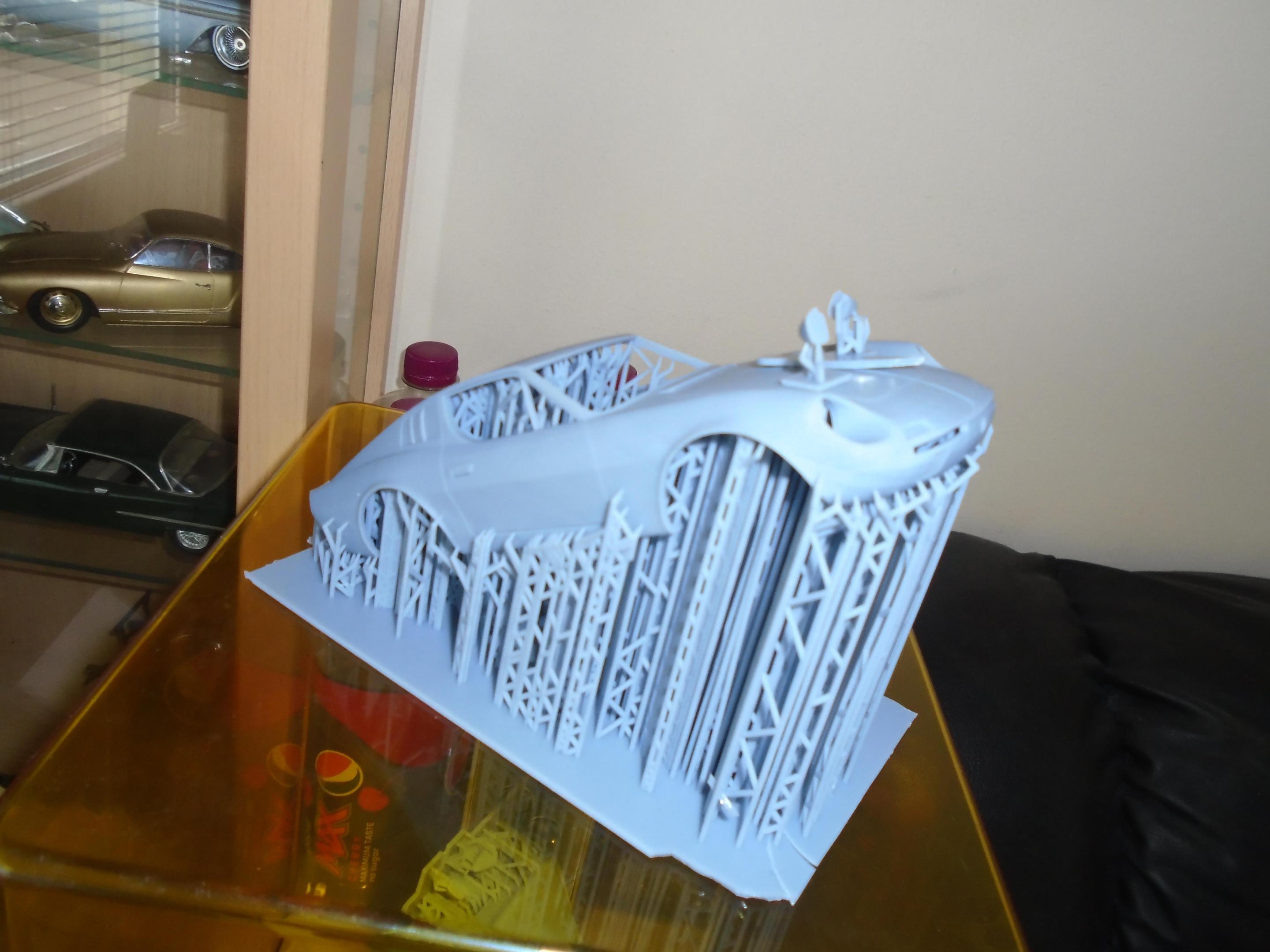

this will become daddy dave's new no prep car. All the chassis and other parts except the body are files from mcs or mattys custom scale on cults. Nice files but they feel underscaled for 1/24

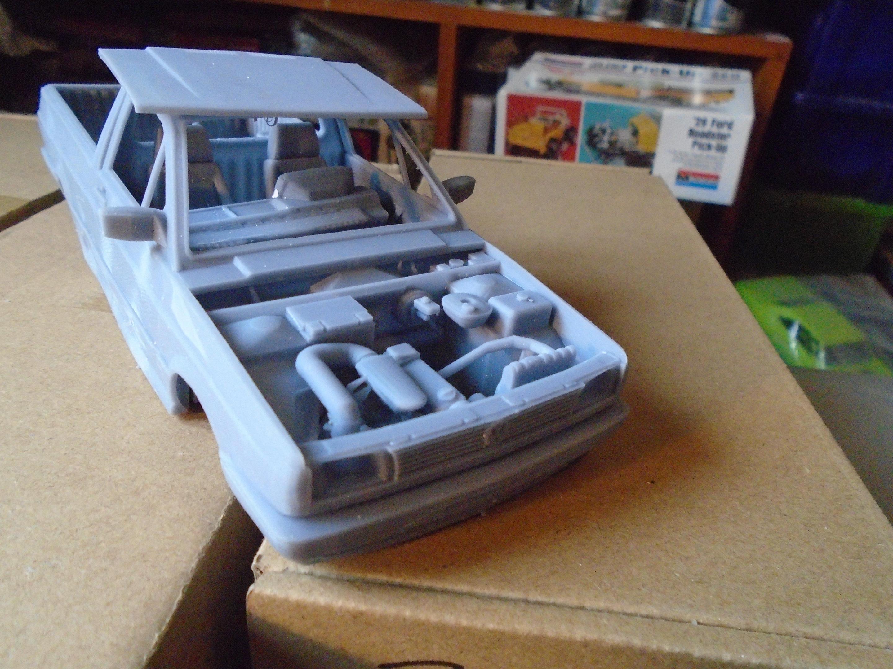

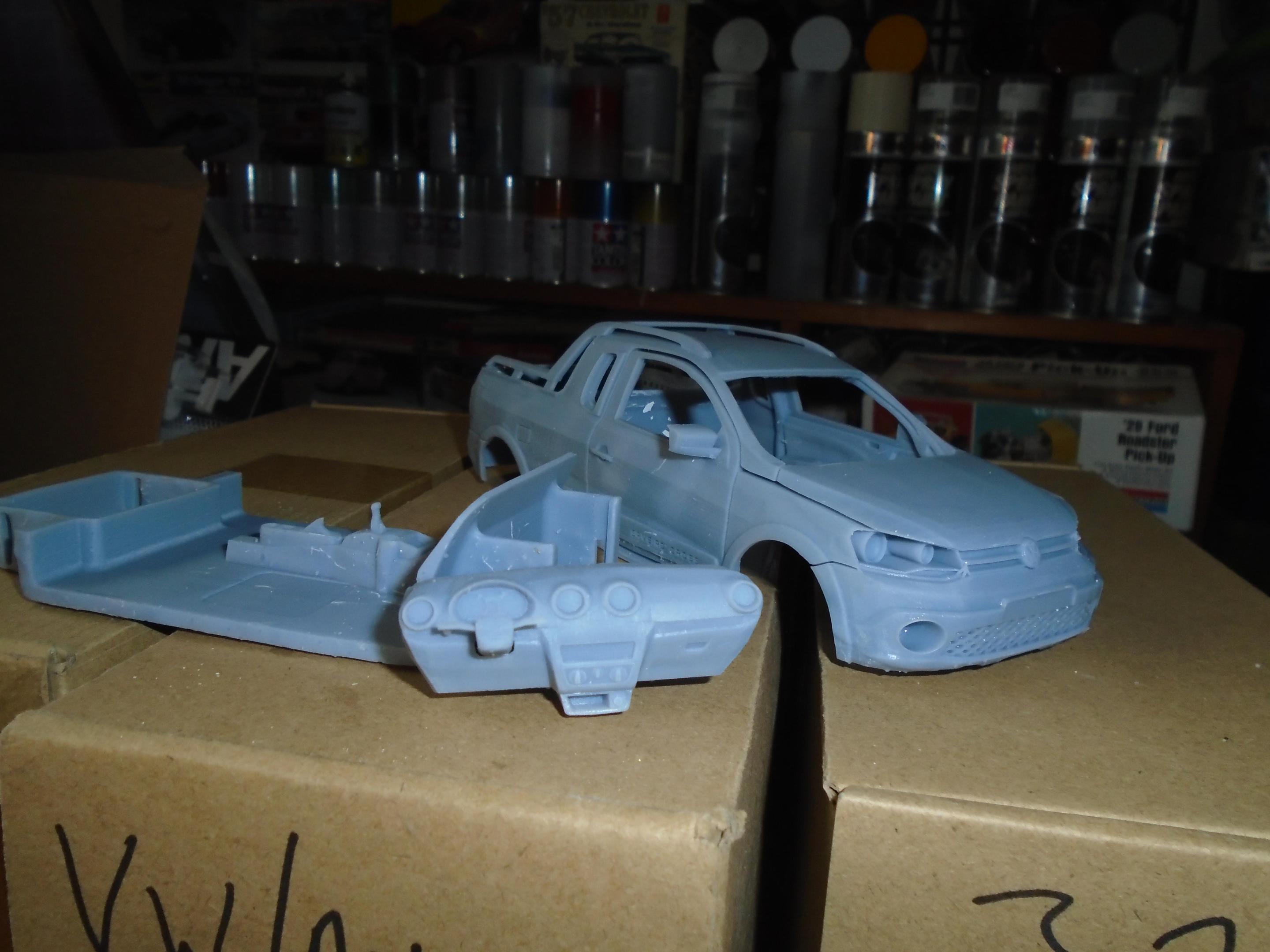

this is a saveiro g1 summer. its got an interior and underhood detail. also needs rescaled

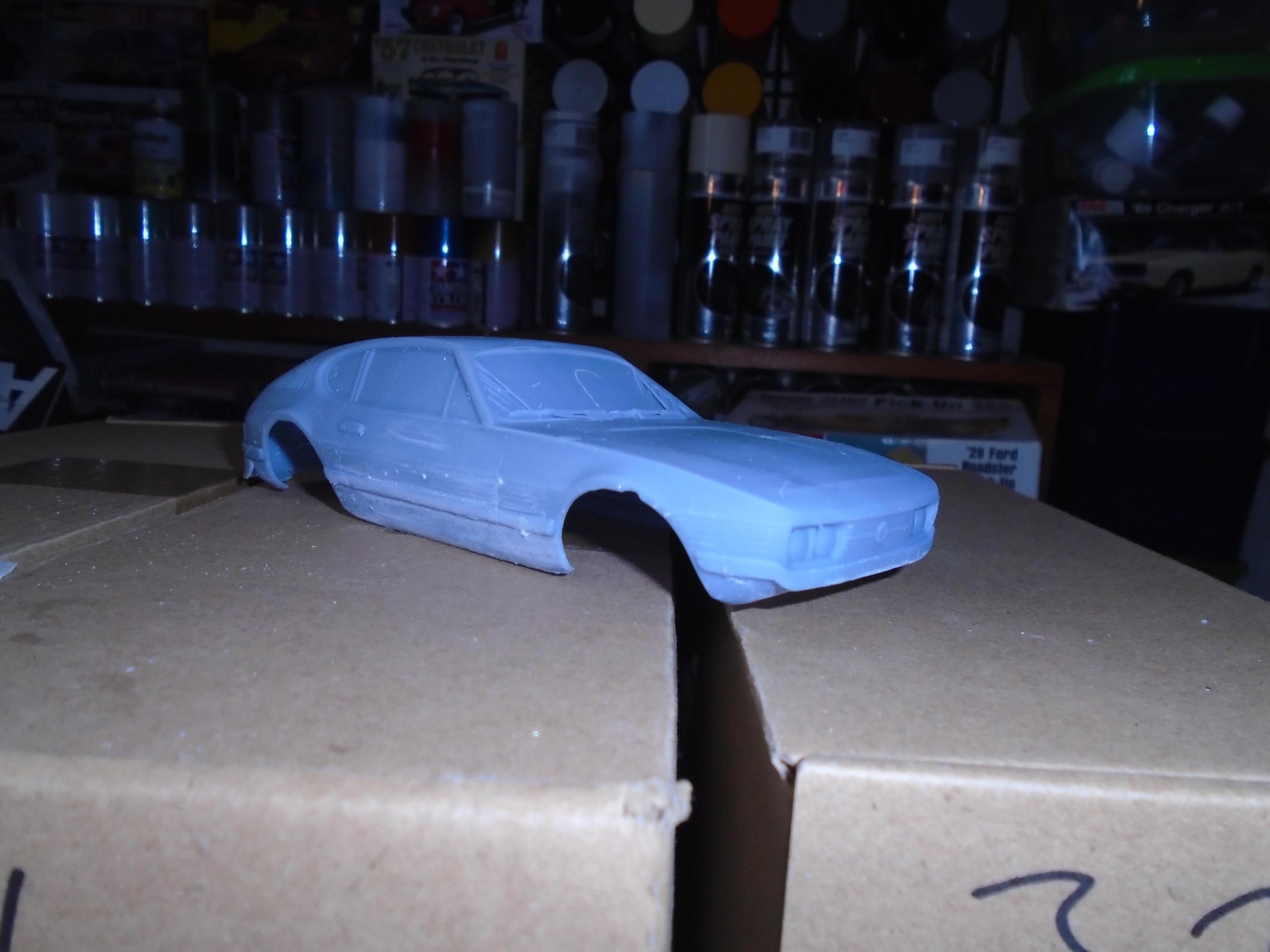

vw sp2. this is a rescaled slotcar body. there are other sp2 files but they all get the rear wheel arches completely wrong

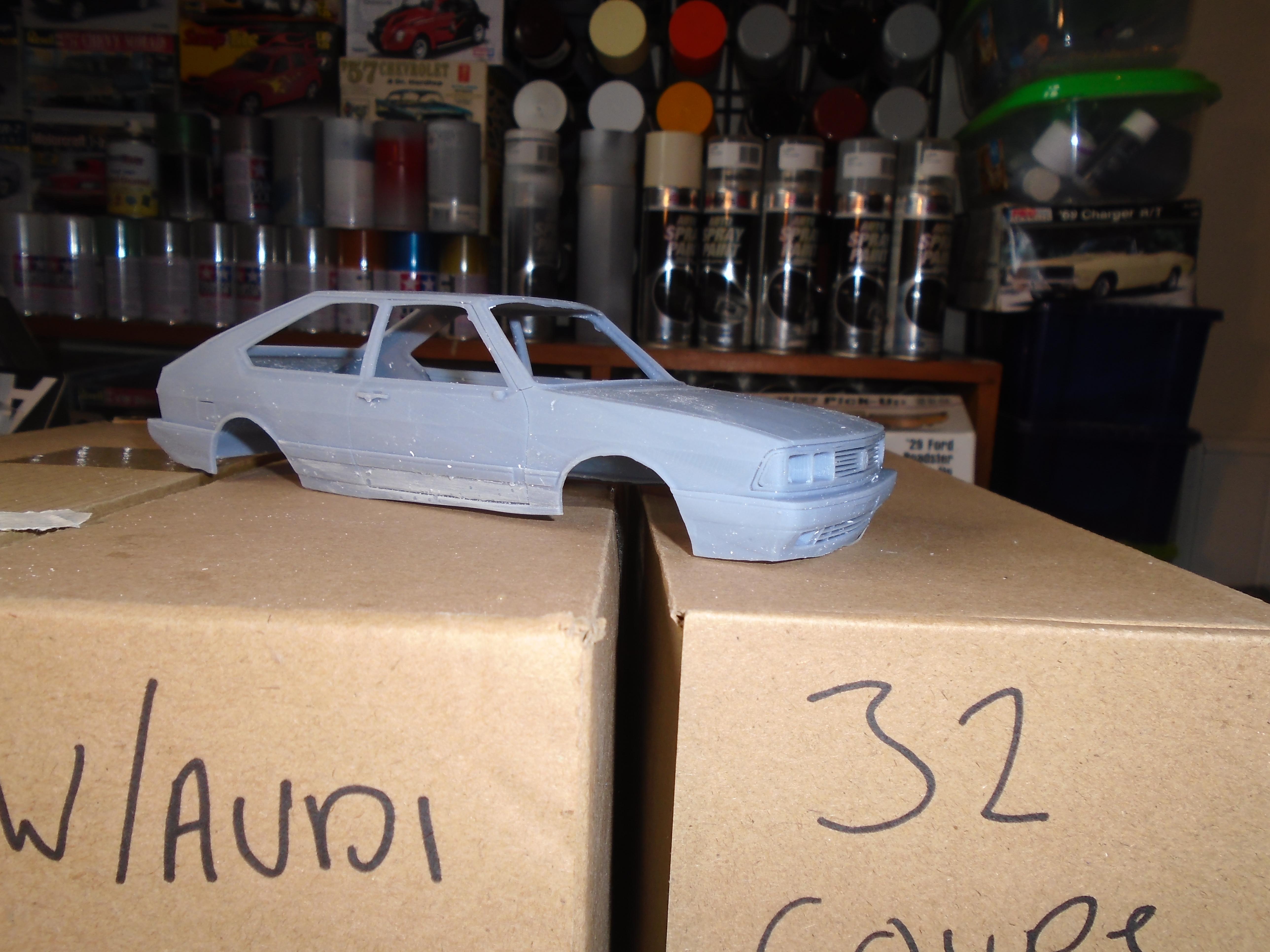

This one i got the scale right on. I've been doing a little work on it. it started a slotcar and was very blocky once printed. I spent a load of time smoothing the body and then fitted a mk1 golf arches but the body keeps breaking on me. Not a very good file but i have another to try

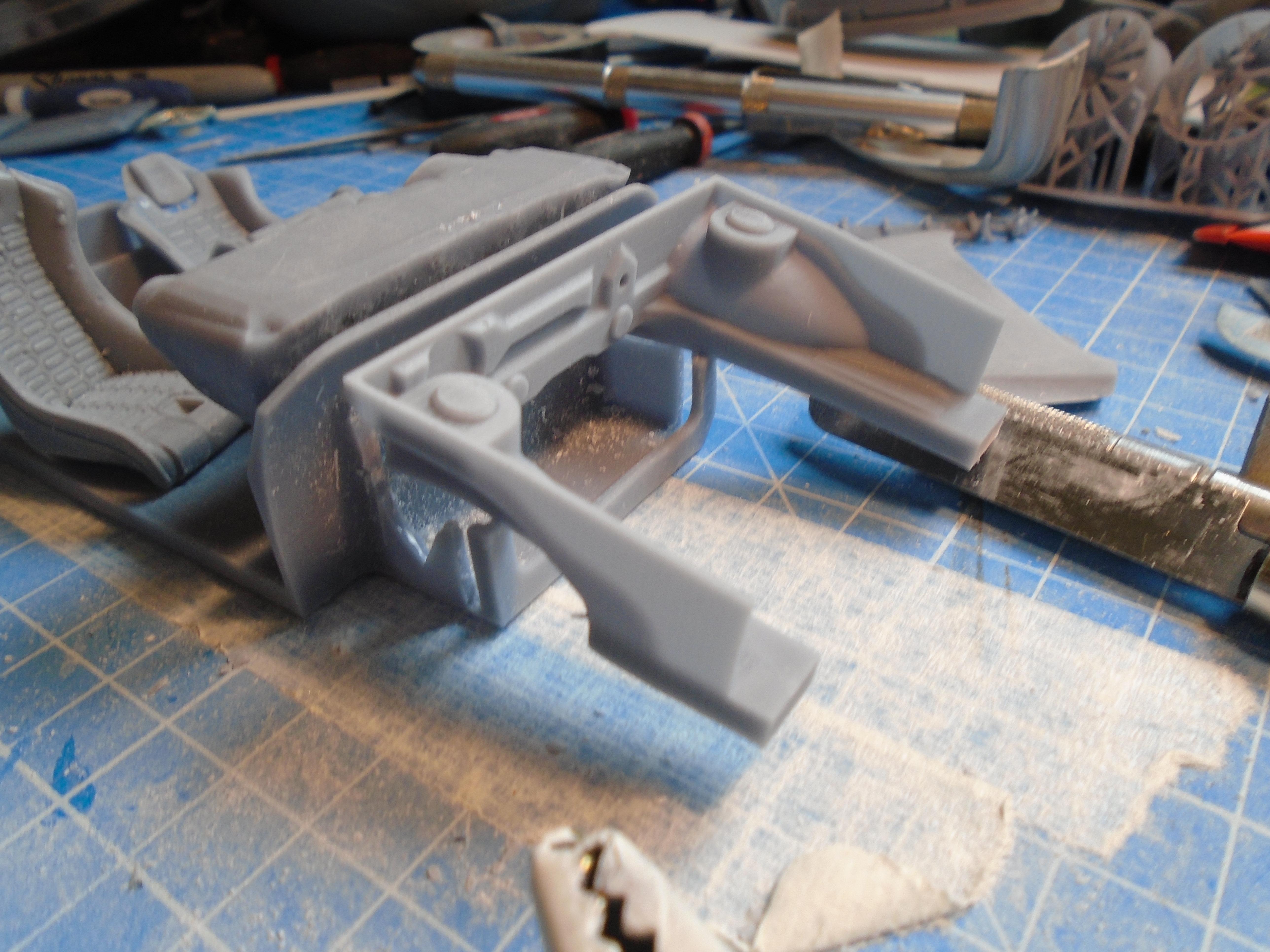

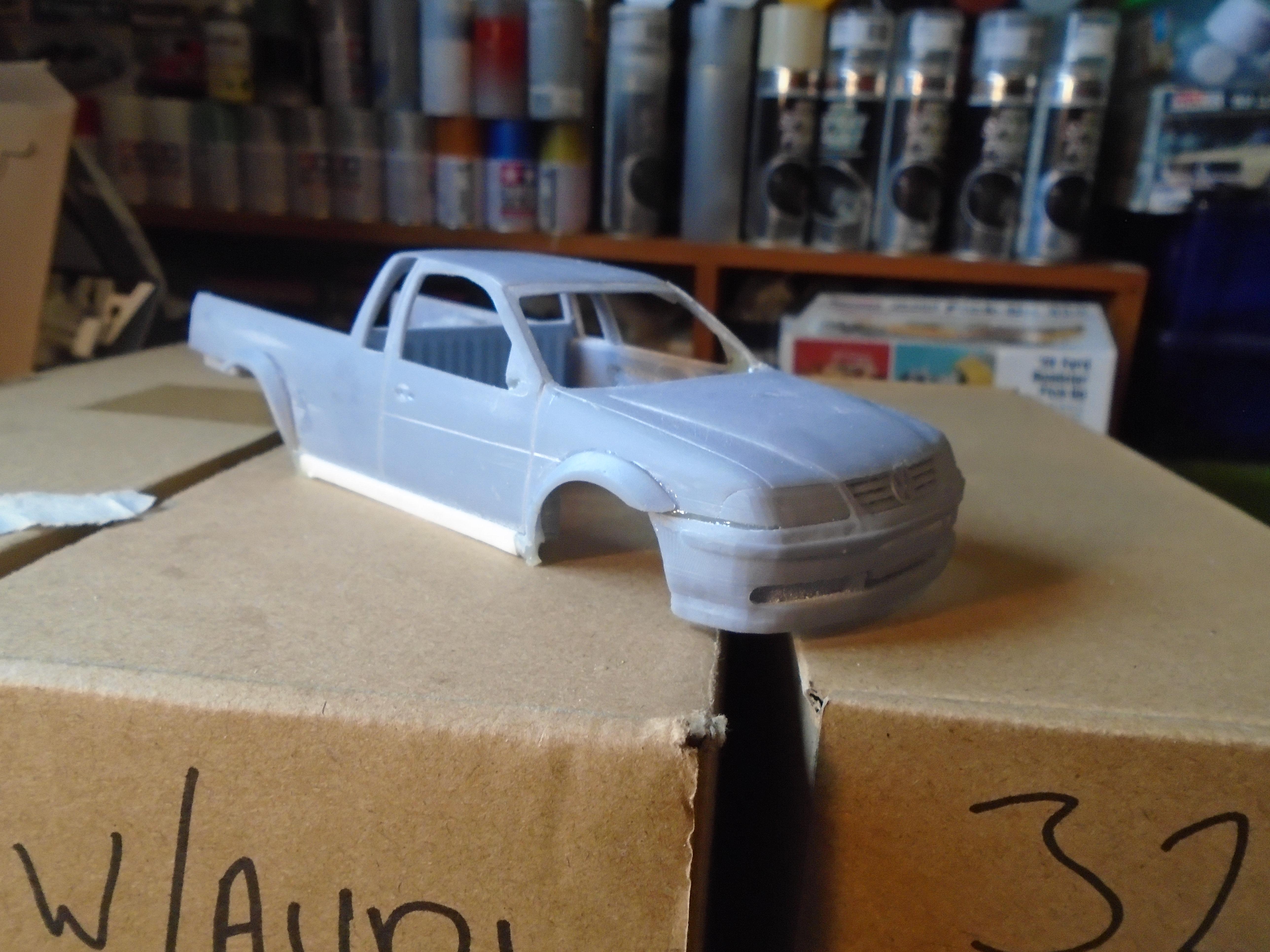

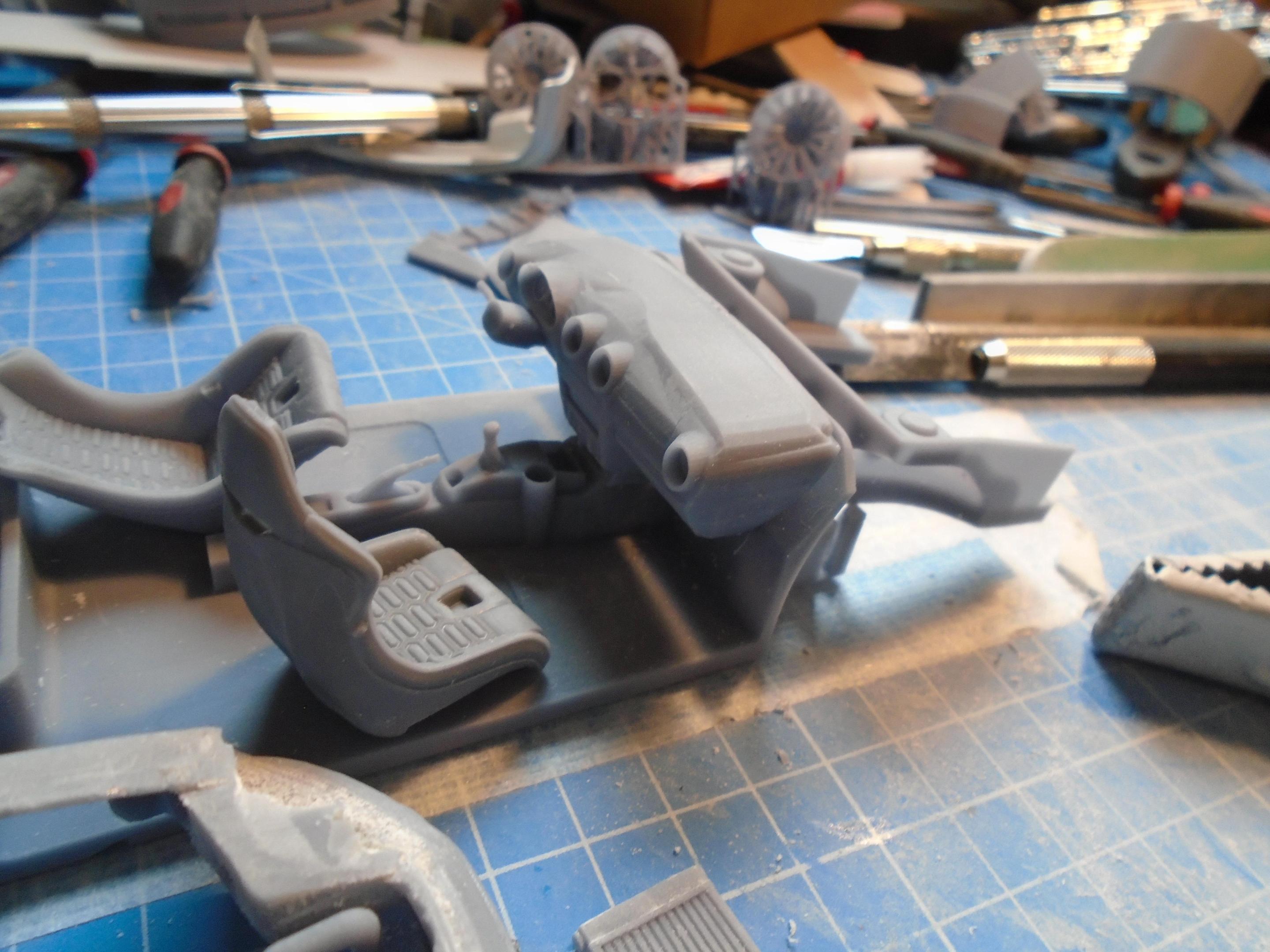

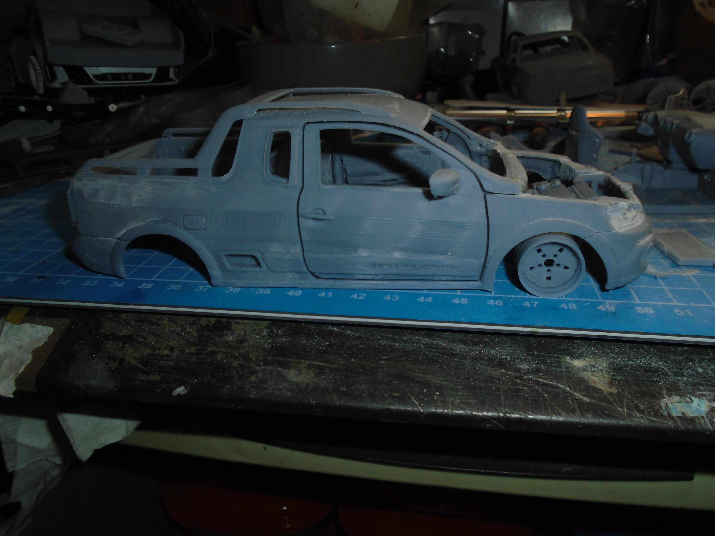

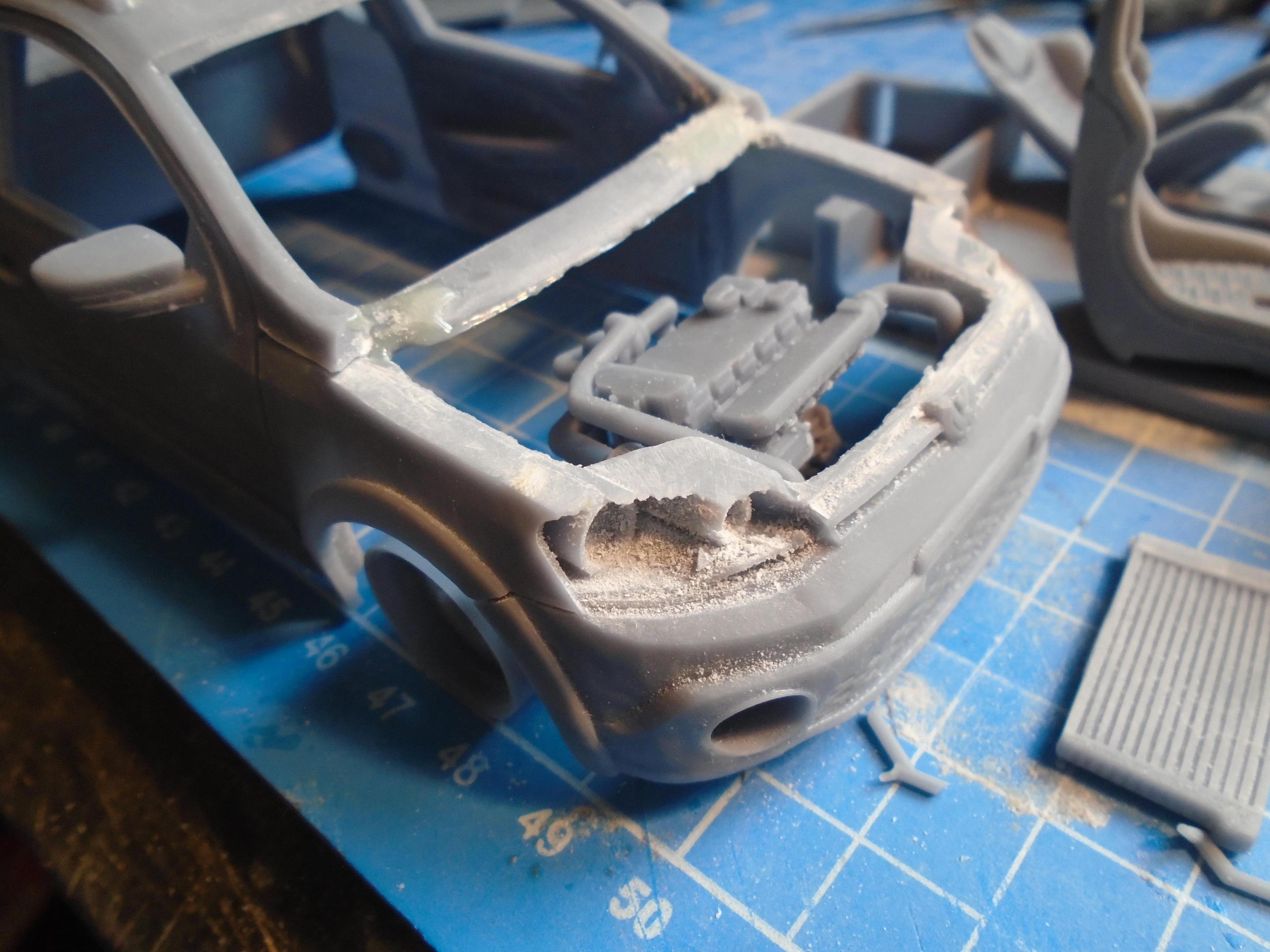

now we get to the one I'm working on currently. Its a vw saveiro g6. As you can see the body has some texture issues but the resin is easy to work with so its not really a problem. I've opened the hood and have rescaled a mk2 golf engine bay to suit. I'm using a vw 1.8t engine but since the file is one piece I'll use 2 and cut them apart to make detailing easier.  The seats I'm using are from blackboxstl and handily have the audi rs pattern. For glass since this has a convex profile I'm going to attempt to cut it from just below the shoulder on a fizzy juice bottle. I'm hoping it will keep the curve as i flatten it out. For the front suspension I'll be using some printed parts from another blackbox bodykit.

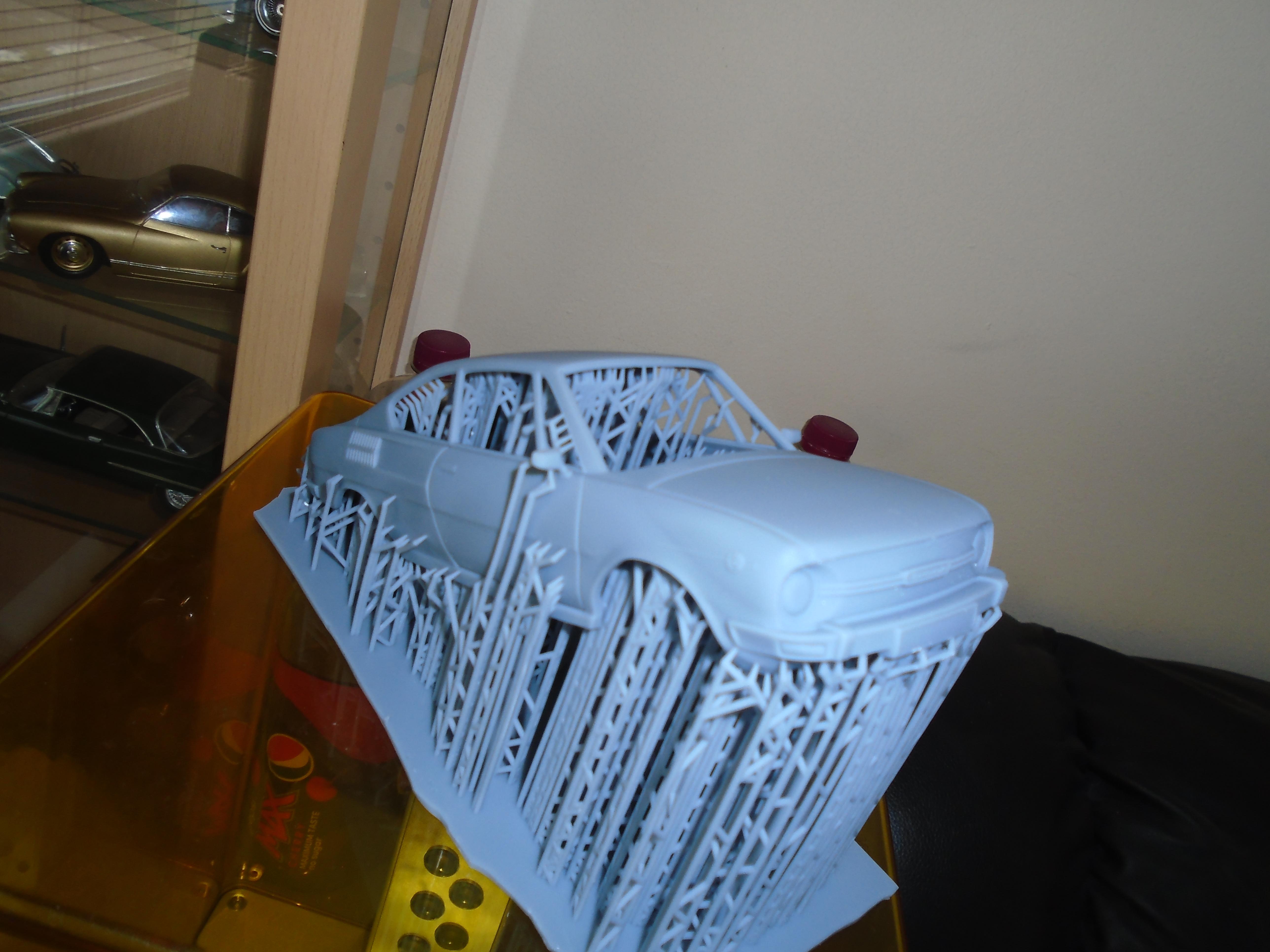

Heres last nights prints. I've included the puma gtb with the vws as the previous puma was vw based while this one is chevy opala based. It originaly came with a straight 6

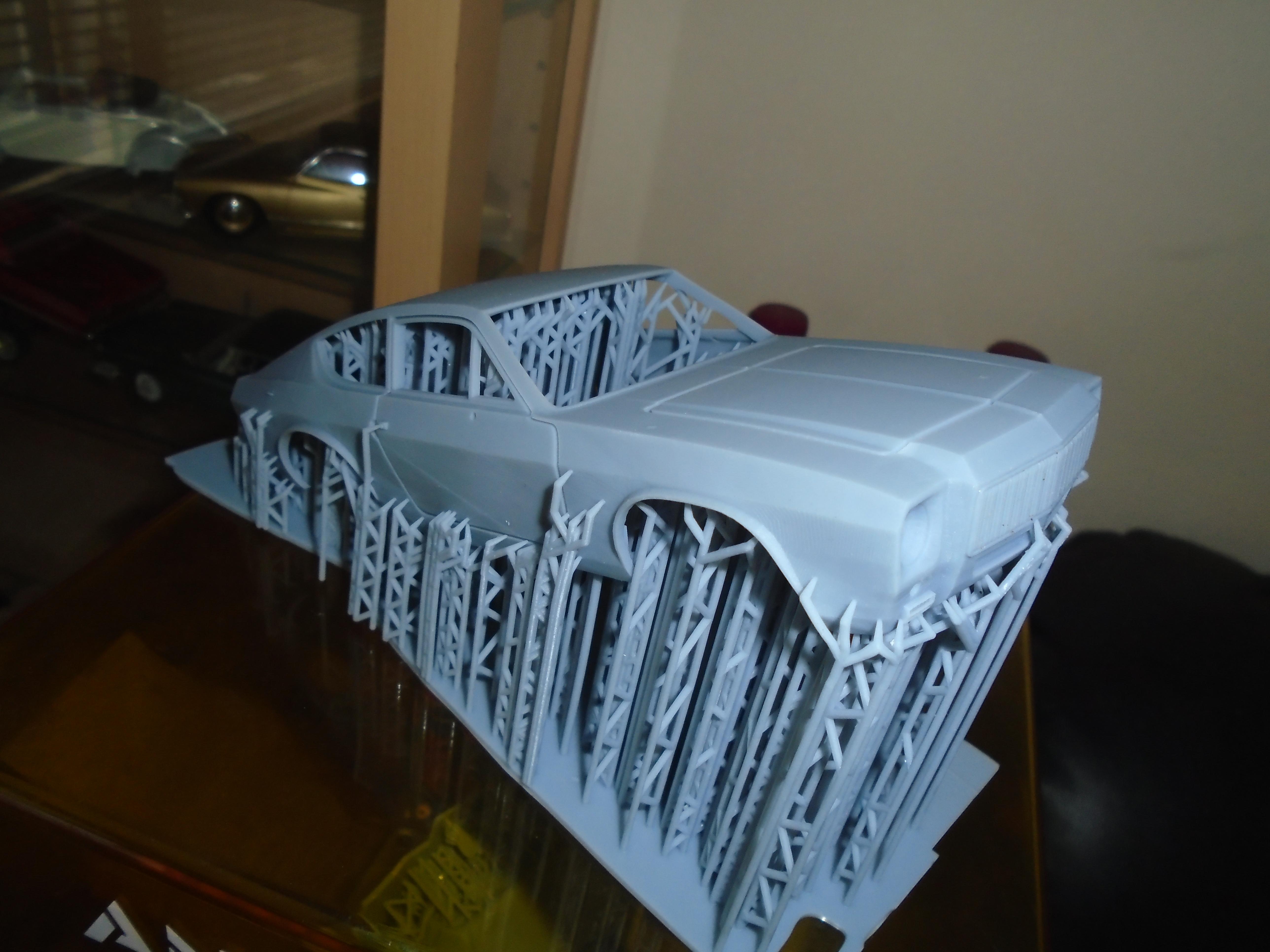

puma gte. these were built on the brasilia vw floorpans.

There's not really much difference imo. If its thin it tends to be brittle so some things need more care taken, but its easy to knock the edges down with normal model tools. The g3 pick up i've been working with has thin sides so it has broken on me a few times so its been reinforced with epoxy and styrene behind the breaks. If you can build a resin model you can easily work with 3d printed resins. You must wear a mask when sanding it though but thats just common sense really
