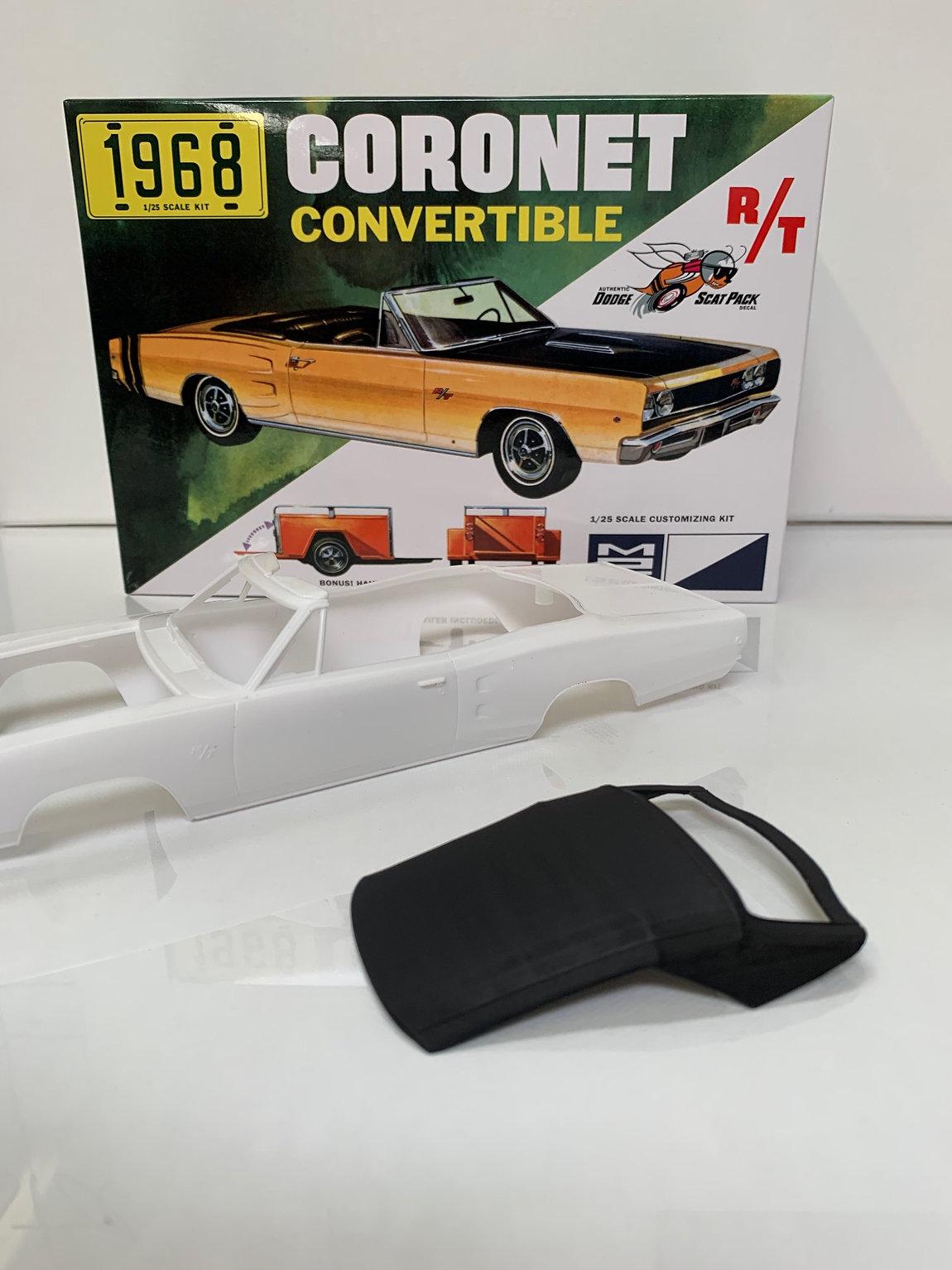

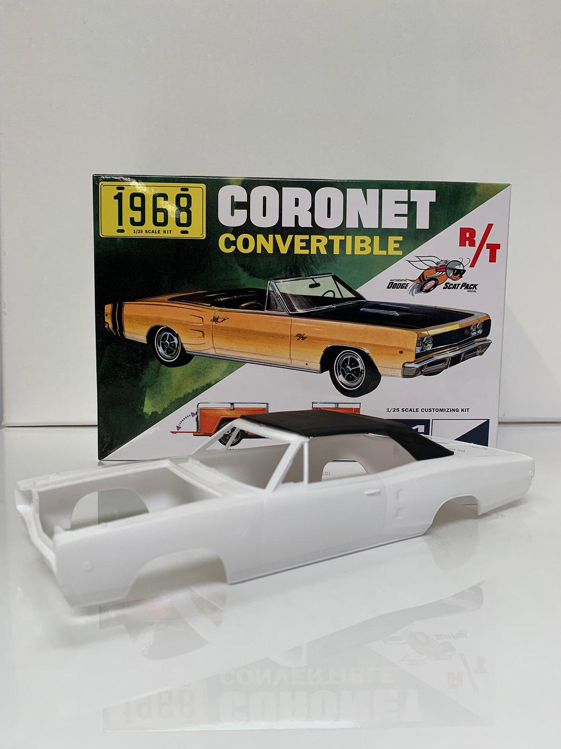

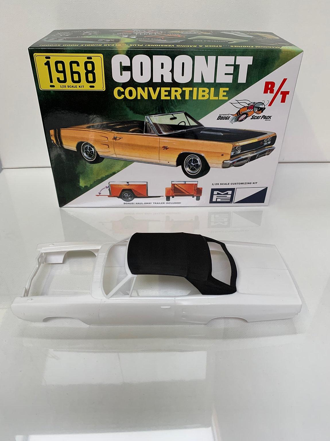

Mr mopar Posted April 15, 2023 Share Posted April 15, 2023 This is now available from 3D Scale Parts 1:25 68’ Dodge Coronet Convertible Top only. Car not included. | 3DScaleParts I just bought one ! 2 1 Quote Link to comment Share on other sites More sharing options...
1972coronet Posted April 15, 2023 Share Posted April 15, 2023 Looks nice ! Keep us posted on its fit ; I'd like one so that I can build an up-top SS/EA version (tops have to be up, along with windows). Quote Link to comment Share on other sites More sharing options...
Zoom Zoom Posted April 15, 2023 Share Posted April 15, 2023 (edited) That rear window shape for this uptop is all kinds of wrong. Just take a look at photos of the real thing. The kit's own tulip panel is wrong, shaped to fit a coupe's compound rear window contour and not the convertible's. AMT masks it somewhat by including a top boot that covers the shape. This uptop just amplifies the shape issue. Good luck making any kind of sheet plastic fit that opening. To make a correct convertible uptop is going to take effort from someone, because it requires an all-new shape of the tulip panel between the decklid and the edge of the body where the convertible top resides. Maybe someone could fix the issue and resin cast a corrected body and offer a properly fitting uptop. A correct 3D file could be created so the uptop shape is proper and would have to include a 3D printed replacement tulip panel. I'll just wait for a coupe version of this kit. I understand why AMT cloned the original as-is, flaws and all. Edited April 15, 2023 by Zoom Zoom added photo 1 Quote Link to comment Share on other sites More sharing options...
Mr mopar Posted April 15, 2023 Author Share Posted April 15, 2023 4 hours ago, Zoom Zoom said: That rear window shape for this uptop is all kinds of wrong. Just take a look at photos of the real thing. The kit's own tulip panel is wrong, shaped to fit a coupe's compound rear window contour and not the convertible's. AMT masks it somewhat by including a top boot that covers the shape. This uptop just amplifies the shape issue. Good luck making any kind of sheet plastic fit that opening. To make a correct convertible uptop is going to take effort from someone, because it requires an all-new shape of the tulip panel between the decklid and the edge of the body where the convertible top resides. Maybe someone could fix the issue and resin cast a corrected body and offer a properly fitting uptop. A correct 3D file could be created so the uptop shape is proper and would have to include a 3D printed replacement tulip panel. I'll just wait for a coupe version of this kit. I understand why AMT cloned the original as-is, flaws and all. This is an easy fix ,what makes this easy is the roof is inside the body not outside ,sure it will need some work ,I'm up for that ! Quote Link to comment Share on other sites More sharing options...

mikemodeler Posted April 16, 2023 Share Posted April 16, 2023 2 hours ago, zaina said: It’s a little on the high side. I print models as a side business and I would probably sell these for $10 plus shipping. But if you are the only one in the game and the quality is up there I guess $25 isn’t terrible. But the problem is that the uptop is misshapen (see ZoomZoom's comments above) so even if it was free, it still isn't a bargain. In addition to the rear of the piece being wrong, it appears the front doesn't meet up with the top of the windshield. 2 Quote Link to comment Share on other sites More sharing options...
