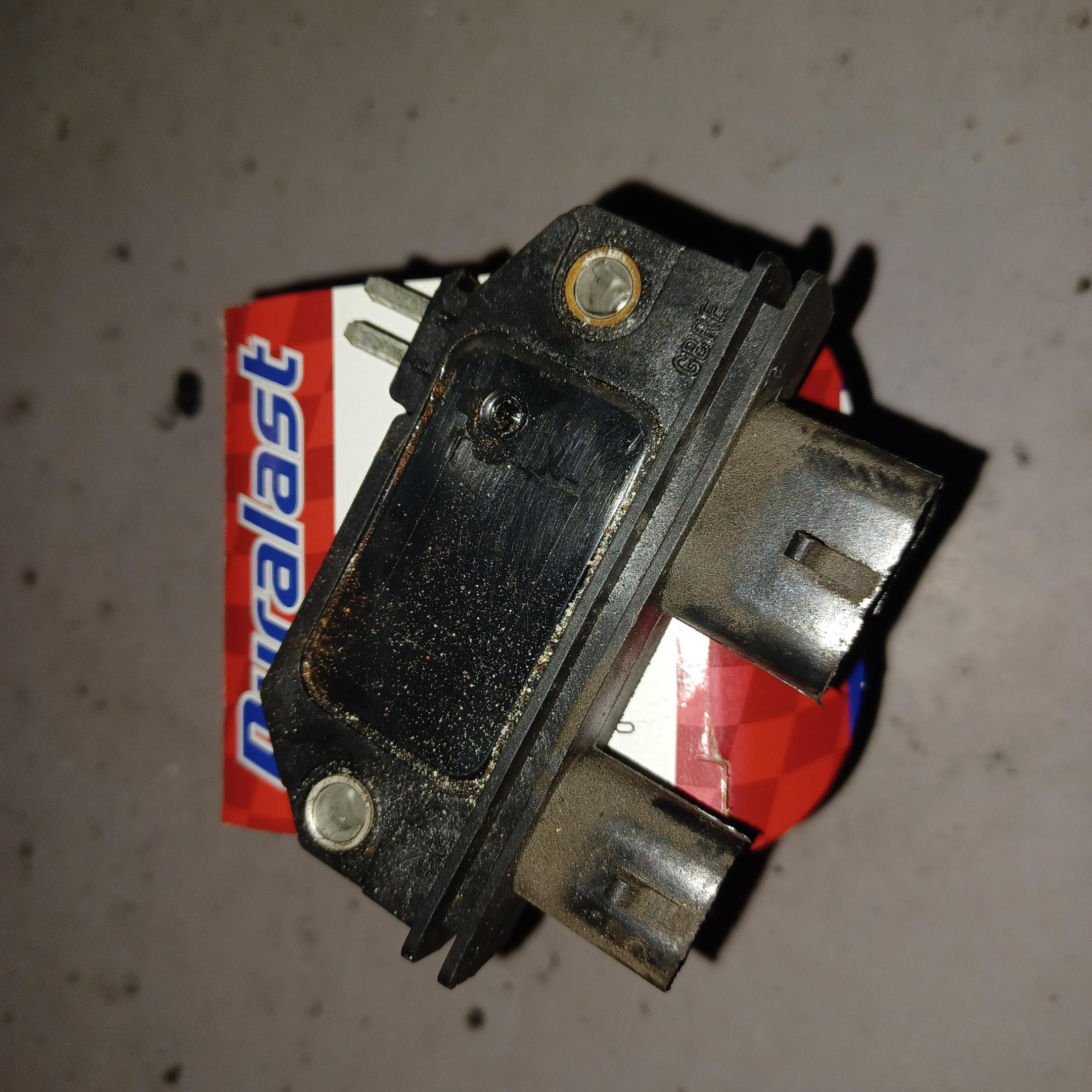

Tabbysdaddy Posted July 26, 2024 Posted July 26, 2024 I finally took the van out two days ago. It worked fine, didn't stall out, so I thought it was fixed. Took it out earlier and it died on me, right in the intersection of two six lane highways. People are horrible, like they thought I was impeding their progress on purpose. Hazards on, people still laying on the horn. I was in the left turn lane, couldn't coast to the right side because everyone has to swerve around me on both sides. So I made it to the middle lane, wait for everyone to pass, then push the beast to the right. But it was an incline, I could only go so far. More people blowing the horn, wait for it to clear, roll it backwards and make it to the right lane. Wait again, more horn blowing, push it to the shoulder. Don't want to help me, fine, I don't expect it, but blowing the horn and whizzing right next to me while I'm obviously broken down is uncalled for. I called my friend to pull me off the road into the parking lot right there. He took me to get the ICM, the second of three parts that could be the problem. The ignition coil was definitely bad anyways, the pickup coil was working, that has to be it. Swapped it on and went on my merry way.
bobss396 Posted July 26, 2024 Posted July 26, 2024 9 hours ago, Tabbysdaddy said: I finally took the van out two days ago. It worked fine, didn't stall out, so I thought it was fixed. Took it out earlier and it died on me, right in the intersection of two six lane highways. People are horrible, like they thought I was impeding their progress on purpose. Hazards on, people still laying on the horn. I was in the left turn lane, couldn't coast to the right side because everyone has to swerve around me on both sides. So I made it to the middle lane, wait for everyone to pass, then push the beast to the right. But it was an incline, I could only go so far. More people blowing the horn, wait for it to clear, roll it backwards and make it to the right lane. Wait again, more horn blowing, push it to the shoulder. Don't want to help me, fine, I don't expect it, but blowing the horn and whizzing right next to me while I'm obviously broken down is uncalled for. I called my friend to pull me off the road into the parking lot right there. He took me to get the ICM, the second of three parts that could be the problem. The ignition coil was definitely bad anyways, the pickup coil was working, that has to be it. Swapped it on and went on my merry way. I have had 2 of them go bad on me over the years. They would do a variety of things, carp out completely while driving. I'd wait a few minutes and it would start again, go 200 yards, rinse repeat. I had another, if the car was running and shut off for less than 15 minutes, it would start up. Past that, I'd have to wait 2+ hours for it to start again. I planned my errands accordingly. 1

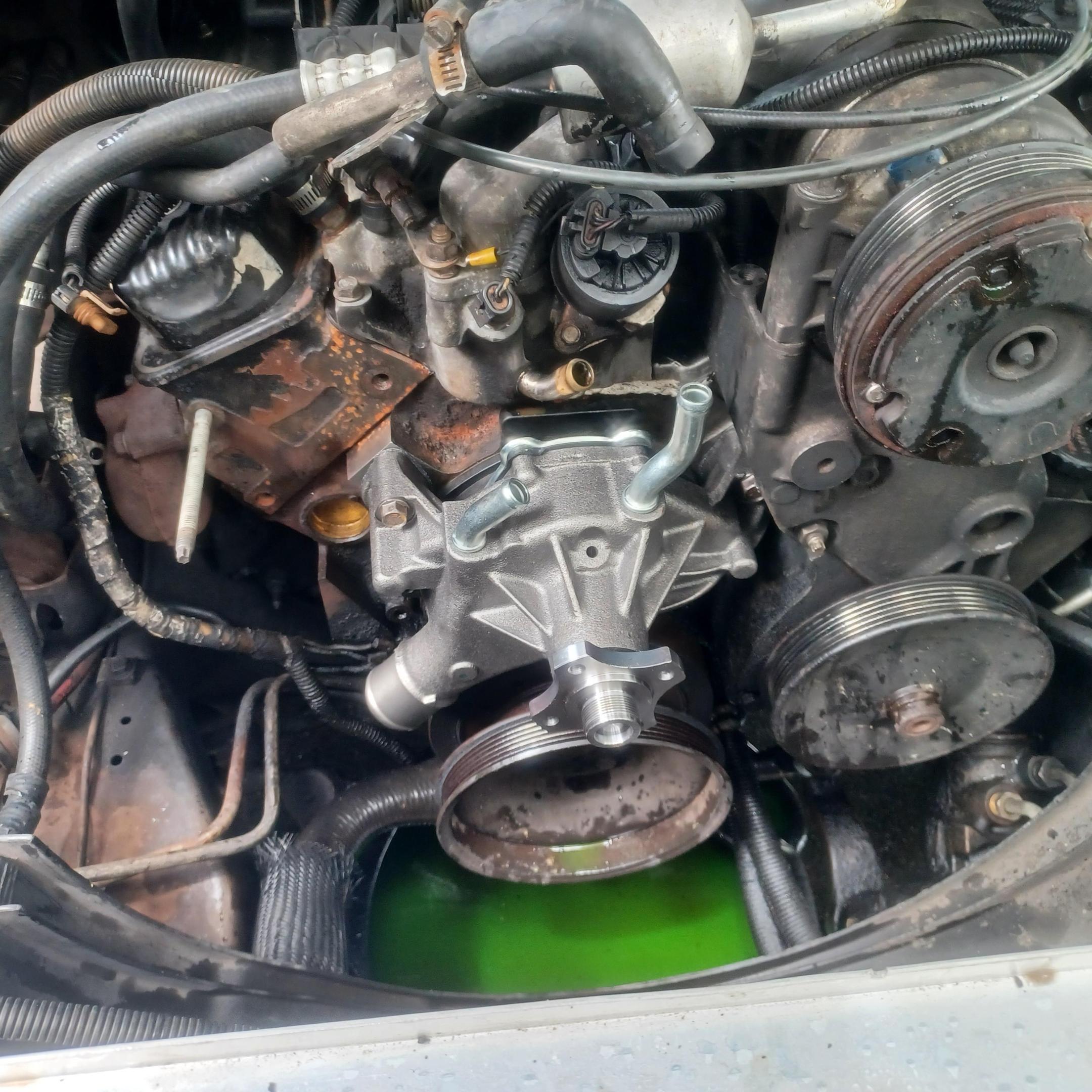

Tabbysdaddy Posted July 28, 2024 Posted July 28, 2024 Of course after all that work on the truck the water pump started leaking. I've been checking the coolant level regularly and it has been dropping slightly, my wife parks on the slab so I saw a pool under it today. It was only 4 years old.

bobss396 Posted July 29, 2024 Posted July 29, 2024 16 hours ago, Tabbysdaddy said: Of course after all that work on the truck the water pump started leaking. I've been checking the coolant level regularly and it has been dropping slightly, my wife parks on the slab so I saw a pool under it today. It was only 4 years old. Hate when that happens. Prestone used to sell a "flush" kit, so I used one on my '67 Chevy back around 1975. It seemed to wash out the water pump seal, pretty embarrassing to have happen in a friend's driveway. 1

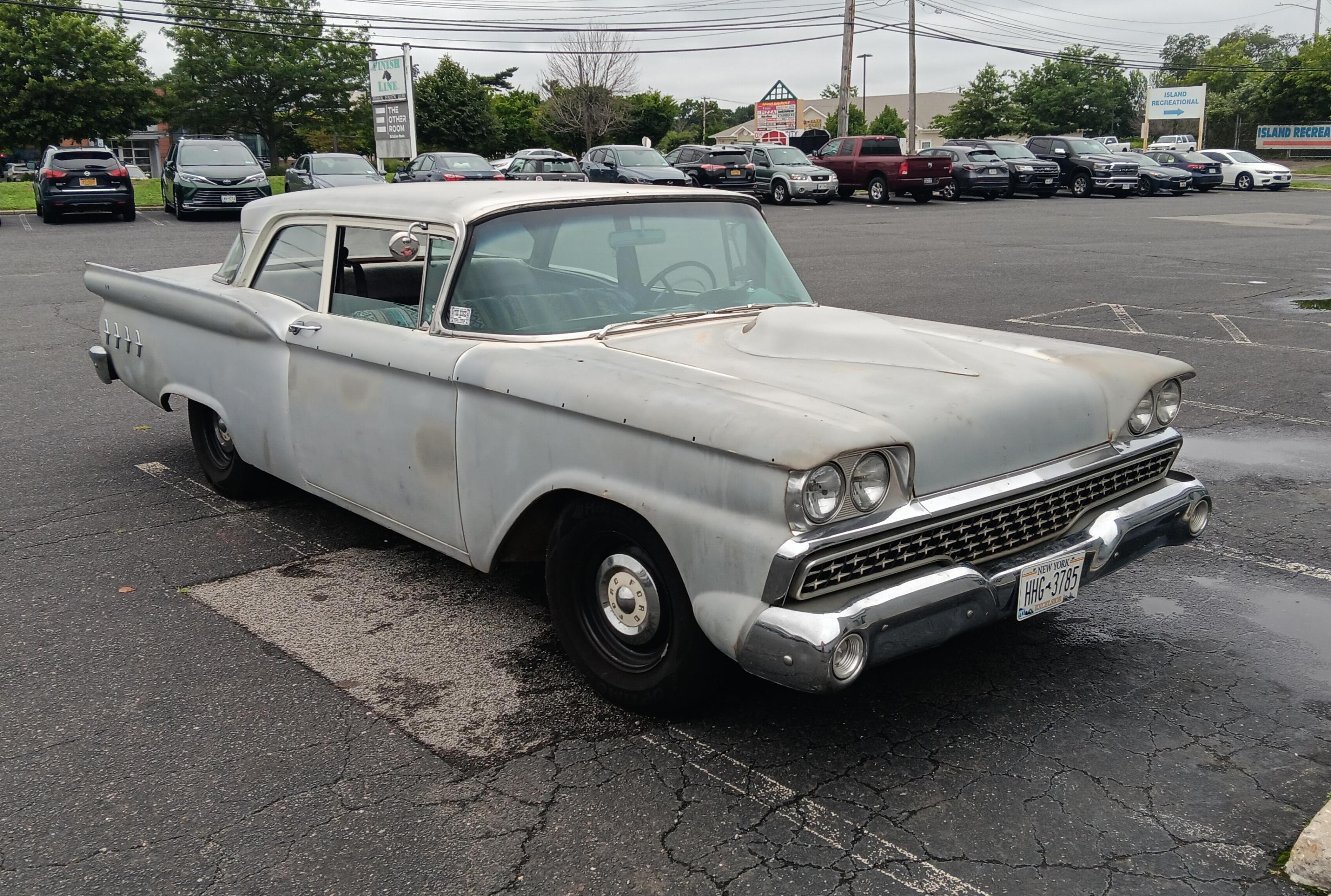

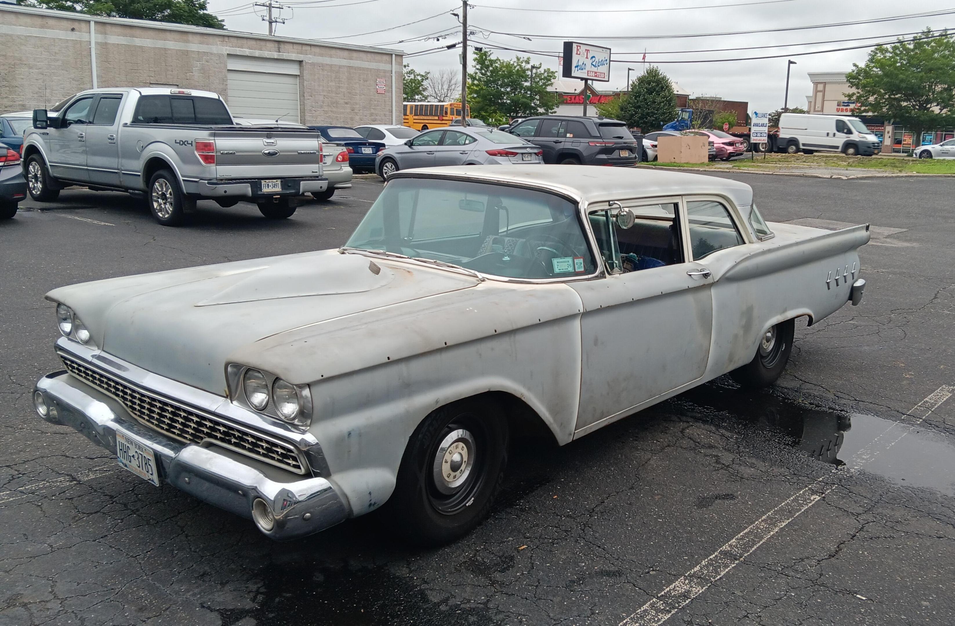

bobss396 Posted August 11, 2024 Posted August 11, 2024 The Ford was up for inspection. Haven't had it out since June. Once it cools more I'll drive it quite a bit. 6

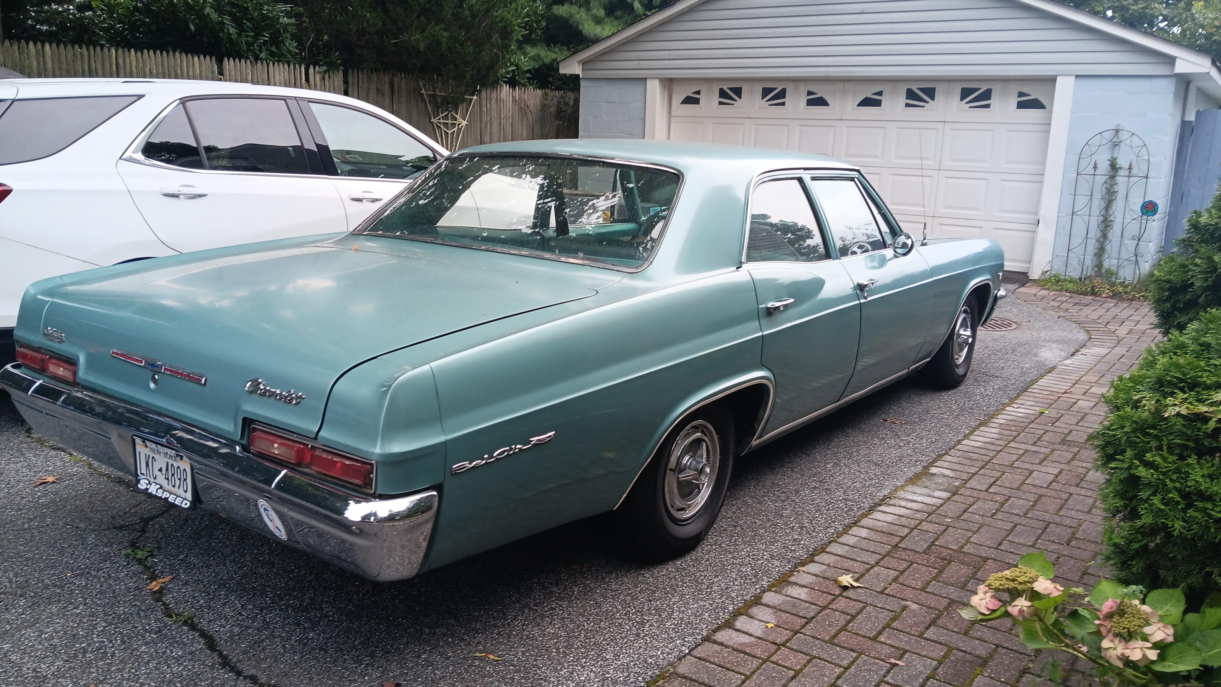

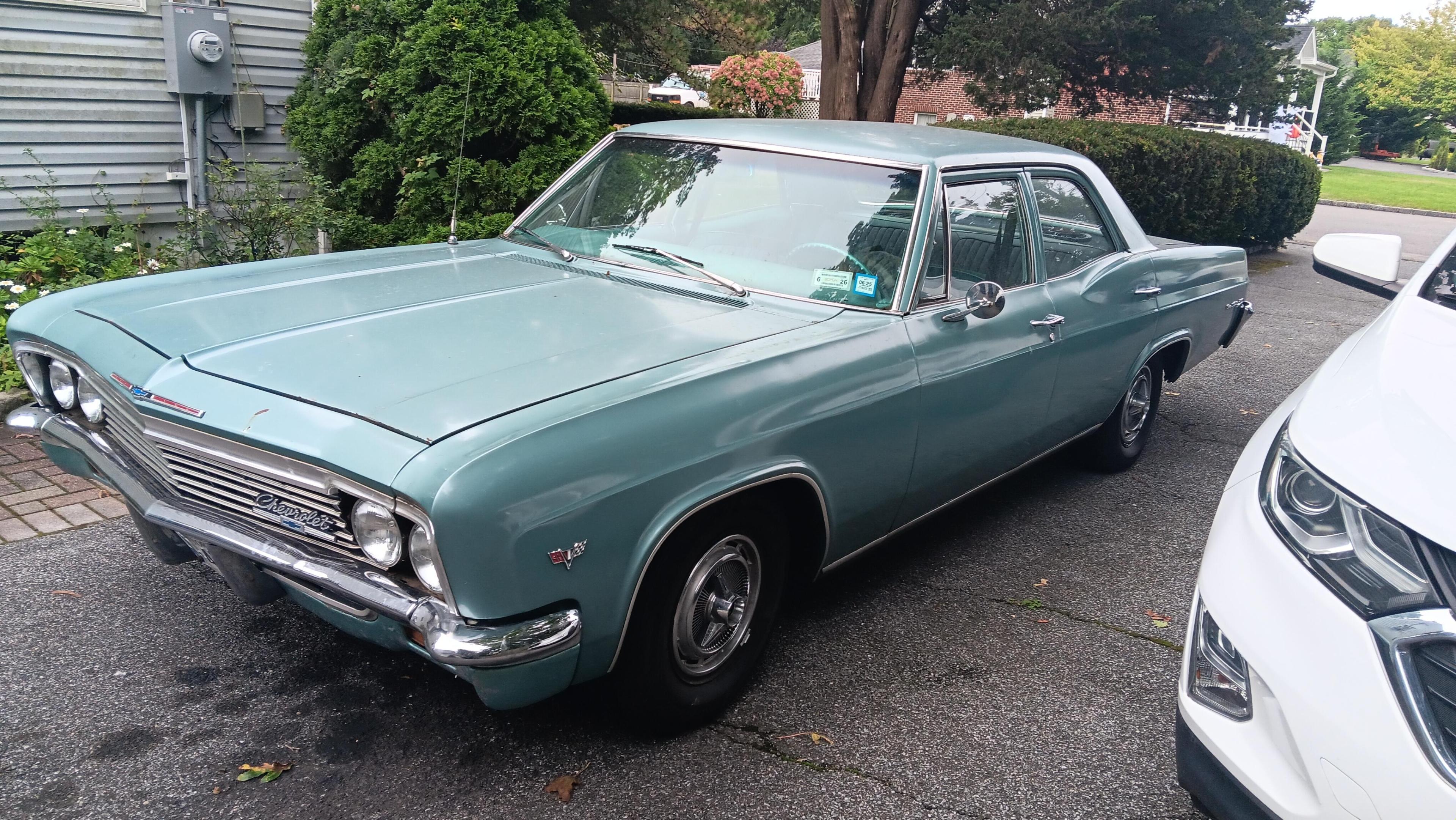

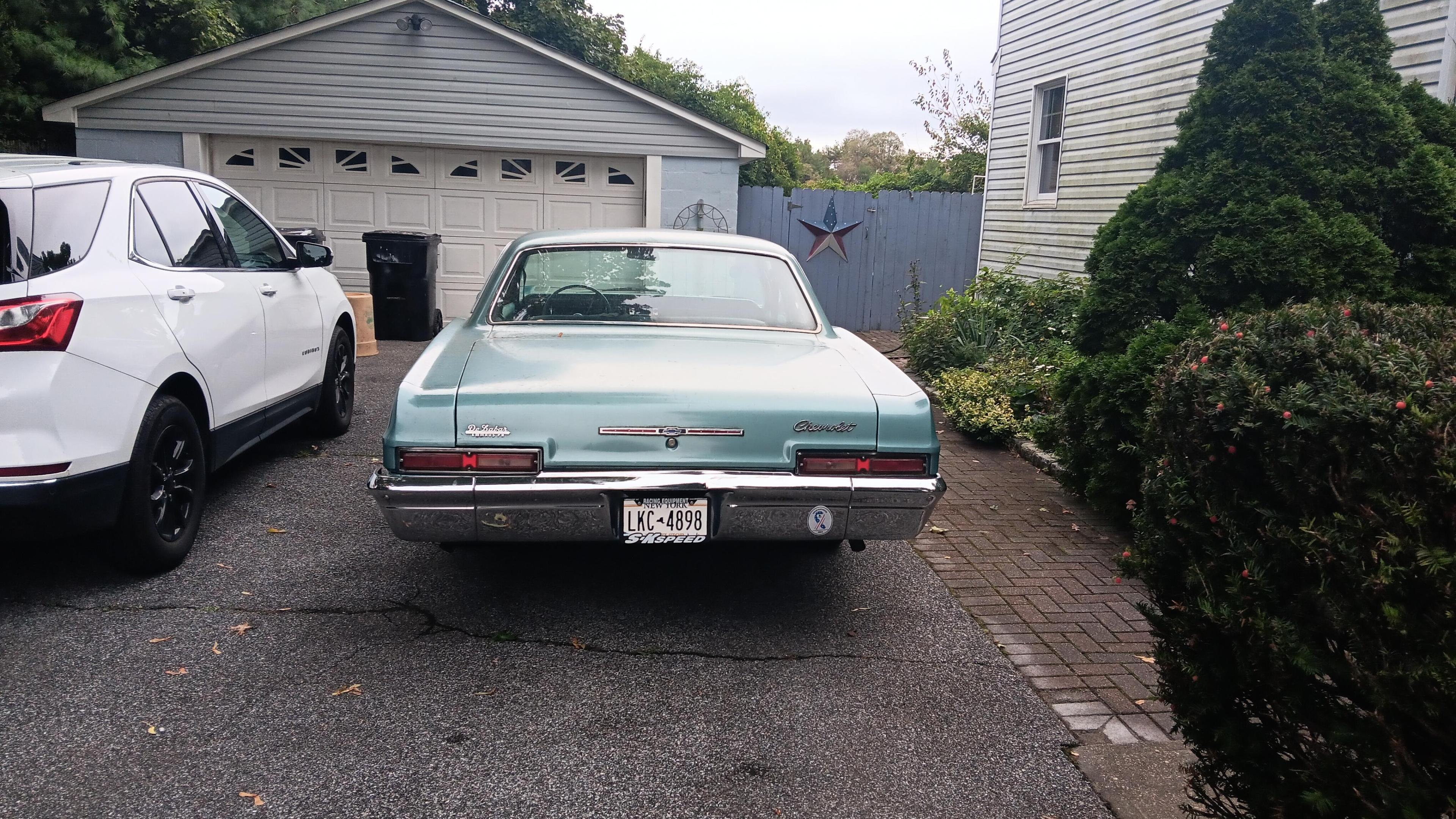

bobss396 Posted September 30, 2024 Posted September 30, 2024 Spent the last few days putting all new springs in the Belair at a friend's shop. The caveat was that it had to be done and out by Monday morning. We finished at noon on Sunday. The rears we did on Friday after hours. My brother showed up and ran with it.. he was a huge help. Saturday we tackled the fronts. Despite having the lift, spring compressors and every tool under the sun, we got ONE side done in 4.5 hours. And it sat a mile high.. I made the decision to take it out and lop 2 coils out of it. Much better! Sunday, the 2nd one took 2 hours flat. To get the strut rod nuts loose, this required the blue wrench. I have a bad cut on one finger, a large bruise on my chest, no hair on one hand and a few scrapes on my head. But it rides much better. Threw some front end parts into it plus new shocks. I'll have the use of a rack soon so I can align it. 3

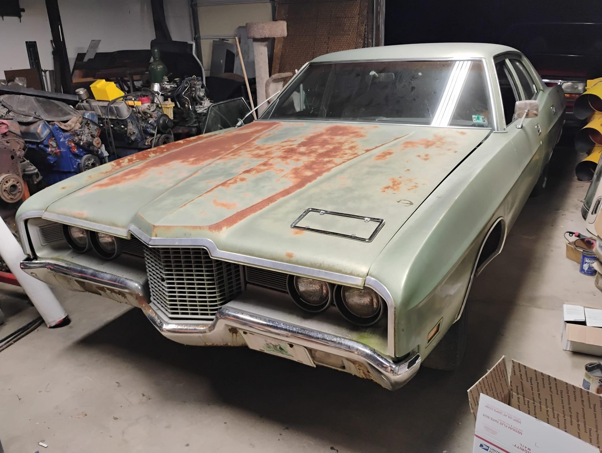

Sledsel Posted September 30, 2024 Posted September 30, 2024 Just pulled this one in the garage for an engine swap. 6

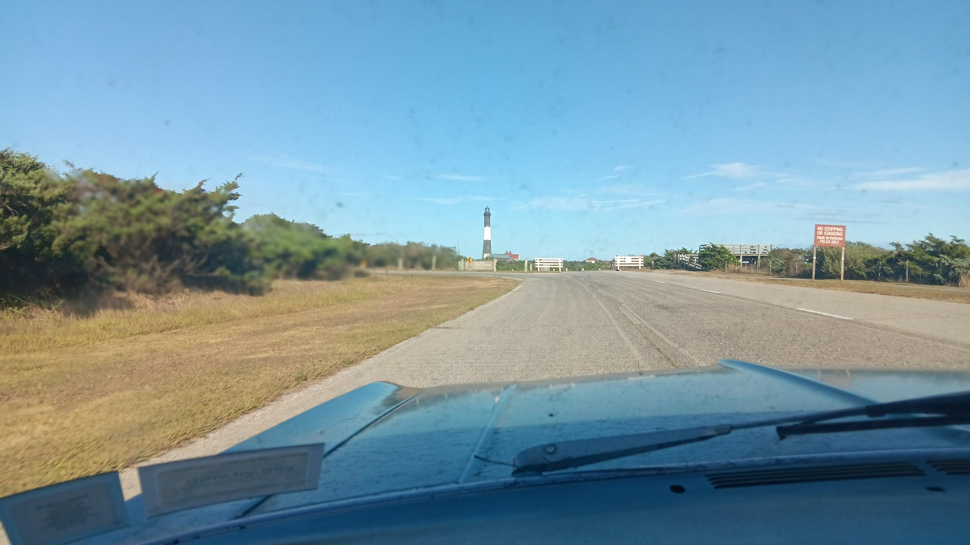

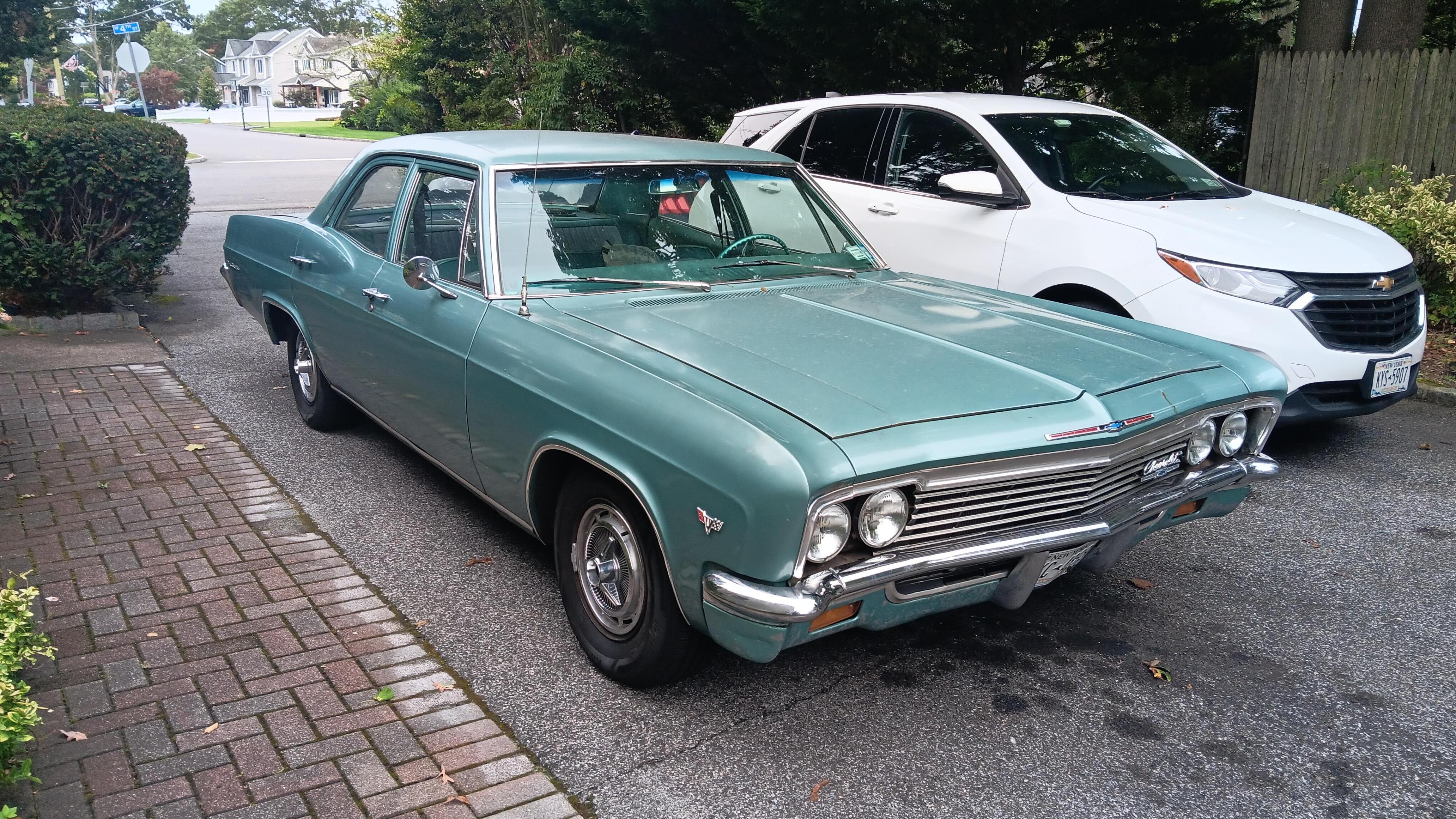

bobss396 Posted October 1, 2024 Posted October 1, 2024 The Belair had a pull to the left. I adjusted the caster on the driver side via the strut rod. Now it goes straight. Photo is by the Fire Island lighthouse, 10 miles from home. 2

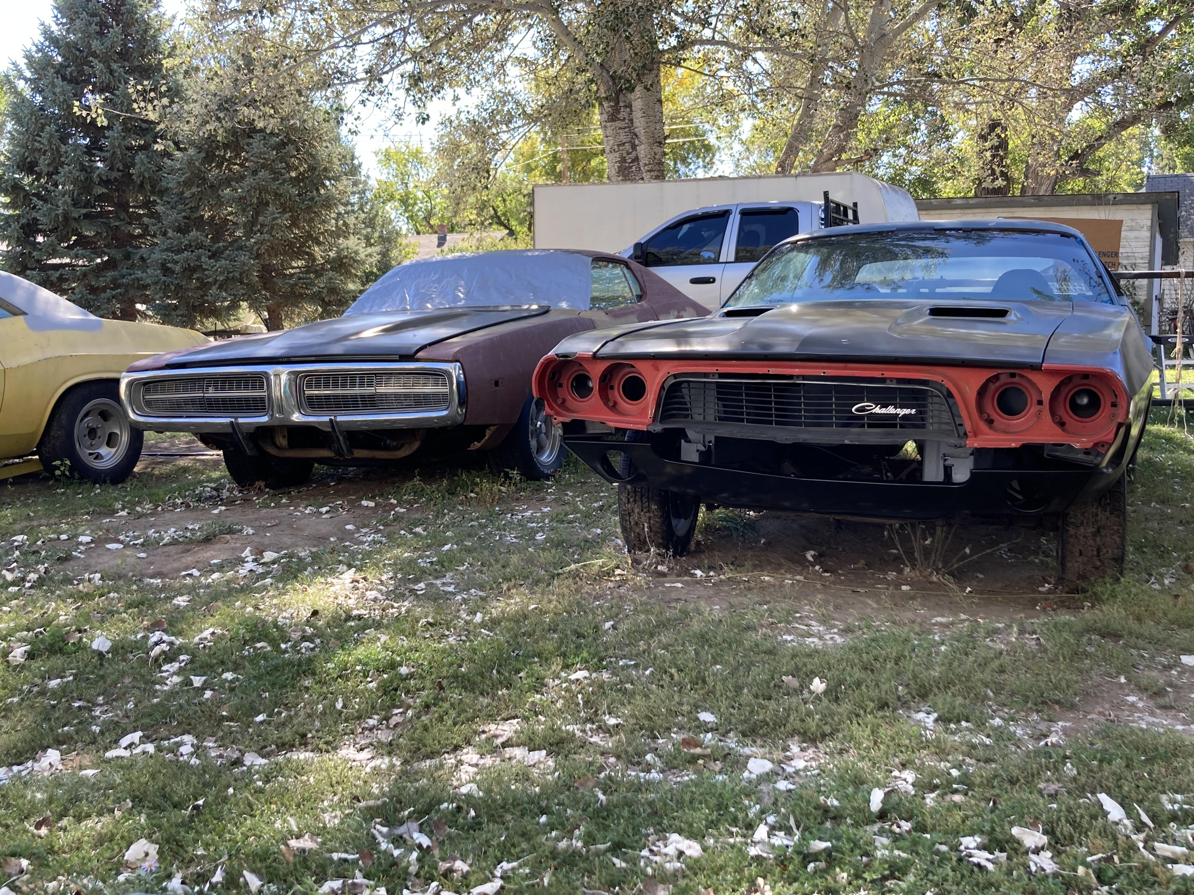

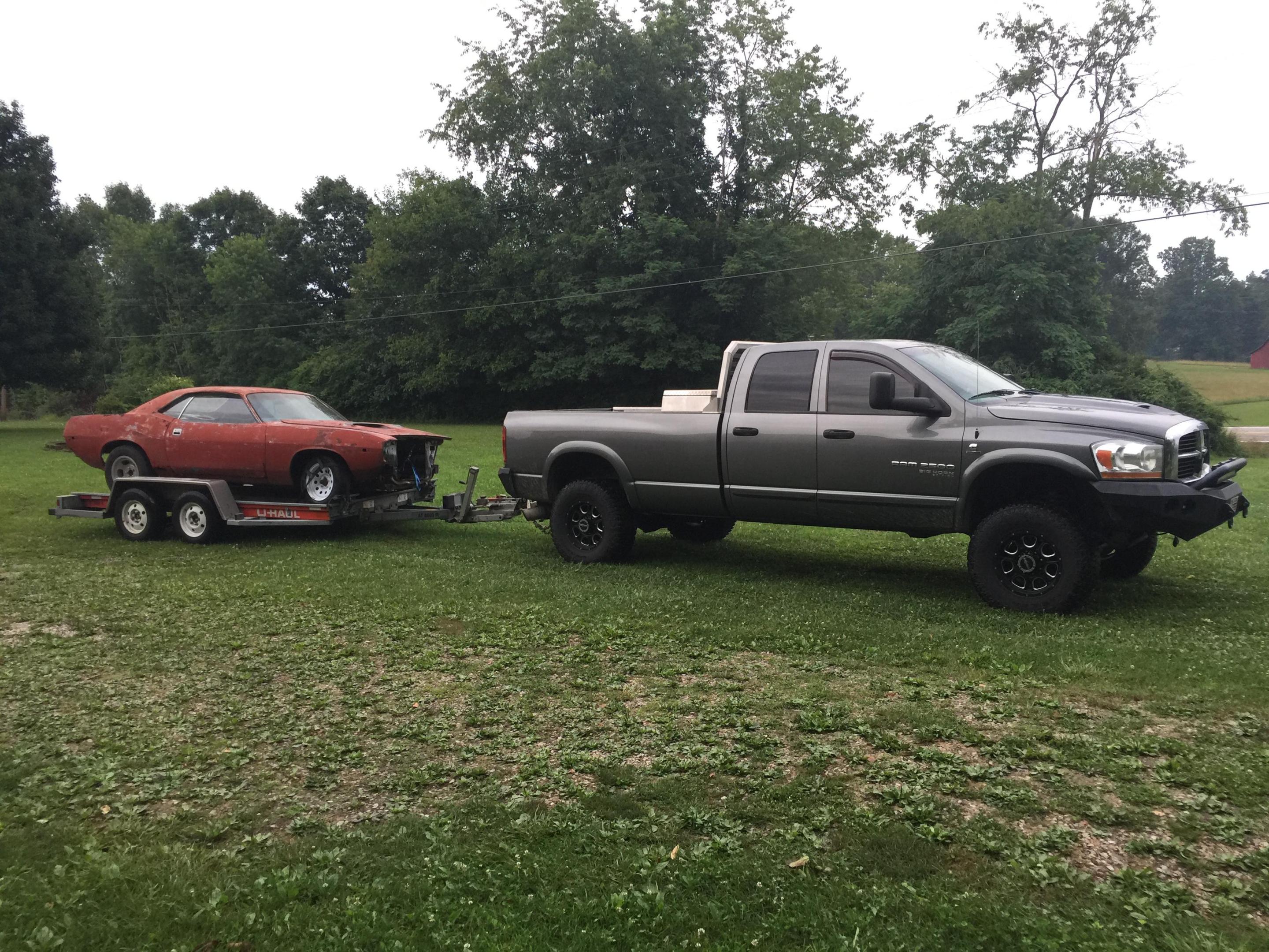

Old Buckaroo Posted December 6, 2024 Posted December 6, 2024 Now this is his collection of Mopar's that Ive been assigned to turn back into daily drivers. Not doing full on restorations but getting them back to where he can sell them to his service buddies and they can drive them and tinker with them as they like. Yellow Challenger 74 with 360 auto , 72 Charger 440 Auto, 72 Challenger 440 4 spd, 72 Cuda 340 Auto 5

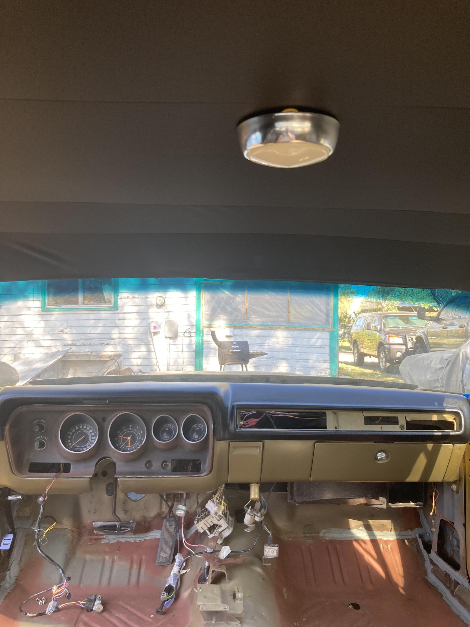

Old Buckaroo Posted December 6, 2024 Posted December 6, 2024 (edited) The work I'm doing besides getting them to move on their own power consists of replacing rusted areas with patch panels (minimal here in Montana) repairing dents, replacing bad body work ect ect . Cleaning and re seaming body panels, interiors are getting new headliners, carpet and seat upholstery. Engines are freshened up with the heads redone, new gaskets all around and auto trans are getting B&M shift kits. He keeps me busy. Our mission is to take these neglected , stripped of parts and turn them back into affordable drivers for those who love the muscle car era but can not afford a full resto car ( think military pay). Getting them back on the road is whats important. Edited December 6, 2024 by Old Buckaroo 2

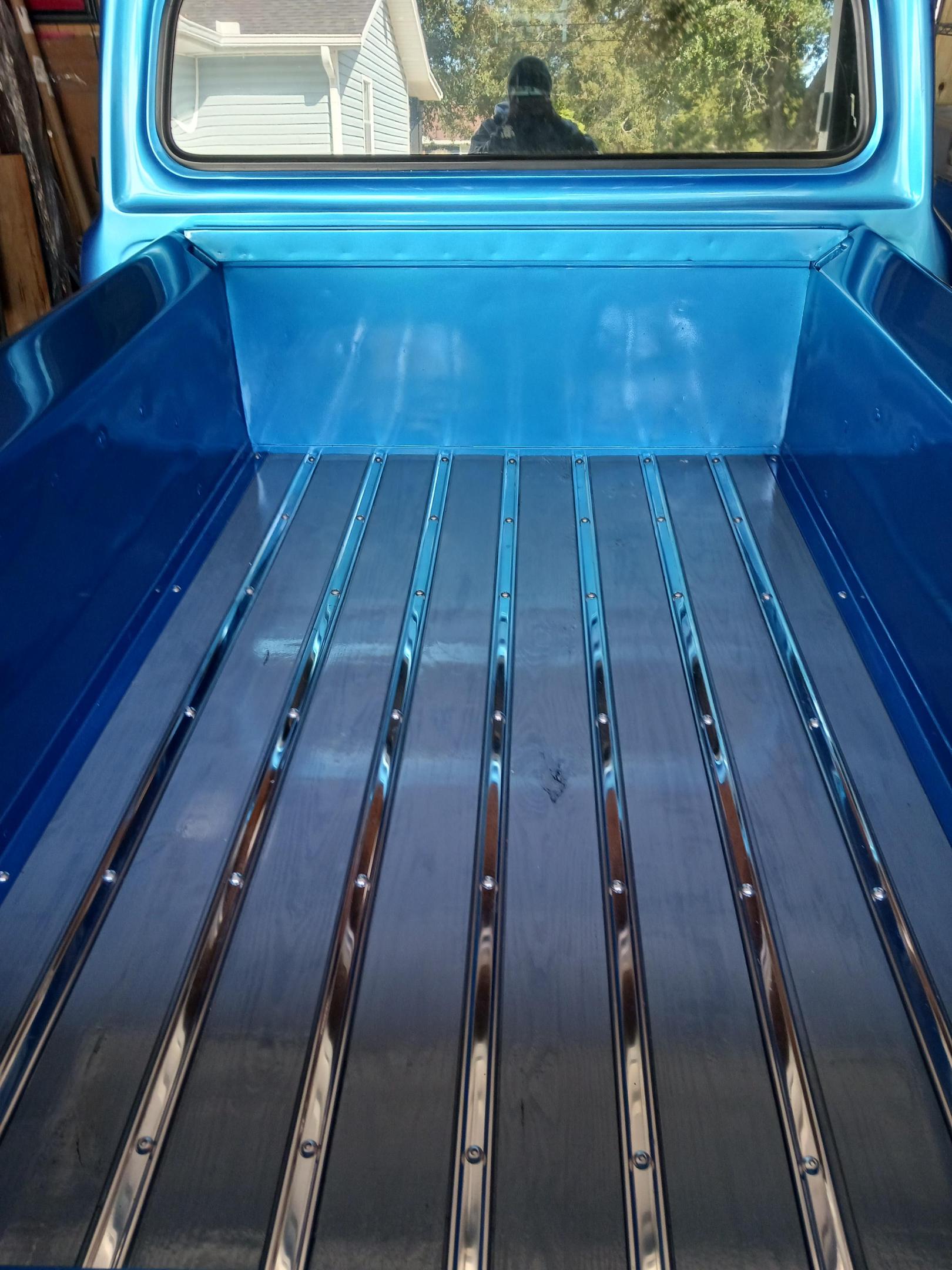

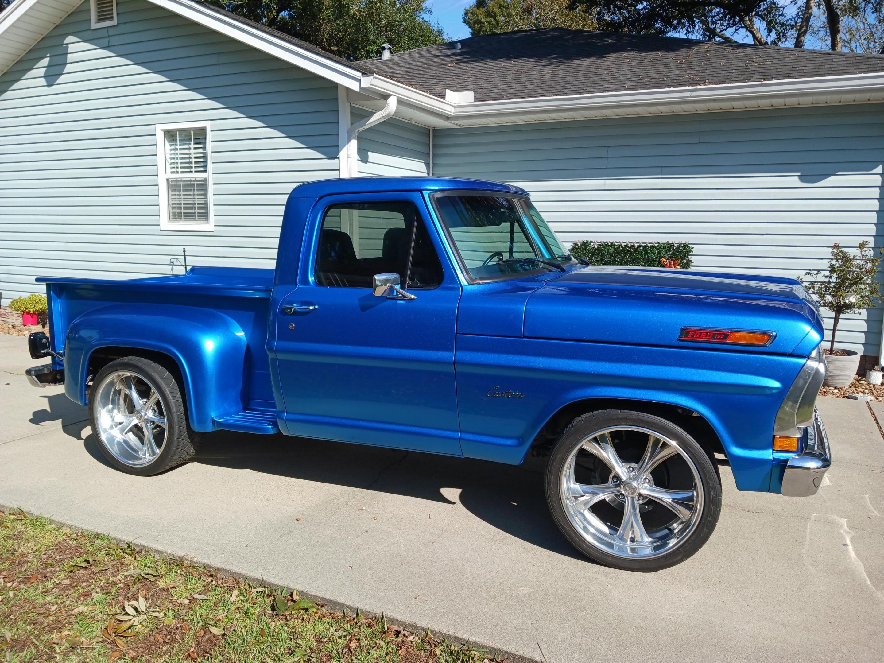

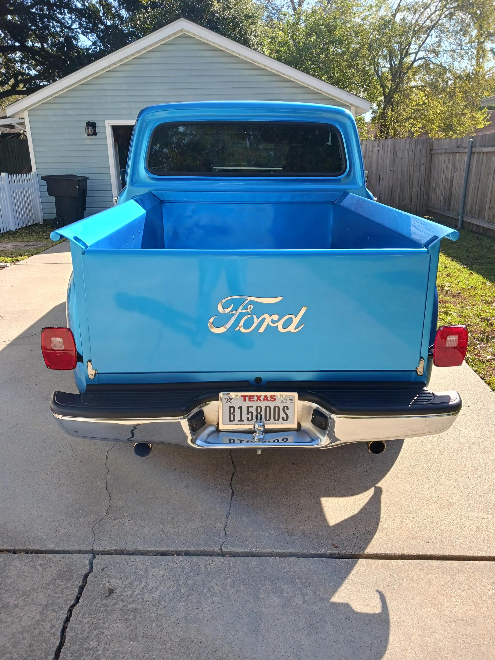

OneTrickPony Posted December 13, 2024 Posted December 13, 2024 I am just finishing up a 12 month project, repainting my 70 F100. I had a few small rust repairs to do, then a full repaint with color change. 6
