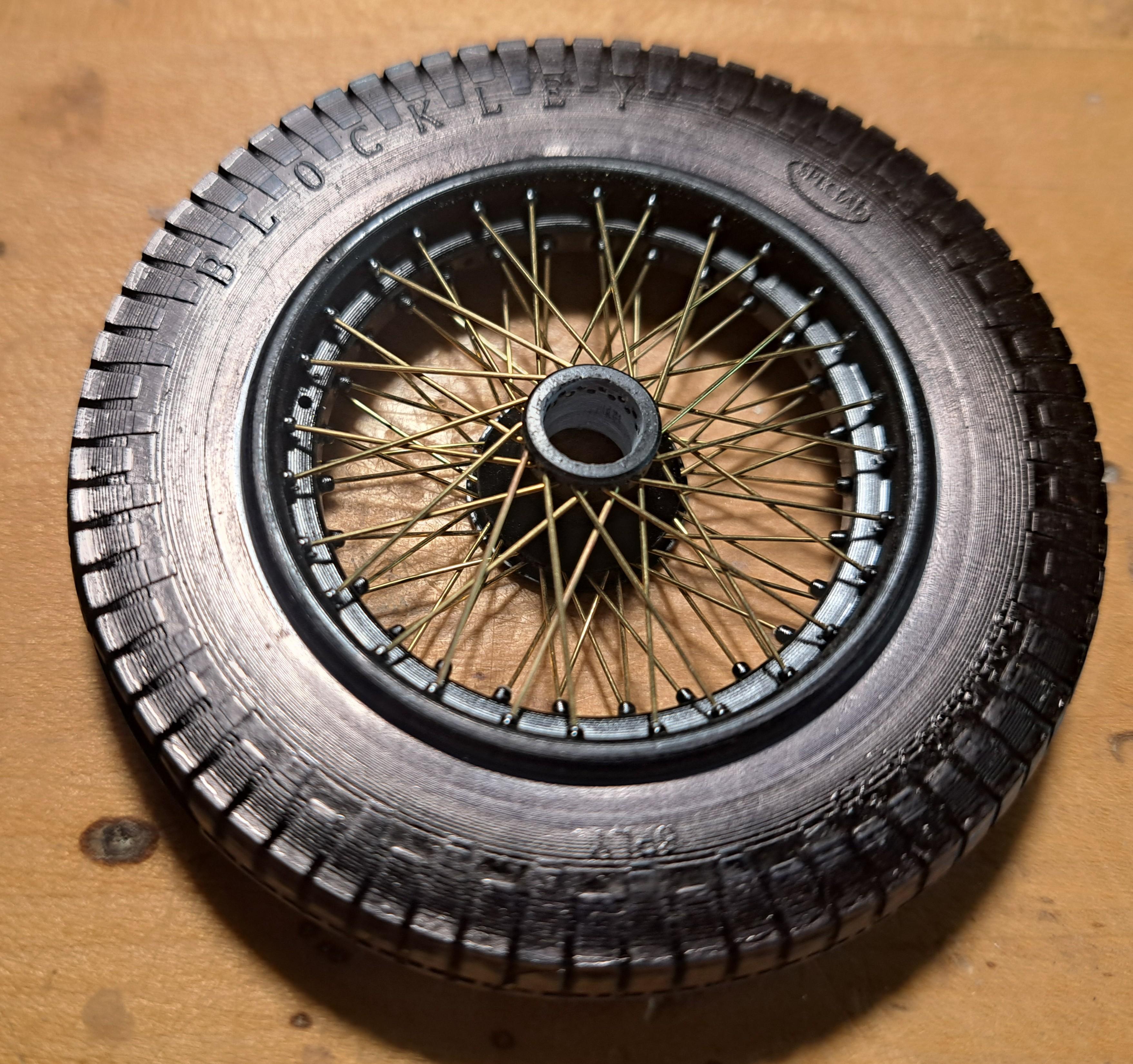

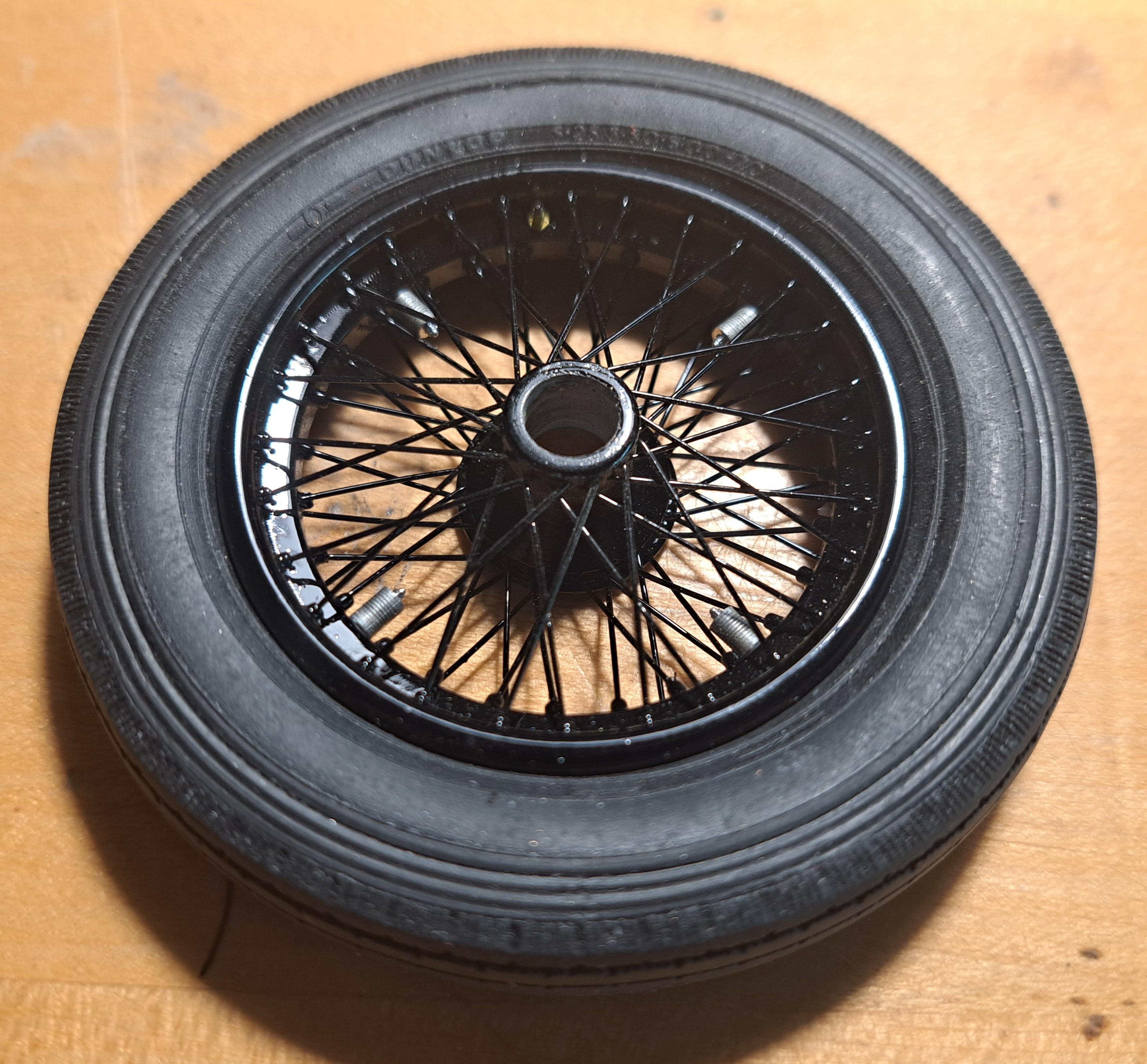

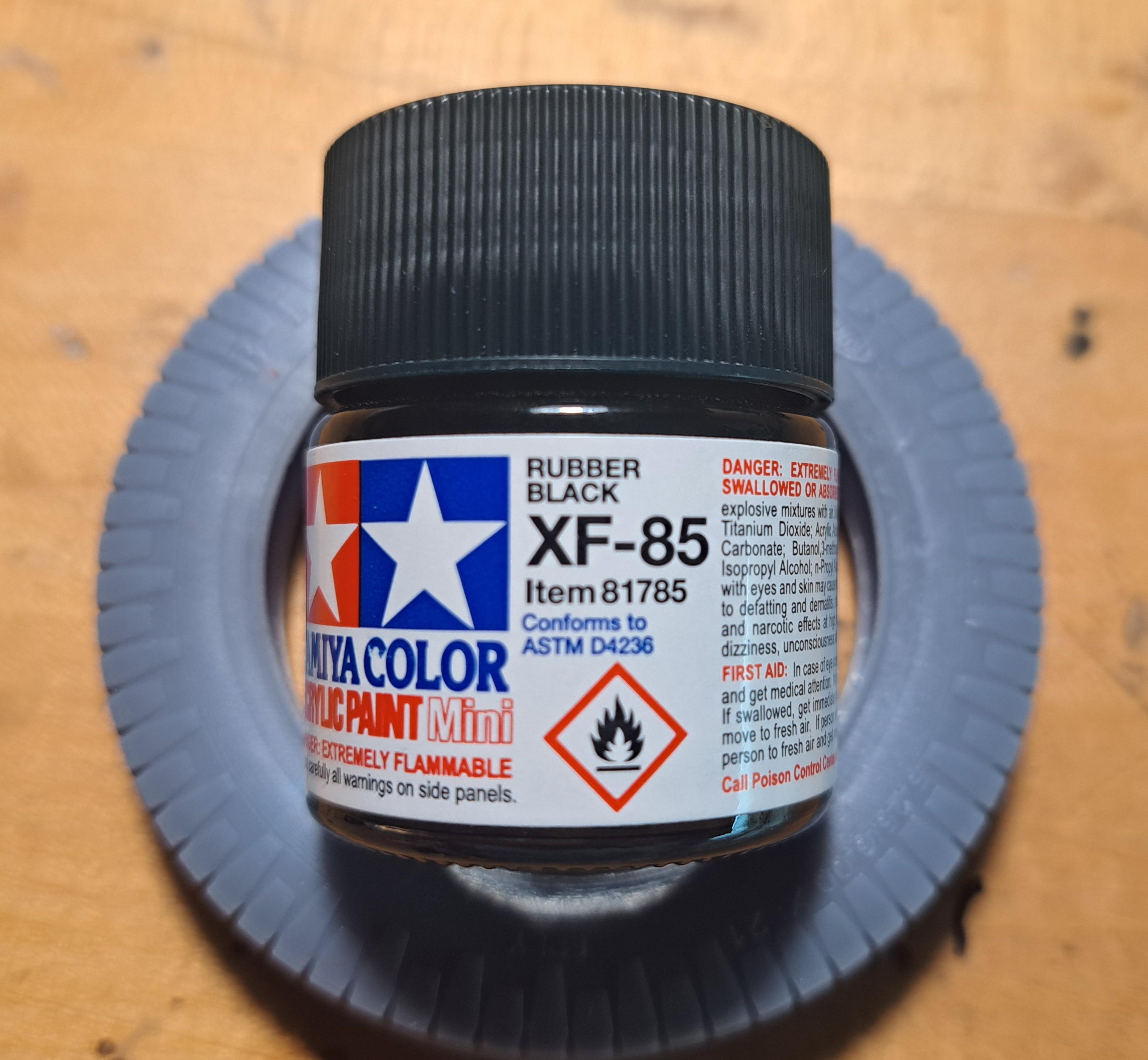

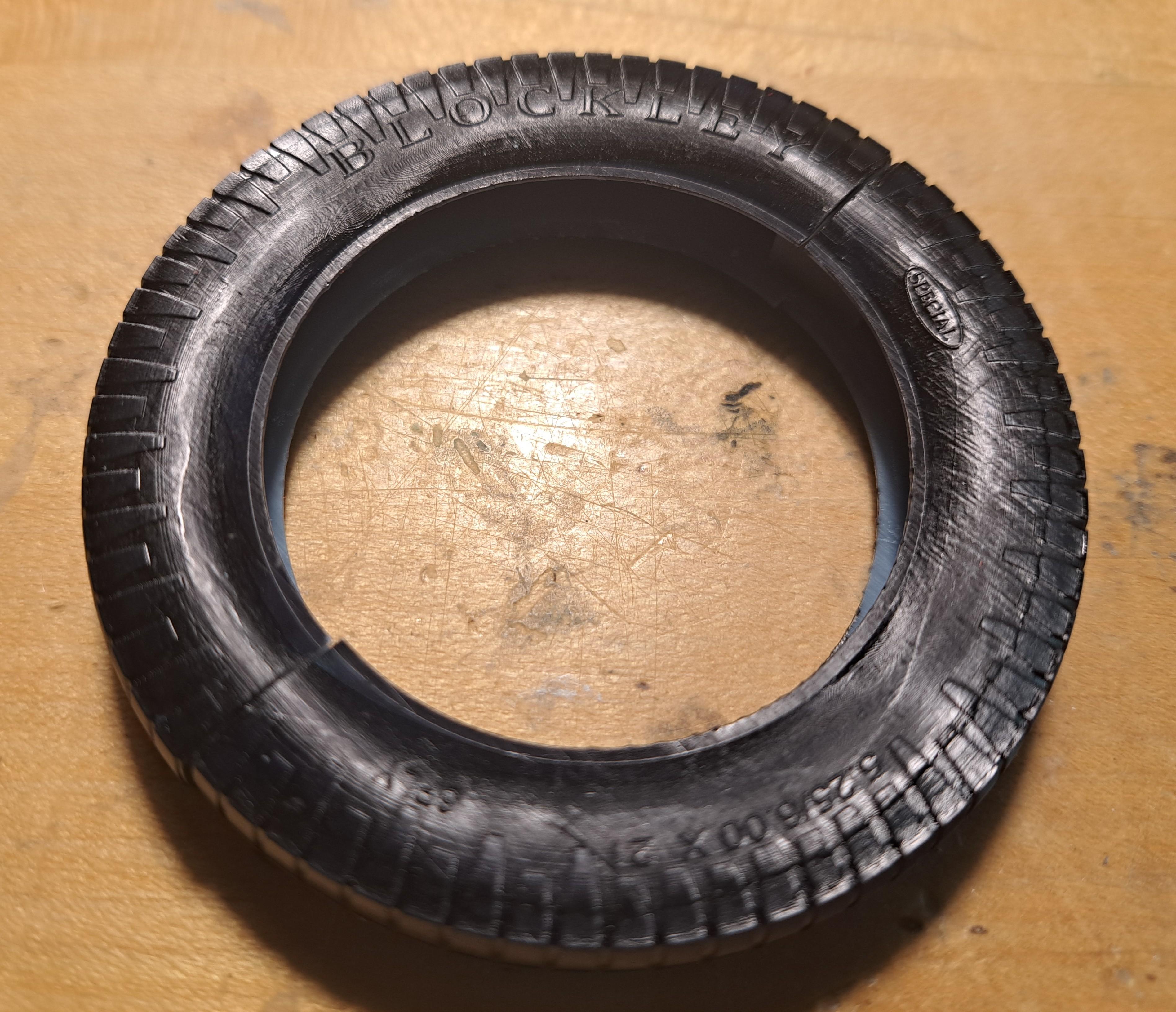

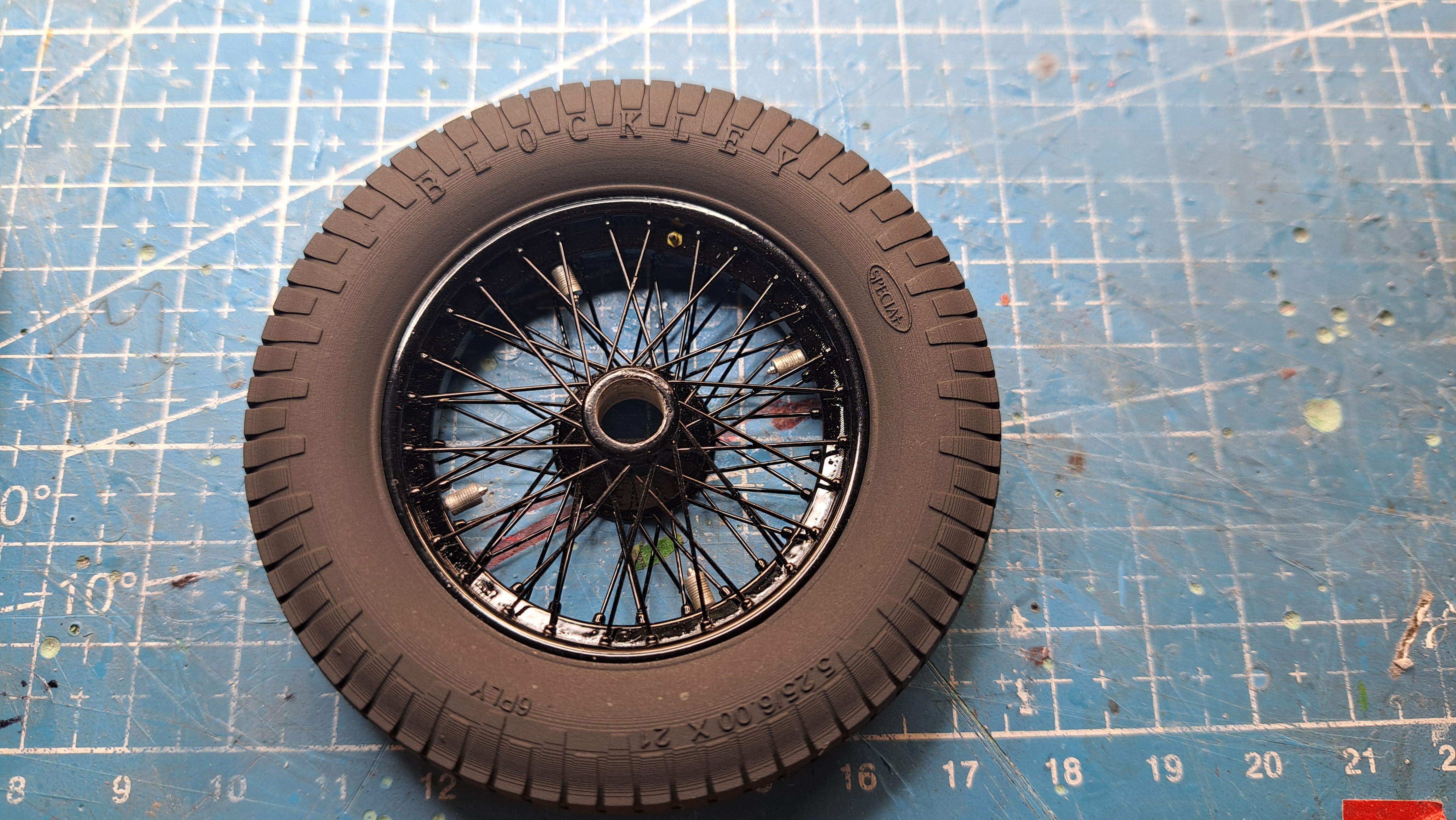

Ok, so I think I have a good tire print but I'll now for sure once I paint it. My 2 first test prints were blackened with a permanent marker, it looks a bit like an armoal coverded tire. I found a black rubber paint made by tamiya. If the paint gives a good enough rubber look, I'll print a 5 tires with regular resin to start and may print them again with rubber resin later on.
Here, in order, are pictures of
the kit's tire
my firts test print
my second test print
my third
a real Blockey tire
and the black rubber paint

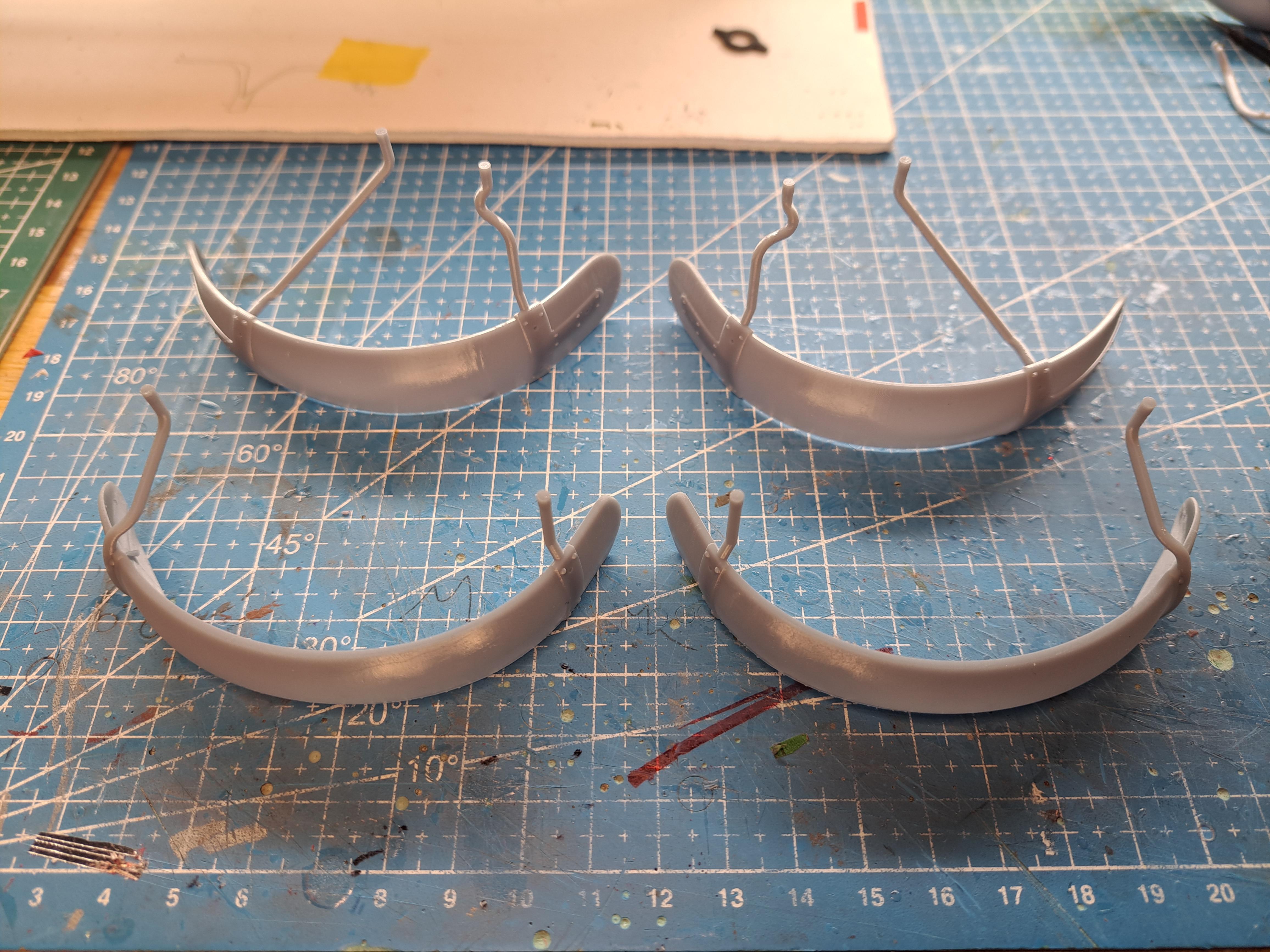

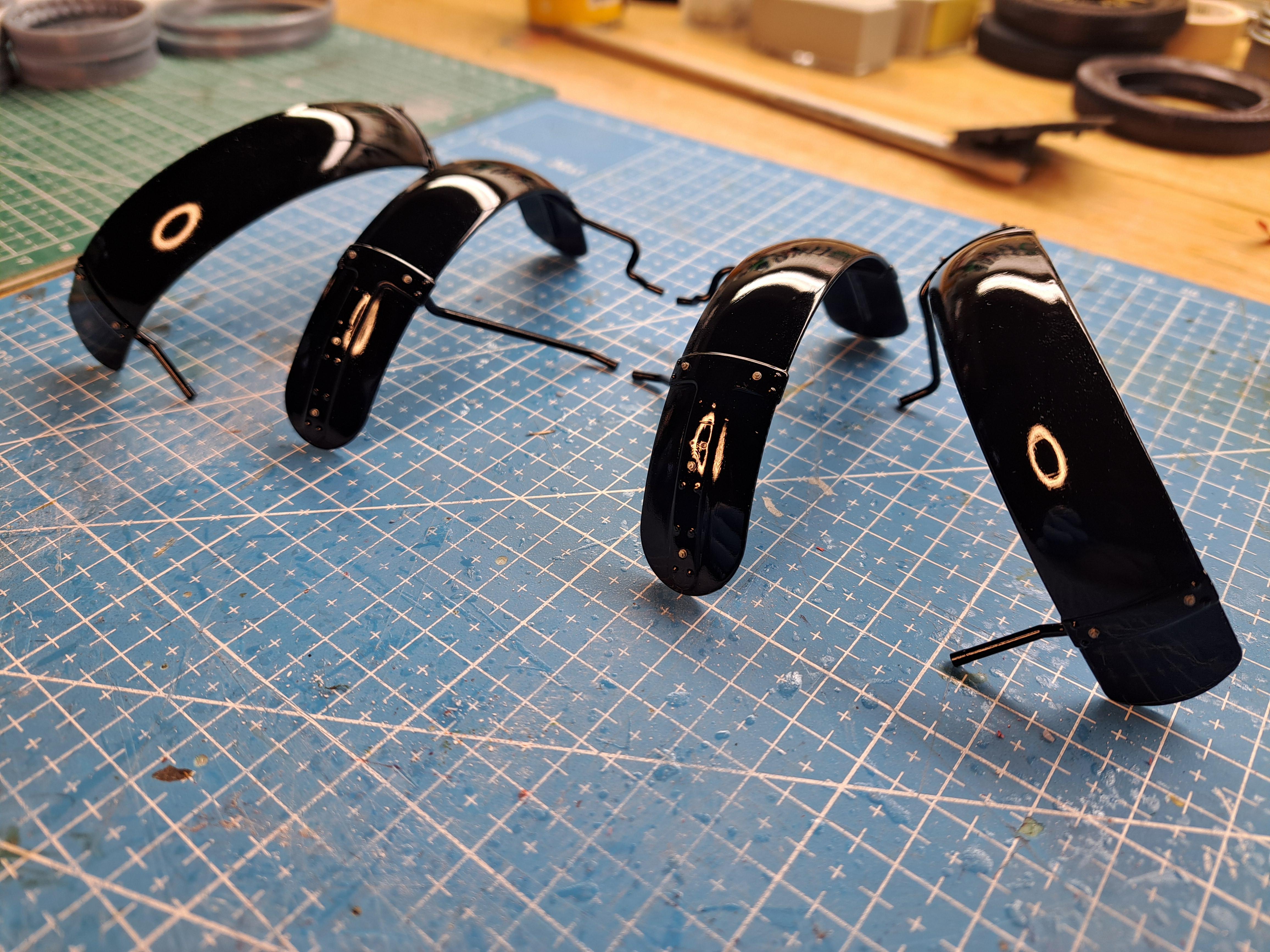

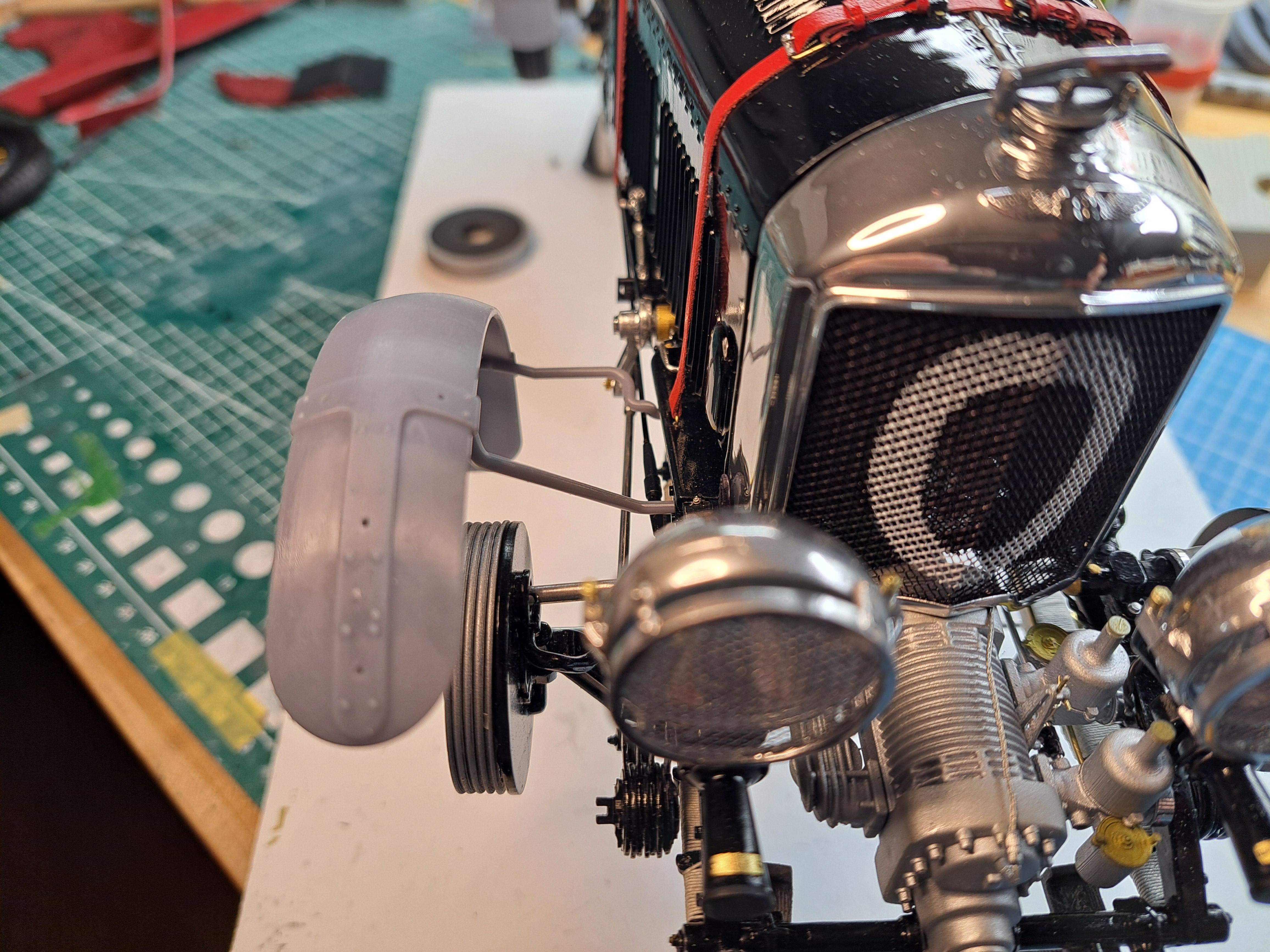

I've also started work on the fenders. The kit's parts are ok but no more. The mounting rods are very flimsy and don't fit good, especially at the front. So me being me, I 3d modeled them and will test print to see if I can do better. It will be print in 1 piece,  the fender with the 2 mounting rods instead of 3 separate pieces. I might need to reprint a few times to get the rods in the correct location but by printing them it's easier to add missing details like rivets, bolt holes...
Kit's rear fender
Kit's front fender
The 3d model
A rear fender ready to print
I found the support brackets for the wings a bit prone to breakage on the kit items on my Bentley that I built years ago.
In the end I replaced them using brass rod for strength. Hopefully 3D printed ones will be stronger than the kit plastic.

Bugatti fan,  the printed rods are stiffer but they are still plastic. The 2 major benefits of printing the fenders are that by printing the rods directly with the fender,  it make assembly much easier and assure a proper fit identical on both sides. It also permited me to better copy the real setup since the kit mist a few details and got some others completetly wrong.
That makes perfect sense what you are saying Francois, and also being able to correct some mistakes that the kit wing parts had on them whilst you were drawing them up on the cad.
Incidentally, your wire wheels and tyres have really worked out well and look most realistic.

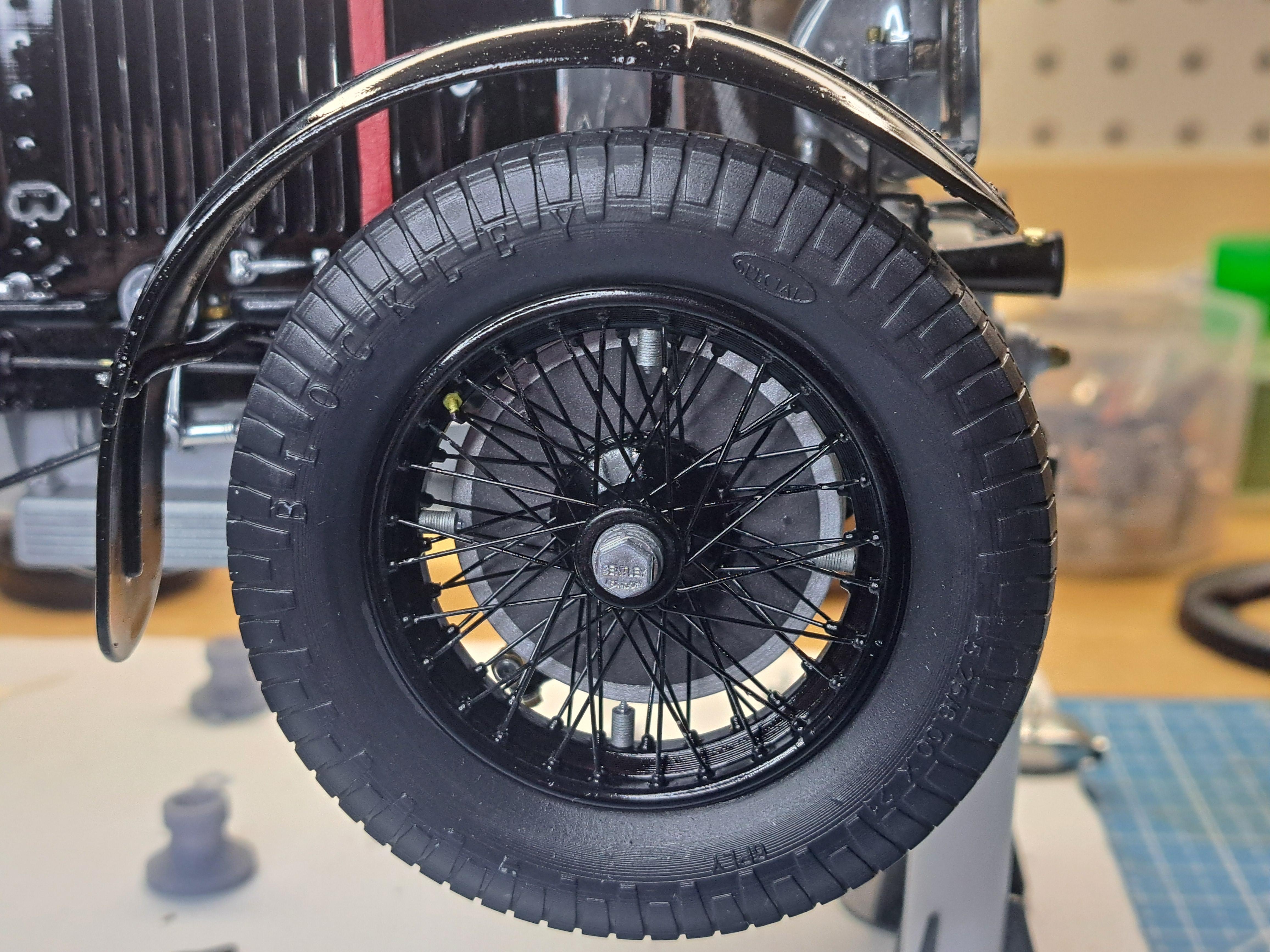

I think I'm getting pretty close to a good tire. For now, it's printed out of regular resin and painted with Tamiya's rubber black. I will eventualy print them will rubber resin.
Left side is kit's tire, right side mine

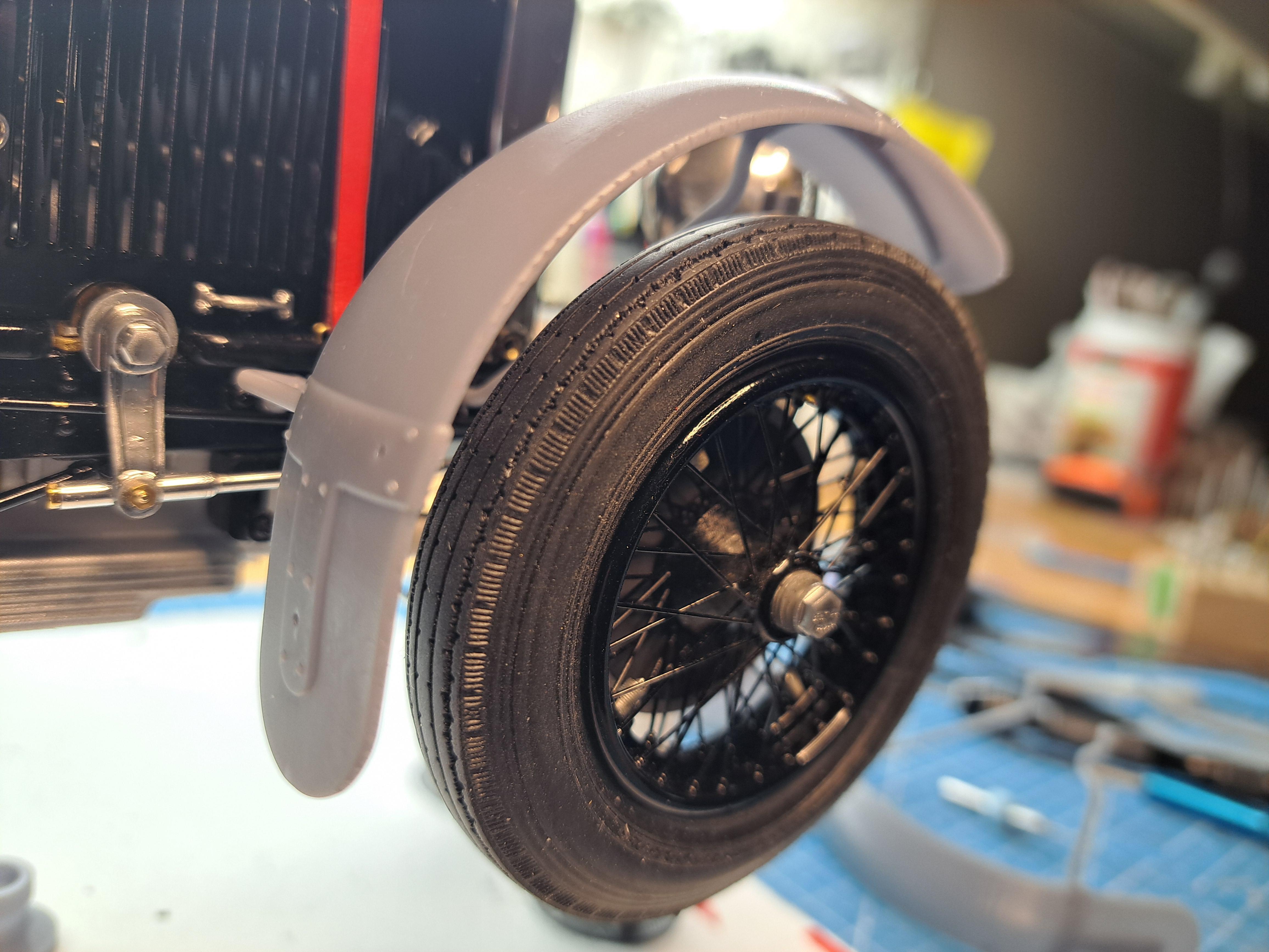

The finished fenders
And temporarily mounted on car

Even wheels look so realistic, so it's hard to tell whether they are real or it's a mini-version.

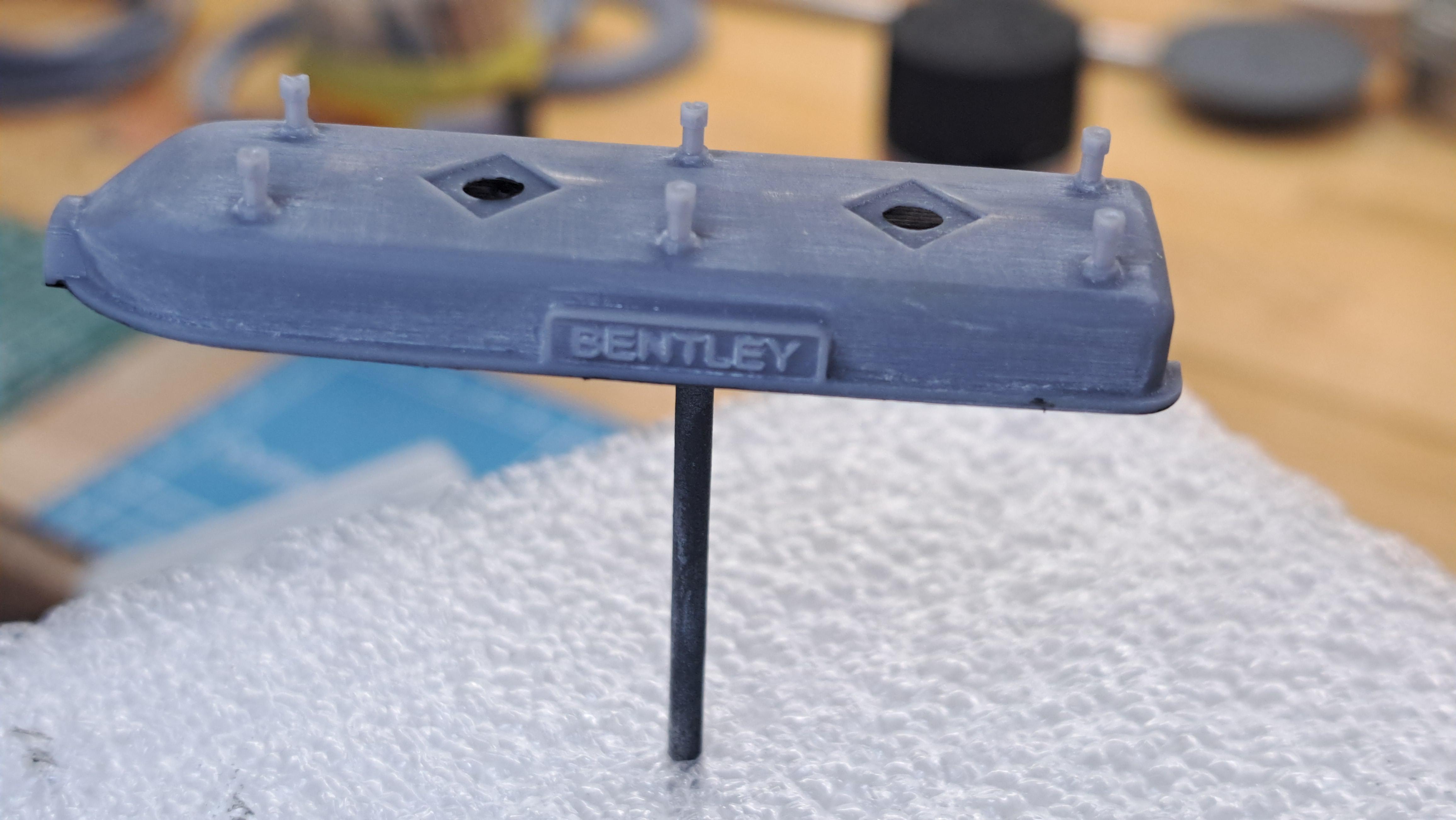

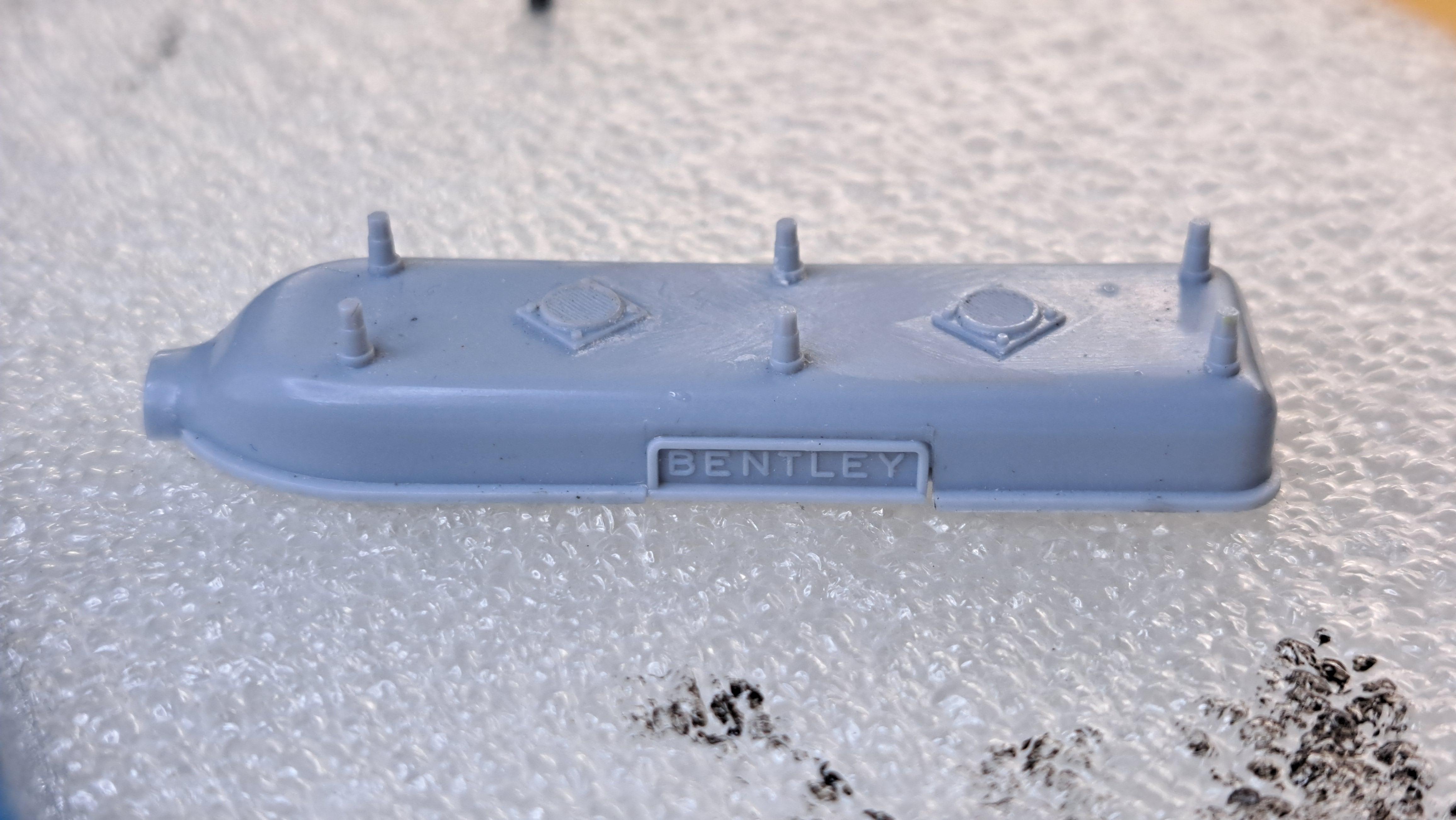

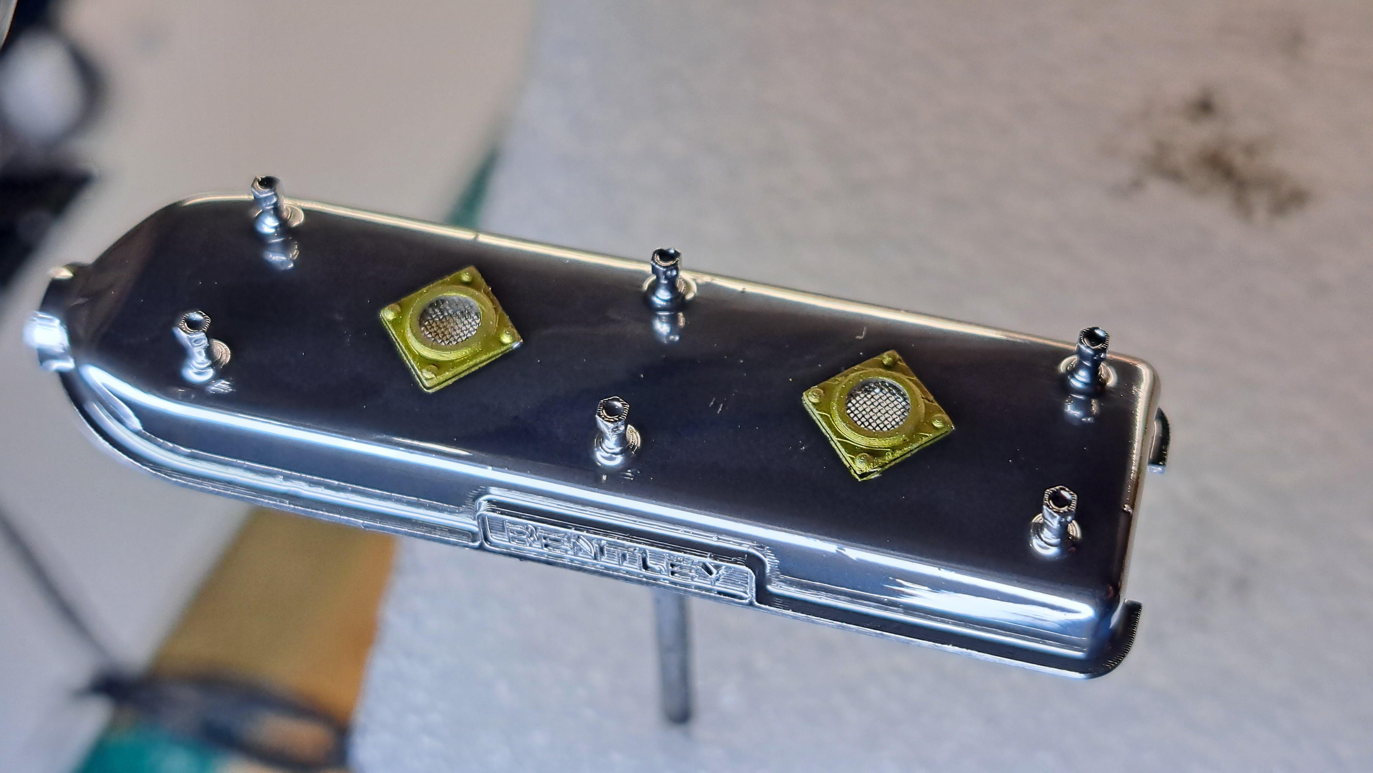

I still have many loose ends to tie up. One of these is the engine top cover. Again, the kit cover, while being ok, is not great. For one thing, the breather plates and mesh are moulded in and not well defined and the 6 mounting bolts don't have the correct shape nor do they have the lockwire holes in them. So I decided to model it and print it.
Here's the kit's cover with everything moulded in
Here's my print. It's hard to see but all 6 studs have a tiny hole on It's tip for the lockwire
The kit's moulded breather plate next to mine which has a micro mesh
My cover chromed and with the vents installed, still need to paint the contour of the letters in black and to install the lockwire

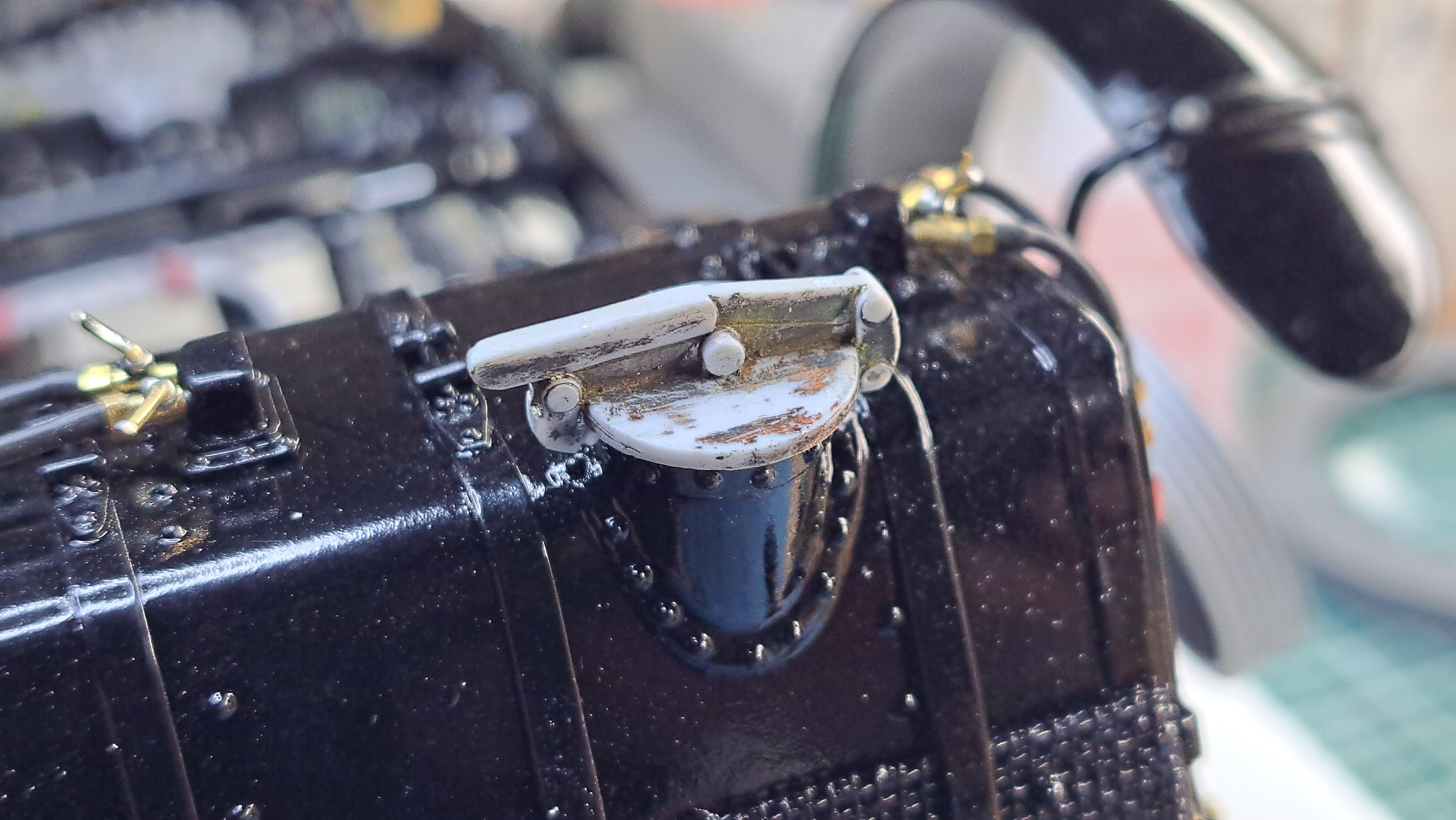

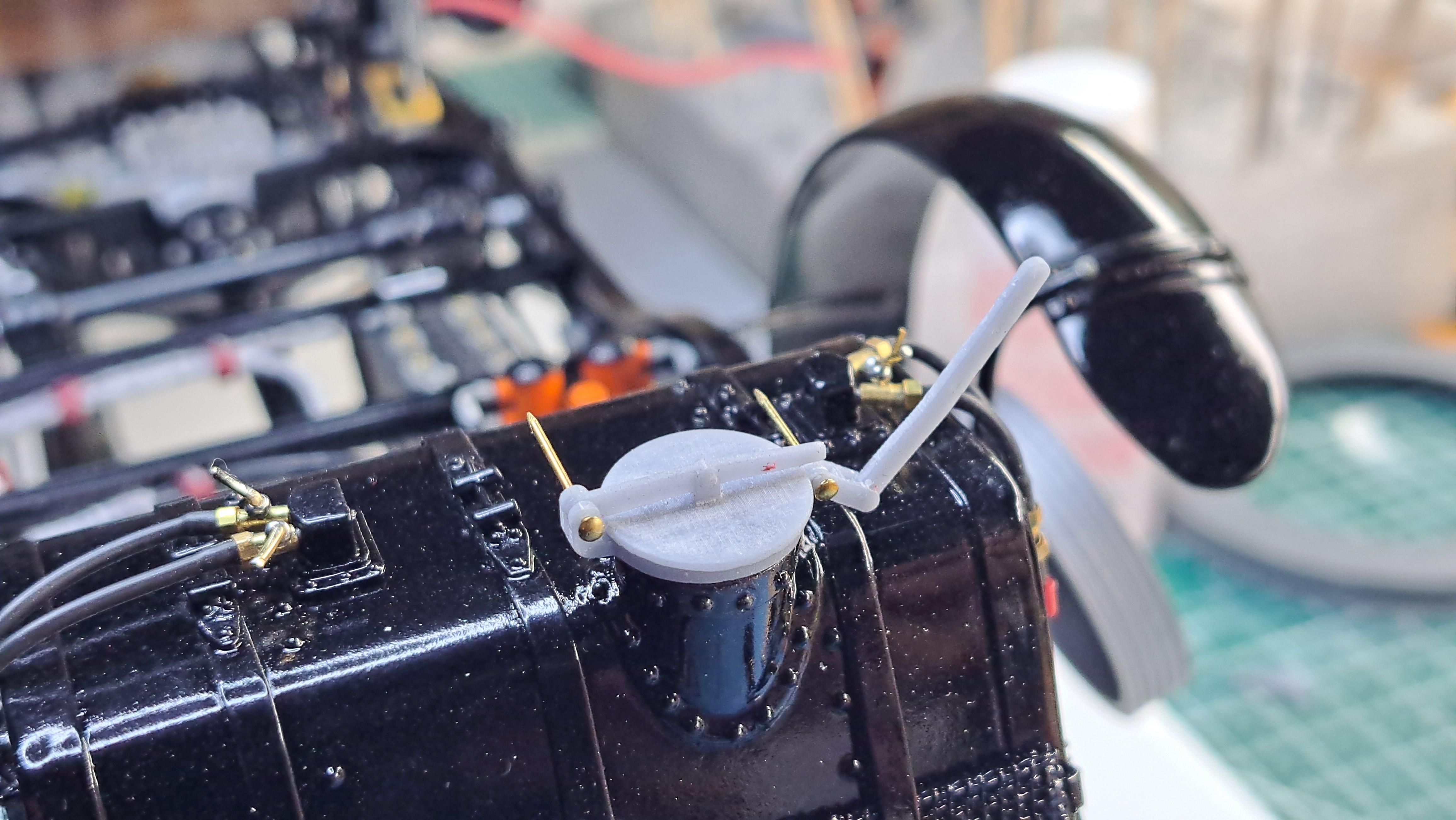

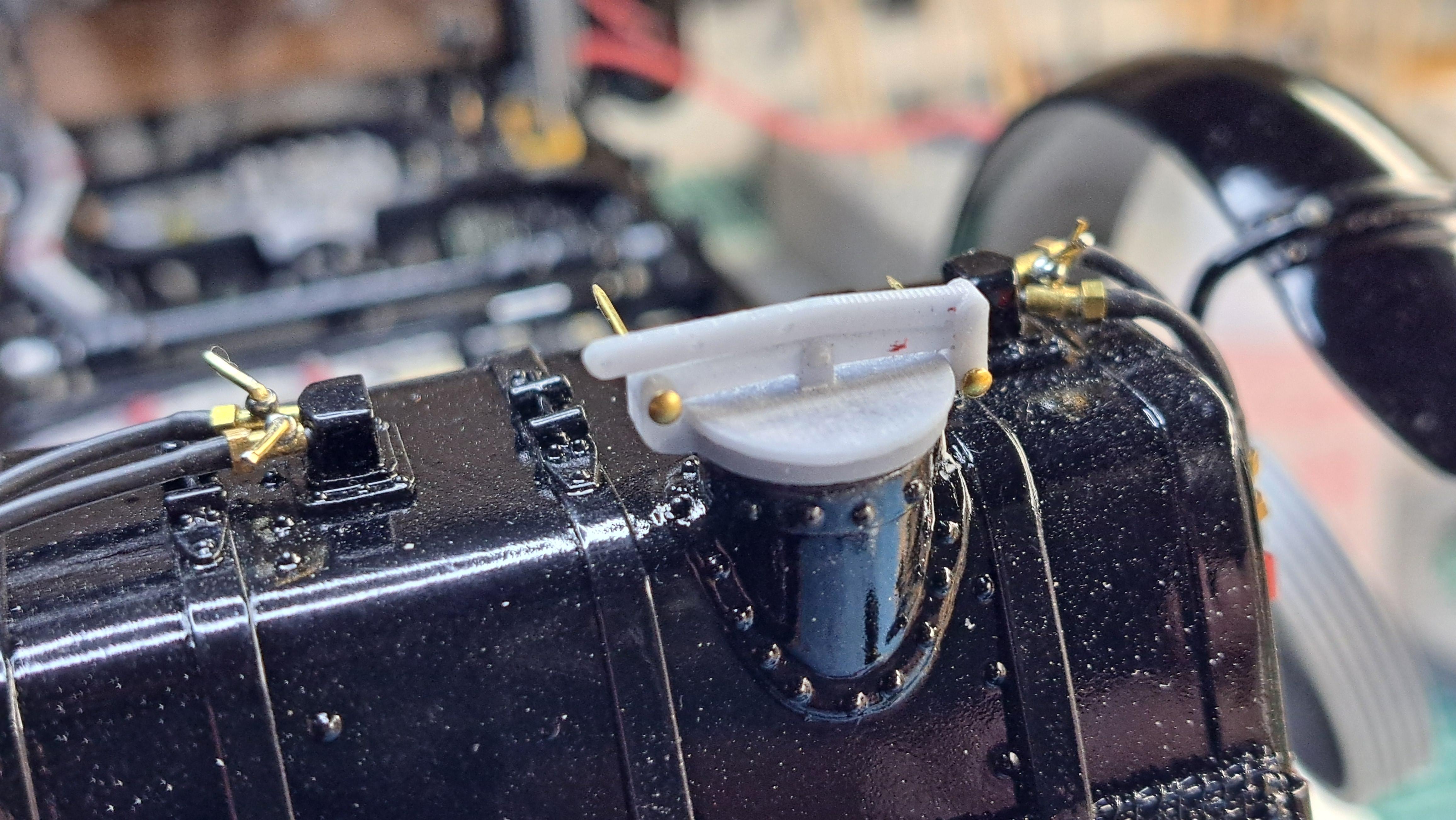

Another loose end was the gas cap. Having already done the radiator cap,  it was easy to just modify the cad a bit to make it bigger and to print it.
The kit's cap
My cap closed
With handle opened
And lid opened

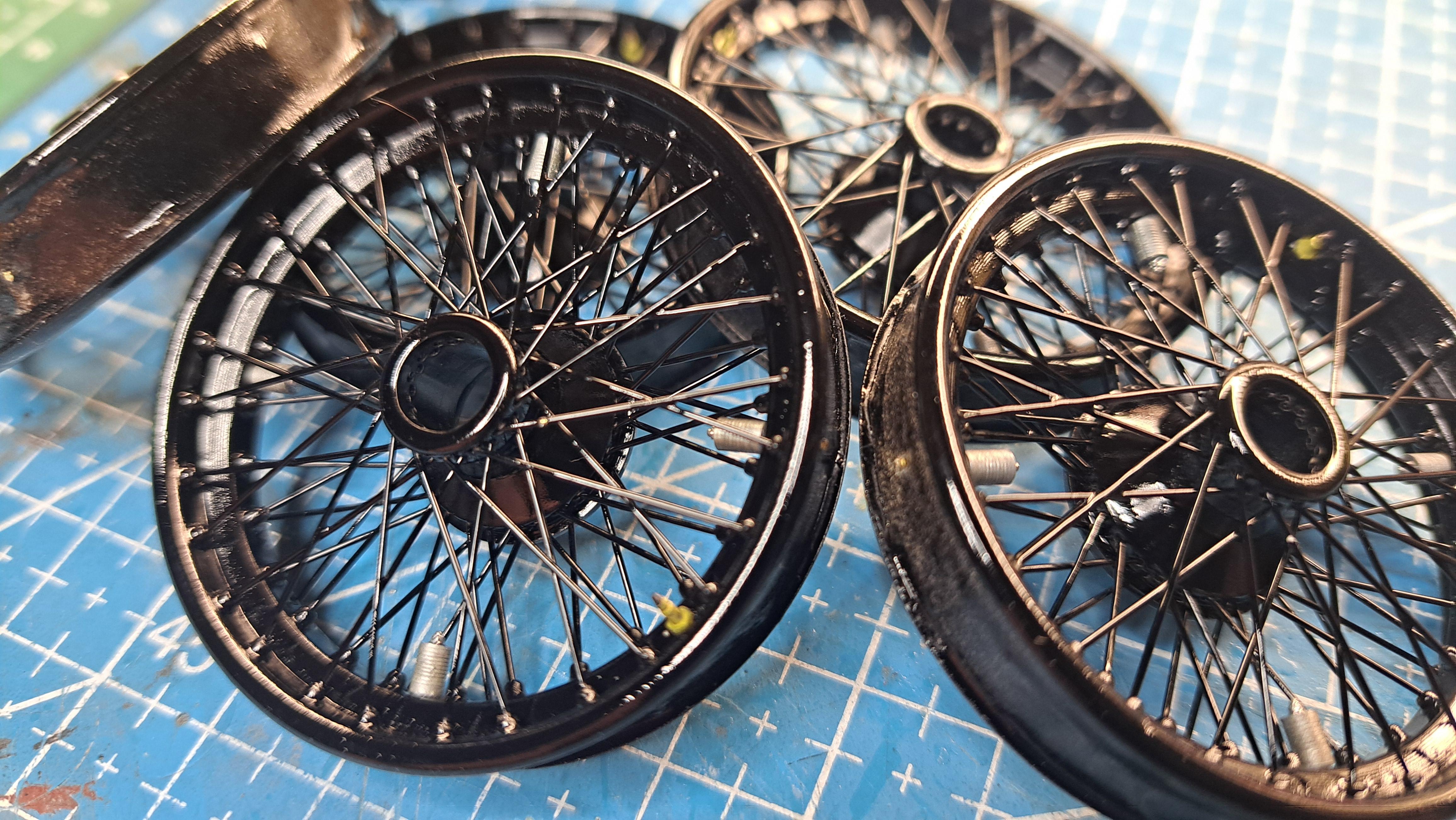

As requested, here are a few pictures of the finished wheels. Just need to mount the tires.  I'm affraid it might prove to be quite difficult since I printed them with a hard resin. If they don't fit properly, I guess I'll have to get the quite expensive rubber resin.

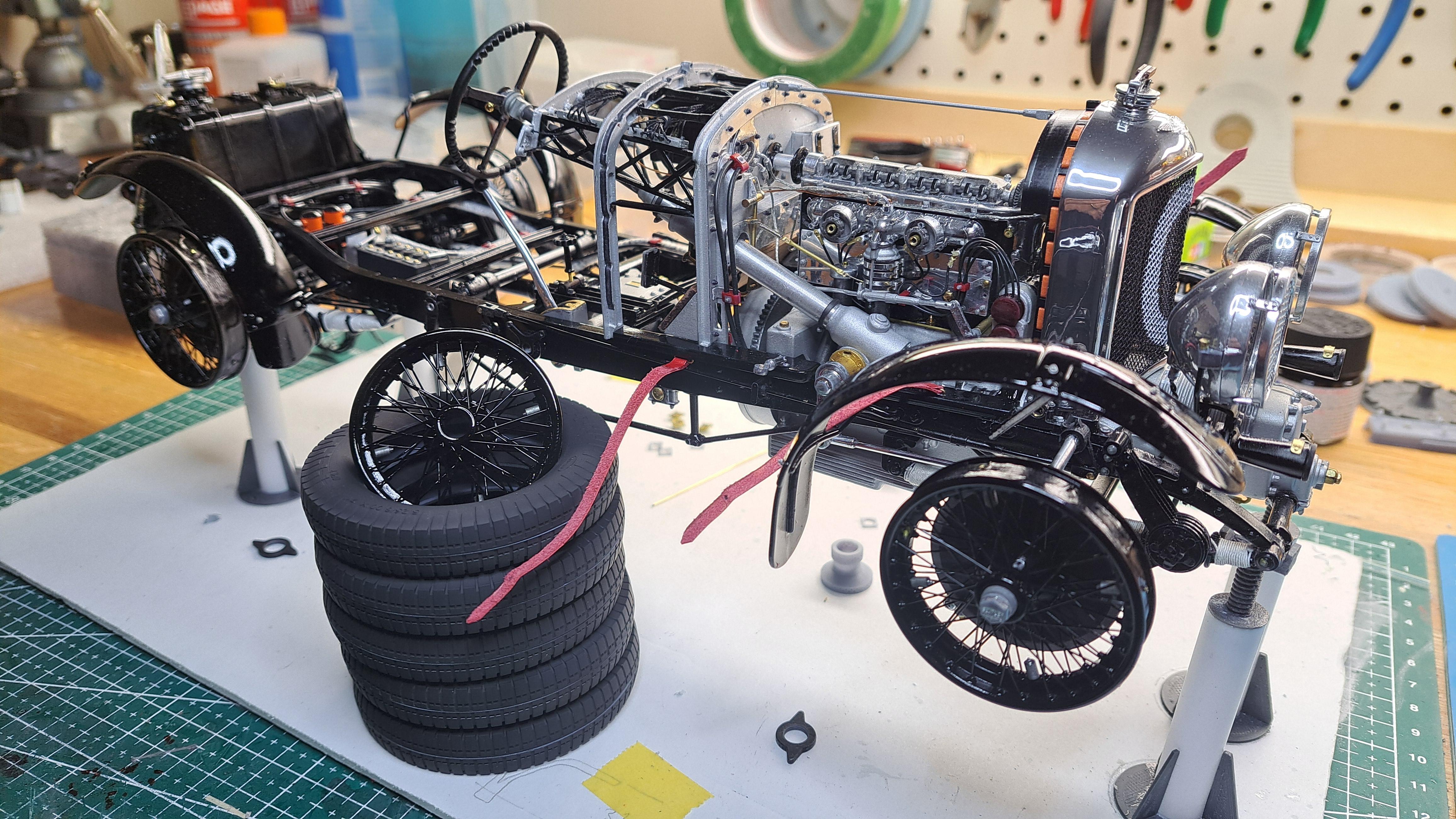

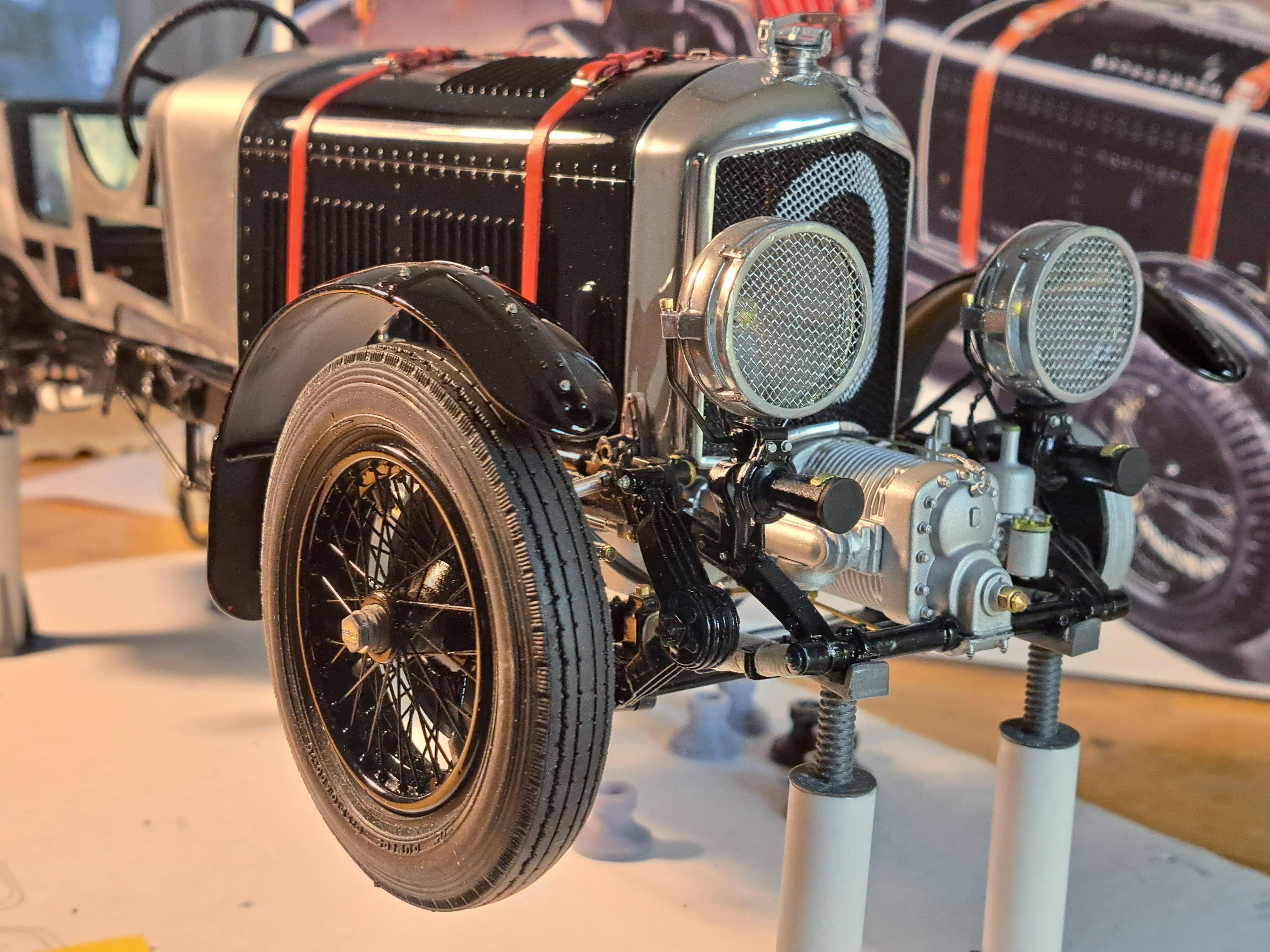

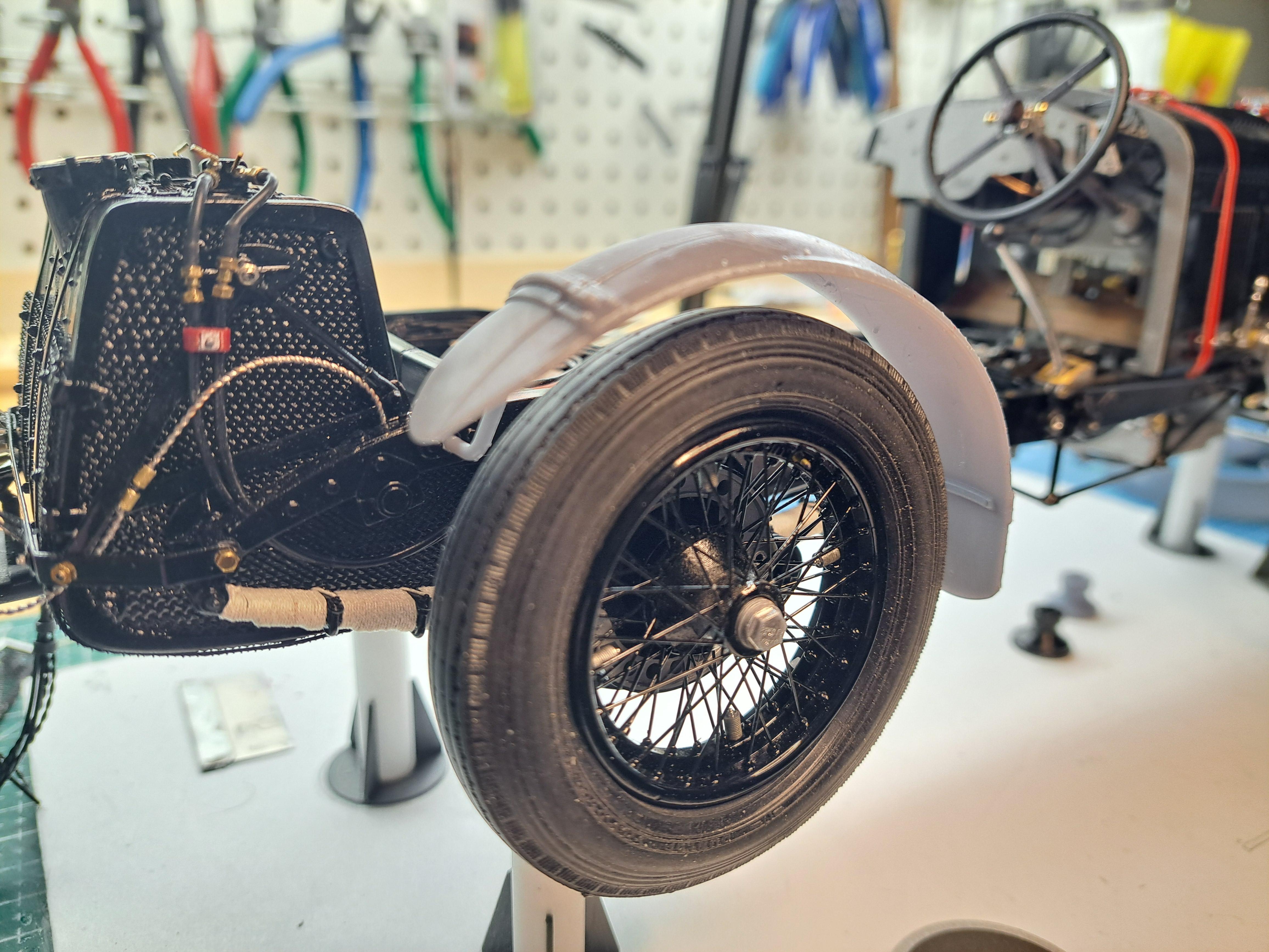

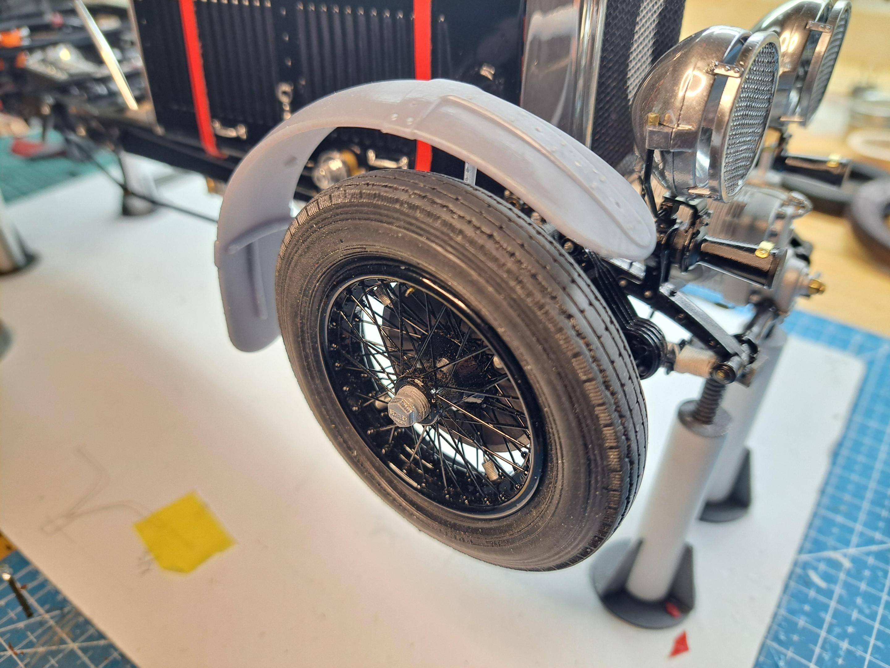

First time on all 4's!
4 out of 5 tires are mounted on the wheels,  I had a little problem with the 5th and had to reprint it. The tires on my ref car have a little shine to them (armour all maybe?). I know it's  not period correct but again,  I'm aiming to reproduce a car built in 2019 so I but a little bit of floor wax on mine to give them a shine. I am more than satisfied with the result.

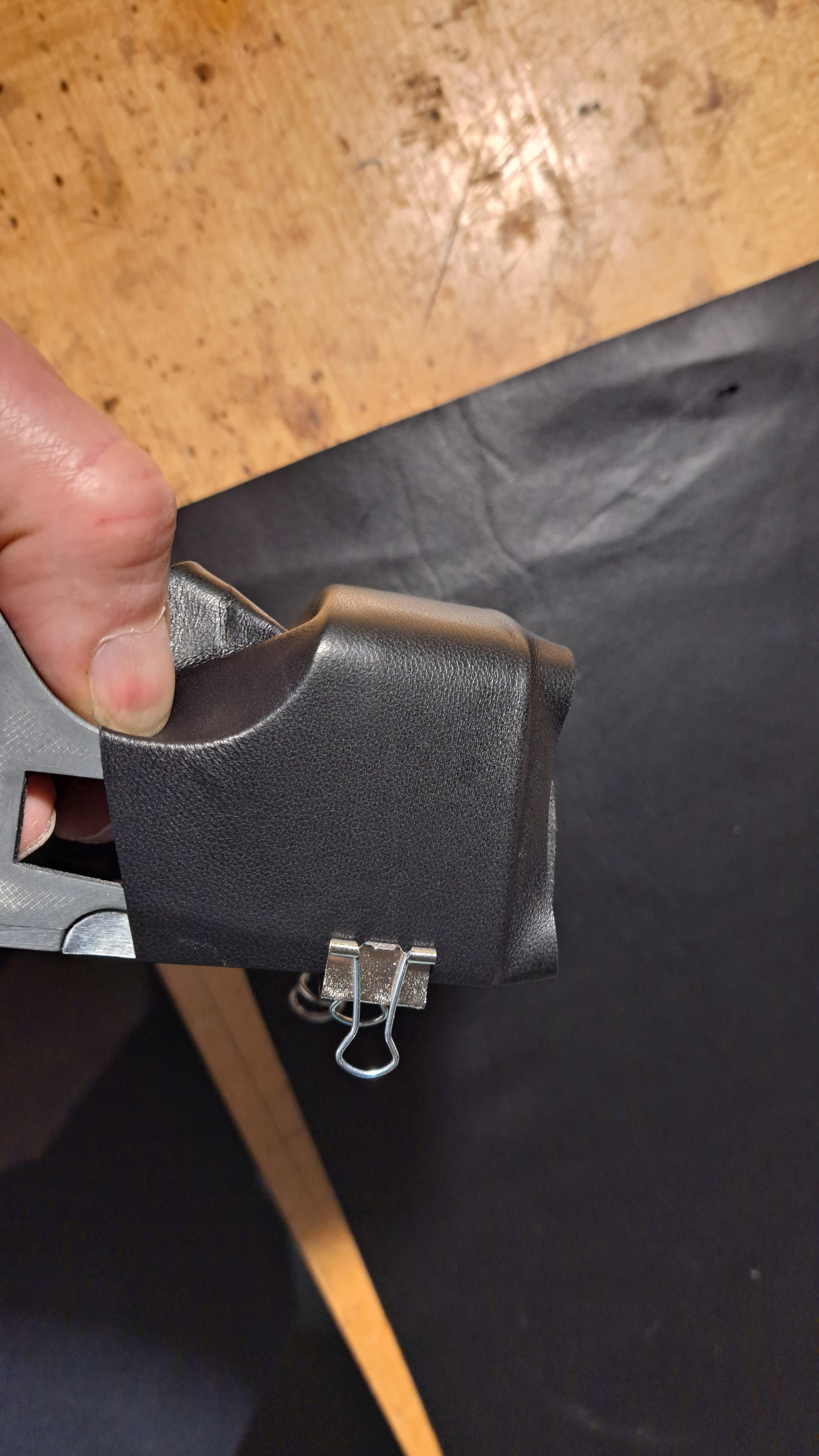

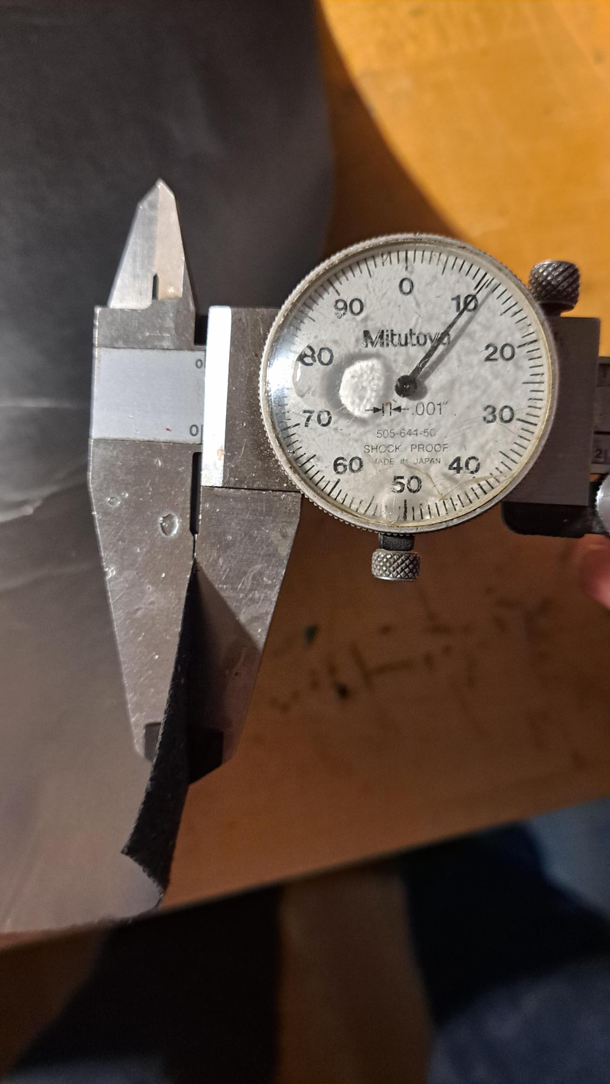

I'm almost down to what I consider to be the most difficult part of this build,  covering the boby and finishing the interior.  This is where this build becomes a real show piece or remains a very nice model. I received a thin lamb skin leather sheet, it's only .3mm thick (.01in). I think it will do nicely to simulate the rexine. It's very flexible,  thin enough for all the curves (I hope) and has just enough shine to it. I  have an image in my head of what the final setup will be, model and display case.  I'm just not exactly sure how I'll go about it, after all I've only been thinking of this for 18 months !! But I'm confident I'll figure something out.
  • Like 1
Oldrevellfan,  how would that work exactly ? Can I glue wet leather or does it need to dry first?
It seems to be already pretty flexible.
And very thin
If I remenber well, you can glue when it is wet wtith a neoprene glue.
it also should dry first depending onthe glue you will use.
 but it seams to be soft enouth to avoid this.
Edited by oldrevellfan
It's usually not a good idea to glue leather when it's still wet. The water can stop the glue from sticking well, making the bond weak. Make sure the leather is completely dry before you glue it. Also, make sure to use the right kind of glue that works well with leather, because not all glues are the same in how strong they hold or last on leather.
