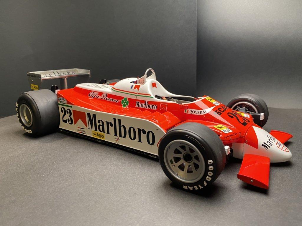

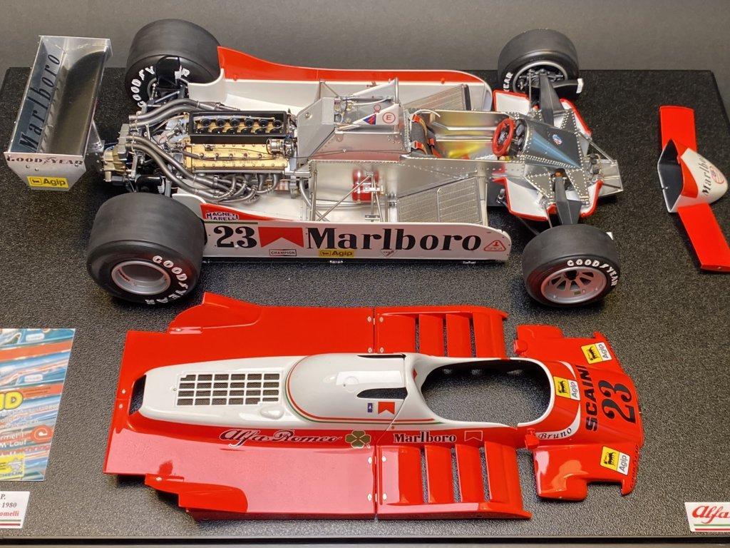

Giovanni La Rosa Posted May 26, 2023 Posted May 26, 2023 Hi at all, the basic kit is from Protar, an italian model company that has been out of the market for several years that produced car and motorcycle kits. A few years ago, Italeri, which acquired the Protar molds, reissued the kit, significantly improving the quality of the plastic and decals. The model I made is a reproduction of the car, in terms of aerodynamic configuration and thechnical solutions, which took part in the 1980 Austrian Grand Prix, driven by italian Bruno Giacomelli. The model refers precisely to that occasion since, in that Grand Prix the position of the air cooler, located above the gearbox, was in a vertical position (as supplied in the kit) for the first race as, up to by then, it had been mounted in a inclined position ; in addition, the side panel of the rear wing, in this race, were mounted in natural metal while , in the previous race, they were colored fluorescent red, as part of the bodywork. During this race, as well as almost all those of the entire 1980 World Championship, Giacomelli retired due to technical problems. 3
Belugawrx Posted May 26, 2023 Posted May 26, 2023 Beautiful Very nice work on a not often seen car. The decal and paintwork work is too notch G
Tommy124 Posted May 26, 2023 Posted May 26, 2023 (edited) Hi Giovanni. what a beautiful build! The funny thing is I am currently in the process of chosing which F1 car to build next. And I have have checked this very kit (which is in my stash) in detail yesterday. Although I decided to go with a 1:20 kit for now, I made up my mind to build the same livery and driver version that you did, in the future. So it's a nice surprise someone (you) had the same idea and built such a great model in exactly the same way. Congrats again, very well done! Judging from the high level of fine detailing, I'd suspect you have used aftermarket parts such as wires, rivets...? Is that so? Edited May 26, 2023 by Tommy124
Rich Chernosky Posted May 26, 2023 Posted May 26, 2023 Protar kits are no walk in the park. They take many long hours of persistence and skill to get them right. This is one of the finest examples of one of these kits I have seen. Congratulations Giovanni on a job very well done.

Giovanni La Rosa Posted May 26, 2023 Author Posted May 26, 2023 4 hours ago, Tommy124 said: Hi Giovanni. what a beautiful build! The funny thing is I am currently in the process of chosing which F1 car to build next. And I have have checked this very kit (which is in my stash) in detail yesterday. Although I decided to go with a 1:20 kit for now, I made up my mind to build the same livery and driver version that you did, in the future. So it's a nice surprise someone (you) had the same idea and built such a great model in exactly the same way. Congrats again, very well done! Judging from the high level of fine detailing, I'd suspect you have used aftermarket parts such as wires, rivets...? Is that so? Hi Thomas, the kit has been revised and complted in all its sectors ! The aftermarkets used are innumerable and the self-built parts are numerous. I am attaching photos of particular sections of the model ; if you had specific questions about what I used in that build, please feel free to ask.

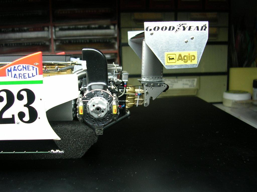

Giovanni La Rosa Posted May 26, 2023 Author Posted May 26, 2023 3 hours ago, Rich Chernosky said: Protar kits are no walk in the park. They take many long hours of persistence and skill to get them right. This is one of the finest examples of one of these kits I have seen. Congratulations Giovanni on a job very well done. Hi Rich, from what you write I deduce that you know Protar/Italeri kits very well ! Indeed, they are not very easy to assemble but, with a lot of patience and research, beautiful models can be obtained from them. I am attaching two photos where you can see how I redid the oil cooler, positioned on the gearbox and the rear suspension arms. In these photos it is possible to see how the modified pieces have been improved in appearance compared to those supplied in the kit.

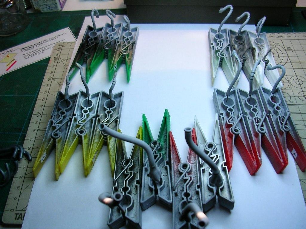

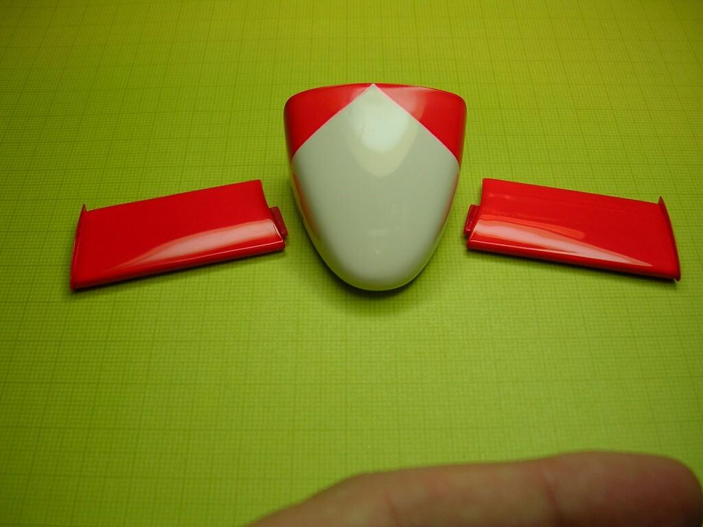

Giovanni La Rosa Posted May 26, 2023 Author Posted May 26, 2023 3 hours ago, rrb124@sbcglobal.net said: Over the top! I saw Bruno race this car while I attended the Caesars Palace Grand Prix September 26, 1982. Wonderful roaring engine sound. I toured the Garage with the pass and bought the 1/43rd die cast (still have it) from the team table. Your paint shade and details are as I remember. Hi Robert, the phase of defining the shade of fluorescent red to be used for the bodywork was long and laborious. In the end, I defined the mixture of Tamiya colors , decanted from the can, by going to see a 1981 Alfa Romeo 179B at the Carlo Biscaretti Automobile Museum in Turin (Italy) ,but which kept the same colors as the 1980 car. After placing various color tests , previously made, on the original bodywork , I decided on the final color : 6 parts of Tamiya TS 36 Fluo Red and 1 part of Tamiya TS 8 Italian red .

Giovanni La Rosa Posted May 29, 2023 Author Posted May 29, 2023 On 5/27/2023 at 5:07 PM, PappyD340 said: Super nice, awesome detail!! Hi Larry, Thank you for your congratulations ! Since you appreciate the details, I am attaching two photos showing the rear wing, totally coveredwith 0,04 mm stainless steel sheet metal and with the side bulkheads replaces as , for the Austrian Grand Prix, a race in which refers to model I built, Alfa Romeo used the side bulk heads in bare metal sheet, not colored in fluorescent red as in the races preceding and following this one. I made them with 0,5 mm steel metal sheet and equipped with Adlers Nest rounded rivets. 1
