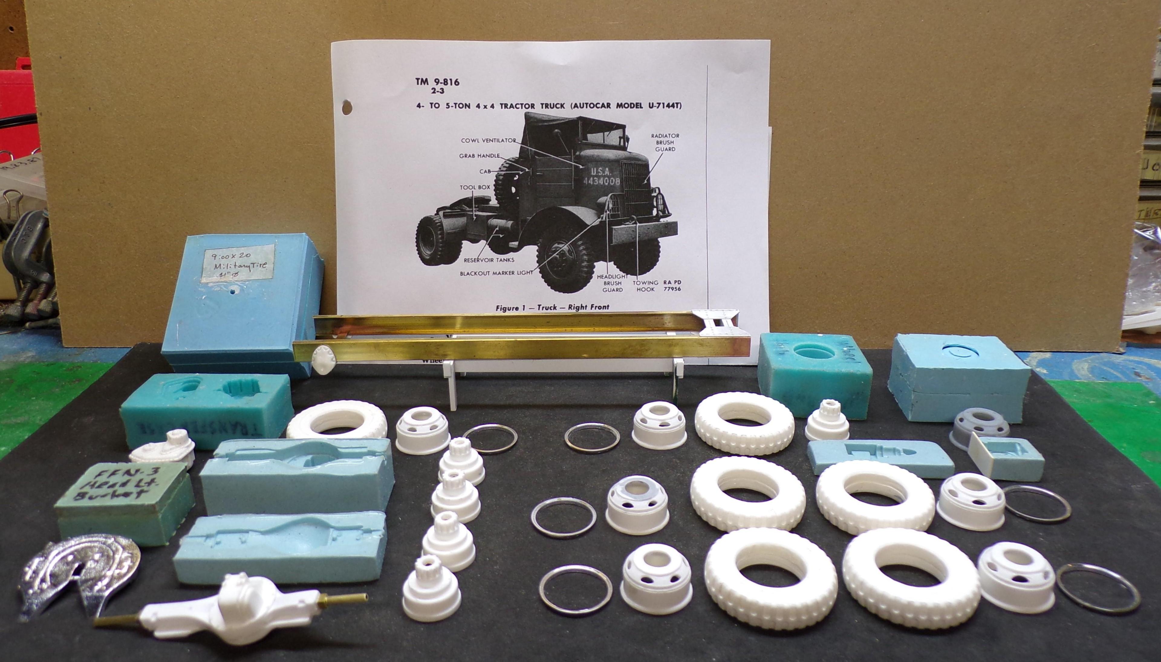

Among the variety of trucks used during World War II for hauling good and equipment to service areas was the Autocar cabover tractor.  It hauled a variety of trailers including fuel, open general cargo, vans, and wrecking units.  This new build will carry on the theme of the Red Ball Express and will be the final military build before returning to fire service vehicles.  Here is a look at the first few pieces for the build.  Not included are the front springs and rear springs which I am having done by a 3D printer.  The supply of strip brass of the size needed has basically run out and KS is not making it anymore.  So I'm glad there is a good alternative.  They should be ready in a week or two.

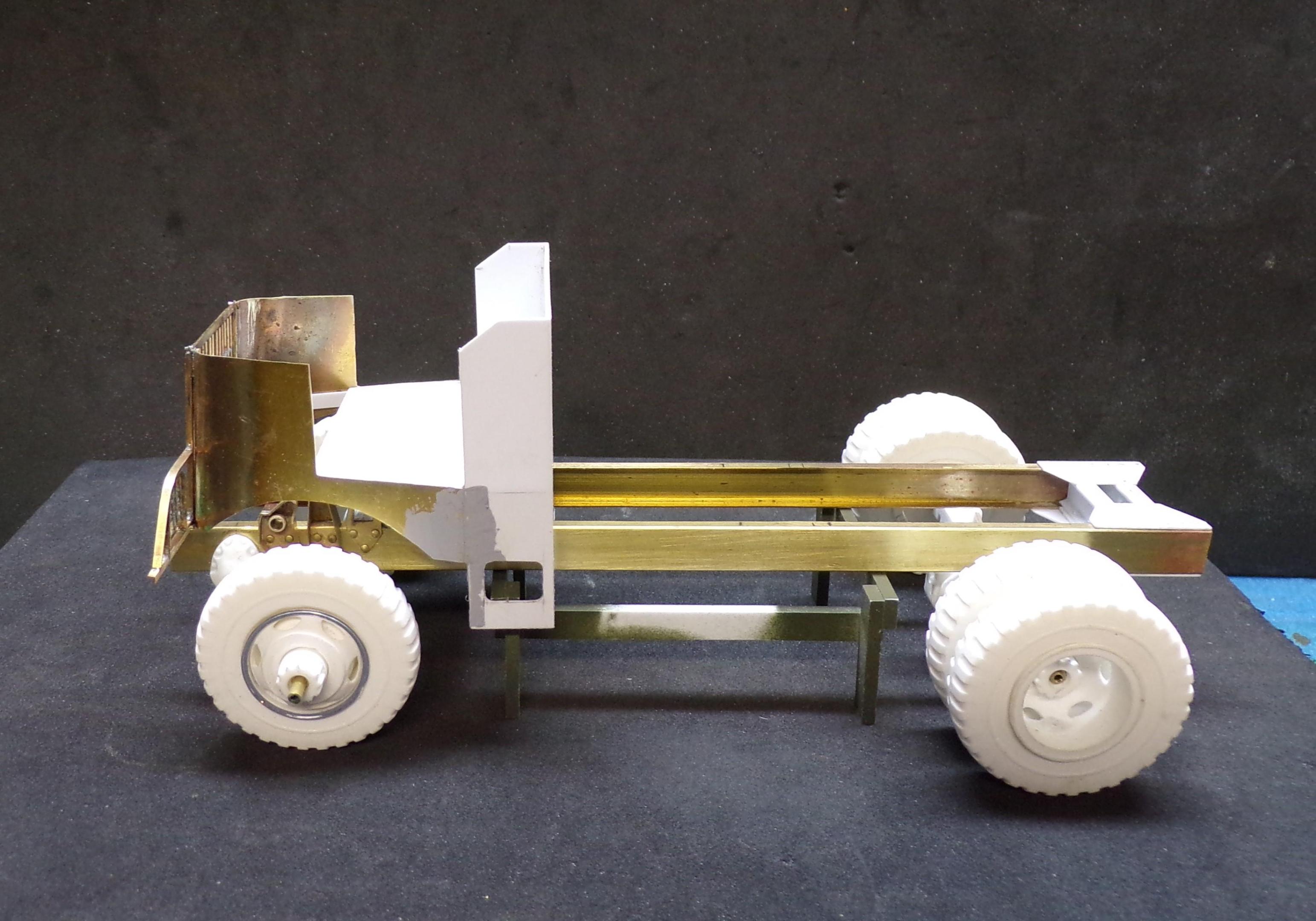

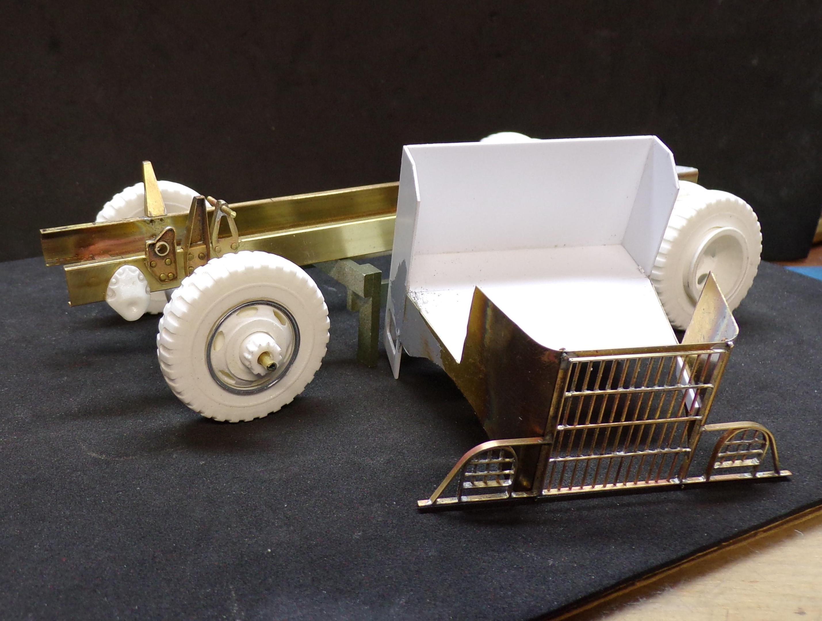

Still awaiting the springs but in the meantime I received the Tankograd publication I had ordered and it is a treasure trove of information for the project.  Reproductions of Autocar drawings are included that show top, side, front and rear views with many great dimensions.  With that information I started on the grill guard after it was re-scaled to 1/25 size and the cab sides and back quickly followed.  The floorboard location is critical to positioning everything else and the mounting points on the frame set it where it is supposed to be.  Here's where we are at so far.
Wheels and tires are resin castings based on 3D masters done by the spring guy.  Wheel hubs came from the AMT ALF kit.  (what doesn't!!)  Axles are a combination of the ALF rear axle for the front and a Mack axle and differential for the rear.
The grill guard is 3/32 brass angle and strip stock along with small brass wire.  Cab sides are 0.010" sheet brass.  Cab rear and floorboard is 0.030" Evergreen.  The grill guard is pinned to the front of the rolled brass.  Access to the engine is either through the cab or from the rear of the cab.  The hood will not tilt.

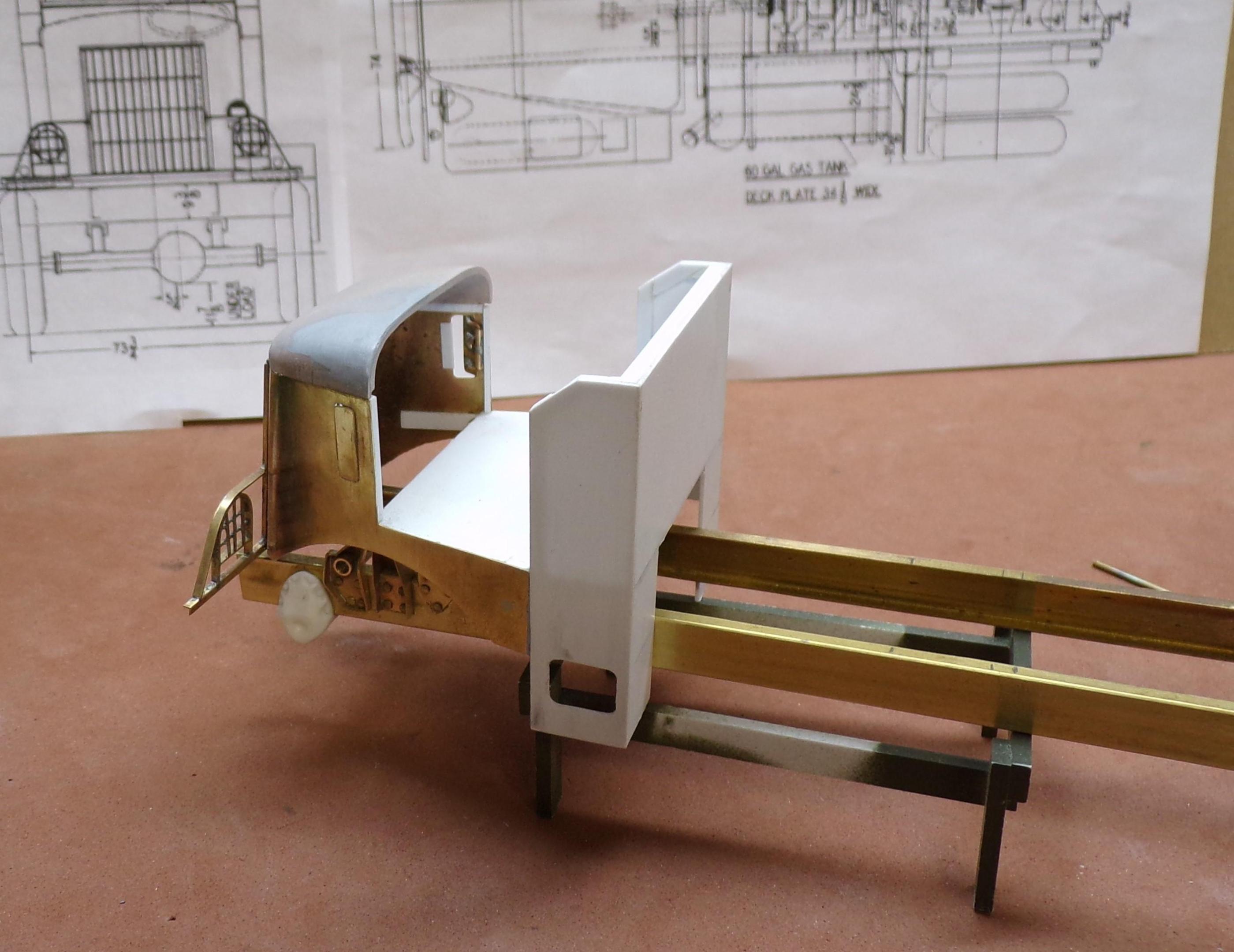

Got the top of the cowl done last night.  Side vents were made up and hinged to open.  The top is Renshape again, thinned out underneath.  It will be glued in place permanently as the hood does not open on this rig.  Access to the engine is either from inside the cab or behind it.  Some photos of the truck show the side vents opening the other way.  I didn't even think about it when they were soldered in place.  Not sure why they would open to the rear.  Other photos in the refrence book show them open as done here.

Thanks, Greg.  In the meantime the study of the cab and frame for the windshield has cleared up some issues so it's on to that part of the build.  And some details for the back of the cab.

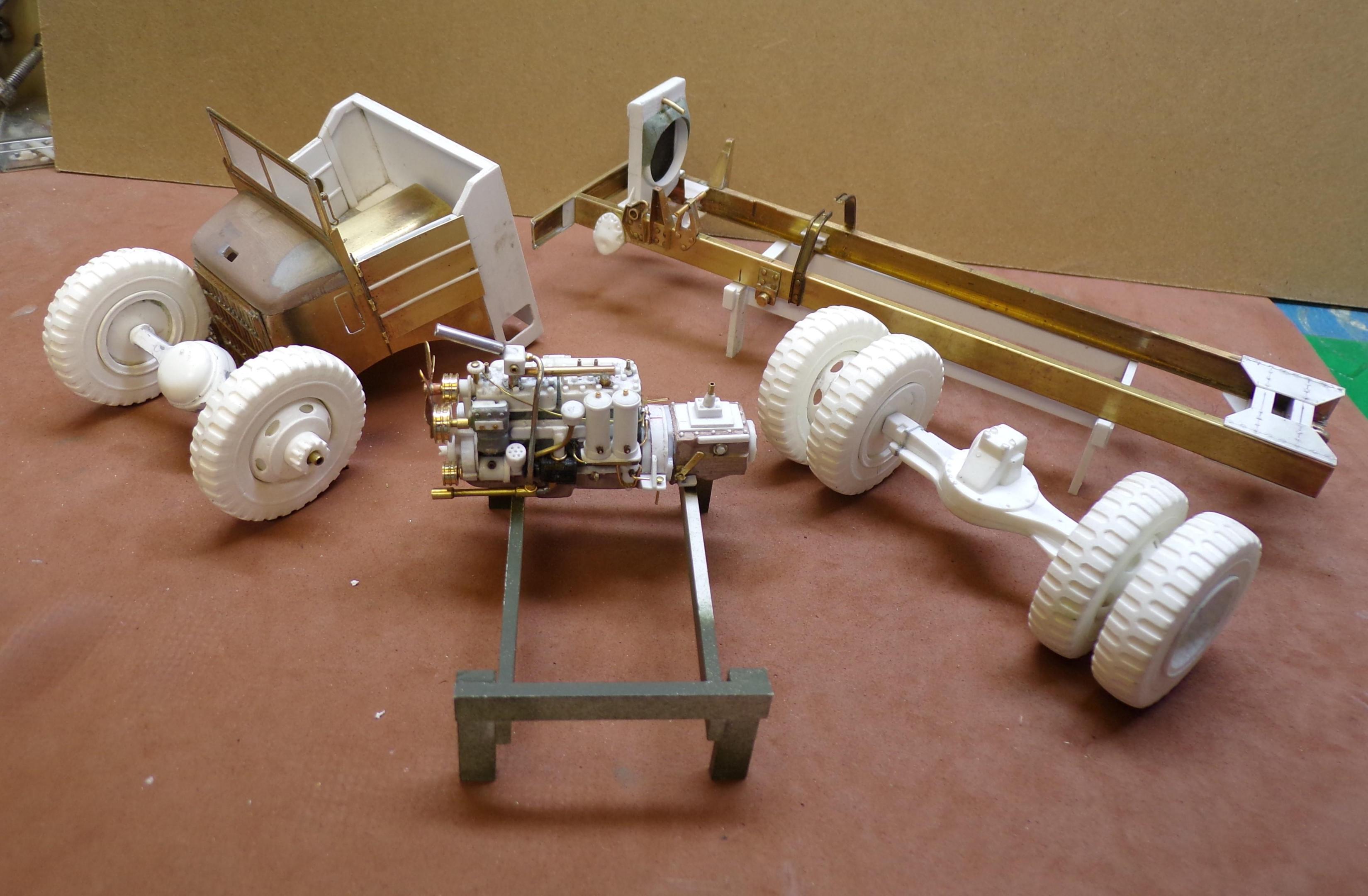

Here's an update of the work done so far.  The windshield frame is done and the glass is fitted.  Protective sheeting is still on it until final installation.  The Hercules RXC engine is coming along.  Still a lot to go on it.

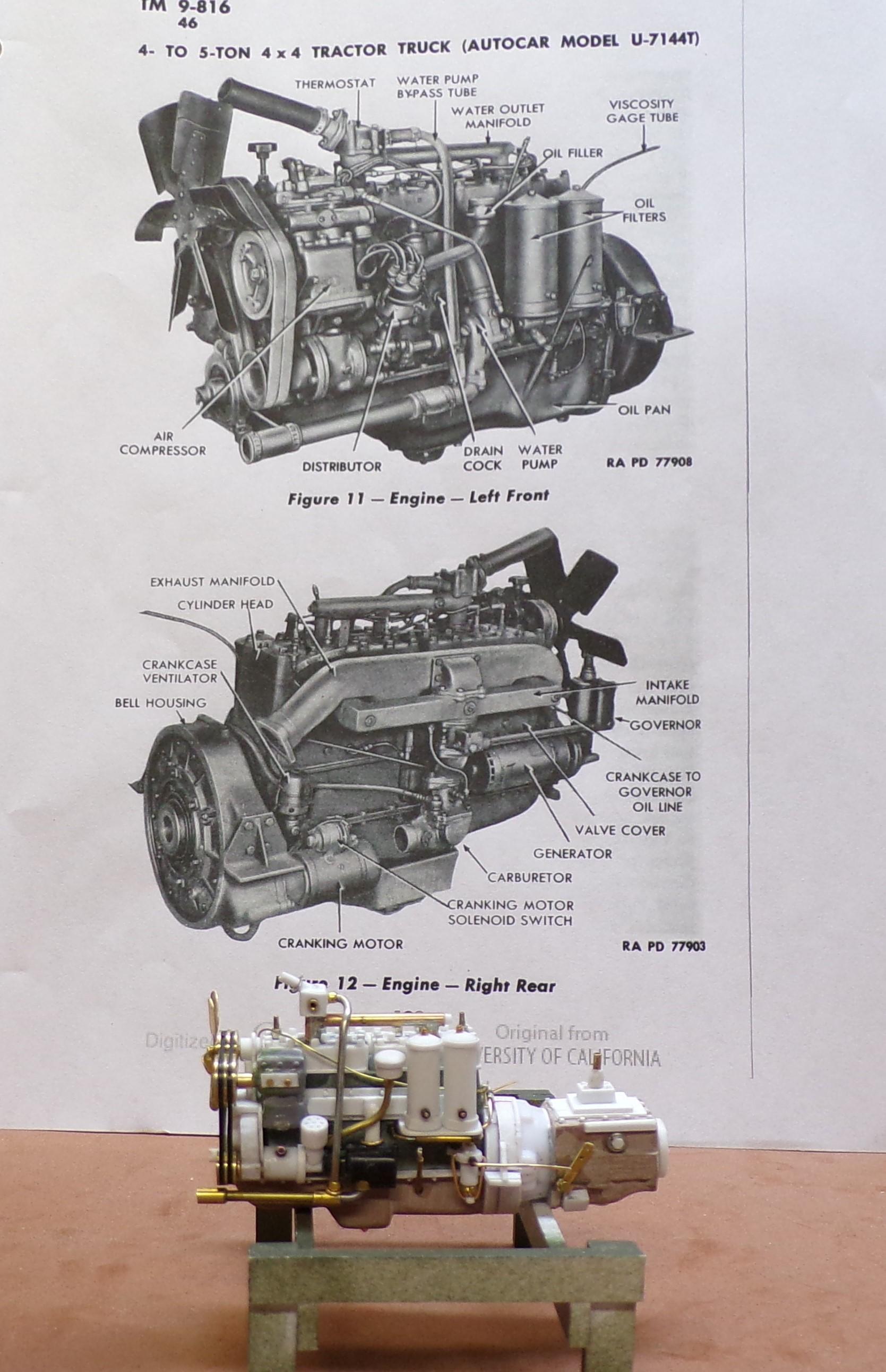

More pics of the engine.  The details are beginning to get a bit in the way of each other!  Paint will be next with some Duplicolor etching primer and then gray as a final color.  Picking out various details will be done in flat and satin black.  Ignition wiring will be done after the painting is finished.  Additional details will be added once the engine is installed in the frame.

That's why I made the cover but I'm thinking that I might find a way to remove the whole cab for viewing of the engine.  We'll see.
