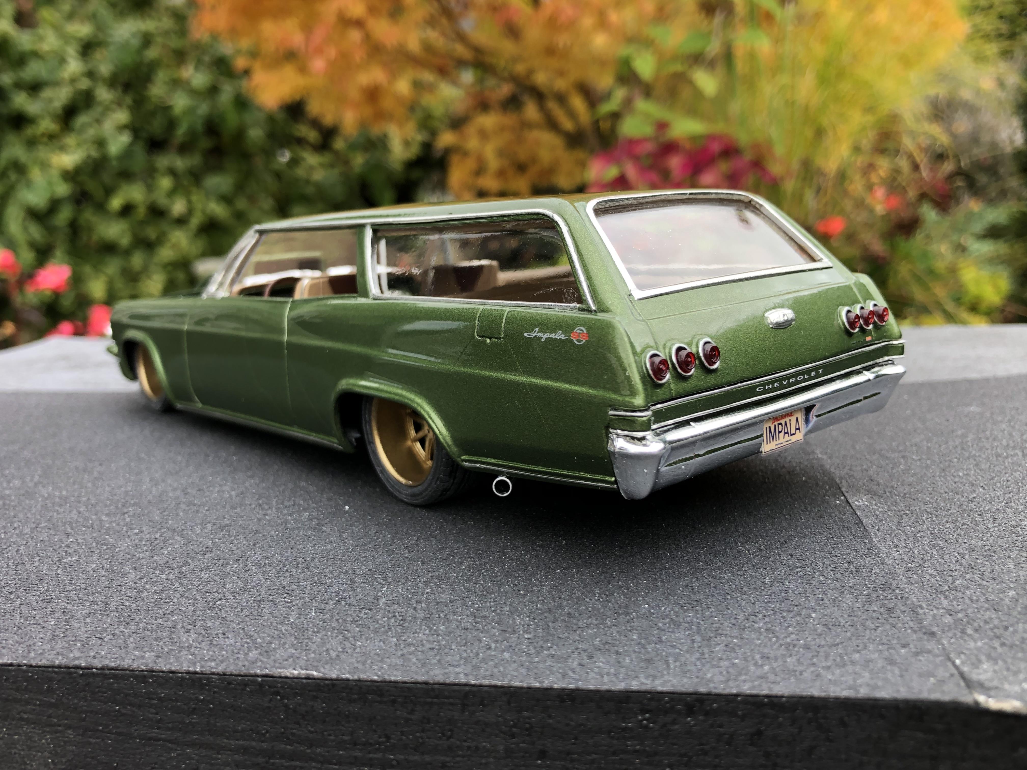

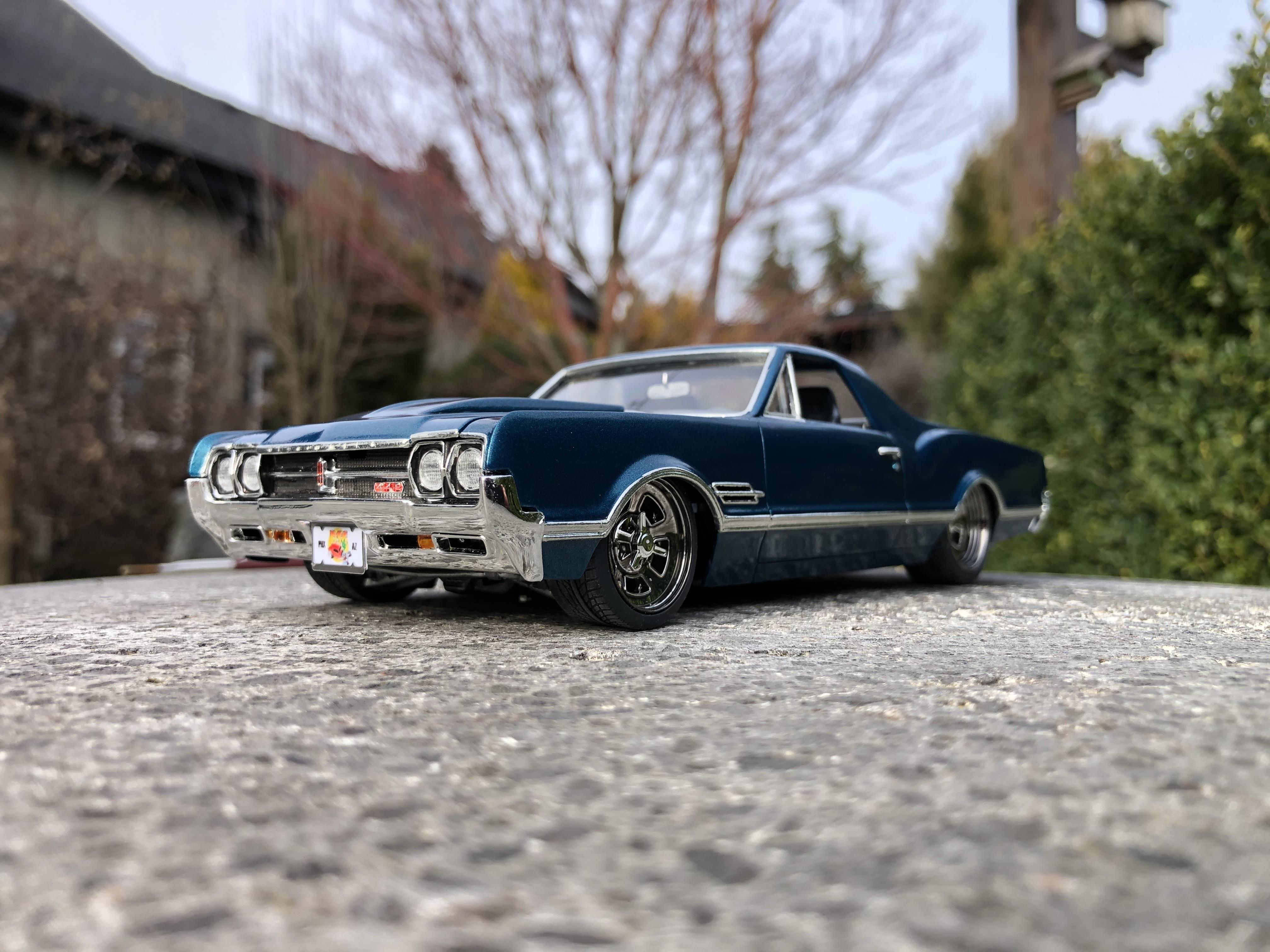

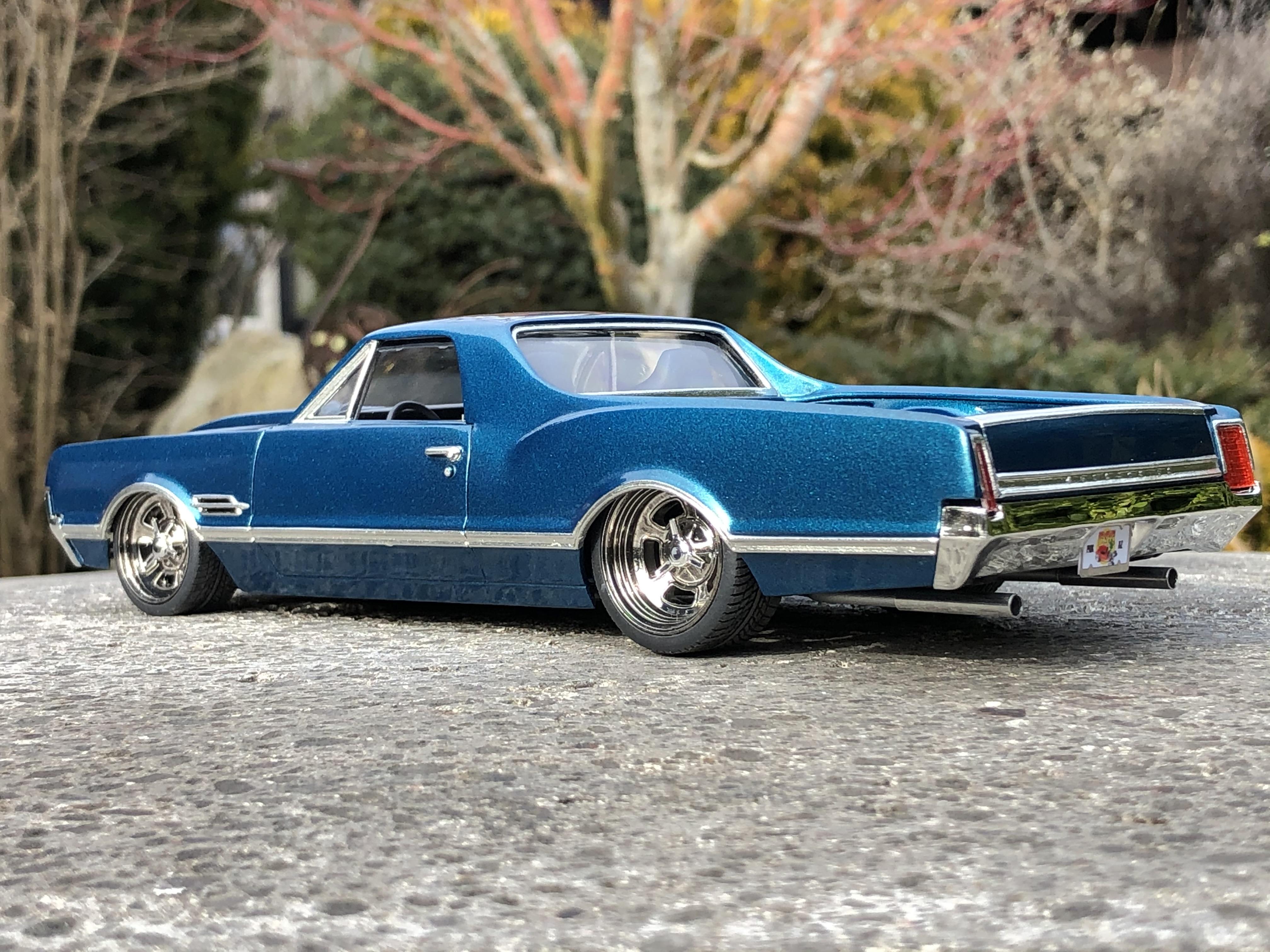

Steve H Posted June 15, 2023 Posted June 15, 2023 Hi Jeff, everyone has differing opinions on this as witnessed by the replies above. Sometimes I leave kit chrome as is, but recently most of my builds get a couple of light coats of Tamiya smoke. Below show a couple of examples. Takes a bit of practice to get it right, the key for me was to warm the paint, and light coats. If you lay it down heavy, the results are not good. 1

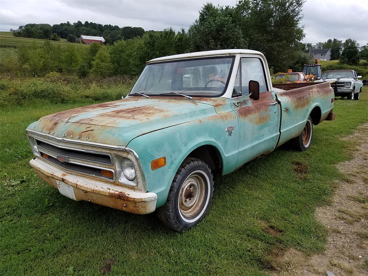

StevenGuthmiller Posted June 15, 2023 Posted June 15, 2023 The bumpers on my 54 year old Grand Prix are old, pitted and oxidized. Never used polish on them in the 42 years that I've owned it. Still looks like chrome to me, and pretty shiny. Steve
jeffp60 Posted June 15, 2023 Author Posted June 15, 2023 On 6/15/2023 at 2:29 AM, Steve H said: Hi Jeff, everyone has differing opinions on this as witnessed by the replies above. Sometimes I leave kit chrome as is, but recently most of my builds get a couple of light coats of Tamiya smoke. Below show a couple of examples. Takes a bit of practice to get it right, the key for me was to warm the paint, and light coats. If you lay it down heavy, the results are not good. Expand Impala is what I am looking for. Not a "mirror" finish. Annoys me when I ask a question and I get a bunch that just has opine about my choice but can't answer my question. I post my builds for honest critiques, I post questions for answers. Thank you Steve H for the answer and photos 1

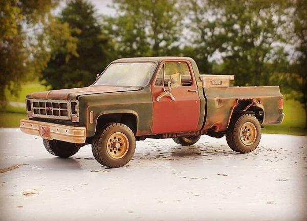

KWT Posted June 15, 2023 Posted June 15, 2023 (edited) The GMC plow truck is a 40+ year old kit, originally released by monogram. Just to add to the topic.. I sprayed the chrome on mine with flat clear and then "rusted" it up. Edited June 15, 2023 by KWT 1
