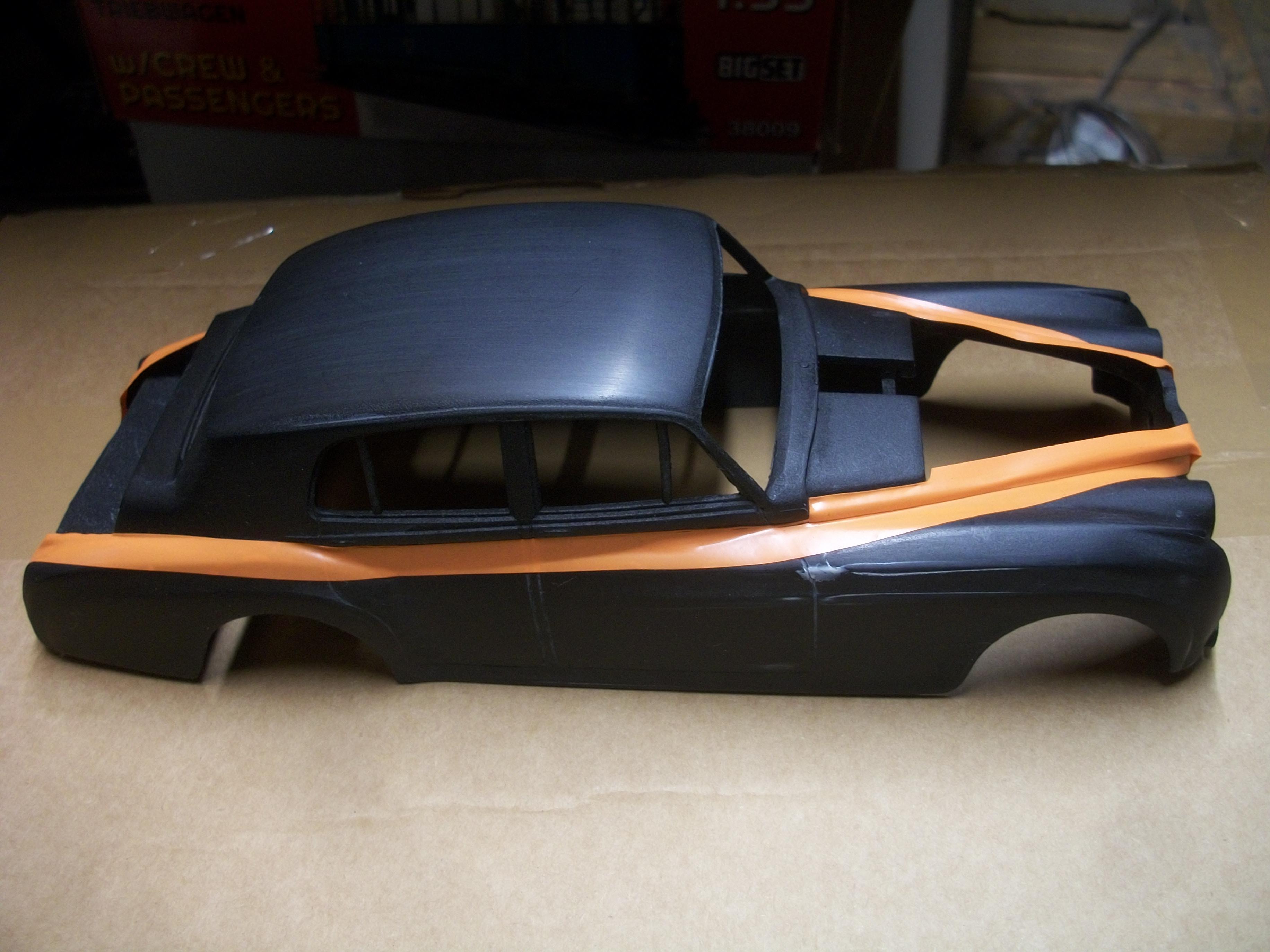

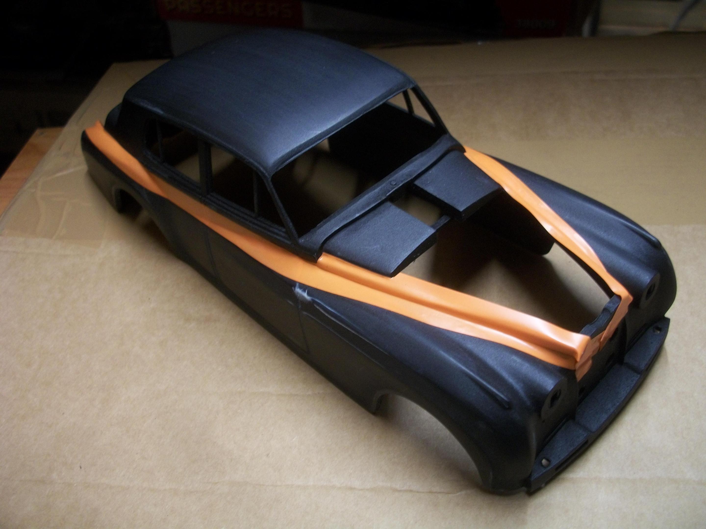

Anglia105E Posted June 20, 2023 Posted June 20, 2023 Not sure if this will help you Jeremy at this stage, but when I carry out two-tone paint jobs on my 1:24 scale Rolls-Royce Silver Clouds, the tape that I use is a specialist automotive tape . . . The tape is orange, 6 mm wide, shiny PVC type surface to it, and it bends around corners. This tape is primarily intended for coachlining work between two colours on full size 1:1 cars, like Pin Stripe . . . . Here is a link to an Ebay seller for the product . . . https://www.ebay.co.uk/itm/175544494533?hash=item28df4469c5:g:0HoAAOSwMEBjpHEy&amdata=enc%3AAQAIAAAA4CkrGR1SKtrhjGMbAhjZ6yenoDF9UPaABPLqc93VP4ZJh1Z4l87mRh9AAWAFRhnsWAjCeVEqbbdOn92g1n8x7xa9Z5fxEZDZm8atZXFpjXg9rwE3AUcftyfkvT5p3UJ5wwZXyuPVPU6ttVXnX4vGuJmCYKwxpvUGmI9QPsYL8SSyzqMjHvpH0N1%2B9HMVsO6tdq0f5hJZh8%2Bq6IkEVfvl0wli8QtHHkJRE6Ku9cfBh%2BrVg5BVFvl7G%2Bcvb5%2Ft8oI3ZWLgvwgwHFaFJsUgeUCLUllZNaG9Rh4yVFtXffrUCBzD|tkp%3ABk9SR4bTuImbYg# Two photos of a previous masking job. The tape is also available in 3 mm width and different colours. David 1
