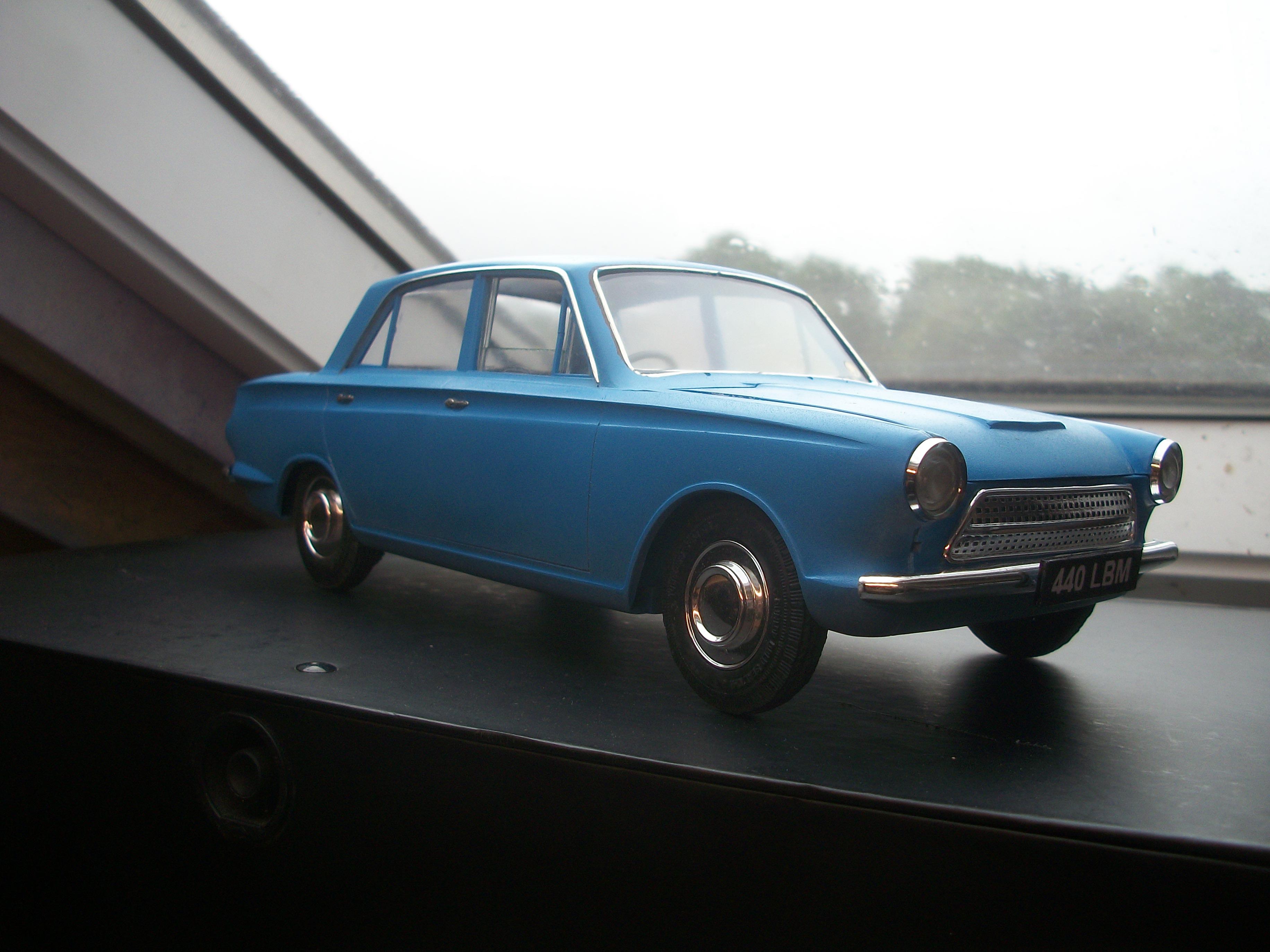

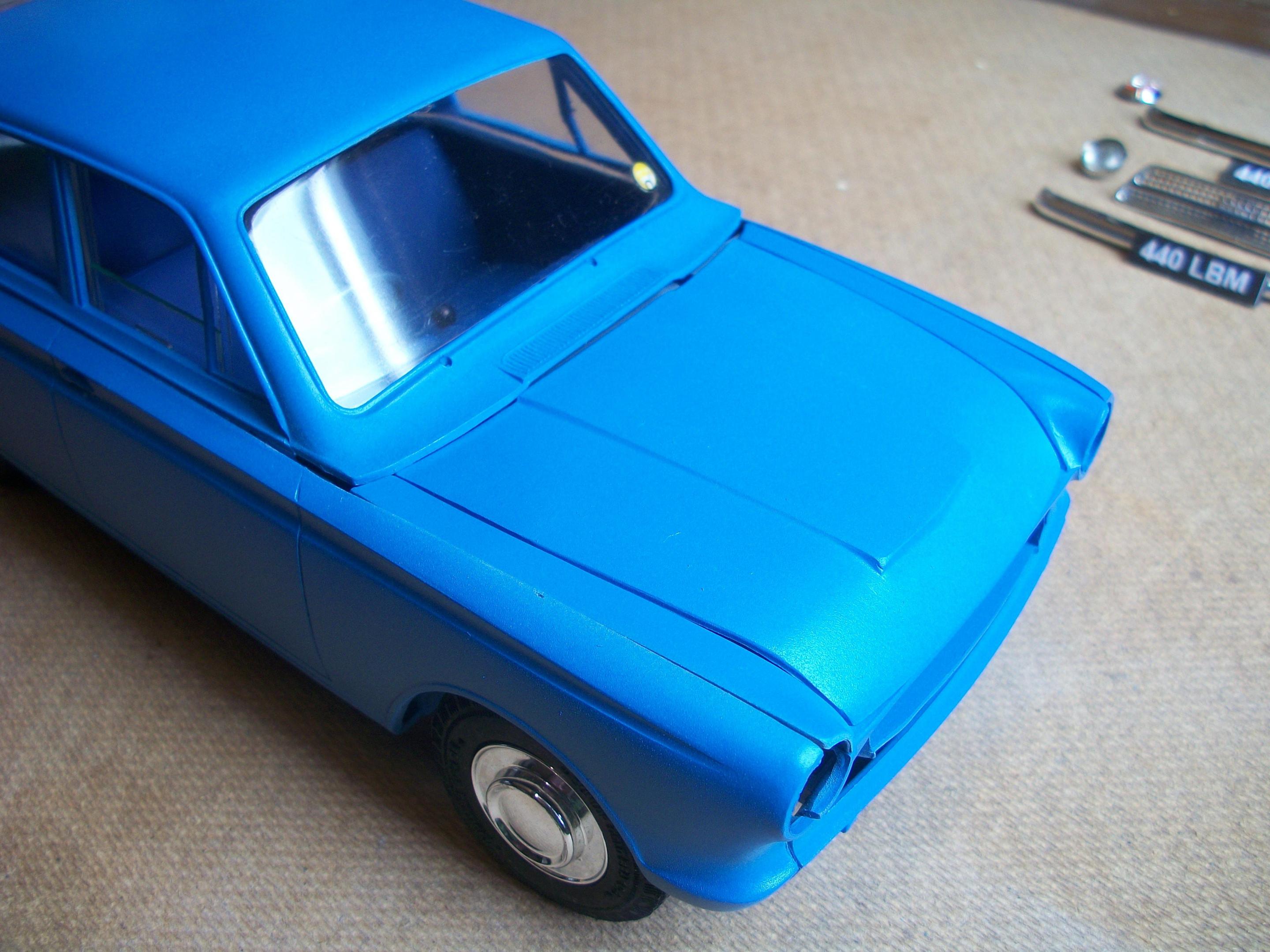

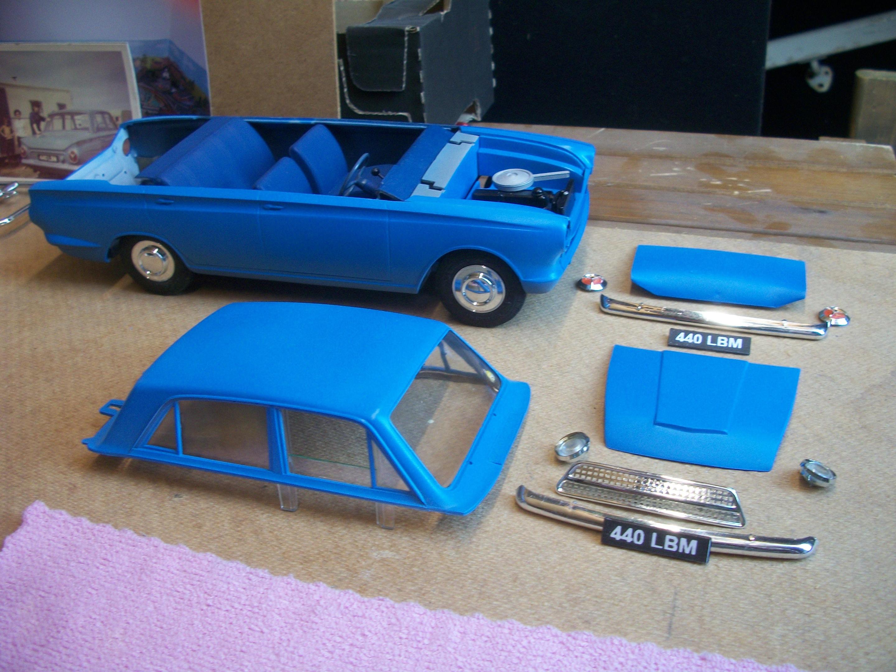

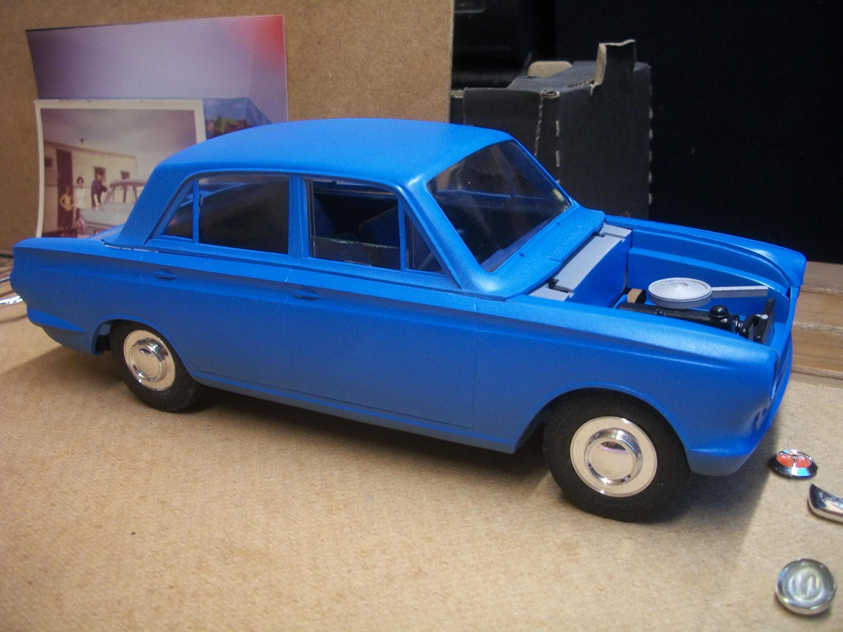

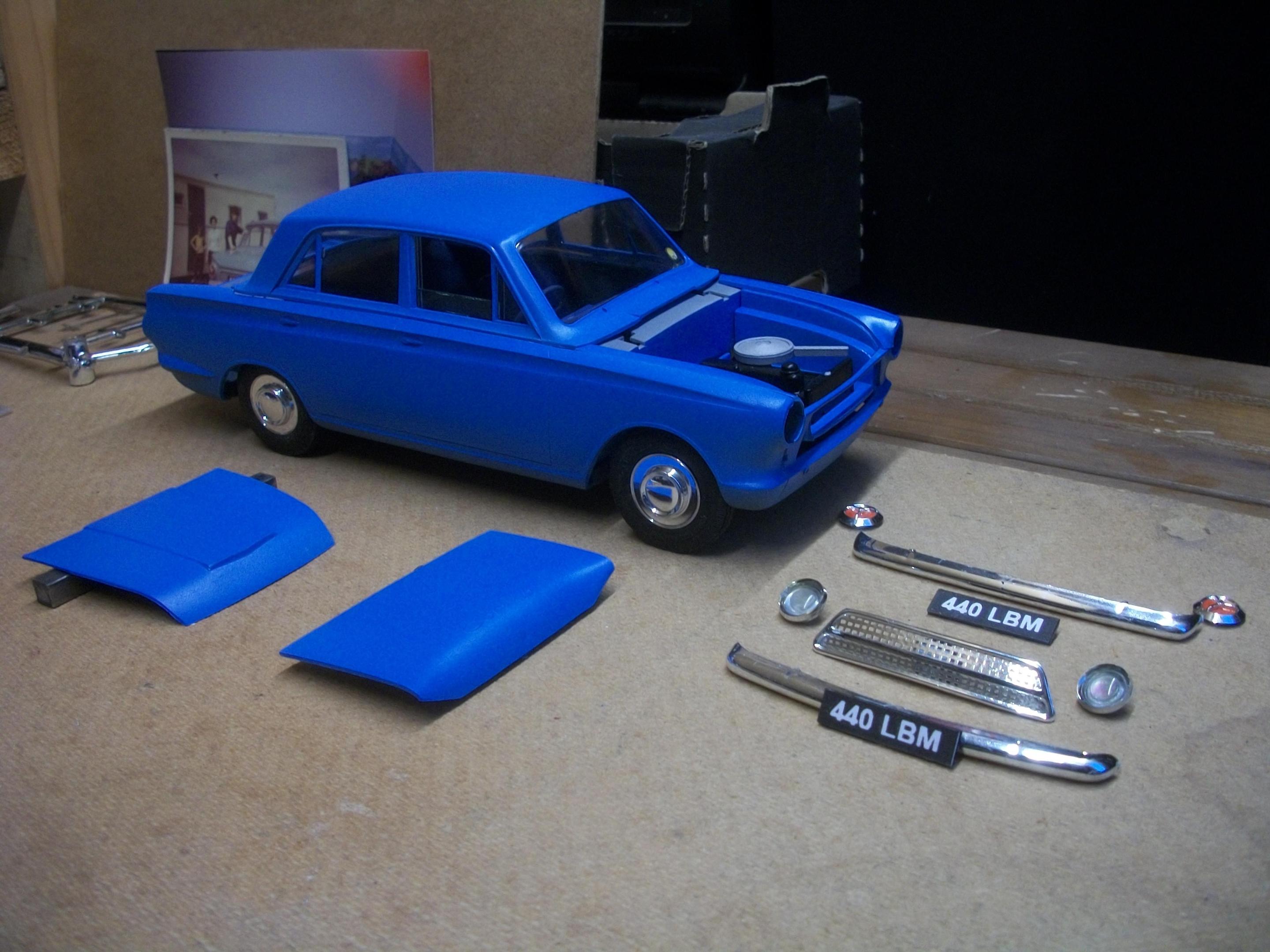

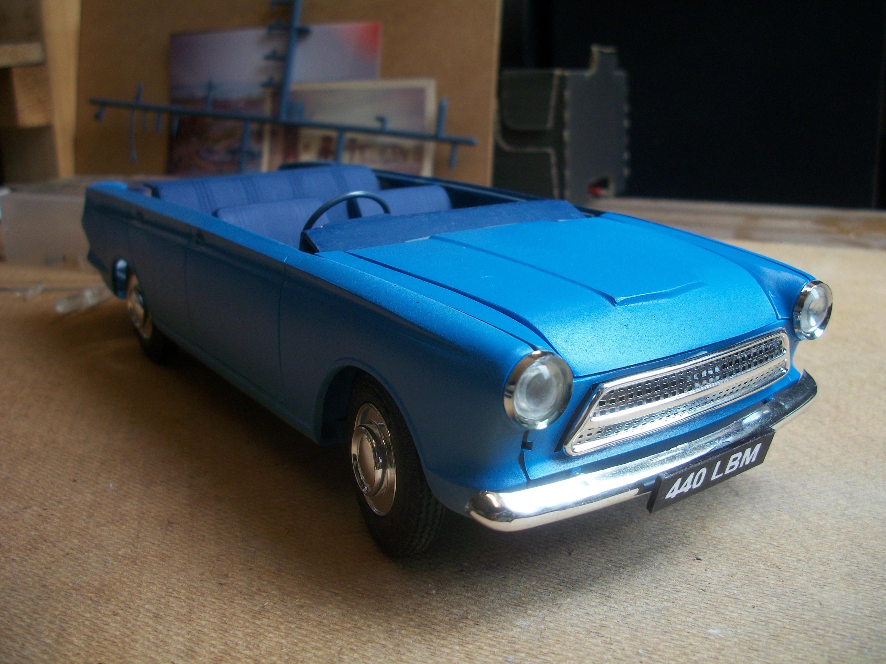

The front end components have been test fitted, including the radiator grille, front bumper, front number plate, and the headlamp reflectors and lenses.

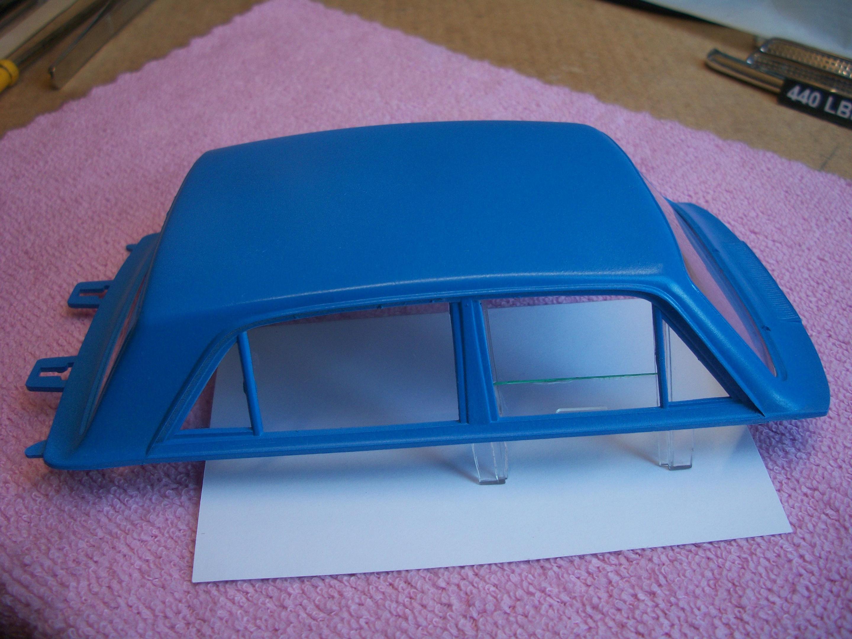

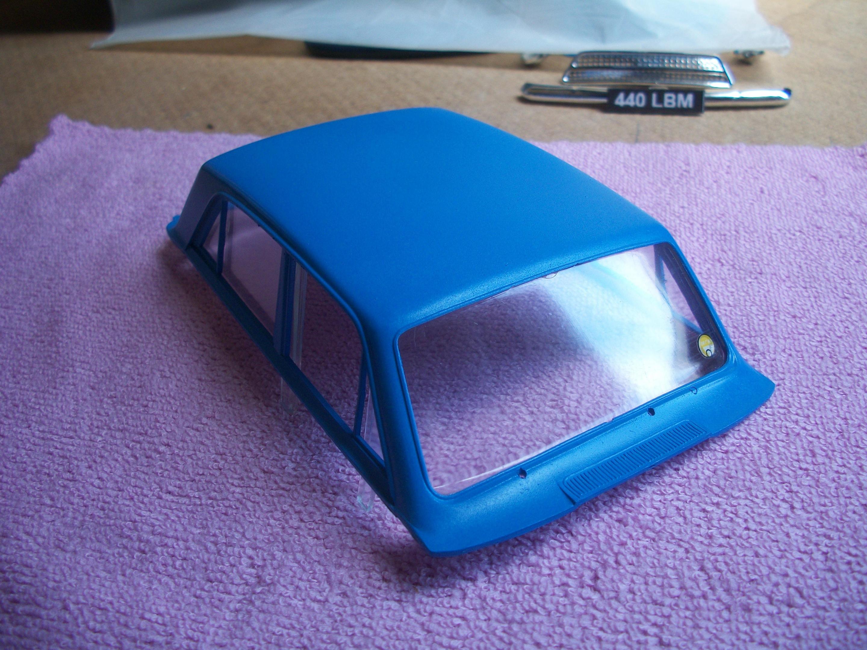

Using Crystal Clear glue, the window glass section has been fixed inside the roof, and the drop down driver's door window was measured, cut to size and glued in place. This window is in the ' lowered ' position and the glass is edged with green Sharpie.

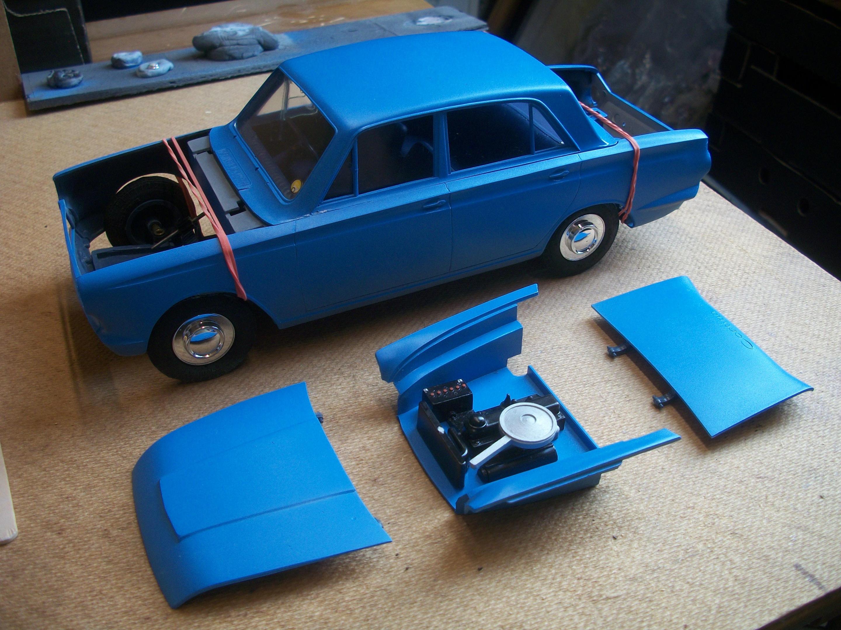

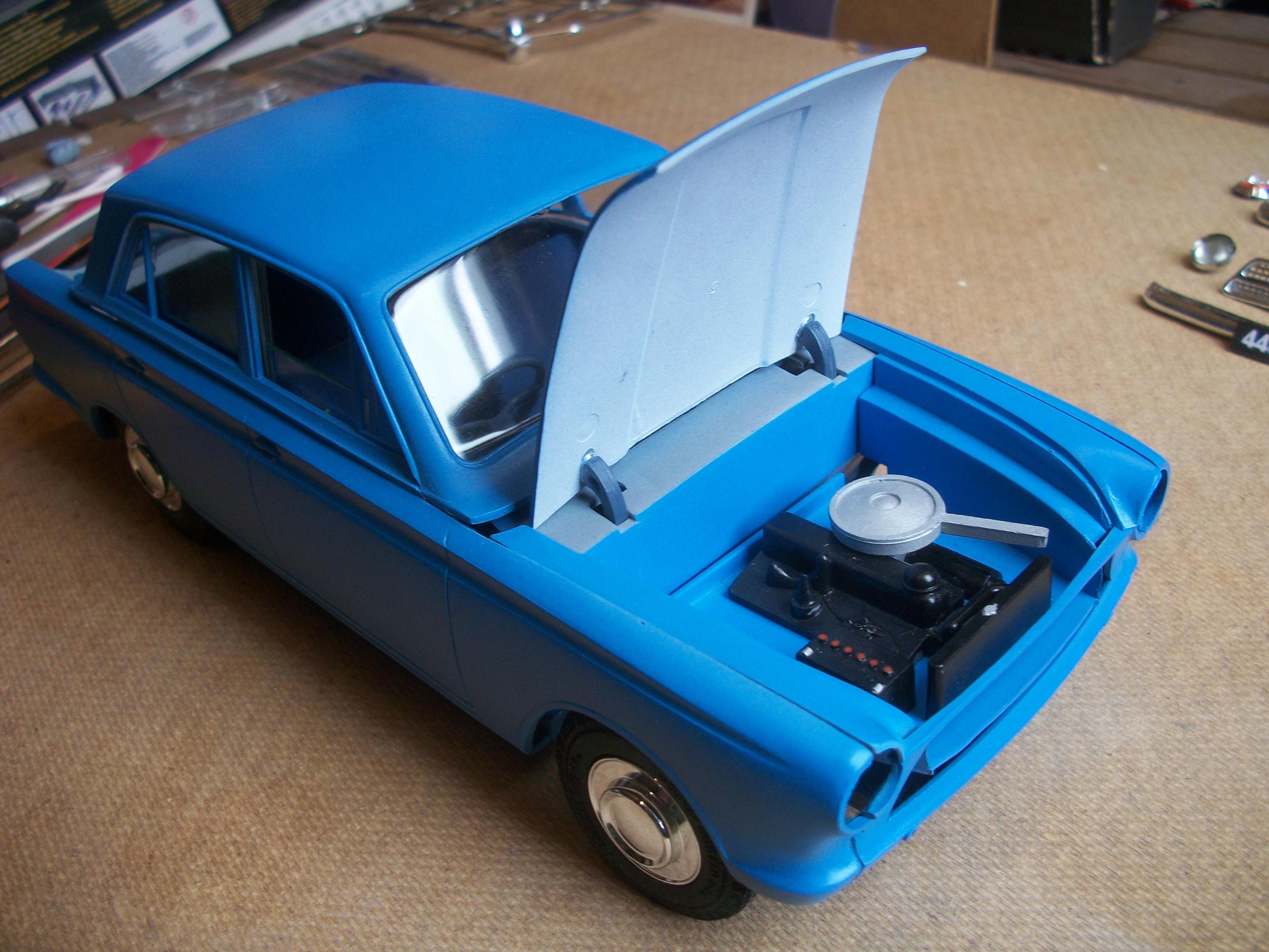

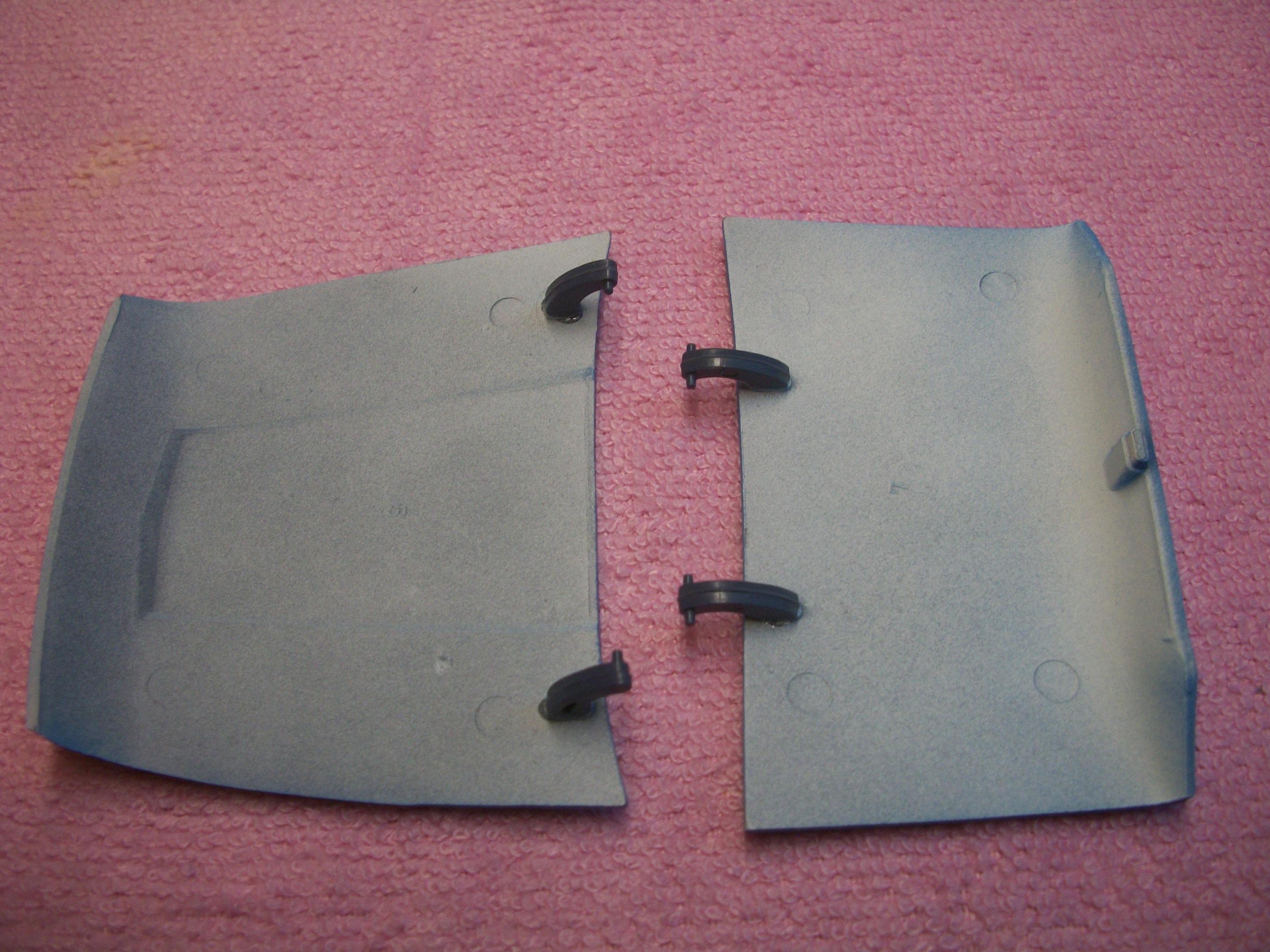

Both the boot lid and bonnet now have a pair of hinges, ready to set in place on the car body. Both are working parts.
Fitting the roof section to the body will be somewhat tricky, but it should turn out okay hopefully !
David

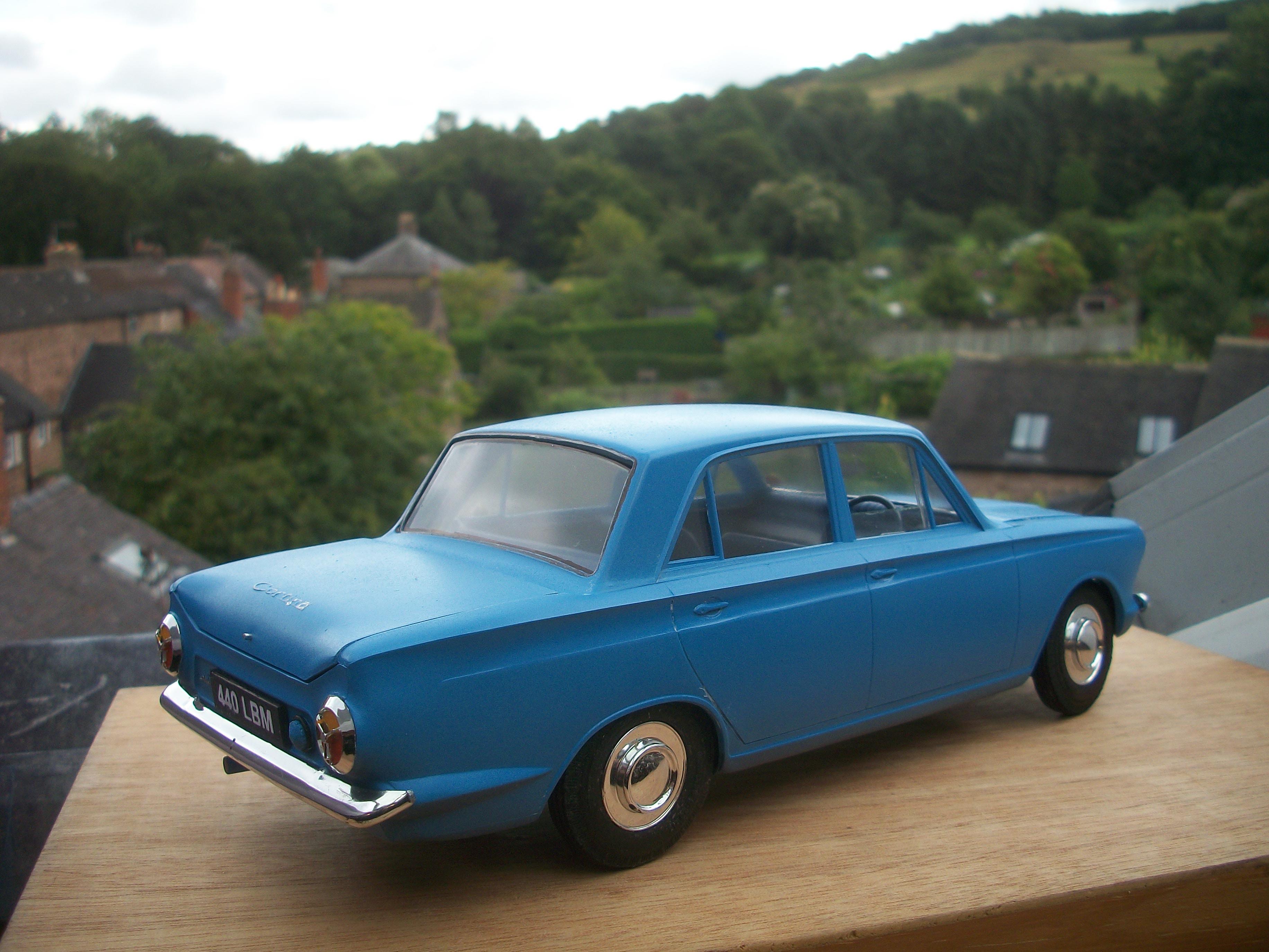

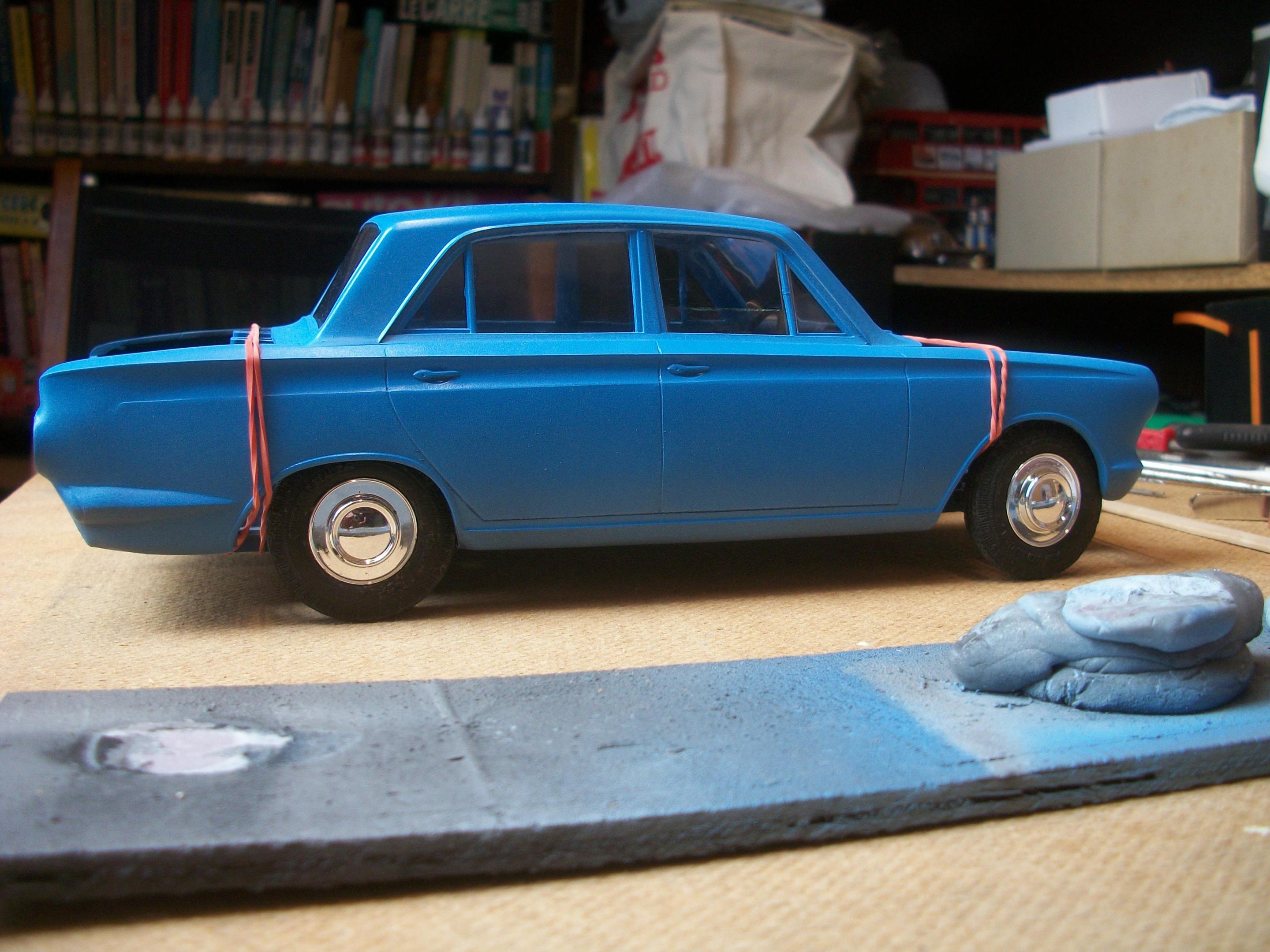

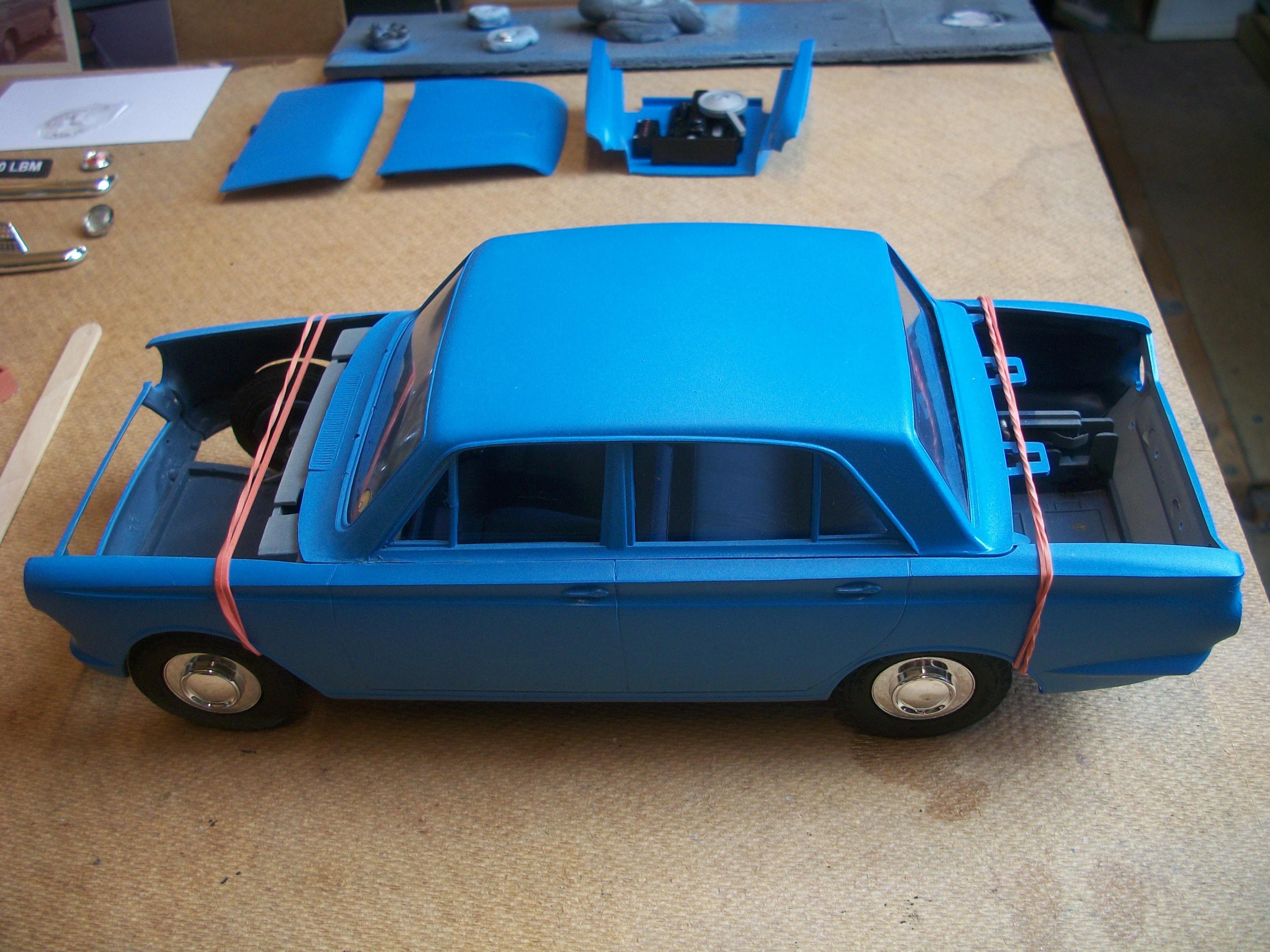

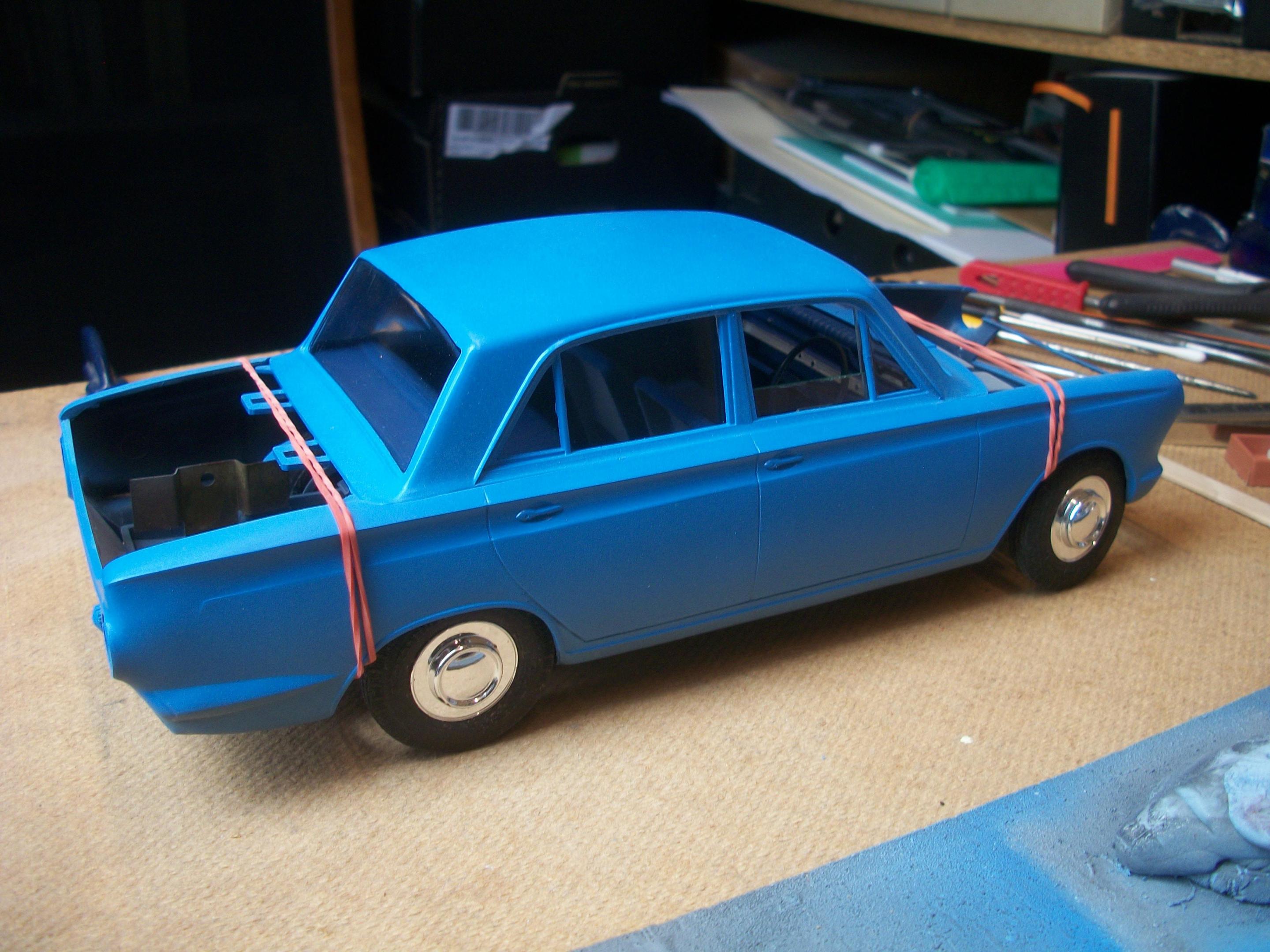

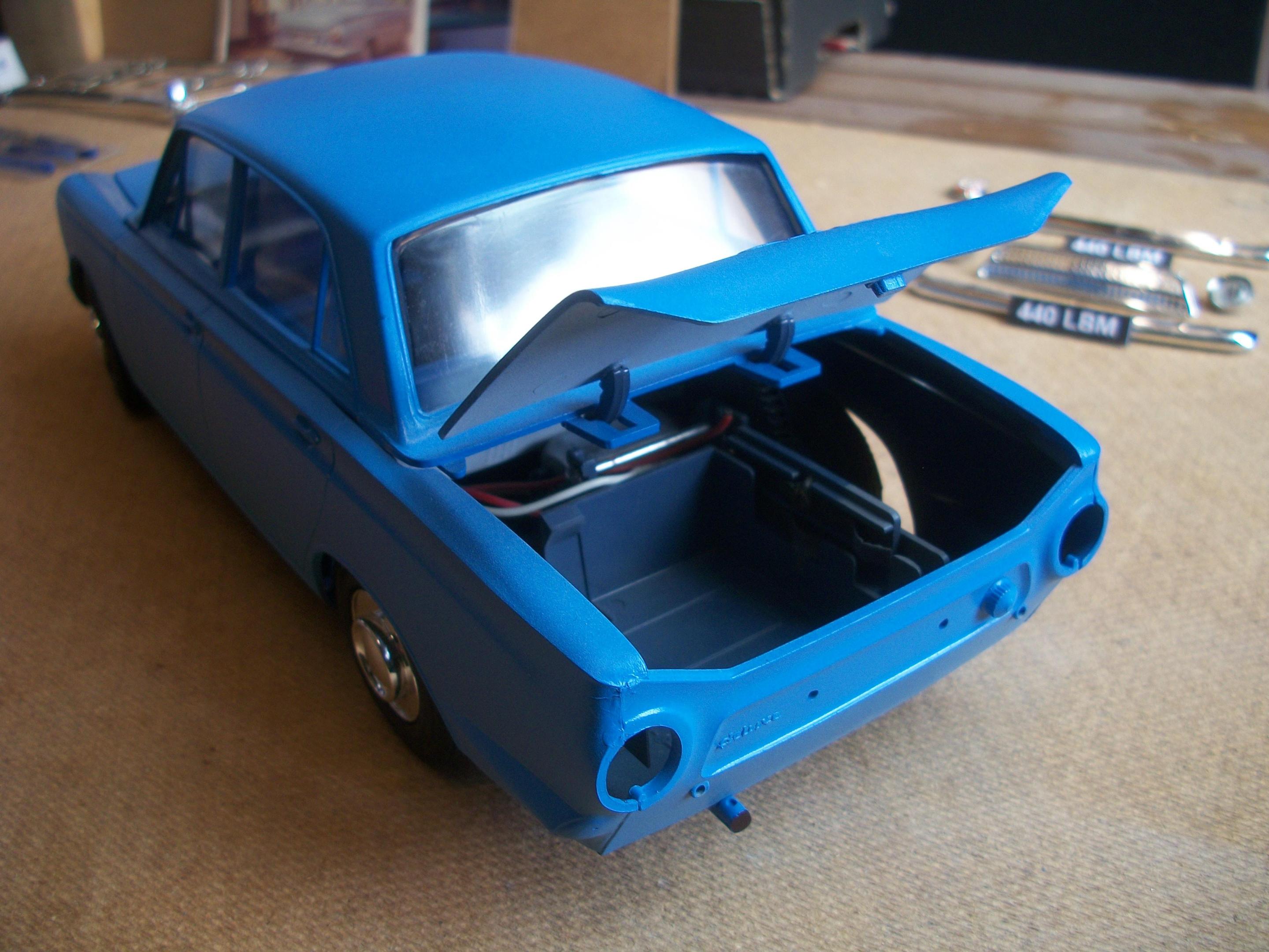

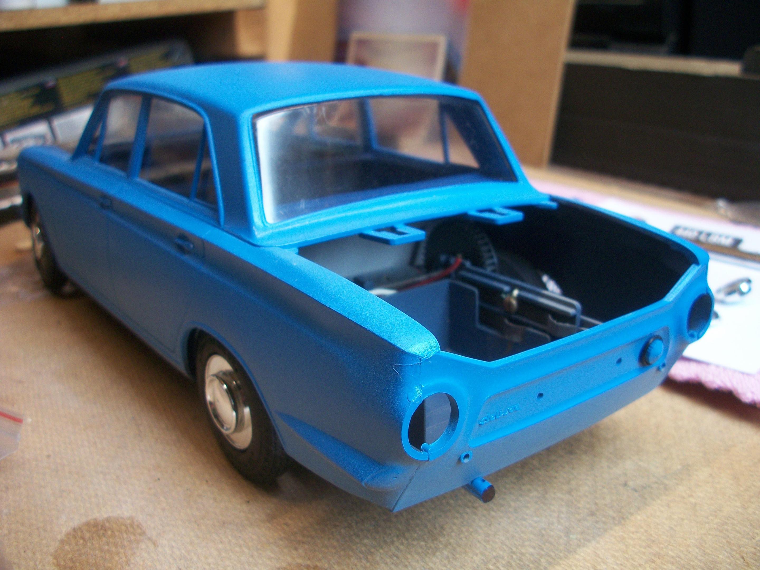

The bonnet panel and the boot lid seem to fit quite nicely on their hinges. Moving onto the next task . . . This was to align and glue into place the roof section, which locates along two narrow ledges, one on each body side panel. The right hand side of the roof fitted well, but over on the left hand side the roof would not easily press down inside the edge of the side panel. To allow this to locate properly before applying glue, I removed the bonnet, boot lid and engine bay panels . . . Then, by prising the side panel away slightly, the edge of the roof section dropped into place.
A couple of rubber bands are holding the rear of the car together overnight and a couple more rubber bands are holding the front of the car together. This coming week is all about polishing the paintwork, and also dealing with chrome work.

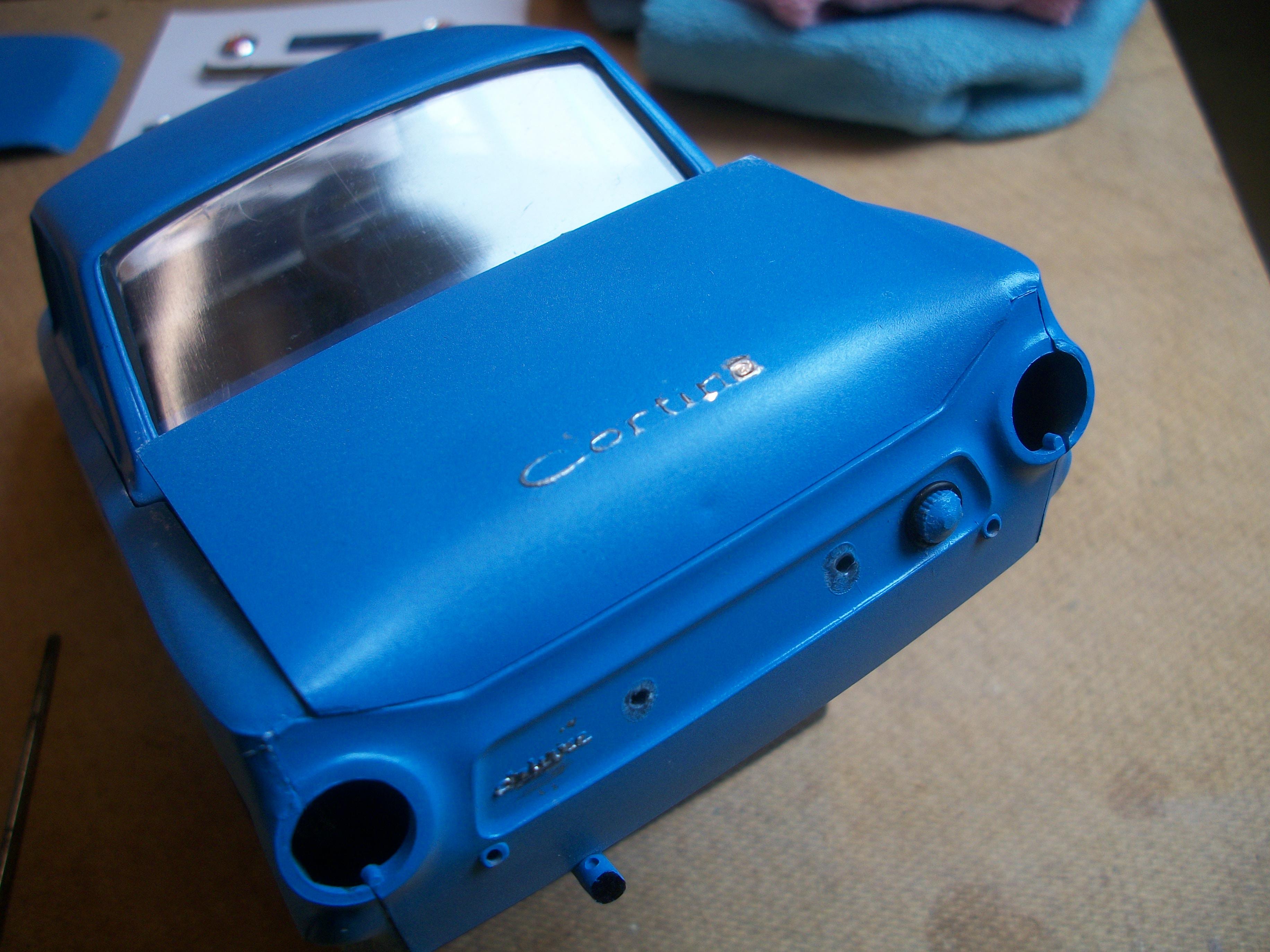

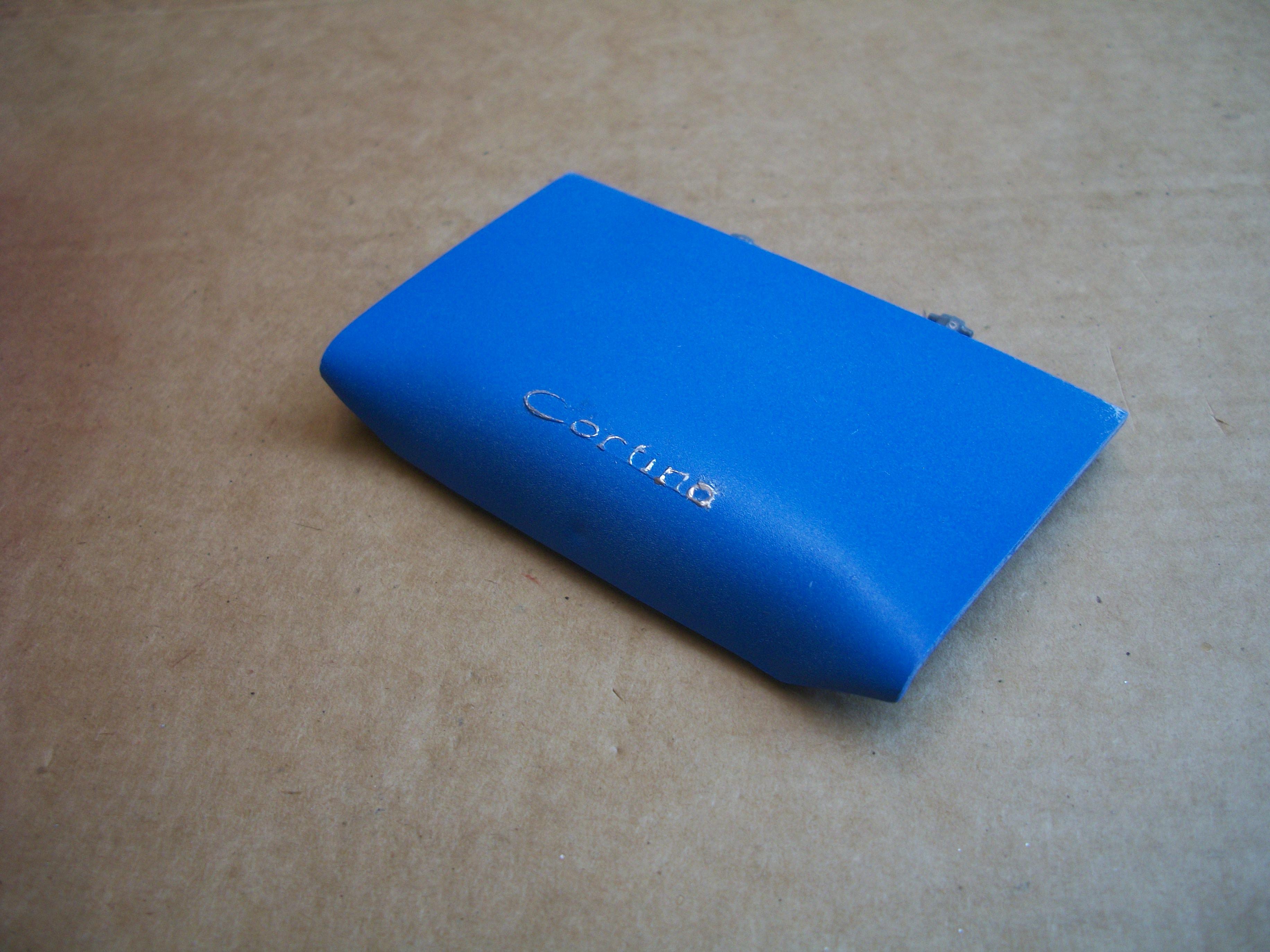

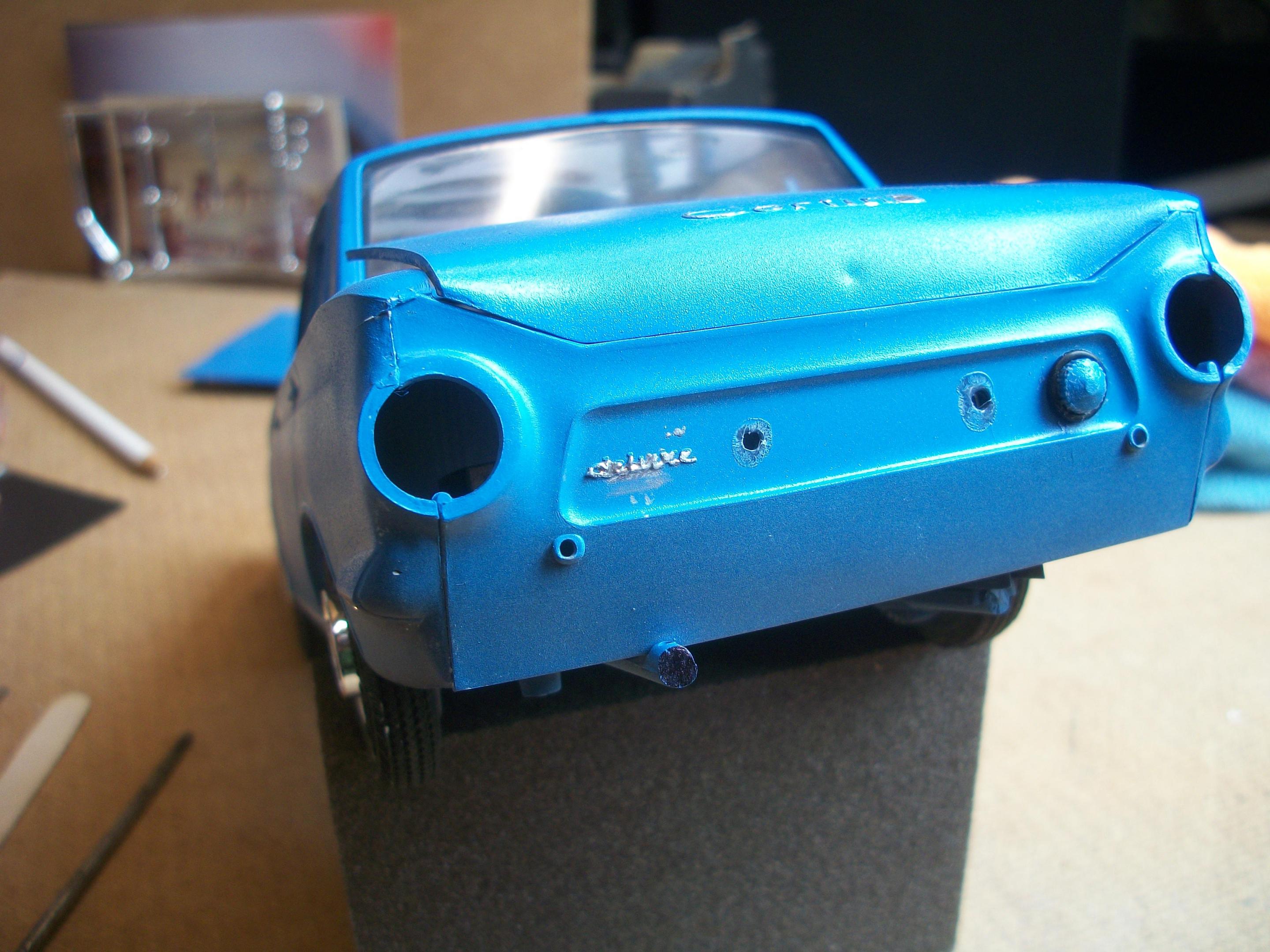

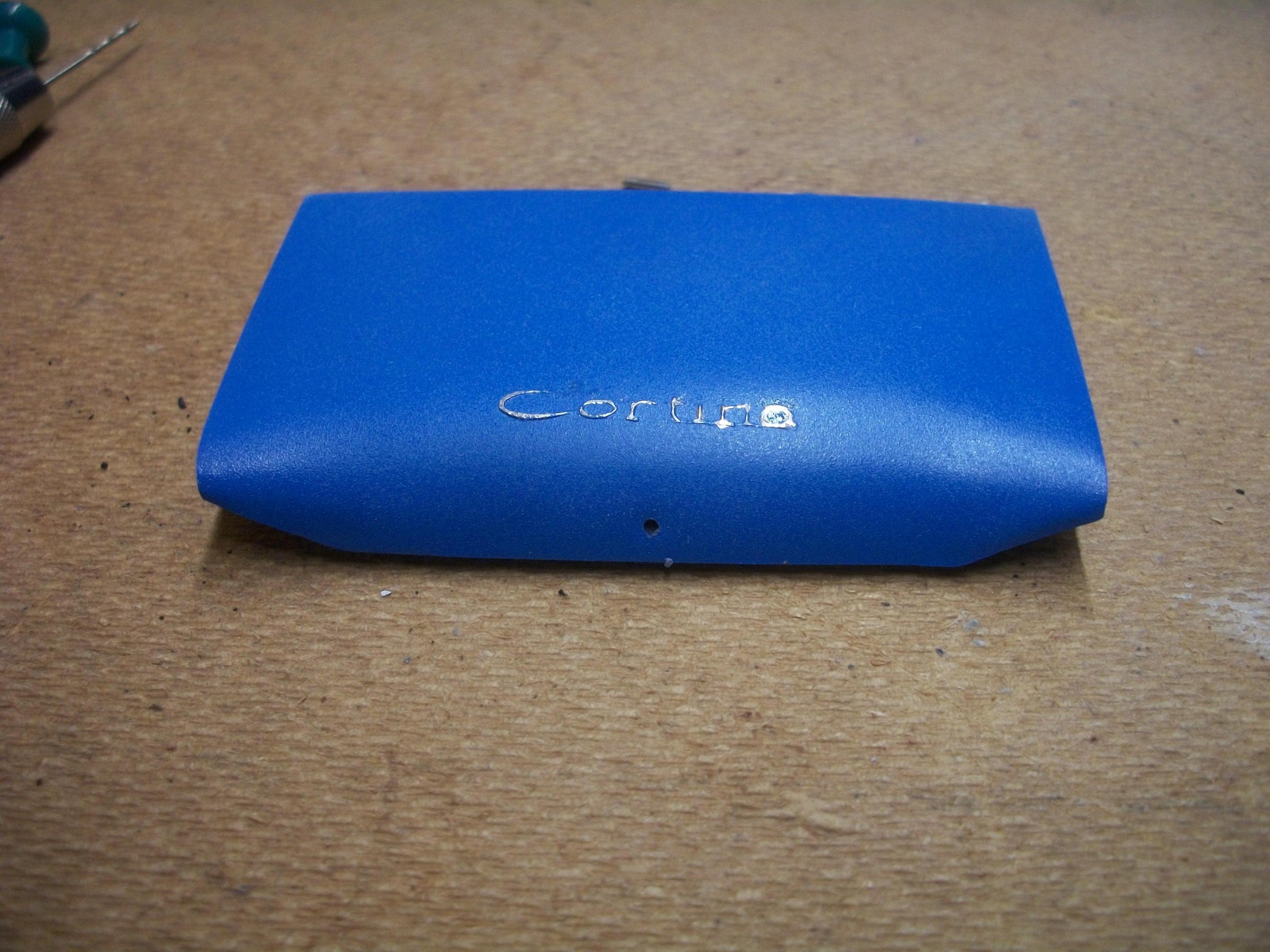

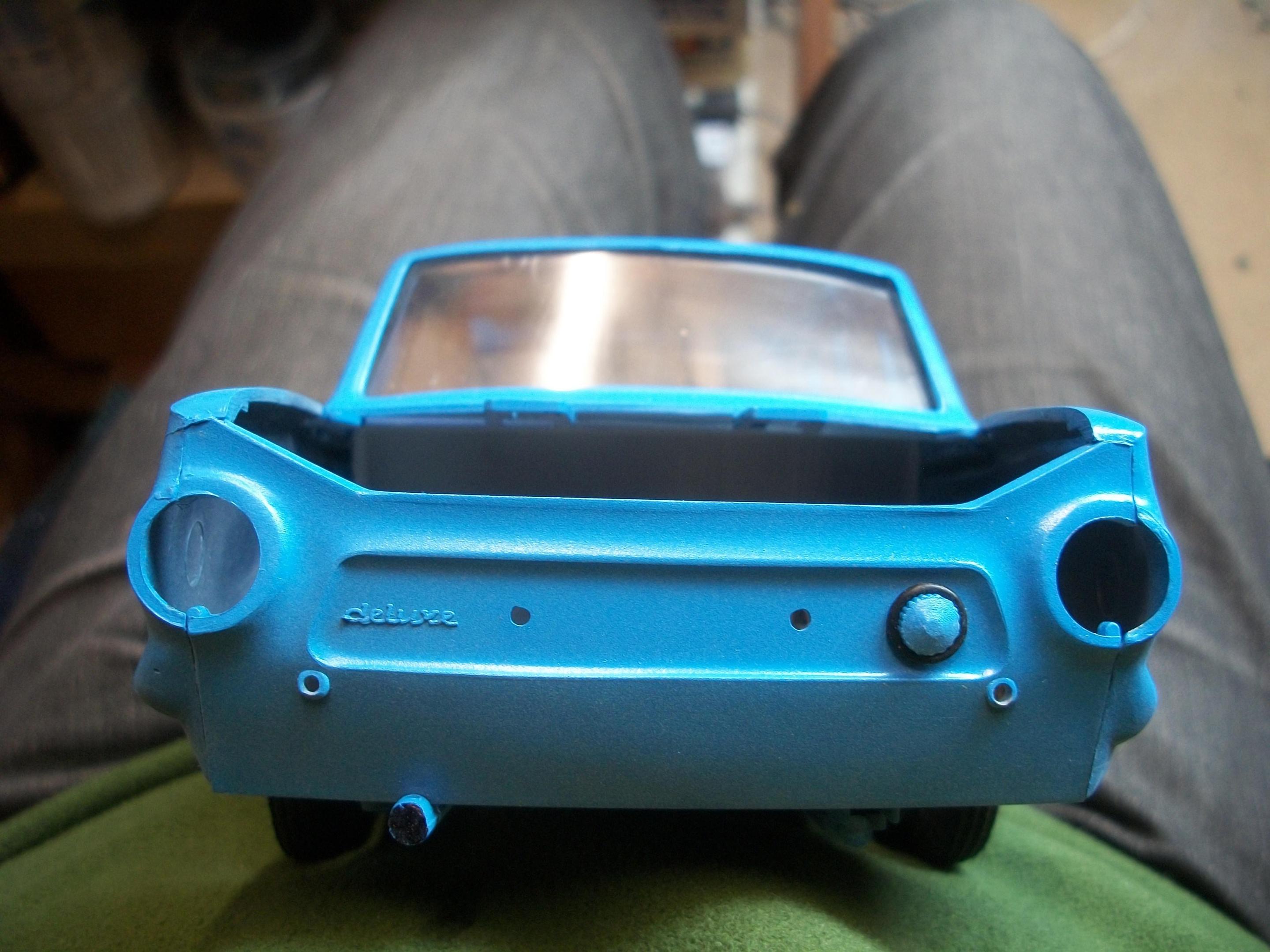

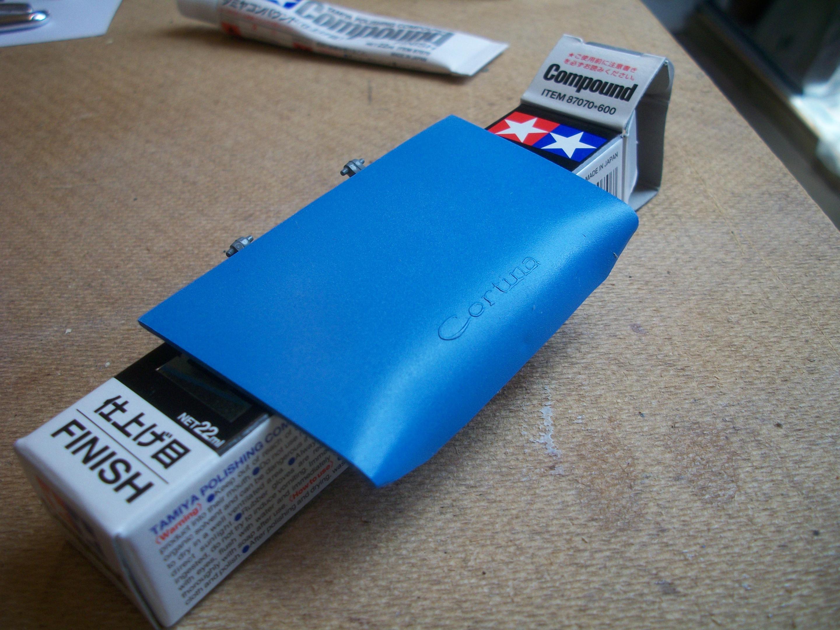

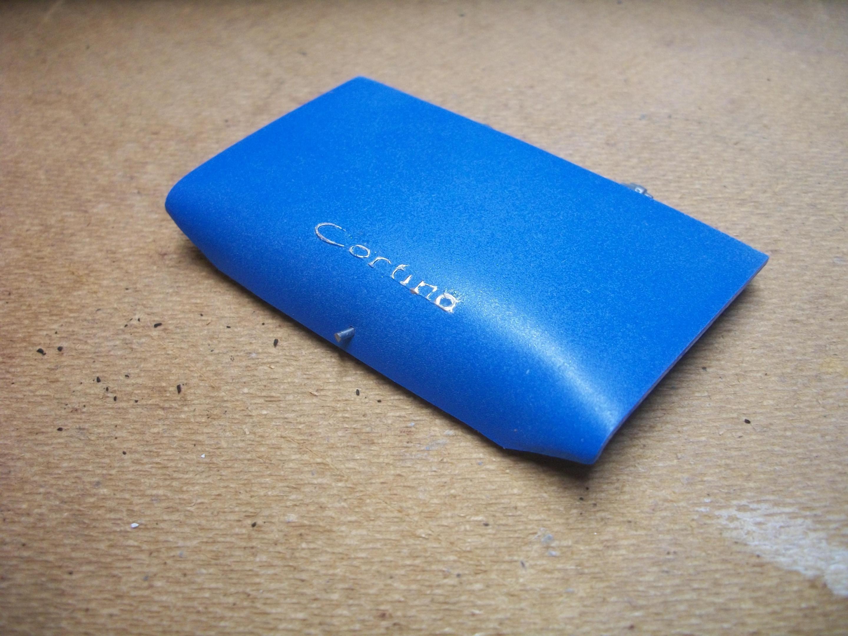

Here is a question for the experienced model builders on here . . . This has probably been covered previously on MCM forums, but I don't remember the answer, if there is one . . . Before starting this Cortina build I considered the idea of using BMF on the scripts that are on the rear of the boot lid, before moving on to the primer painting and topcoat painting . . . But foolishly I didn't do that. Now of course I have fully painted this model car, and applied polish on some panels, including the boot lid. My question is how can I apply chrome to these two scripts, having got to this advanced stage?
I don't feel confident to use my Molotow Liquid Chrome pen, which has a 1 mm tip, and I don't fancy my chances using a very fine brush to apply the liquid chrome from the refill which I have. Could I still use BMF in this situation? ( probably not ).
The two scripts shown in the following photos are ' Cortina ' and  ' deluxe ' . . . This is a schoolboy error I know, and I should know better !
David
The one on the rear panel may stick out enough to paint (dry brush technique). Another approach worth considering is to apply a thin coat of chrome paint to an eraser, let the paint set up for a minute or two and then tamp the painted eraser onto the raised scripts.
If the logos stick out quite a bit you could try the dry brushing technique. If doing this mask off as close to the logos as possible so as not to get any paint on surrounding areas. Use a good quality masking tape like Tamiya's or Washi thin paper masking tape. In the UK, Wikos sold Washi tape. It was red in colour. I think they sell the same thing but now call it paper masking tape and the colour is now buff. I use it a lot on my models. It is both good and inexpensive.
When dry brushing make sure there is next to nothing on the brush hairs and drag almost horizontally across the very top of the lettering. He patient and build up very, very gradually until you obtain the desired effect.
As another thought, as you are making this for your dad, a nice finishing touch would be to buy a dedicated acrylic display case and mount the model in the case. It will protect the model both from dust and unnecessary handling to keep it in pristine condition. After all you have invested a lot o time and trouble to make it for him!
Edited by Bugatti Fan
That is exactly the idea that I was trying to remember Greg . . . I have a pencil that has an eraser on one end of it, just like in the old school days, so it is a hard pink eraser. This might well be my best option, so thank you . . . Certainly I will try the technique on the ' Cortina ' script first, and if successful then apply the liquid chrome to the ' deluxe ' script.
David
The ' deluxe ' logo is raised quite a bit on the rear panel, whereas the ' Cortina ' script is not raised as much on the boot lid . . .  I shall keep the dry brushing technique in mind of course, but I am leaning towards Greg's suggestion about using an old pencil type eraser, by tamping a small amount of liquid chrome onto the raised scripts after allowing the paint to set for a minute or two on the eraser. This was a technique that I had seen used on MCM forums some time ago, but couldn't remember seeing the topic.

Now it is well past midnight, and the two raised scripts have had chrome applied earlier today, so I shall post on here during Sunday sometime.
David

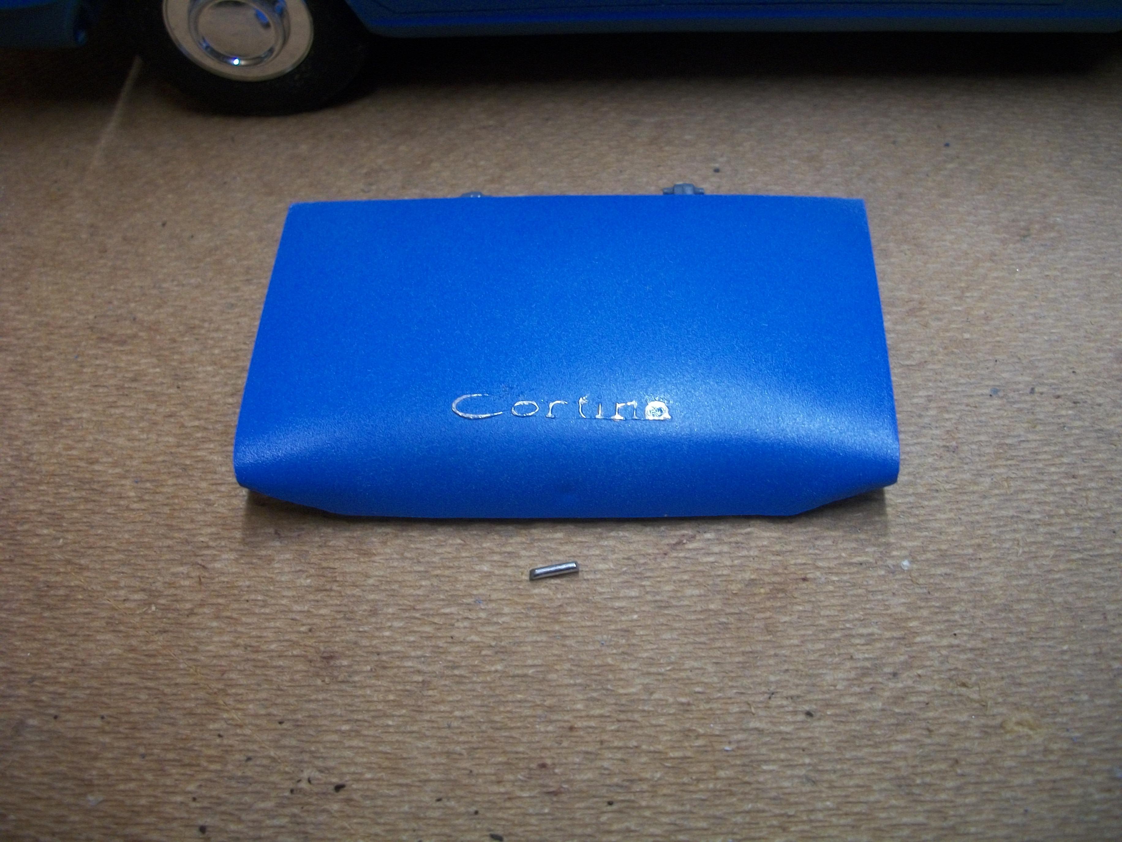

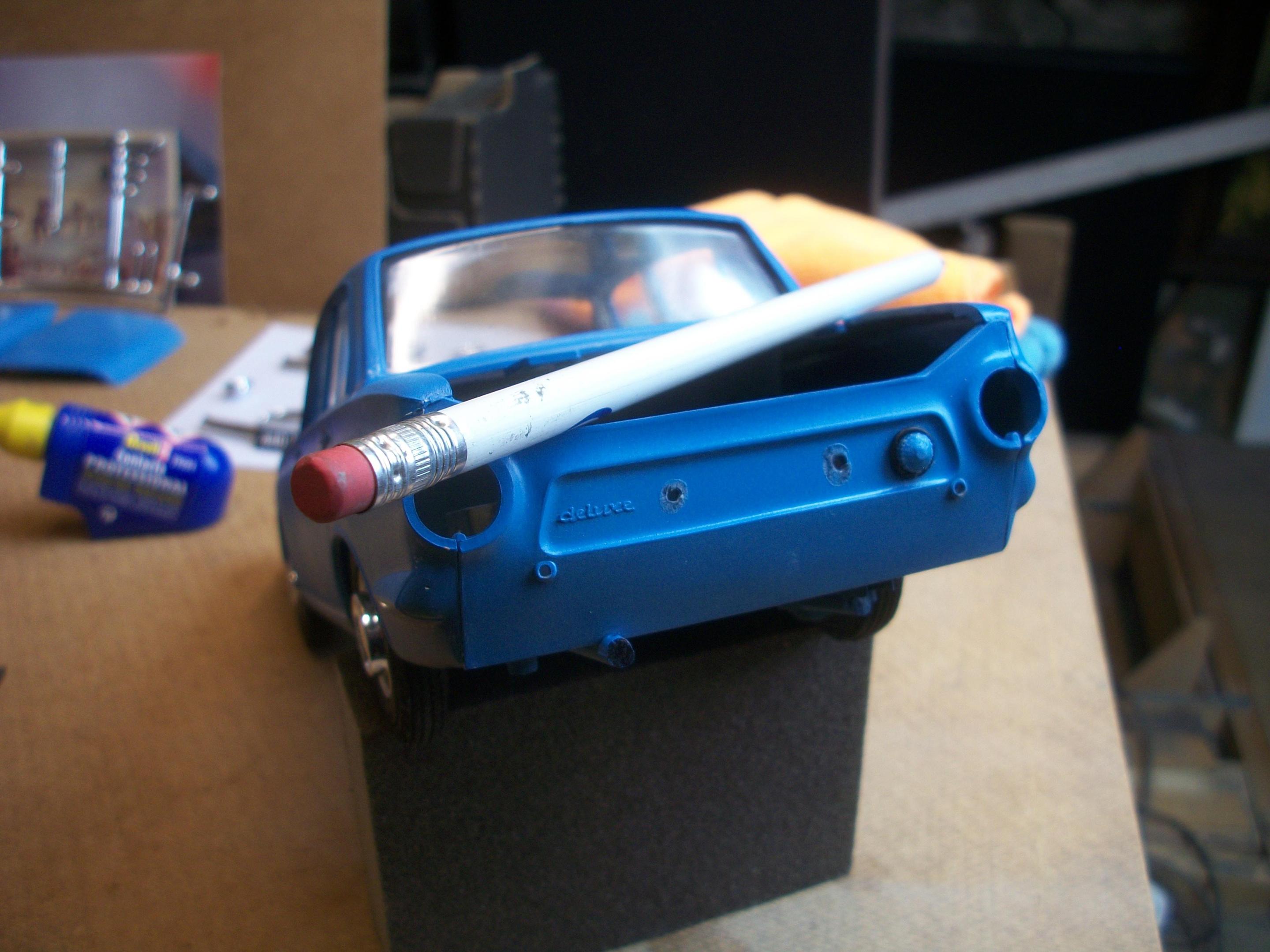

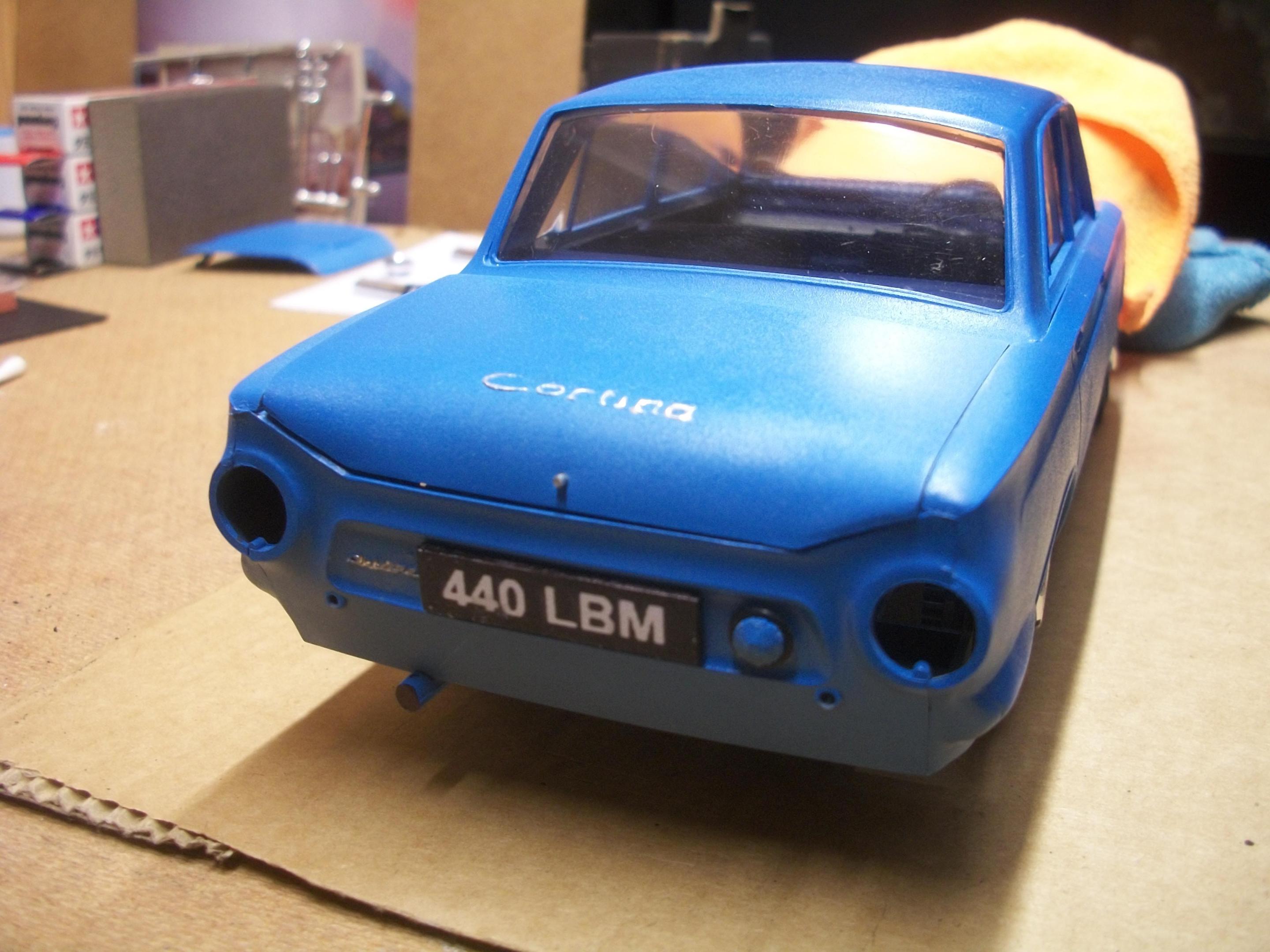

The liquid chrome was applied very carefully onto the slightly raised scripts, using a pencil eraser. For the most part, this was successful, but the letter 'a' at the end of ' Cortina ' was not right., and there were a couple of small areas of excess liquid chrome around the ' deluxe ' script.
To correct these errors I sprayed a tiny amount of Tamiya TS-10 French Blue into an aerosol cap, and then I used a fine brush to cover the blemishes with blue paint. The result is acceptable, if not great.

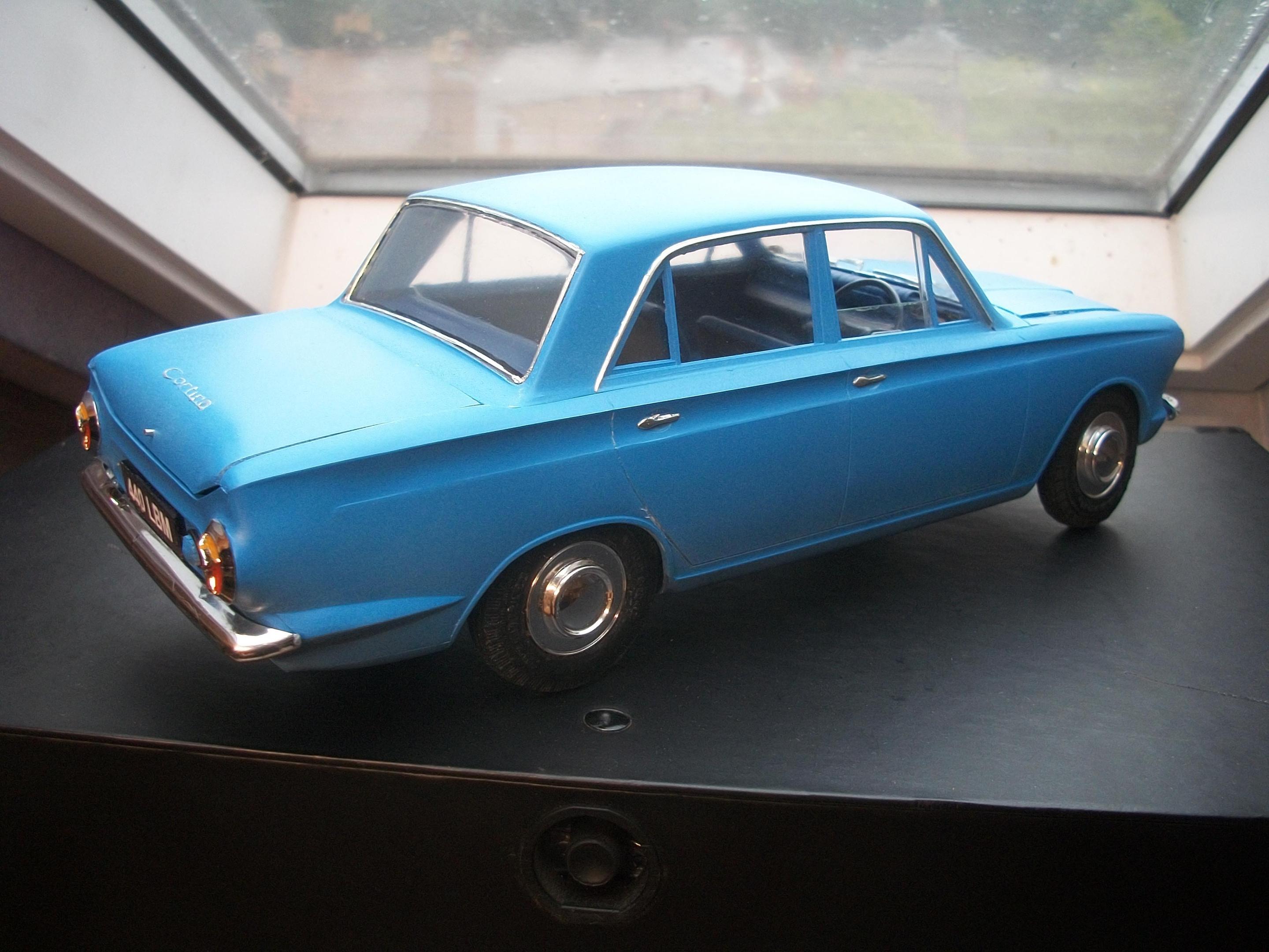

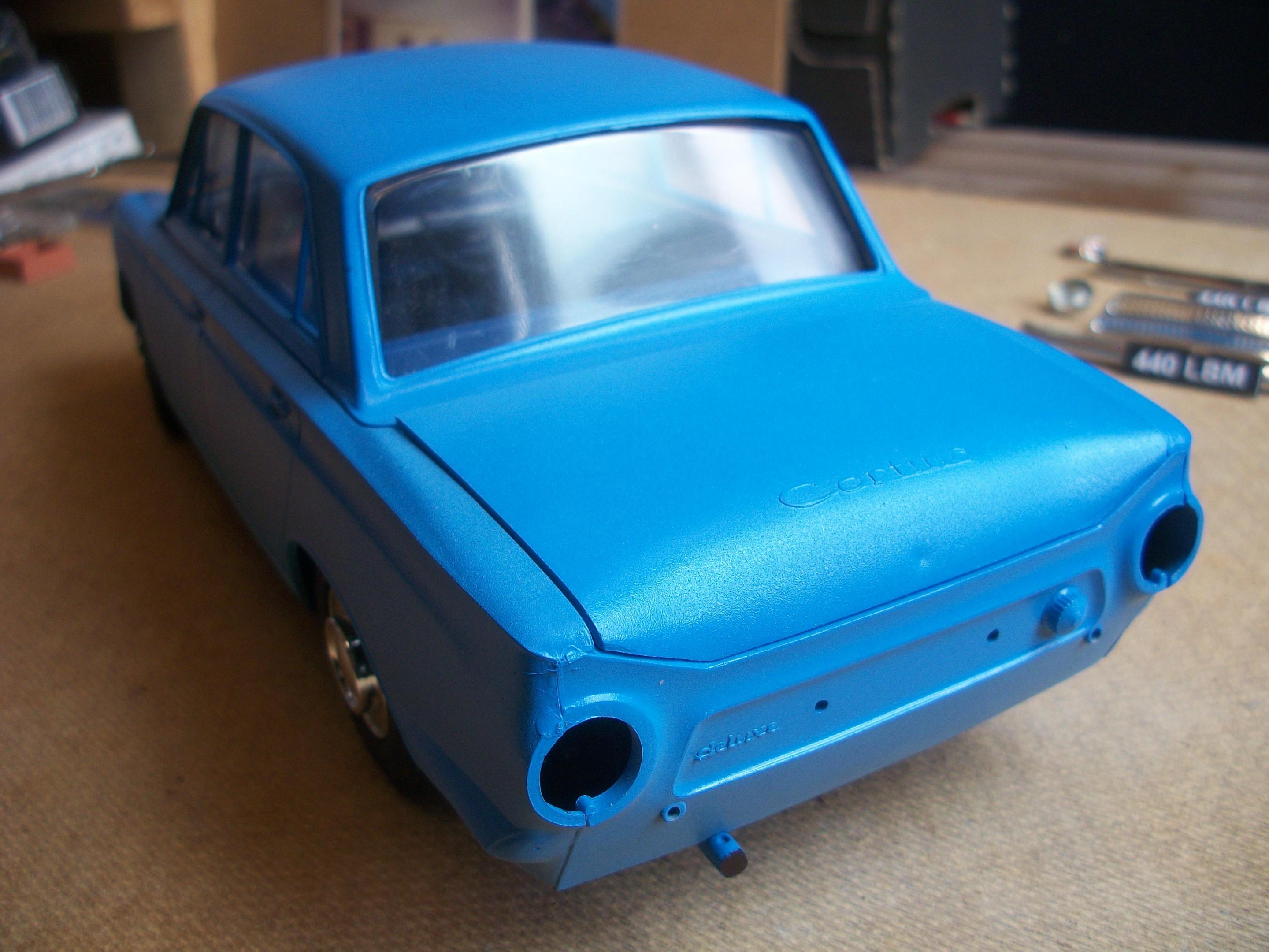

The rear number plate was glued in place, and the boot lid attached to the body. I then drilled a hole in the centre of the lower edge of the boot lid, so that I could insert a tiny piece of silver wire to represent the barrel key lock. This fitted tightly in the hole, so no glue was needed.
Some further polishing was carried out today and more will follow. The rear end of this model car is looking good, and I shall work on the front end shortly.

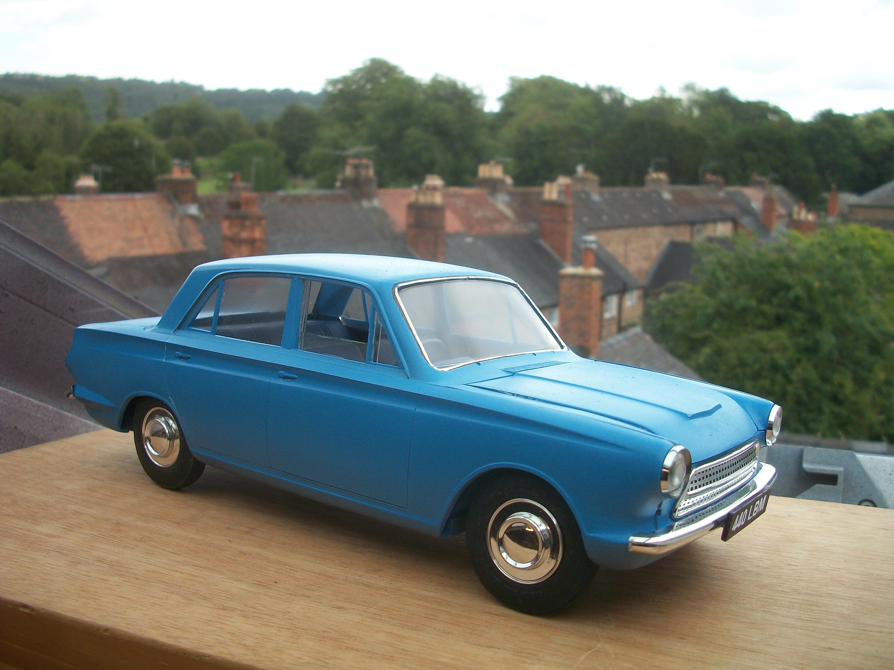

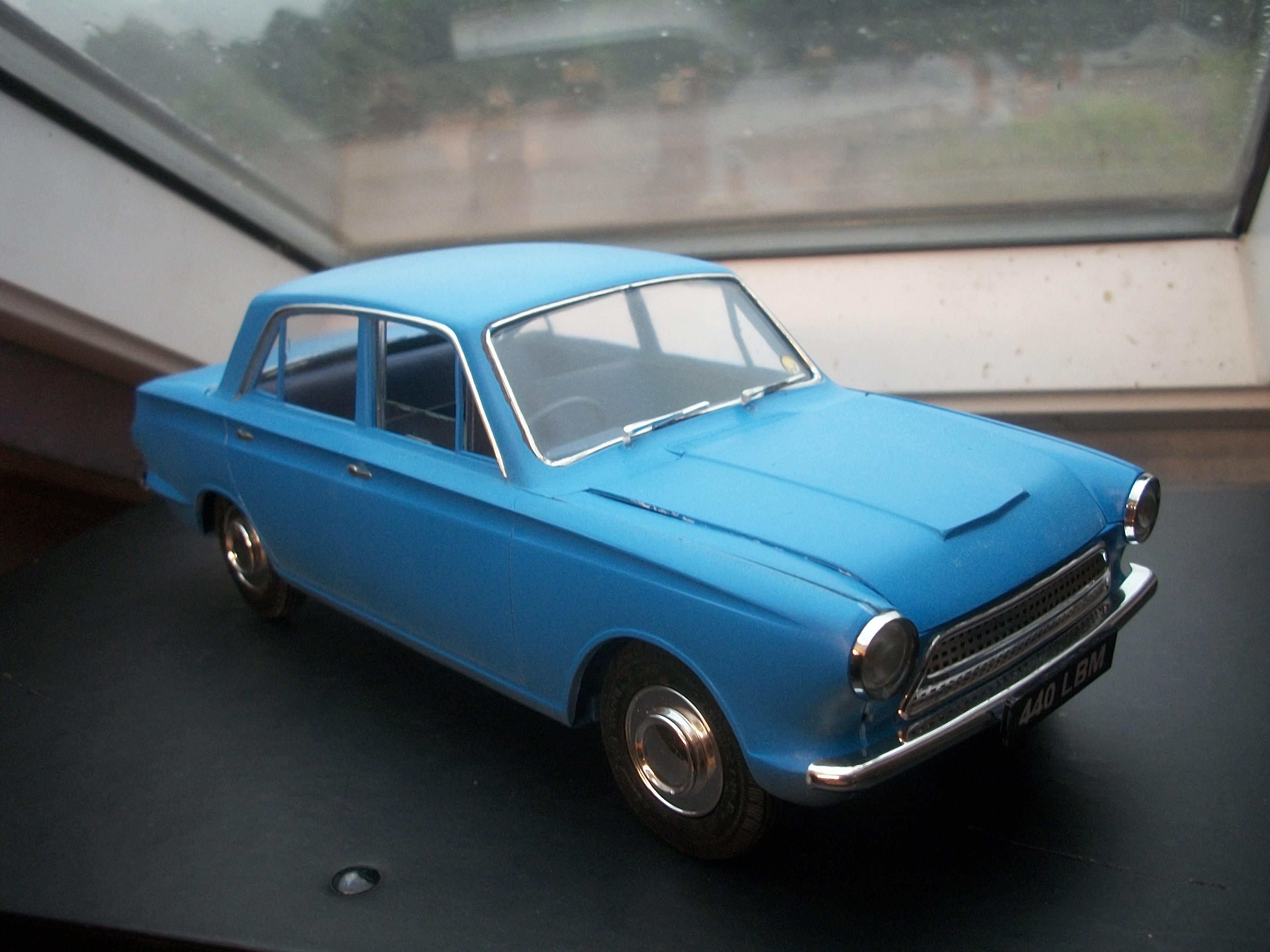

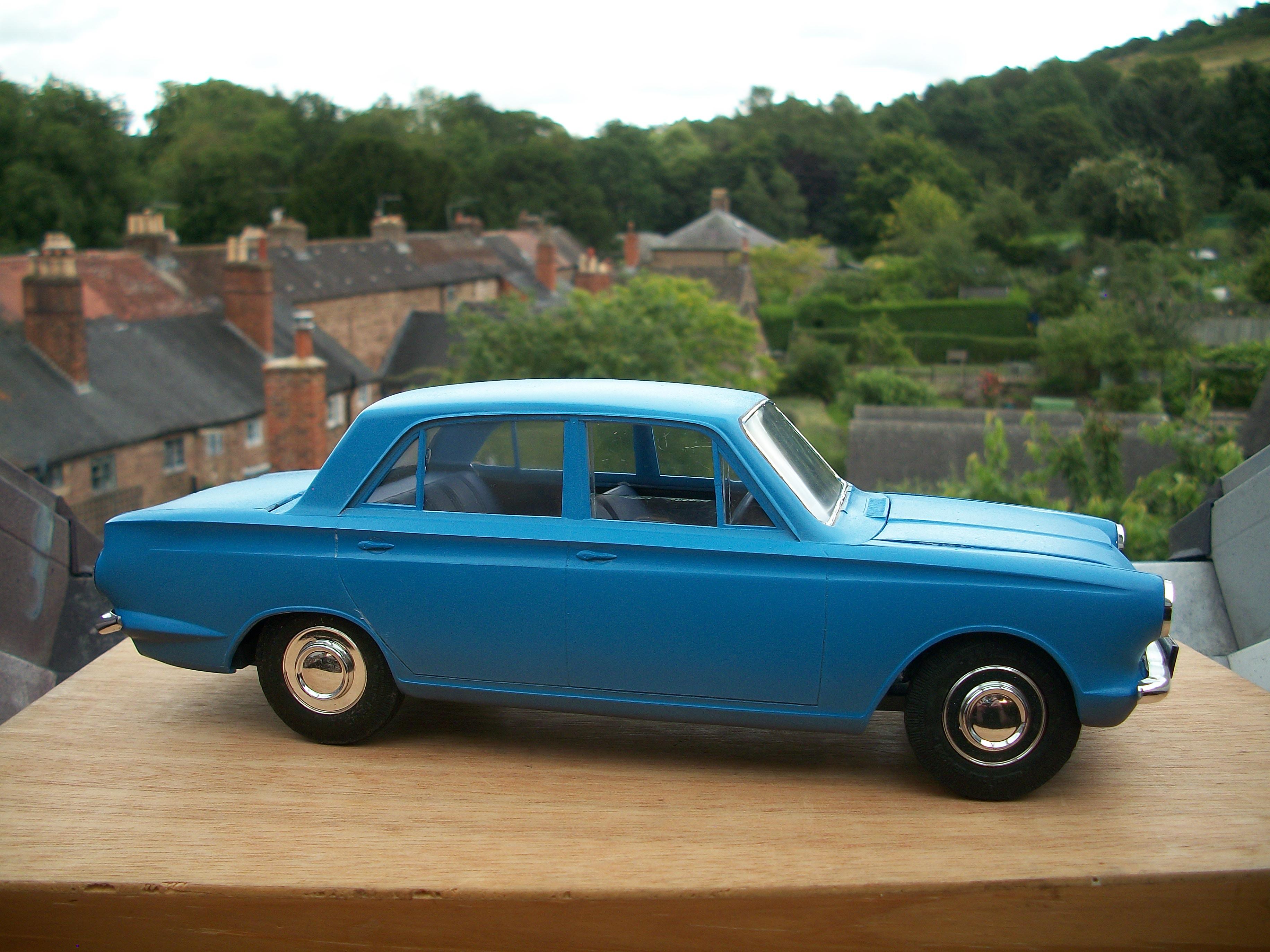

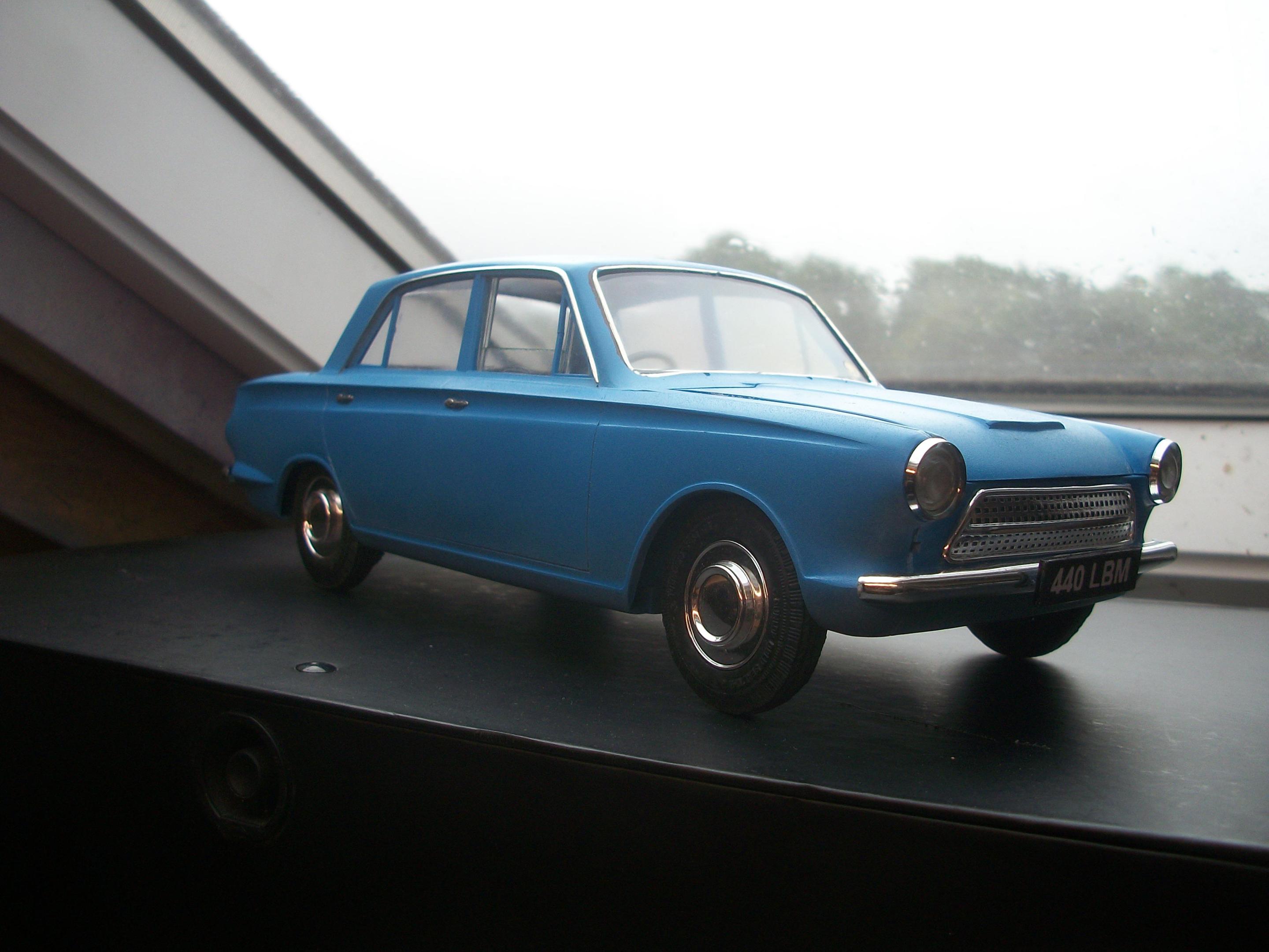

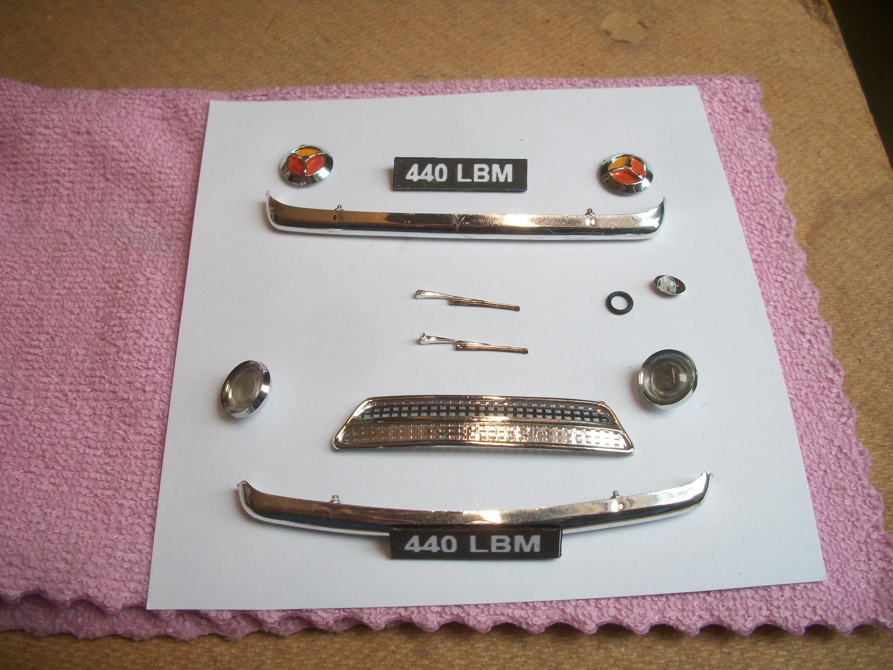

Recent work over the past three days has included assembling the rear bumper, rear tail lights, and also the front radiator grille, headlamp reflector bowls and lenses, front bumper and number plate . . . I decided to use Bare Metal Foil for the windscreen surround moulding, also BMF for the rear window surround moulding, after using a black Staedtler pen to define the window seals. Having applied bare metal foil to the four door handles, there are only two further mouldings to BMF, which are the long side mouldings for the roof drip channel.
I need to glue the wiper arms and blades in place and also fabricate a second front side light, as I only have one side light.
Plans are moving forward to do a couple of outdoor photo shoots with this Cortina, one using my Kodak M340 camera that I use for all these MCM forum topic photos, and one using my 35mm Zenit SLR camera when the film arrives in the post. Considering the Kodak camera will have difficulty with the forced perspective technique as it cannot get both the model car and background in focus at the same time, I should be able to achieve better results with the old Soviet SLR camera. This will allow me to make use of an f/16 stop to give a narrow aperture and a greater depth of field.

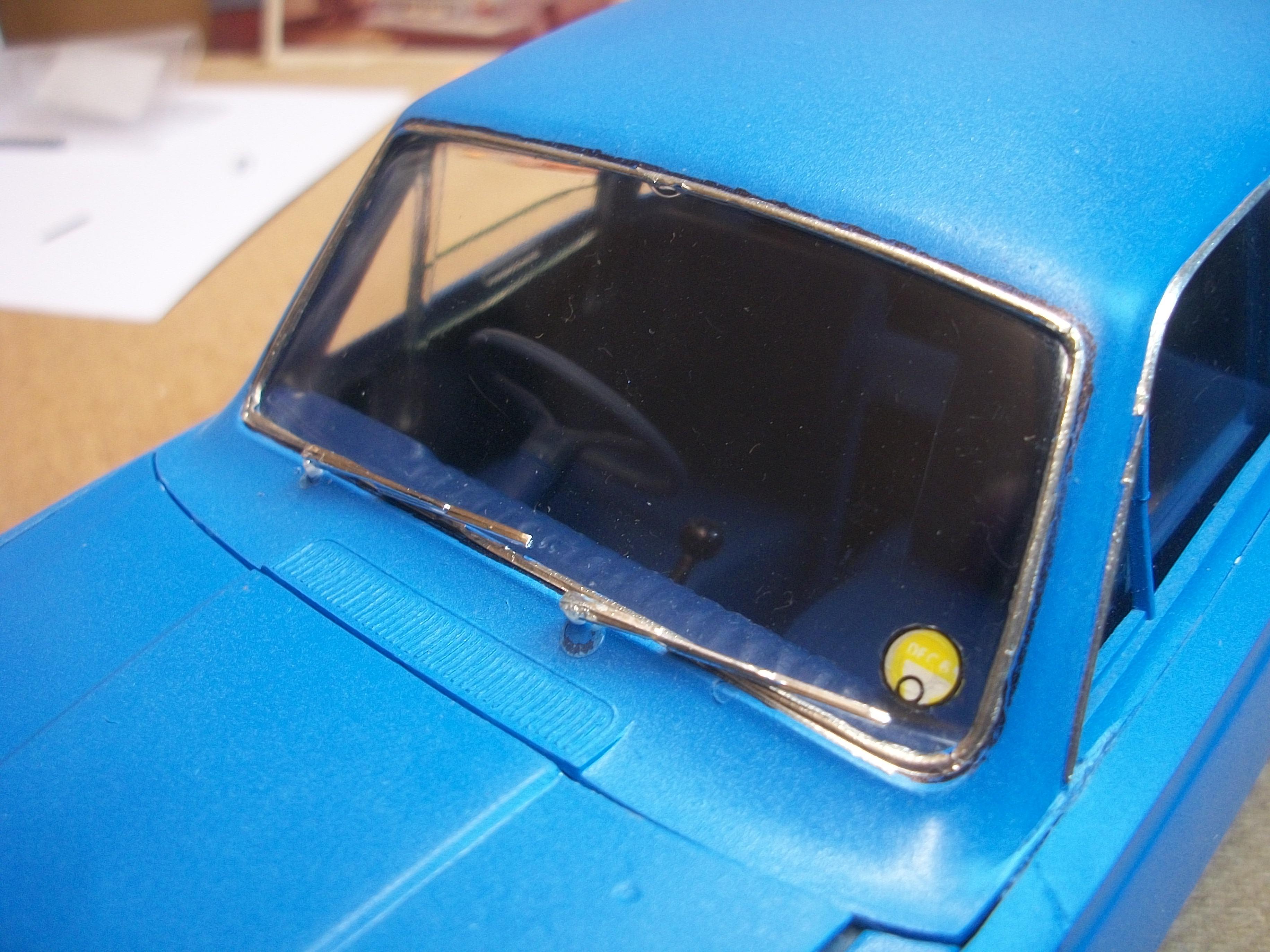

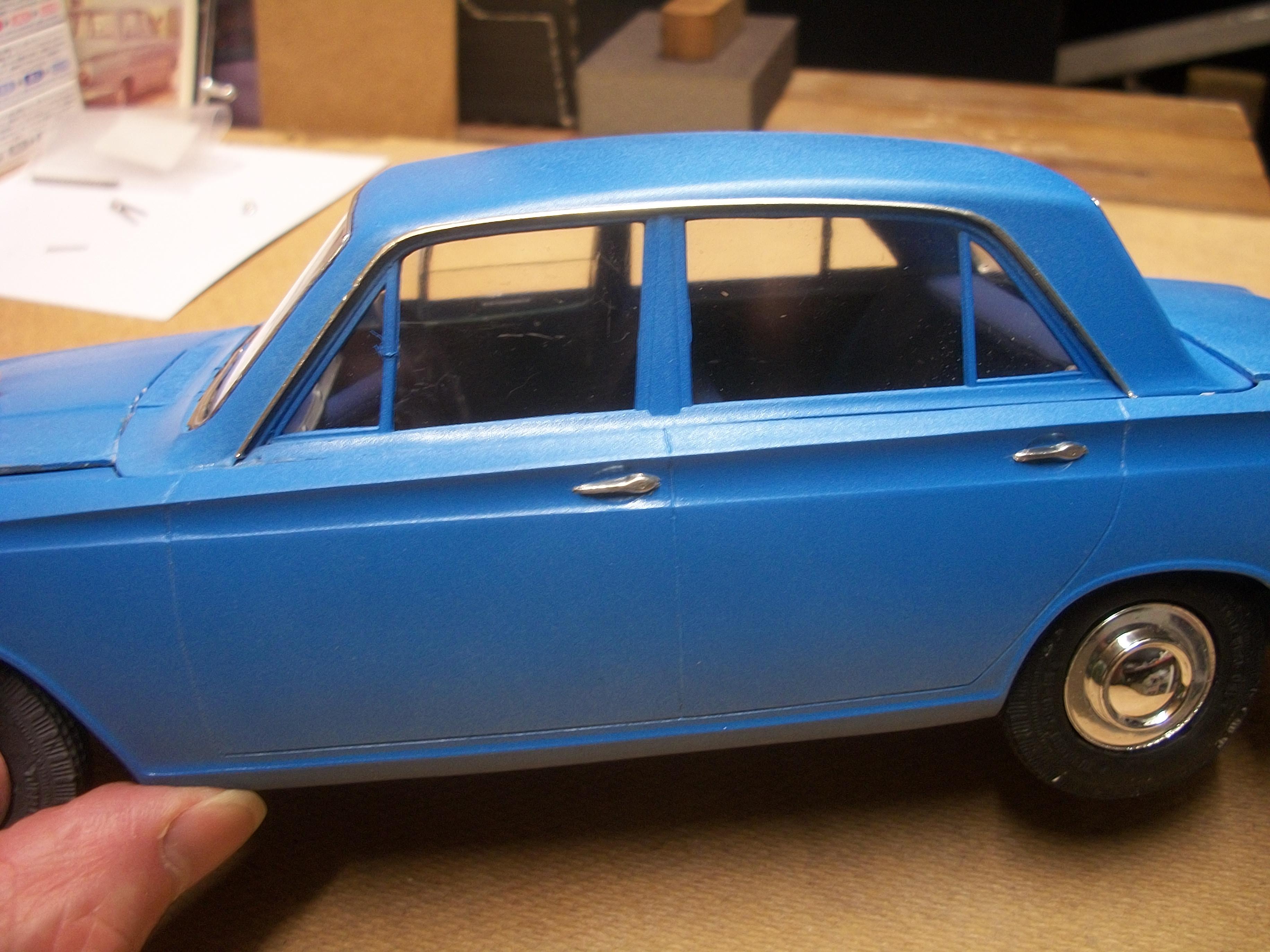

Here are a few photos showing the drip rail mouldings and the door handles after the BMF was applied yesterday.
I made a couple of wiper spindles from 1 mm square styrene rod, and then glued them in place. The wiper arms and blades are glued to these spindles.
Also, I am experimenting with methods of moulding and casting the front side light, by testing materials with a part from a Jaguar kit.
