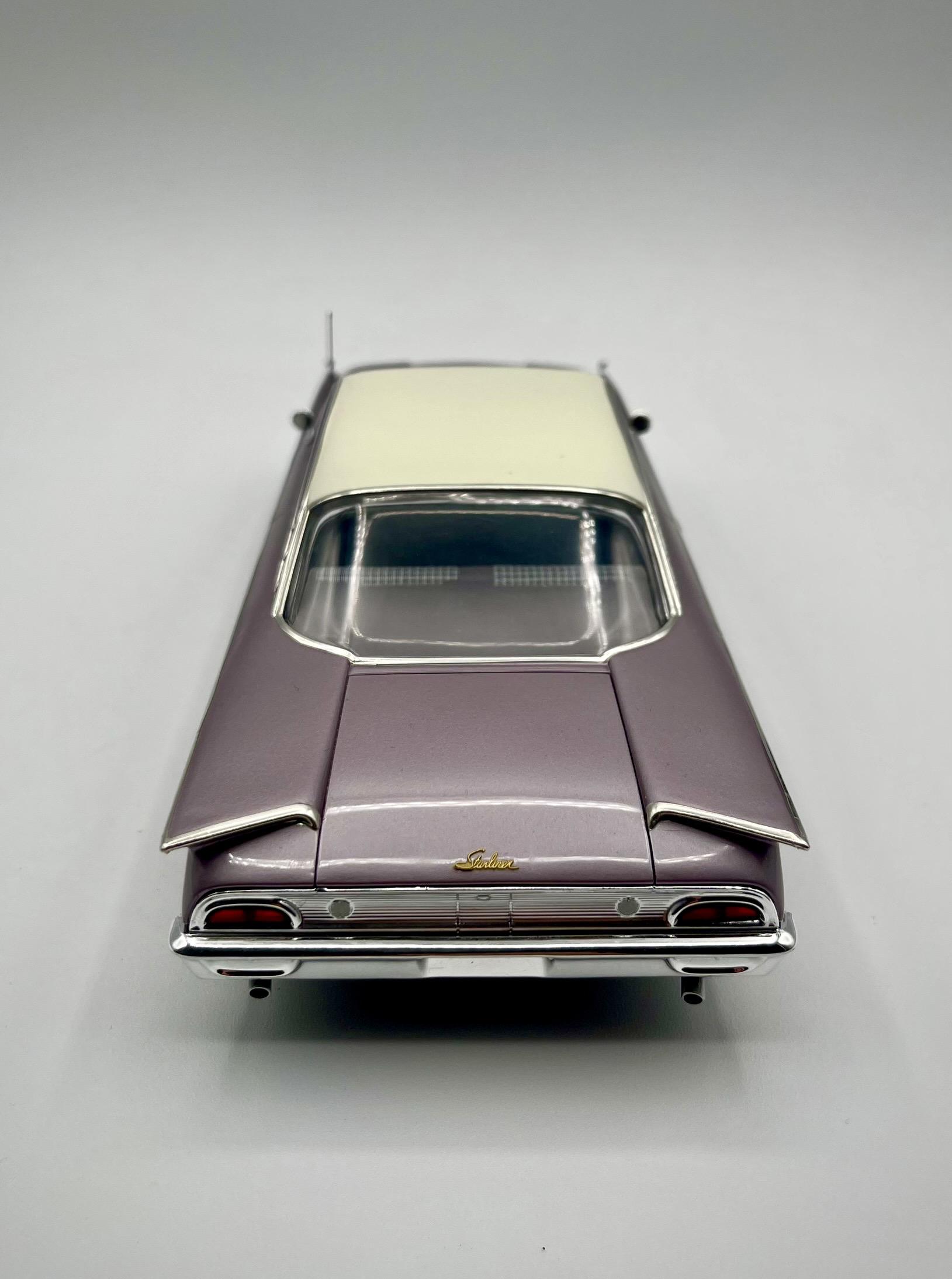

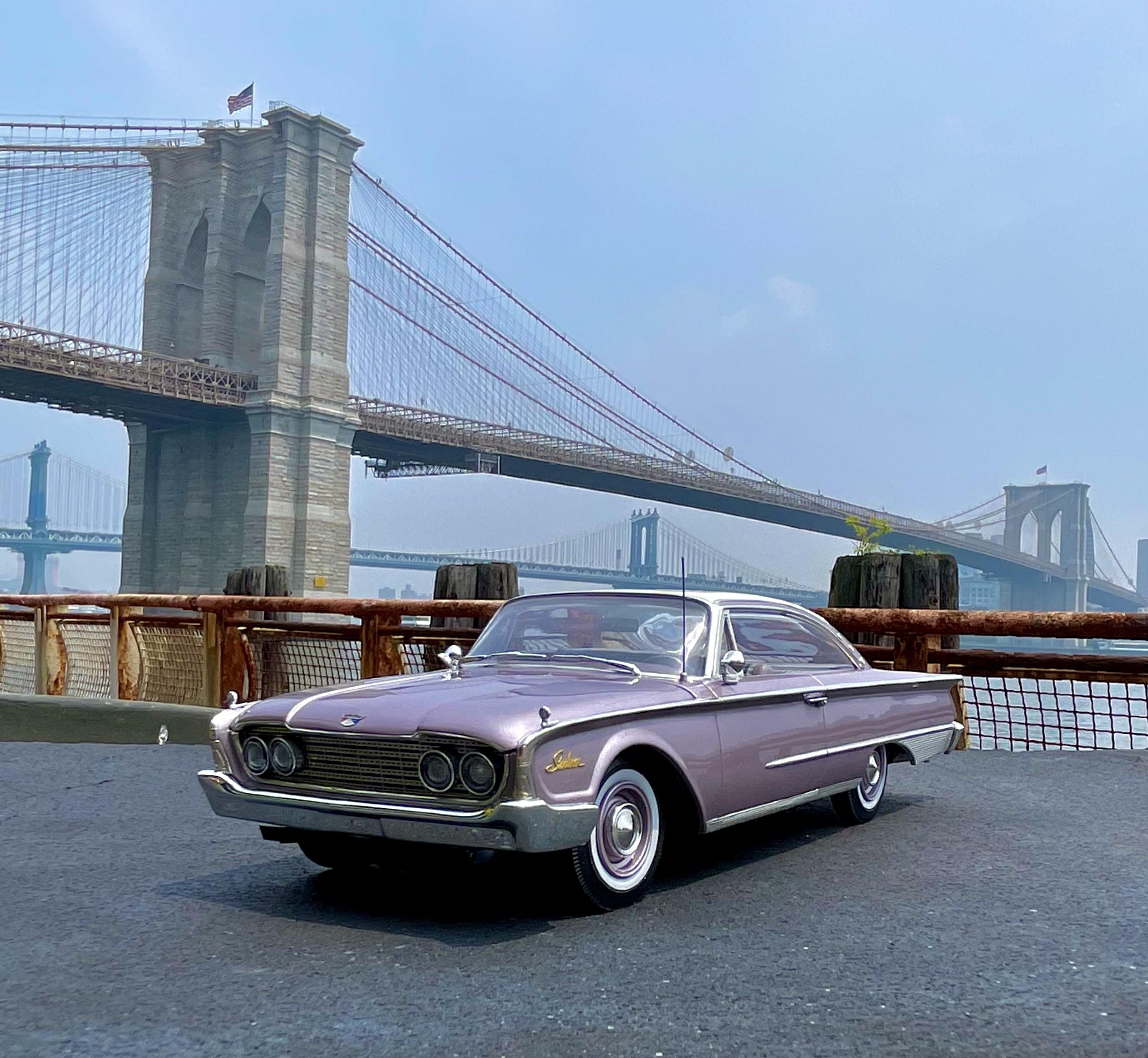

Just wrapped up an AMT ‘60 Ford Starliner.  This really was an awesome kit. Can’t wait to build another.  Sorry if the pics are a little hazy - there have been some veeery strange skies in NYC lately… I’ll post some build details below ??

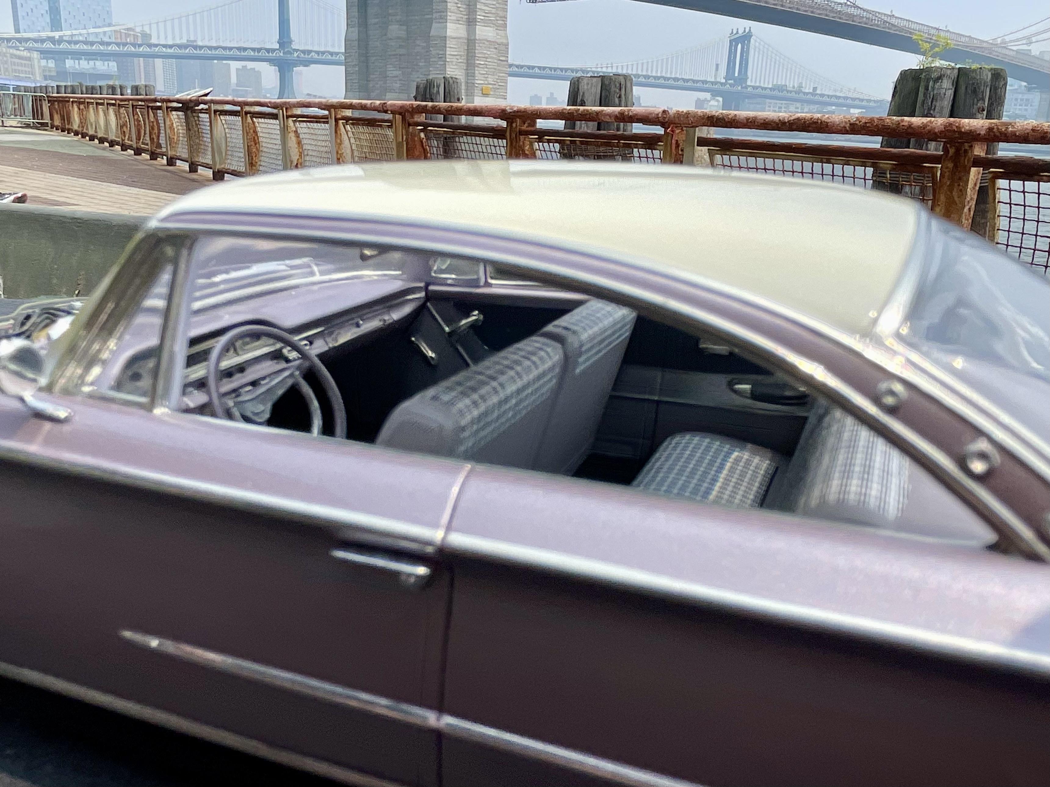

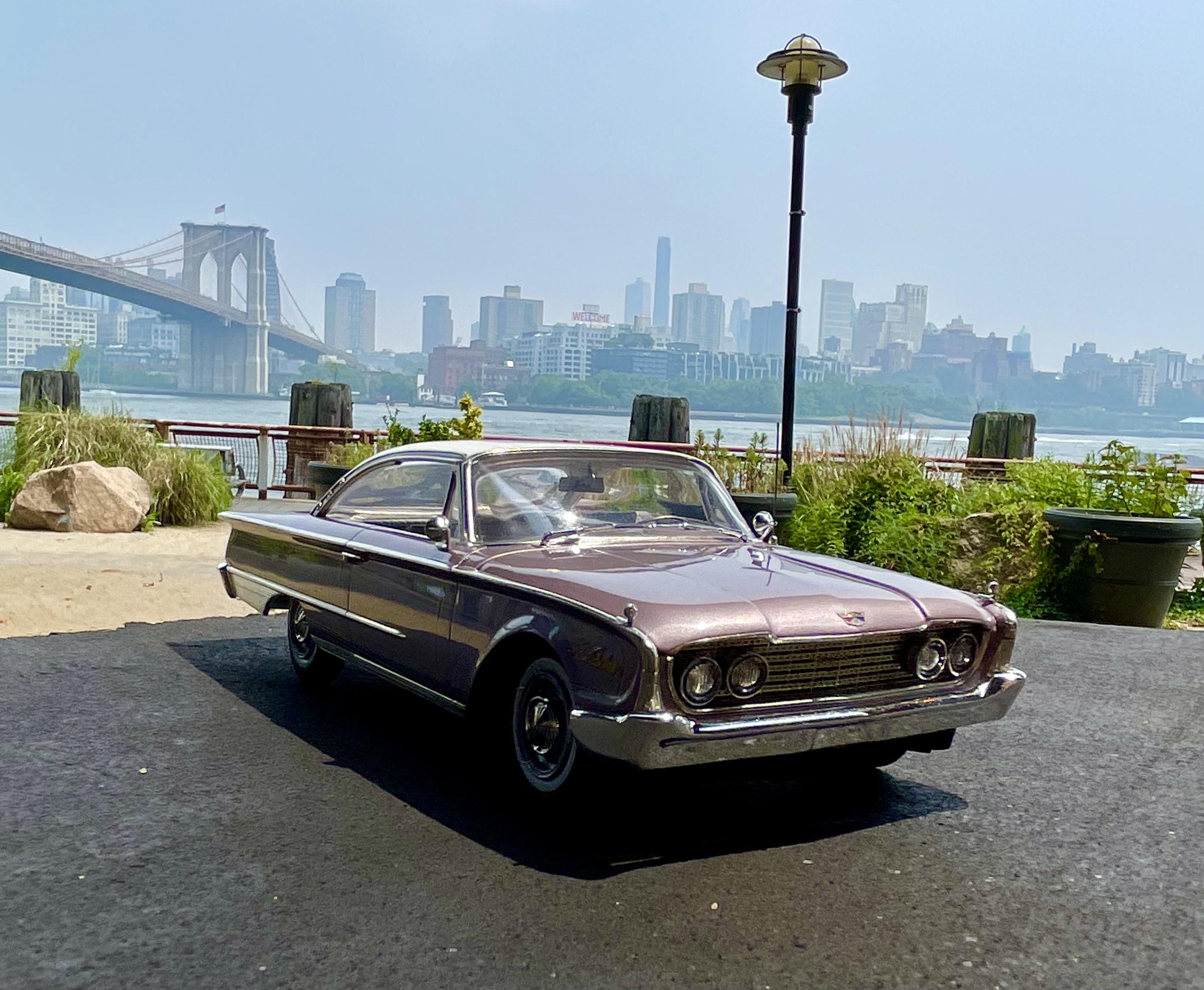

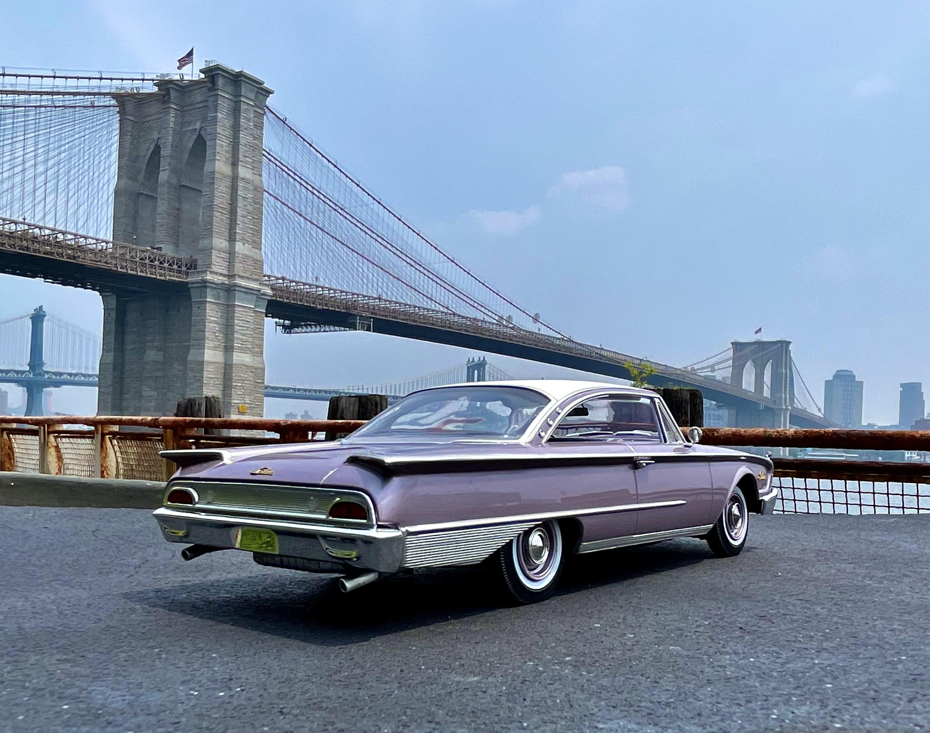

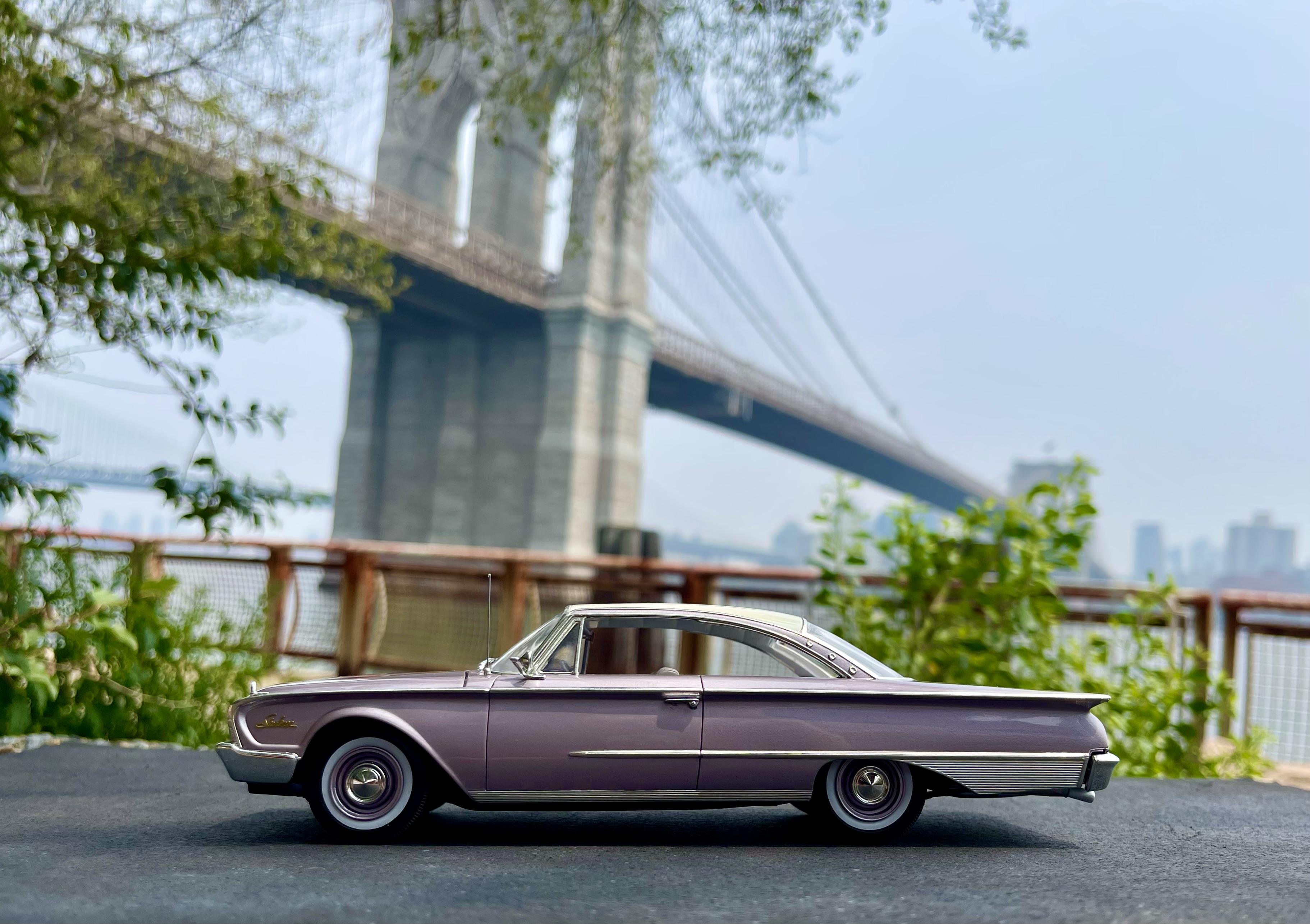

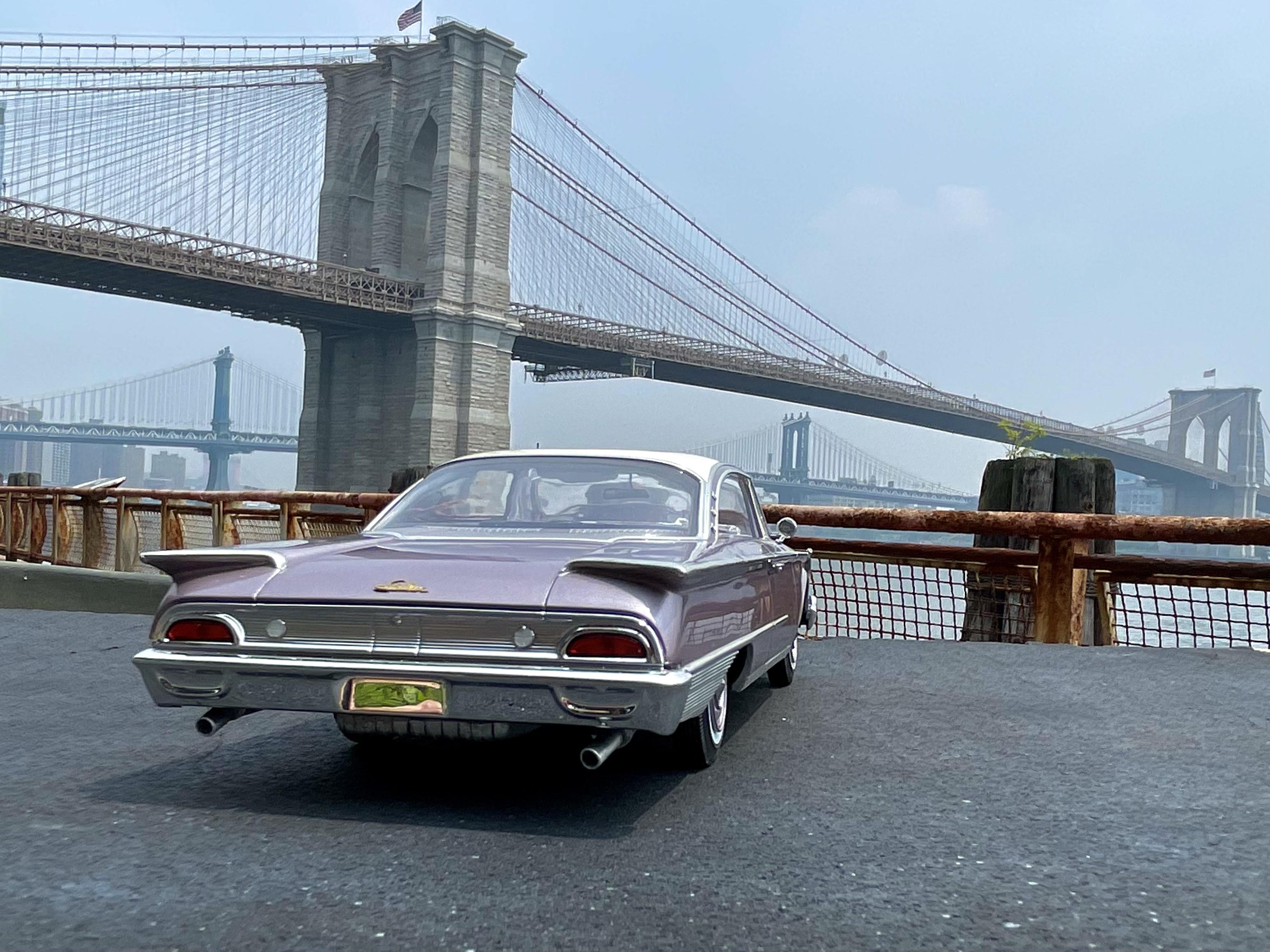

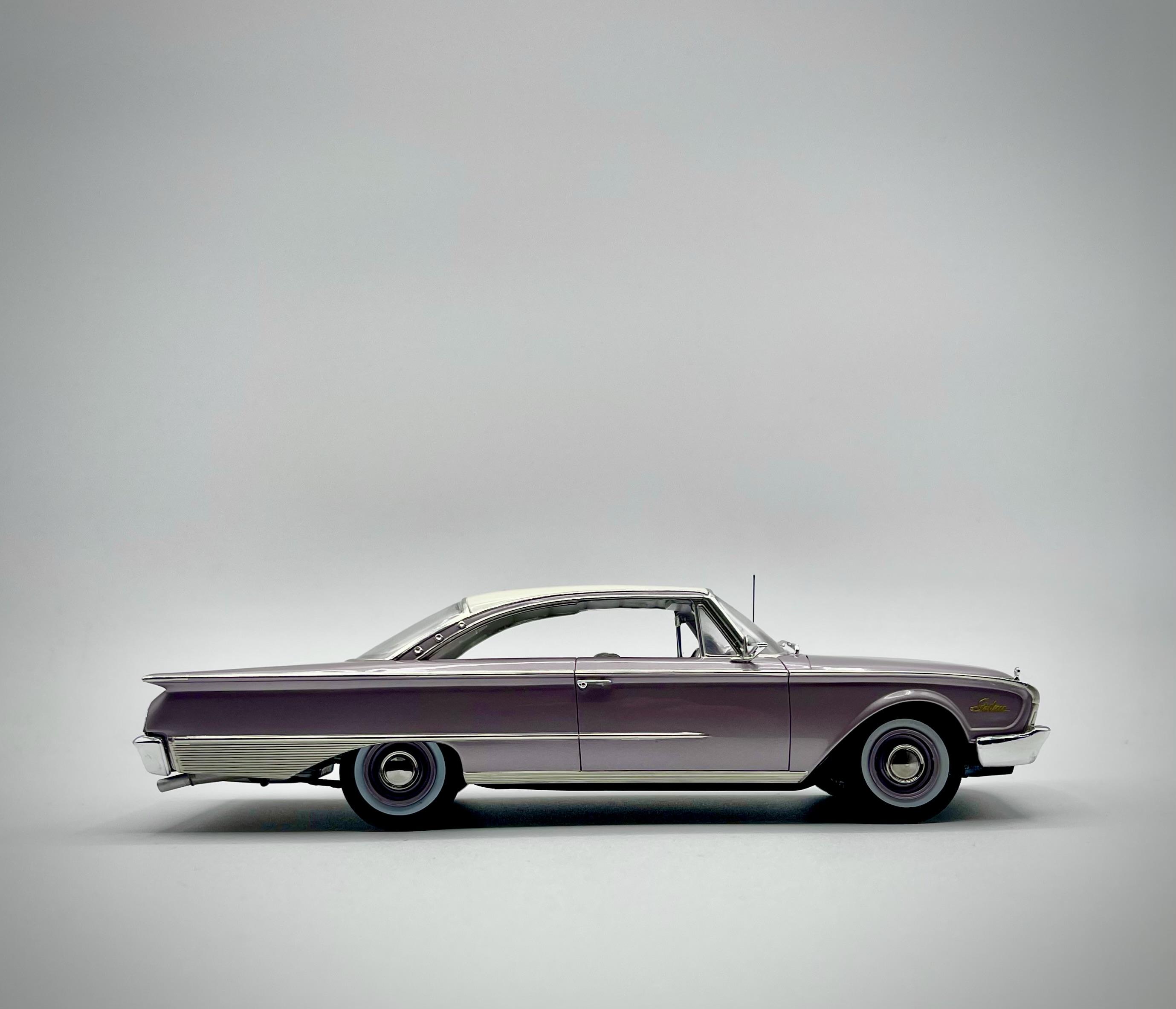

Ok - so, I’ve had this one in the stash for awhile but was hesitant to tackle it because of the intense foiling session I knew it would require.  Foiling was hands down my biggest weakness on so many builds and I didn’t want to ruin this beauty of a kit.
Then, a few builds ago, I tried some new things with my foil application that has totally changed the game for me.  First of all, the new bmf is much easier to use than the Covid-era product. This stuff sticks and burnishes down as it should.  Next, I made the switch from using #11 exacto blades to #11 surgical scalpels. This was probably the biggest difference maker.  The cut lines are 1000% smoother now, since it takes literally no pressure at all to cut through the foil.  Additionally, any cuts you make once the foil is in place will be nearly invisible on the body because the blade is so thin. It also holds an edge phenomenally well - no more slipping or sliding and chipping the body.  Also, I now try to cut the foil as close to shape as possible, prior to application. This reduces knife-on-body time and minimizes chances for an errant cut.  You just line the foil up as straight as possible along the most visible edge of the part you’re foiling, and burnish it down as you move along.  If you need to make additional cuts afterwards, you can just trim along the less visible edge until it looks right. This reduces adhesive residue on the body as well.   I can’t tell you how much easier those little changes have made the job for me.  I should also note that I used to avoid wet sanding the trim/edges because I didn’t want to burn through the paint…but recently I asked myself, why? If the edge is getting foiled anyway, who cares if it burns through a little bit?  Now I just carefully sand them too, and it leaves me with a nice smooth surface that won’t show as much texture under the foil as it used to - sounds like common sense but it only just dawned on me ??‍♂️  Anyway, if any of you are struggling with foil like I did, give those things a try…it just takes practice and patience
Build notes:
1. Lowered the front end by 5-6 mm
2. I used the model car garage photo etch set for the emblems, grill, dash
3. Headlights were built with different sized aluminum tubing, styrene, and the kit lenses
4. Seats were done with scale productions fabric decals and tons of microsol
5. Carpet is adhesive suede
6. Antennae is aluminum tube and music wire. Exhaust pipes are also aluminum tube
7. Rv mirror is a bent tailor pin and some aluminum sheet with hasegawa mirror finish
8. Tires are from an AMT Impala kit (I think)
9. Engine bay had a bunch of stuff added but it honestly would have looked fine without it. Might be the nicest engine I’ve seen in a kit.
10.  Ext. paint is Splash Paints evening orchid (body) and tamiya racing white (roof) under mr color clear
11. Int. Paint is a tamiya acrylic grey/red/blue/white mix on the seats, gray/blue/black mix and Alclad silver candy base on the door panels, and evening orchid on the dash and tops of the doors under semigloss clear
The body did need quite a bit of sanding and putty but I really can’t complain. Beautiful kit.  Here are a couple more pics ?

Beautiful build! All the details are meticulously done inside and out and the paint looks great. Looks like a real car in the pictures in front of the bridge.
Thanks guys!! I really had fun with this one.  Taking the pictures at the end of a build has become the part i look forward to most!
