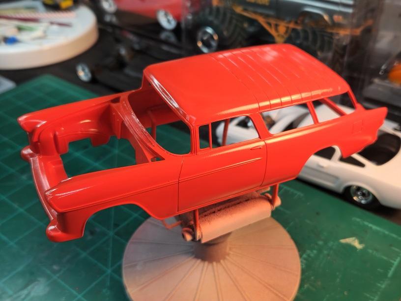

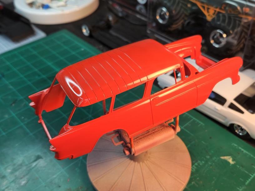

Zippi Posted August 15, 2023 Author Posted August 15, 2023 Ok fellows, I had a small window this morning where the humidity dropped below 60% so I fired up the airbrush and got some paint on the 55 Nomad body. I think it turned out really nice. There is a little bit of trash in the paint but I'll wet sand that out before I shoot the clear on later this week. This is the Testor's paint (Gloss Sunburst) in the small bottle mixed 50/50 with Mr. Color Leveling Thinner shoot at 35 psi. 5
Slotto Posted August 15, 2023 Posted August 15, 2023 Congrats. Nice save Bob! I know how frustrating painting can be
Zippi Posted August 15, 2023 Author Posted August 15, 2023 1 minute ago, Slotto said: Congrats. Nice save Bob! I know how frustrating painting can be Thanks Steve. Yeah, this paint job fought me all the way but I wipped it into submission ?
Rattlecan Dan Posted August 15, 2023 Posted August 15, 2023 Wow! That baby POPS. Really good job. Especially after all that work. I know you'll keep on it till it looks completely gorgeous. (USAF Veteran also) 65-69.
Zippi Posted August 15, 2023 Author Posted August 15, 2023 1 minute ago, Rattlecan Dan said: Wow! That baby POPS. Really good job. Especially after all that work. I know you'll keep on it till it looks completely gorgeous. (USAF Veteran also) 65-69. Thanks and thank you for your service. Yup, once I get the Tamiya X-22 clear on it will get wet sanded and polished.

Zippi Posted August 17, 2023 Author Posted August 17, 2023 2 hours ago, dragcarz said: I love the color! Looking really good! Thanks Roger. Now I'm thinking maybe a white top??? 2
espo Posted August 17, 2023 Posted August 17, 2023 I was going to suggest that since it would be sort of an OEM touch, but figured you had your color idea already figured out.
Zippi Posted August 17, 2023 Author Posted August 17, 2023 2 hours ago, espo said: I was going to suggest that since it would be sort of an OEM touch, but figured you had your color idea already figured out. I hear ya. Since I've been having so much trouble with the paint and clear drying I've backed out of painting the top white. I'm afraid of the tape leaving marks in the orange paint. Don't want to go through stripping it again. 1
