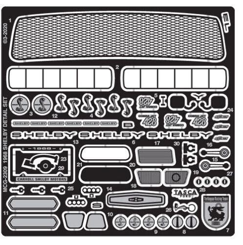

StevenGuthmiller Posted July 28, 2023 Share Posted July 28, 2023 3 hours ago, Milo said: + 5 dolla tax and they don't have the chrome metal sheets for logos on ebay You have to pay to get in the game, plain and simple. If you don't want to spend the money, you either have to paint them, or print your own decals. This is where planning comes into play. You order 5 sets of decals, you get one free, and you pay shipping for one. (the $4.49 is shipping, not tax) And yes, eBay does have photo etched parts for the Shelby GT 500. You just have to know where to look. Steve Quote Link to comment Share on other sites More sharing options...
