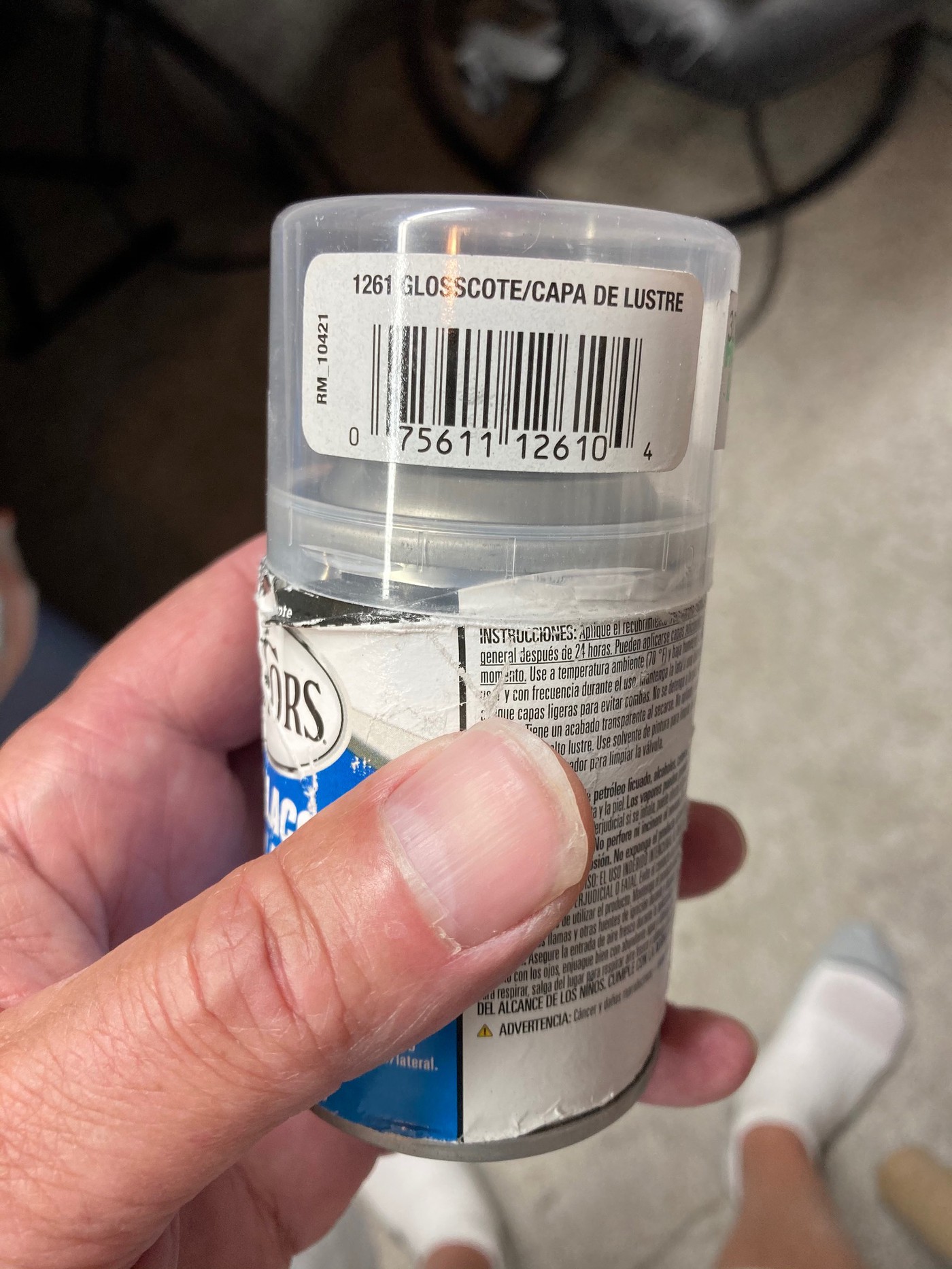

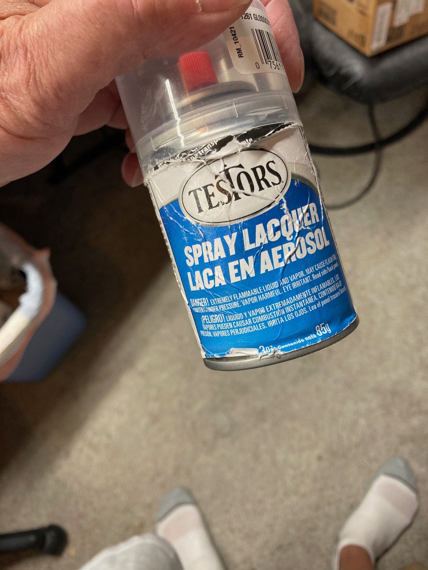

Milo Posted July 17, 2023 Author Posted July 17, 2023 56 minutes ago, StevenGuthmiller said: I don’t understand why everybody has so much trouble using Testors clear lacquer over enamel. I can’t remember the last time that I built a model where half of the parts weren’t first painted with enamel and cleared with Testors lacquer. Testors clear lacquer is in no way, shape or form a hot, automotive type acrylic lacquer. I have no idea what the formulation of the paint is, but I have my doubts that it’s even a lacquer in the normally accepted definition of the word. All that I “can” tell you is that I spray it over enamel all of the time, and by all of the time, I mean very frequently! As a matter of fact, I’ll be doing it tonight over some parts for my current project that were painted last night with flat enamel, and I haven’t even the slightest apprehension about it! Steve do you use the extreme lacquer that i showed?
StevenGuthmiller Posted July 18, 2023 Posted July 18, 2023 1 hour ago, Milo said: do you use the extreme lacquer that i showed? No. The regular clear lacquer is cheaper, and apparently won’t cause the same problems that it seems that the extreme does. I probably got a little carried away with my first response on this thread, as it just makes me a little crazy when people speak in absolutes on subjects like this. ”Never use lacquer over enamel” is overall a sound practice, but as with almost all things, it’s not an “absolute”. Although I still have a problem considering Testors lacquers an actual lacquer, that’s what it says on the can, so the extreme lacquer aside, which I confess that I have no experience with, the other Testors clear lacquers are absolutely safe to use over enamels. At least that has been my experience, and I have quite a bit of experience with using it in that fashion. Steve 1
Can-Con Posted July 18, 2023 Posted July 18, 2023 The thing that most people don't understand is there are several different types of lacquer, about a 1/2 dozen, maybe more. Some are hot like the nitrocellulose lacquers that were used on cars and others like the waterborne ones that are relatively neutral. The ones made for hobby use are usually the cooler waterborne types. [There's also a few other types I have to use sometimes for work meant for use on wood etc. but we don't need to mention then here.] just earlier today I sprayed some of the Testors clearcoat flat in the blue label as shown in Greg's post on the very glossy dark red Testors bottle paint I used on the interior of the Volare I'm currently building, pretty heavy coat too. No problem at all. No way I'd even think about doing that with an automotive product.
StevenGuthmiller Posted July 18, 2023 Posted July 18, 2023 1 hour ago, Can-Con said: The thing that most people don't understand is there are several different types of lacquer, about a 1/2 dozen, maybe more. Some are hot like the nitrocellulose lacquers that were used on cars and others like the waterborne ones that are relatively neutral. The ones made for hobby use are usually the cooler waterborne types. [There's also a few other types I have to use sometimes for work meant for use on wood etc. but we don't need to mention then here.] just earlier today I sprayed some of the Testors clearcoat flat in the blue label as shown in Greg's post on the very glossy dark red Testors bottle paint I used on the interior of the Volare I'm currently building, pretty heavy coat too. No problem at all. No way I'd even think about doing that with an automotive product. ? Steve
peteski Posted July 18, 2023 Posted July 18, 2023 (edited) 1 hour ago, Can-Con said: The thing that most people don't understand is there are several different types of lacquer, about a 1/2 dozen, maybe more. Some are hot like the nitrocellulose lacquers that were used on cars and others like the waterborne ones that are relatively neutral. The ones made for hobby use are usually the cooler waterborne types. That is the main problem with the hobbyists. Many just put every paint in the enamel or acrylic buckets, where when in fact are many formulations of each type of paint out there (especially if one starts using paints not made for the hobby market). Same goes goes for even different brands of paints. When you do that, you are always doing an experiment (on your precious model, if you didn't to a spoon test first). When mixing paints and brands you always run a risk of incompatibility. Edited July 18, 2023 by peteski 1

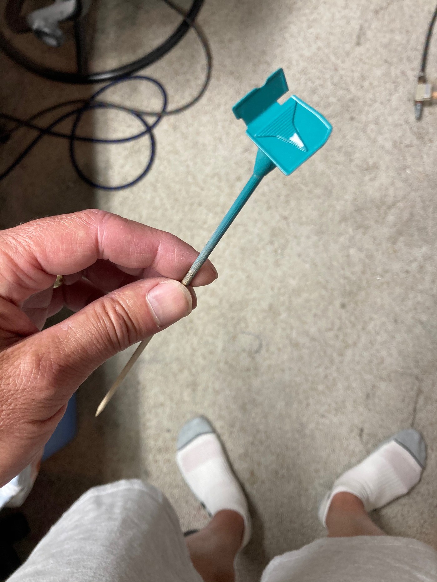

StevenGuthmiller Posted July 18, 2023 Posted July 18, 2023 Just sprayed these parts about 2 hours ago. They were painted with a custom mix of Testors flat enamels, thinned with mineral spirits, and airbrushed yesterday. The white Pontiac crests were brush painted last night with Mr. Hobby "aqueous" white acrylic. (water based) Tonight they were sprayed with a medium coat of Testors #1261 "Glosscote" spray lacquer. No problems whatsoever. One coat of this lacquer over flat enamel will not give you a glossy finish. Just a nice satin sheen, depth of color and the protection of a lacquer over coat......which is exactly what I was looking for in this case. Steve
Milo Posted July 18, 2023 Author Posted July 18, 2023 2 hours ago, StevenGuthmiller said: No. The regular clear lacquer is cheaper, and apparently won’t cause the same problems that it seems that the extreme does. I probably got a little carried away with my first response on this thread, as it just makes me a little crazy when people speak in absolutes on subjects like this. ”Never use lacquer over enamel” is overall a sound practice, but as with almost all things, it’s not an “absolute”. Although I still have a problem considering Testors lacquers an actual lacquer, that’s what it says on the can, so the extreme lacquer aside, which I confess that I have no experience with, the other Testors clear lacquers are absolutely safe to use over enamels. At least that has been my experience, and I have quite a bit of experience with using it in that fashion. Steve Well despite everyone's suggestions and everything, I got a little bored on waiting for amazon's deliveries. I started to use the extreme lacquer gloss on a small body part that doesn't matter so much, it seems that it only starts looking bad after many small coats. I'm on my fourth very very minuscule coat, and it is only now having the bumps show up as described from my previous model. But this time it is also sort of glossy. Can I wet sand between clear coat coats?
StevenGuthmiller Posted July 18, 2023 Posted July 18, 2023 42 minutes ago, Milo said: Well despite everyone's suggestions and everything, I got a little bored on waiting for amazon's deliveries. I started to use the extreme lacquer gloss on a small body part that doesn't matter so much, it seems that it only starts looking bad after many small coats. I'm on my fourth very very minuscule coat, and it is only now having the bumps show up as described from my previous model. But this time it is also sort of glossy. Can I wet sand between clear coat coats? You can, but I would just wait and sand and polish at the end. Steve 1
