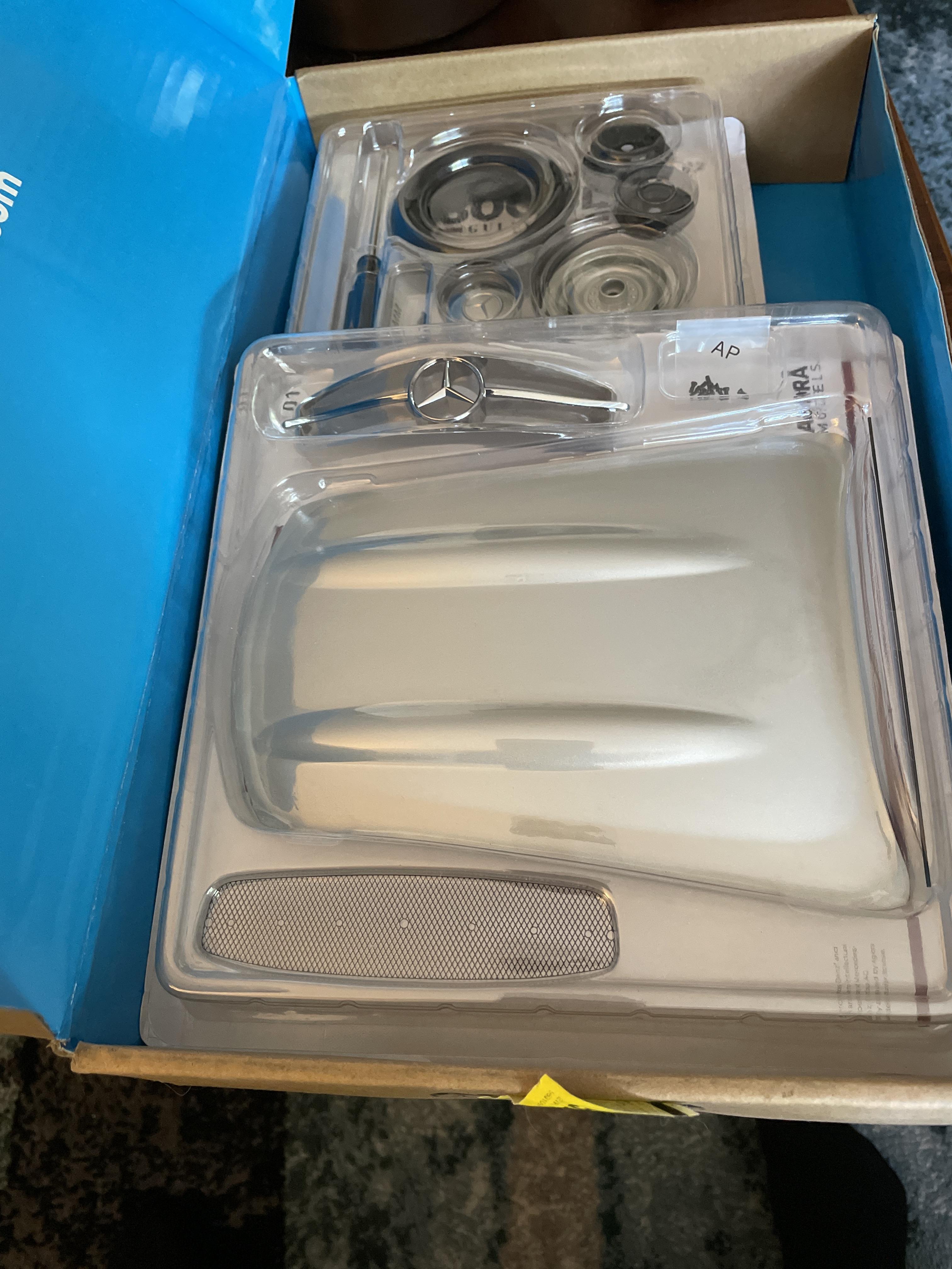

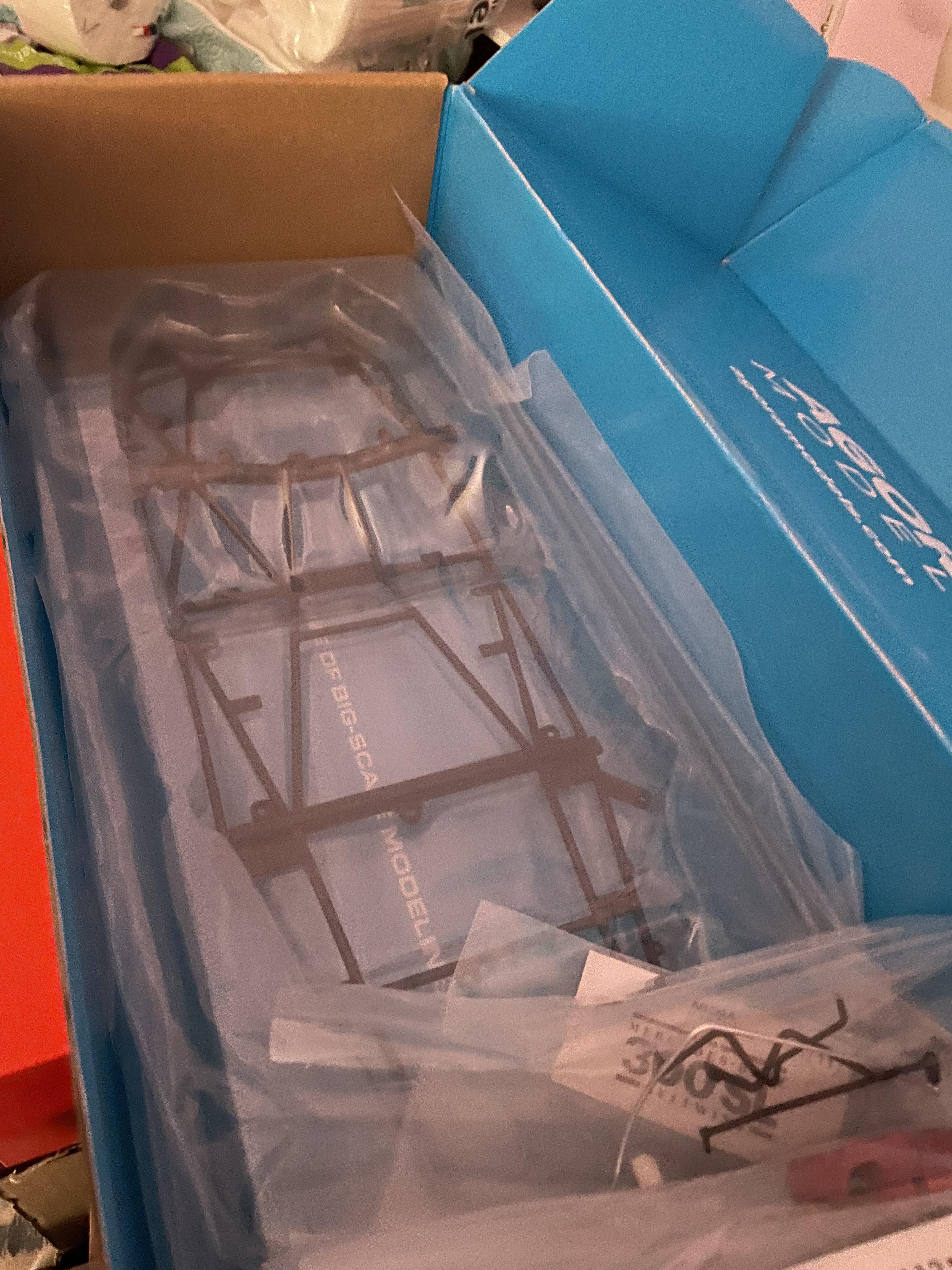

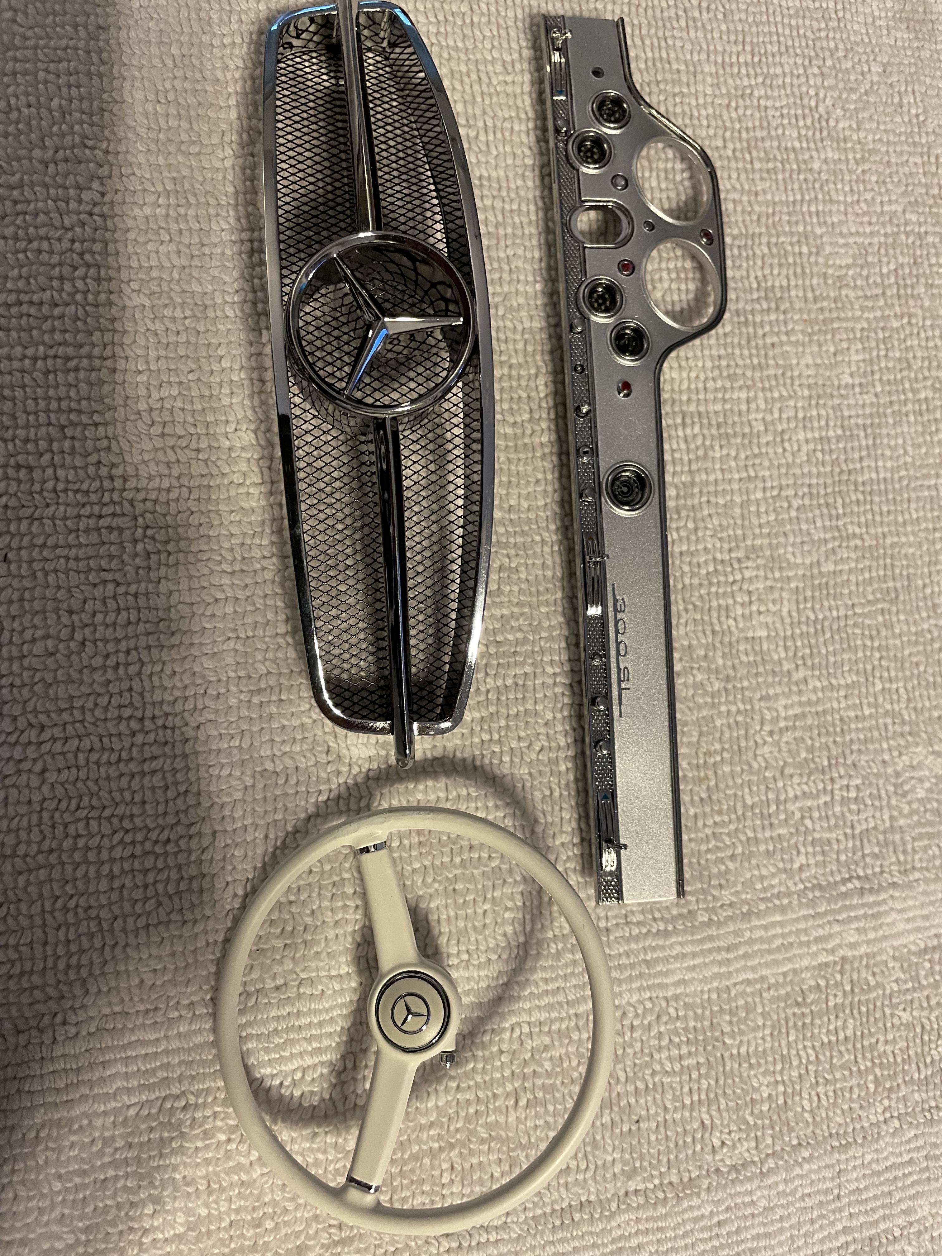

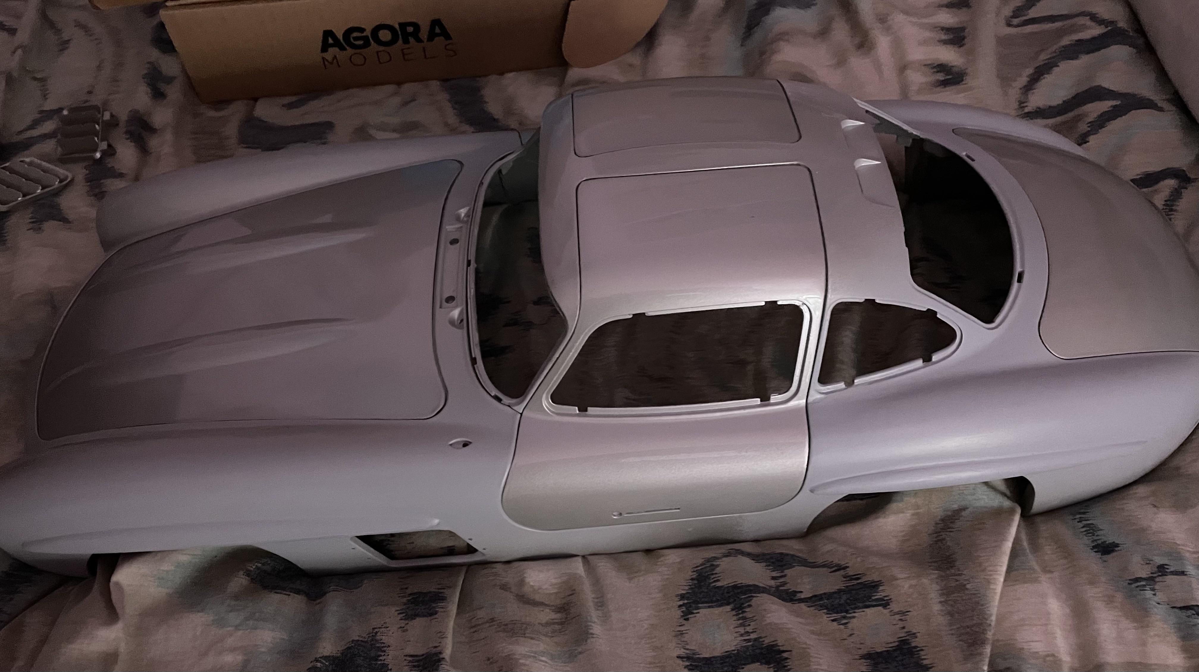

Brudda Posted July 22, 2023 Posted July 22, 2023 Here we go, just received this today. Repainting the car black. Mark said black with the red interior will be cool looking. So it shall be black. 2

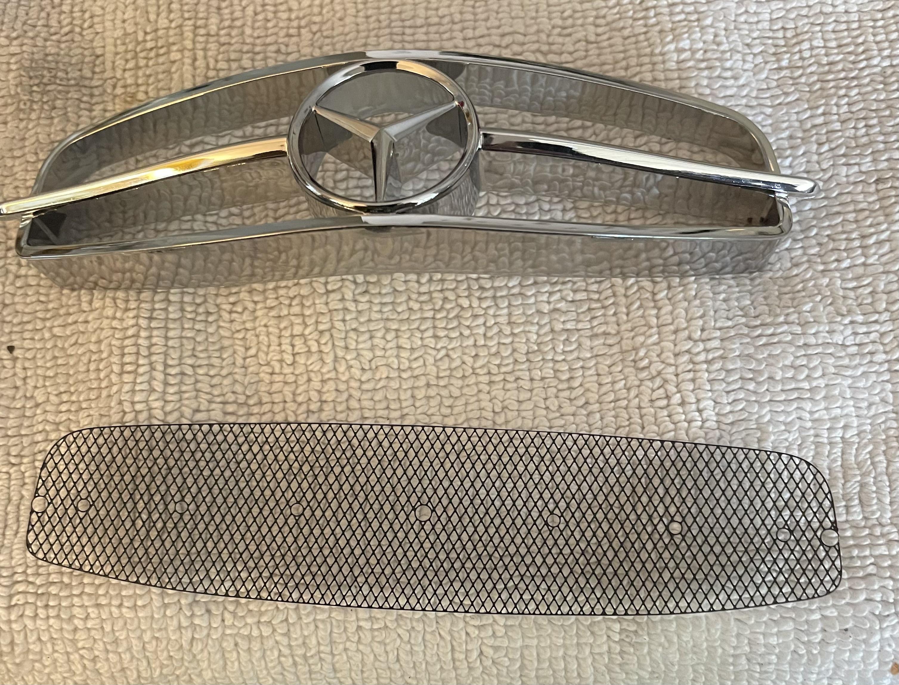

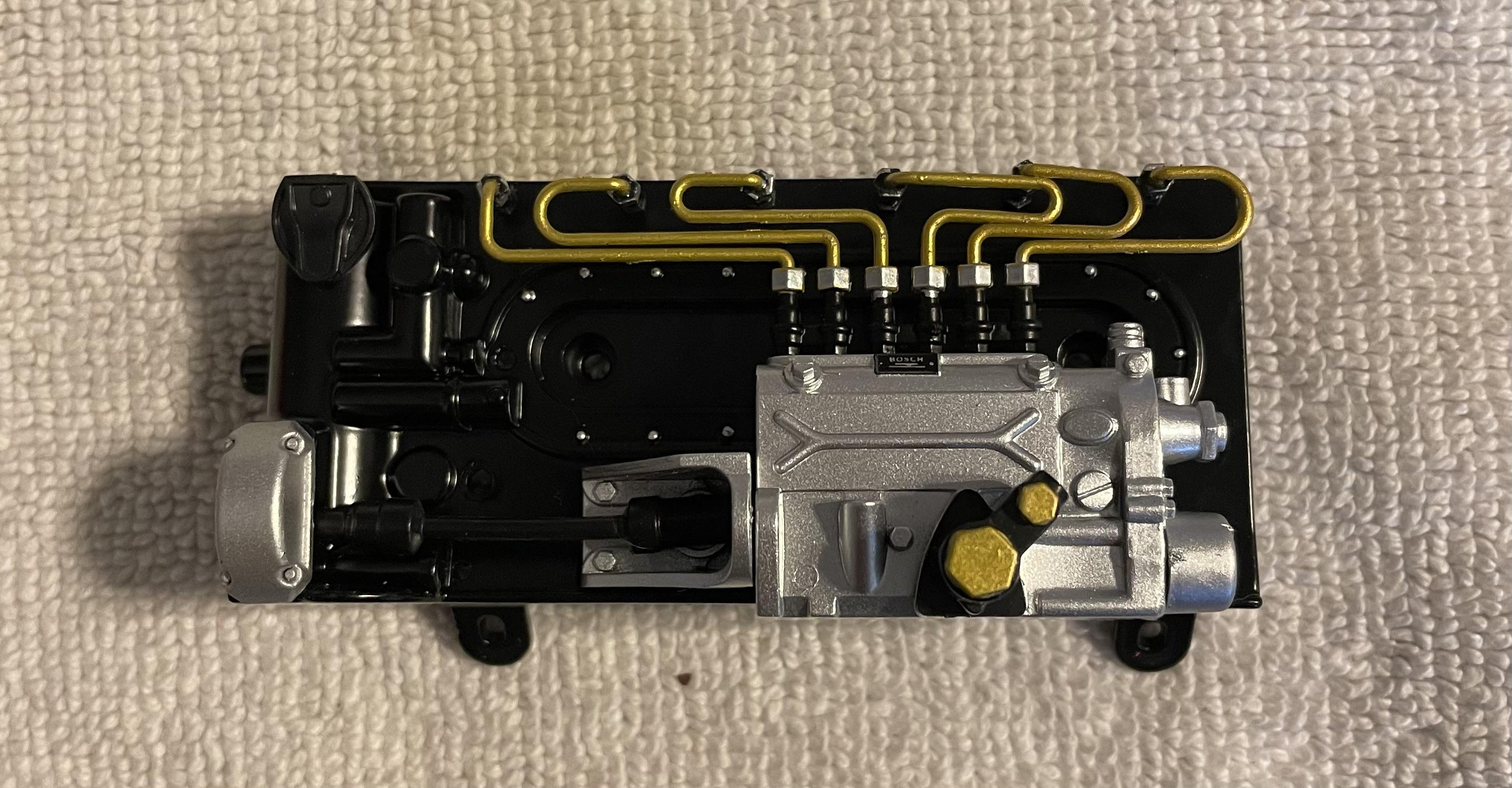

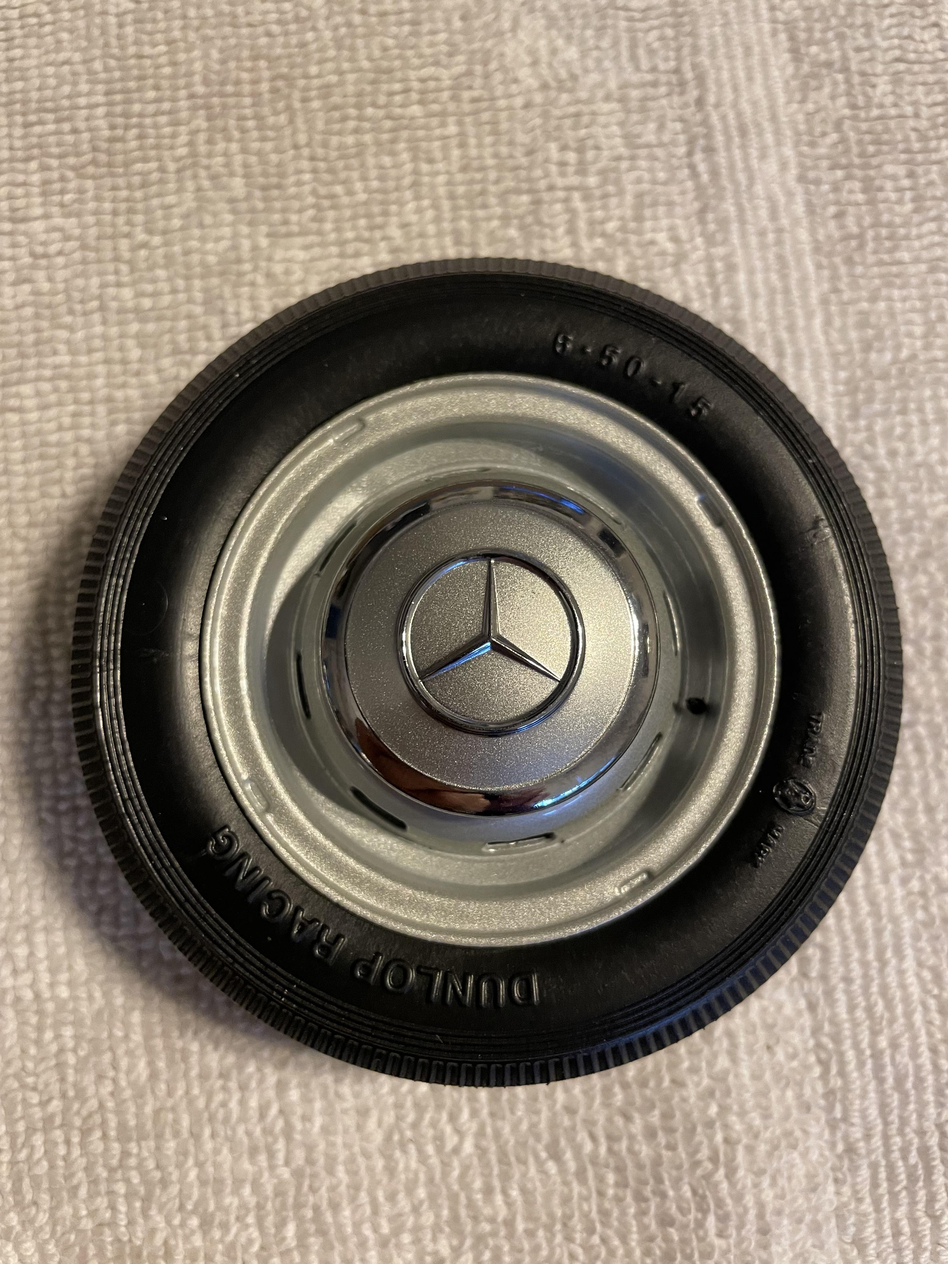

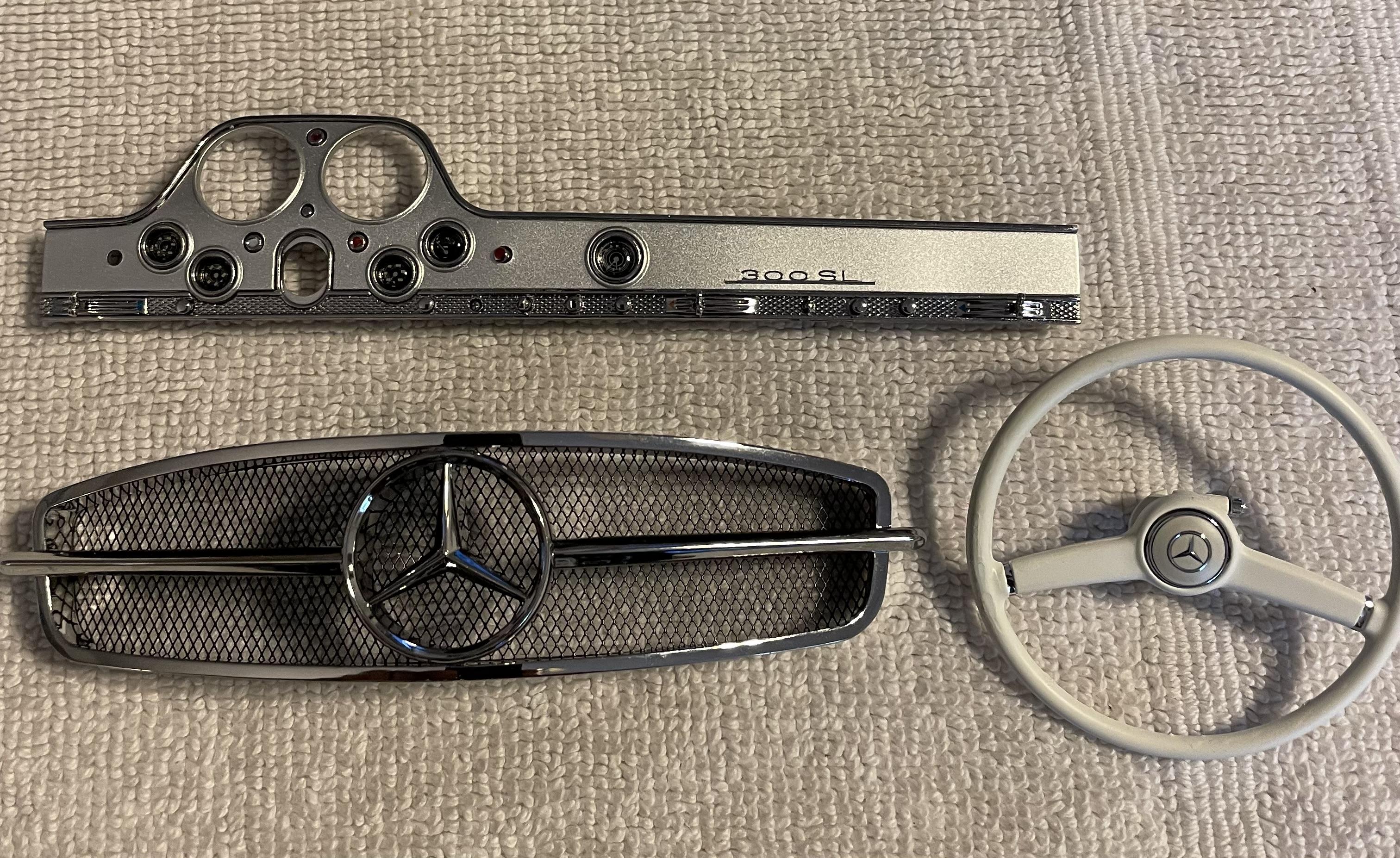

Brudda Posted August 14, 2023 Author Posted August 14, 2023 Pack one is finished . Just need to paint the hood. This car is going black, Dash, steering wheel, tire and wheel , grill and the side of the engine. I’m going to leave the dash and wheel cover silver. Supposed to be black but the contrast of the silver might make it pop. The chrome is fantastic. 2

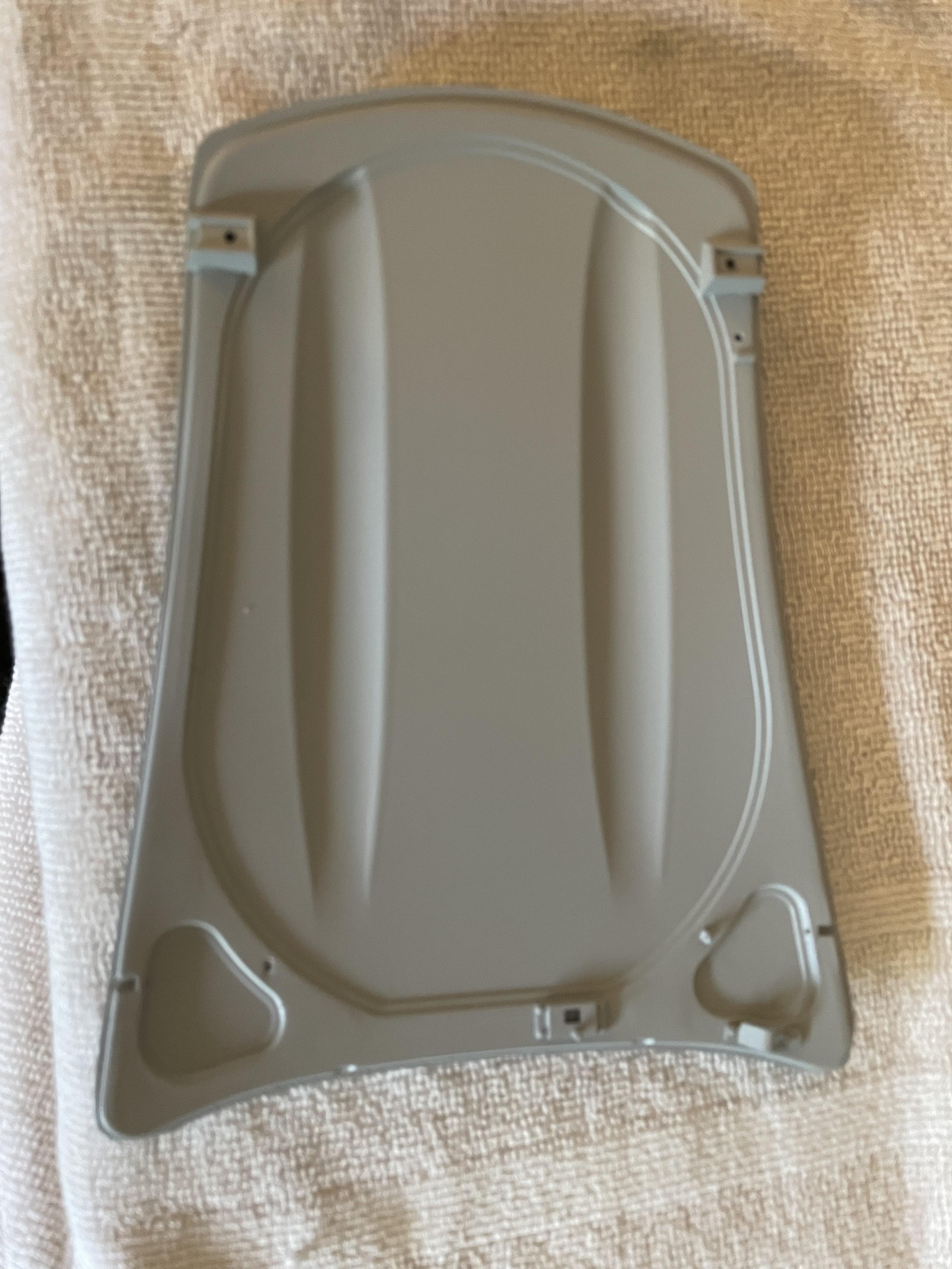

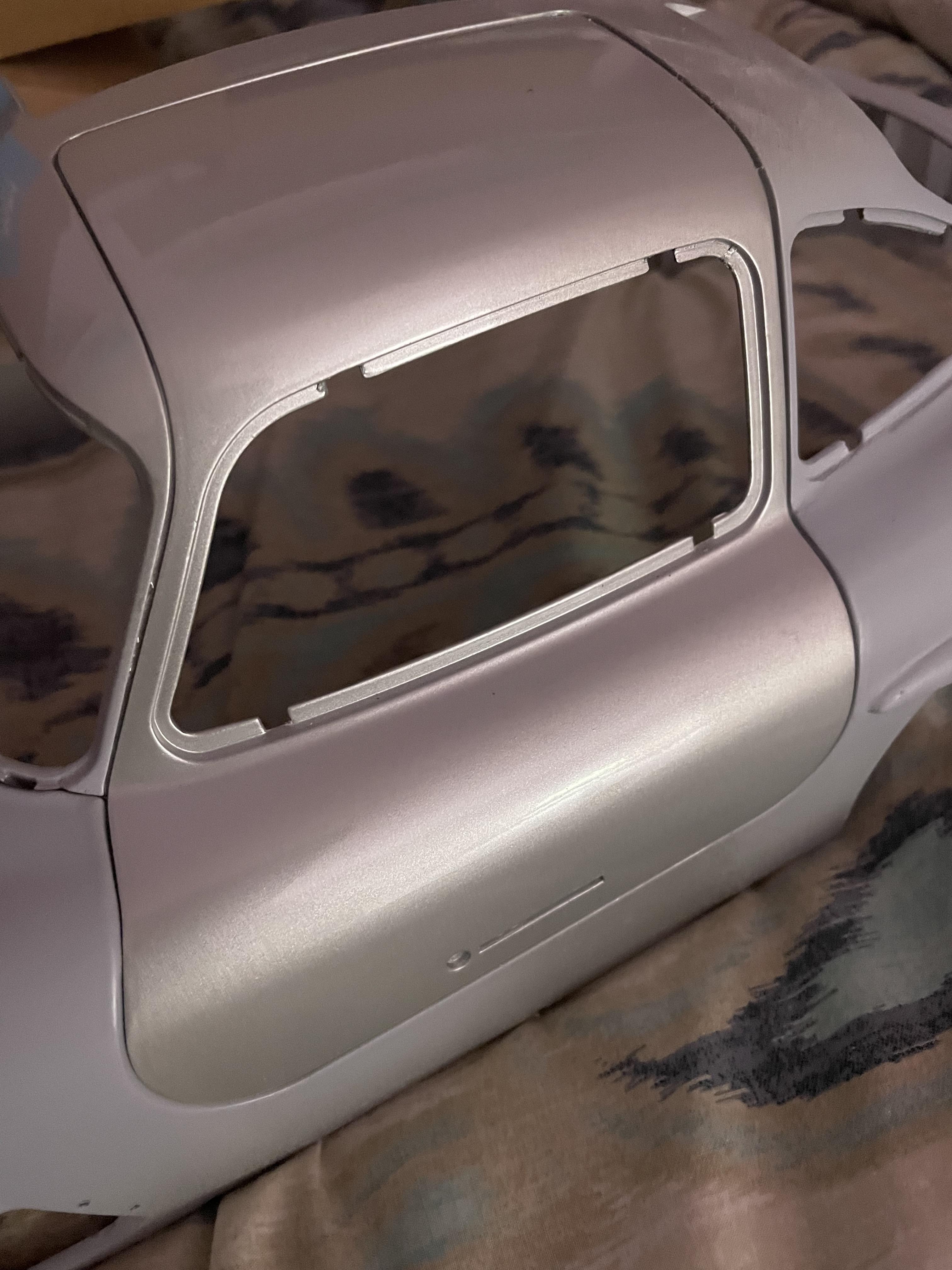

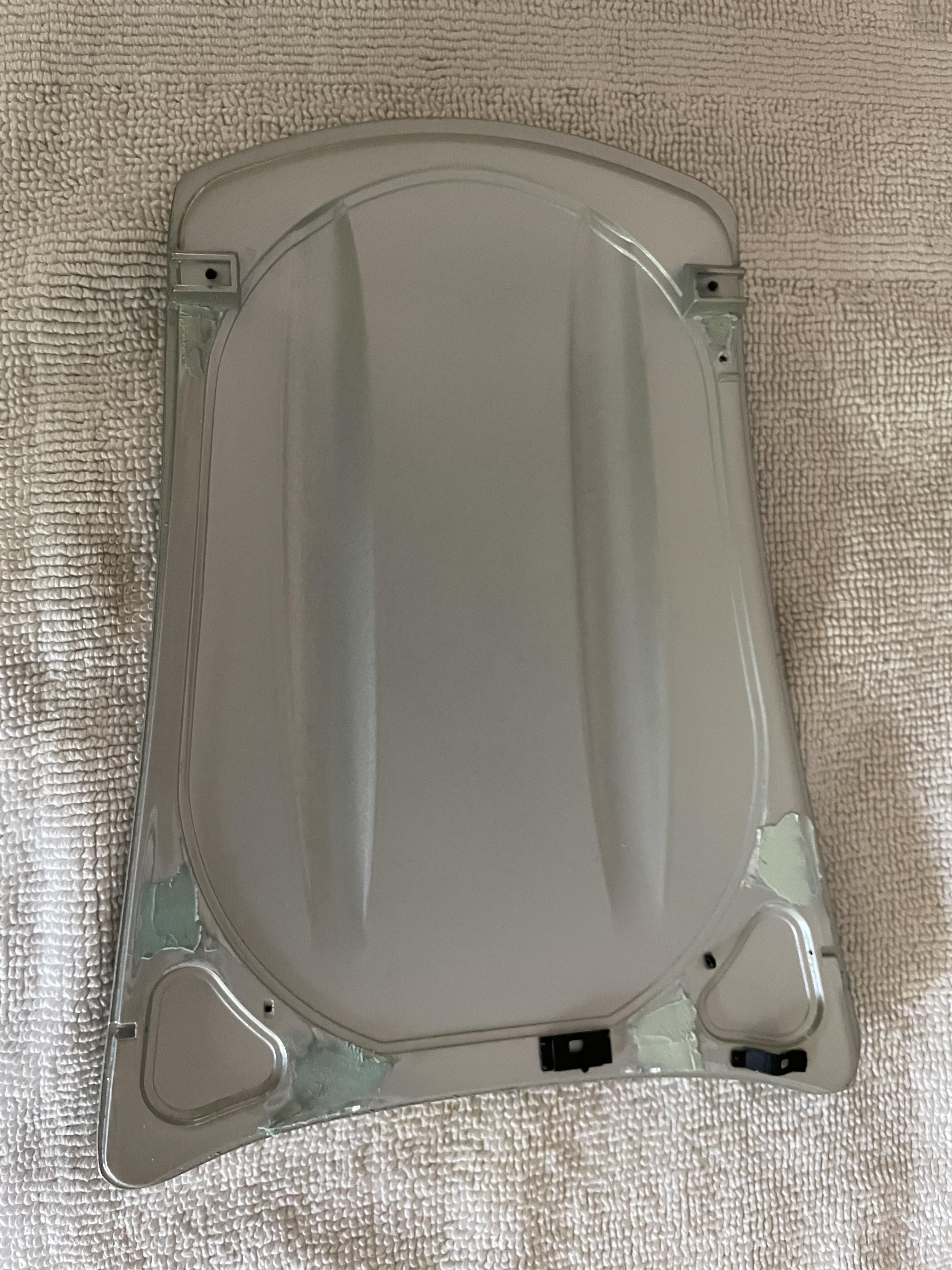

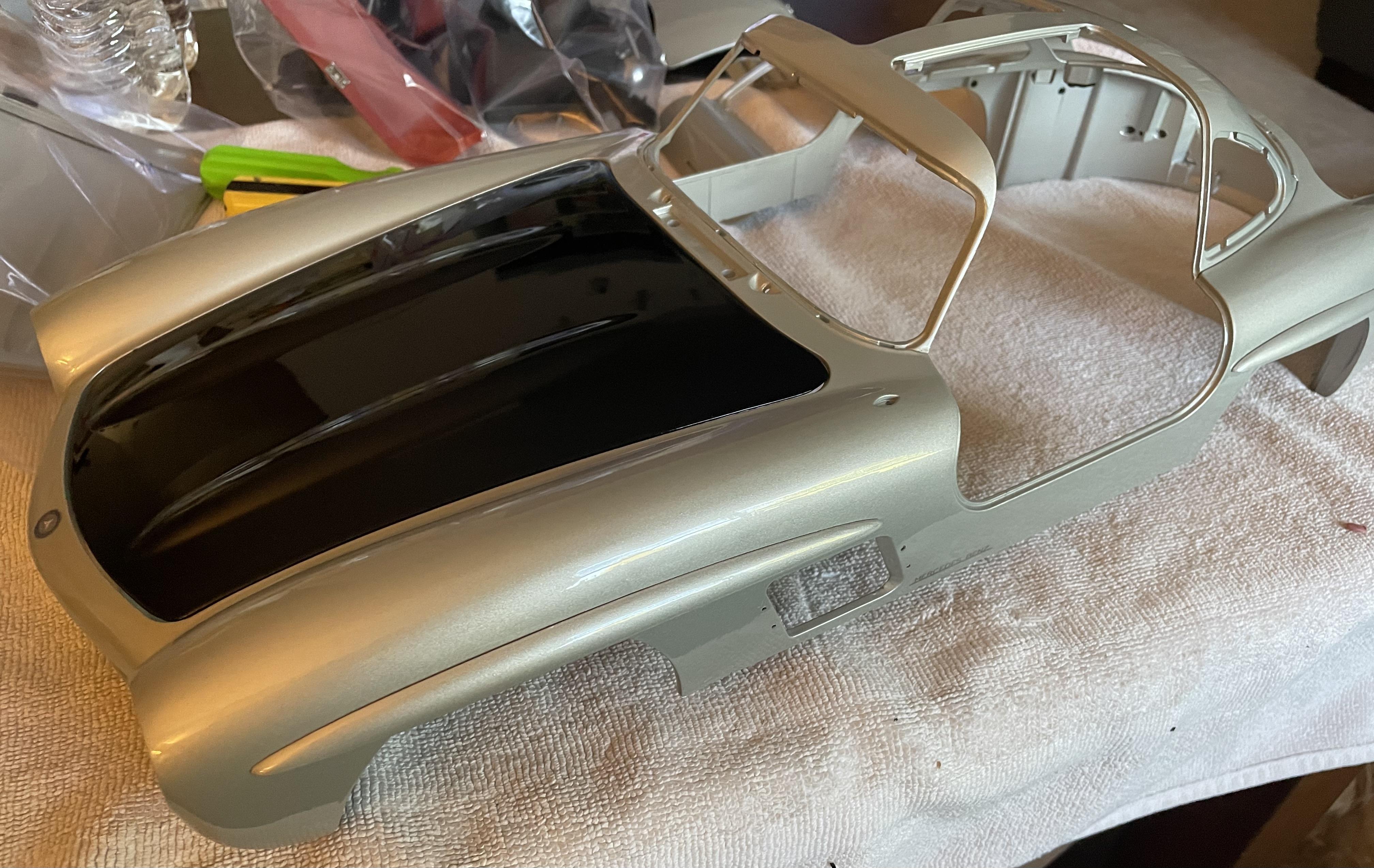

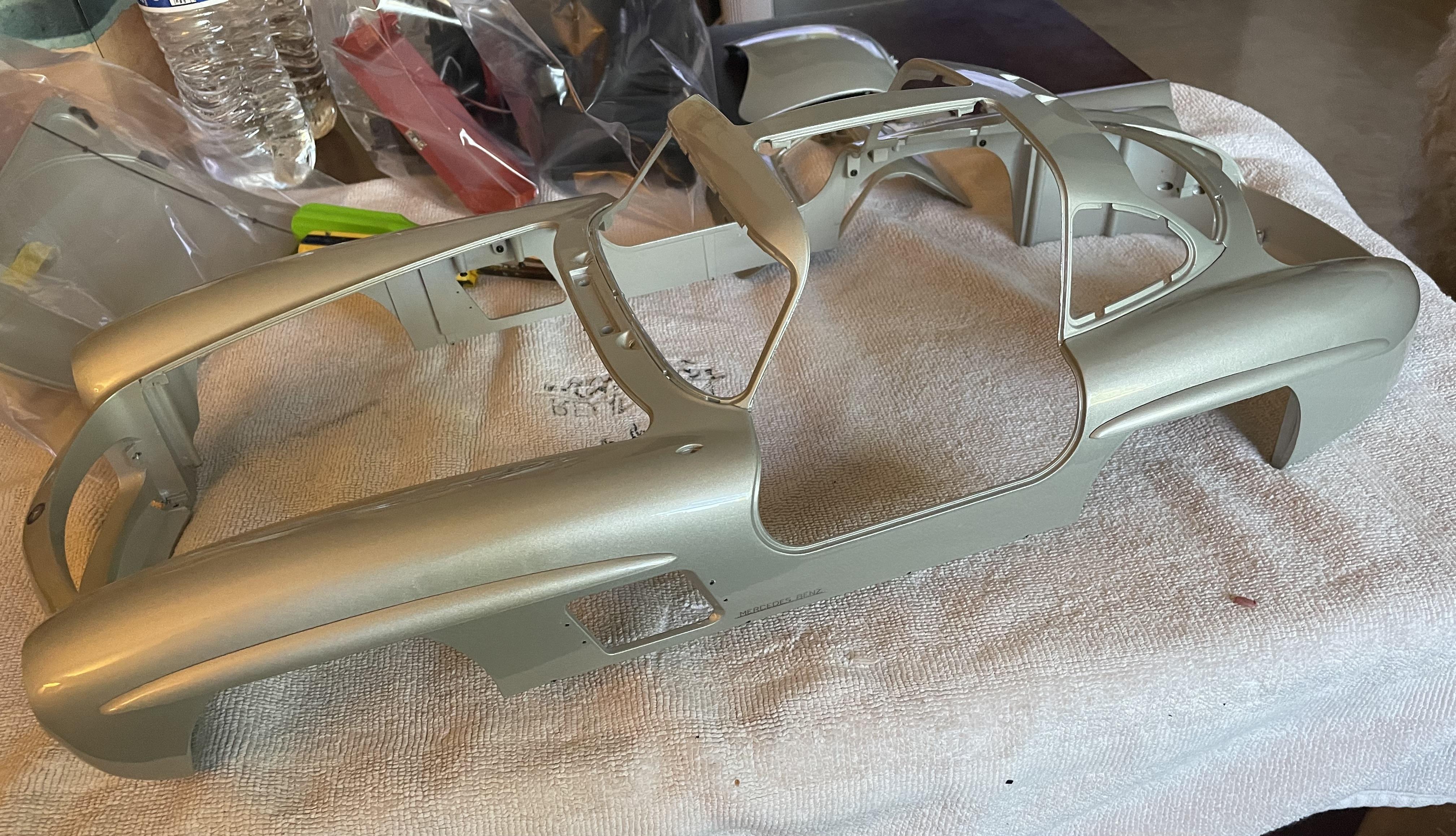

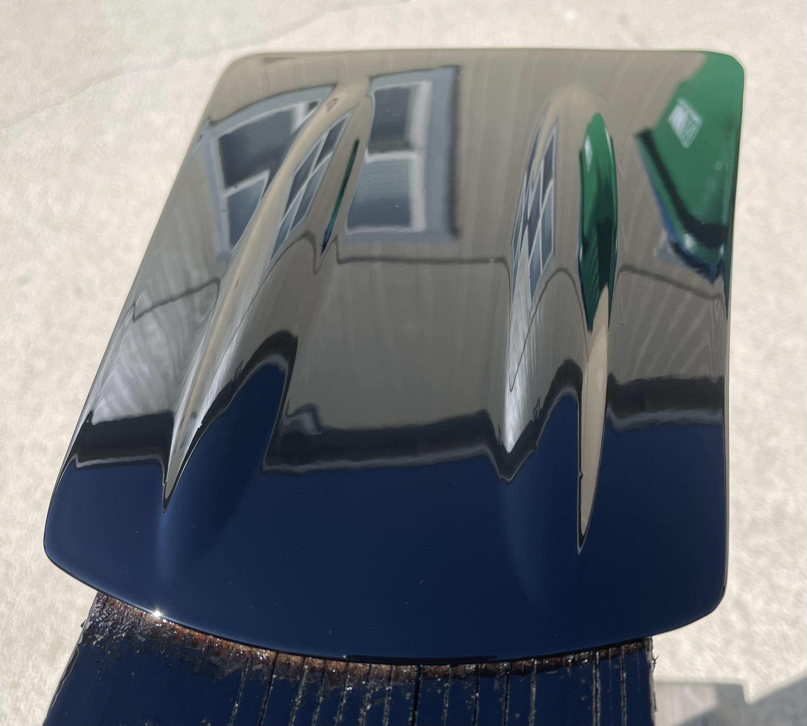

Brudda Posted August 27, 2023 Author Posted August 27, 2023 Painted hood. Starting pack 2. Mark A from agora has supplied me a complete body to paint black. Needs some body work going to disassemble the body and paint the body. Do not have to wait for each pack to arrive to paint her. Saves a lot of time. 1

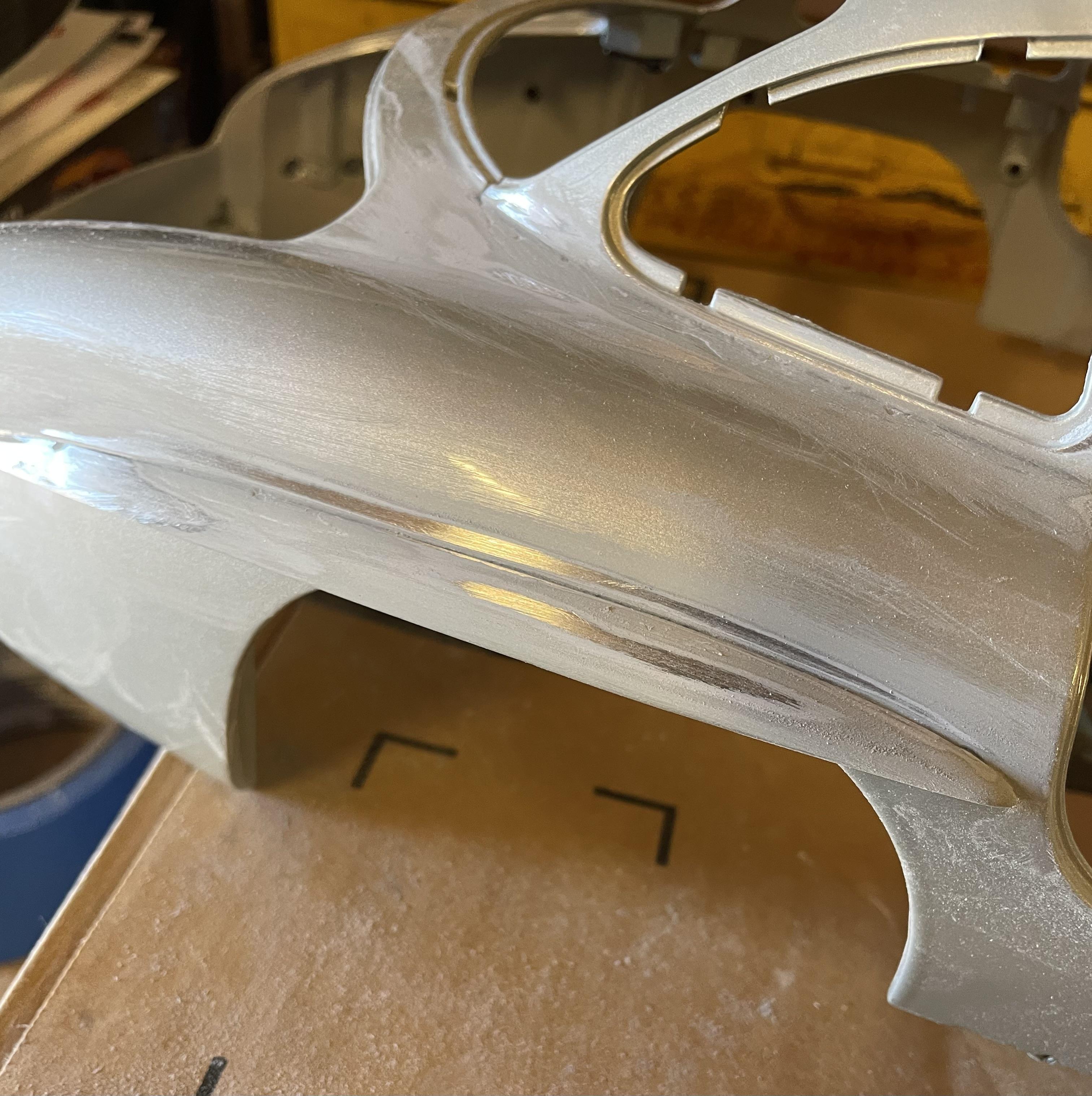

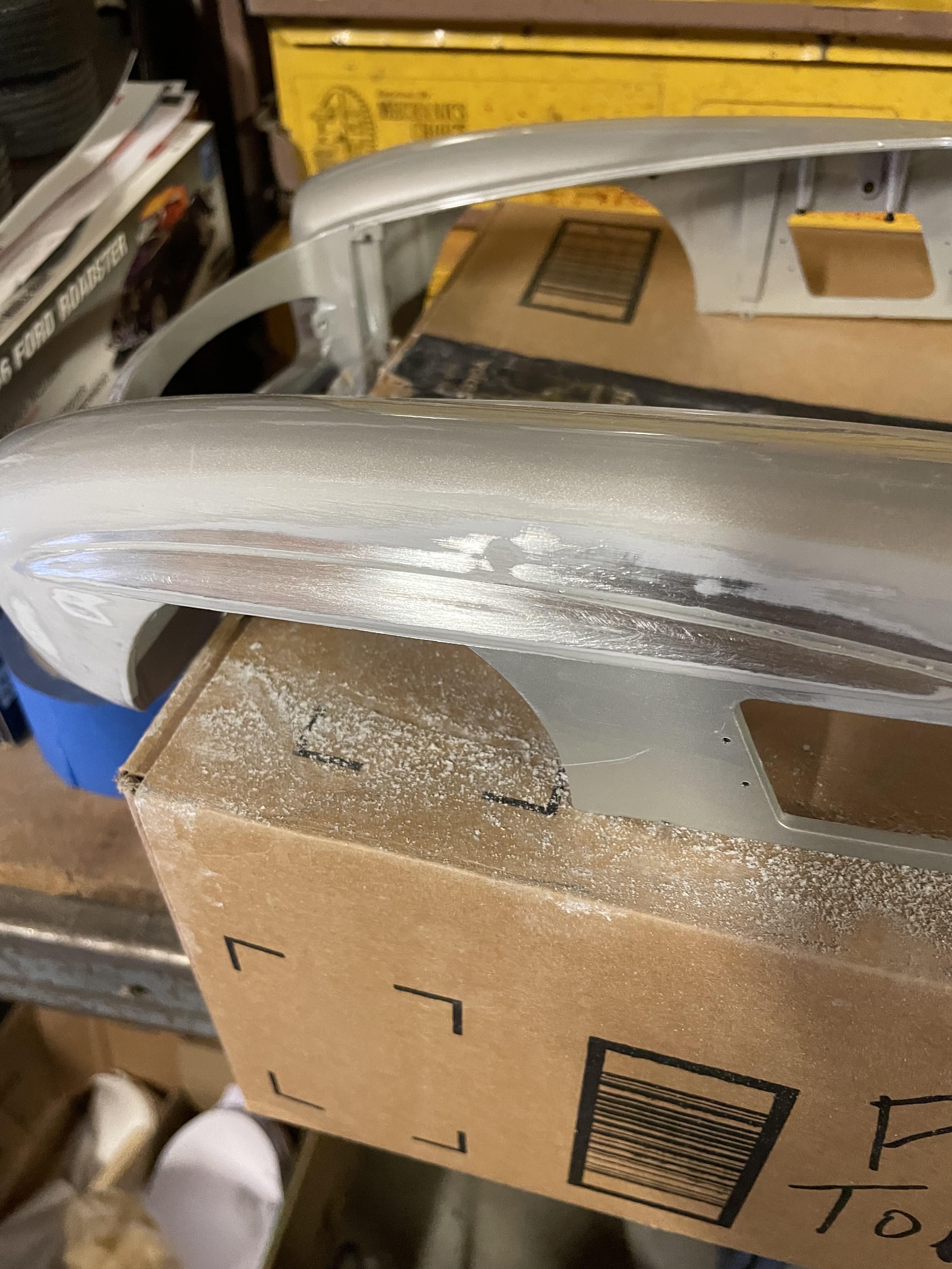

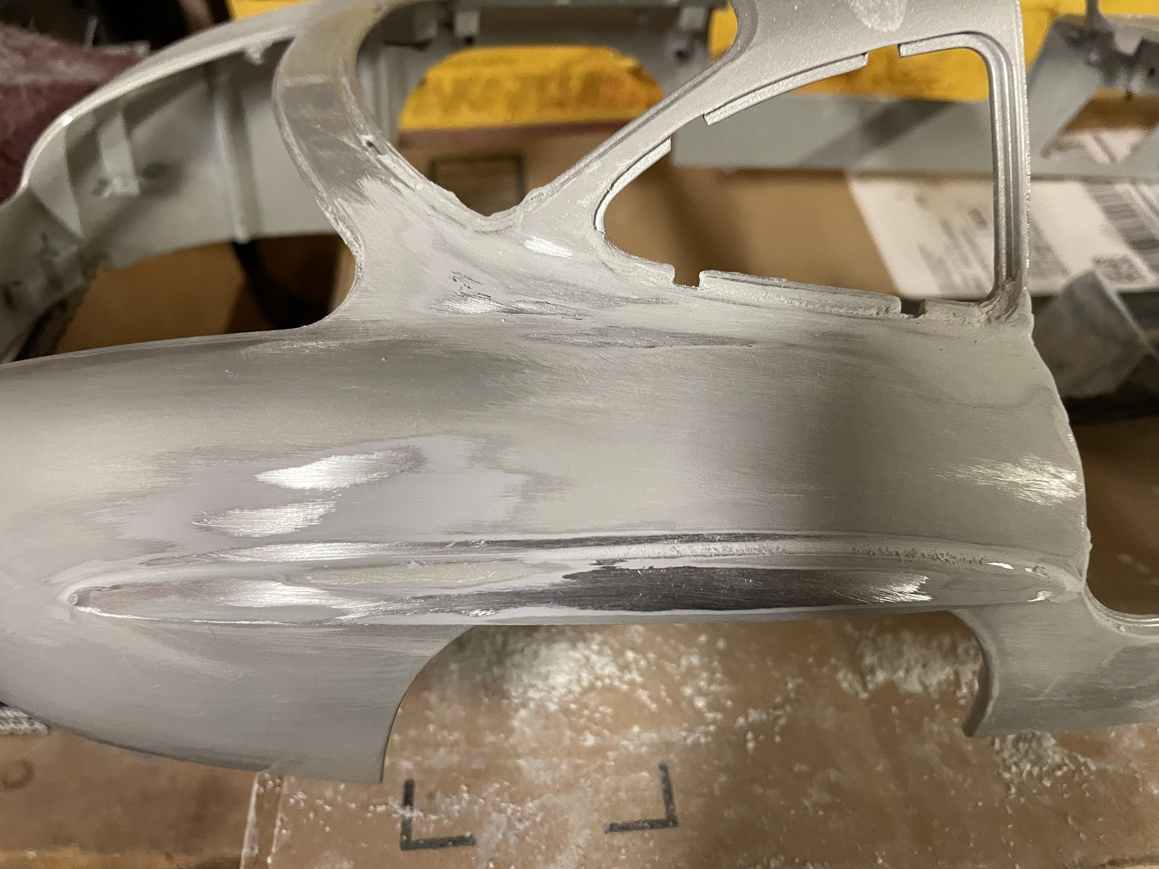

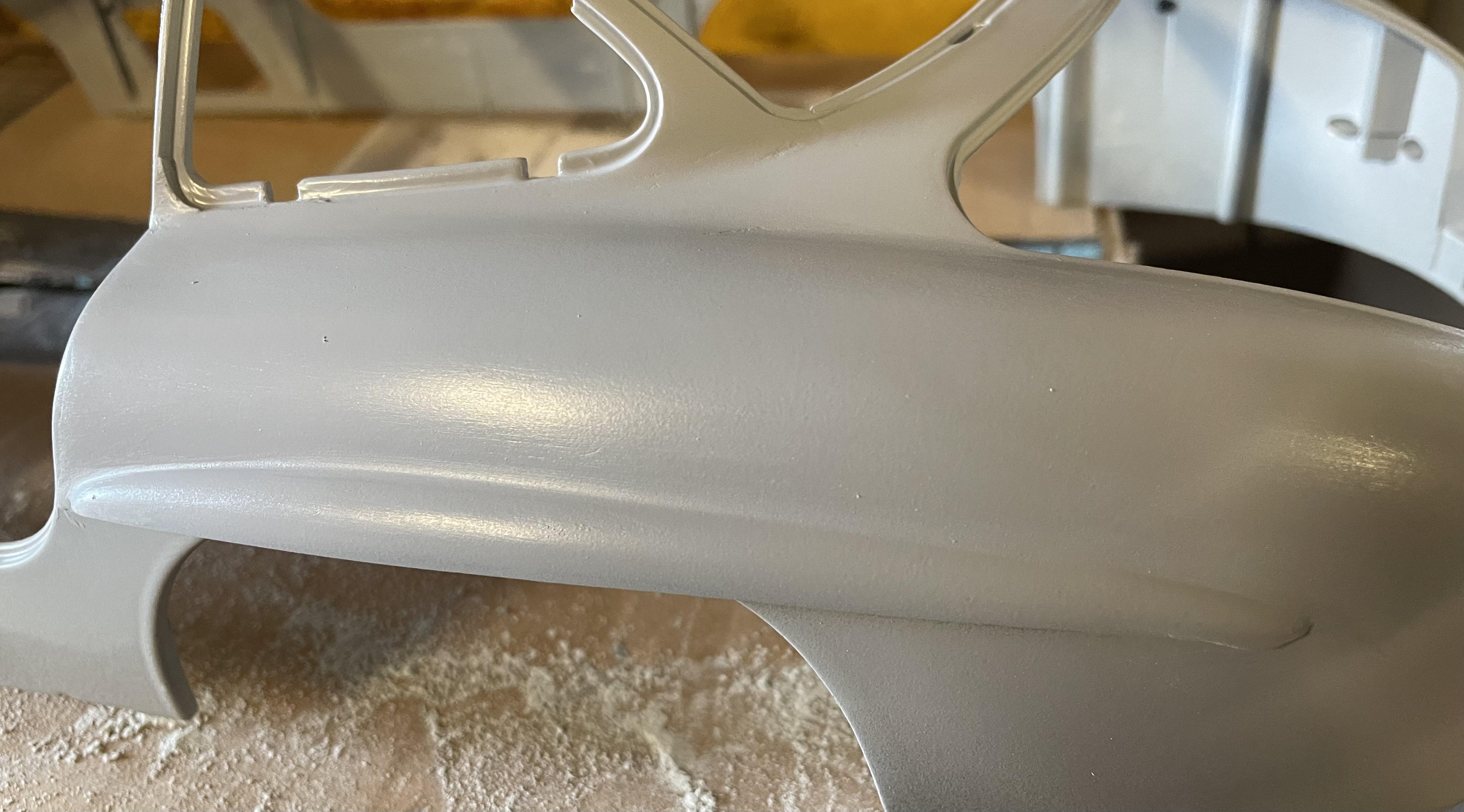

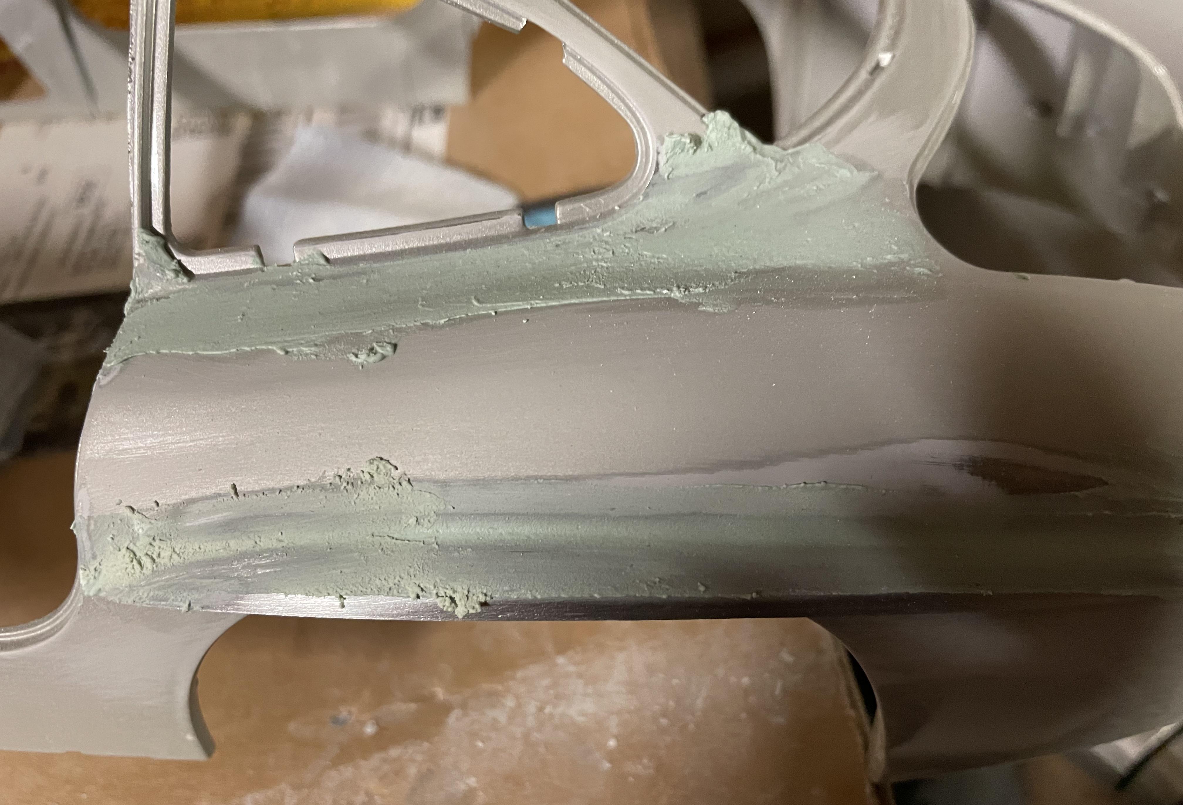

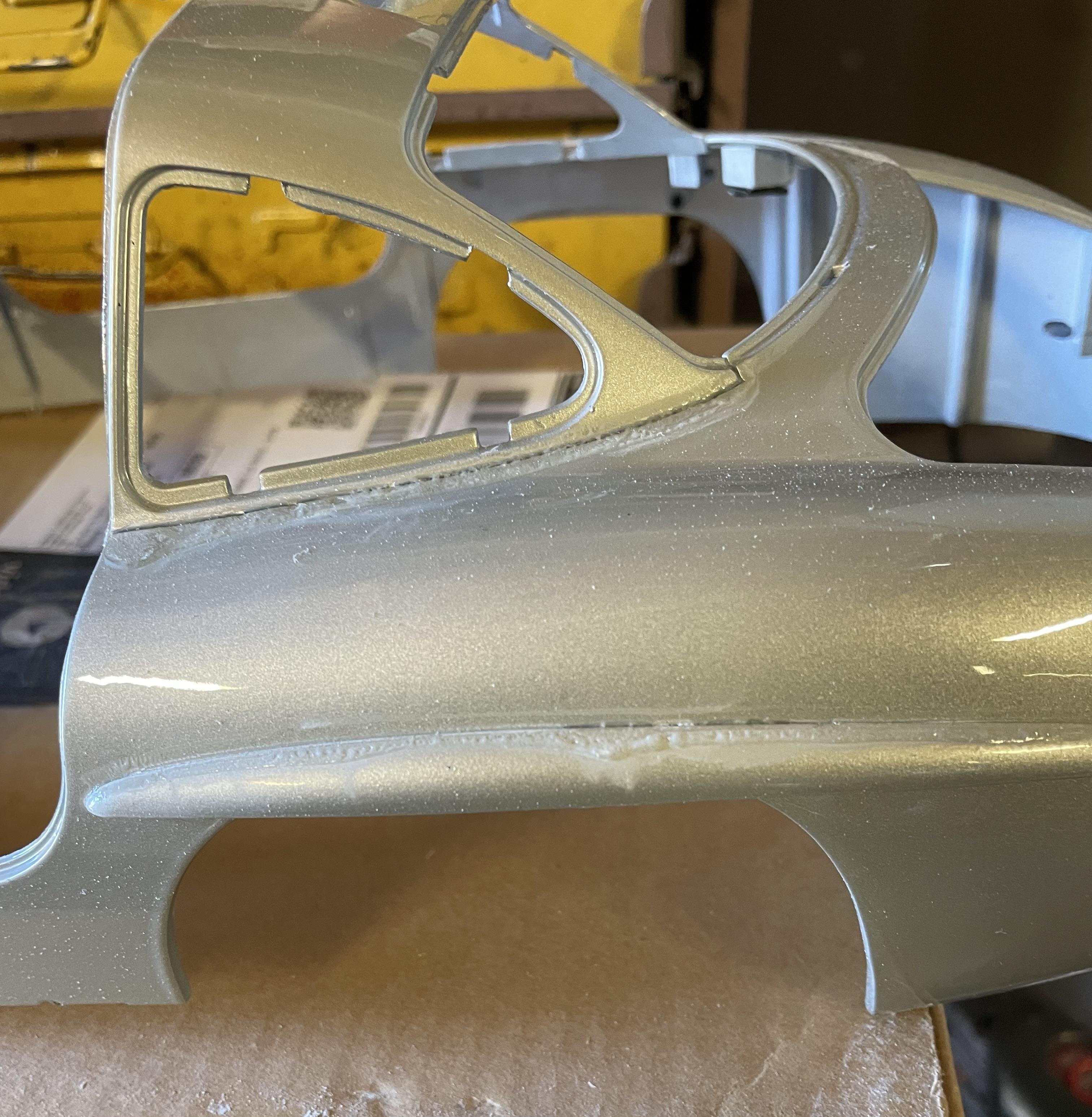

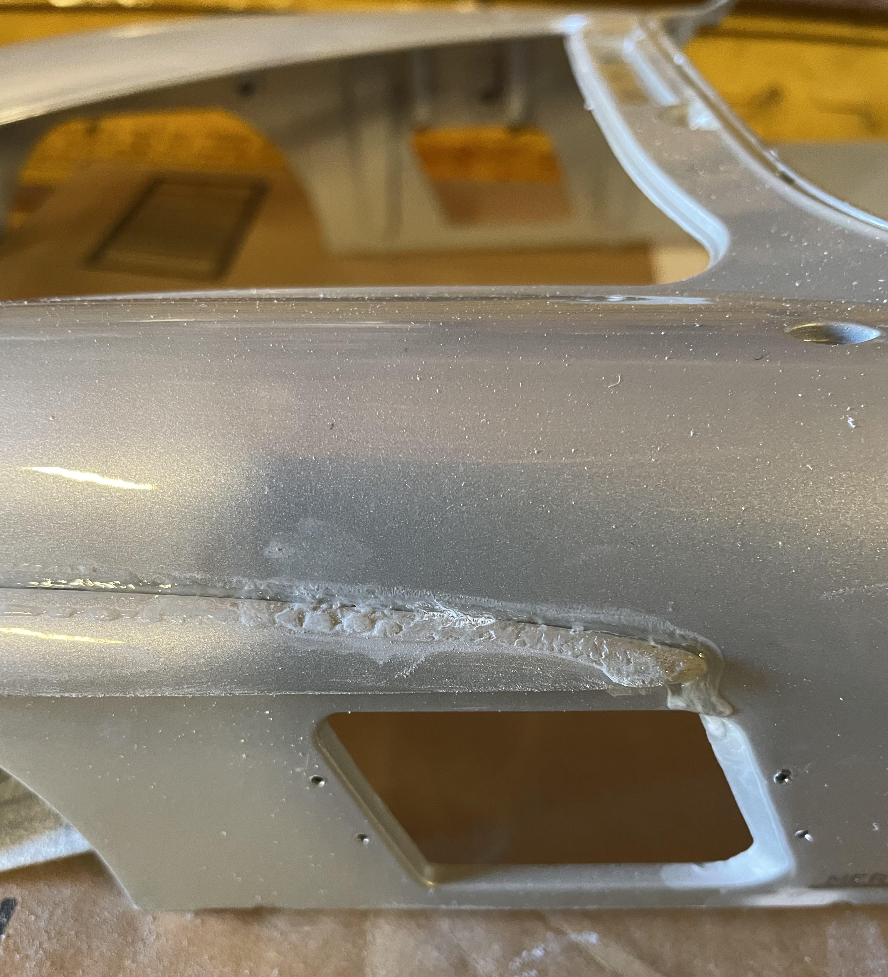

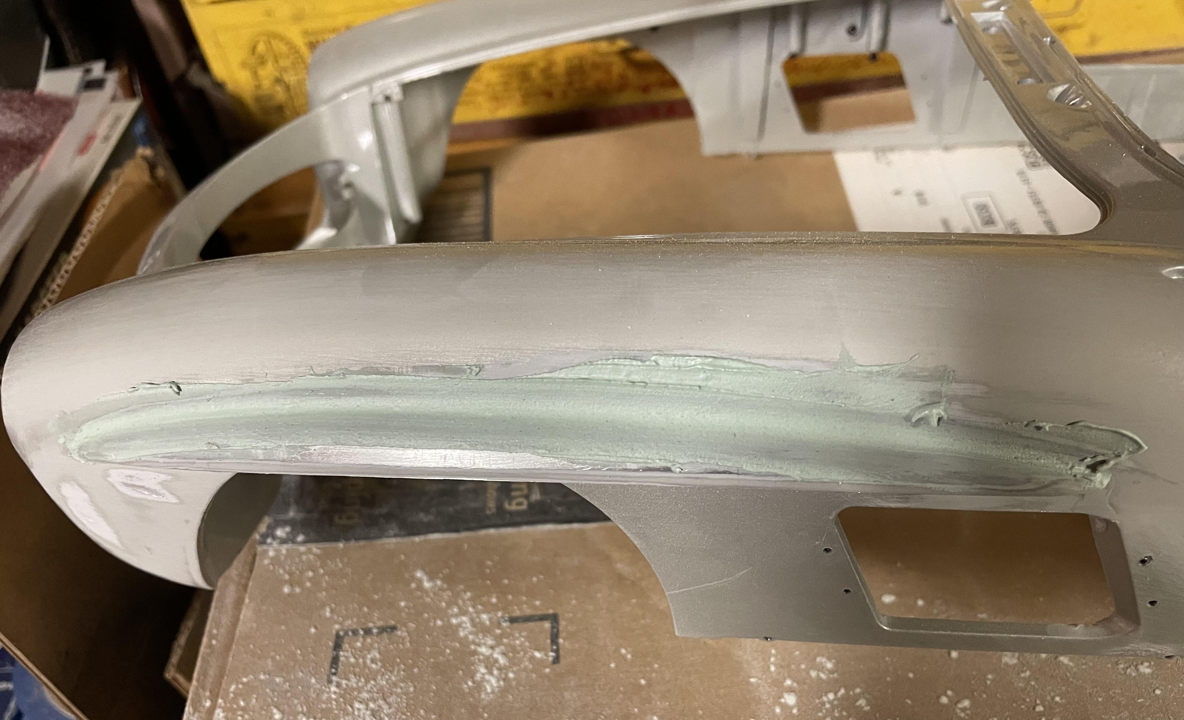

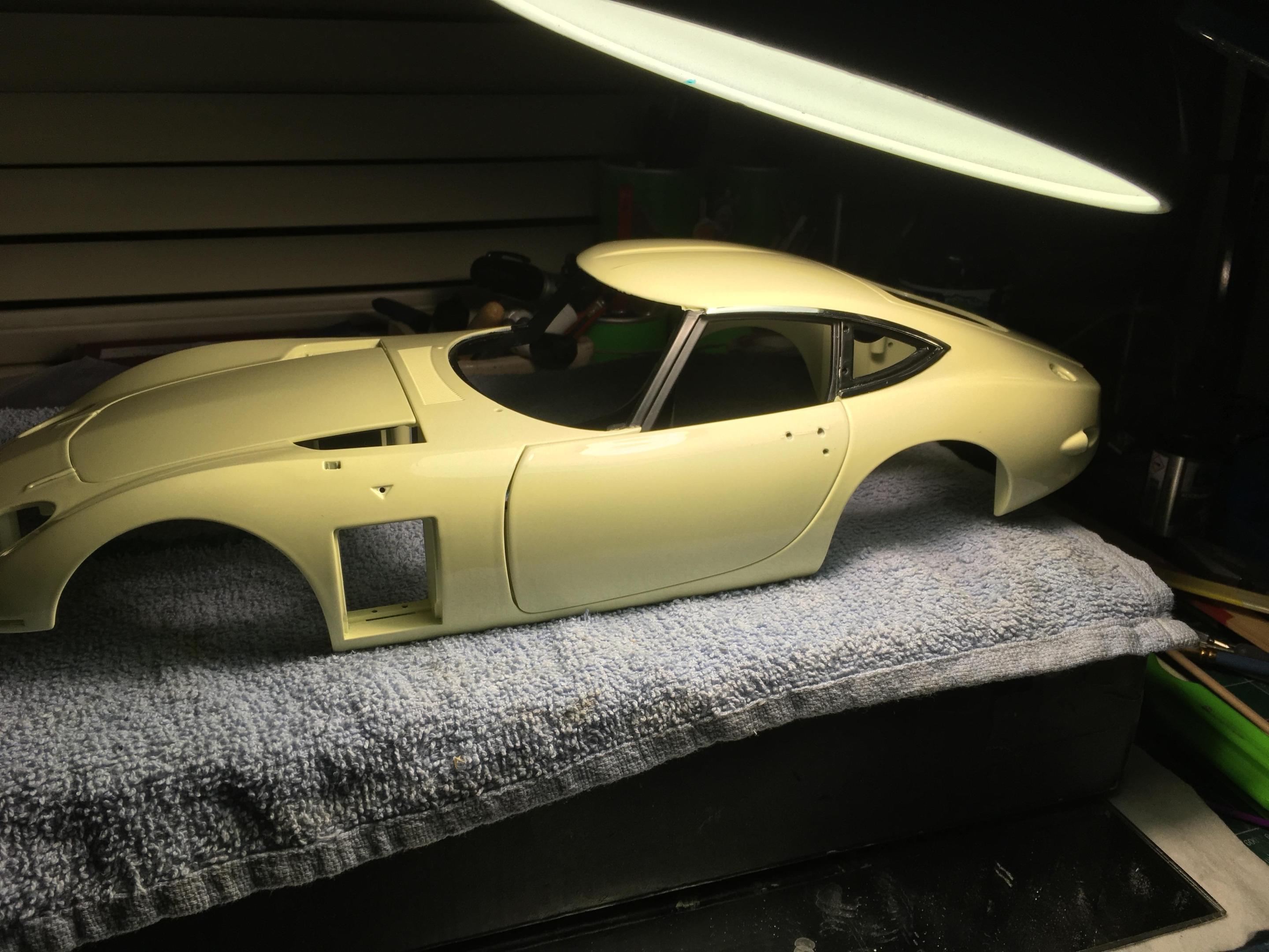

Brudda Posted August 31, 2023 Author Posted August 31, 2023 Ok I am super glue with activator. Eyebrows over the wheel house. And a roof to quarter panel seam. Sanding the glue. It’s insurance for the bolted on eyebrow. Next, Filling with evercoat automotive putty. This part of the build is the most exciting to me. I love to do the body and paint on models. Stance, paint job then details. For a contest , I use this as commandments for building a model car. The stance and paint catch the eye, draws people in to look at the details. Actually I use this for all my car models. Fun or contest. I’m sanding the super glue with 180 grit. Apply the putty over the sanded area. I will use 320 to finish it off. Primer. Reblock as nessary, reprime as nessary.
Brudda Posted August 31, 2023 Author Posted August 31, 2023 15 minutes ago, Brudda said: Ok I am super glue with activator. Eyebrows over the wheel house. And a roof to quarter panel seam. Sanding the glue. It’s insurance for the bolted on eyebrow. Next, Filling with evercoat automotive putty. This part of the build is the most exciting to me. I love to do the body and paint on models. Stance, paint job then details. For a contest , I use this as commandments for building a model car. The stance and paint catch the eye, draws people in to look at the details. Actually I use this for all my car models. Fun or contest. I’m sanding the super glue with 180 grit. Apply the putty over the sanded area. I will use 320 to finish it off. Primer. Reblock as nessary, reprime as nessary.

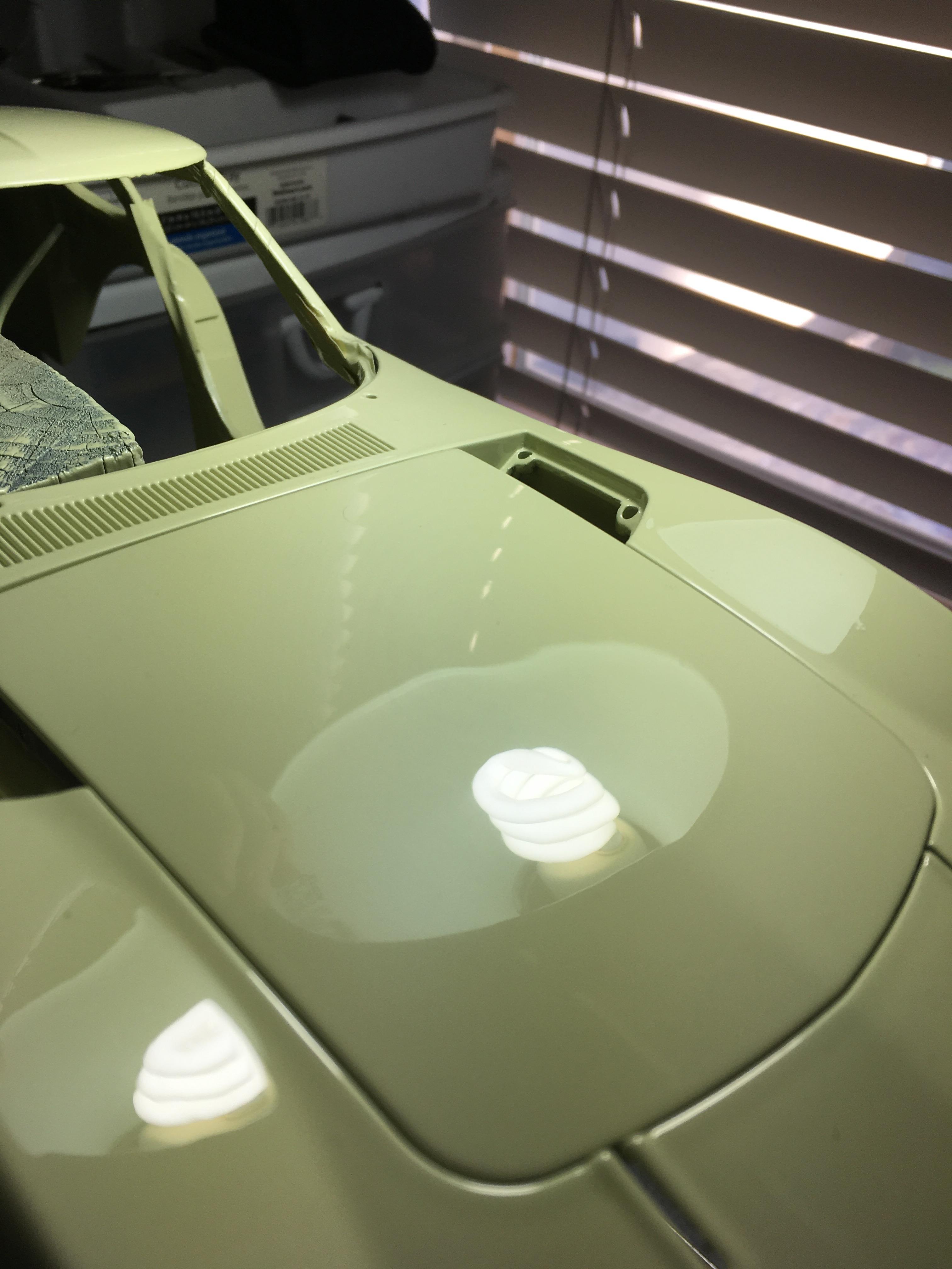

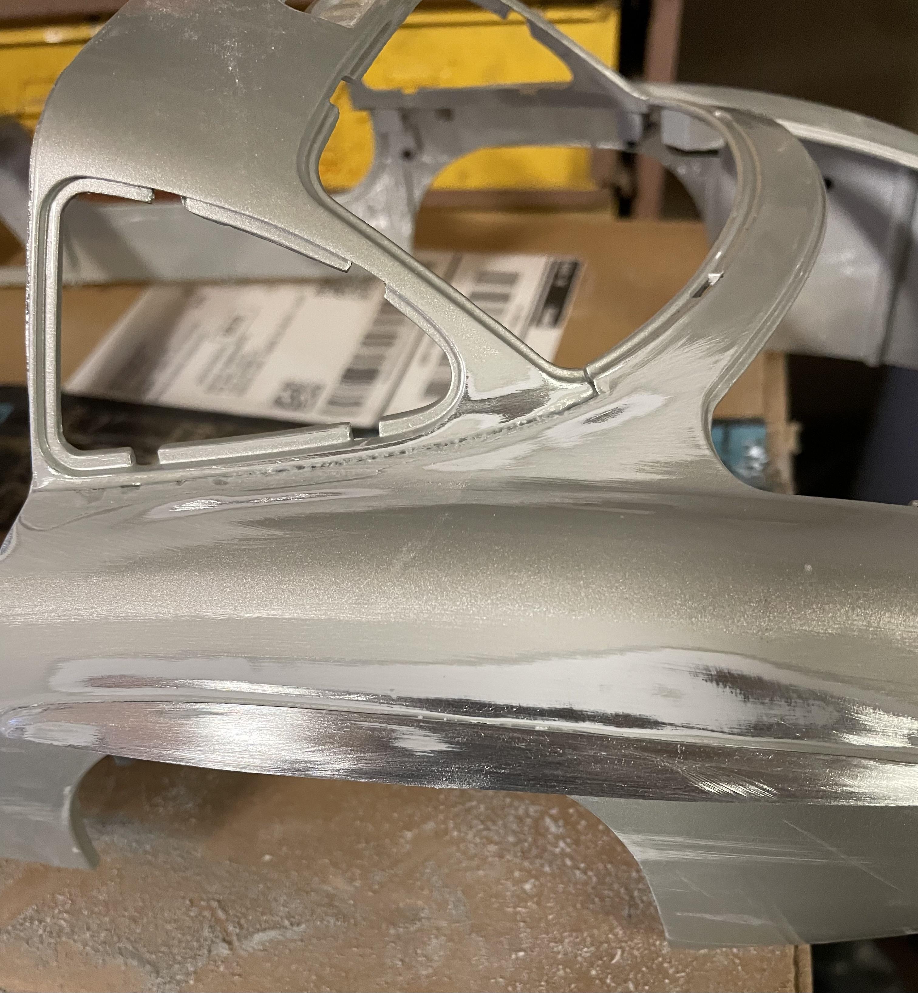

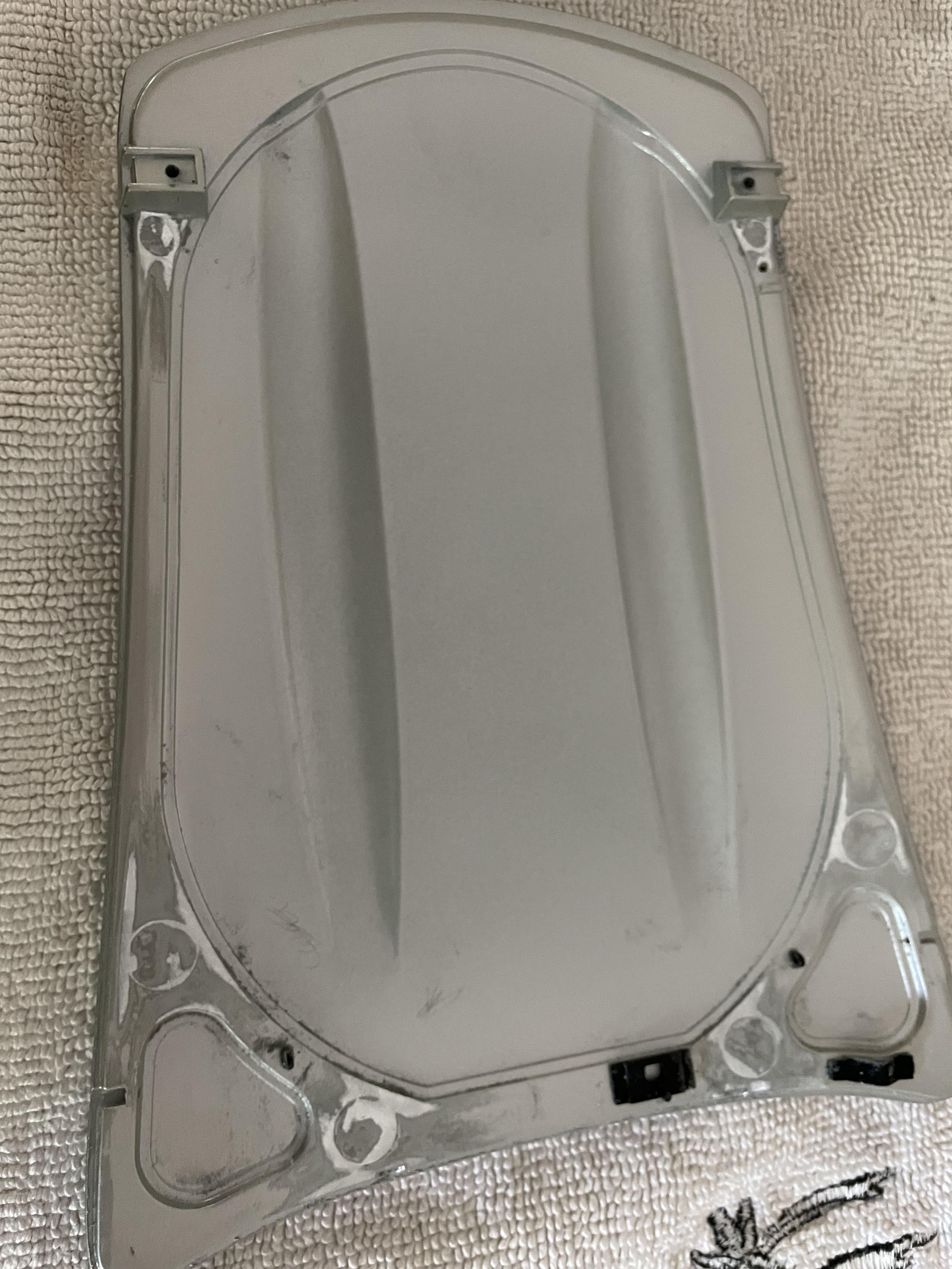

Brudda Posted September 1, 2023 Author Posted September 1, 2023 Filled with evercoat putty , sanded with 180, 320. Prime with self etching primer. Let the primer dry, next step, resand with 400. Reprime. Do this over and over till it’s straight and right.

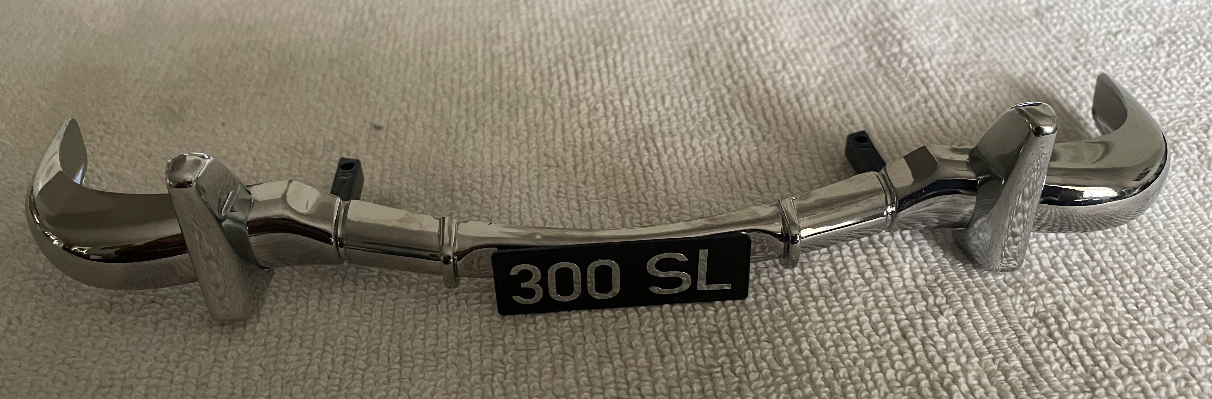

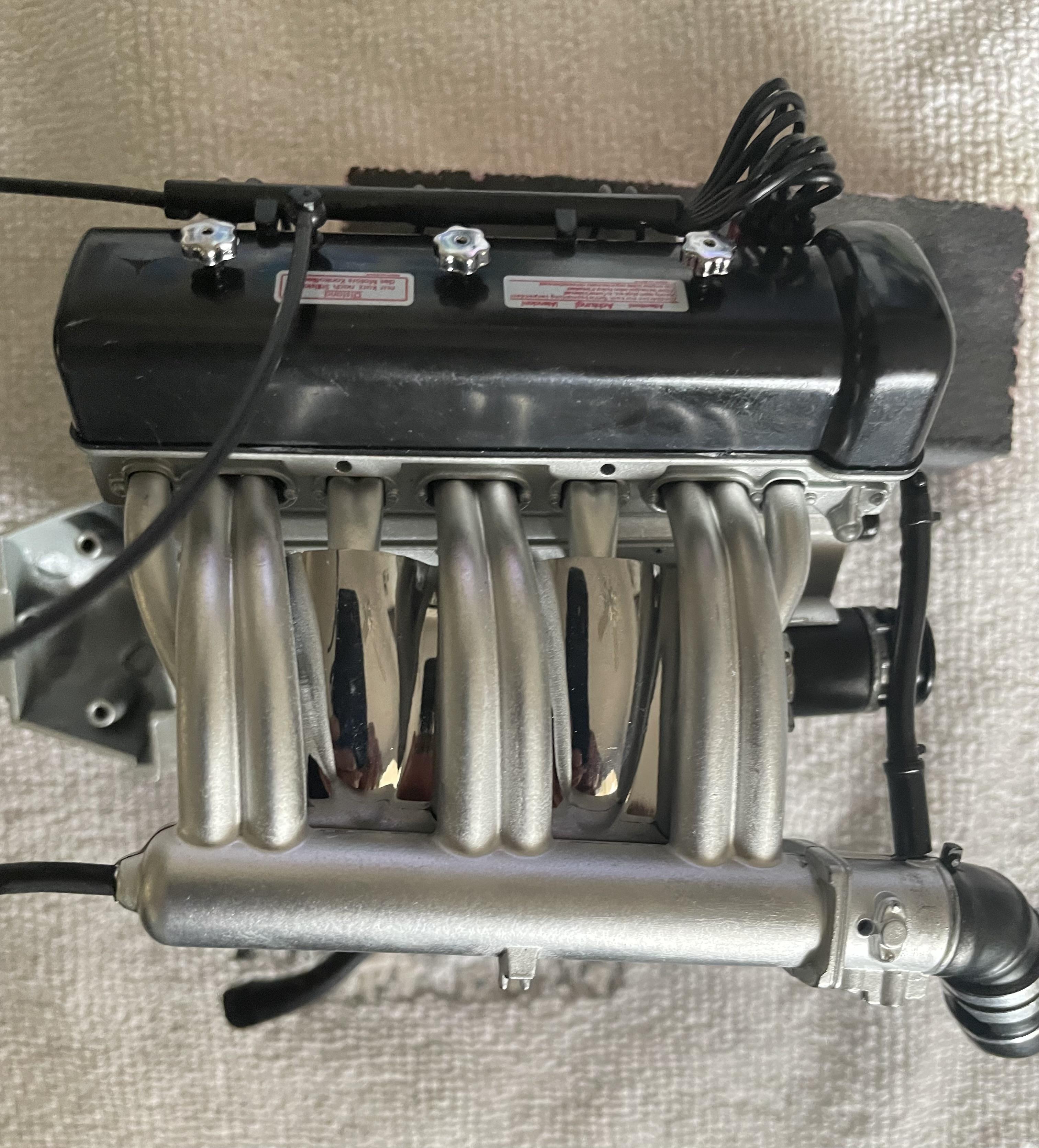

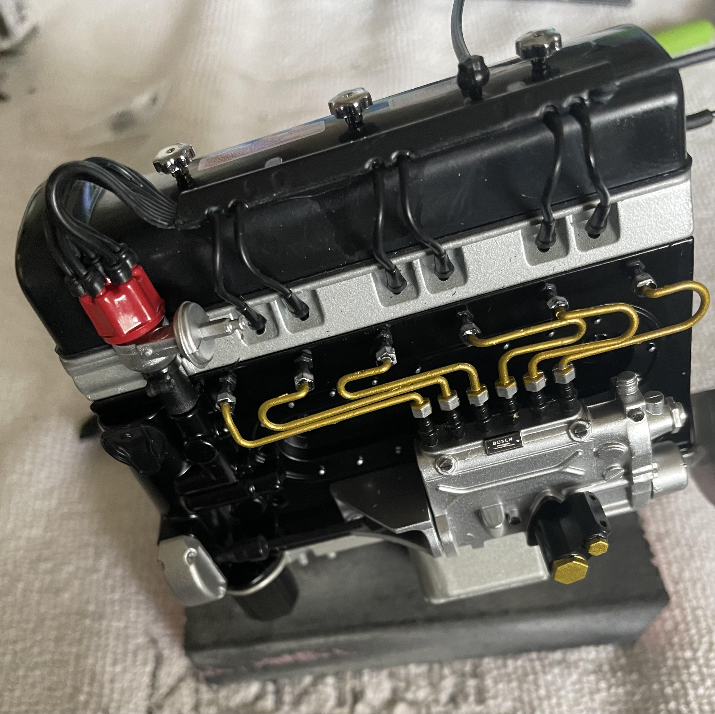

Brudda Posted September 3, 2023 Author Posted September 3, 2023 Engine starting to look good. Front bumper chrome is very nice.

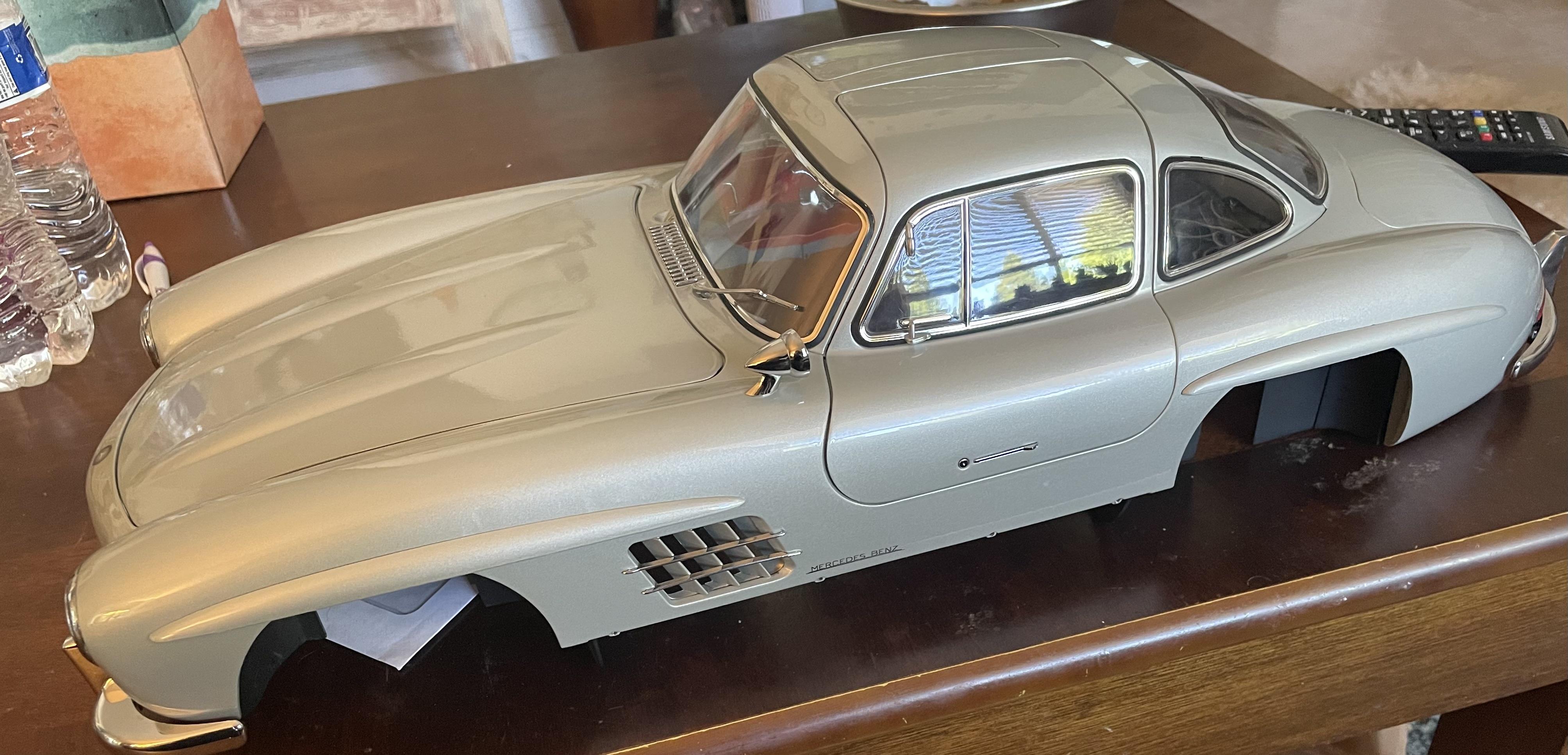

Brudda Posted September 4, 2023 Author Posted September 4, 2023 The body panels fit real well. Getting ready for the black paint.

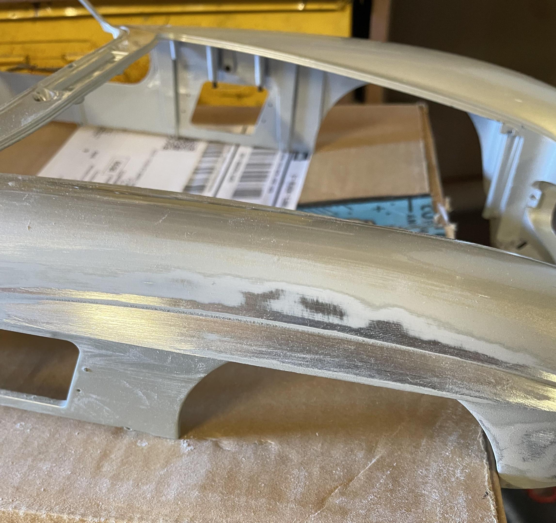

Brudda Posted September 28, 2023 Author Posted September 28, 2023 Sanding the body for the black paint. Hope to paint soon. Received another box and it looks like the chassis. This build will have to wait until I finish the GT500. Not much longer on that build so I can start building this beautiful car.
