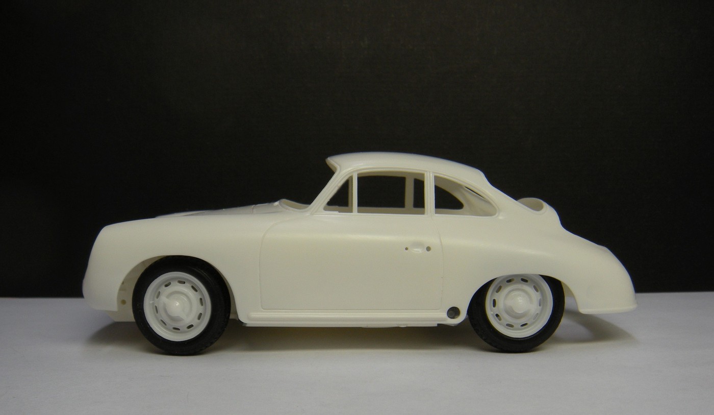

Thanks Maxx.  Here is the Dean Jeffries 356 car Maxx mentioned he hopes to build.
Porcshe-356-Custom-2.pngPorsche 356 Custom

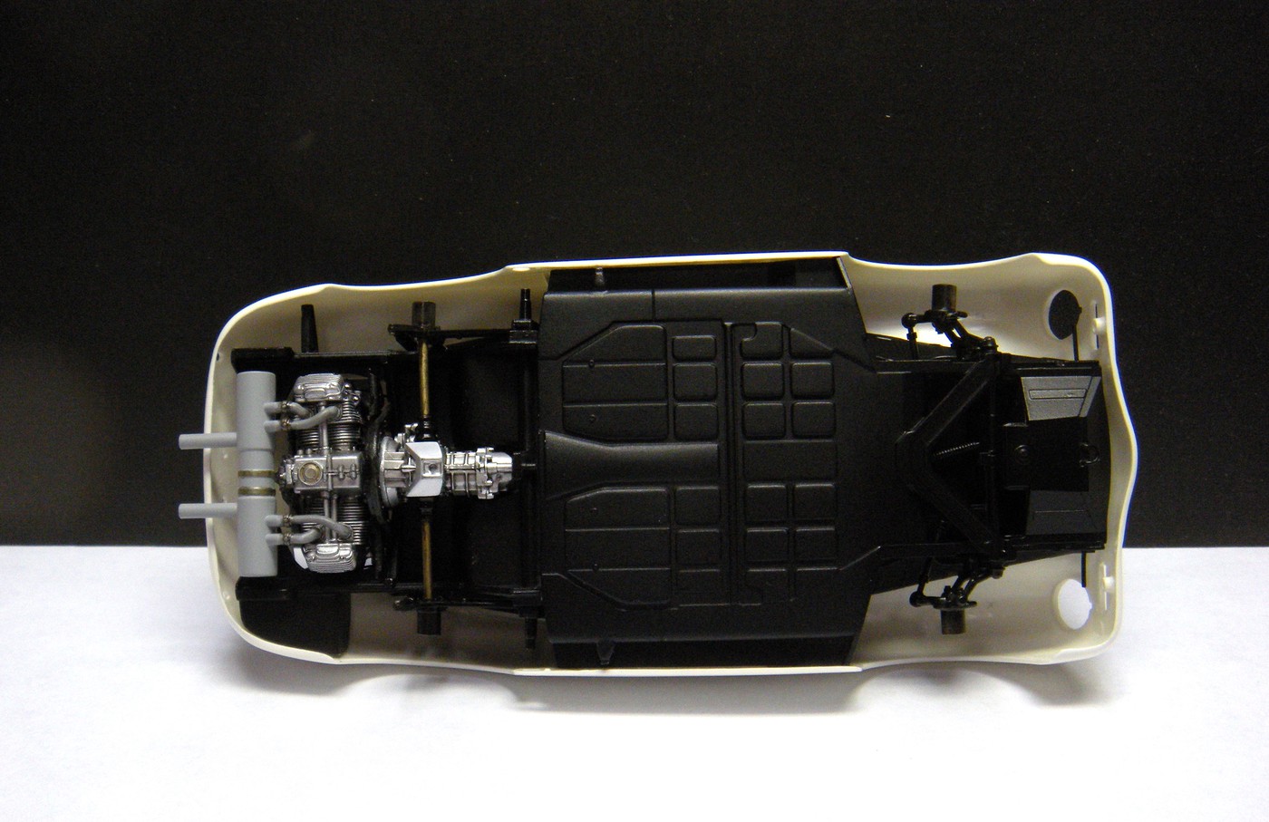

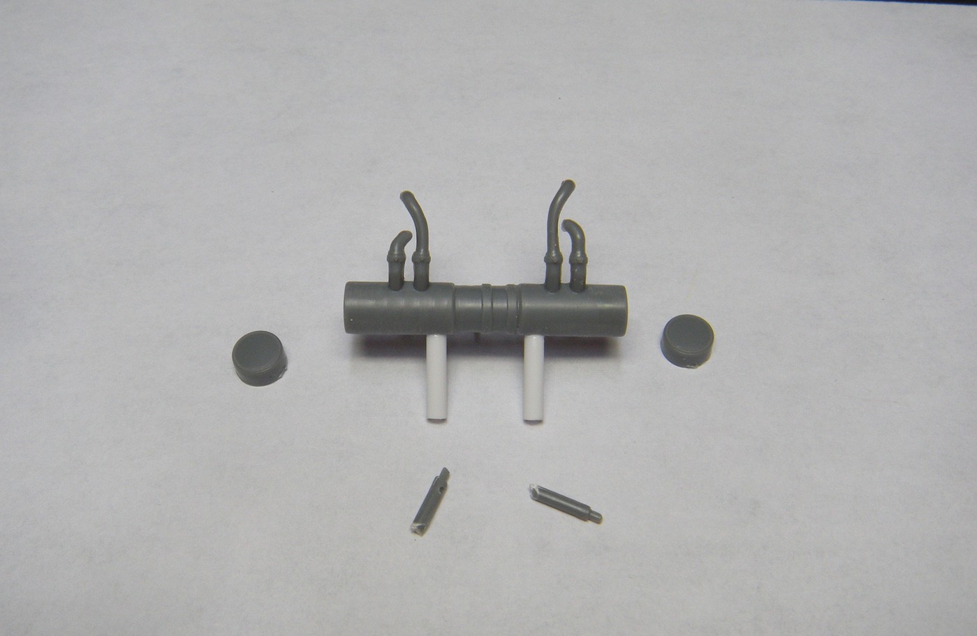

  • You don't get the stinger exhaust and I won't try and scratch build it
  • Not using the large end caps on the muffler
  • Replaced the outlet tubes for better flow and a more raucous exhaust note
DSCN9417

Yes, this is the car. It's now back in the Los Angeles area and currently on display at the Petersen Automotive Museum.

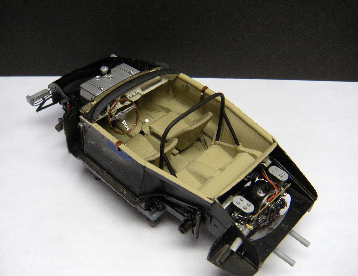

  • Engine installed
  • Added leather window lifting straps - no window cranks for the lightweight Plexiglas side windows
DSCN9425DSCN9423

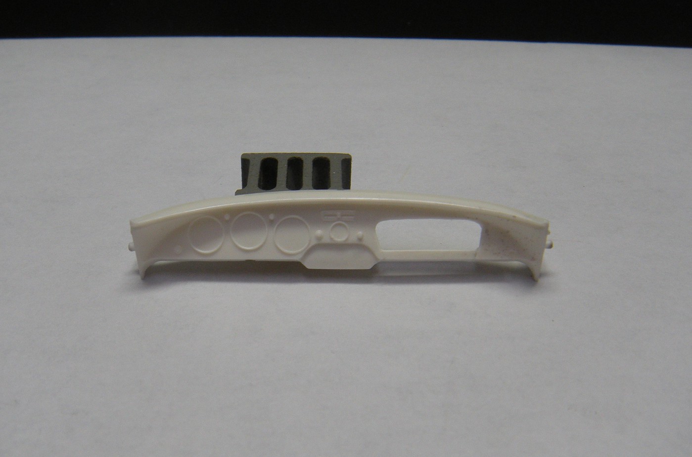

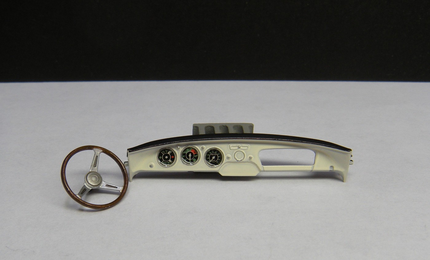

Dash is complete:
  • Dash pad should be interior color but I chose to paint if flat back to reduce glare for competition
  • No clock to "add lightness"
  • I really like Fujimi kits but their decals leave a lot to be desired
DSCN9426

  • Minus the wheels the chassis/interior/boot/engine bay is complete
  • Fuel tank should be black, I chose silver
DSCN9428DSCN9431DSCN9432
