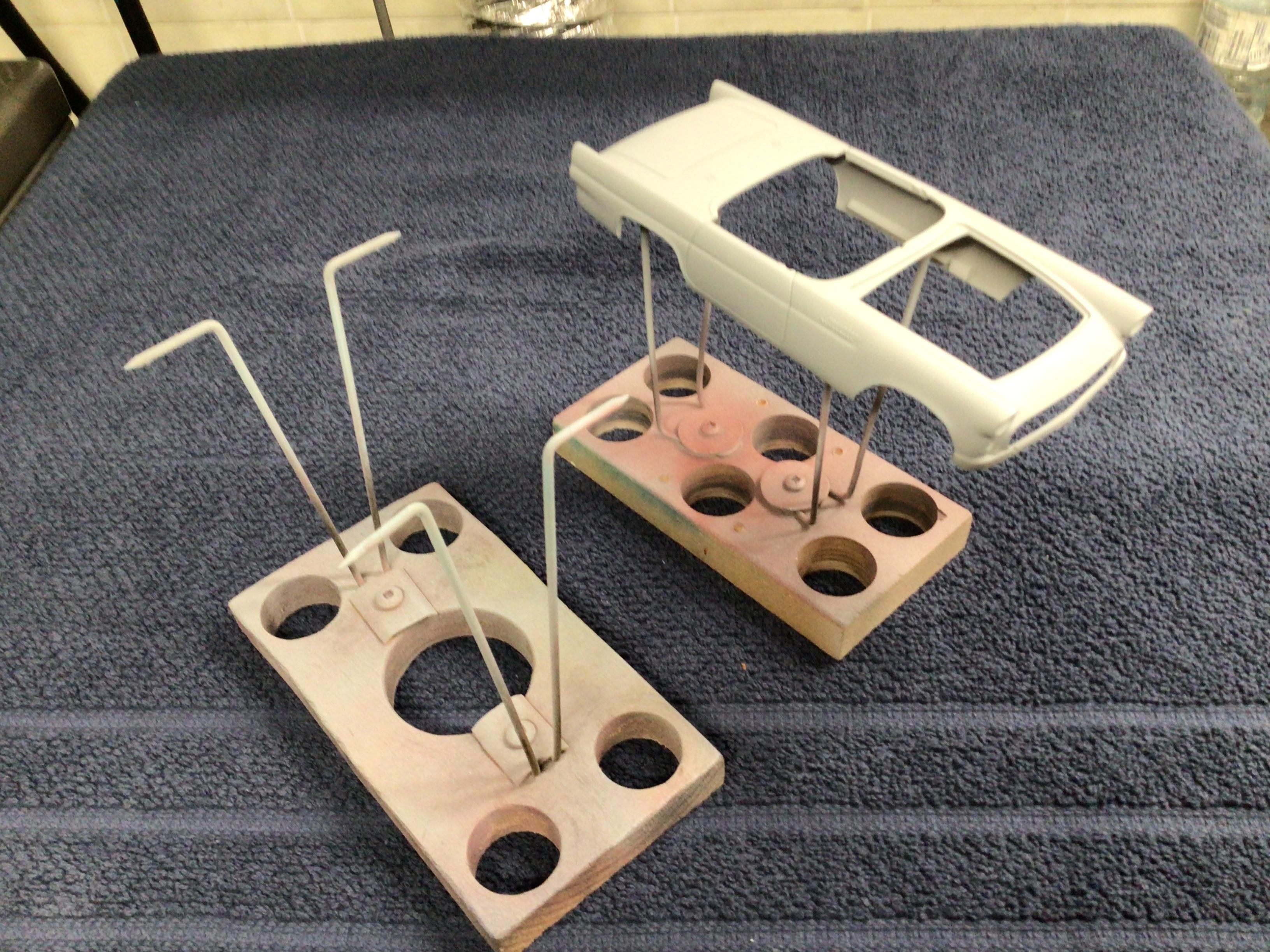

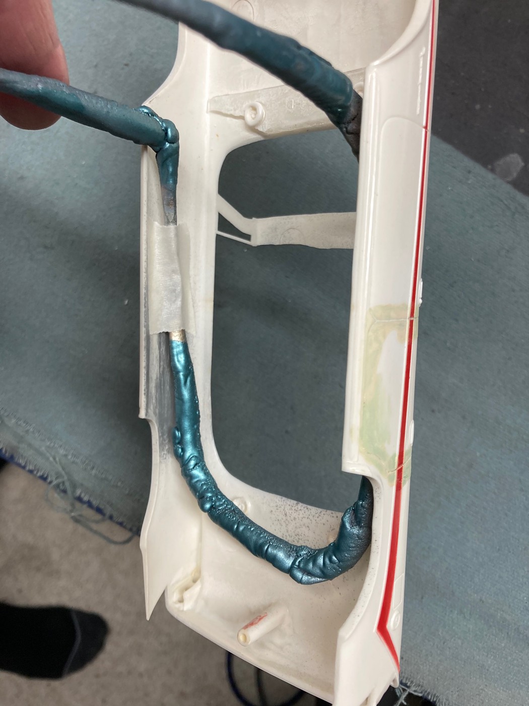

NOBLNG Posted September 24, 2023 Posted September 24, 2023 13 minutes ago, Milo said: So then how do you put it on a base to paint? Make yourself one of these out of a wire coat hanger and a block of wood.?
carrucha Posted September 24, 2023 Posted September 24, 2023 1 hour ago, NOBLNG said: Make yourself one of these out of a wire coat hanger and a block of wood.? I also made my own with a scrap piece of plywood and an old coat hanger. I covered the ends of the coat hanger with tape so it will not scratch the body. 1
Milo Posted September 24, 2023 Author Posted September 24, 2023 And once I make one of those kinda bases, how do I clean them afterwards? I heard that sometimes uncleaned paint flakes off into a paint job

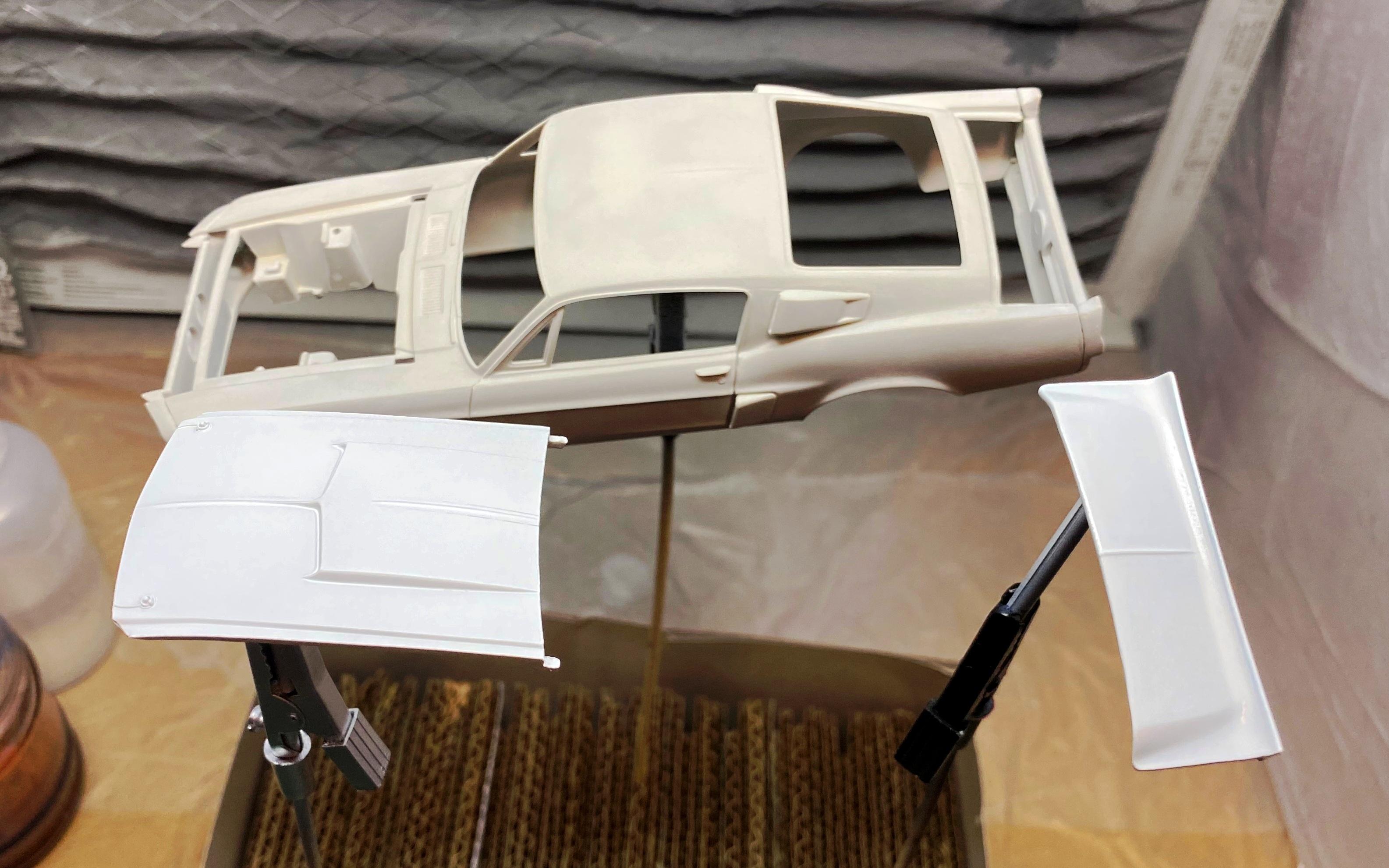

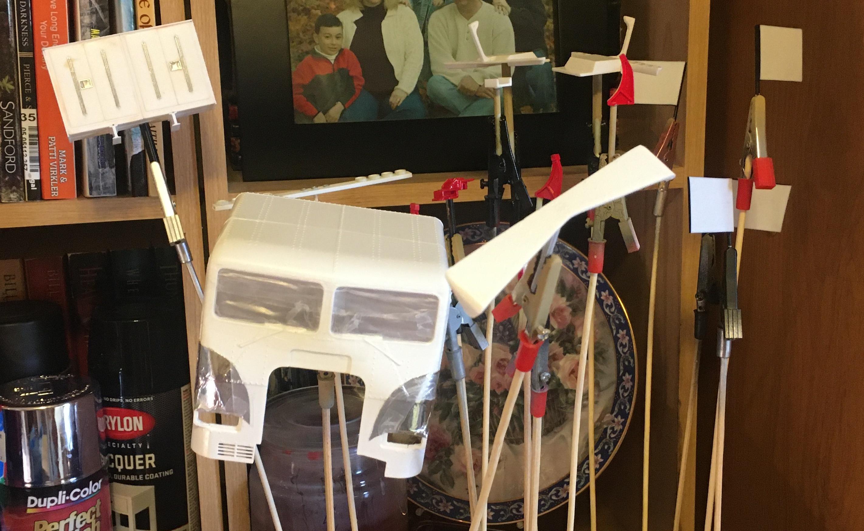

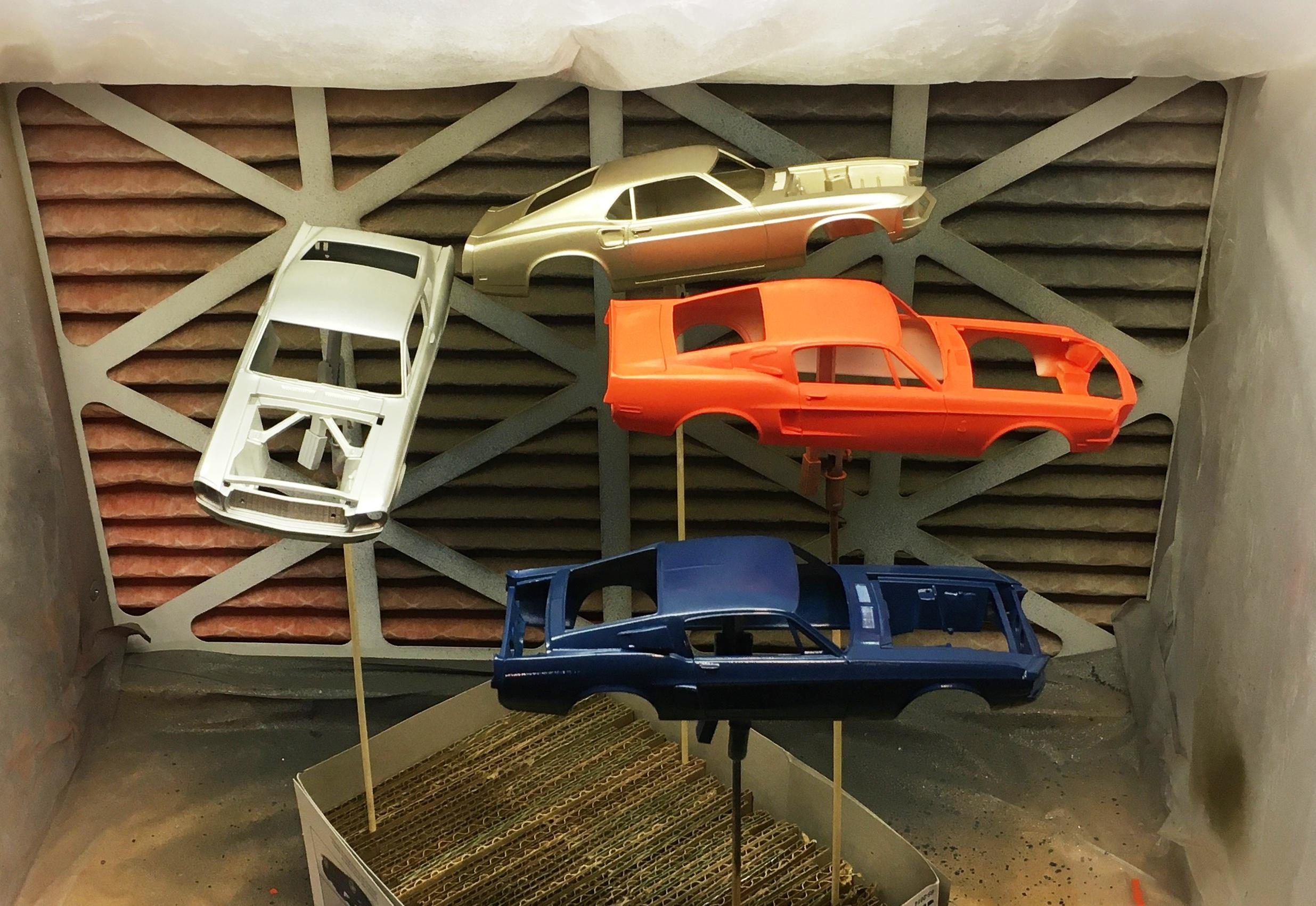

Bills72sj Posted September 25, 2023 Posted September 25, 2023 I glue a thick sprue piece with CA to the roof right where a dome light would go. I then hold the body with an alligator clip on a bamboo stick. It permits spraying and viewing every square inch of the body without obstruction. A model box full of corrugated strips glued together holds the item while spraying other parts. When done, the sprue piece snaps off cleanly where I can the touch up with interior paint or make a dome light.

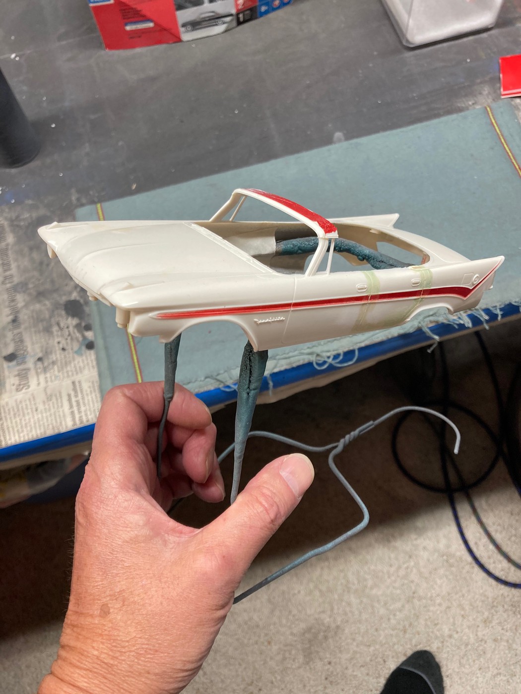

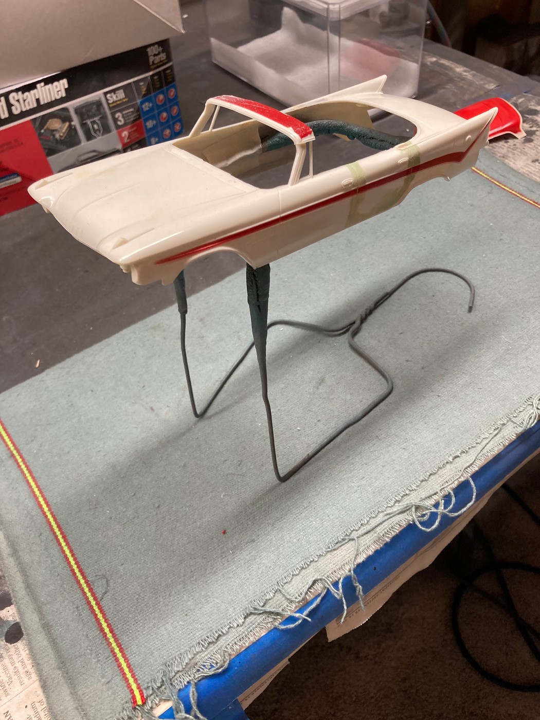

StevenGuthmiller Posted September 25, 2023 Posted September 25, 2023 Certainly doesn't require anything fancy. I bent this coat hanger in about 30 seconds 20 years ago and have used it for painting every body since. A couple of short pieces of tape on the inside of the body will hold it in place just fine. Steve 2
Fat Brian Posted September 25, 2023 Posted September 25, 2023 I second Steve's coat hanger method. As an added bonus you can hang the body upside down to minimize the chance of something landing on it while it's drying. 1
