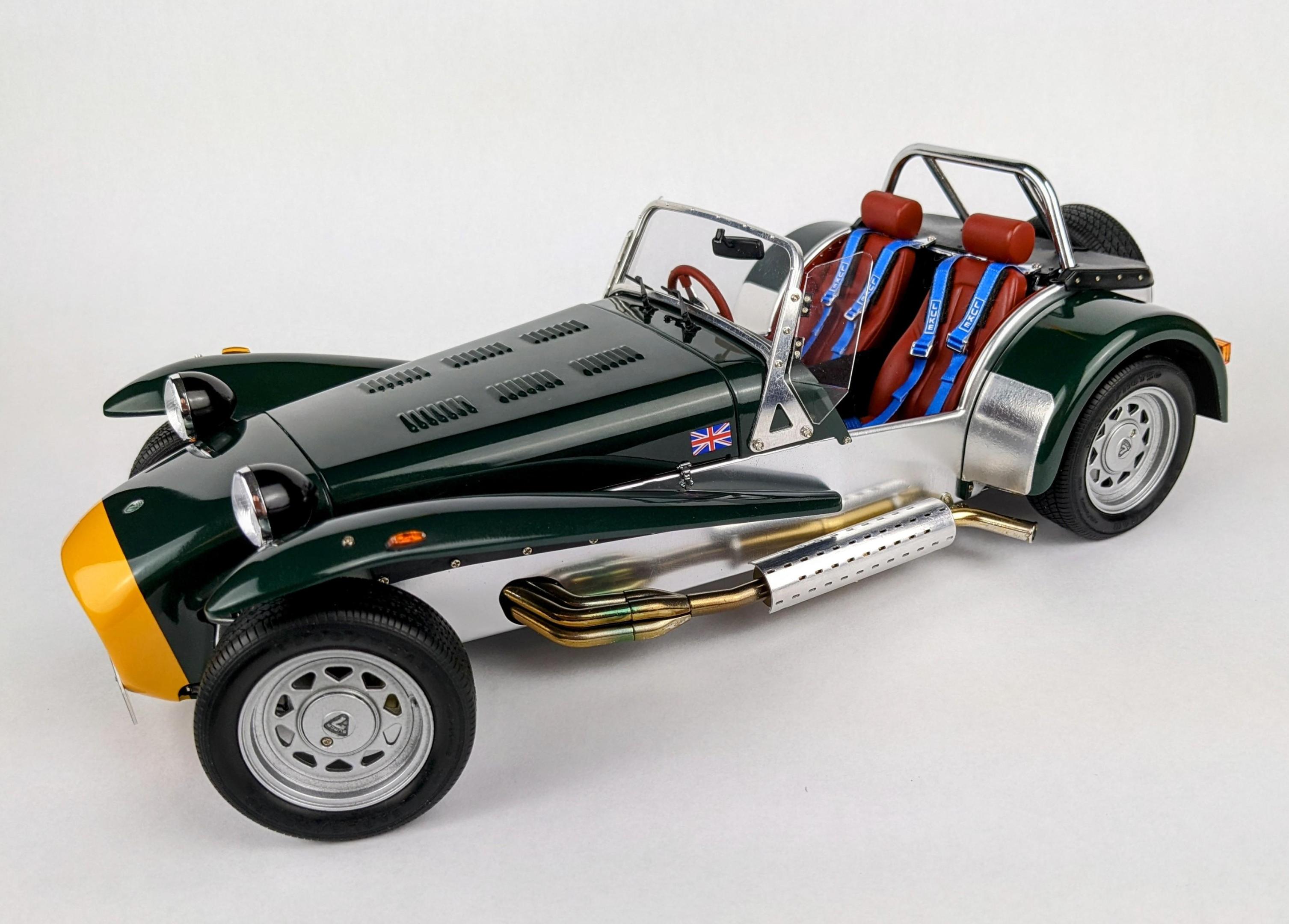

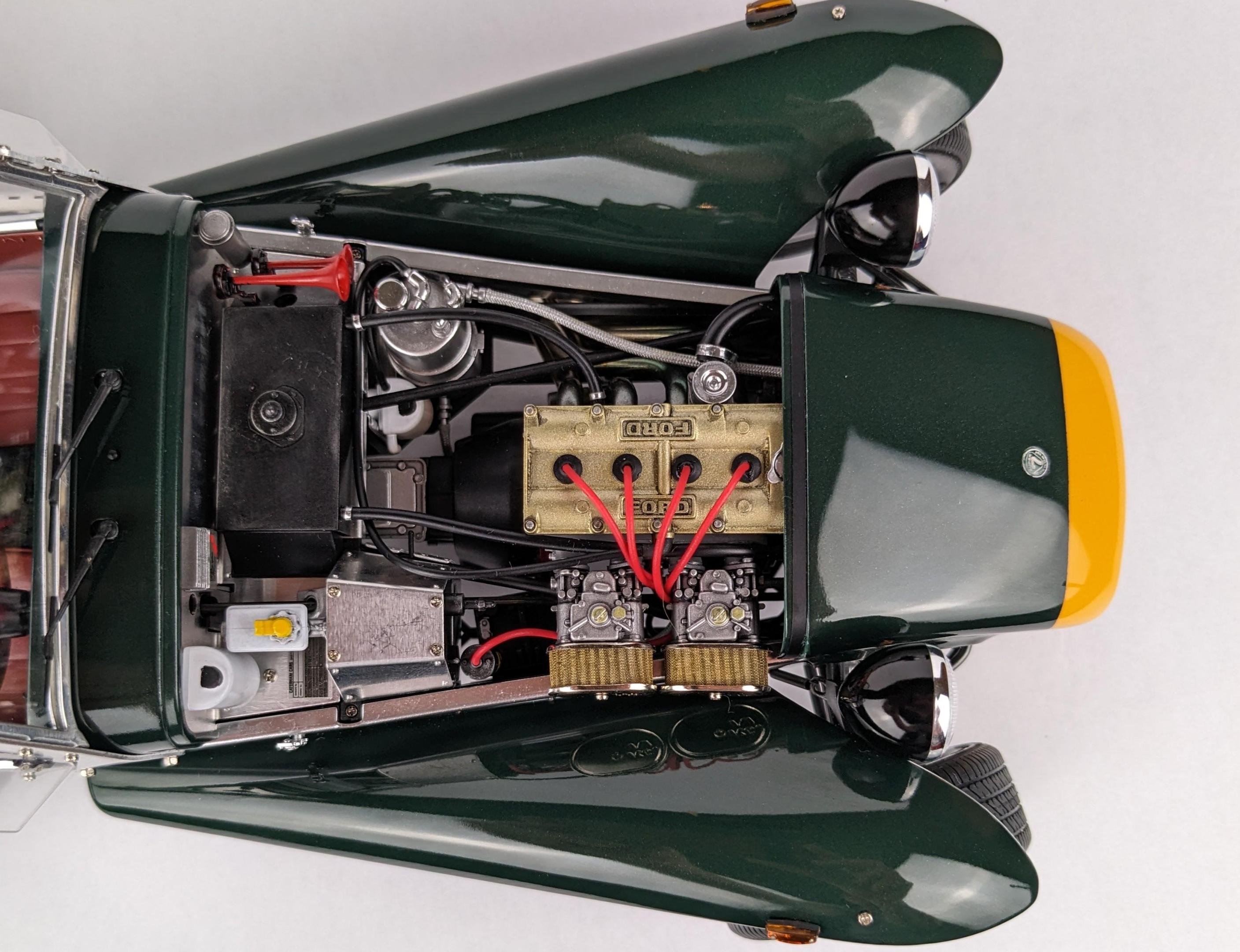

Love 'em. The green on this Caterham 7 was done in their Bentley Racing Green. I haven't tried their 2k clear though, this was Tamiya lacquer clear with Mr. Leveling Thinner. Primer was Tamiya grey straight from the rattle can. You can see how fine the flakes are, especially in the second pic.

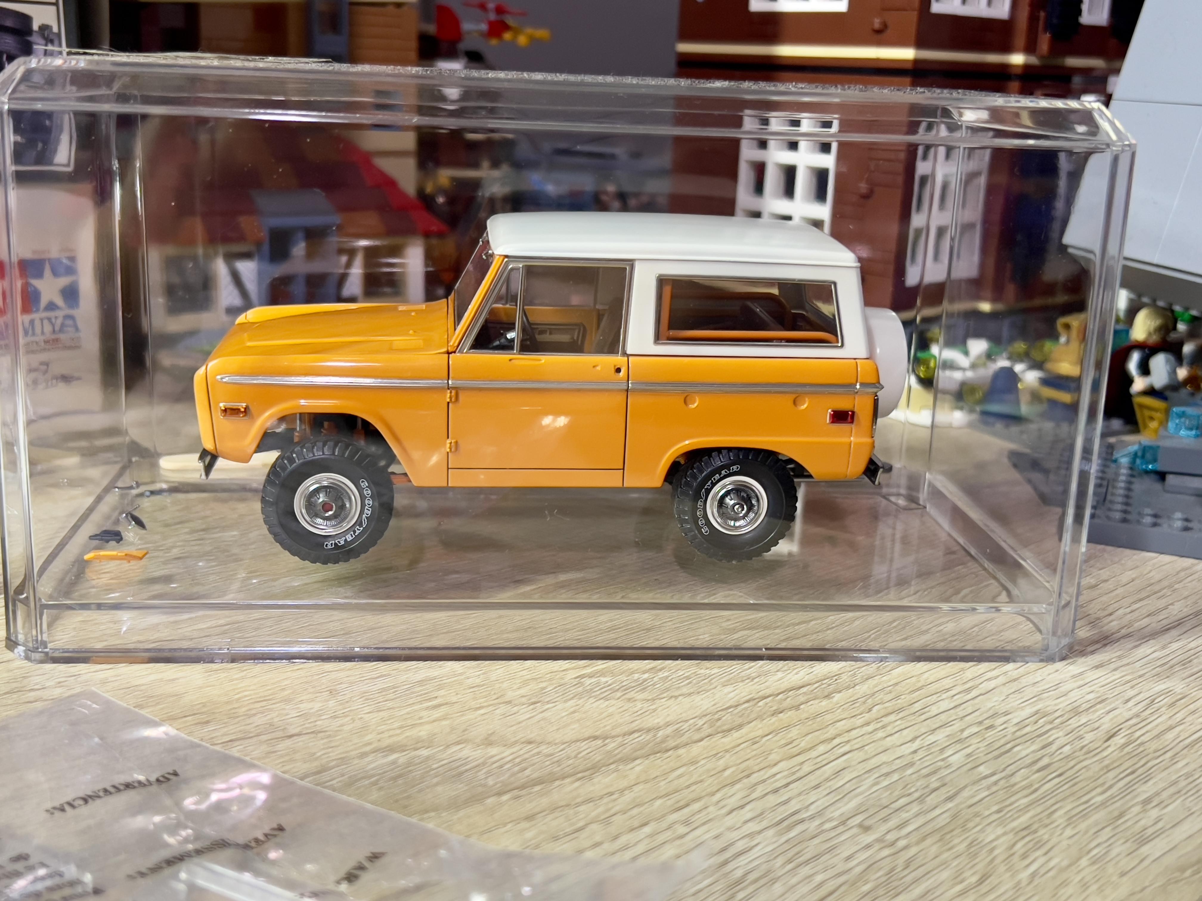

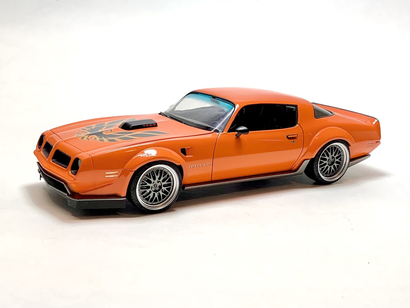

There good 2 part paints meaning you need a clear. There in the list of great automotive paints such as gravity colors(Spain), scalefinishes, MCW to name a few. unfinished bronco done in grabber orange by splash paints.
Edited by Dpate
2074315936_PXL_20230503_2132306592.thumb.jpg.a1e18aeb2b228359266ad979551f7599.jpgPXL_20230503_213512466.thumb.jpg.428260eecc20c1ea5584078f2e5dbbd1.jpg
That’s an outstanding looking build

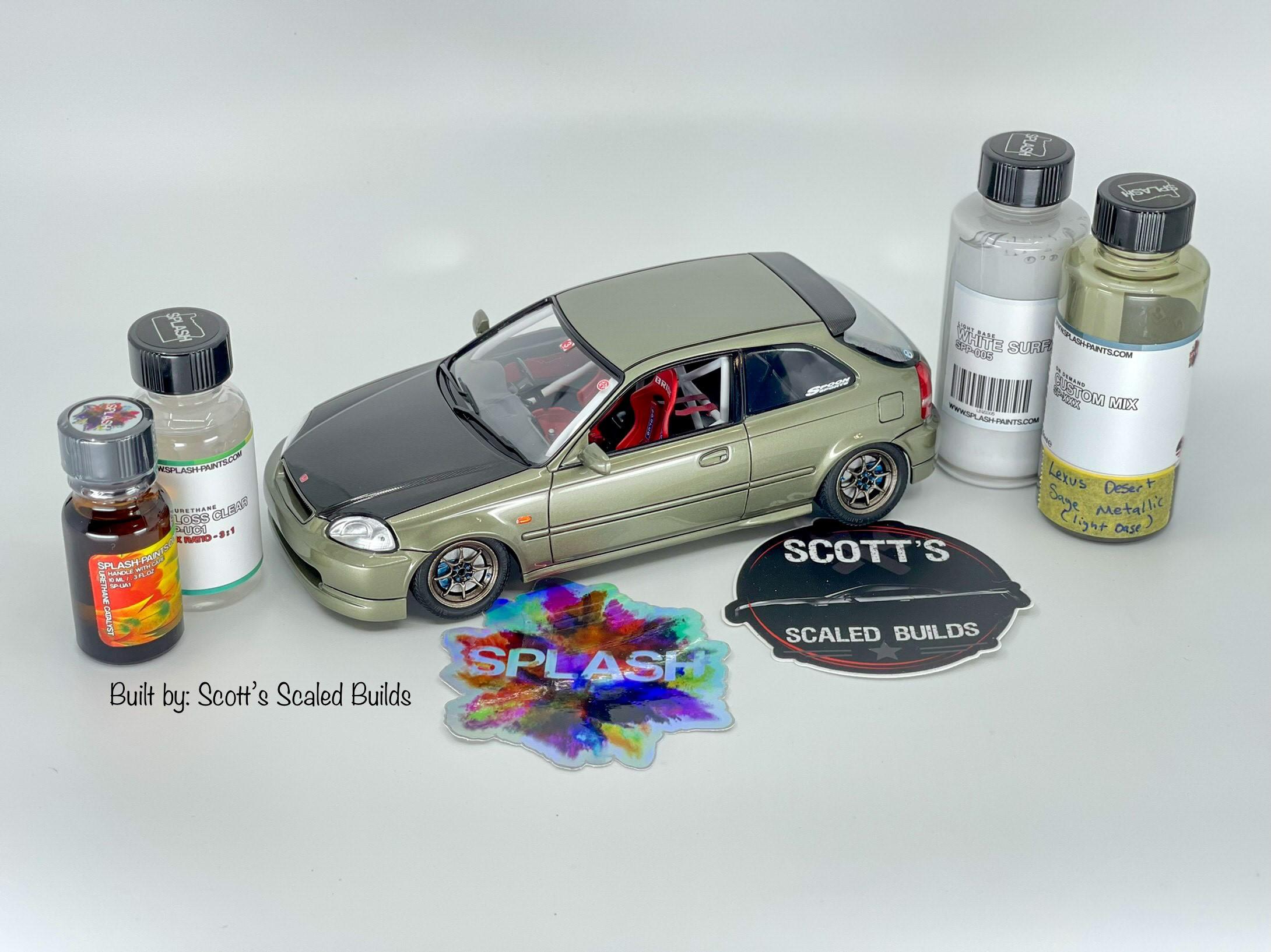

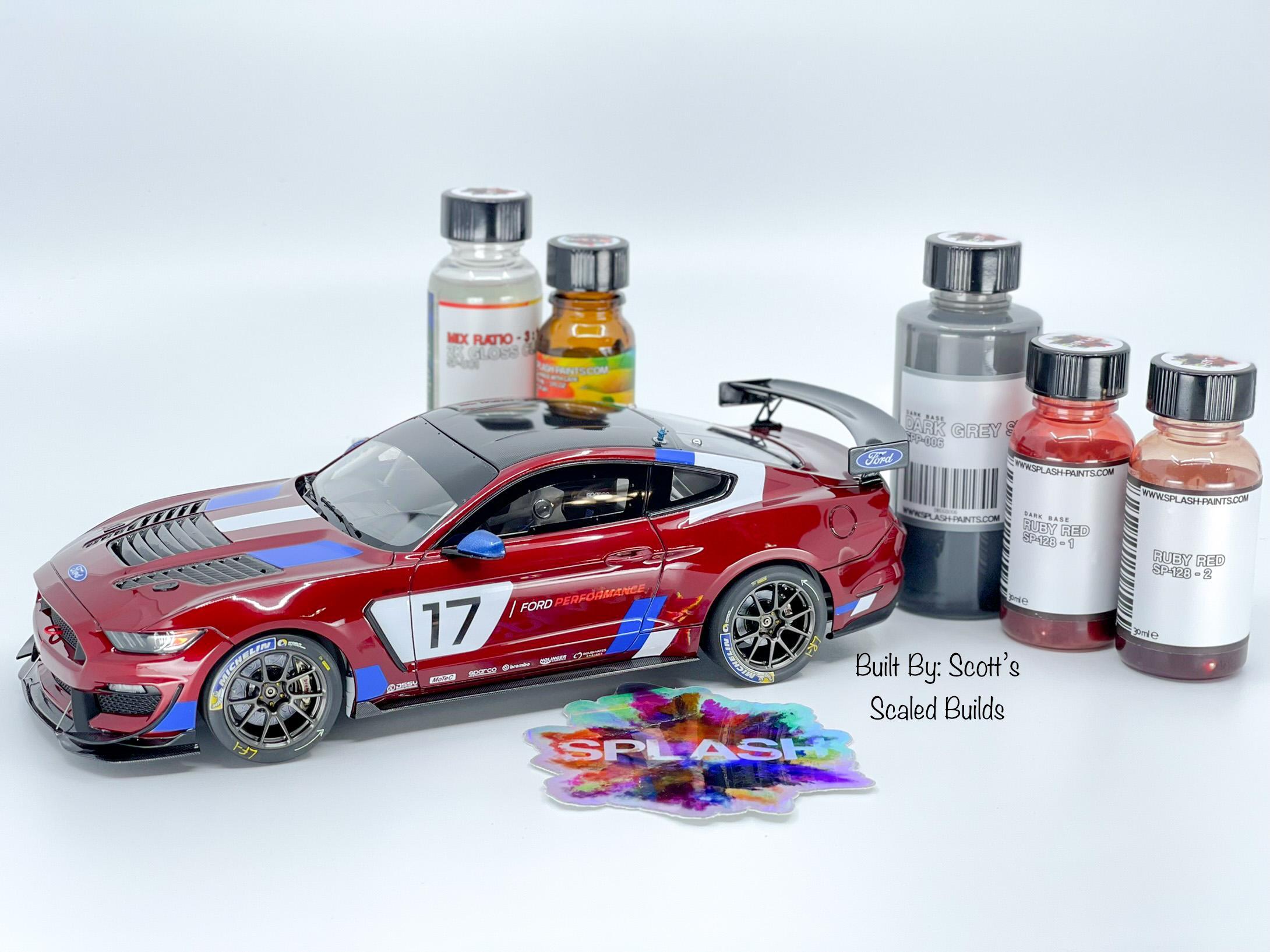

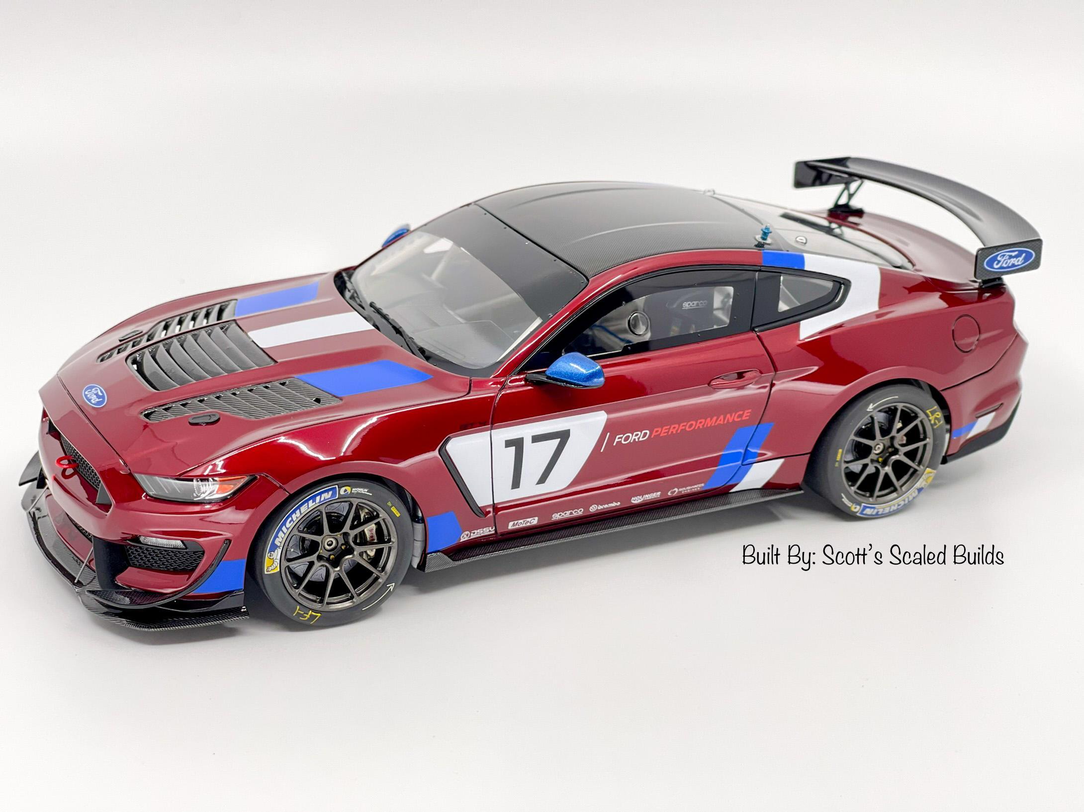

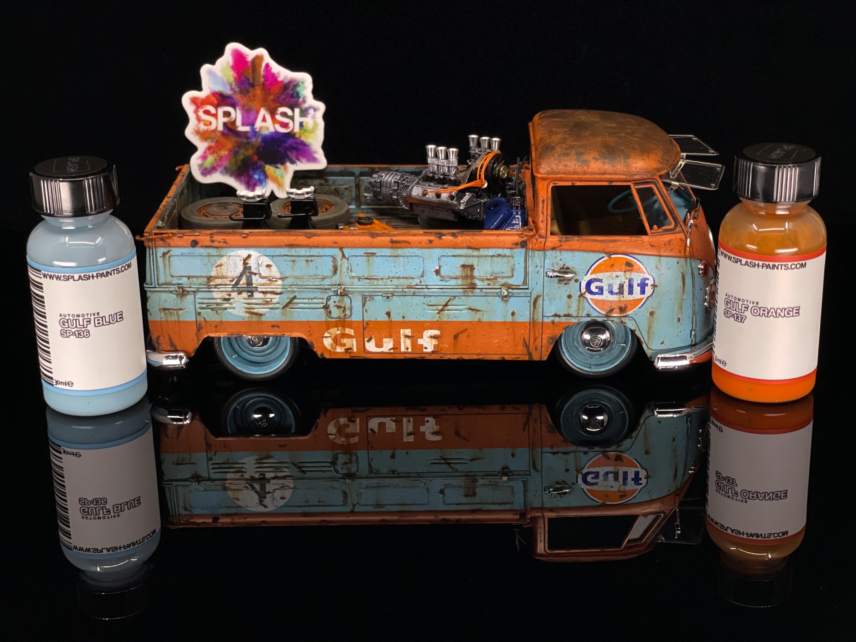

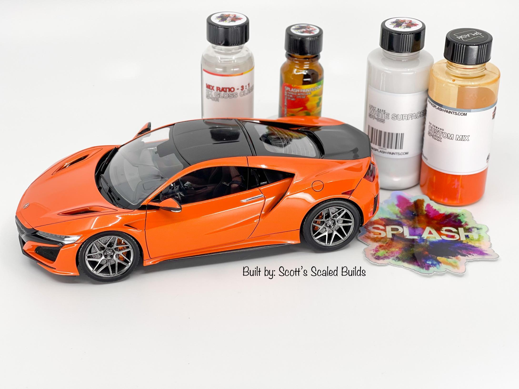

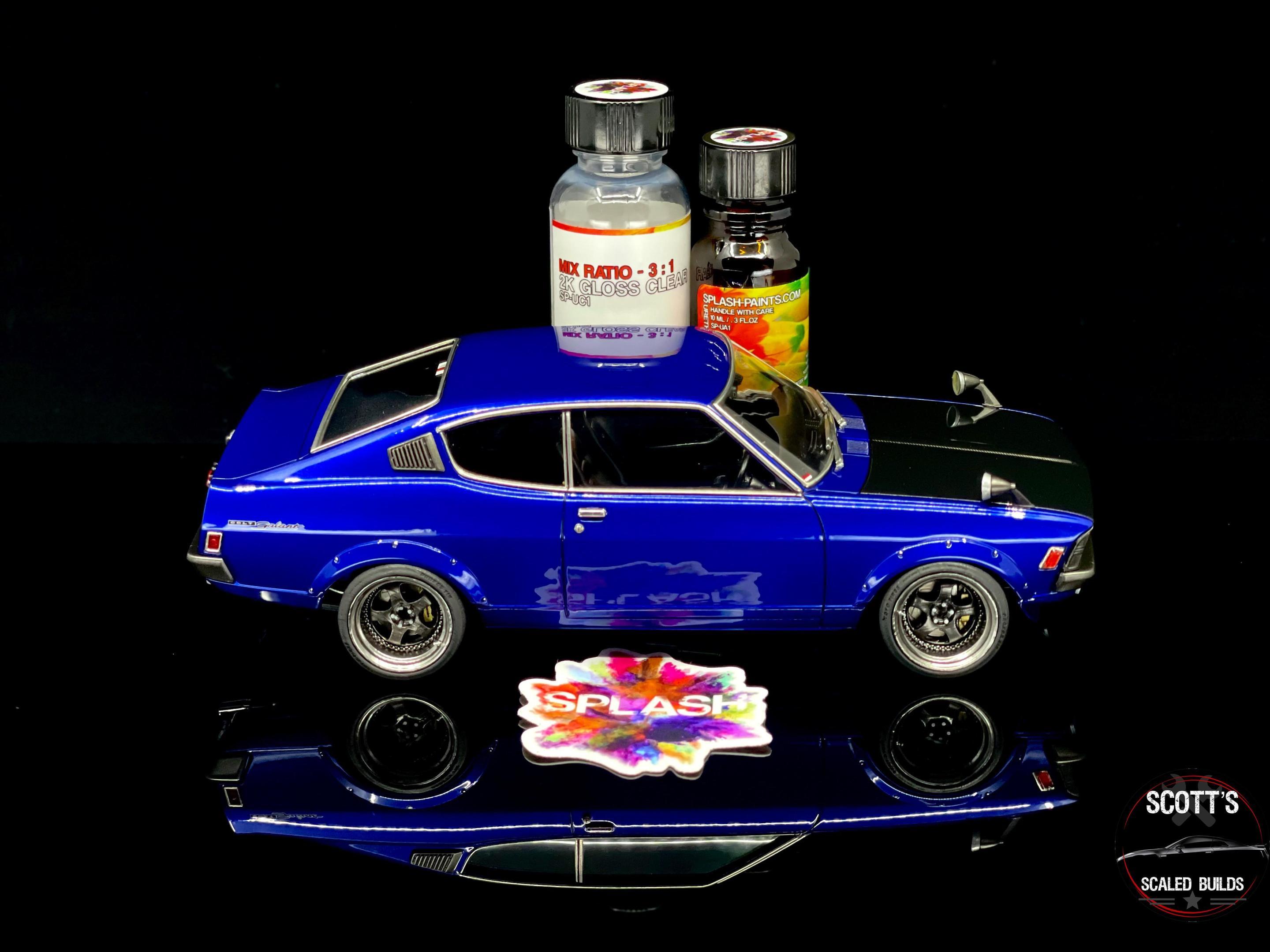

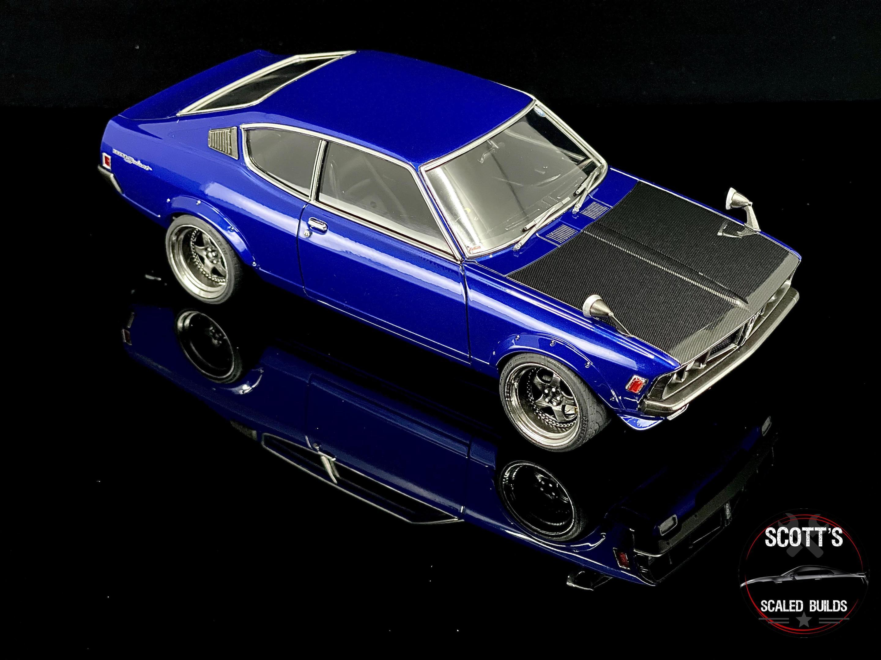

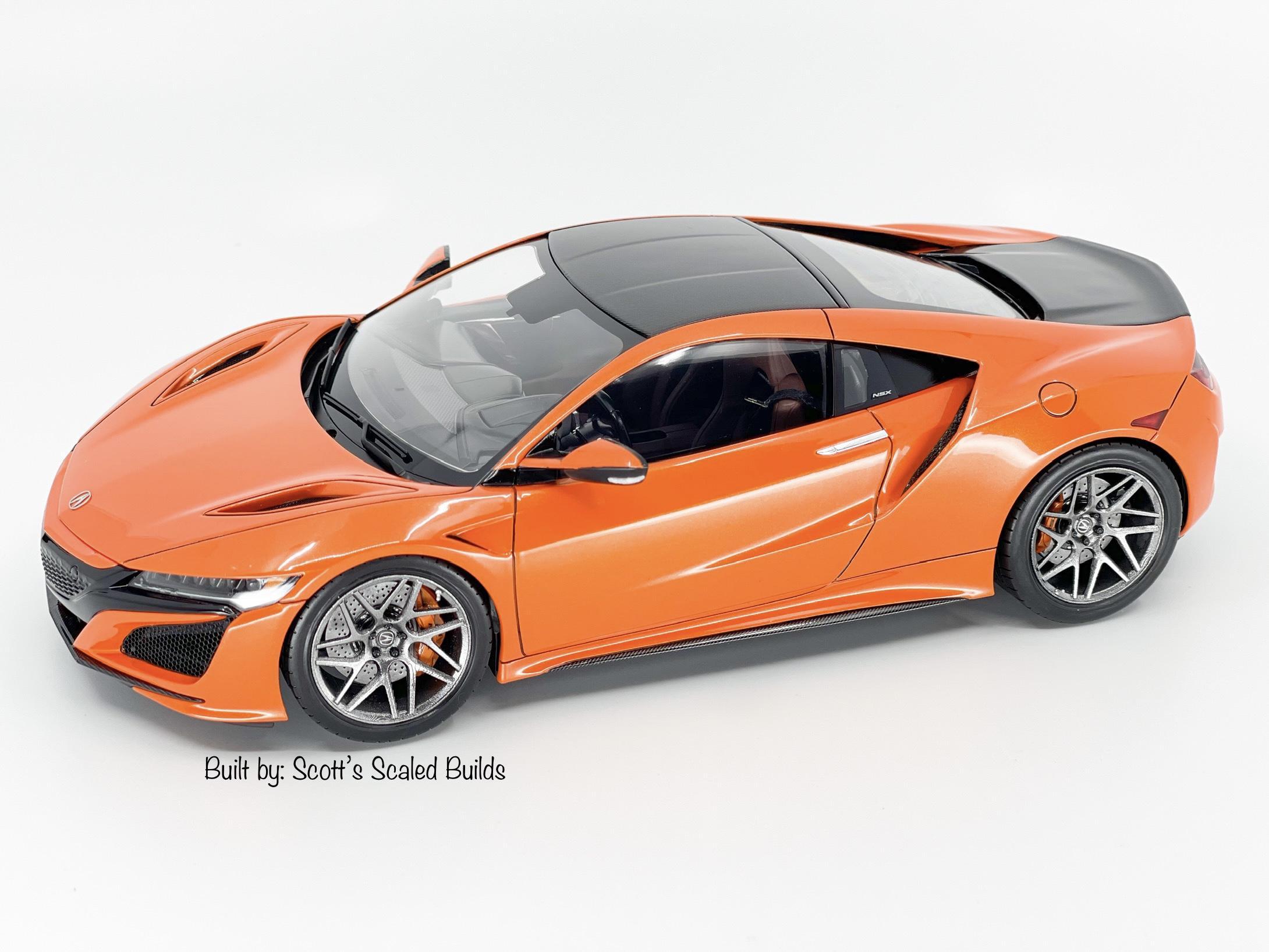

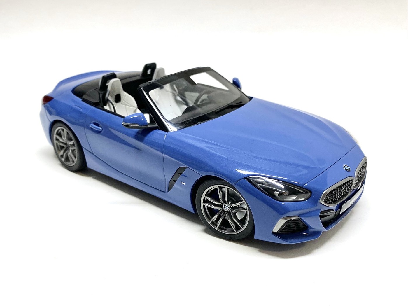

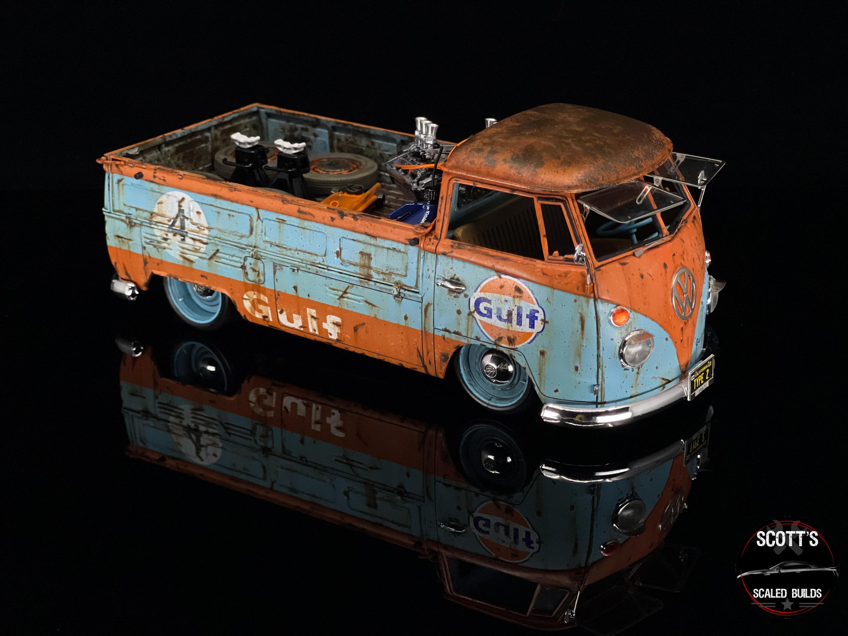

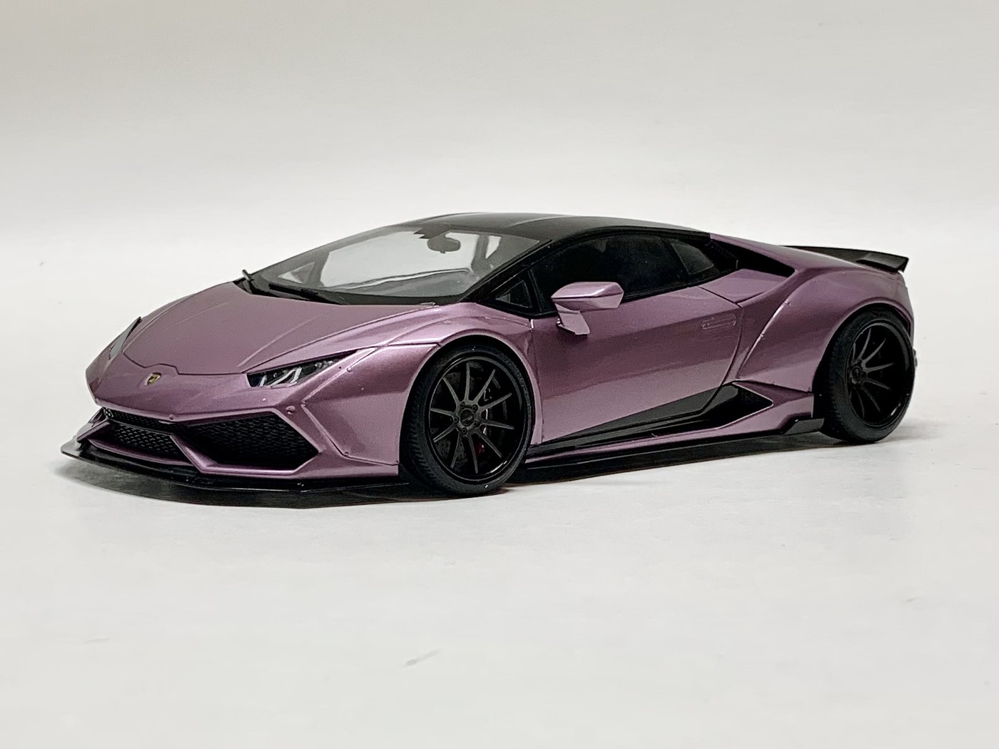

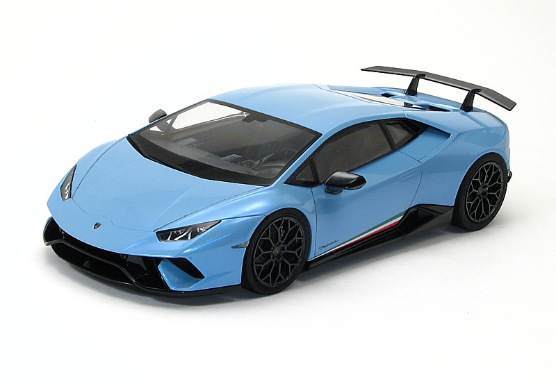

Splash Paints has some awesome colors, and quality of paint.  Their clear coat is extremely easy to use and super nice and if sprayed correctly, lay down smooth with no wet sanding/polishing needed.  Their paints are solvent based as stated, and are base coat clear coat. They can also mix custom colors if you provide a color code.
The flakes in metallic paints are scaled very fine and don't look oversized unlike some other makers.
Here are some of my builds using splash color and clear...as well as some of them on Splash's website.
