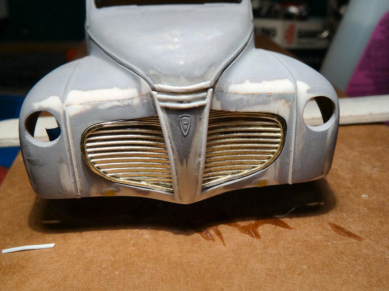

I'm actually sitting here now working on the Coupe and getting aggravated with the front end. Took a day off from work as I need to take the dogs to the vet so I'm putting in some bench time while the snow comes down outside. The more I look at it the more I see it needs work. Started by filling in the cutouts for the bumper brackets as I'm eliminating the front bumper on this one. Which that part is easy.
Then I put the hood on and looking at the alignment of everything the gap between the hood and the grill top are so uneven.
Next I removed all the trim and am in the process of adding the trim back with some .040 half round as you did. That is in the process of drying right now so I can't grab a pic.
I pulled out the grill and put it in place before I attached the vertical trim and it appears to me that the trim will actually have to overlap the grill a bit.

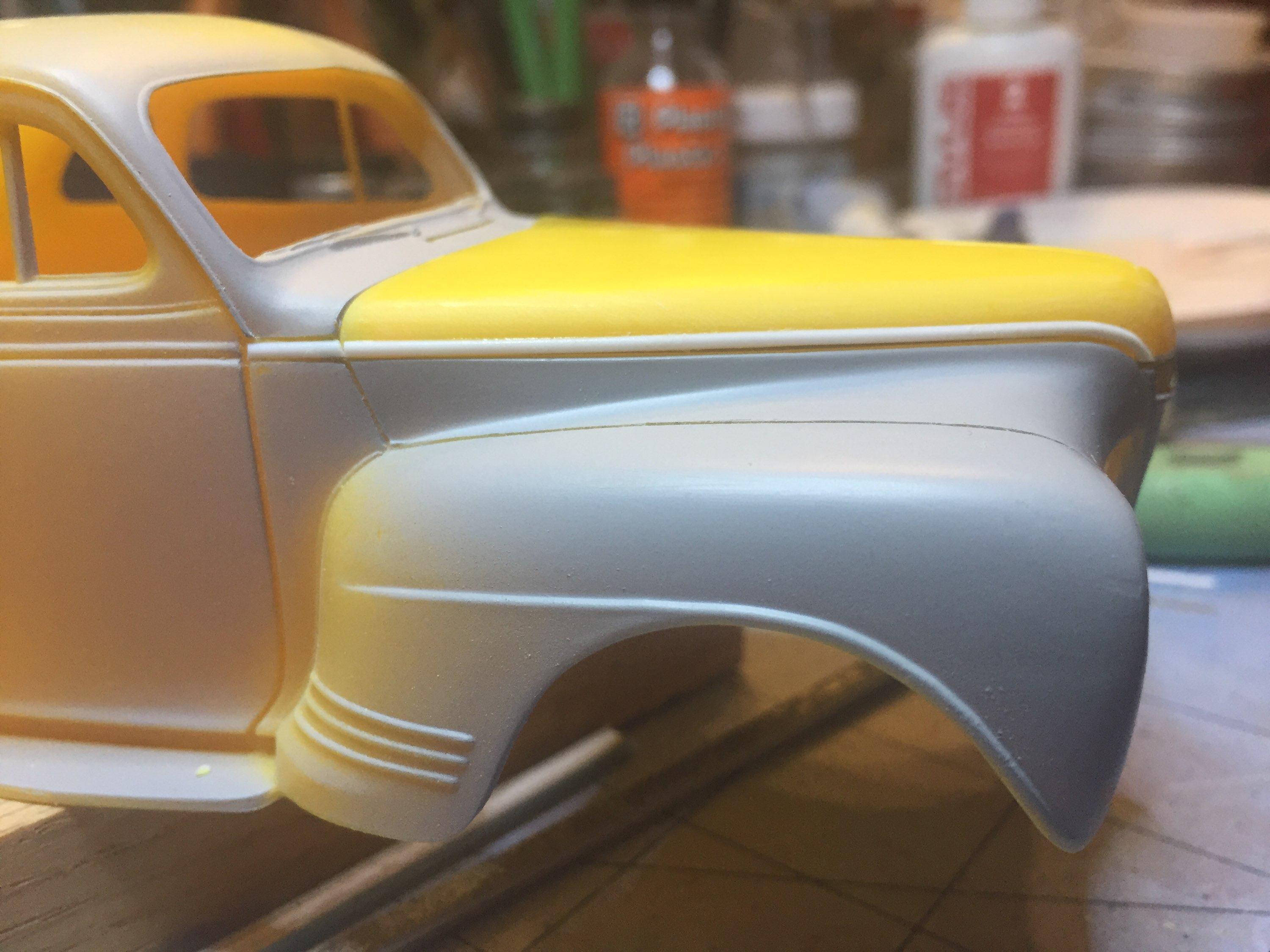

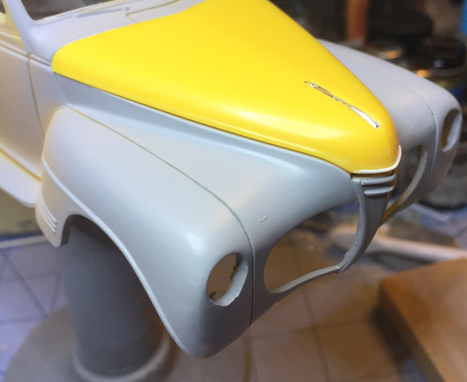

I did a bit more today on the "dent" I created and some other minor gaffs and got some primer on it. Thanks for your input, Len, I'm sure the others here are interested in what you are doing as well.
IMG_5382.jpg.e543a1ec0135a3fefec69a2b94021ad4.jpgIMG_5383.jpg.b5065d6e20e0b0fab9a844b21201237c.jpgIMG_5384.jpg.c909160adec288354d59193bf7adc687.jpgIMG_5386.jpg.0340c2356d78e95354f3380d7baec19e.jpgIMG_5385.jpg.ef095a53eff665c9411a1122fb8003e1.jpg

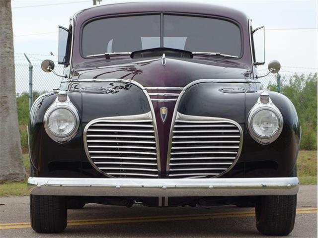

Here's what it's supposed to look like ?
If I try for a better fit of the hood, it will probably mean a re-do of the hood trim. I need to figure out exactly what is causing the bad fit.  I've got to think about this. ?

Yes, the hood is a pain. I filed away some of the bottom of the sides on the hood to get the nose to drop down a bit. But my hood is slightly warped and it wants to drift to the left rather then sit where it belongs. Probably going to need to fabricate some type of hinges to hold it in place as it's never going to sit in the right place on it's own.
This is where I'm at right now. The glue is still drying so I have to let it sit overnight before I can clean this up and shoot some primer to get a proper look at it.

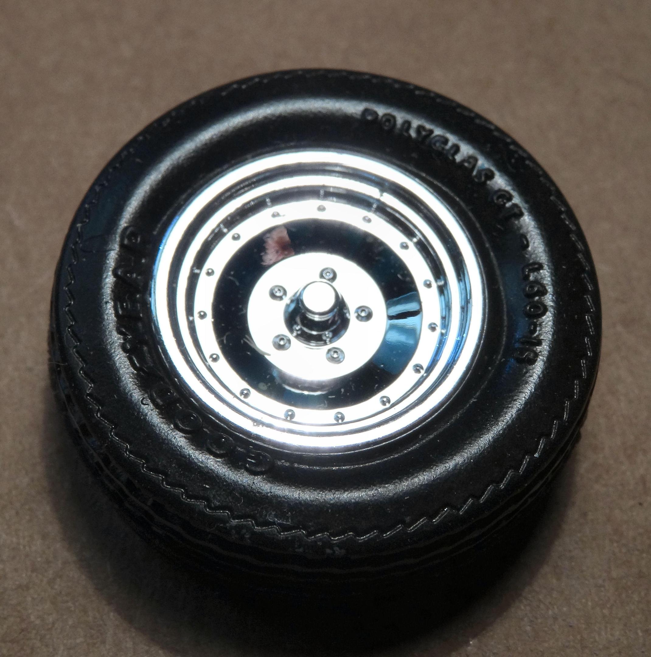

Did the"Rocker" have the same crappy custom wheels as the current $13 Ollie's kits?
The sealed one in the attic is the original issue. Yes, I'm well aware you're not going to get a hot meal at the local diner by selling off one of these kits. ?
I was thinking of putting the BMF over a bead. Tried to go out this morning and get some round stock but Hobby Lobby didn't have anything suitable, unless I wanted a 1/25th scale baseball bat. Gonna have to order some online. Not sure of the size, probably .040".
Here is a shot of the wheel from the Rocker kit.

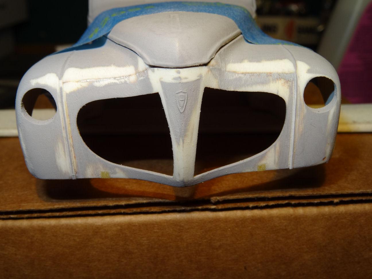

I think maybe the easiest thing to do in order to get the trim to meet without a gap is to do the nose trim over and extend it a bit rather than mess with the hood. The look will be better with a closed hood. I should set the hood up with magnets first, though, so it always lines up. When the hood is off, the trim will be seen to extend a bit but hey, you're the only ones who will know ?

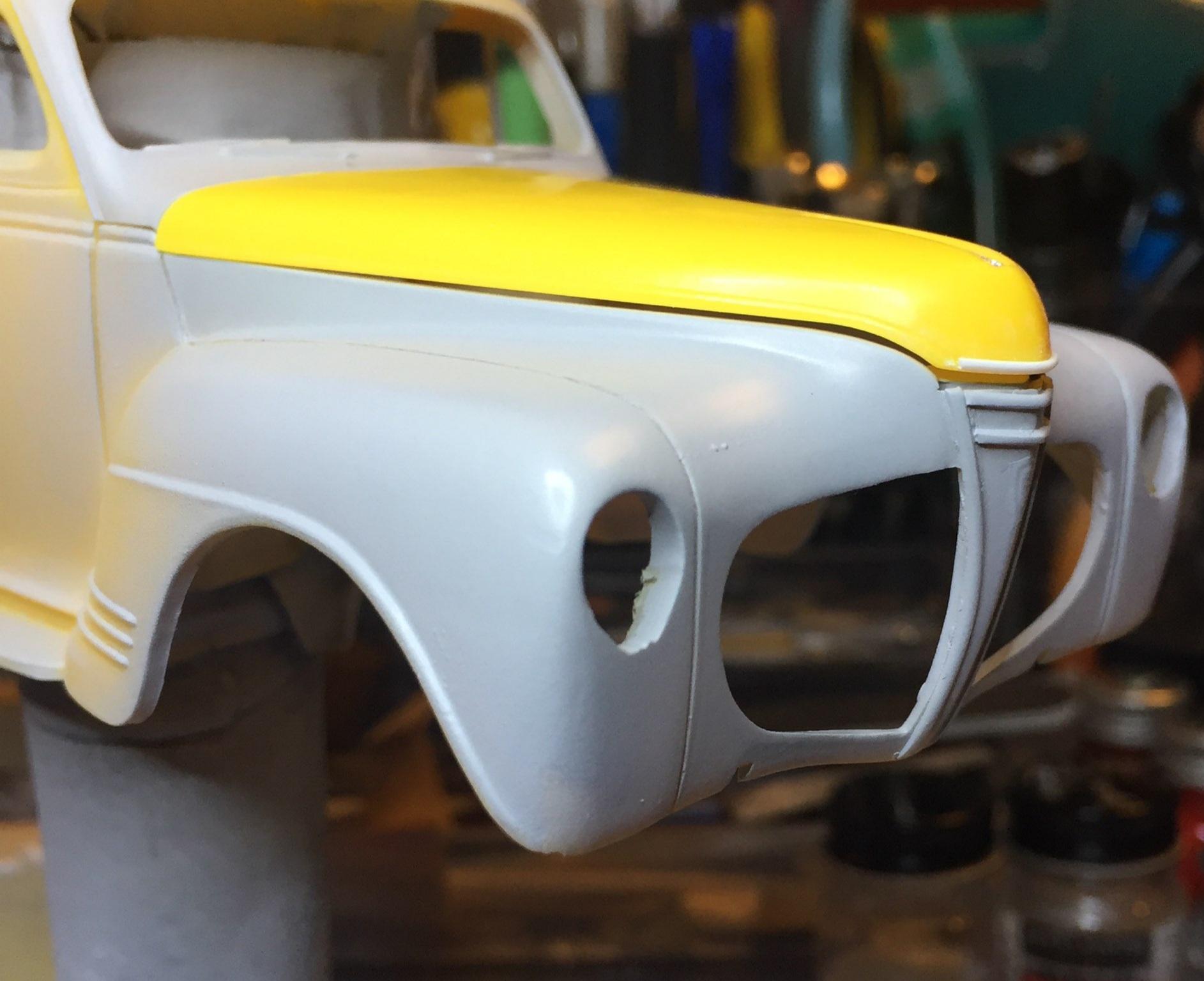

The first photo shows the poorly shaped hood. I would like to fix that. The second photo speaks for itself. I gotta fix that (again) ?
IMG_5384.jpg.ea2067dc9e28a2b6bdd6b73abdcabc48.jpgIMG_5386.jpg.5adad0c1dc90296c96c3214ba7ac833f.jpg
Jim
It looks like you have the center trim bar right up at the top of the nose. It actually has a bit of body above the trim. Couldn't you just add a bit of body above the trim to close the gap?
That's a great shot of the 1:1 nose, Len.  The work you did on yours looks darn good. I would (and plan to) go with .020 but making it stick without melting it will require some finesse. I'm waiting for mine to get here. I'm not too sure about the BMF idea but I wouldn't tell you not to try it. I may paint the car black simply to avoid the problem. The wheels provided in the Rocker kit are a far sight better than the ones in the current kit (why would they do that?)

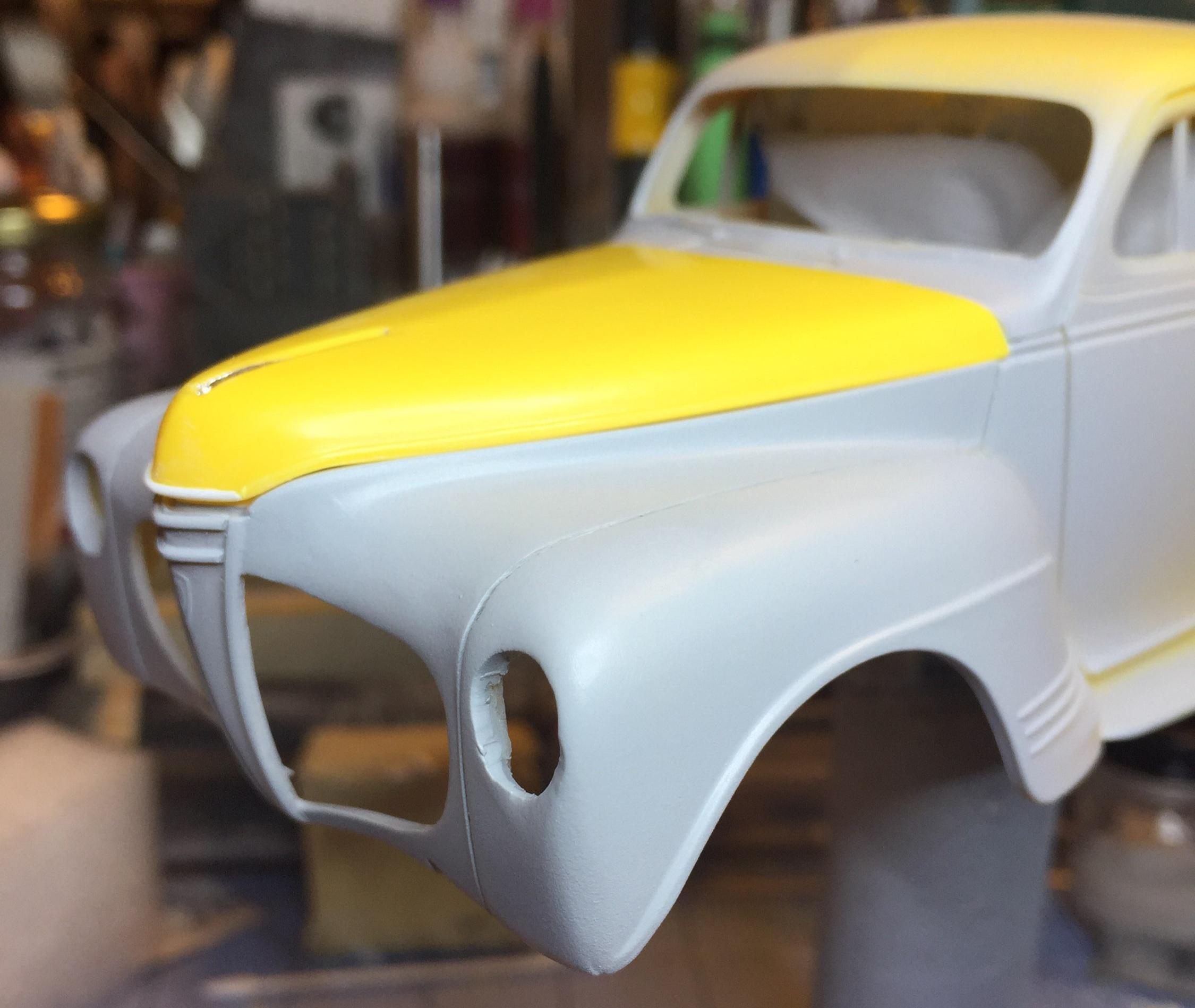

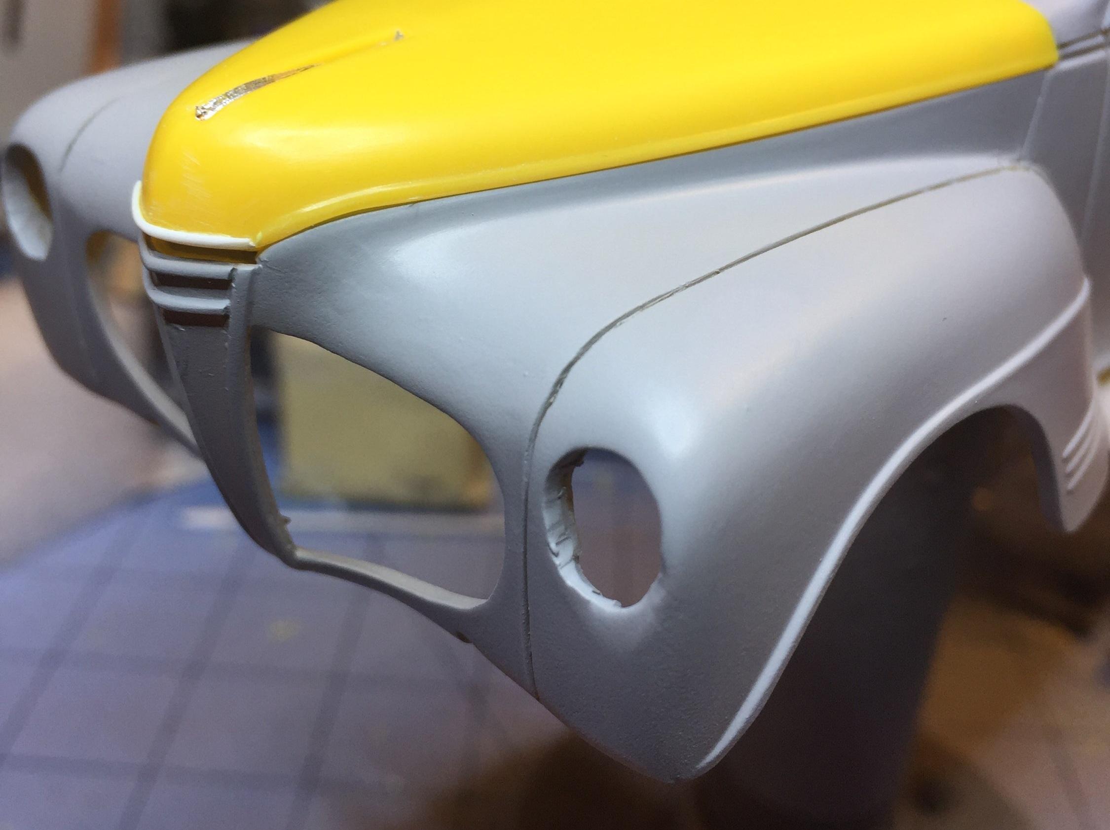

Quick update. Decided to attack the hood issues. Started by removing the molded-in trim and continued to remove material along both sides in order to facilitate adding new trim using .040 half round. I also removed the trim on the cowl and replaced it because I want the hood trim and the cowl trim to line up better. Everything I do creates another issue to resolve. Ya gotta love it.
I removed the small top nose trim bar because i will need to relocate it slightly. I also added some sheet stock to the bottom of the hood peak. This seemed like an easy way to get things a bit tighter. I discovered that my hood was slightly twisted and some tweaking was in order. Before I do any more, though, I will be setting up the magnets that will keep the hood closed and in alignment ( I hope.) Thanks for keeping up!  ?
