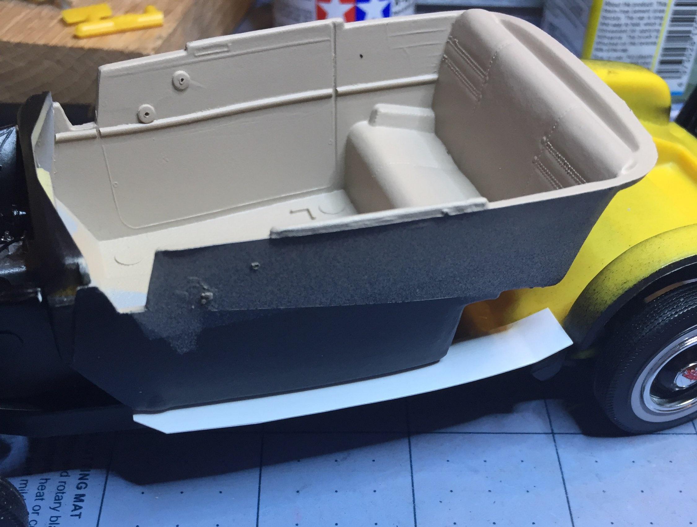

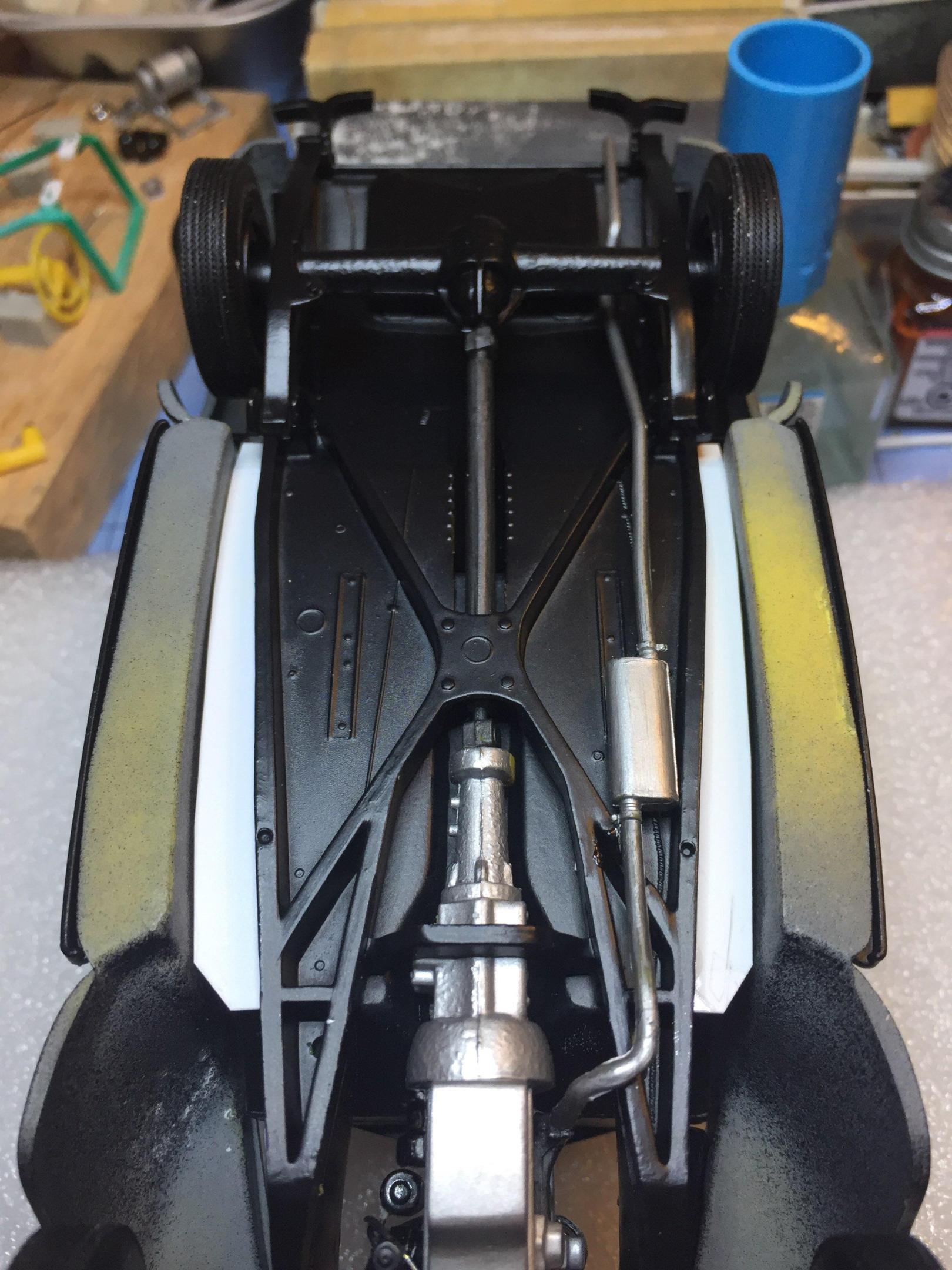

customline Posted March 9, 2024 Author Posted March 9, 2024 I can not understand why AMT didn't give this elderly mopup a full floor. Maybe they figured because the cowl vent wouldn't open they needed to have a way for fresh air to enter the cabin. I dunno ?, but it looks stupid so I figured I would at least try to close it up. By the way, it seems it was not the tyranny that was keeping the tub from bottoming out on the chassis. First it was the inner fender panels. Having trimmed those, I thought it was the tyranny so I flattened the top of it but to no avail. It turned out to be some raised circles on each corner; remnants of the injection process, apparently. The tub settled down after I shaved them off (first photo- circled). To close up the bi-lateraI abysses, I used .015 evergreen glued to the top of the chassis. It will be painted black to match. A builder could improve on this idea but, frankly, I'm done. I think y'all know how I feel about this kit by now. Thanks for your understanding ? 1
FoMoCo66 Posted March 9, 2024 Posted March 9, 2024 Nice I should do that to my mpc 67 vette that I'm working on but... whatever. Yours makes a world of difference it is 10 times worse on the 41 plymouth than the 67 vette to. Good job

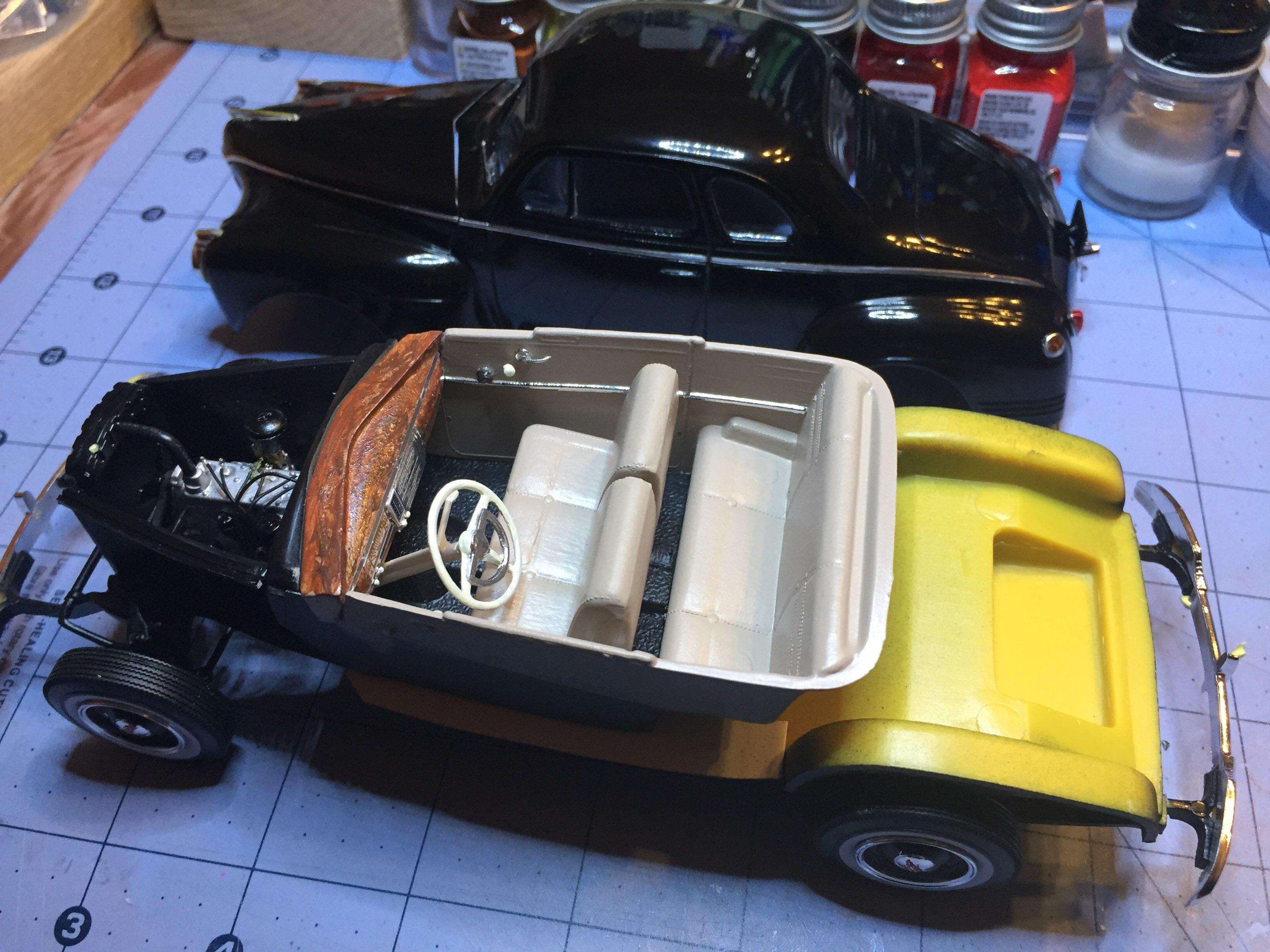

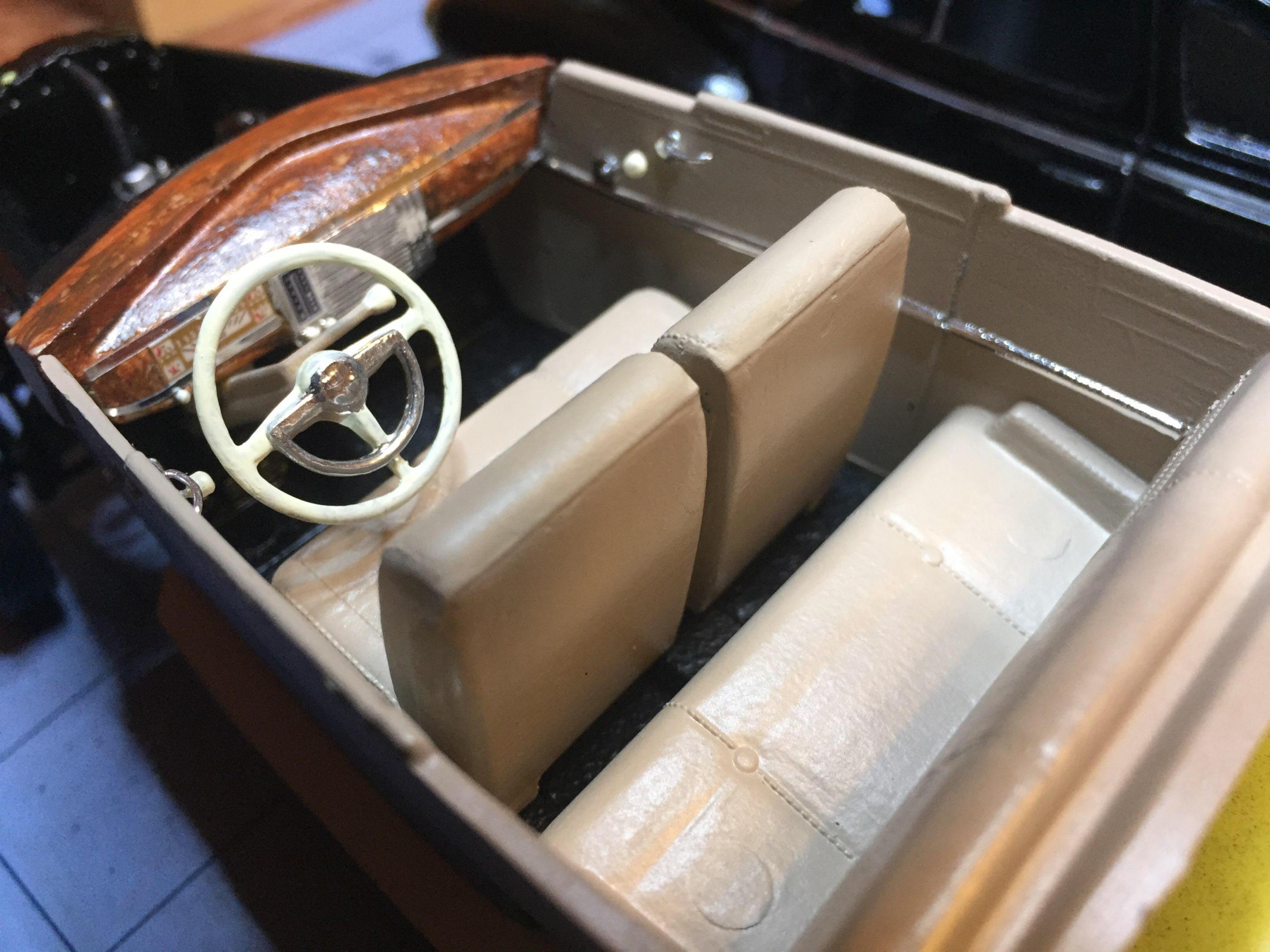

customline Posted March 12, 2024 Author Posted March 12, 2024 Ok...almost there....had a little trouble getting the body to sit all the way down. Seemed like a typical dash/windshield thing. I dropped the dash down about 3/64" and that did the trick. I'm still playing with the rear splash pan. I glued it to the body twice now ?. I had to re-do the angle of the magnet on the hood nose because it was holding the rear of the hood up. Working on battery cables, etc....the bumpers are now in place...oh, I attempted a wood grain job on the dash...?....anyway, yes....go ahead, but it's staying. I gotta find a tutorial on you tube for that ?. Thanks for looking and having a good laugh. it looks like what those guys did to Christine ??? 2

LennyB Posted March 12, 2024 Posted March 12, 2024 Be glad you didn't pick a woody and have to woodgrain the whole back of the car?
David G. Posted March 12, 2024 Posted March 12, 2024 It looks like the paint turned out nicely Jim. The interior looks pretty good too. You expressed some interest in getting information on creating a woodgrain effect. I have a little information I can share. For these I started with a base of TS-46 Tamiya Light Sand, I then used thin washes of Tamiya Flat Earth and NATO Brown acrylics letting them pool a bit here and there. For the dash I started with the same technique but before the Flat Earth and NATO brown washes I drew some light thin lines and patches with black, brown and red Sharpies... very sparingly! I then used rubbing alcohol on cotton swabs to thin and soften the Sharpie lines and patches blending them a bit. After that dried, I followed up with some very thin washes of NATO Brown Flat Earth and black acrylics. Very thin, very light. Subtlety is the key. Once all that dried, a nice coat of Tamiya sprayed from a can gave it all a nice shine. It took me quite a few failures to be able to get good results. I even messed up the service trays the first time around and what you're seeing is my second attempt for those. I hope you find these unsolicited pointers helpful Jim. Of course, if you have any questions, please feel free to ask. David G. 3

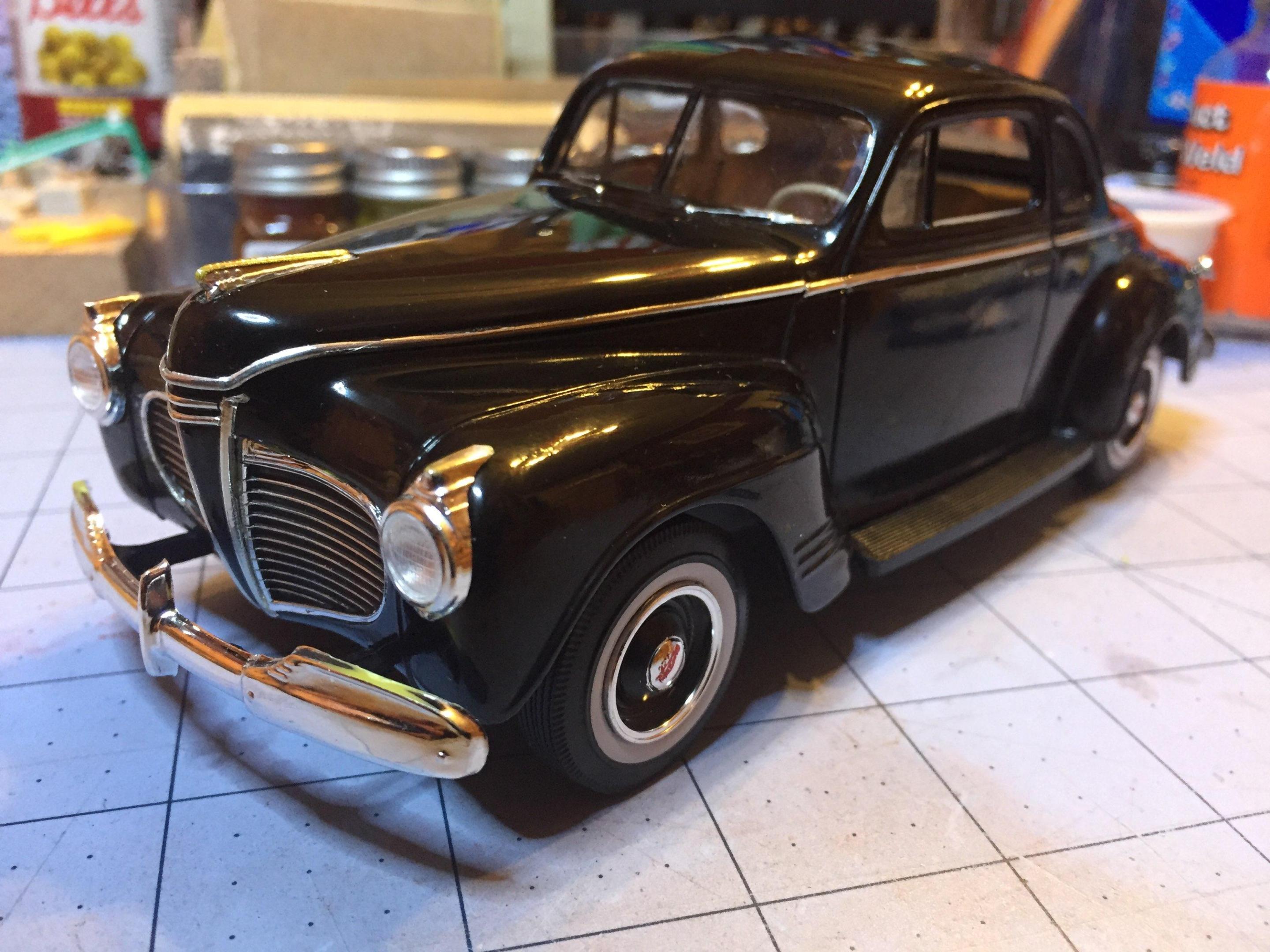

customline Posted March 12, 2024 Author Posted March 12, 2024 3 hours ago, NOBLNG said: It’s looking good Jim!?? I'm glad you think so, Greg! ?....I am so done with this ?. On a lighter note, I have several days of dry, warm weather in my immediate future and an untested, brand new Iwata waiting patiently for my enthusiasm to reach a high enough level to motivate me to take it for a spin! And no medical appointments! ?. 1

slusher Posted March 29, 2024 Posted March 29, 2024 eeReally impressive work, Jim! I knew you would make a beautiful model out of it.!
