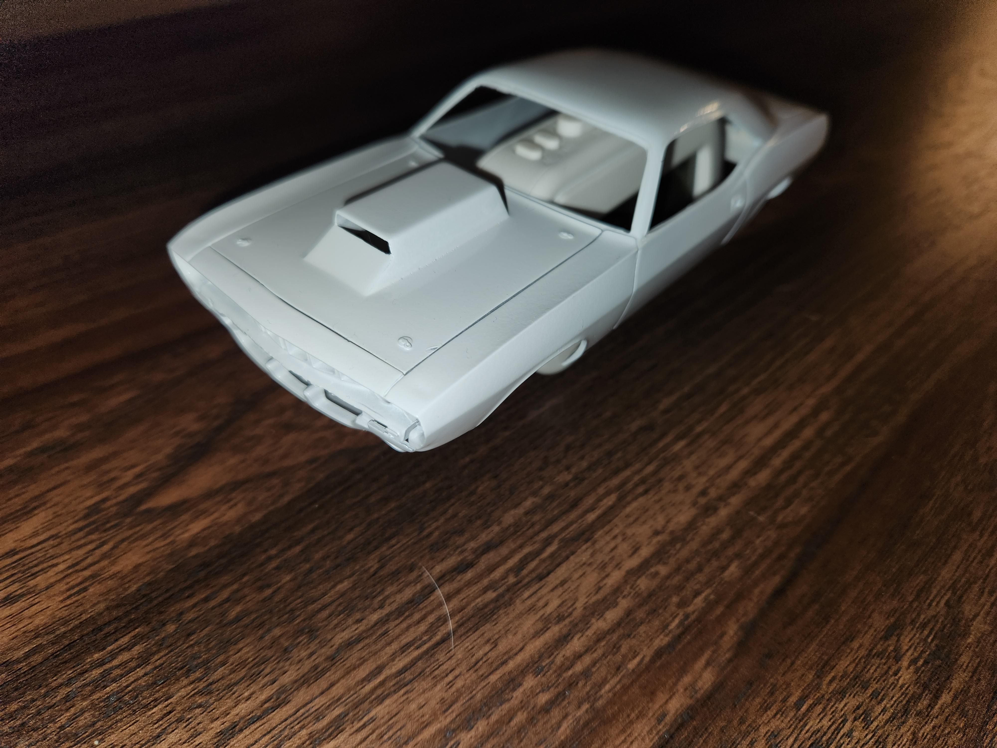

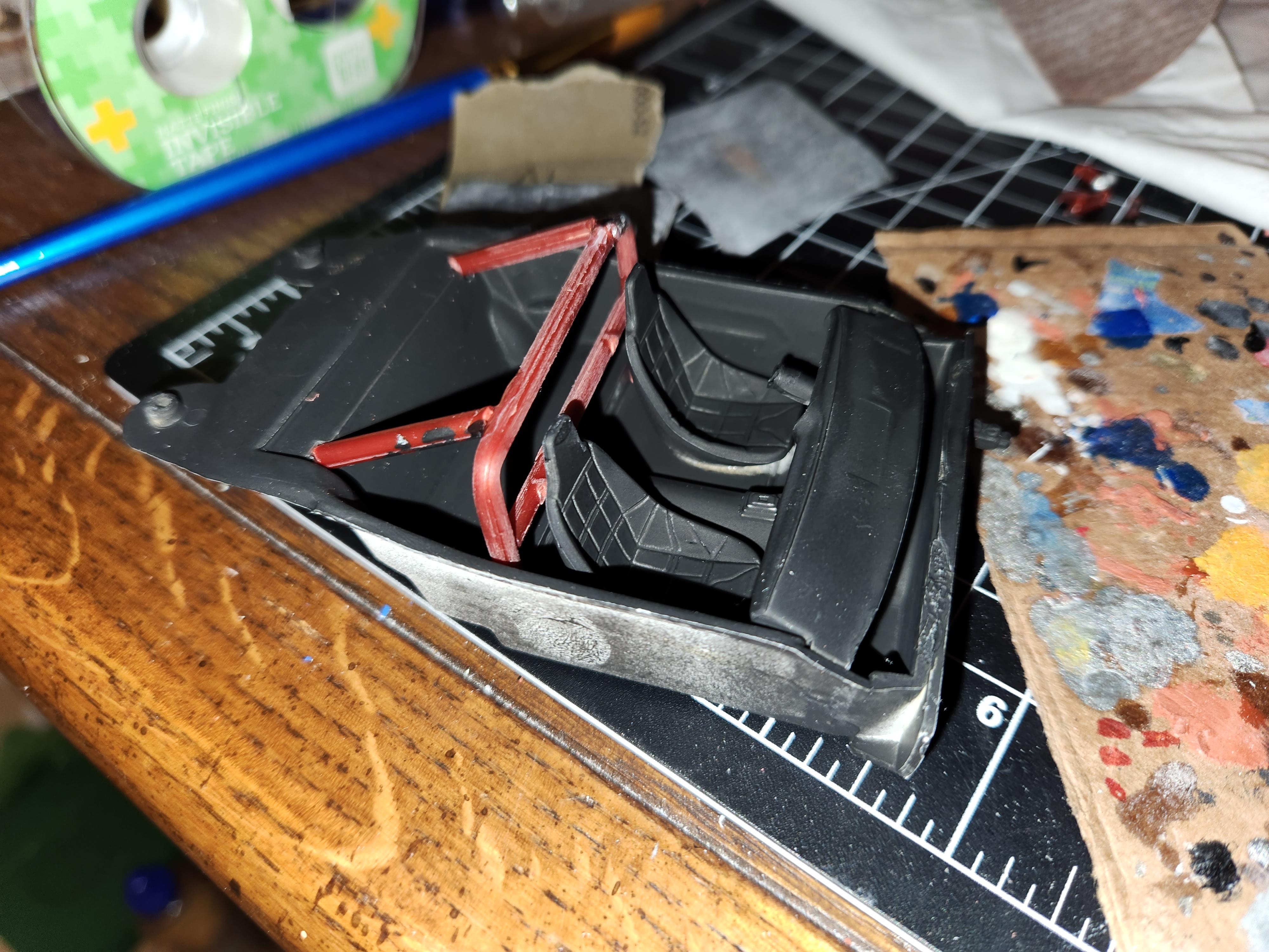

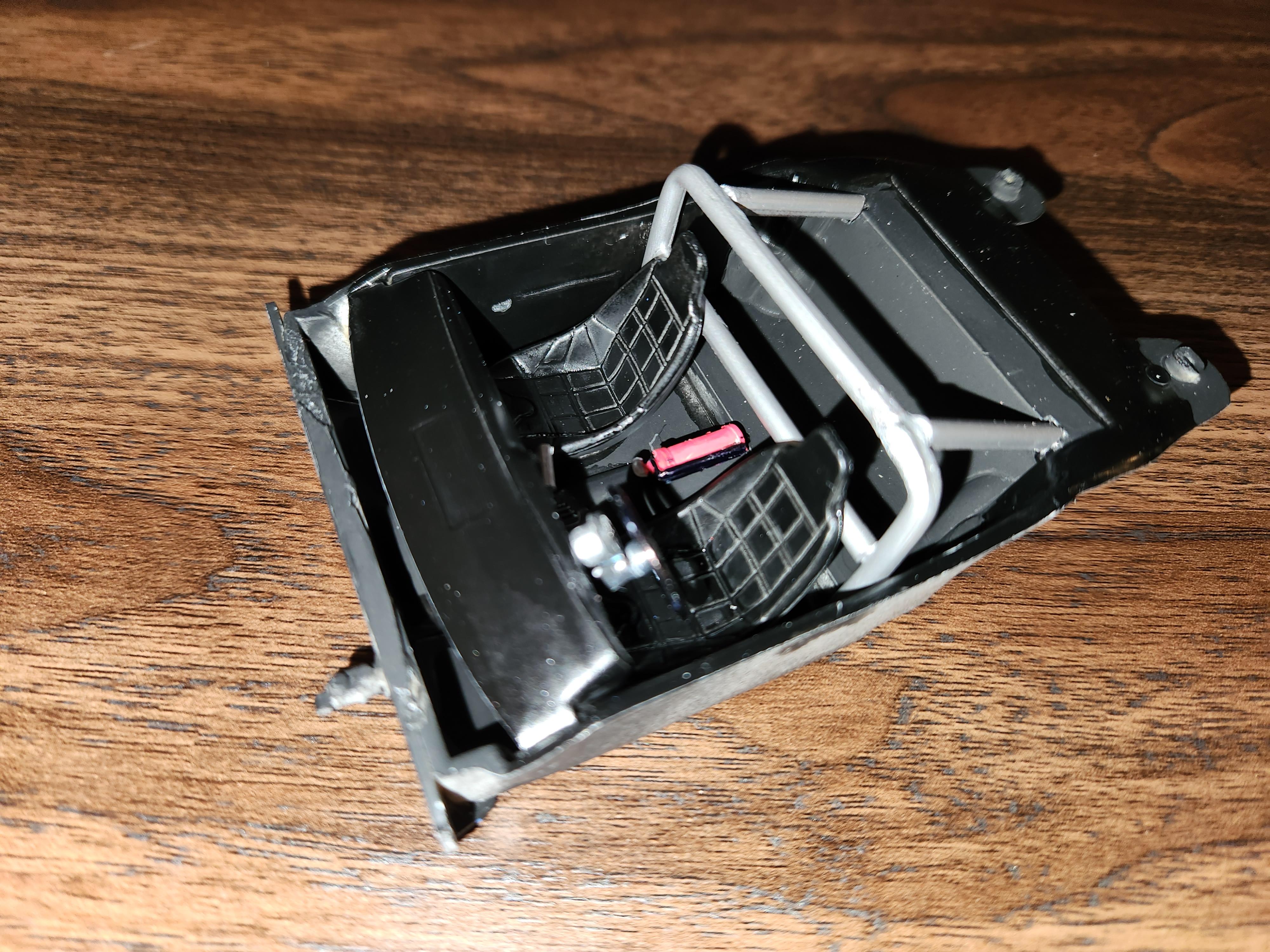

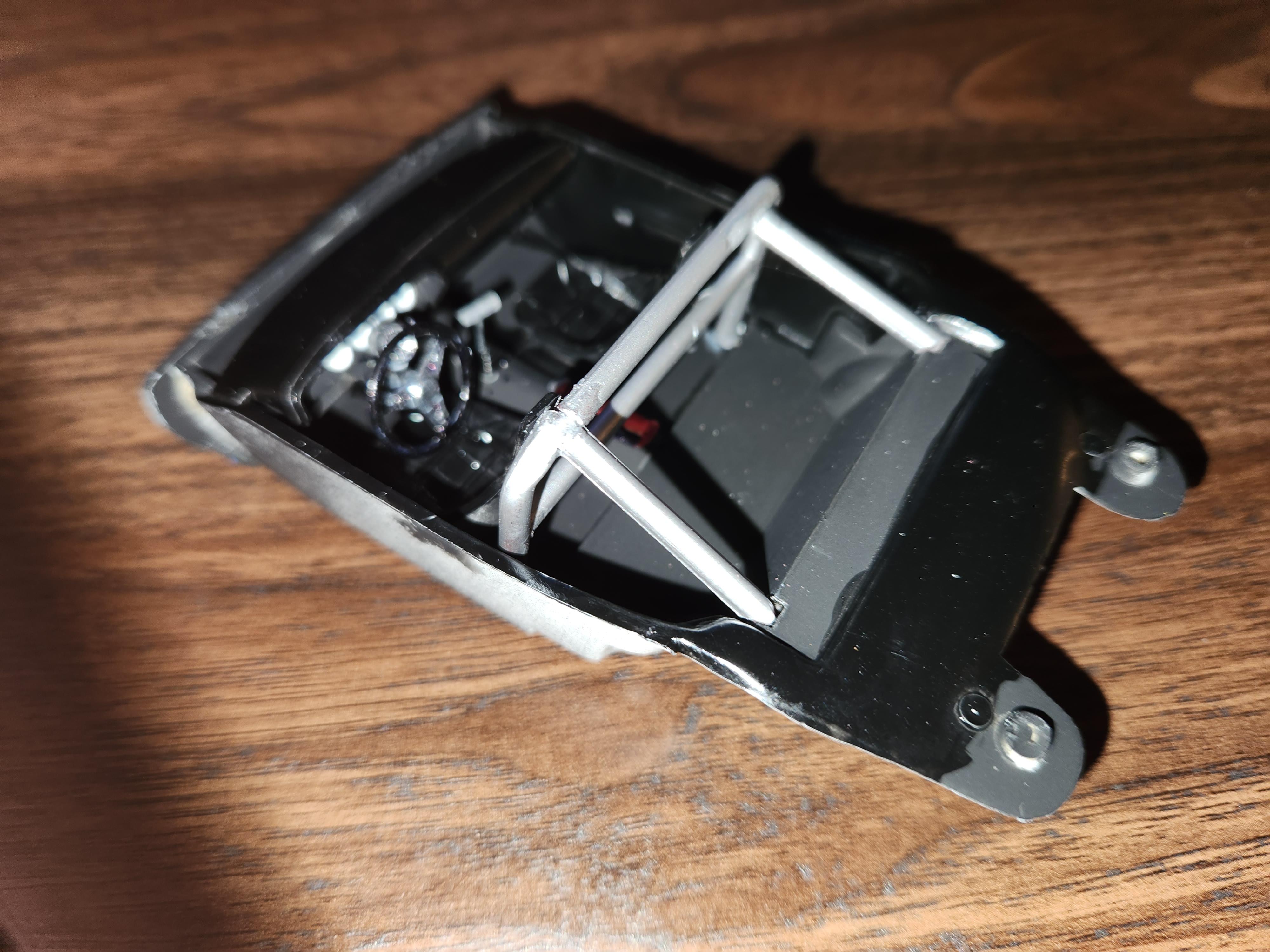

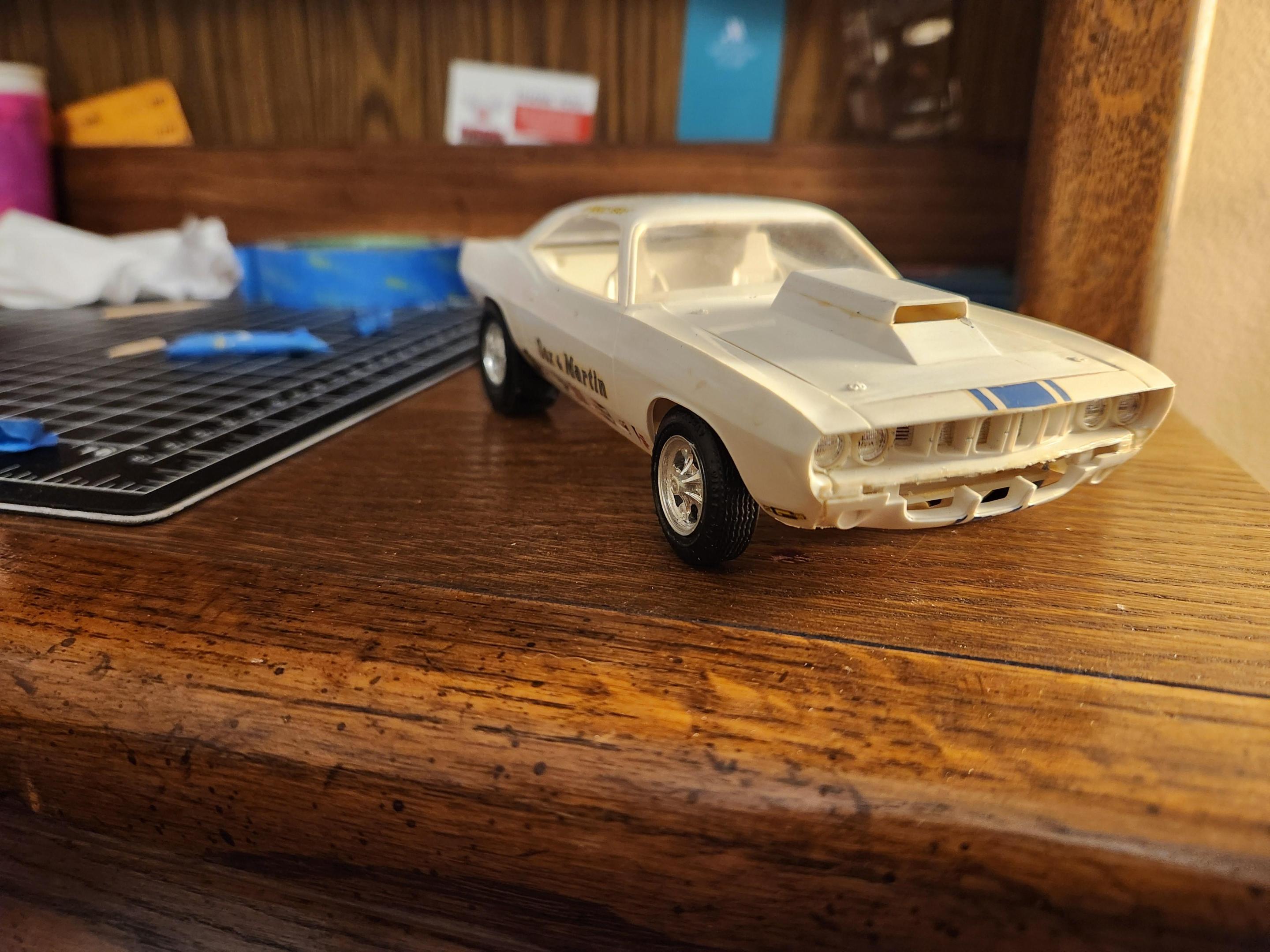

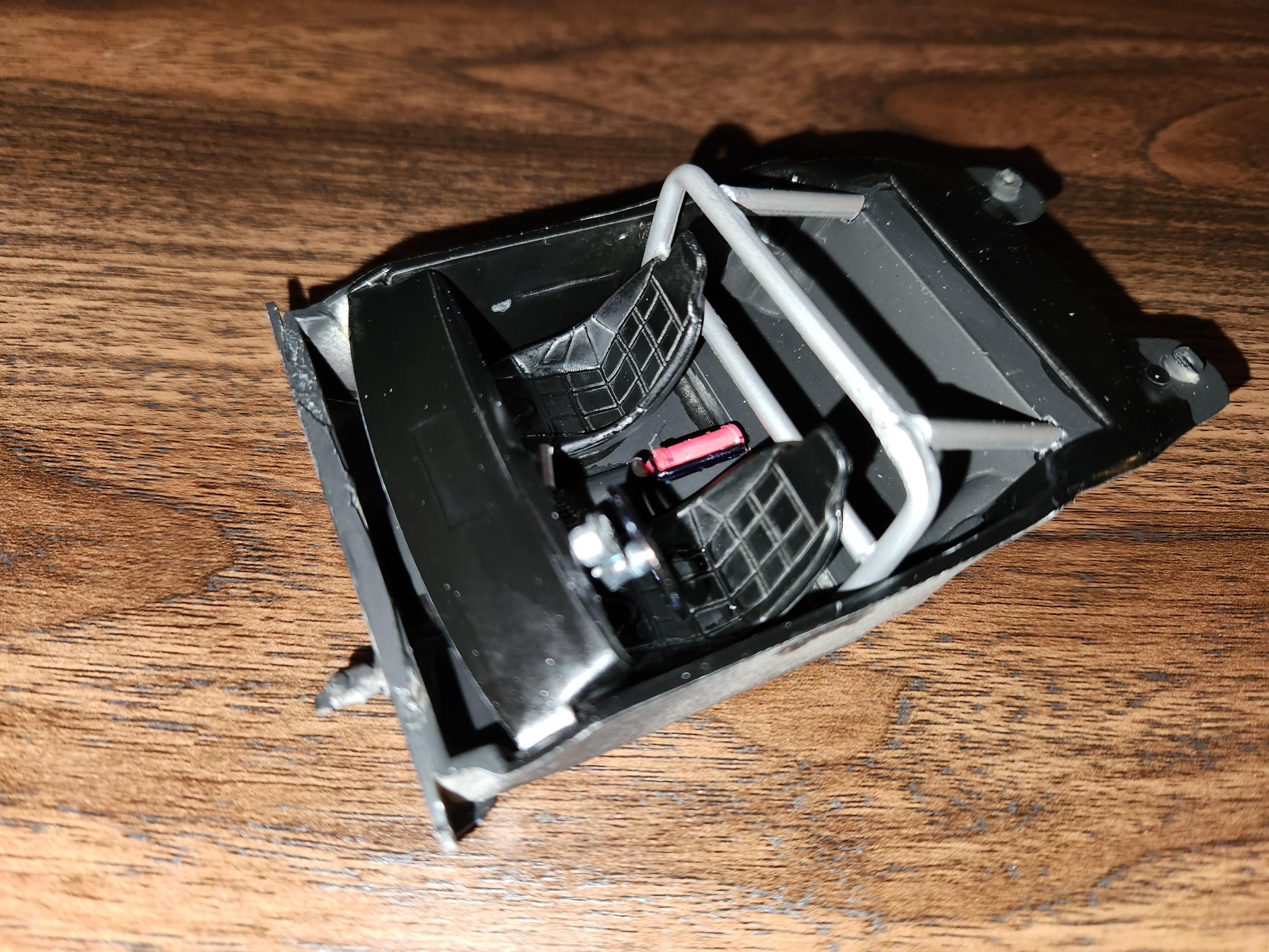

FoMoCo66 Posted January 26, 2024 Posted January 26, 2024 This is a kit that I inherited from my Grandpa. In the lot of my dad's and Grandpa's cars that was sitting at my grandparents basement sense the late 90s. I found this (the tires are from the parts bin I just used them for a moch up (im missing those and one front wheel)). A plus about this car is that it was never painted. After doing some research it seams as though the molded in white version was the rarest (correct me if I'm wrong). But the decals were still there so I removed them with micro sol. The windows were a PAIN to get out the back was the easiest, the front took some prying and the drivers side a pillar came off with the windshield but some glue fixed that. I was also missing the rear axle so I used a Dana 60 rear end, I don't know what kit it came out of though. Here it is in primer. The interior was also missing the roll bar so I made one under the candle light(and heat?). I also sprayed it with rustoleum camo flat black and I'm planing on putting pledge on the dash, seats, and door cards for a vinyl look. Advice is welcome. Thanks for looking. FMO66 2

James2 Posted January 26, 2024 Posted January 26, 2024 Always enjoy saving a old classic. Why Pledge?
FoMoCo66 Posted January 26, 2024 Author Posted January 26, 2024 3 hours ago, James2 said: Always enjoy saving a old classic. Why Pledge? Thanks. The Pledge gives it a glossy but not super glossy look. It looks just like vinyl. FMC66 1
dwc43 Posted January 26, 2024 Posted January 26, 2024 3 hours ago, James2 said: Always enjoy saving a old classic. Why Pledge? It's like putting a clear coat on it, but not as shiny. He wants a shiny vinyl dash and seat covers like they were Armor Alled.

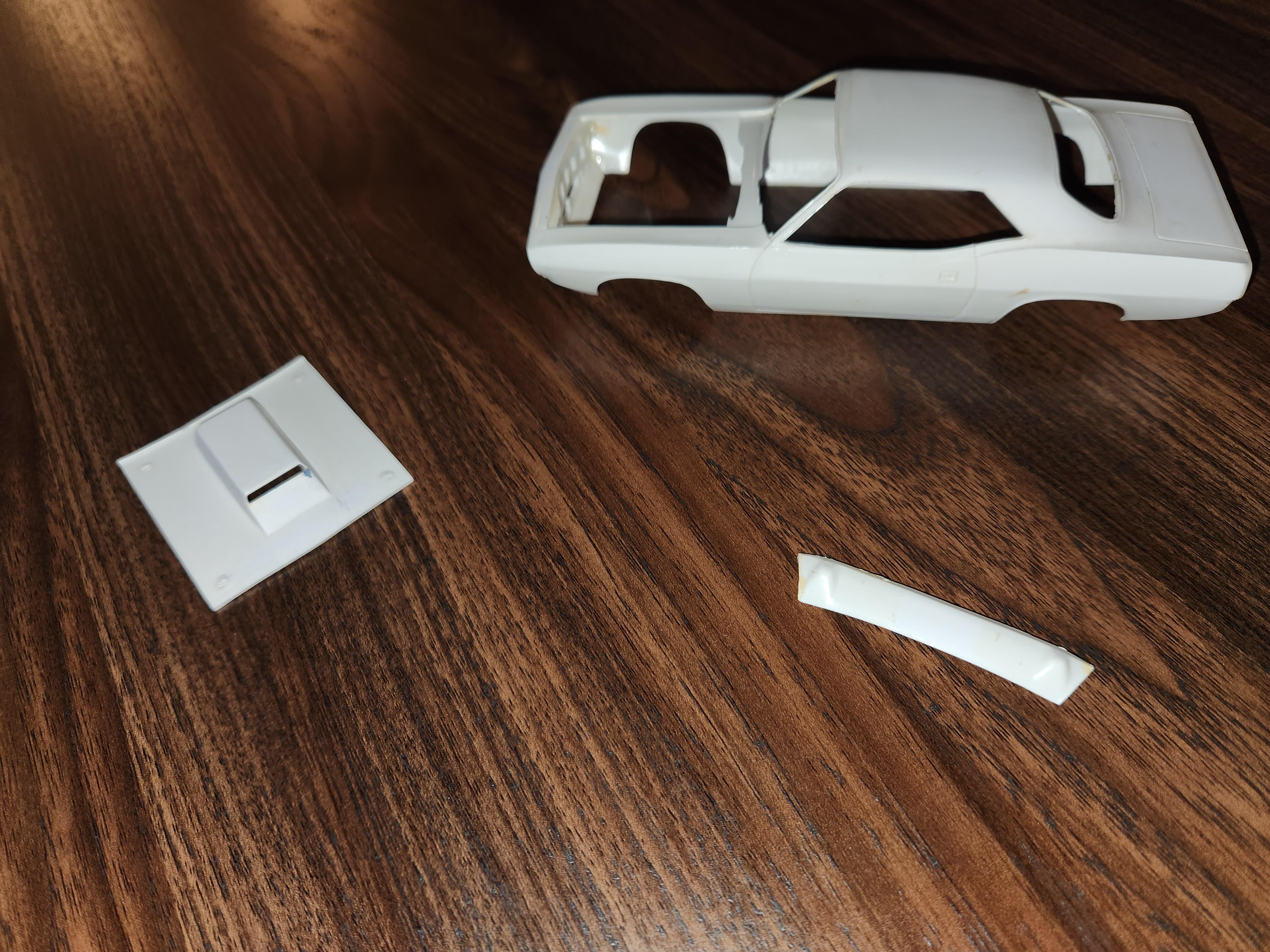

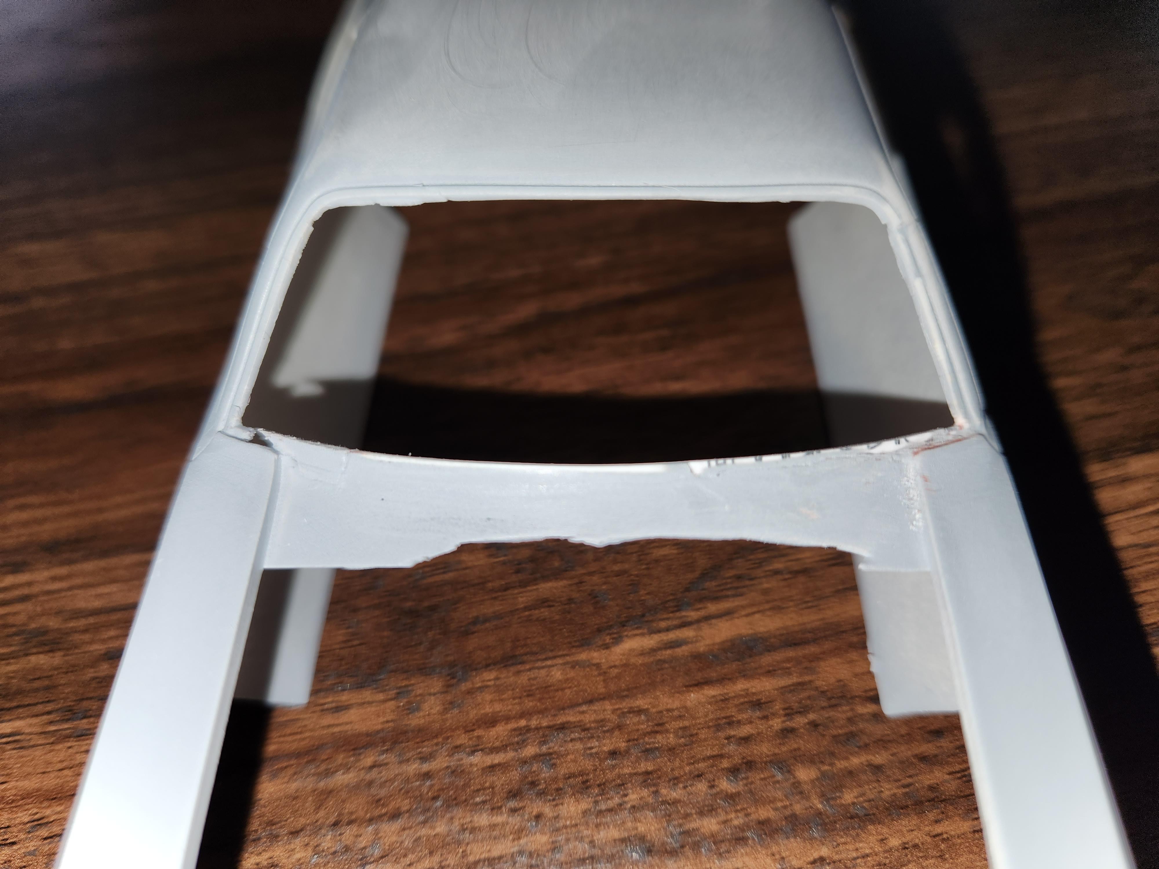

FoMoCo66 Posted January 27, 2024 Author Posted January 27, 2024 Hi again I have a question How would I go about fixing the bottom windshield sill. It cracked when I was getting the windshield out. As you can see I tried using bondo glazing buddy, I don't know what I was thinking. The bottom one came out with the fire wall so I'm good there. FMC66
Force Posted January 27, 2024 Posted January 27, 2024 My favourite Jo-Han kit. Jo-Han used whatever color plastic they had on stock, white, orange and green is what I have seen, I have several of this kit in different versions and most are white and I think I have one orange.
James2 Posted January 27, 2024 Posted January 27, 2024 7 hours ago, FoMoCo66 said: How would I go about fixing the bottom windshield sill. Making a pattern and replacement might be the best way. 1
Scott Eriksen Posted January 27, 2024 Posted January 27, 2024 11 hours ago, FoMoCo66 said: Hi again I have a question How would I go about fixing the bottom windshield sill. It cracked when I was getting the windshield out. As you can see I tried using bondo glazing buddy, I don't know what I was thinking. The bottom one came out with the fire wall so I'm good there. FMC66 Cut out the damaged area and glue in a piece of Evergreen sheet styrene ,you can get their assortment pack,sheets of different thickness and a couple black sheets in the last one I got ,then contour sand to match, you can apply a skim coat of putty and feather it in with the rest of the cowl
FoMoCo66 Posted January 27, 2024 Author Posted January 27, 2024 16 minutes ago, Scott Eriksen said: Cut out the damaged area and glue in a piece of Evergreen sheet styrene ,you can get their assortment pack,sheets of different thickness and a couple black sheets in the last one I got ,then contour sand to match, you can apply a skim coat of putty and feather it in with the rest of the cowl I think I will go with Roosters method because I don't want to Butcher the body anymore than it is.
FoMoCo66 Posted January 27, 2024 Author Posted January 27, 2024 I made some templates then glued them on, sprayed primer, then finished sanding. How's it looking? FMC66 1

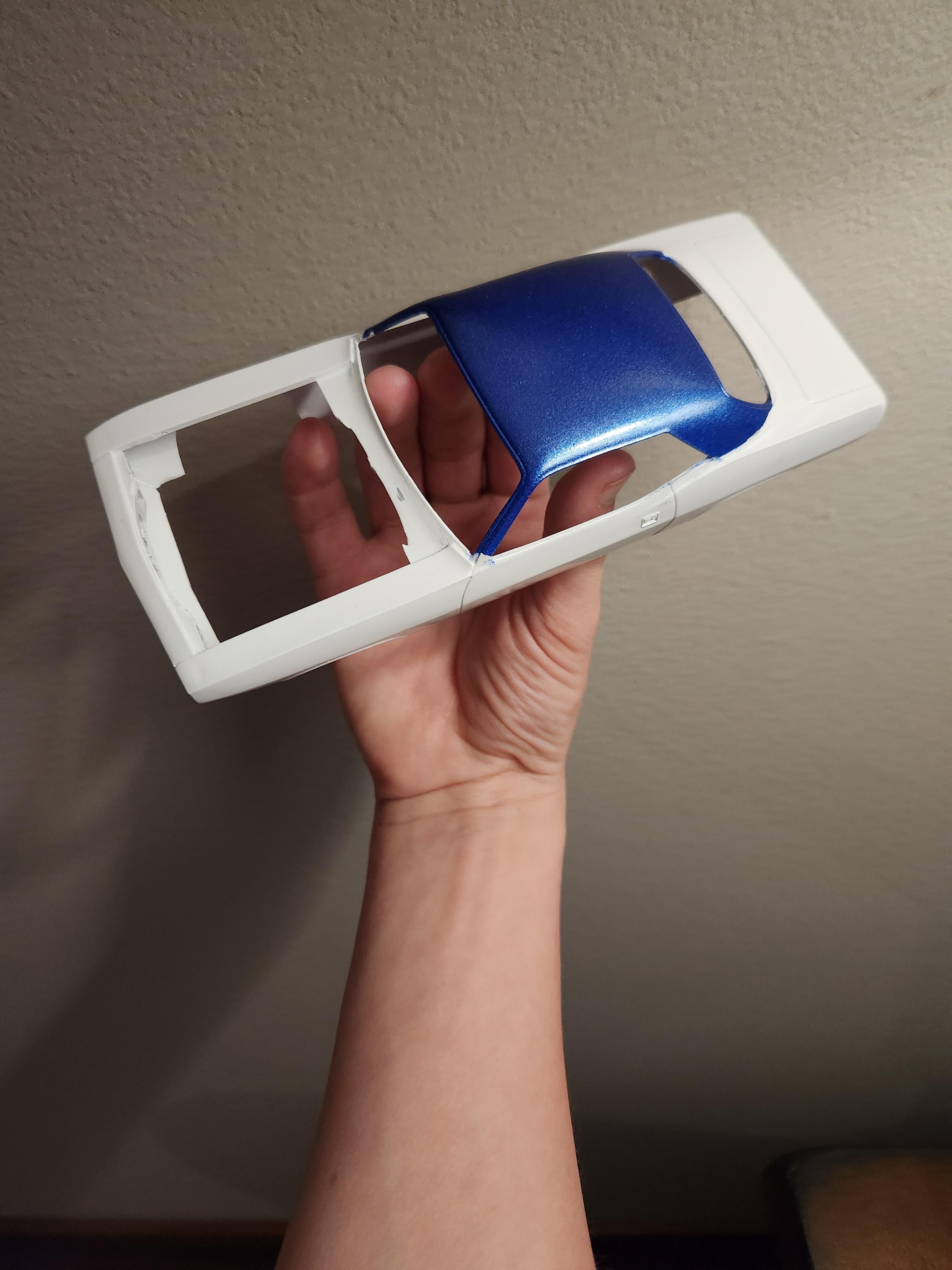

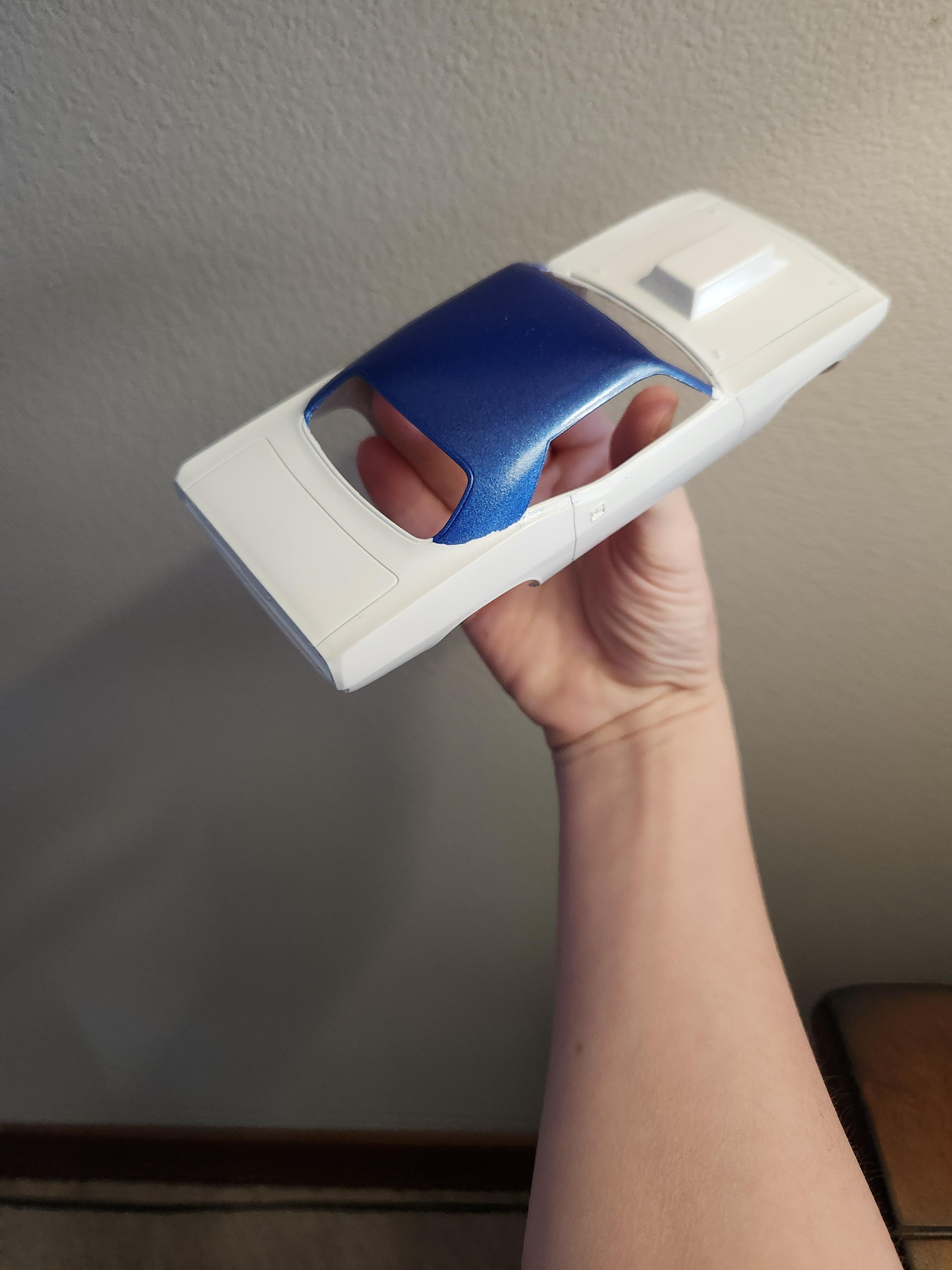

FoMoCo66 Posted March 10, 2024 Author Posted March 10, 2024 This project is still postponed but I had some time to get the top painted. I used rustoleum metalic blue that was lying around in my garage. The only thing I'm not super happy is the c pillar line I got some bleeding. That might be because of my tape which is just blue painters tape. What tape work's best for you at a somewhat cheap price. Thanks for your comments. FMC66 1
