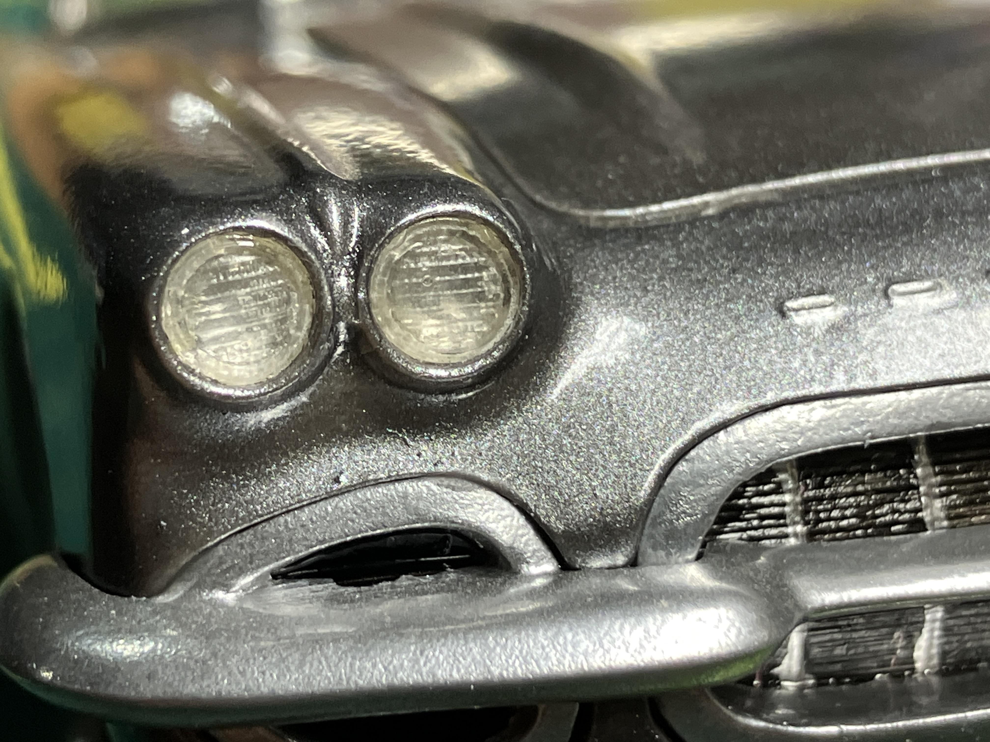

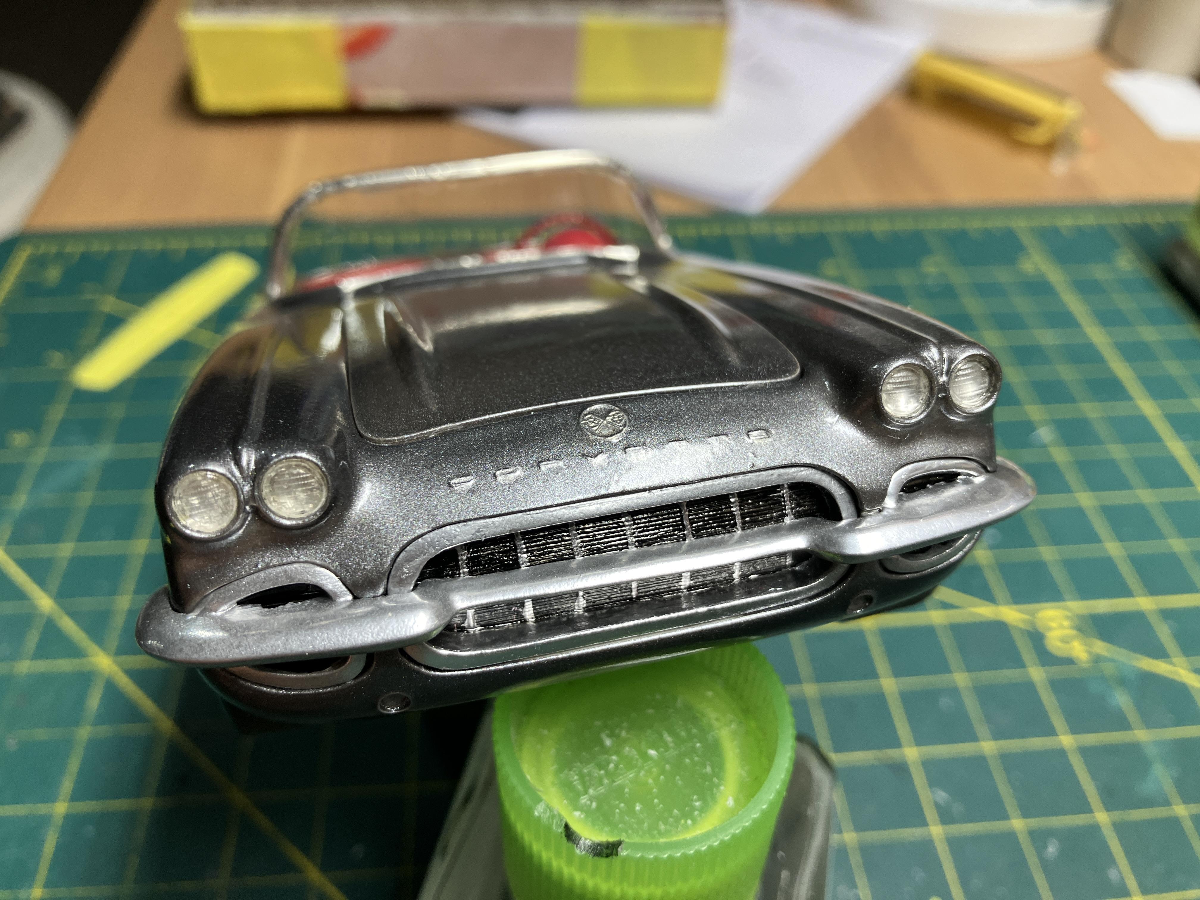

This is how the bondic ones looked during the build. I don’t have the model here now, but I can post up a current (5 yrs later) picture in about a week.

As promised…here are the bondic lens when first made.IMG_0552.jpeg.b9ffd80d6d359c0cf449dc653659bf3a.jpeg
And about 5 years later.IMG_1378.thumb.jpeg.855cb1d47de0c02466c3c76b72c3b402.jpeg
Those look good! I bought a kit and need to do a couple of molds to try it. Thanks for the pictures.
Those look good Gary, but why you are calling it "Bondic", when it is clearly another brand of UV-cured resin?
As I mentioned when I tried actual Bondic, after curing it remained slightly rubbery and its surface was sticky.   "Bondic" is just a trade name for a specific resin. Calling your resin "Bondic" does a disservice to modelers  looking to replicate your success.

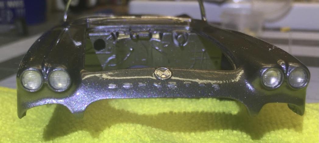

The stuff I used for the Corvette headlights IS Bondic brand. The stuff that Gary got (and states is NOT Bondic) apparently has 3 different viscosities which may work better? I found the Bondic to be a little thick and had to poke it with a toothpick to get it to fill the mold. Please let us know how they turn out Gary.?
Edit: The UV light supplied with the Bondic is a little anemic, which is maybe why your castings were sticky Pete. IIRC, I flipped them over when out of the mold and cured the other side too.
