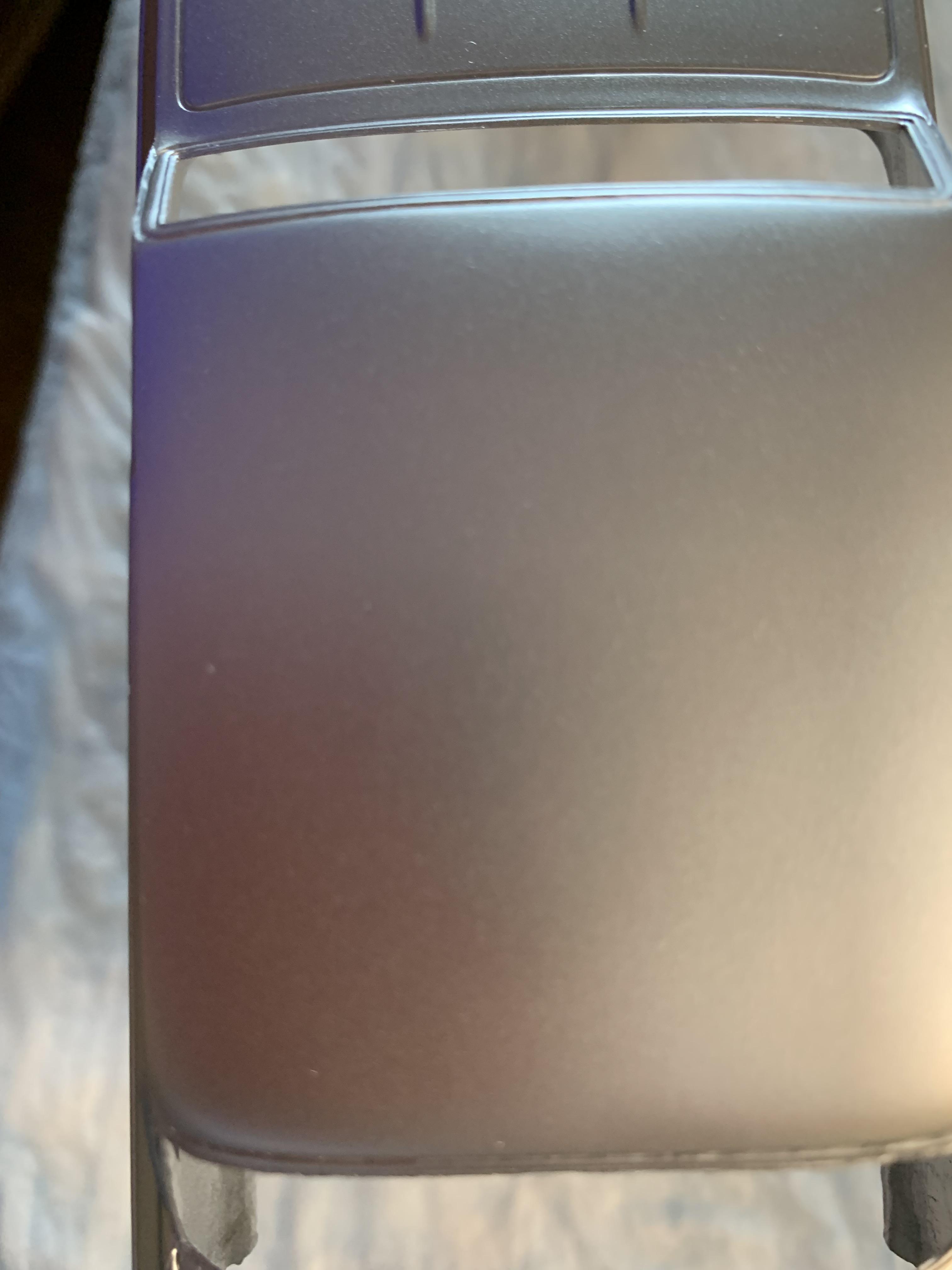

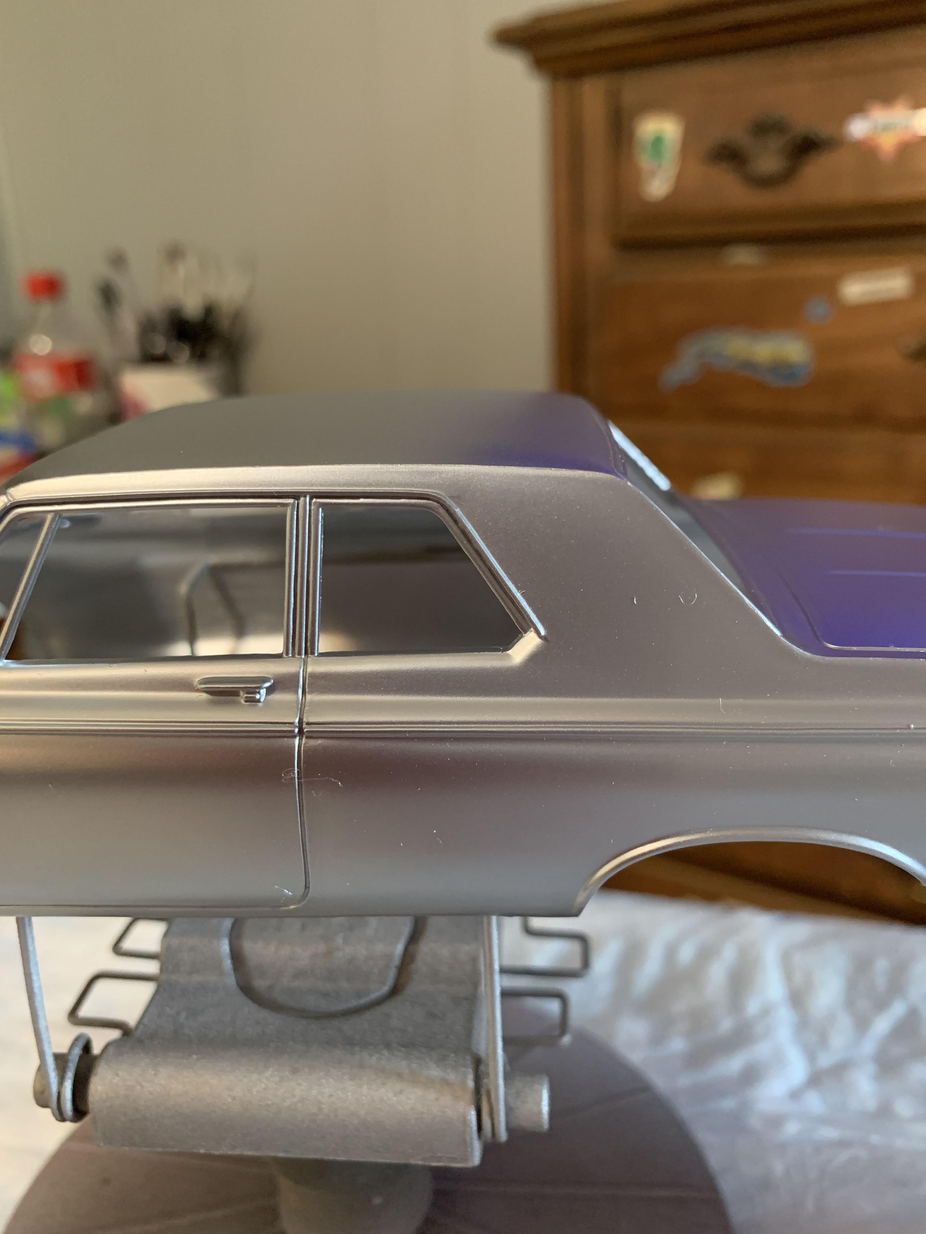

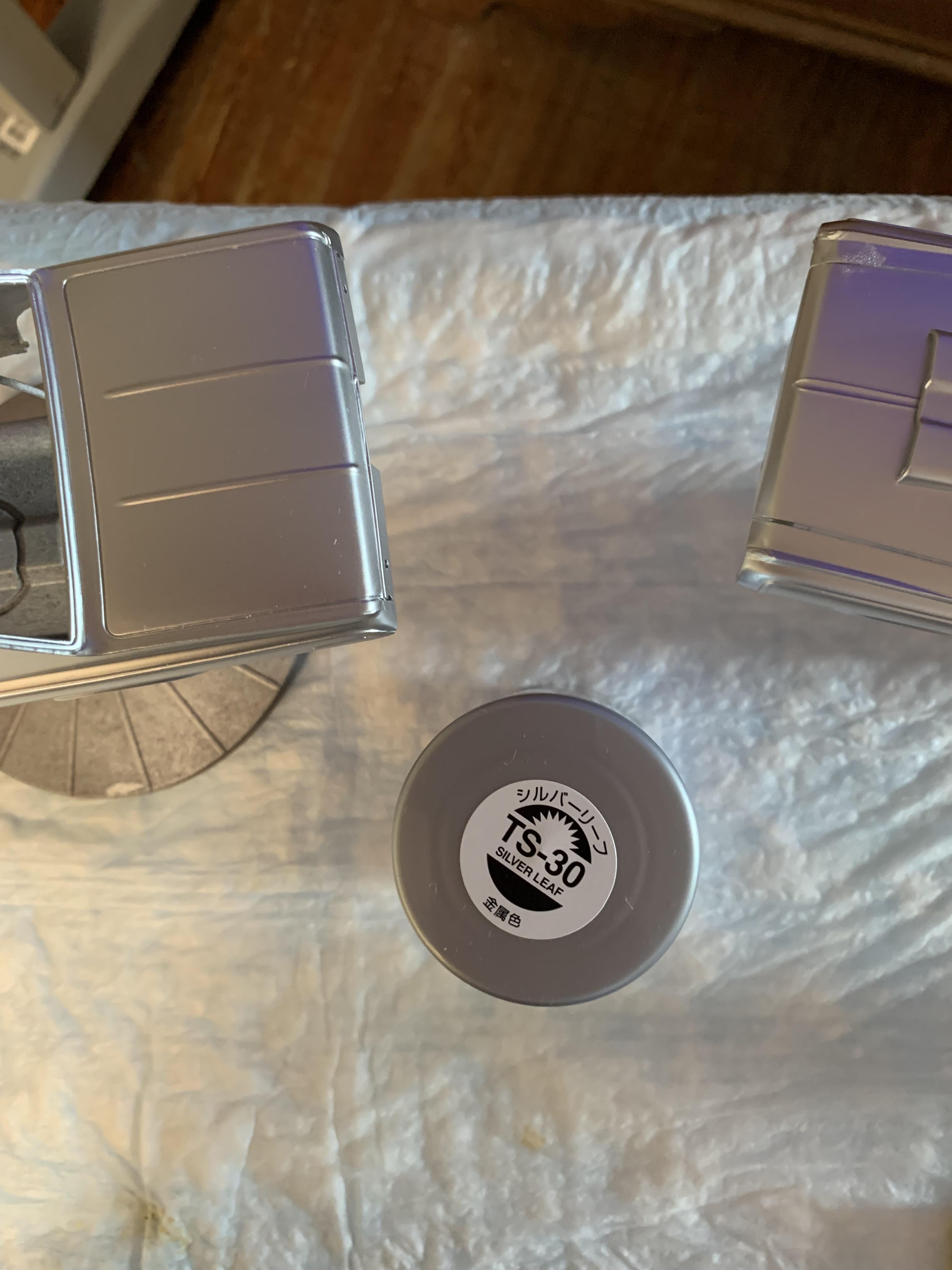

Claude Thibodeau Posted February 6, 2024 Posted February 6, 2024 Hi! Silver leaf is nice, with radiance that is more "in scale" with model cars. However, it is trickier to apply, and sensible to "mottling" if you don't have a steady fan and stable distance from the model. Here's a sample of the final results. Good luck! CT 2

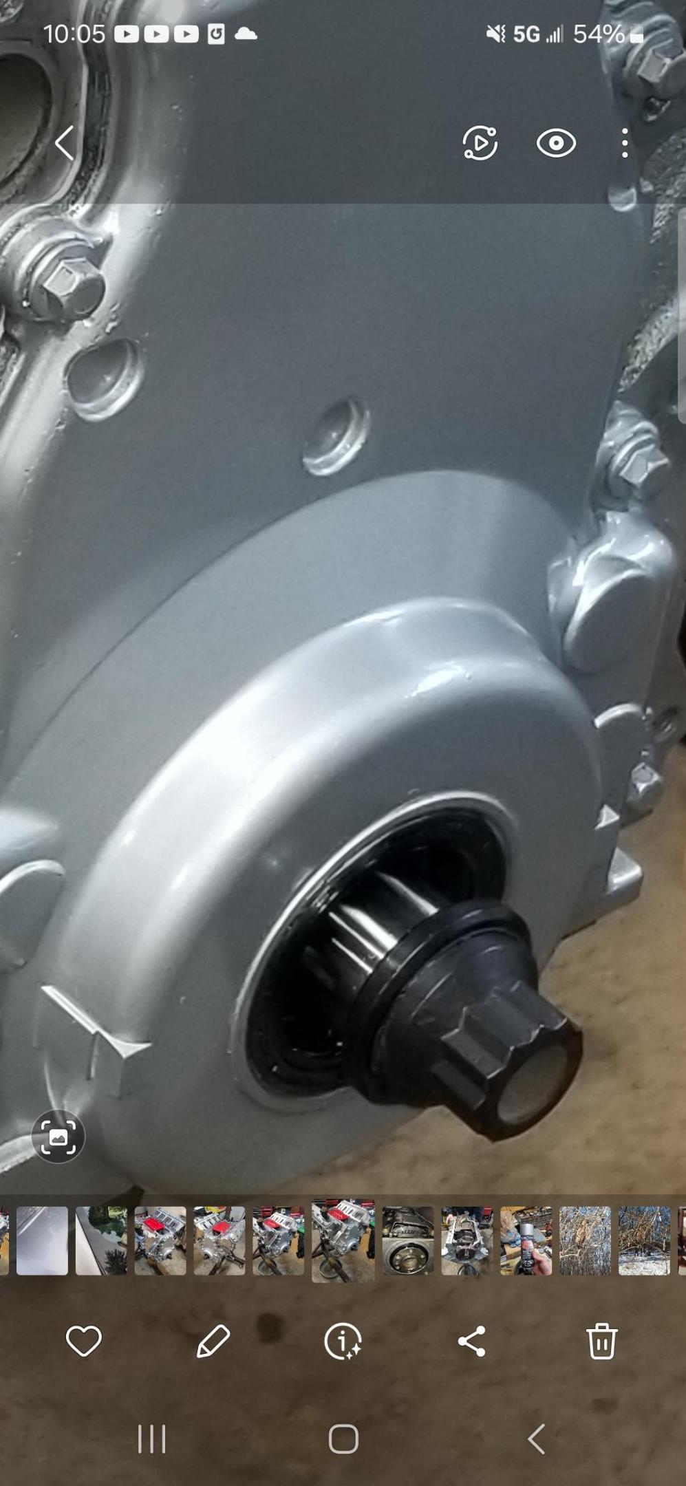

keviiin86 Posted February 9, 2024 Posted February 9, 2024 I've had great results with enamel dupli color silver caliper paint..used it on several occasions on my car, when last assembling my engine I painted the timing cover and valley cover with it and used some rustoleum enamel 2x clear over it..with minimal prep it turned out very nice. The silver has a very fine flake to it lays down nicely, and the rustoleum clear gives it a very smooth finish. Next time I decide to paint a model car body silver that's what I'll be using. I zoomed into the timing cover on my LS to show the finish as best as I can.
