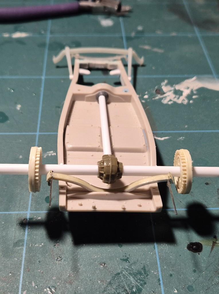

Chris B Posted Sunday at 09:07 AM Author Posted Sunday at 09:07 AM Well after spending a little bit of time modifying this axle this afternoon I've decided I really don't like the results. I stumbled upon a chrome center section just randomly laying on a shelf in my display cab net. i have no idea where it came from or what kit it came out of but I played around a bit with it and decided I liked the look. I stuck it in a shot glass of bleach and stripped the chrome from it split it into two halves and gave it a good cleanup, I glued the two halves bvack together and drilled it out to accept the axle tube and I have decided to stick with the enclosed torque tube for a drive shaft. I think I'm liking the results so far, what do you think? 1

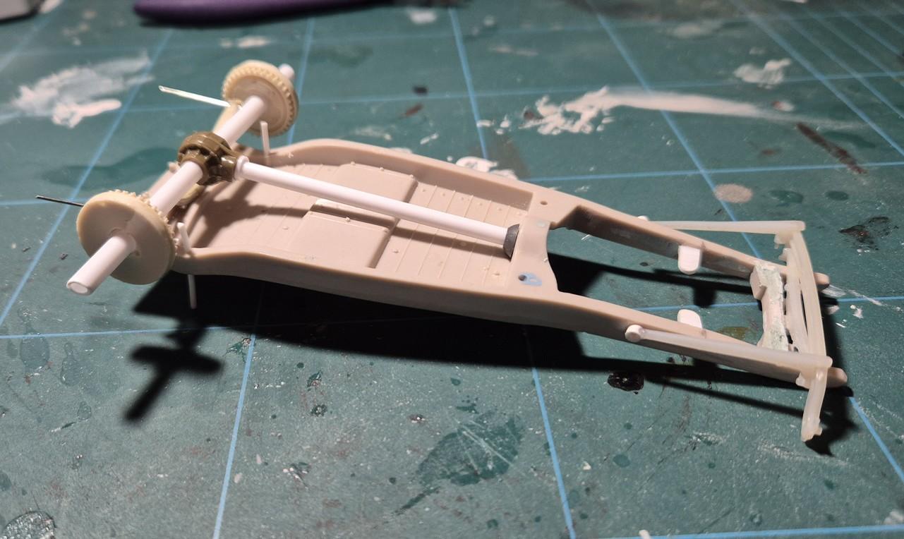

Chris B Posted Sunday at 09:50 AM Author Posted Sunday at 09:50 AM (edited) Trimmed things up a little and drilled some holes for the pins I have used to secure the transverse spring to the axle tubes and it all looks like it fits pretty good. Next up will be shock absorbers. I haven't been able to find anything suitable in the parts stash so these at this stage will be scratch built also. Edited Sunday at 09:53 AM by Chris B 2

stavanzer Posted yesterday at 11:19 PM Posted yesterday at 11:19 PM On 8/31/2025 at 2:50 AM, Chris B said: Trimmed things up a little and drilled some holes for the pins I have used to secure the transverse spring to the axle tubes and it all looks like it fits pretty good. Next up will be shock absorbers. I haven't been able to find anything suitable in the parts stash so these at this stage will be scratch built also. Looks Top Rank! I like it.
