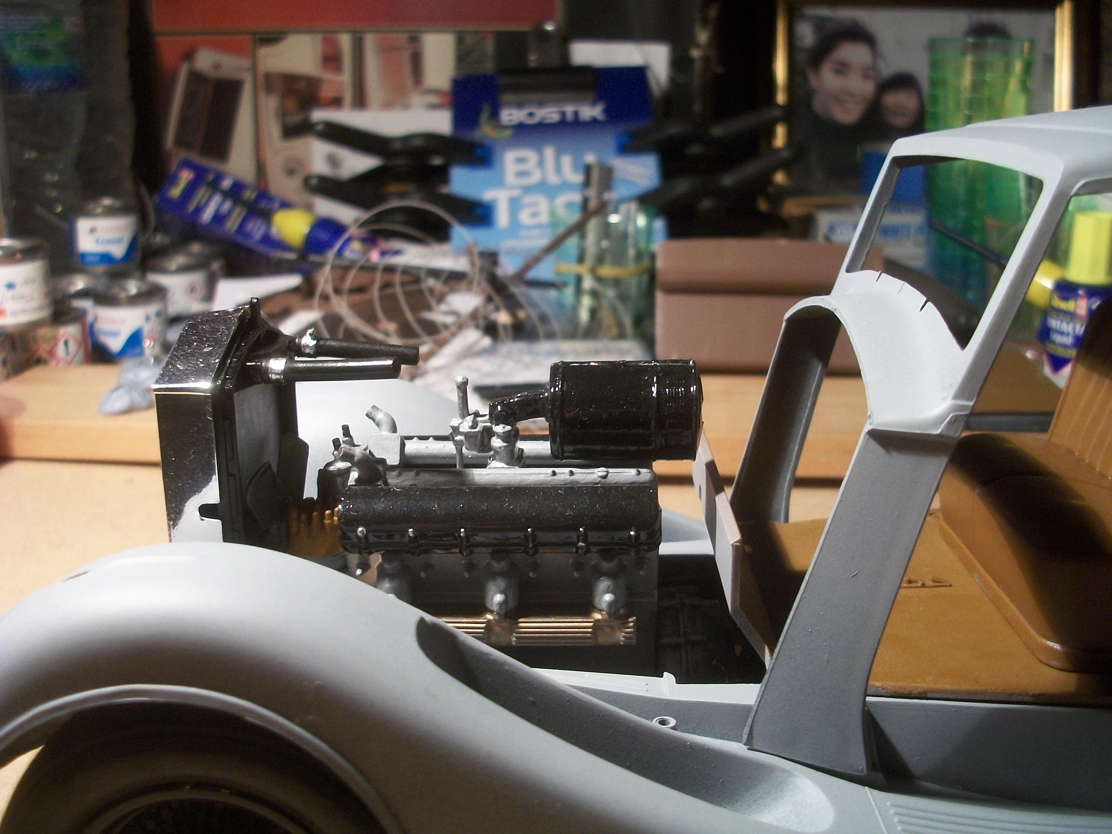

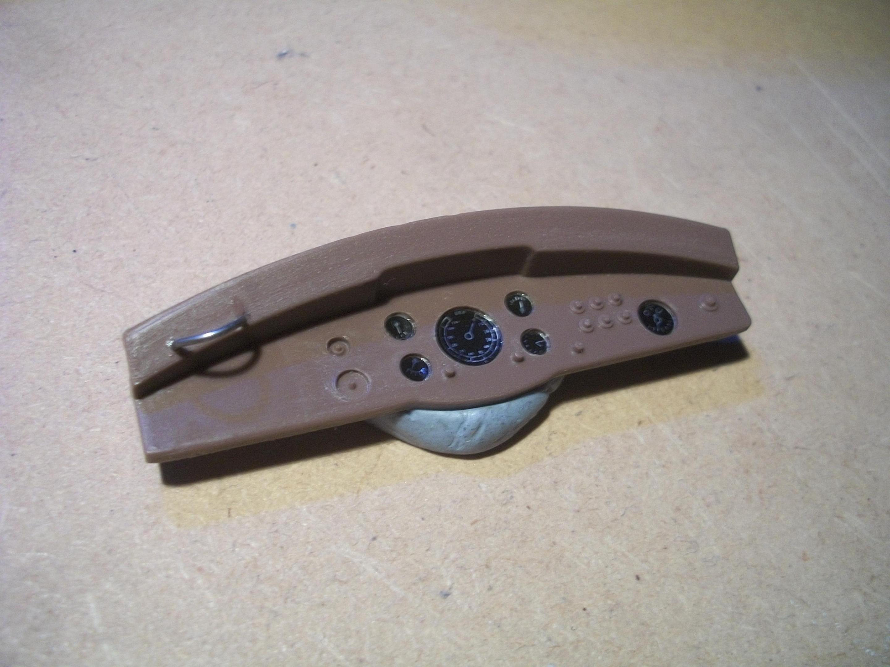

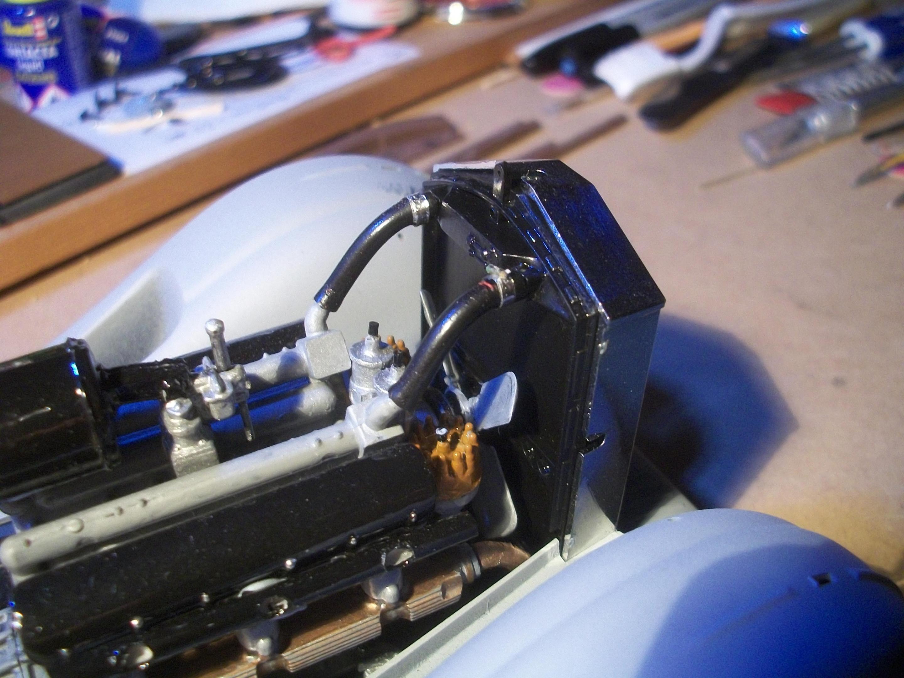

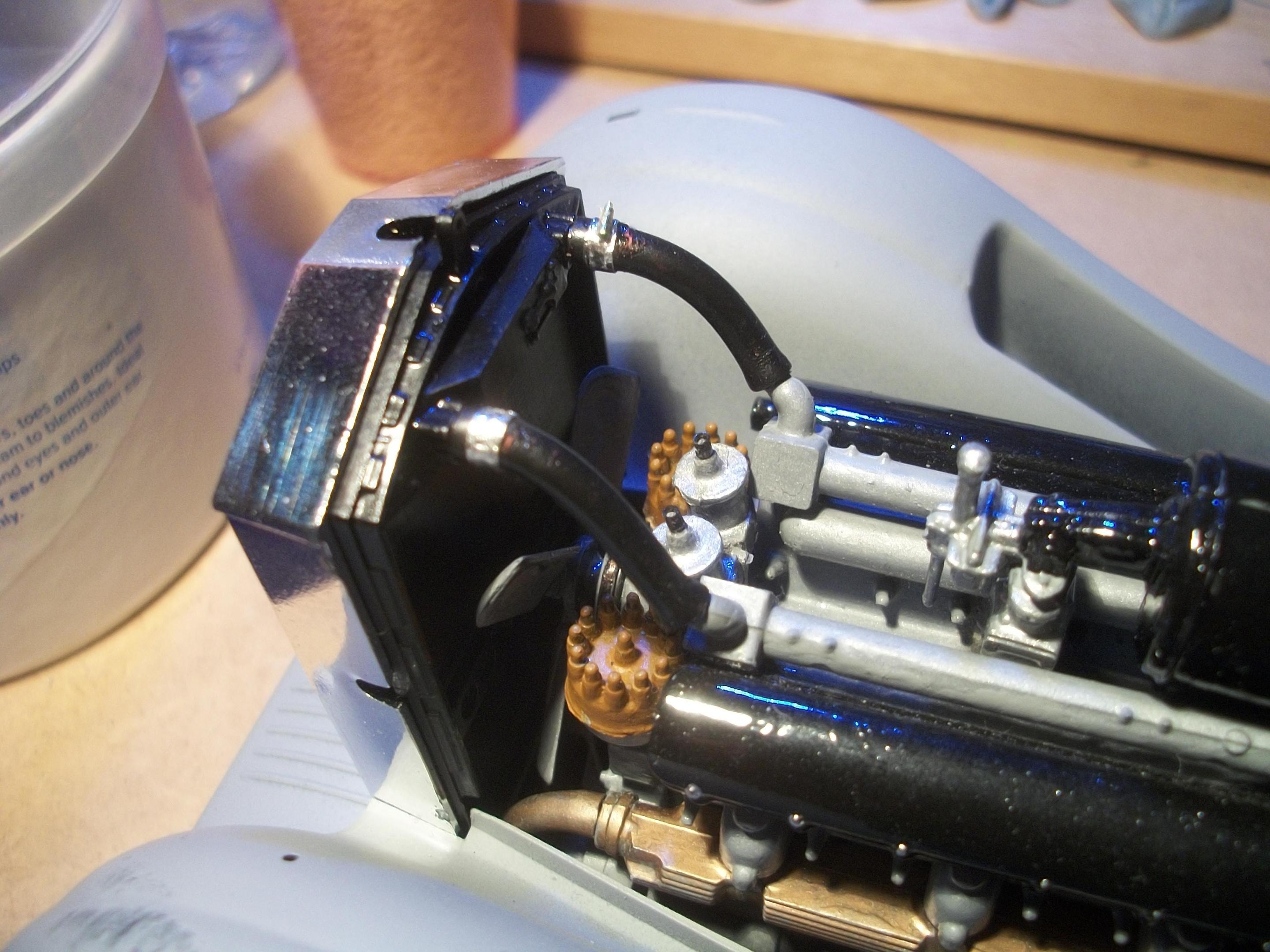

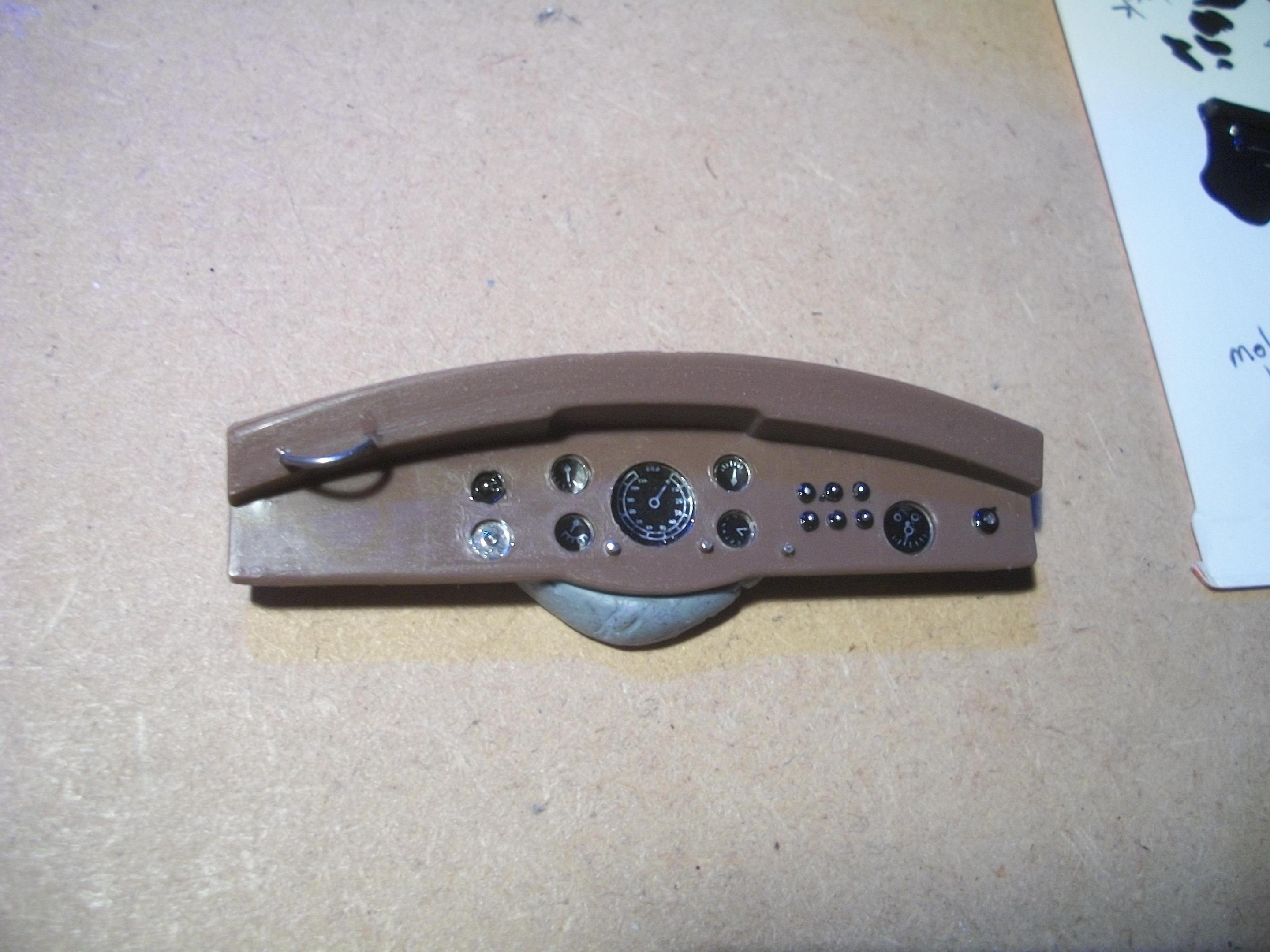

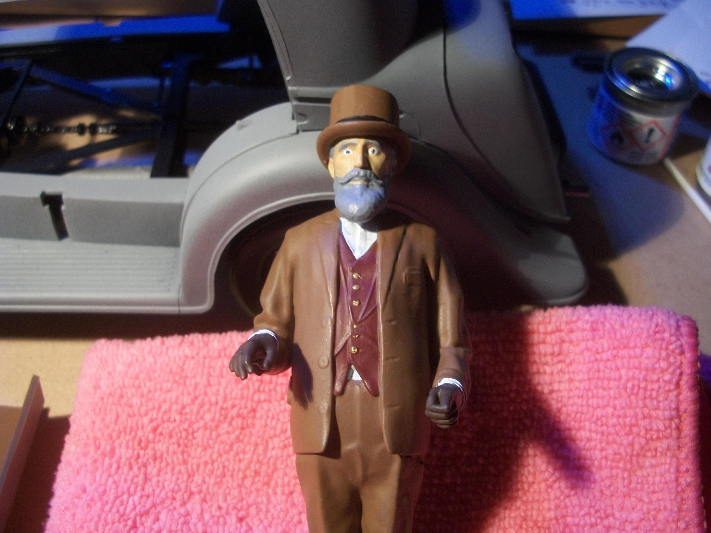

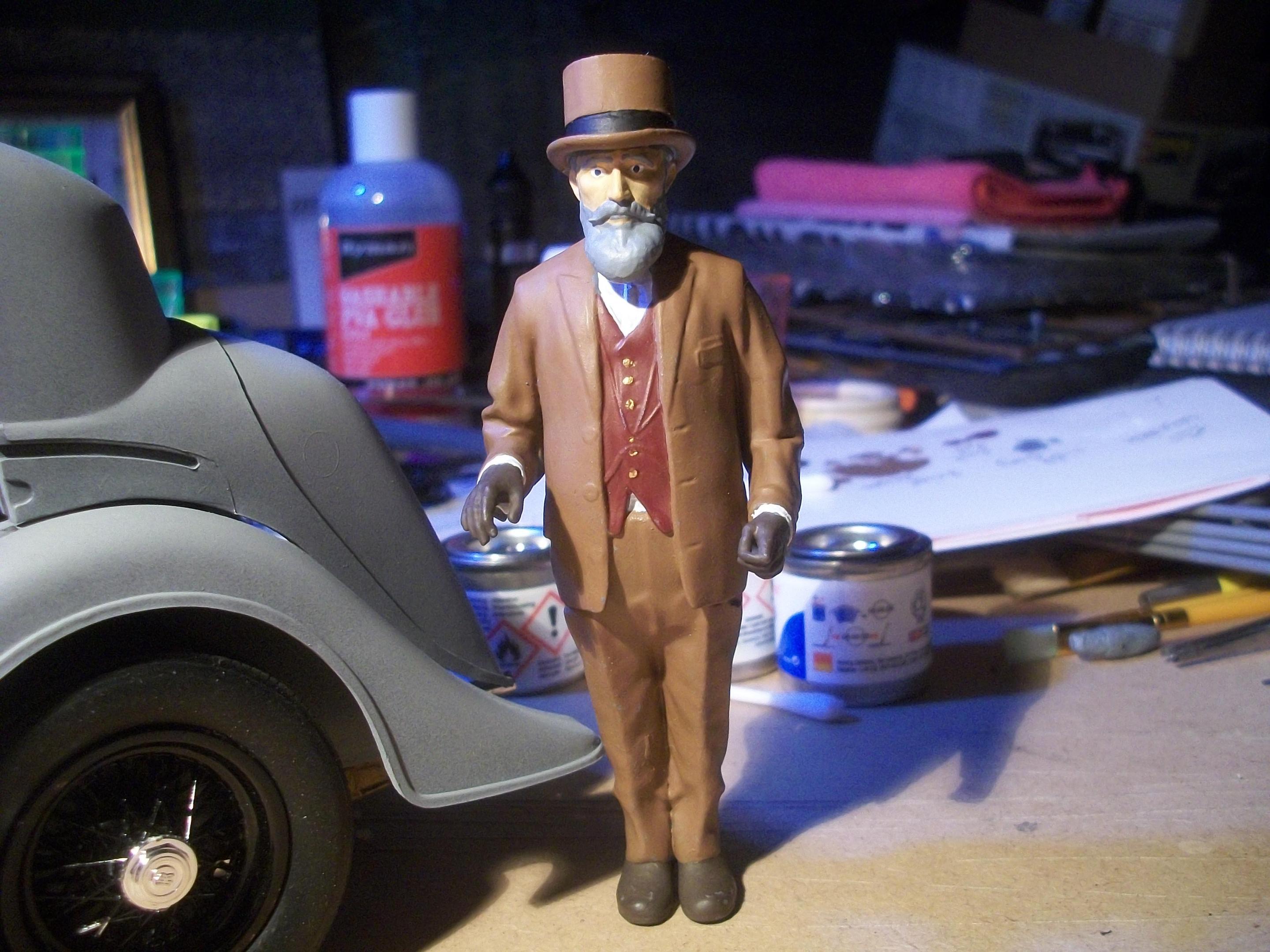

The jubilee clips ( hose clips ) on the two cooling hoses that connect the radiator to the water rails that run along the top of the engine have been made from Bare Metal Foil, cut into thin strips, and tiny pieces of brass wire for the screws on top . . . Details have been added to the dashboard, including a grab handle on the passenger side made out of a short length of solder, and super glued in place. Once most of the details have been added, the painting of the burr walnut effect can begin . . . Last job today was to carefully paint in the pupils of the eyes of the figure, or should I say the IRIS which is Prussian Blue acrylic, and applied with a cocktail stick rather than a brush . . . A cocktail stick was used also for the dashboard detail, using Molotow Liquid Chrome refill and Humbrol Metallic Black enamel.

Excellent detail work on the engine and dash panel David.
The ol' gaffer is coming along quite well too. I like the colors you're using for his outfit.
David G.
Thanks again David . . . This time I decided to add the detail to the dashboard BEFORE applying the burr walnut paint effect, whereas previously I have applied the burr walnut first , and then struggled with the detail afterwards . . . For the hat, jacket and trousers on this figure I didn't want black, white or grey, and I didn't want red, blue, green or purple, so I settled on brown which I think looks fine . . .

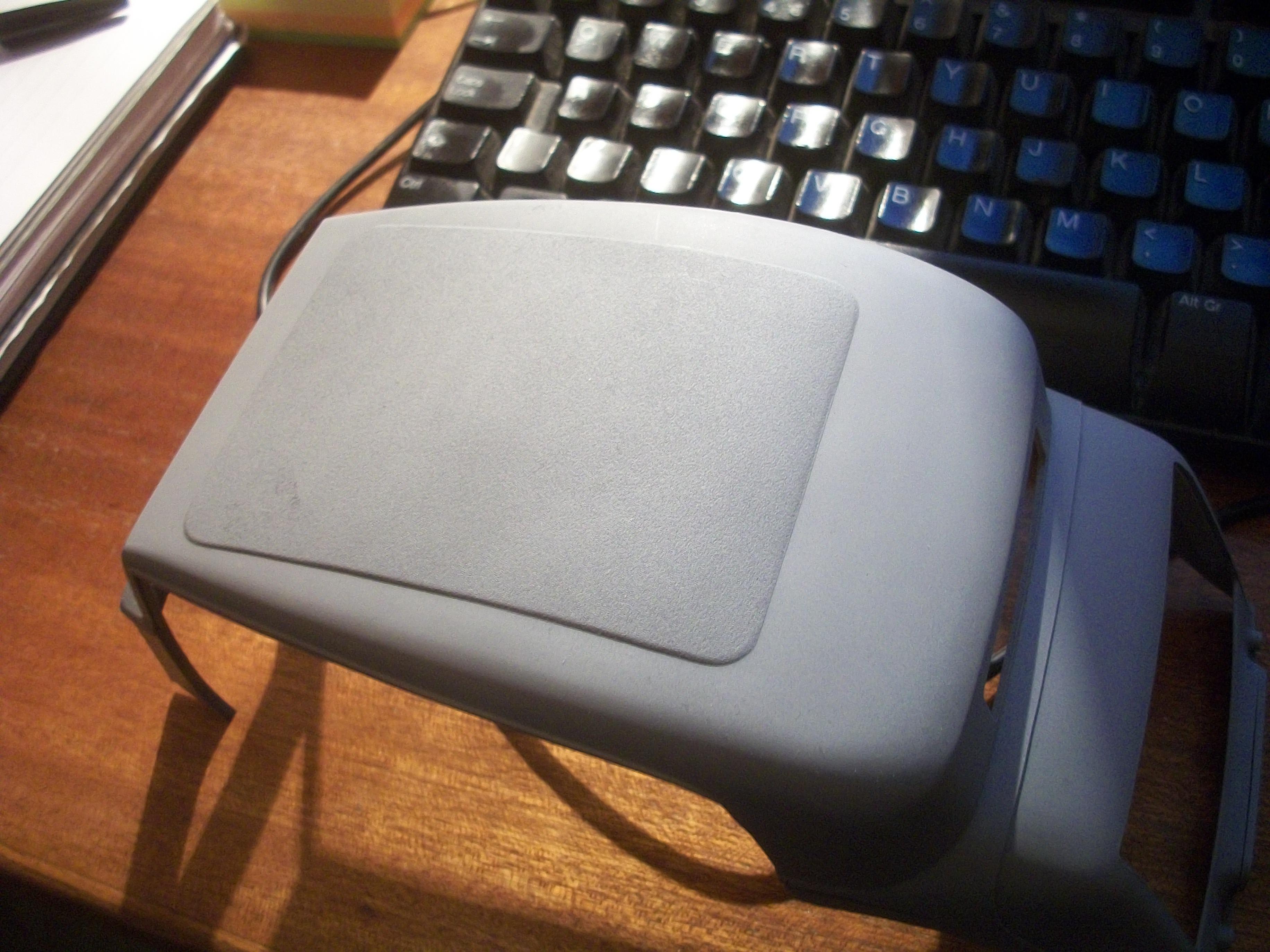

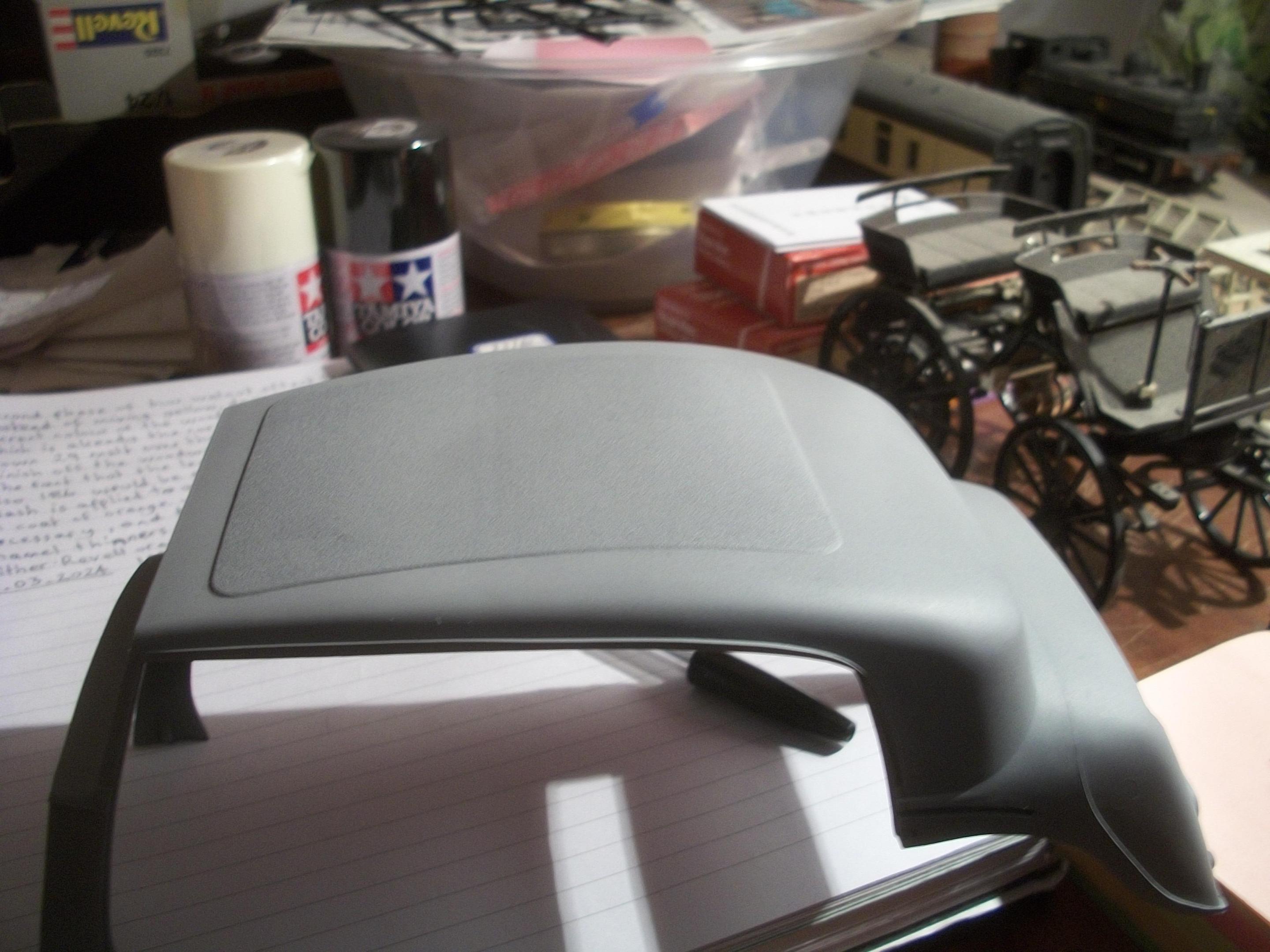

Thank you Skip, and that is just what I like to see . . . That is a Freestone and Webb bodied motor car, and a few things spring to mind as I am seeing those images . . . The sunroof appears to be above the driver's compartment only, whereas my model Phantom III has a soft fabric panel on top of the roof that extends almost to the rear of the roof area. Also I noticed, the wind-up division glass has an interesting feature. The winding down of the glass partition window causes the mechanism to tilt the glass at an angle towards the rear of the car, so that the glass lowers into a forward angled housing behind the driver's seat. Then when you wound up the glass, it would rise and angle upwards to the 90° vertical as it reached the interior of the roof.

The canvas roof cover isn't really supposed to be roll-back. I've read that cars of the day had that feature because molding a slightly curved metal roof of that size was technologically difficult at the time, so there was a hole in the roof, supported underneath with wood beams, then covered inside with a headliner.

You have come up with some really good information Skip . . . The 1937 car is the same as my Phantom III model, with same steering wheel and the same door configuration . . . I was puzzled about the canvas roof covering, and I wrongly assumed that it was an opening sunroof. I understand what you are saying about the roof construction back in the day, and it all makes perfect sense now!

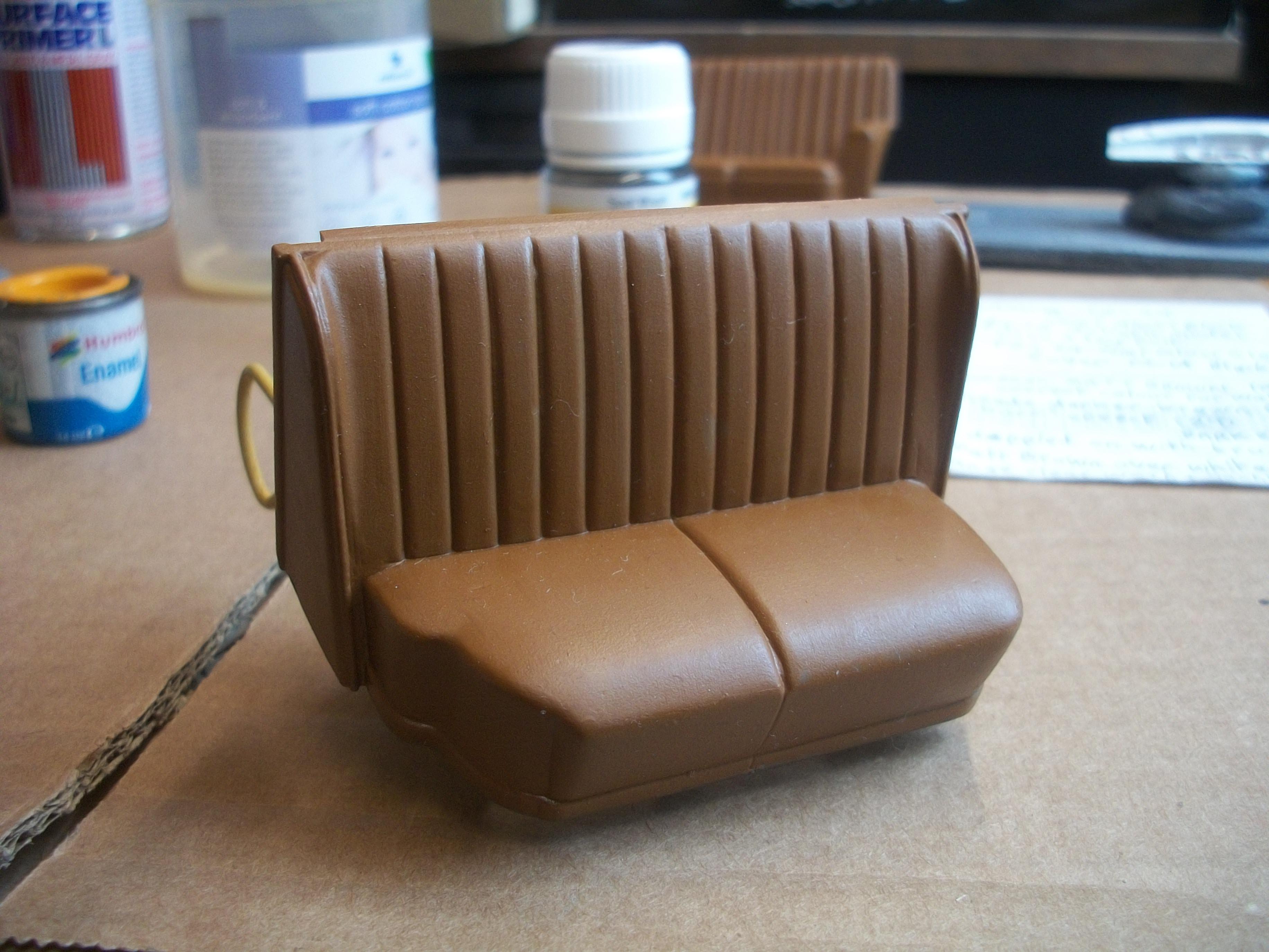

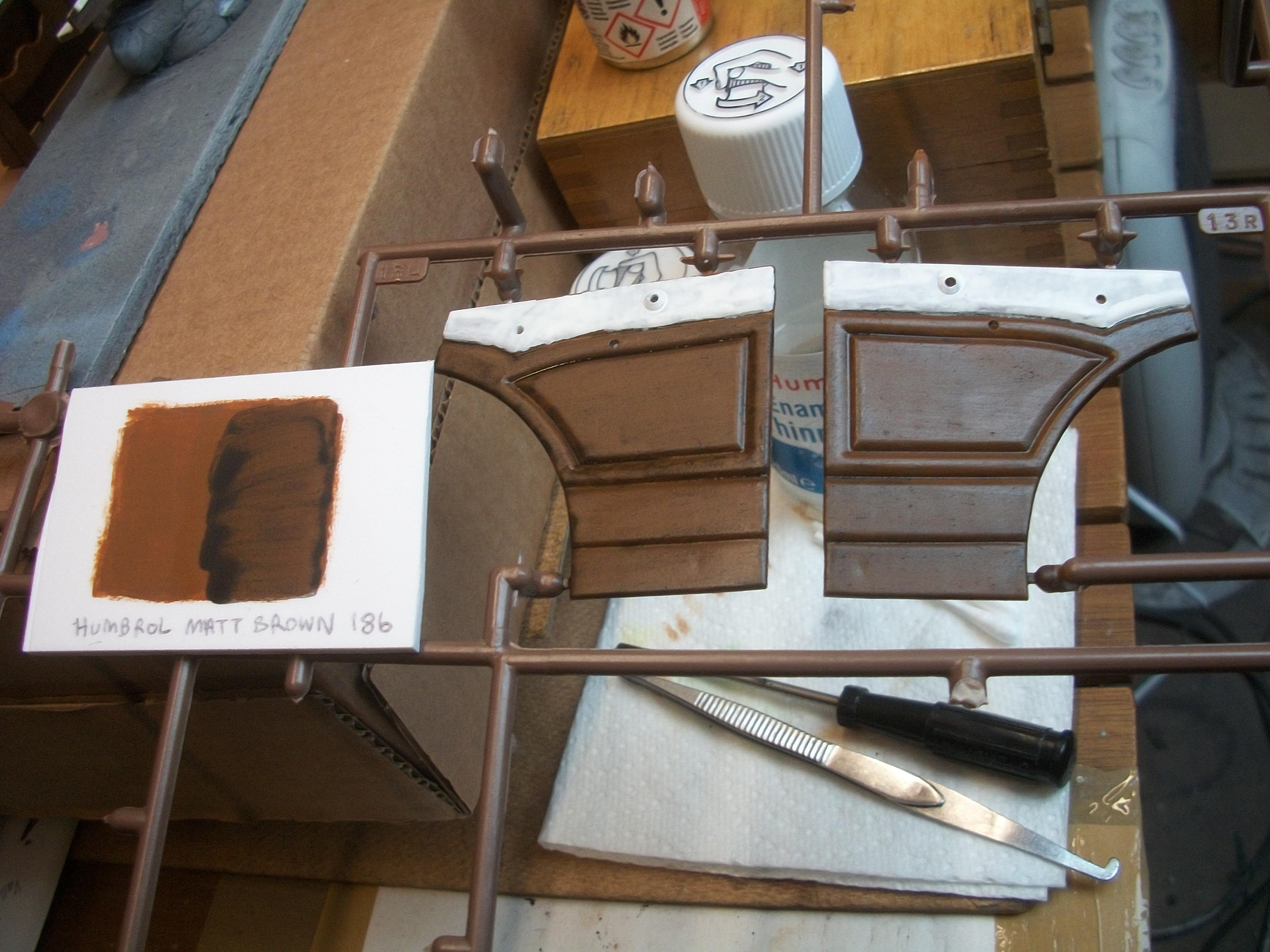

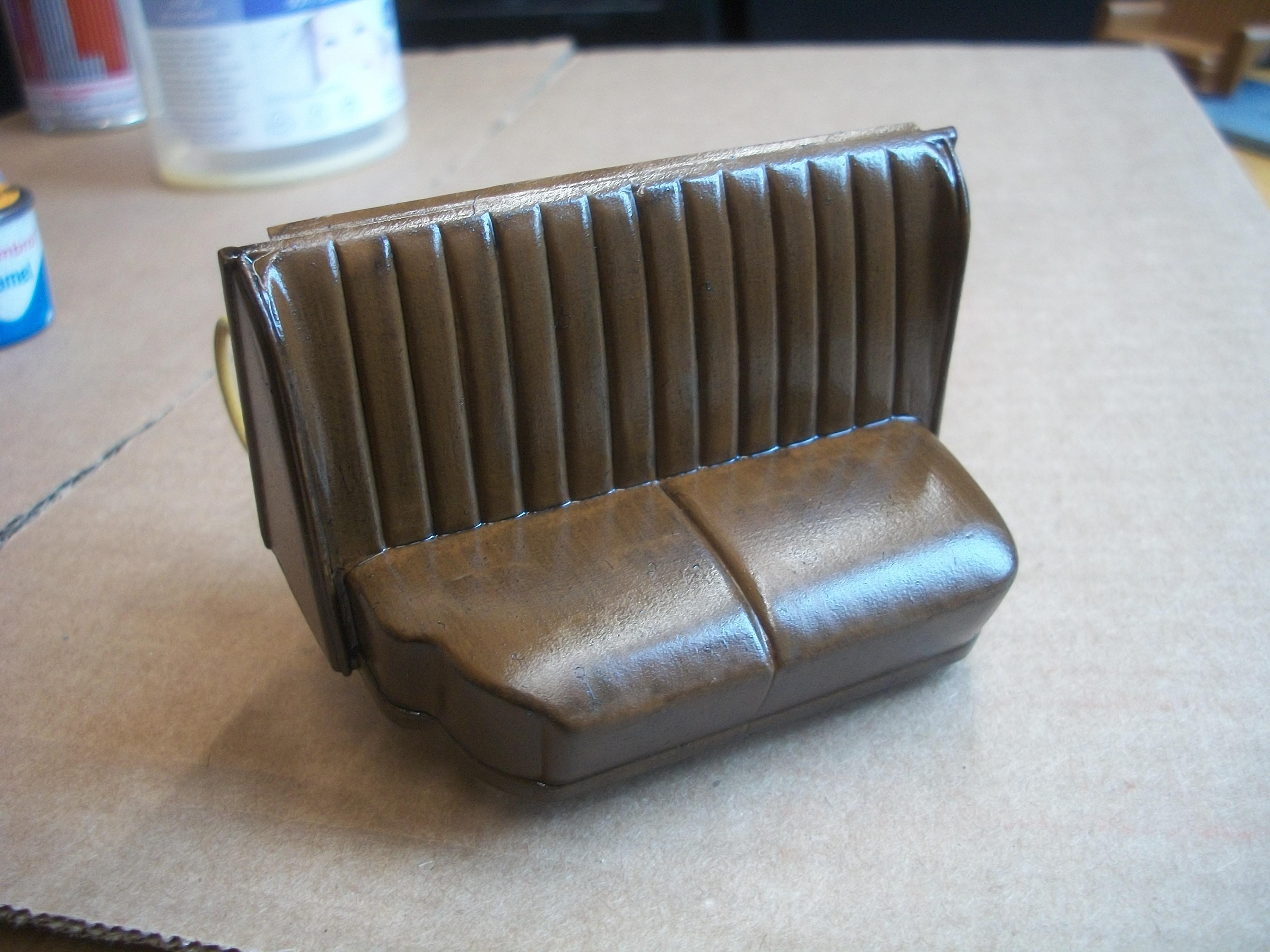

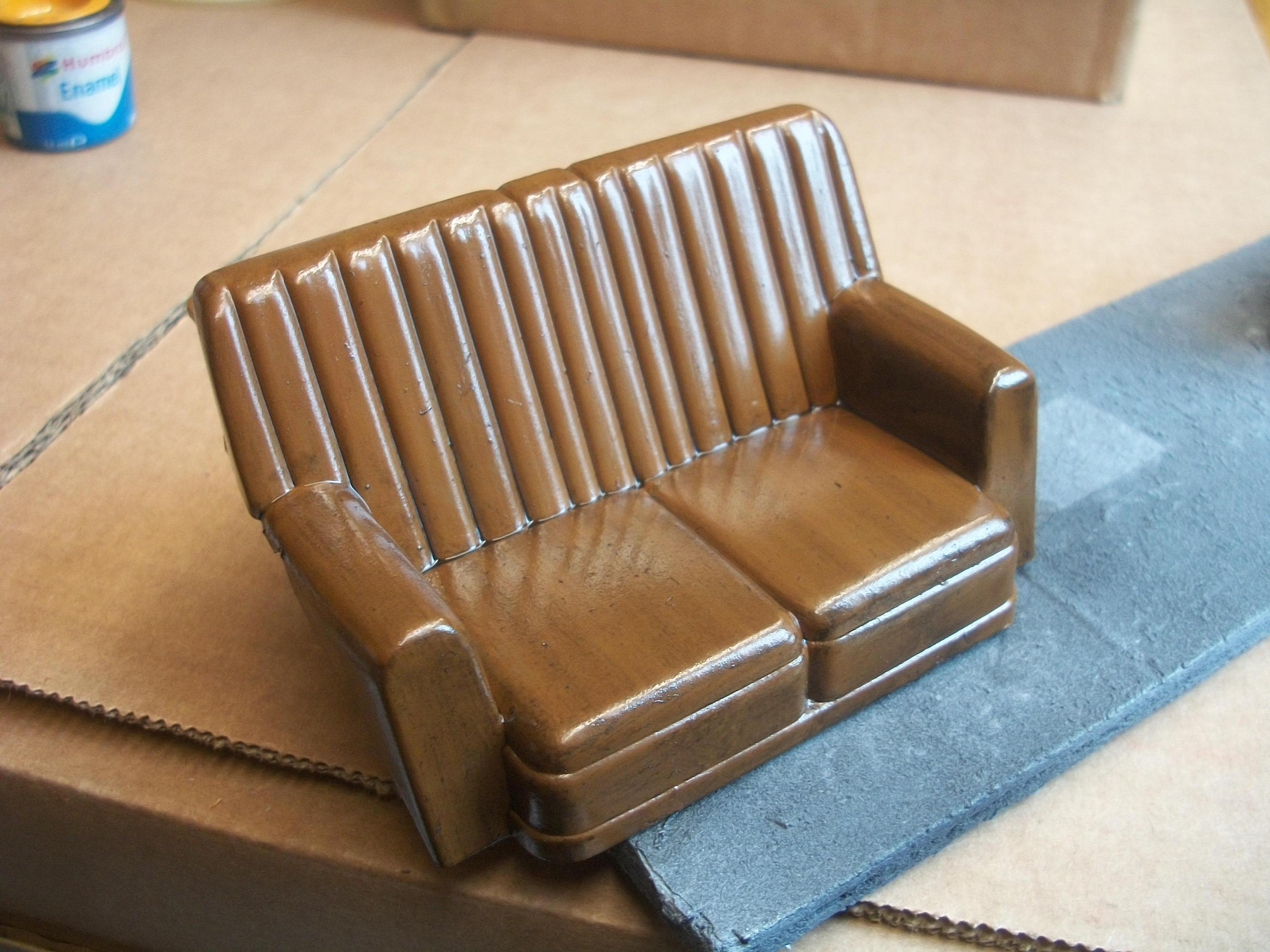

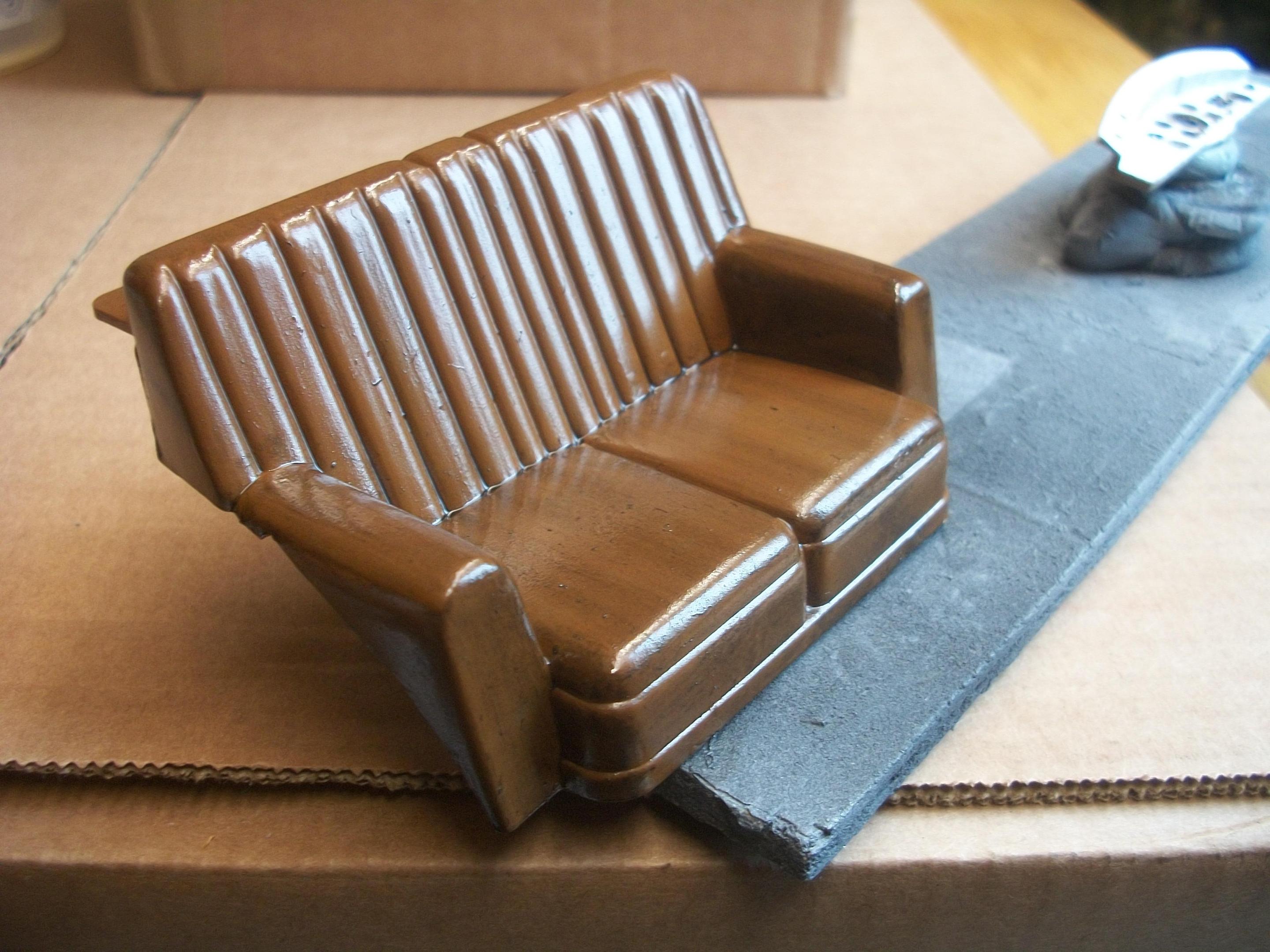

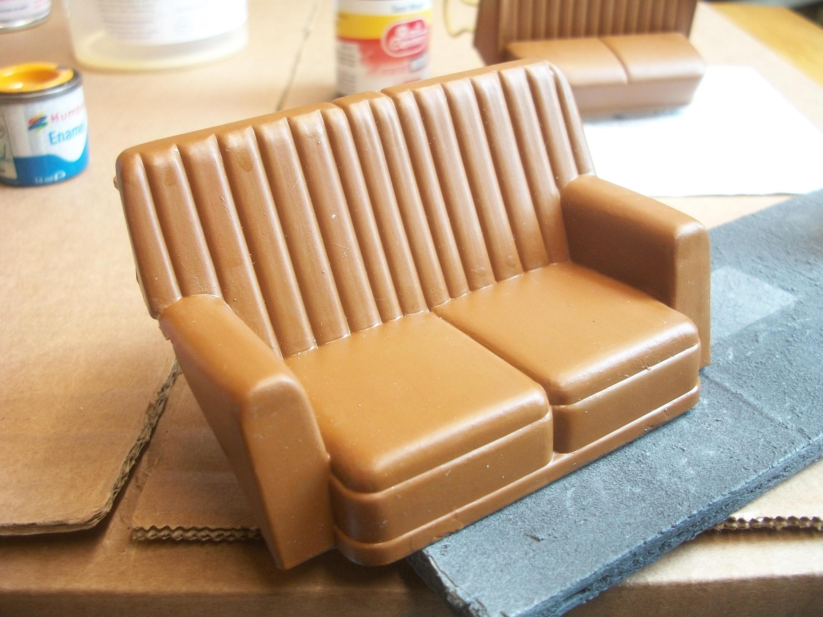

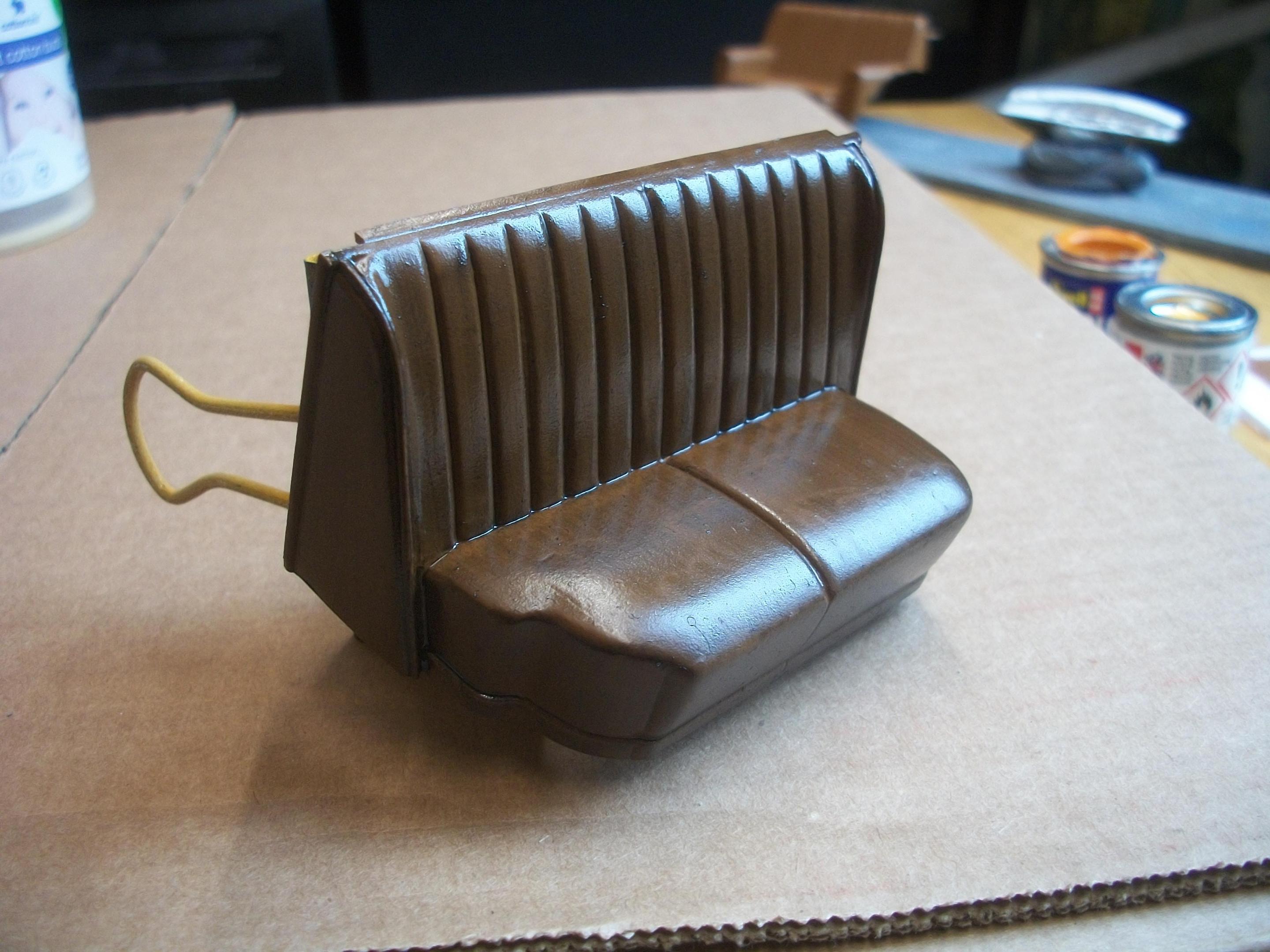

Today I made a point of focusing on the leather interior of the Phantom III, and put the other two jobs to one side, which were the burr walnut woodwork and the felt carpeting . . . The rear seat, front seat, lower division and the four interior lower door panels were given a coating of soot black enamel wash, and this has transformed the appearance of the leather surface. First of all, the matt brown colour is now darker, and also the black wash brings out the relief and texture.
The glossy appearance of the seats in particular is the exactly the look that I was after, but I suspect this will dry to a matt finish overnight. This is not a problem, as I can apply some Satin Cote enamel over the leather areas . . .
These photos show the before and after effect of using the black wash, with the first two photos being the untreated seats . . .
