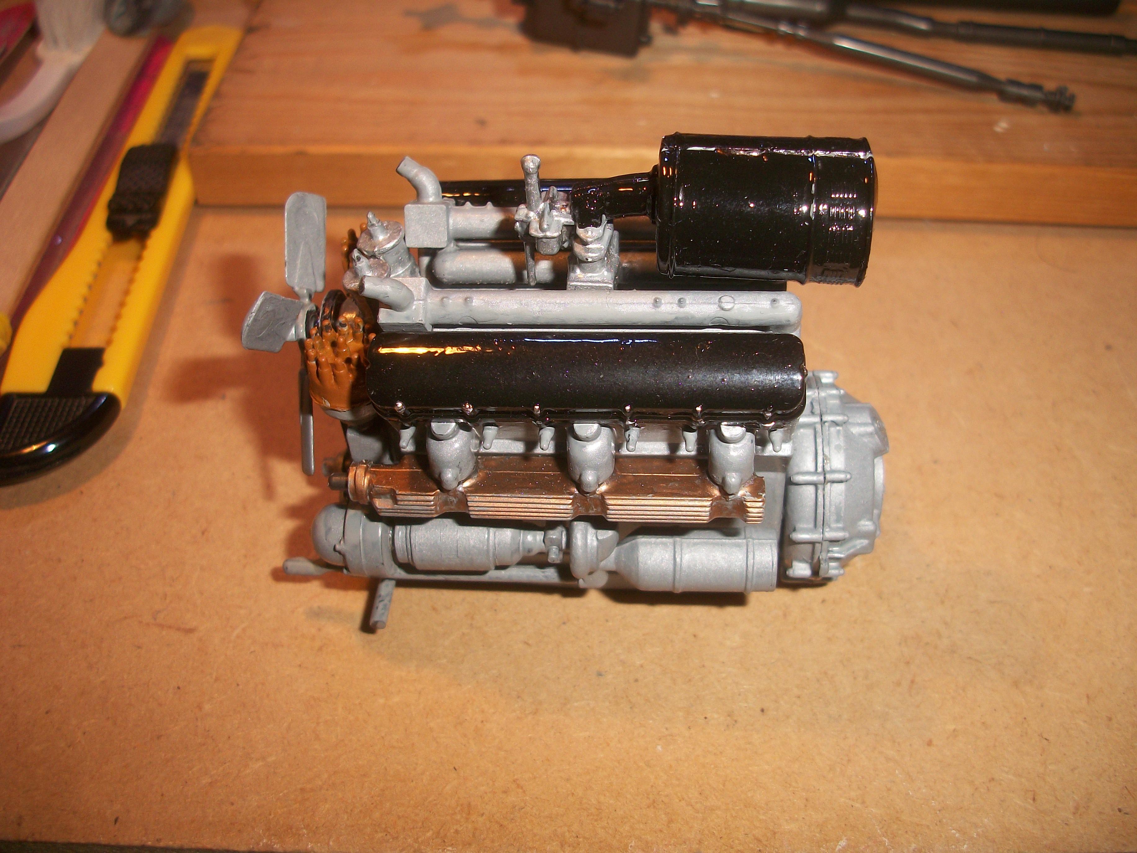

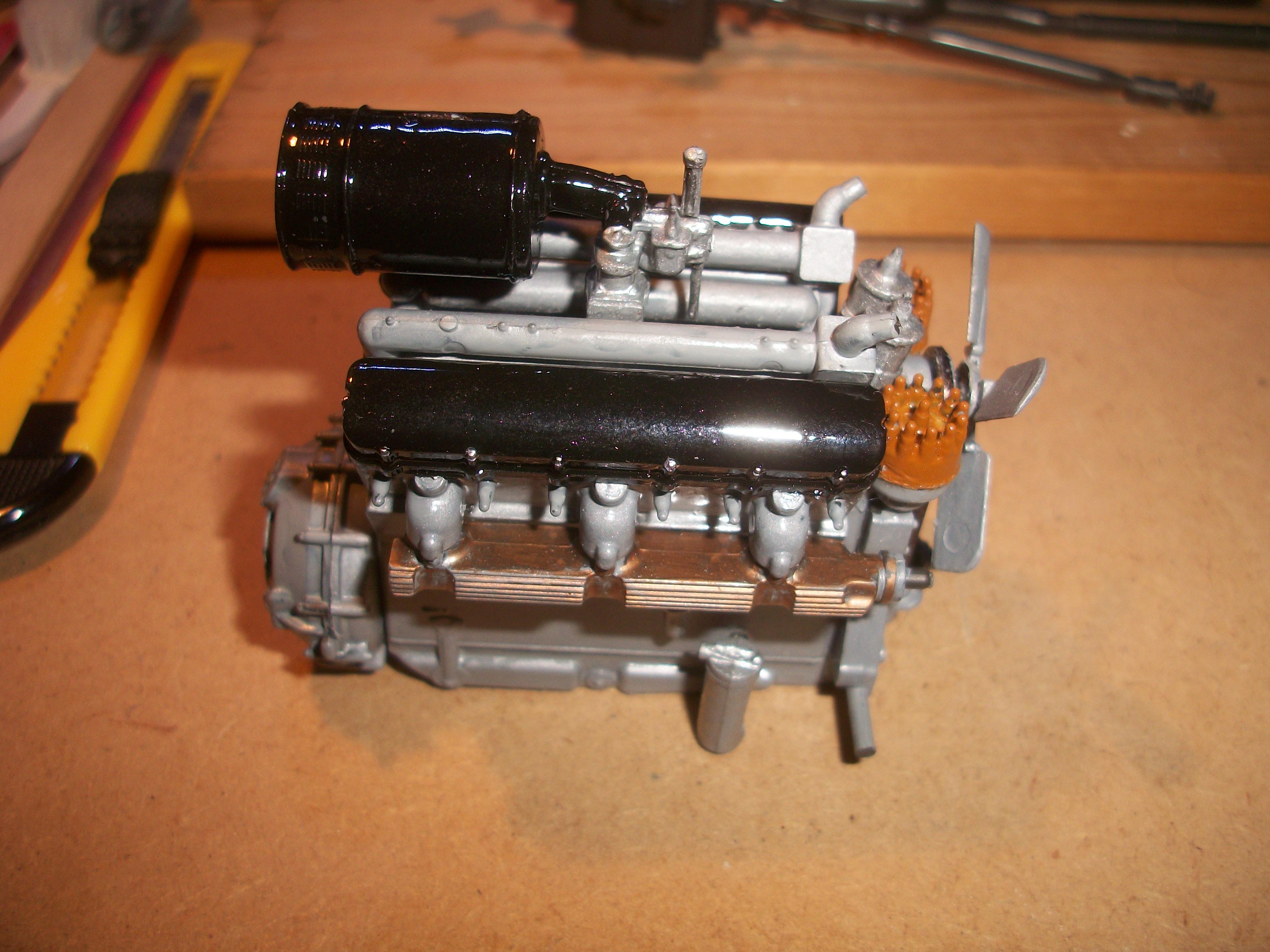

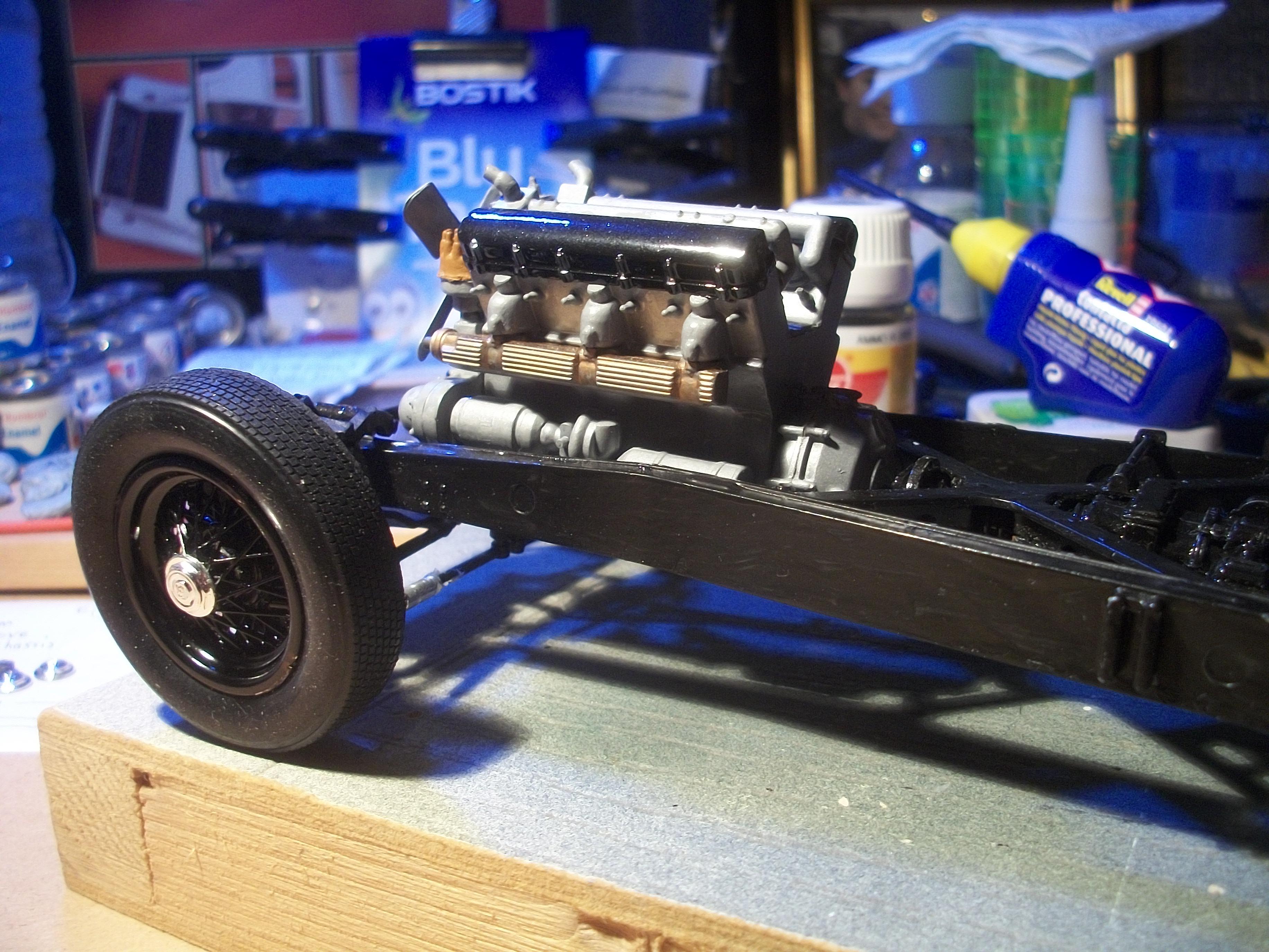

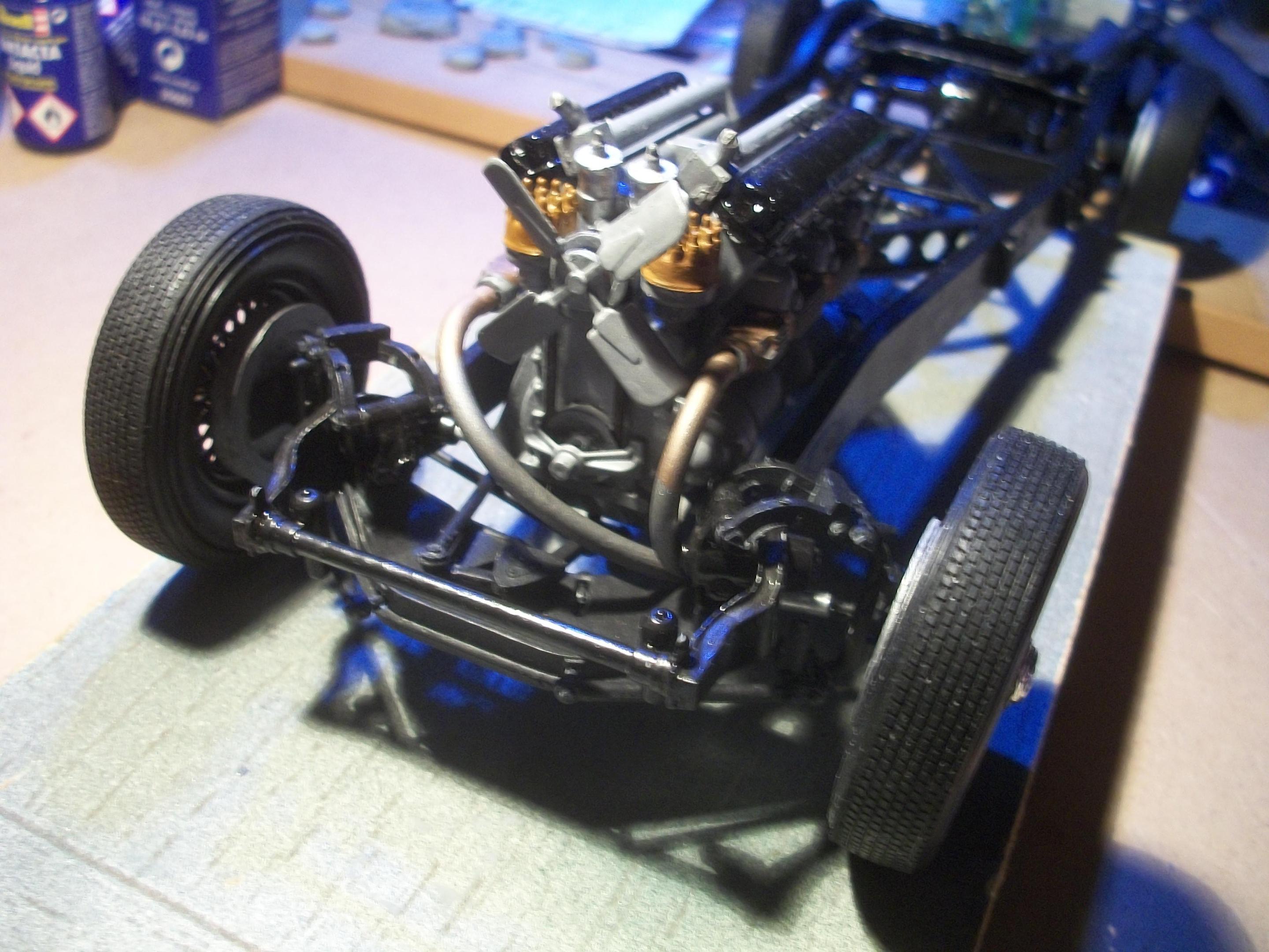

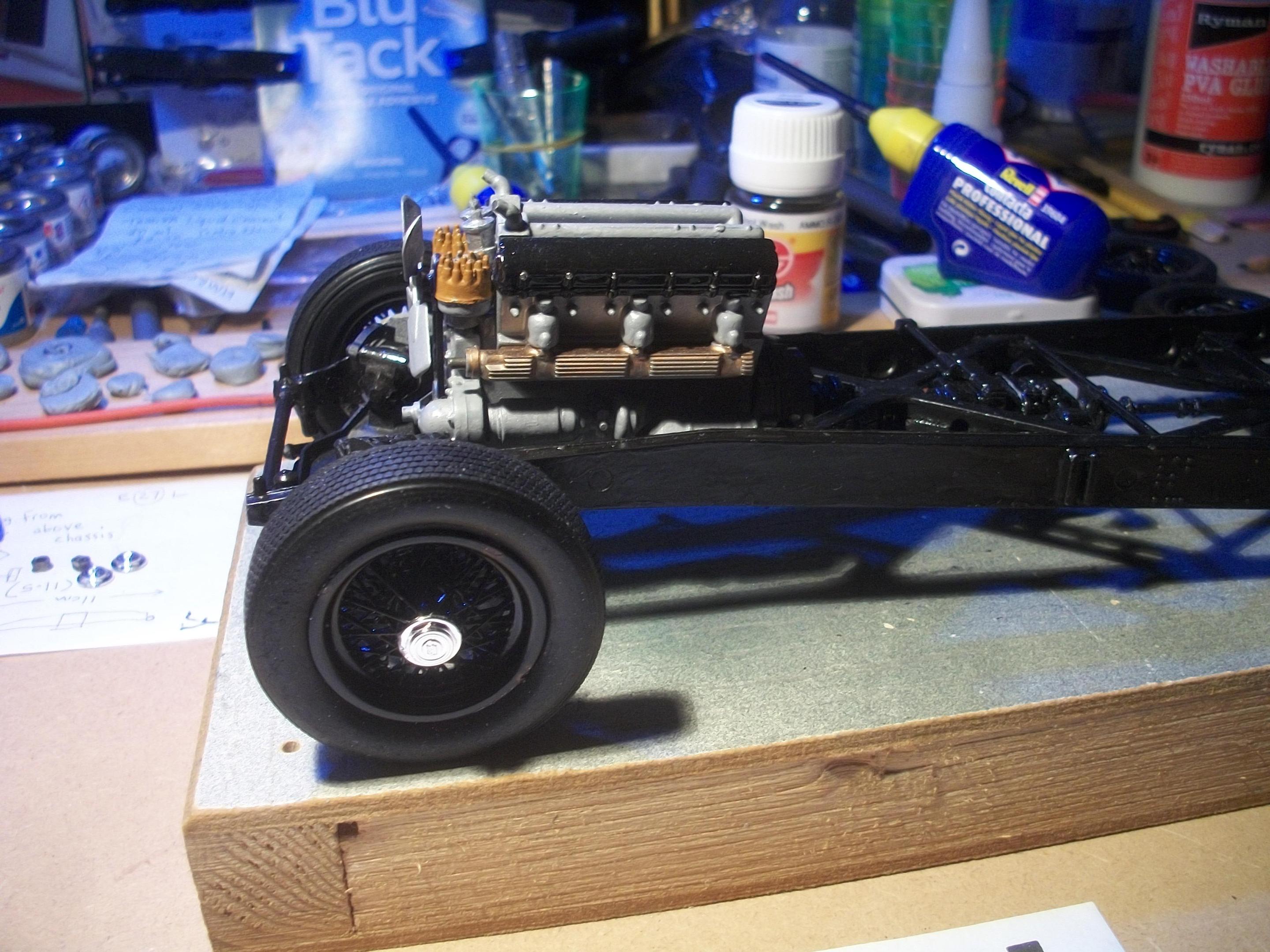

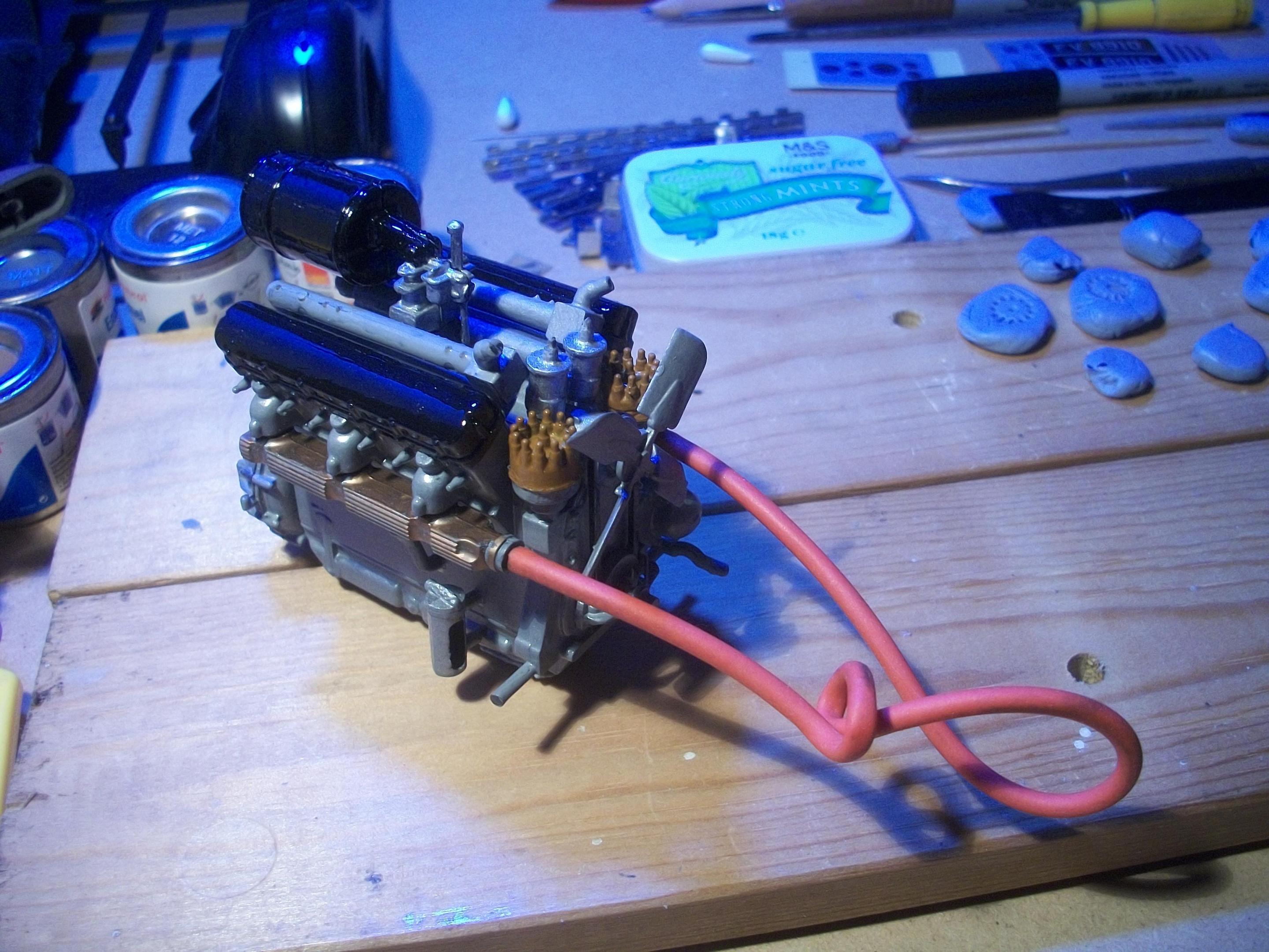

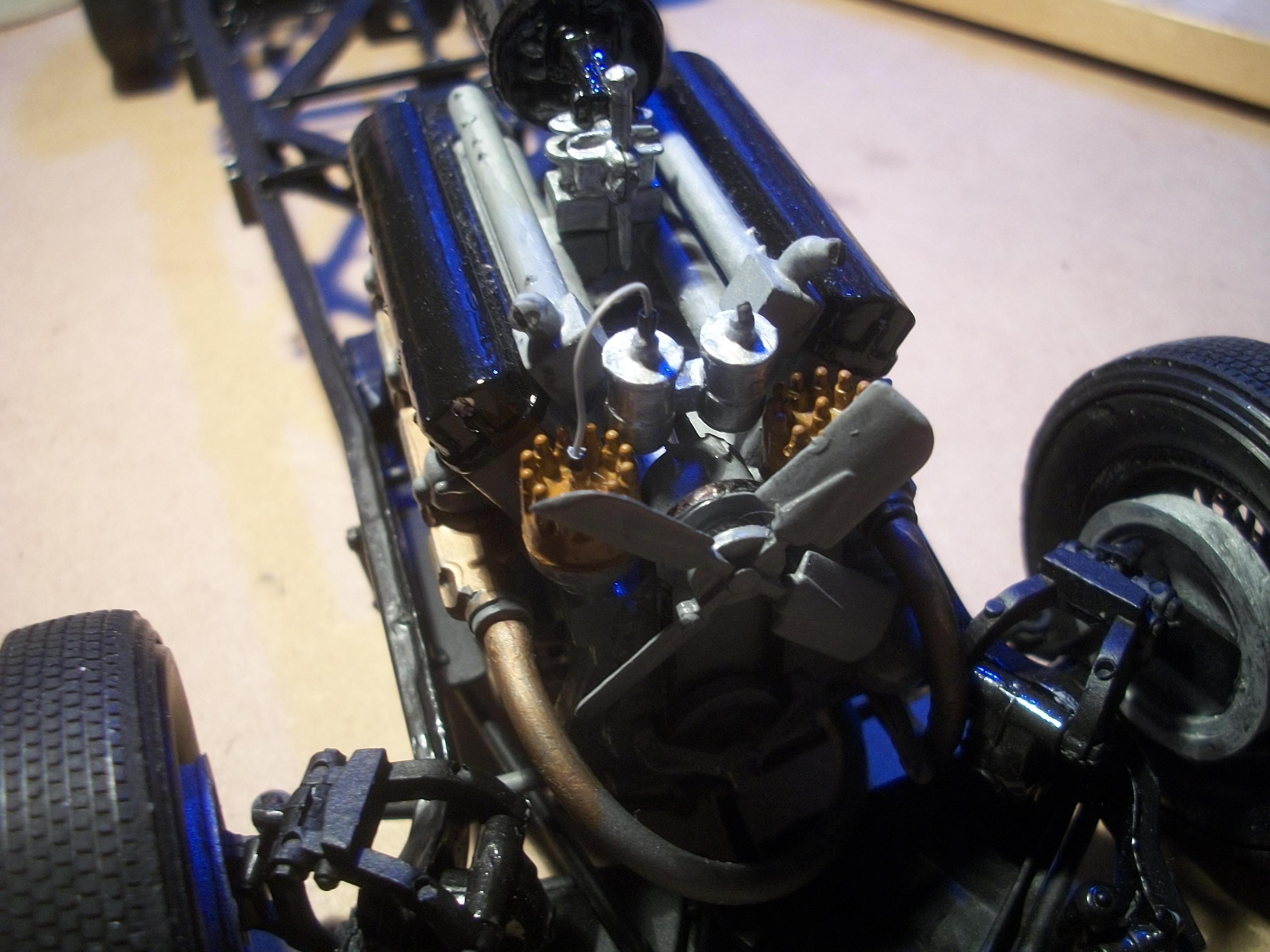

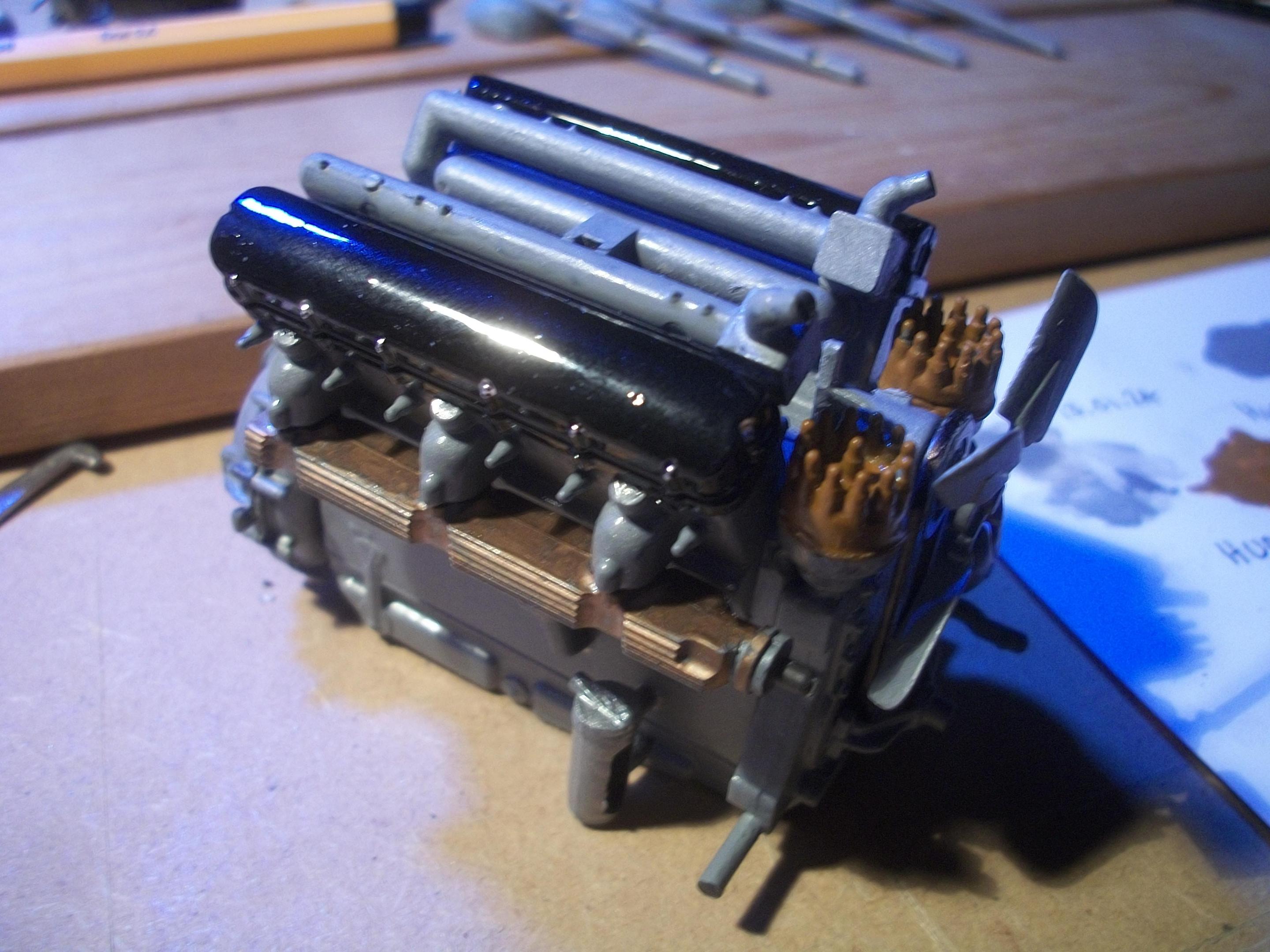

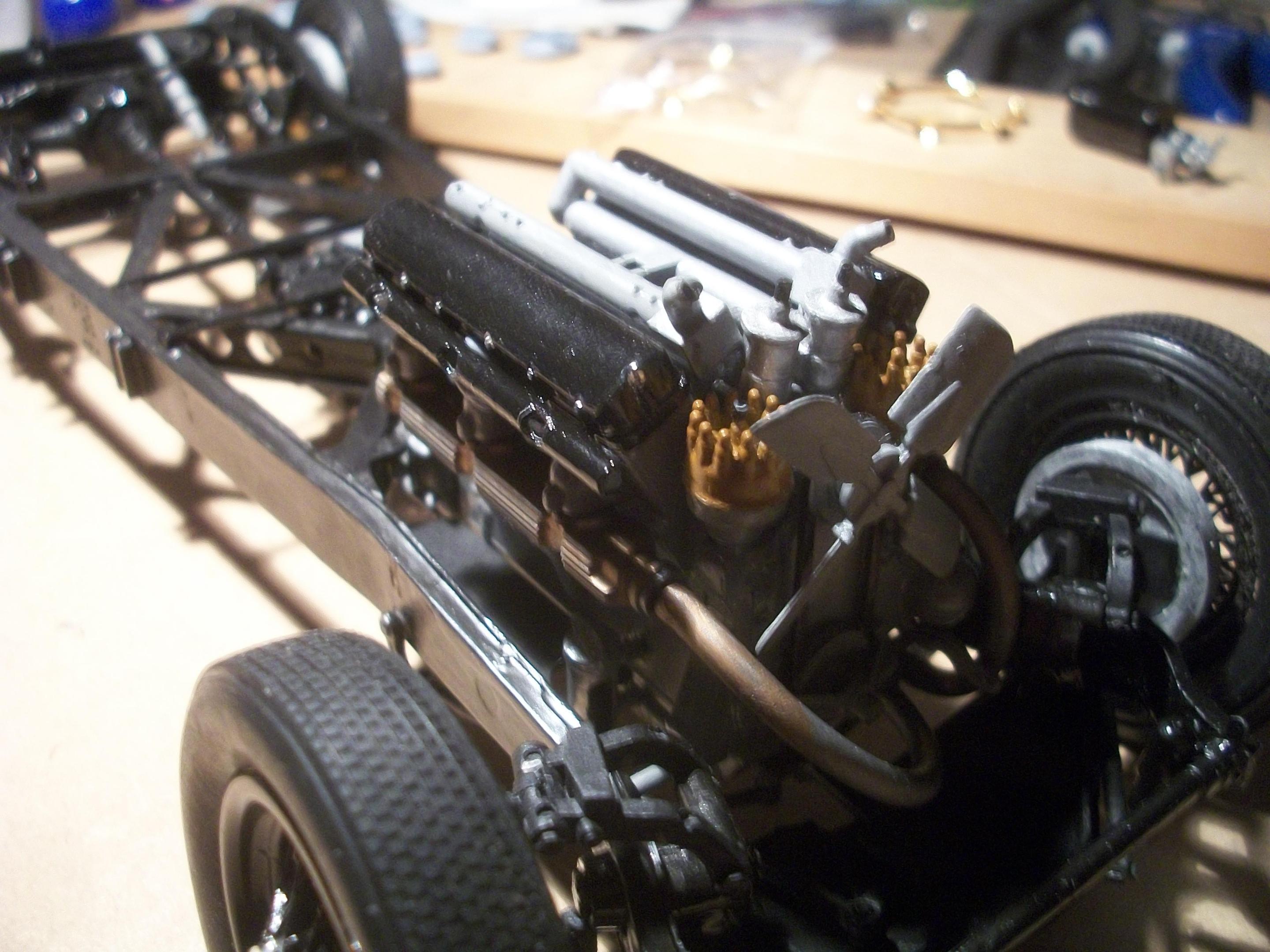

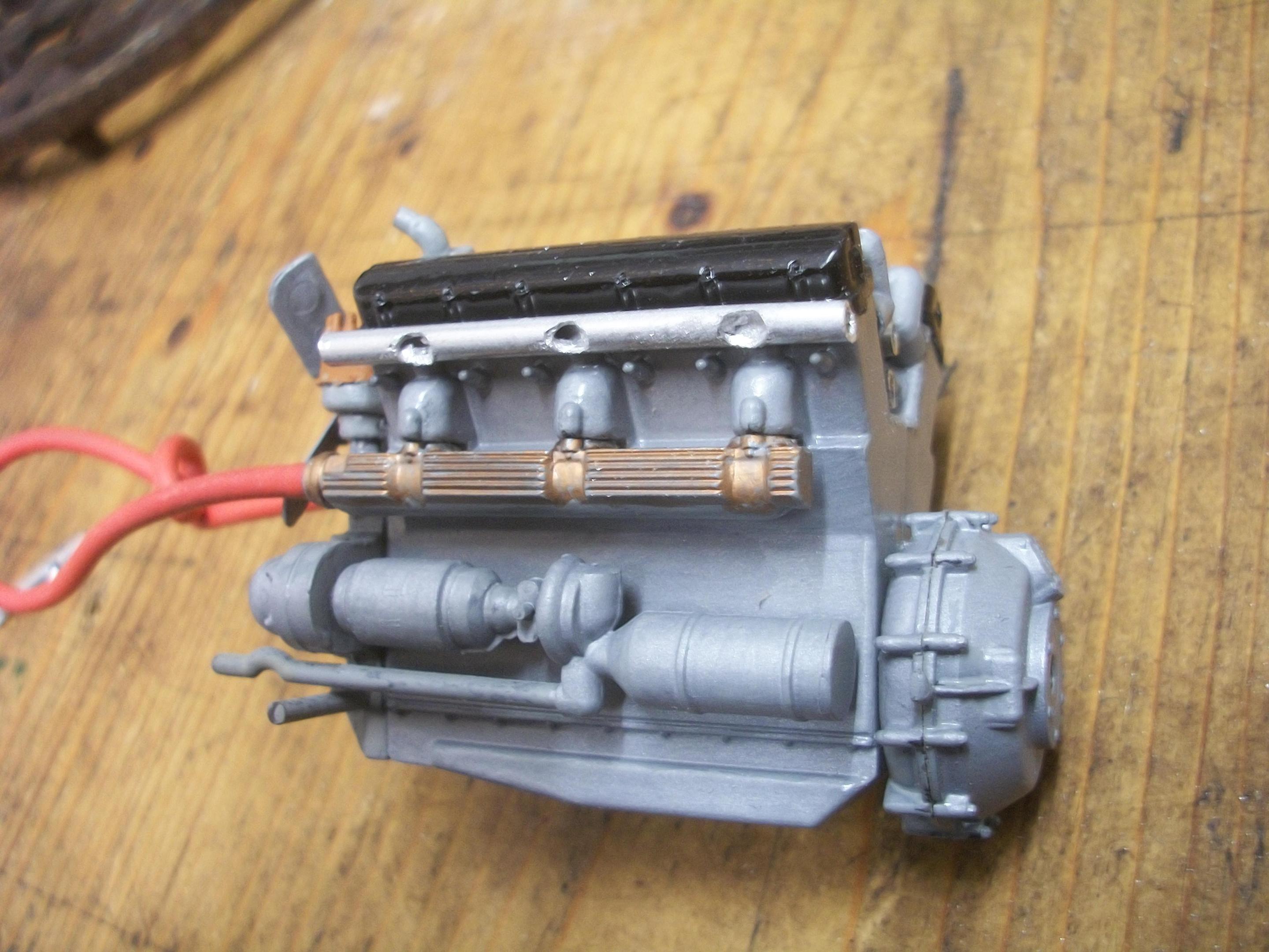

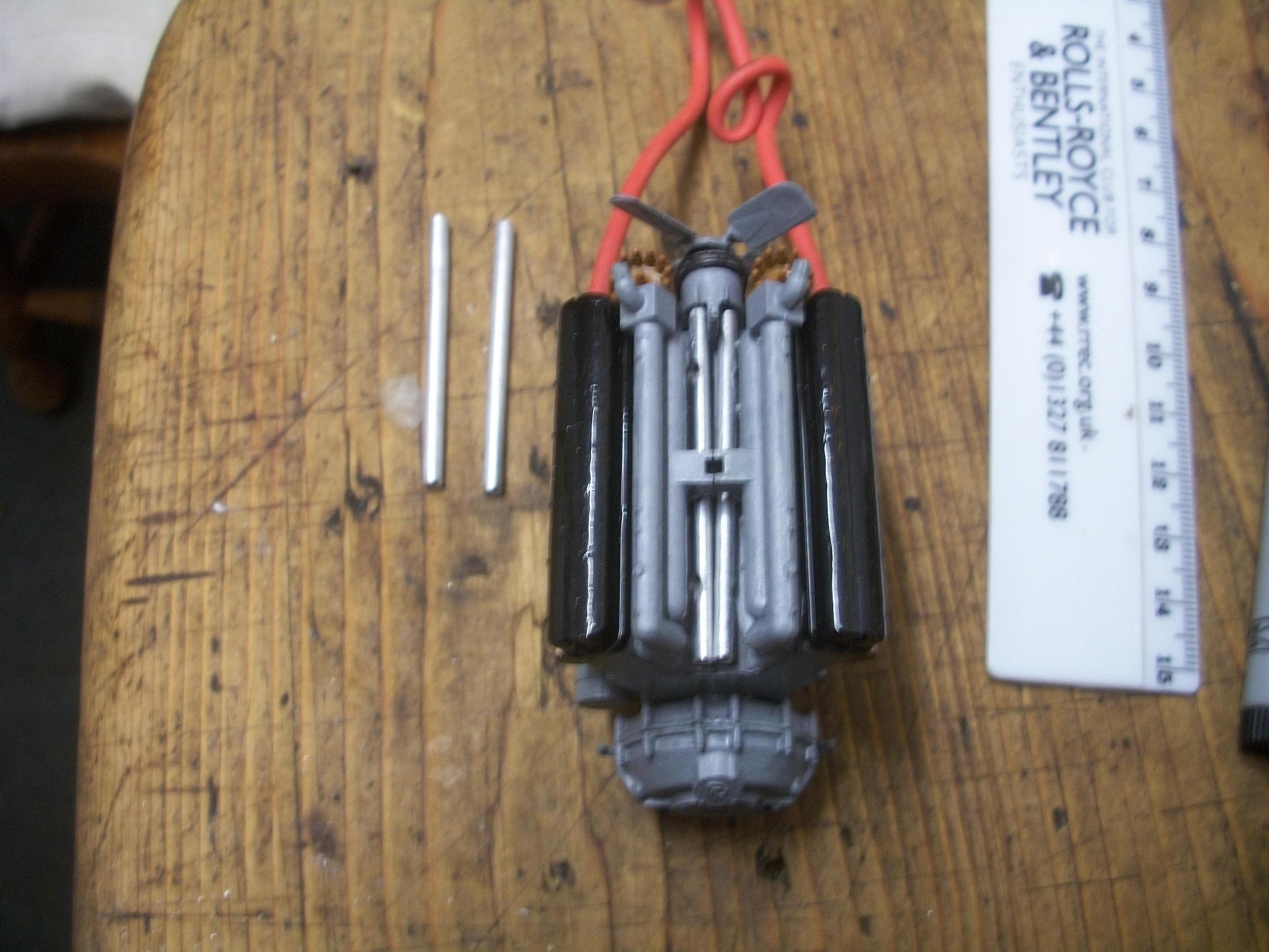

Anglia105E Posted February 6 Author Share Posted February 6 Here are some photos of the engine, which is not yet completed . . . The carburettor and air cleaner are mounted in position, but not yet glued in place. This is because I have fabricated two conduits and two tubes from aluminium material, and these will have to be fitted in the vee between the cylinder heads, and also along the outside of the cylinder heads . . . There are twelve ignition plug leads running from the distributors and then routed through the two aluminium conduits, with a further twelve plug leads routed through the two tubes. All the leads end up at the spark plugs of course, and there are the two inition leads as well. According to the Gunze Sangyo instruction sheet, those two lengths of red rubber piping should be connected to the front end of the two exhaust manifolds, and these are then connected to the front pipes of the exhaust system underneath. Surely this rubber piping will need to be painted in burnt iron or similar? At the moment, none of the suppliers in the UK have any ignition plug lead material available in 0.4 mm size, so I have moved on to the assembly and painting of the chassis . . . The engine can be worked on later, and there is no need to hold up the progress of the build. I managed to source the three Tamiya paints that I shall need, from an Ebay seller that does have stock. These are Tamiya Surface Primer Light Gray, TS-14 Black and TS-7 Racing White . . . The TS-14 Black is very difficult to obtain currently. The V12 engine block is finished in aluminium enamel, with gloss black enamel rocker covers and air cleaner, while the exhaust manifolds are done with bronze Sharpie over aluminium enamel. The conduits and tubing for the plug leads will also be gloss black enamel. My next post will show the construction of the chassis, transmission, propshaft and rear axle, which is now at an advanced stage. David 2 Quote Link to comment Share on other sites More sharing options...
David G. Posted February 8 Share Posted February 8 Nice work so far on the engine David. I think connecting all those wires would drive me buggy. I believe I'd rather foil the chrome trim on a '59 Chrysler Imperial! David G. Quote Link to comment Share on other sites More sharing options...
Anglia105E Posted February 8 Author Share Posted February 8 4 minutes ago, David G. said: Nice work so far on the engine David. I think connecting all those wires would drive me buggy. I believe I'd rather foil the chrome trim on a '59 Chrysler Imperial! David G. Thank you David G., and certainly the wiring is going to be challenging . . . Most of the wires are hidden from sight, as they are inside the metal tubes, so only a small amount of wiring is actually visible when the engine is completed. I take your point about the BMF on a '50s American motor car, and that would be my preference also ! The Phantom III chassis is not too far away from becoming a rolling chassis, and the front suspension was looking good last night. This is known to be very challenging, as mentioned by a skilled model builder on a different forum. What makes the suspension / steering assembly particularly difficult and frustrating is that the Gunze Sangyo instruction sheet shows left and right in one diagram, but then turns the chassis over and consequently left becomes right and right becomes left ! One minute you are looking at the chassis from inside the car as it were, then the next minute you are looking at the underside of the chassis, which also means top becomes bottom and upper becomes lower . . . Despite my extremely careful orientation of the suspension and steering parts, I discovered that I had got the wishbone arms on the wrong sides . . . This was easily rectified as it happens because the link rods are clipped into holes and not glued. I am hoping to post photos on here of the chassis WIP very shortly . . . David W. Quote Link to comment Share on other sites More sharing options...

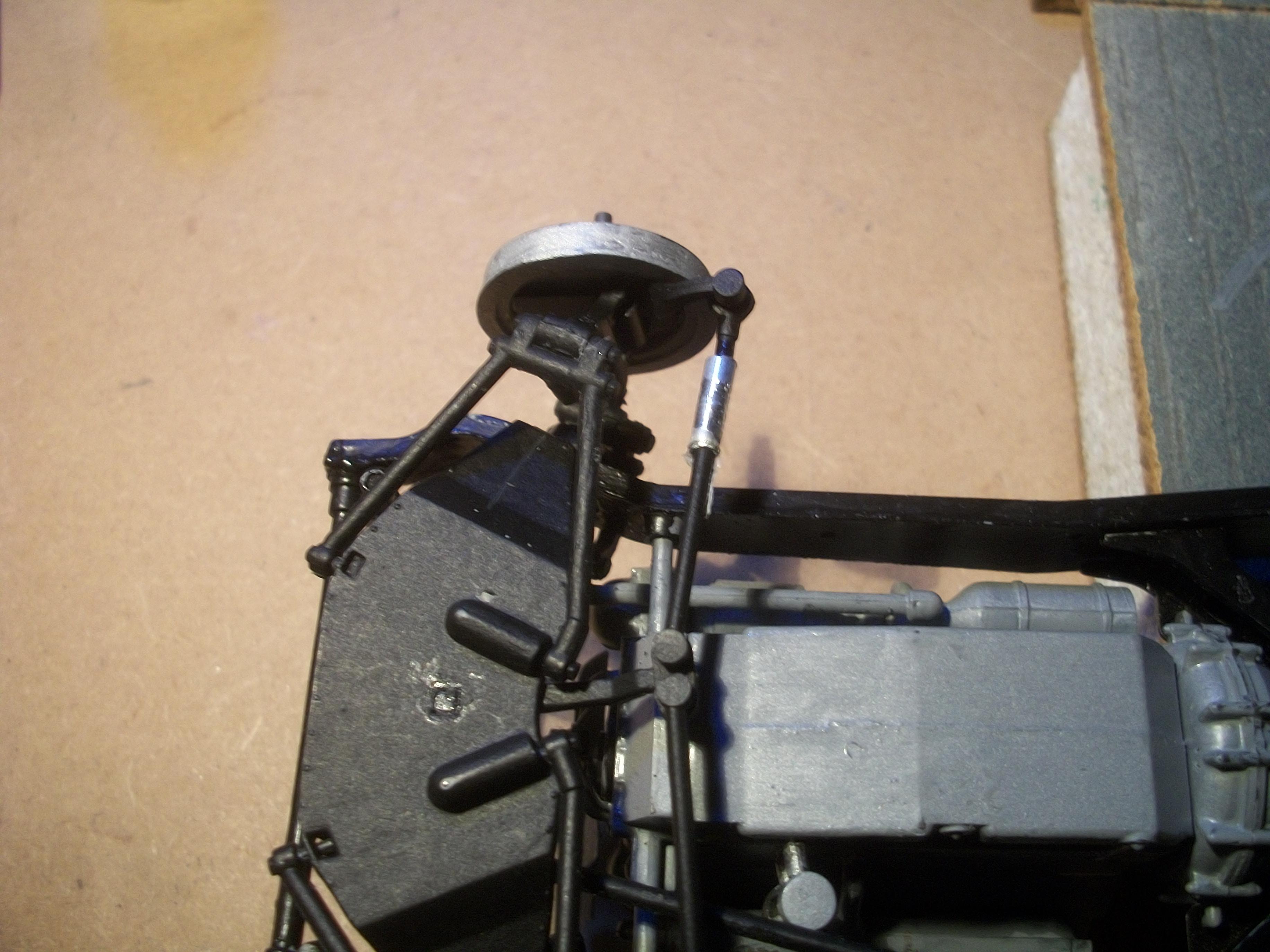

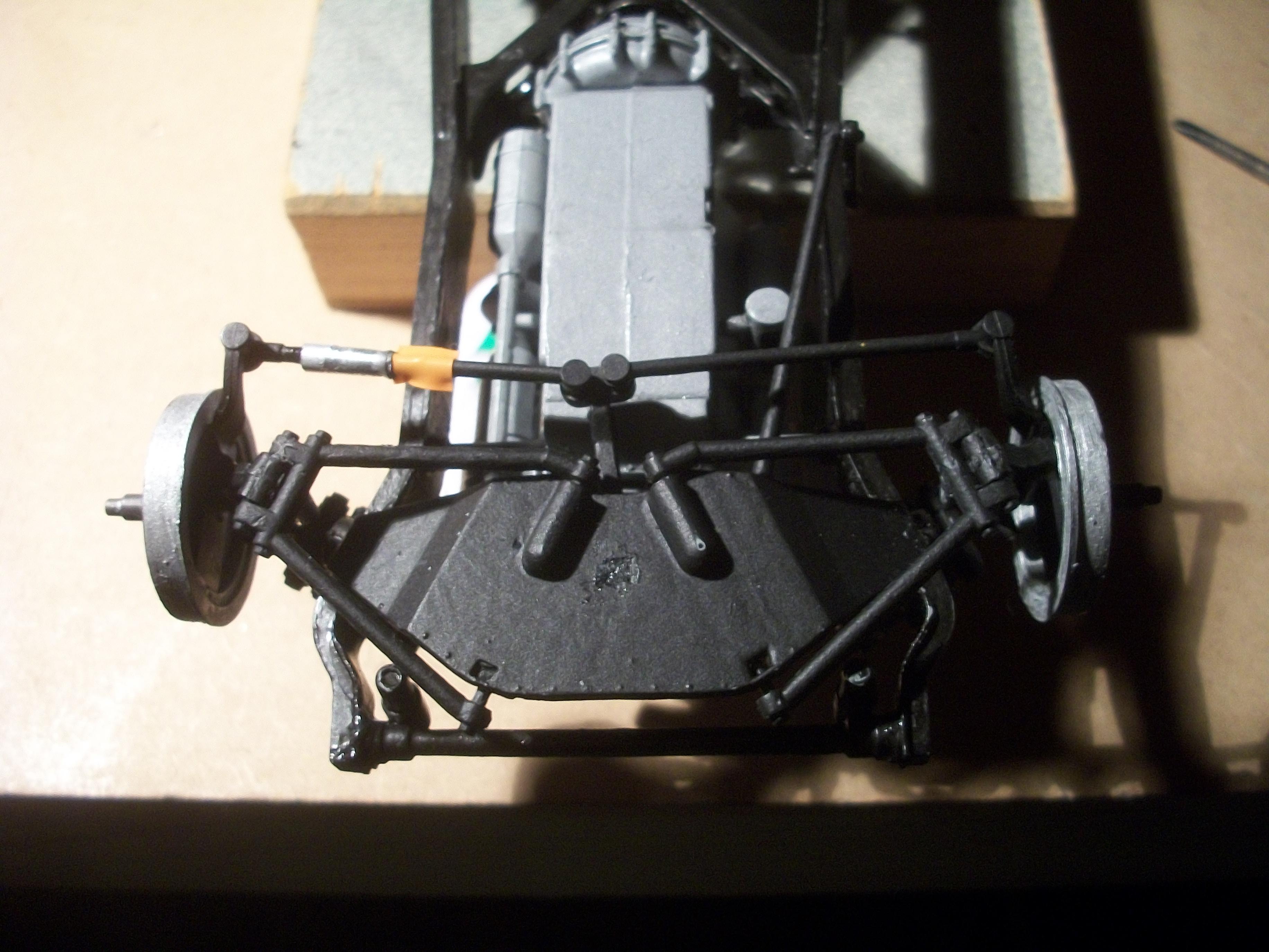

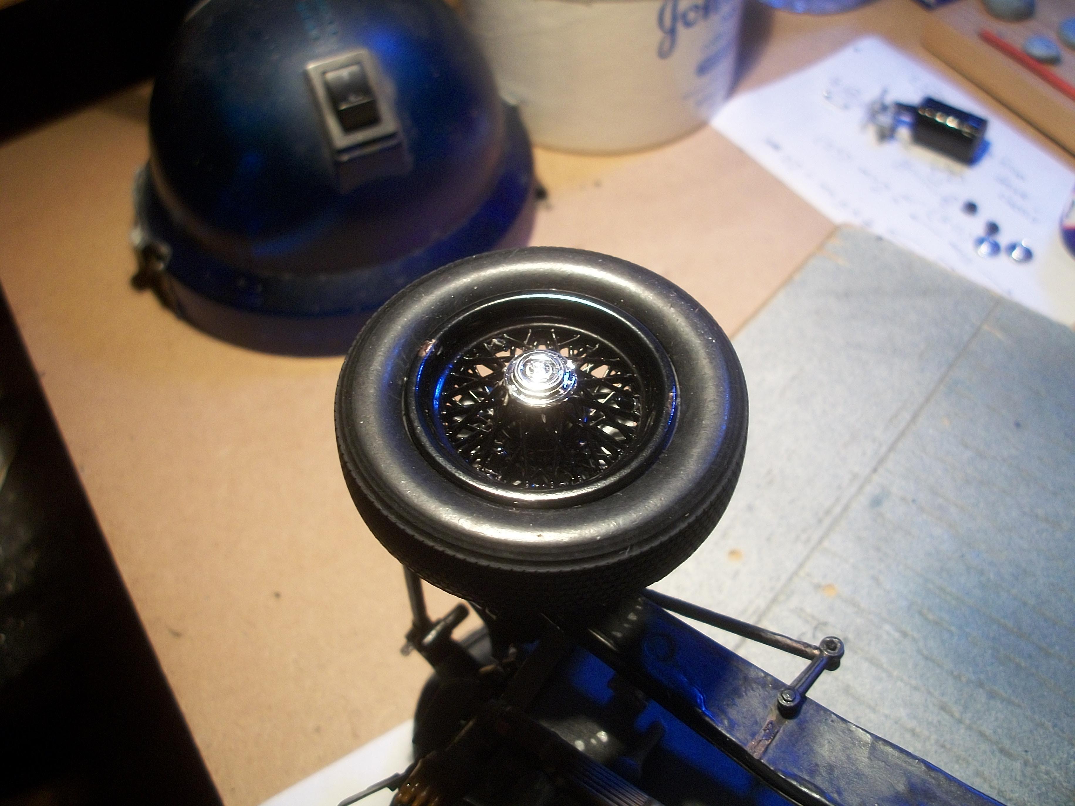

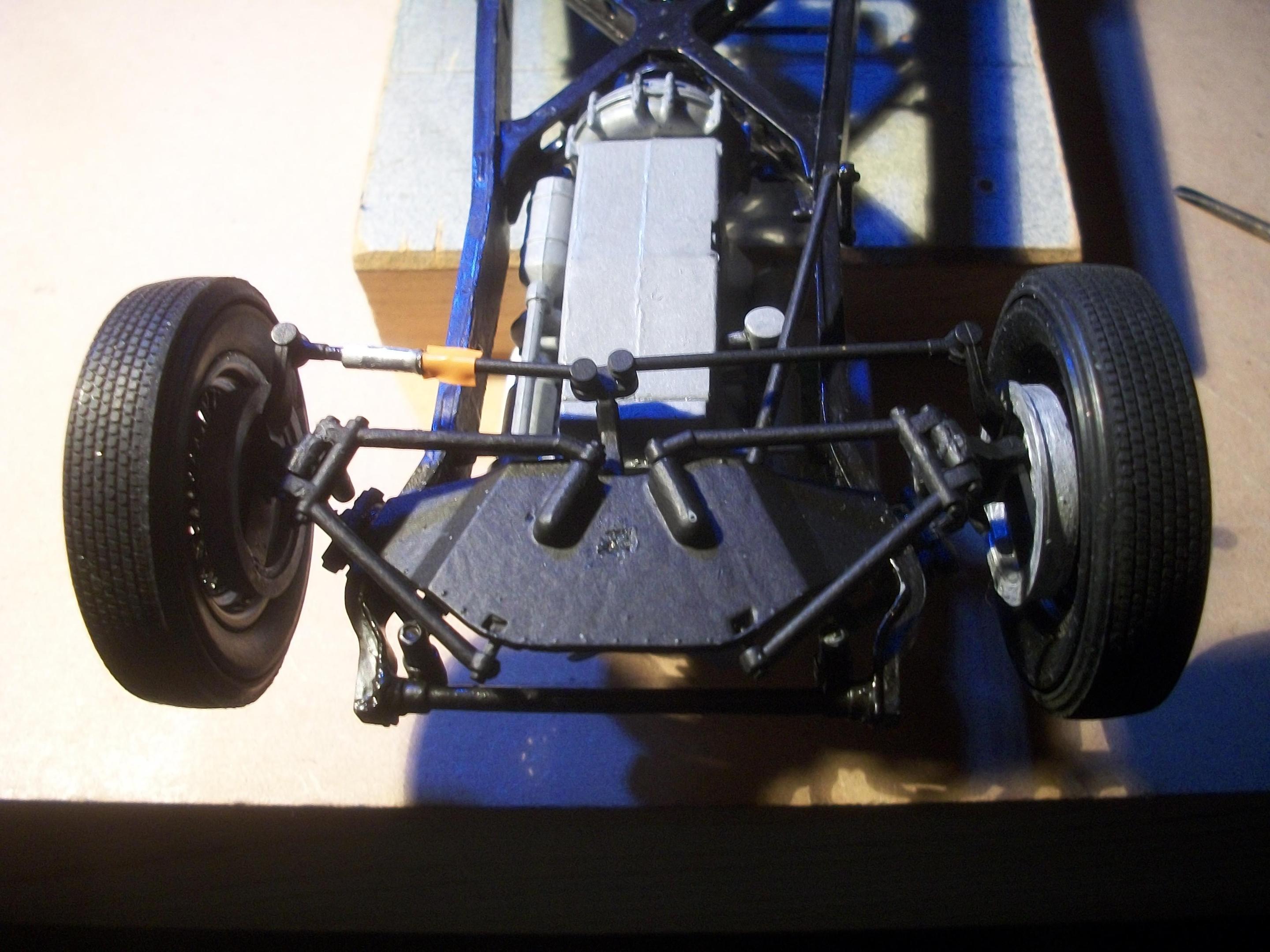

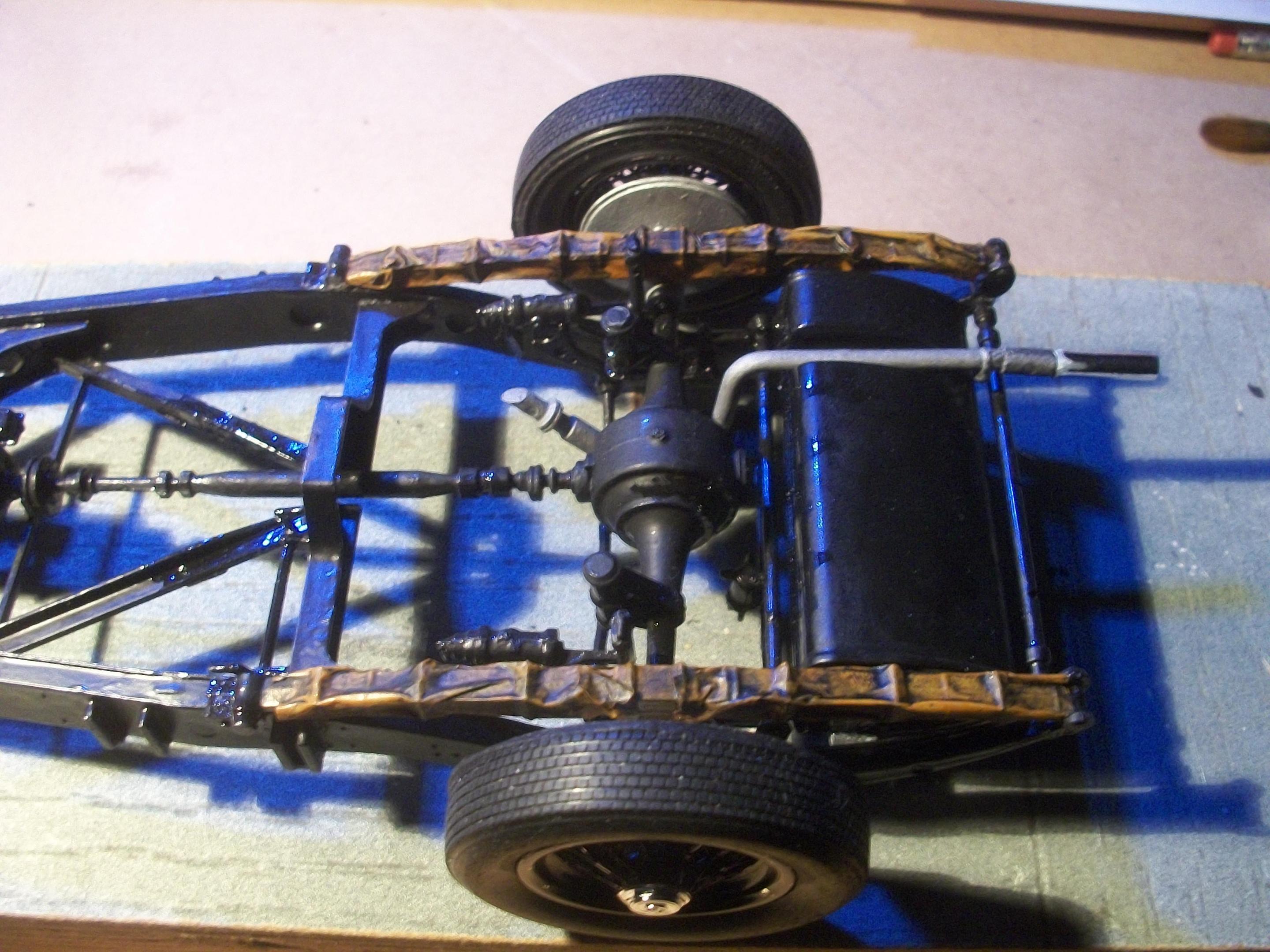

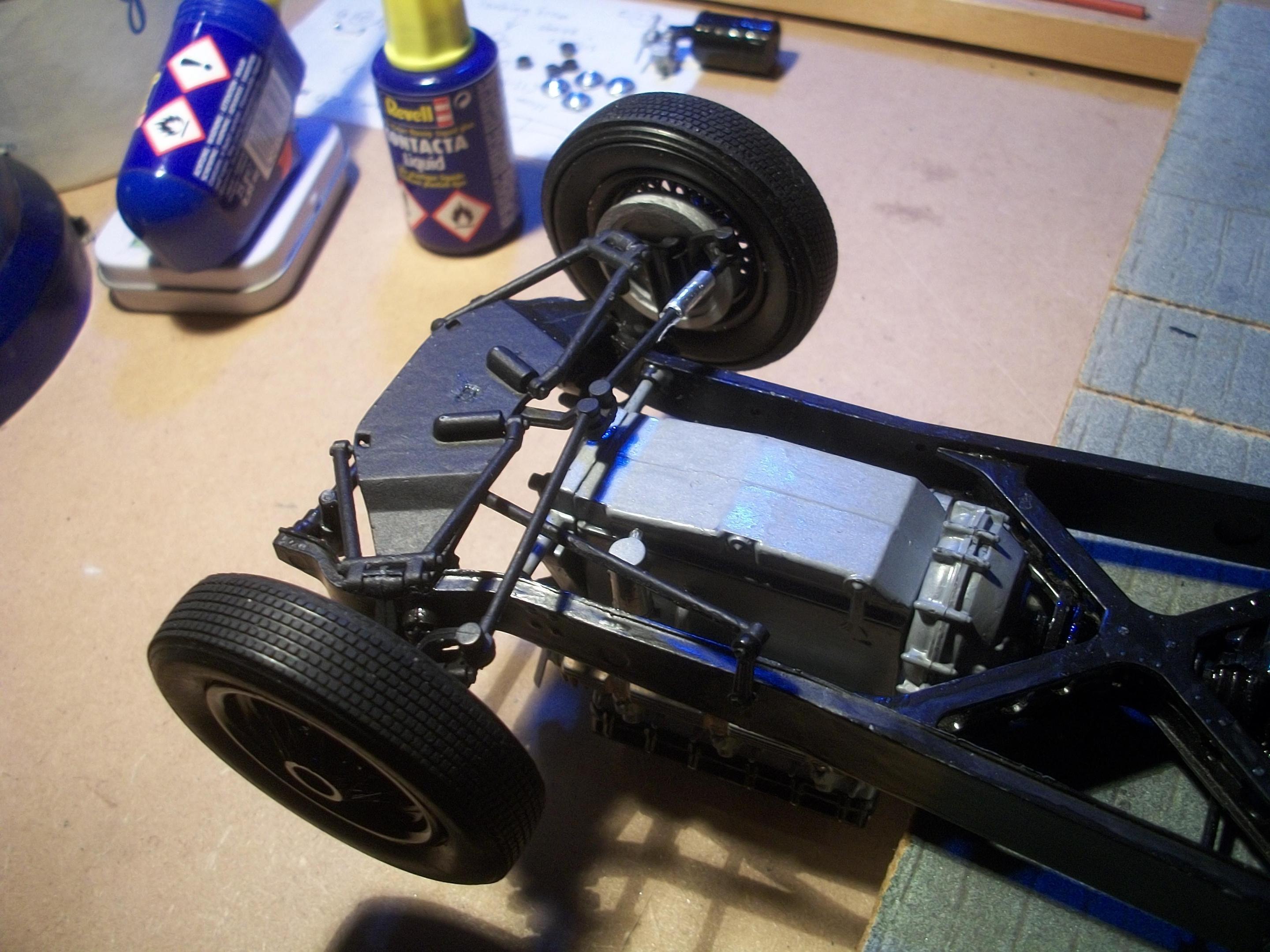

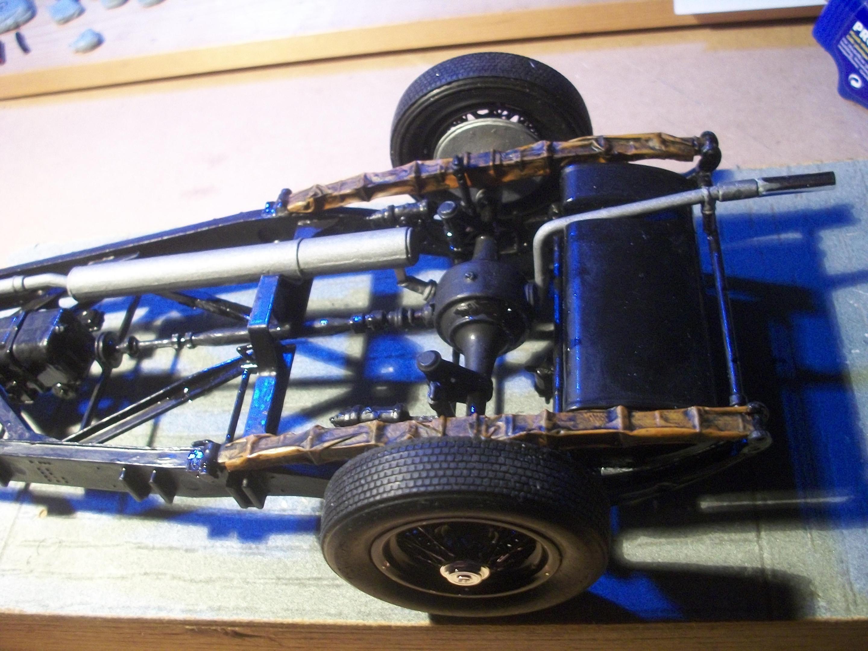

Anglia105E Posted February 14 Author Share Posted February 14 The paint seemed to go on well during a weather window of 13°C temps, despite the fact that I did not remove the chrome from the wheels using Oven Cleaner . . . I was worried about the effect the aggressive chemical might have on this 40 year old plastic, to be honest. So this means I applied Tamiya grey primer over chrome, then Tamiya black over the primer . . . As you can guess, this forces me to be extra careful handling the parts, as the paint is easily rubbed off. By Thursday of this week I shall have a rolling chassis, which is pretty good for only 5 weeks into the build. The front wheels, brake drums, hub nuts and hub washers are in place, and the steering is fully functioning. I discovered that the front wheels were not parallel, and as there didn't seem to be a way of adjusting the turning in of the wheel on one side, I came up with a clever idea . . . I cut the track rod on one side with sprue cutters, then I removed a further 2 mm of material from the track rod nearest the centre of the chassis, and then I fabricated a 10 mm length of aluminium tubing. The two ends of the track rod were glued inside either end of the tubing, and with the wheels parallel, the idea has actually worked ! David 2 Quote Link to comment Share on other sites More sharing options...
David G. Posted February 14 Share Posted February 14 The chassis looks great so far! Clever indeed your solution to the toe-in problem. Maybe they should have made the kit with adjustable tie rod ends. In 1/16 scale, it could be done! David G. Quote Link to comment Share on other sites More sharing options...
Anglia105E Posted February 14 Author Share Posted February 14 5 hours ago, David G. said: The chassis looks great so far! Clever indeed your solution to the toe-in problem. Maybe they should have made the kit with adjustable tie rod ends. In 1/16 scale, it could be done! David G. Pleased to hear that you like the look of the chassis so far David, and I am happy with the appearance of the structure. While the strength of the overall chassis is good, I have to say that the method of attaching both front and rear wheels as designed by, engineered by Gunze Sangyo is not the best. I would have liked this stub axle arrangement to be significantly stronger, and it just seems rather weak at this point. Funny that you should suggest having adjustable tie rod ends (or track rod ends if you like), because that thought was running through my mind as I was putting together my amateur modification. Certainly, you could have tie rod ends that turn in 1:16 scale, as they might in 1:12 scale. David W. Quote Link to comment Share on other sites More sharing options...

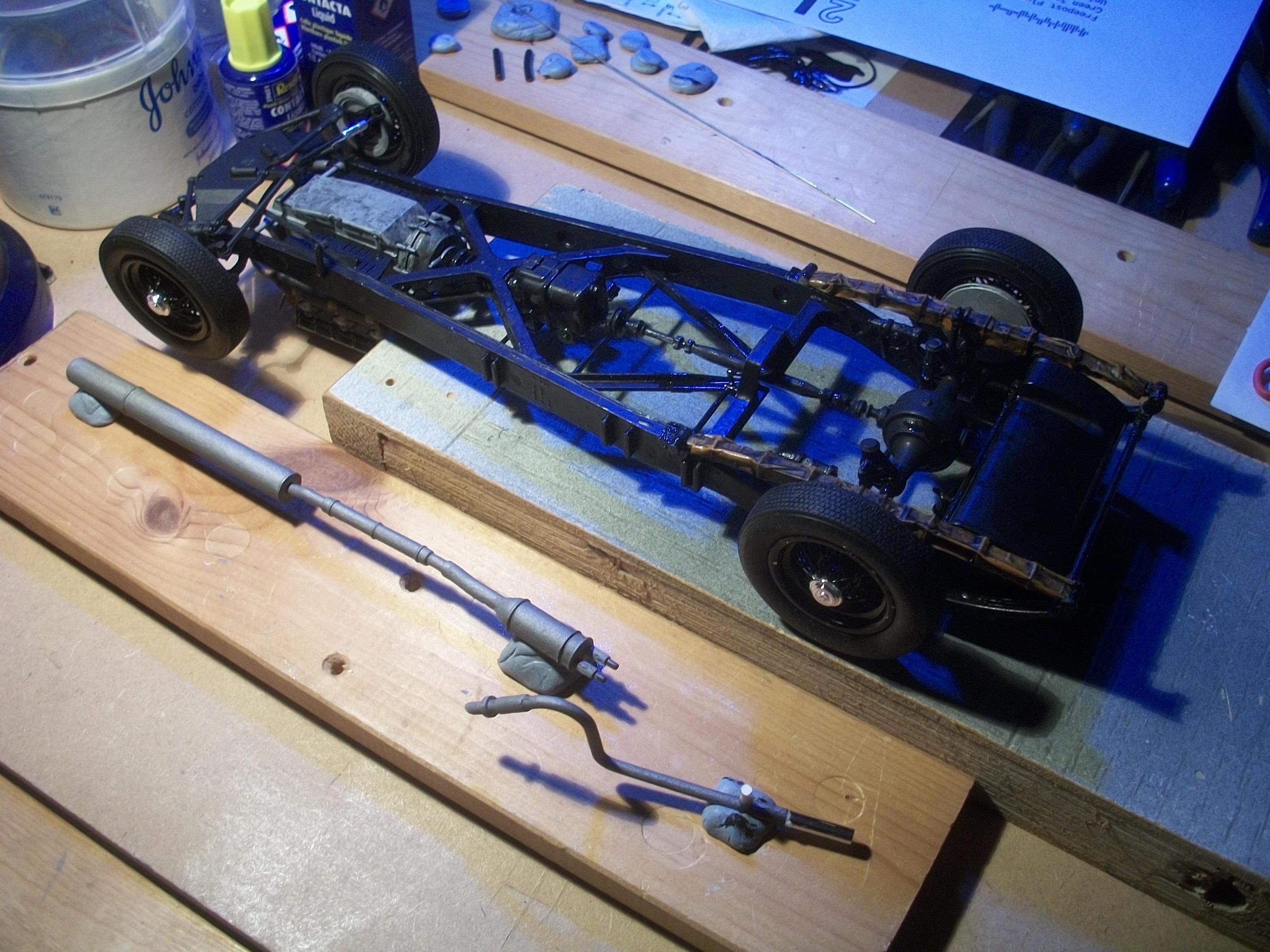

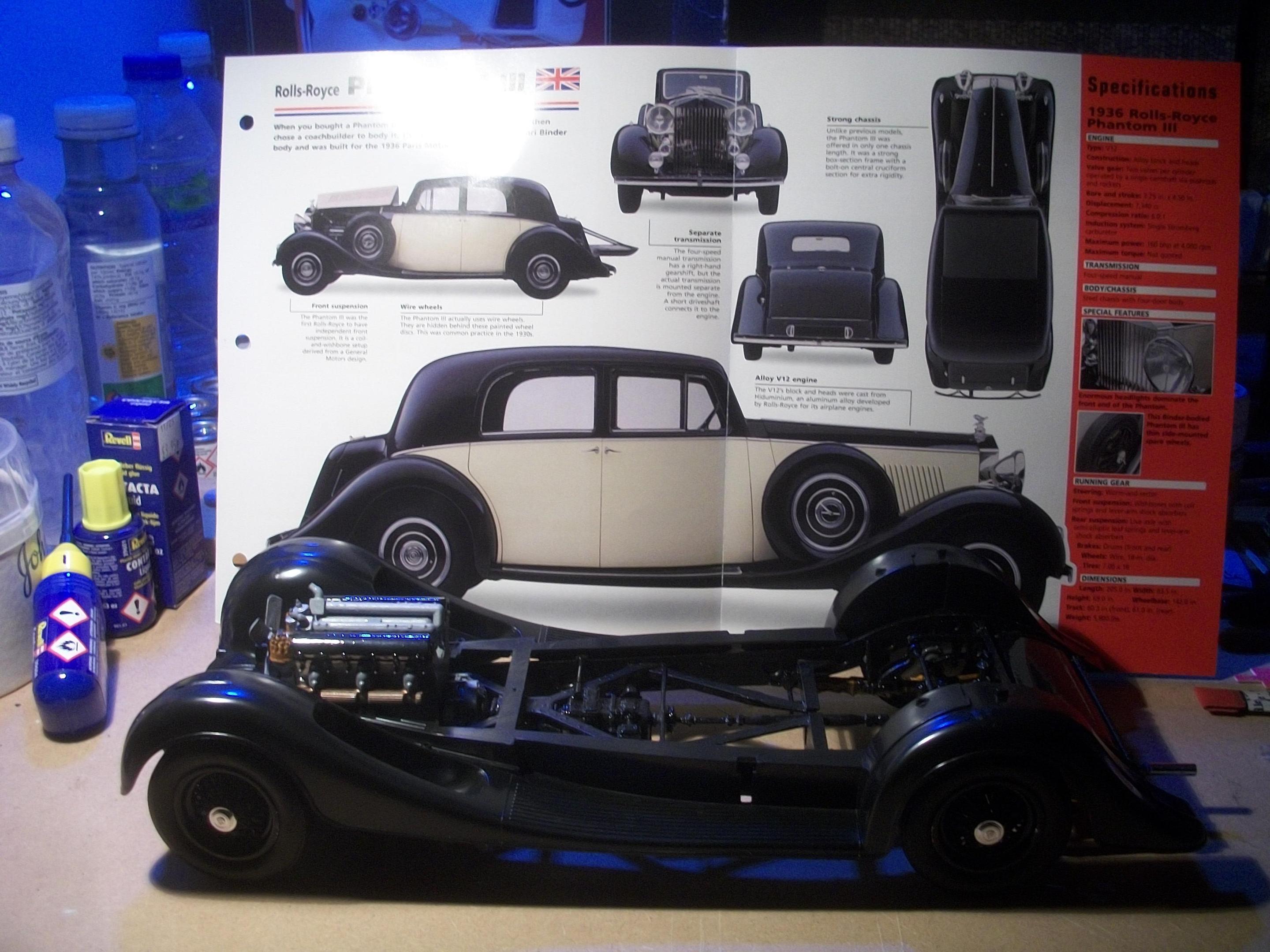

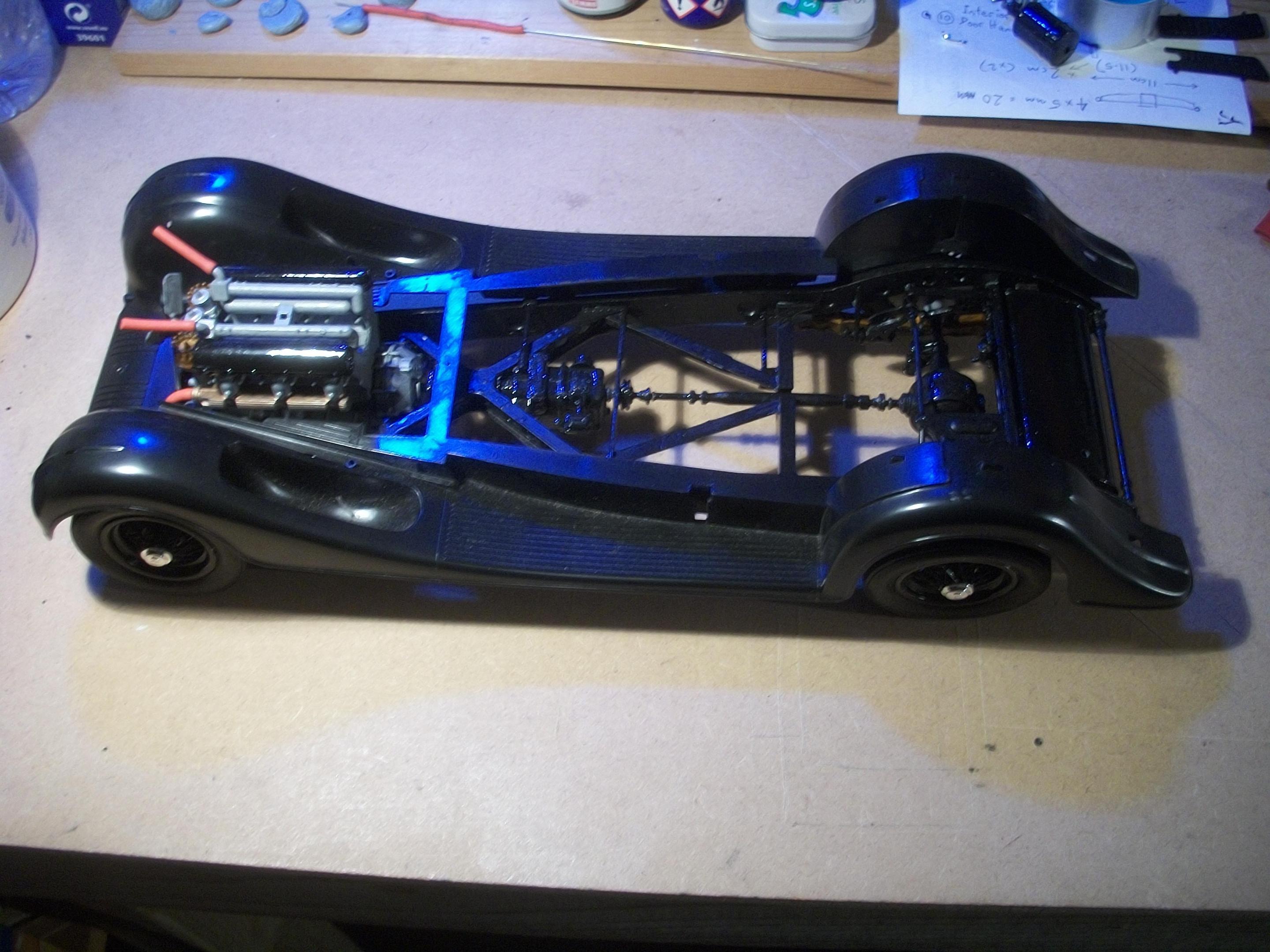

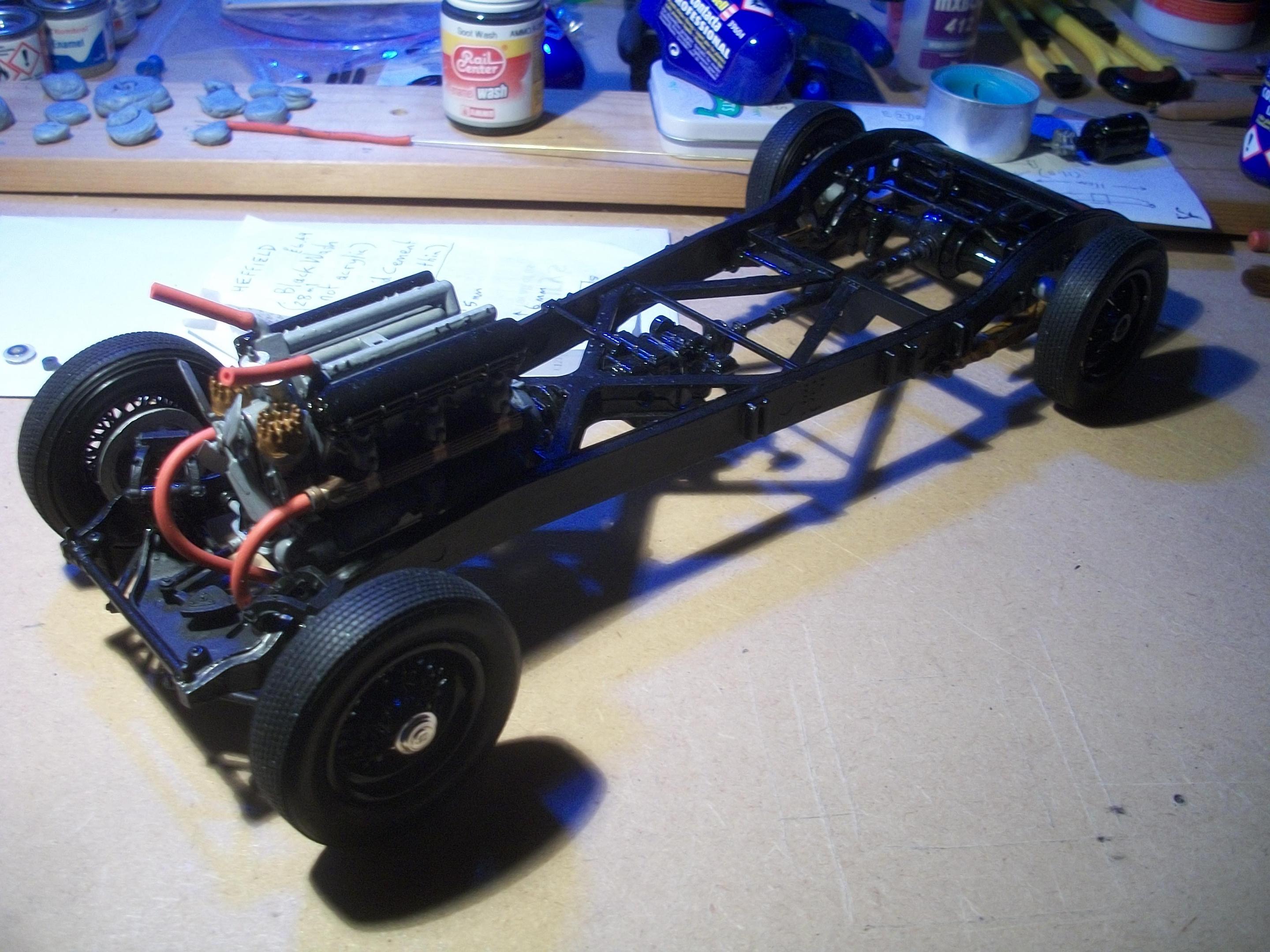

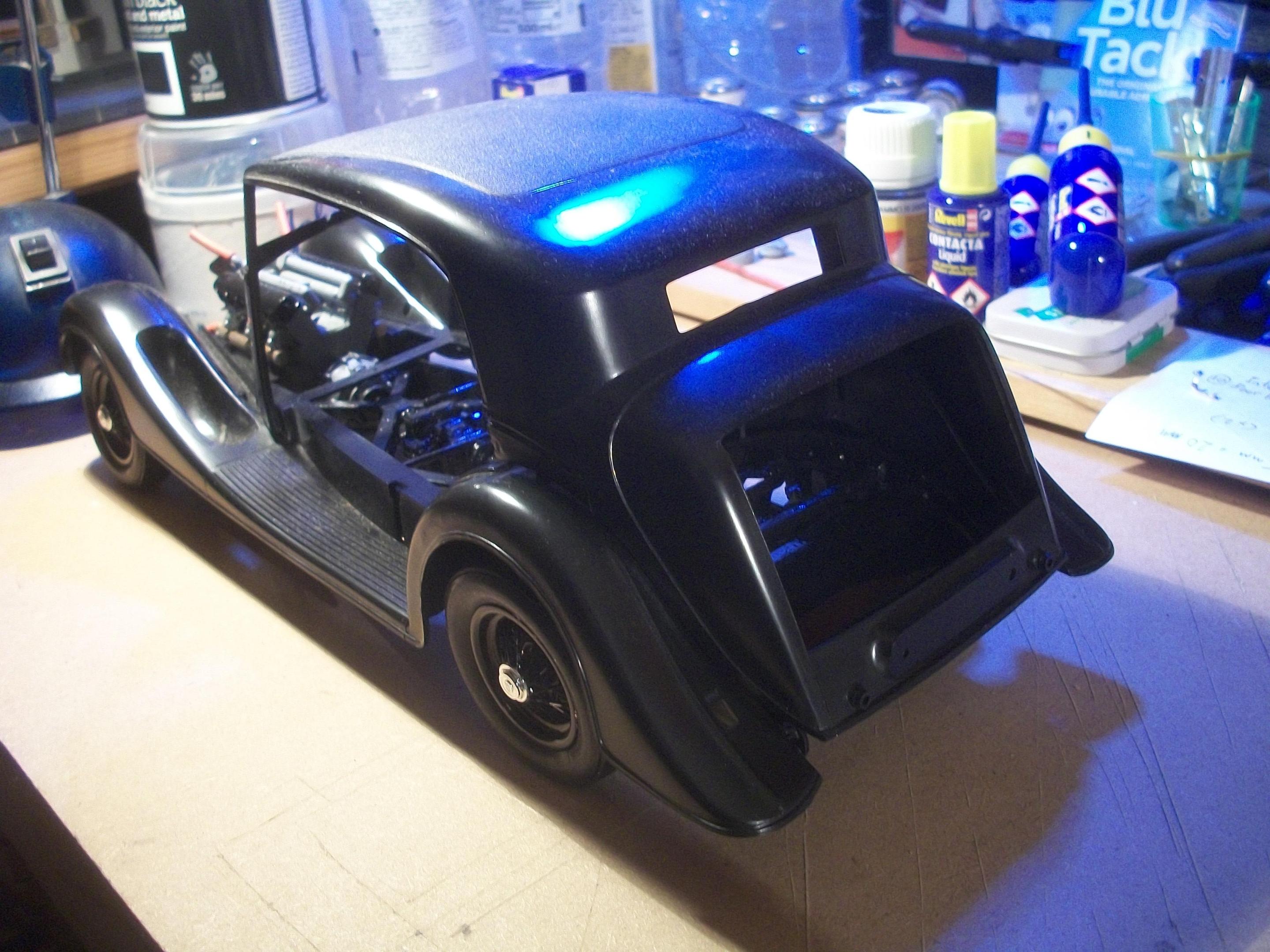

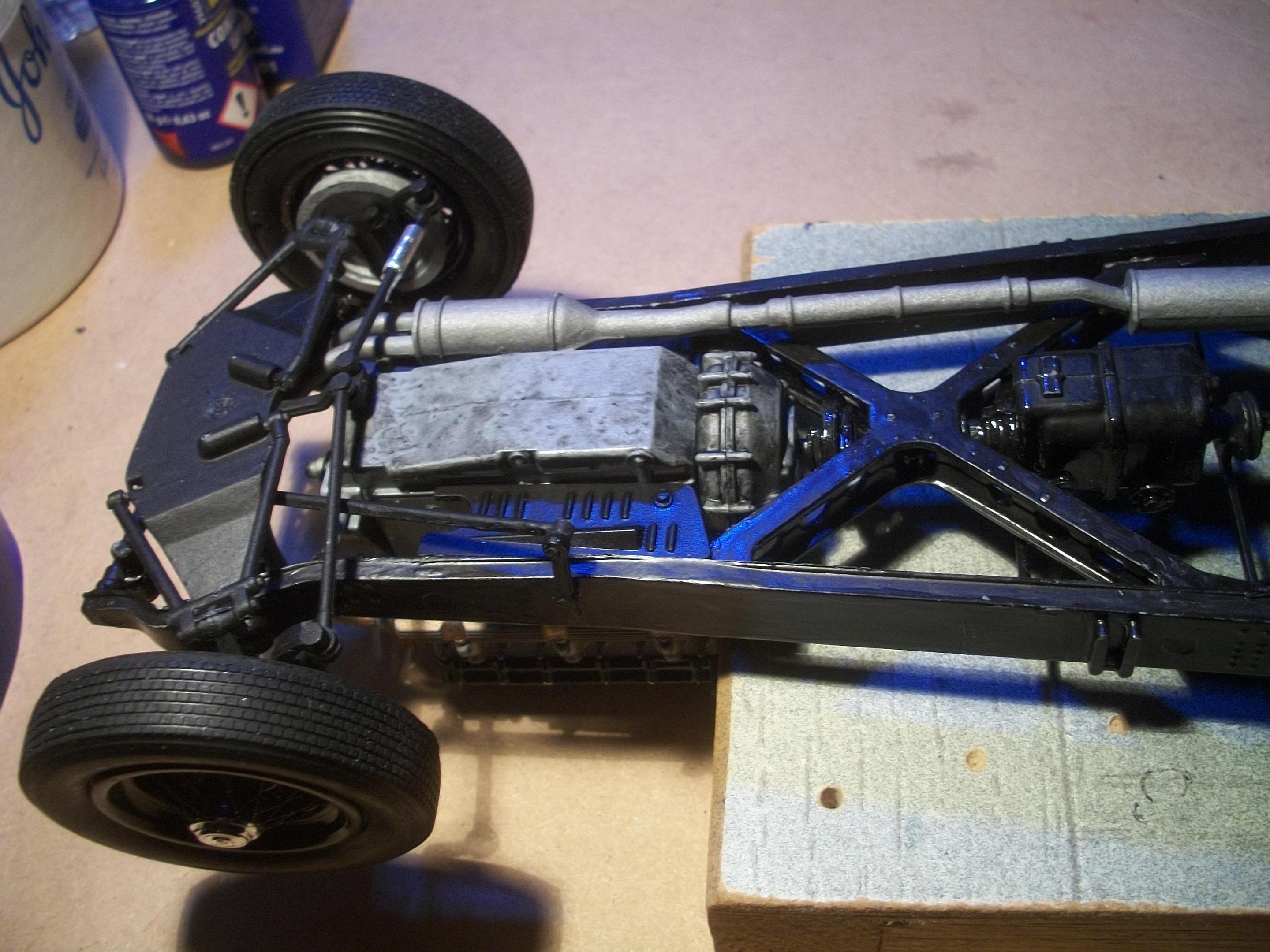

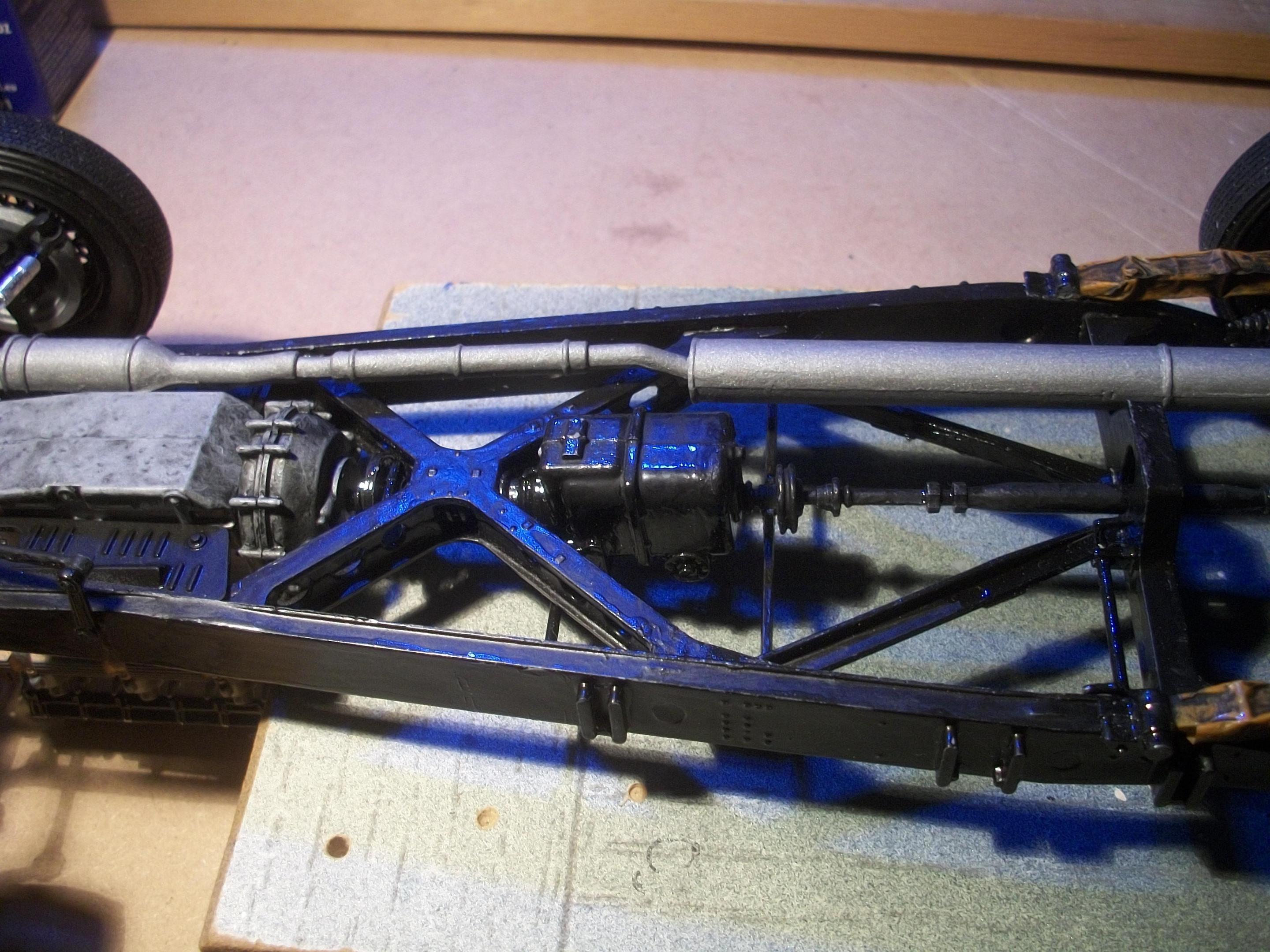

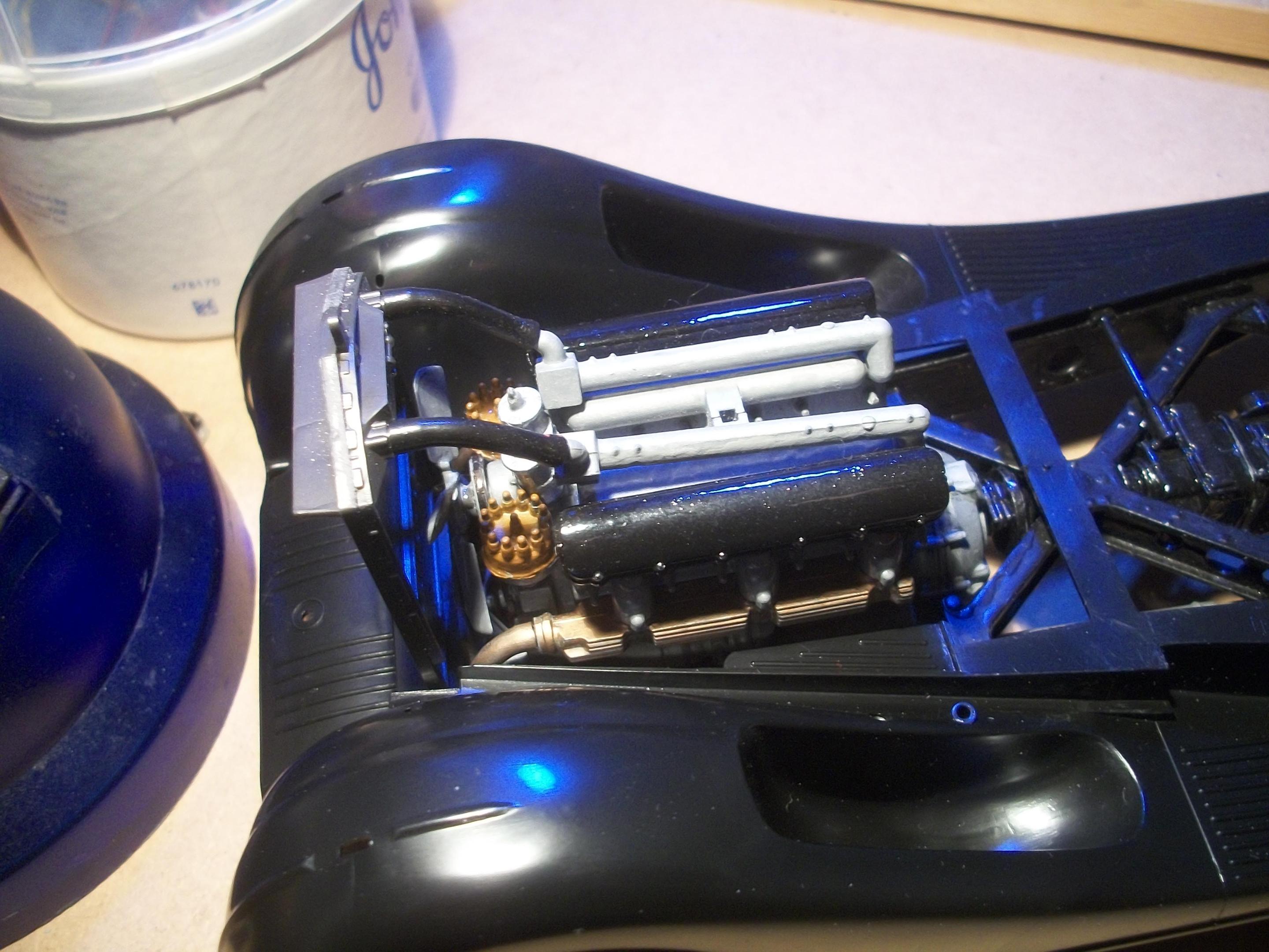

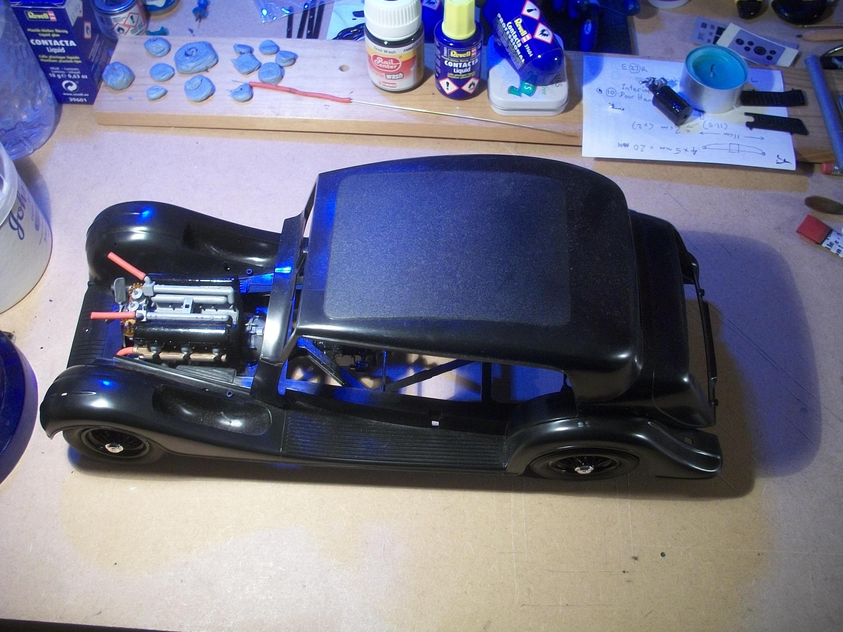

Anglia105E Posted February 18 Author Share Posted February 18 I have now reached the stage where the rolling chassis is standing nicely on all four tyres, and also the exhaust system has been fitted. The lower body has been test fitted onto the rolling chassis . . . The upper body was also test fitted, in order to give me some idea of the overall size of this car. The exhaust downpipes that connect the exhaust manifolds to the front silencer are lengths of red rubber piping . . . These two downpipes have been painted gunmetal enamel, with a thin coating of bronze Sharpie along the upper front section. Now that the rear leaf springs have had a black enamel wash applied the brown leather appears less glossy, and not so bright. Further applications of the black enamel wash have included the engine underside, the rear axle and differential, and petrol tank underside. According to the instruction sheet, there are 294 parts in this Gunze Sangyo kit . . . The instructions require the cementing together of the chassis to the lower body, but this has to wait for the body parts to be painted. Today I washed the upper and lower body parts, so they are reay for grey primer, and I just need the outside temperature to rise a few degrees . . . currently we have 12°C here in England, which is pretty good for mid-February. David 1 Quote Link to comment Share on other sites More sharing options...
David G. Posted February 19 Share Posted February 19 In my builds I always consider getting the wheels mounted and all of them touching the ground a tipping point. It's no longer just a collection of parts in progress, it's a model of a motor vehicle. "Foursquare and firm" as the saying goes. Great work so far David! David G. Quote Link to comment Share on other sites More sharing options...
Anglia105E Posted February 19 Author Share Posted February 19 5 hours ago, David G. said: In my builds I always consider getting the wheels mounted and all of them touching the ground a tipping point. It's no longer just a collection of parts in progress, it's a model of a motor vehicle. "Foursquare and firm" as the saying goes. Great work so far David! David G. You are absolutely right David, and I detected a change in my overall feeling for the ' car ' as the rolling chassis was standing square and true. Here is a link to my YouTube video which shows the rolling chassis from all angles . . . The rotating turntable is from Amazon, which is mains operated and 10 inches diameter. The 15 inches diameter mirror is from IKEA . . . Lighting is natural daylight plus one overhead flourescent tube light. The video is best viewed full screen, and this one has no music, or talking or captions. This slowly revolving display stand will be used later to display the finished Phantom III and will feature background music, carefully positioned lighting and a plain black background ( or white ? ) . . . https://www.youtube.com/watch?v=gEvoLzd3CgM David W. Quote Link to comment Share on other sites More sharing options...

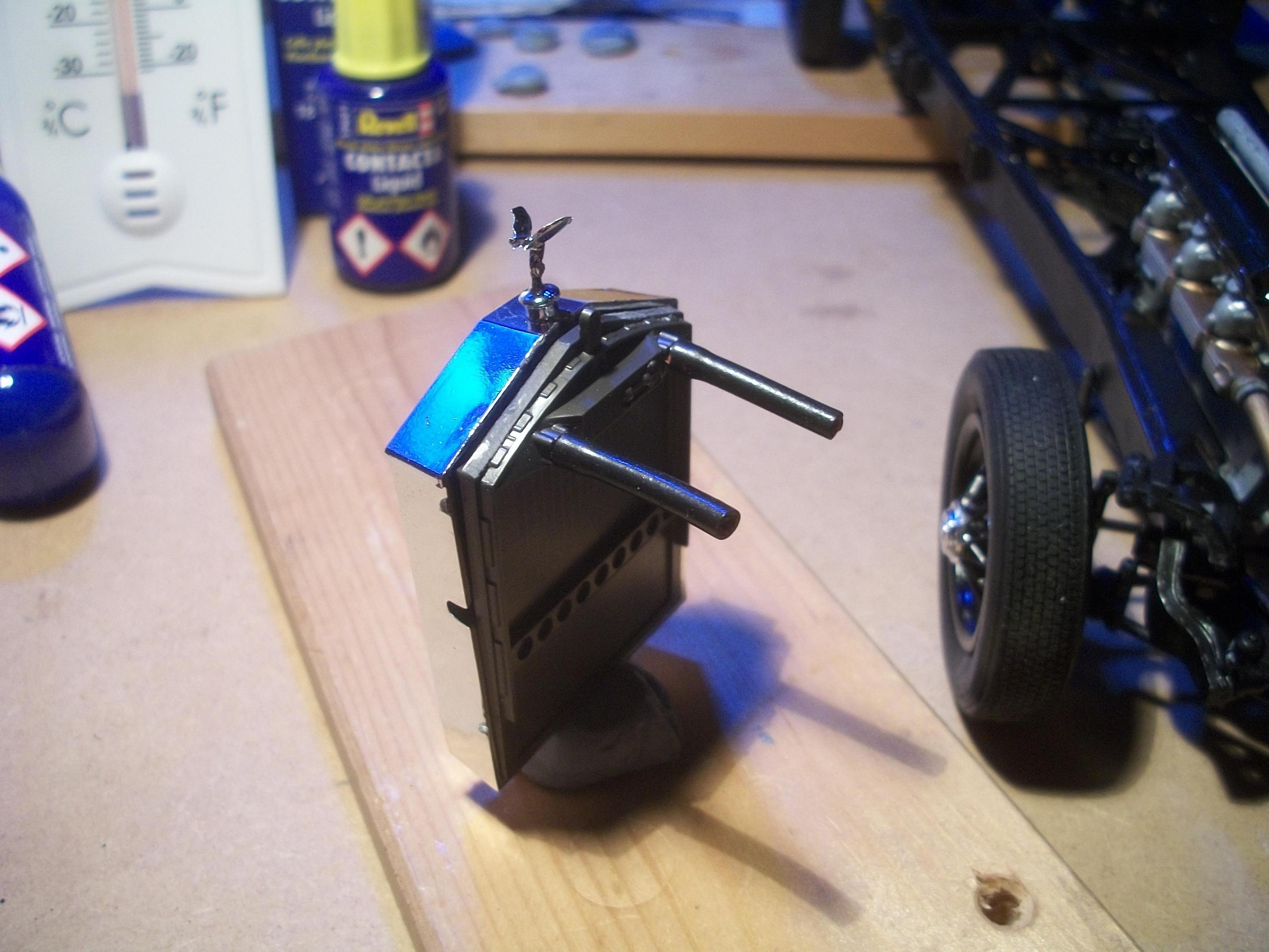

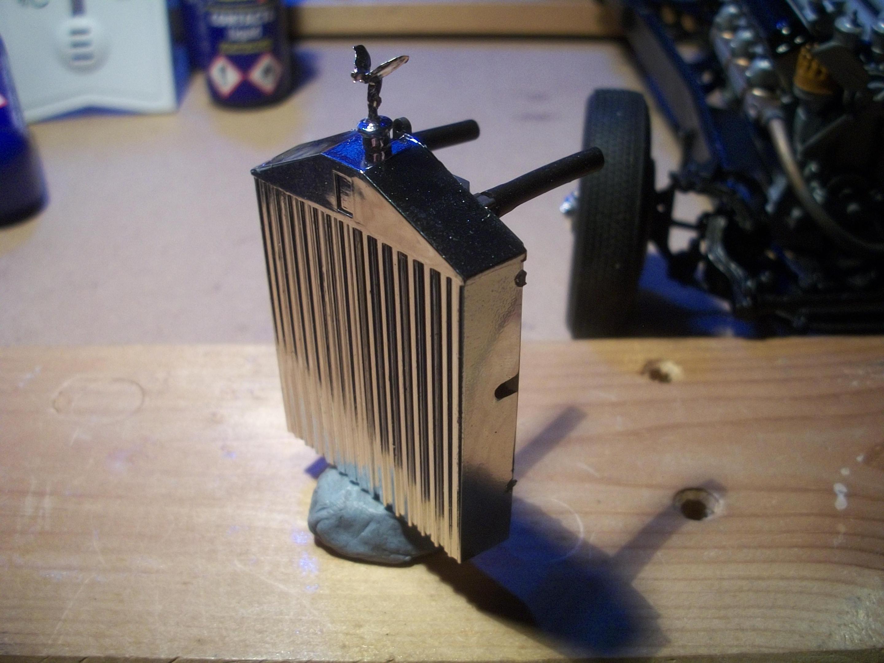

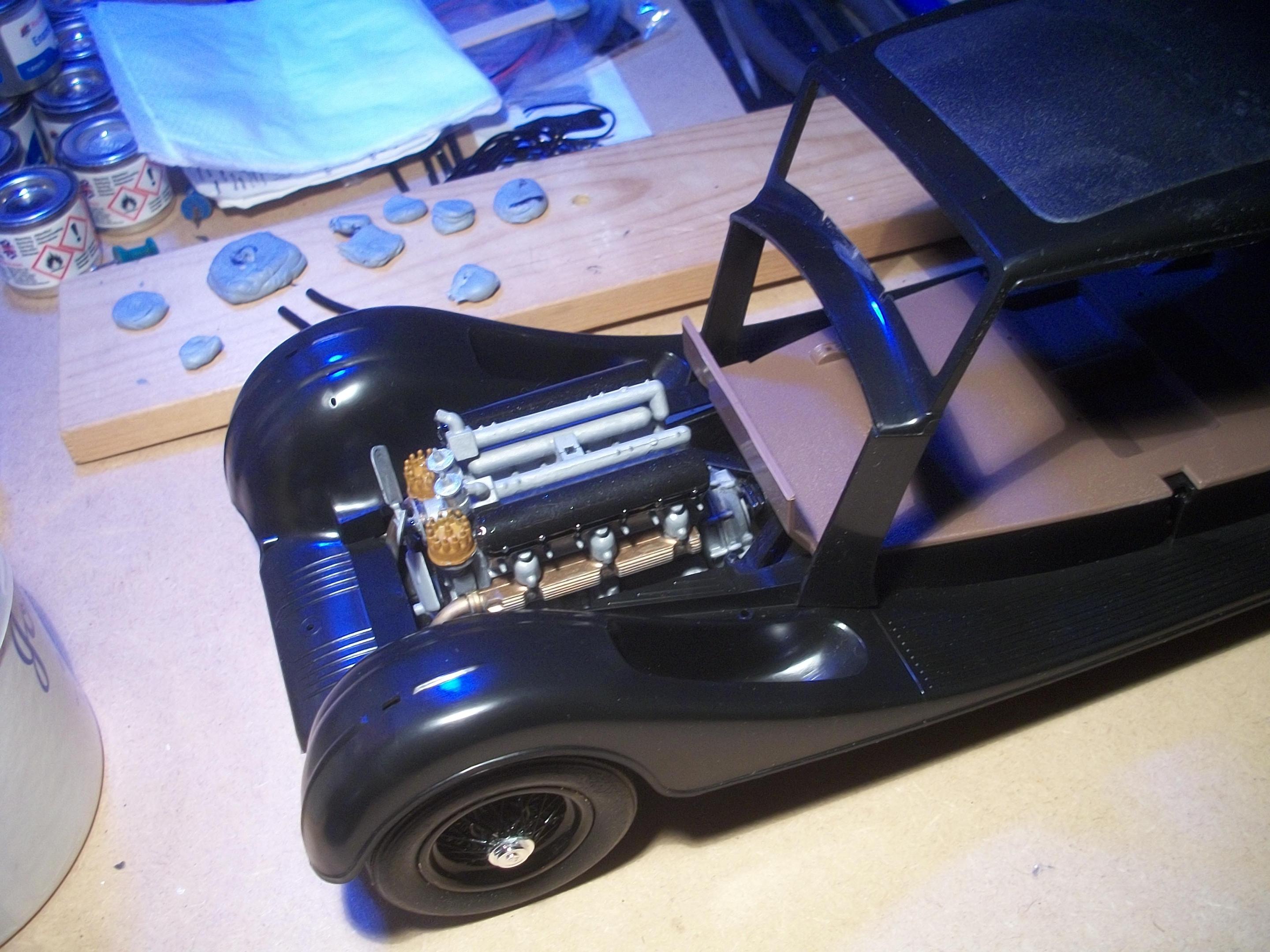

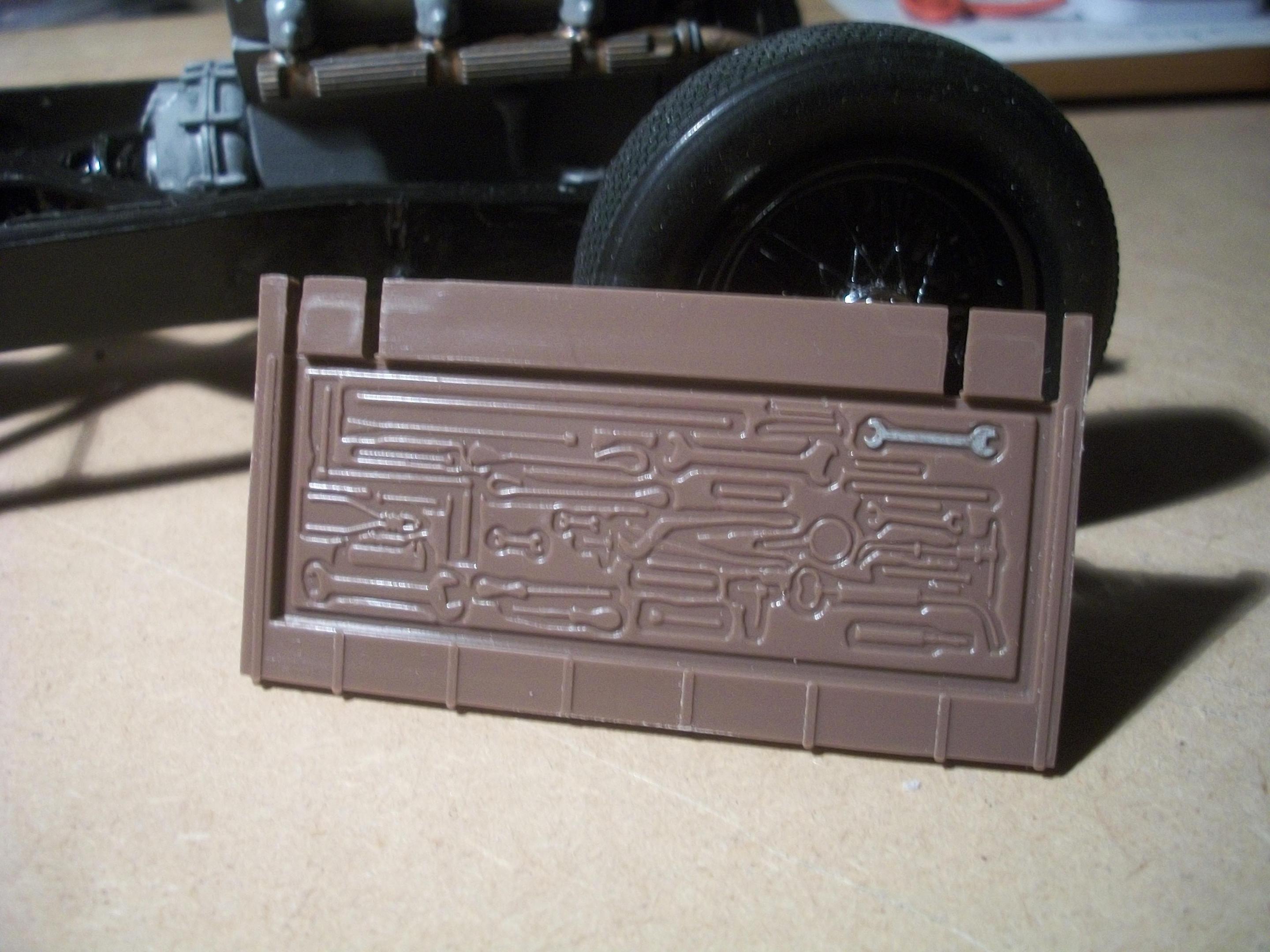

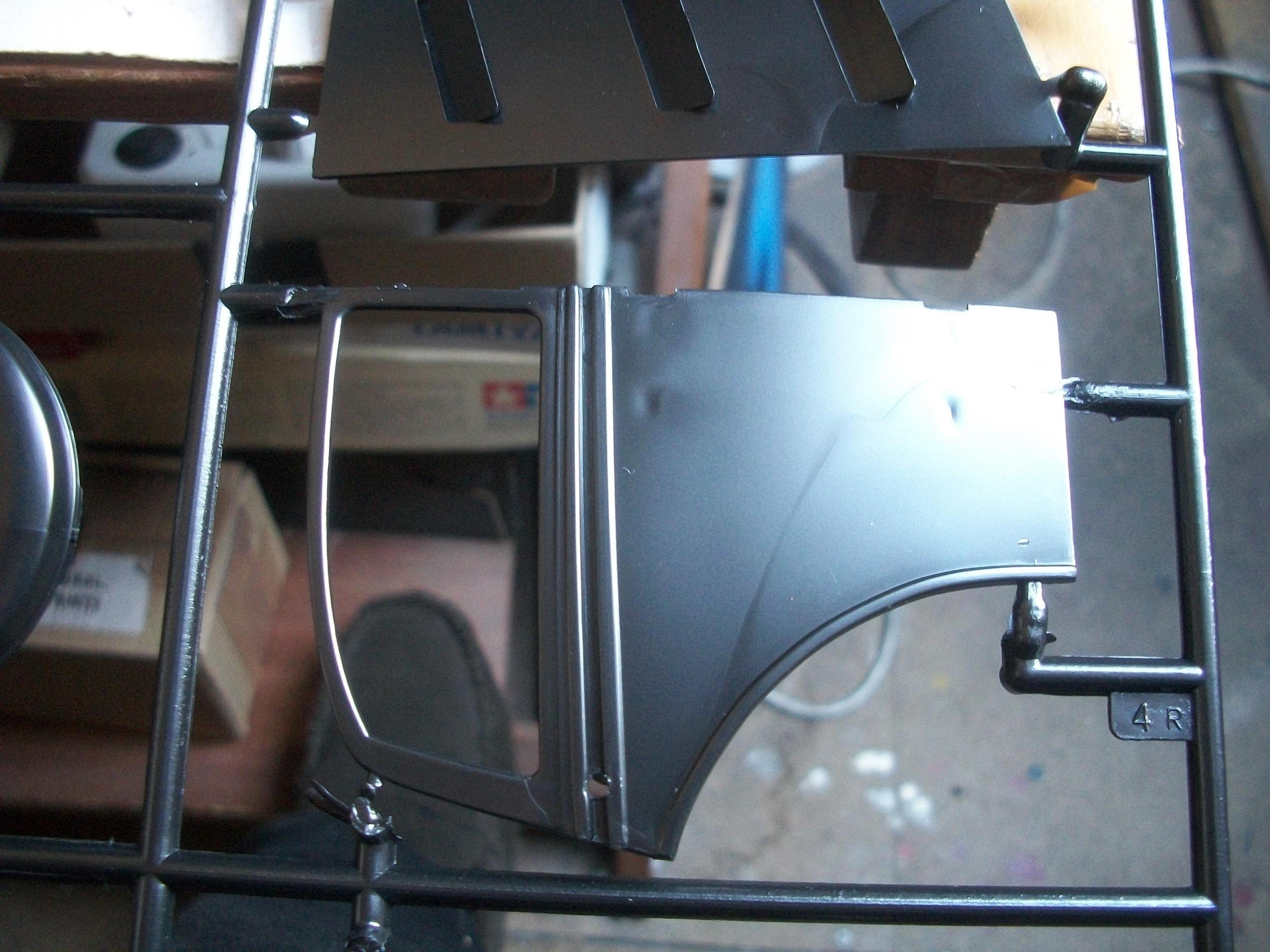

Anglia105E Posted February 20 Author Share Posted February 20 The lower body of the Rolls-Royce Phantom III clips nicely onto the rolling chassis, and may not even need any glue later. The first of the following series of photos shows the spec sheet behind the model, which represents the colour scheme in which this car will be painted. While the temperature upstairs in my loft was between 12°C and 14°C this afternoon I applied some Tamiya Surface Primer Light Grey to the body parts . . . This was when I noticed that there are some nasty dimples on the outer surface of the two rear doors, and to a slightly lesser extent on the two front doors. These will have to filled and sanded before the second coat of primer is applied. It is a shame that Gunze Sangyo allowed these parts to go into production in this state, and it seems to be where the hinges are fitted on the inside of the doors. While the paint was left to dry overnight, I turned my attention to the radiator and grille assembly . . . I was pleased to find that the Spirit of Ecstasy mascot slides into a slot on the top of the chrome radiator grille, so that I can swivel the mascot rather than have it fixed in place. The mascot can then be turned as on the real car, to allow the bonnet panels to be lifted open. The radiator fits well into the grille, and prevents the mascot from coming adrift. Two short lengths of cooling hose were connected between the radiator and the water rails that run along the top of the cylinder heads. These are red rubber piping that has been painted satin black, and I shall make up some jubilee clips to go onto the hoses, which might be made from BMF or similar. The tool tray that fits into the boot / luggage compartment / trunk, will be painted matt black at some point, and each one of the tools then has to be painted individually . . . It might be easier to use Sharpies to colour the tools rather than trying to paint them, as this will be very intricate work. Just to see how this might look, I applied some silver Sharpie to one of the spanners, and this is before I apply the matt black base. David 3 Quote Link to comment Share on other sites More sharing options...
David G. Posted February 21 Share Posted February 21 Seeing all this brings a smile to my face David. Except those sink marks on the doors, no smile there. At least they're easily remedied and well within the normal scope of model building. Also, I had no knowledge of the swiveling mascot. It makes perfect sense upon consideration, I hadn't had any reason to consider it. It would seem that I've learned something new today, thanks for that! David G. Quote Link to comment Share on other sites More sharing options...
Anglia105E Posted February 22 Author Share Posted February 22 On 2/21/2024 at 12:51 PM, David G. said: Seeing all this brings a smile to my face David. Except those sink marks on the doors, no smile there. At least they're easily remedied and well within the normal scope of model building. Also, I had no knowledge of the swiveling mascot. It makes perfect sense upon consideration, I hadn't had any reason to consider it. It would seem that I've learned something new today, thanks for that! David G. Thanks David . . . The sink marks on the doors don't appear to too bad now that the coat of grey primer has dried overnight. Several of my reference photos show a green baize base to the tools tray, just like you would see on a snooker table or a pool table, so I might choose green rather than a matt black base as suggested on the instruction sheet. Outside temperature is down to 6°C maximum during the day, and will continue at this level for a few more days yet. No spray painting this week ! David W. Quote Link to comment Share on other sites More sharing options...

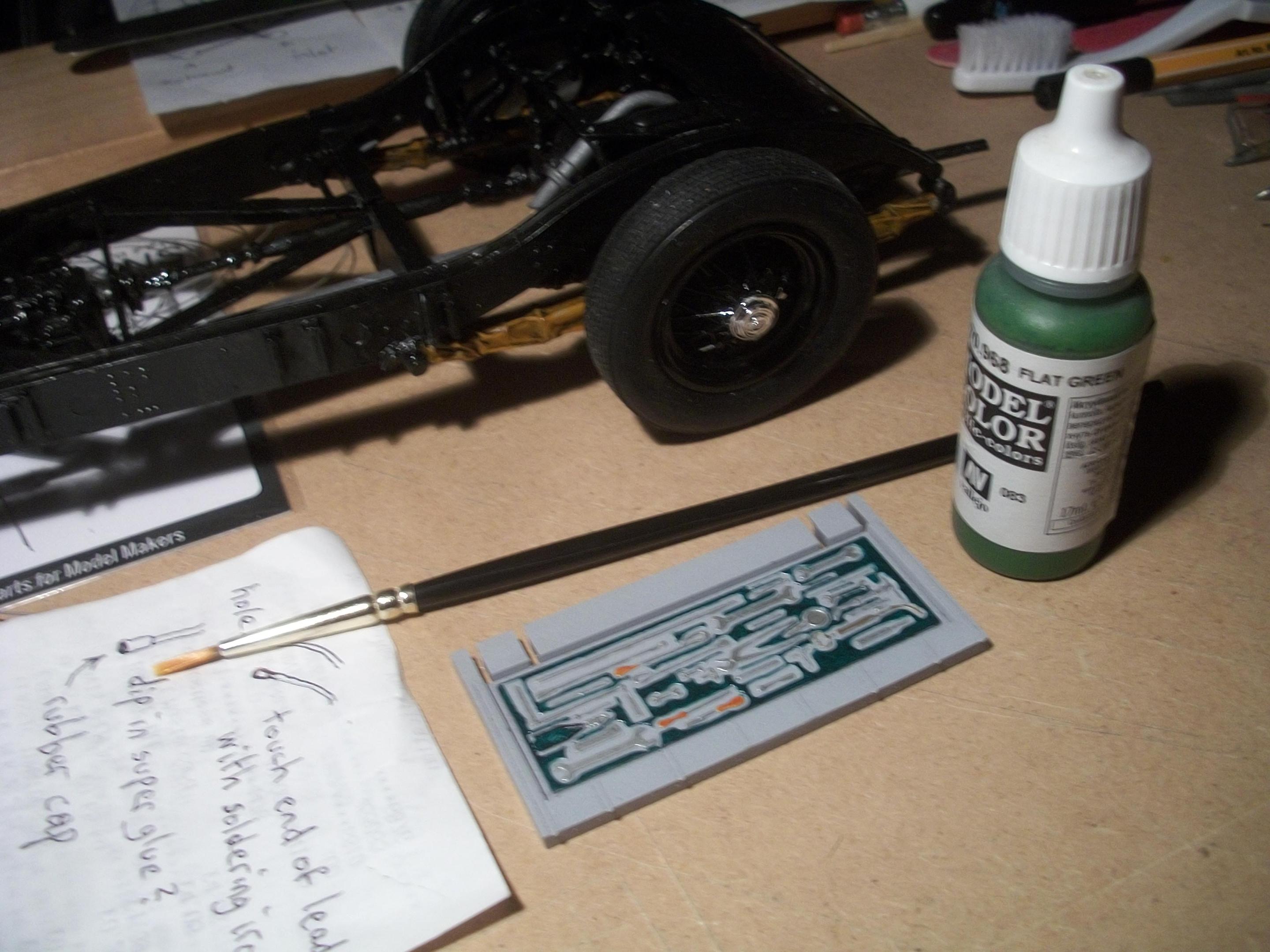

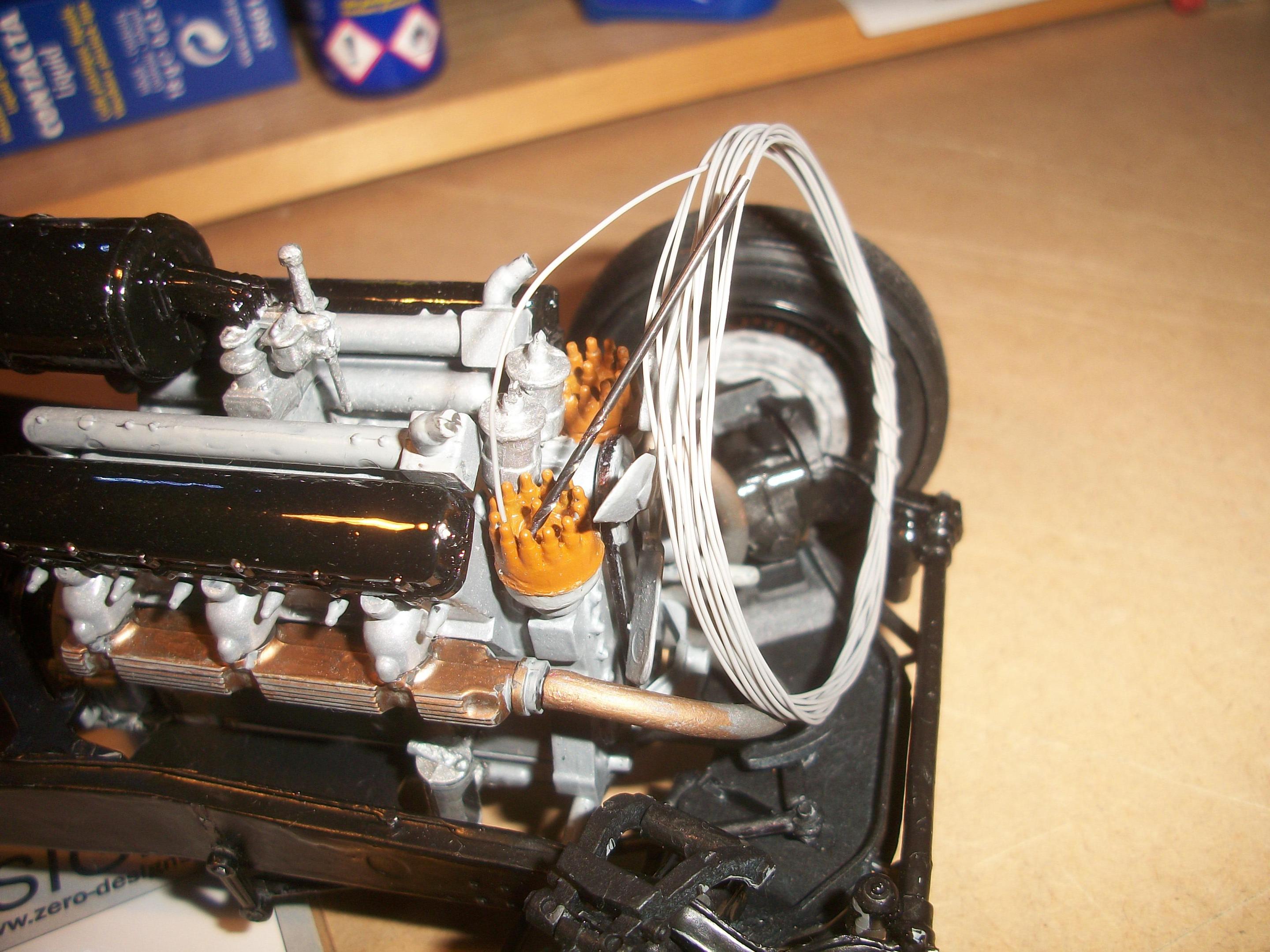

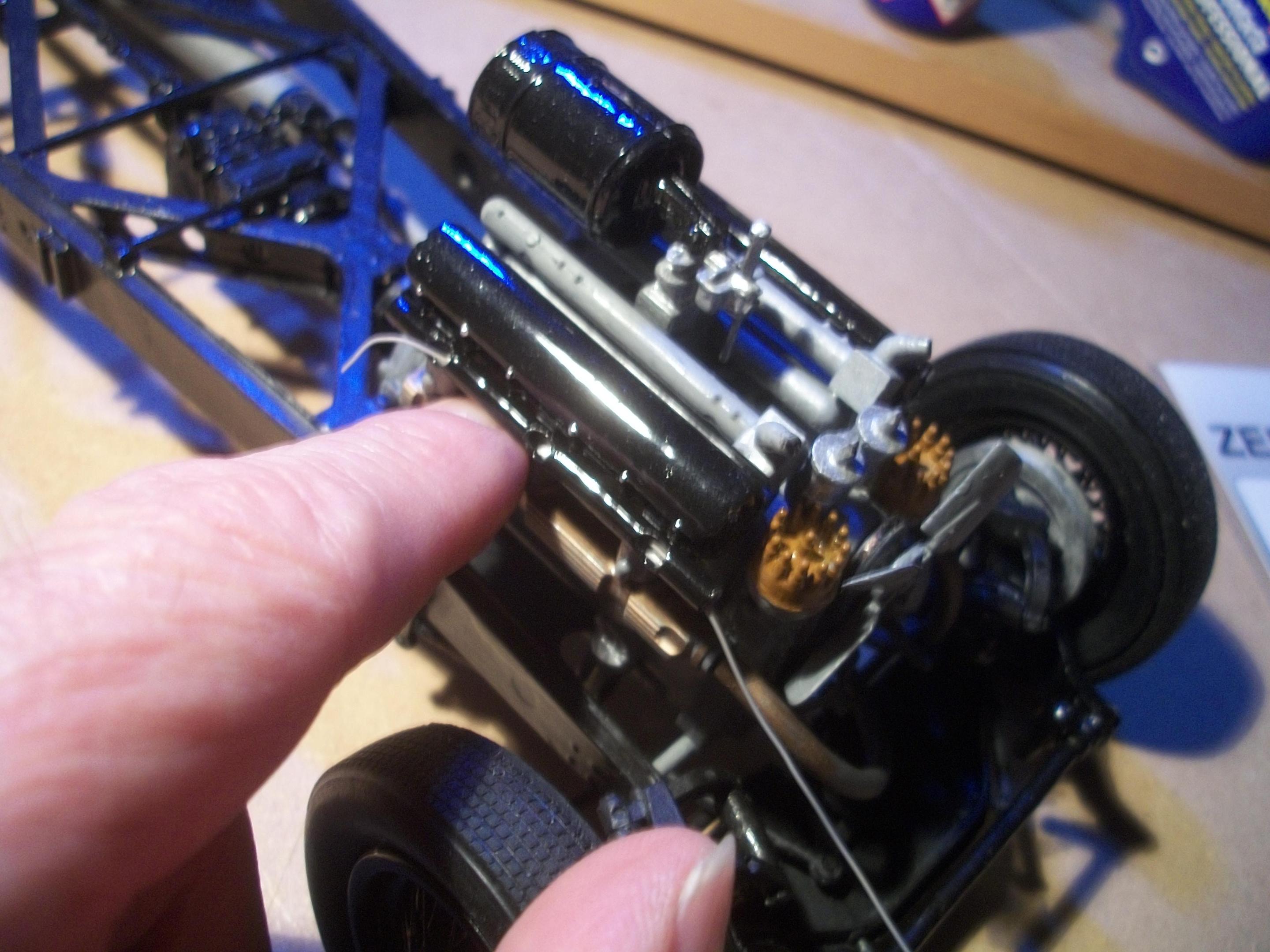

Anglia105E Posted February 22 Author Share Posted February 22 Yesterday was all about the ignition plug lead wiring, which is turning out to be a bit of a headache ! Two packs of plug lead material arrived in the post, so I decided to have a closer look at the task in hand . . . This is 0.4 mm plug lead and grey in colour, as supplied by Hiroboy and the Zero brand . . . Following several hours of considering the prospect of drilling 52 holes of 0.4 mm each, and also discovering that none of the micro drill bit suppliers have any stock of the 0.3, 0.4 or 0.5 mm drill bits, my thinking turned towards an alternative solution. The Gunze Sangyo kit for this Rolls-Royce has a length of black vinyl tubing, and by cutting tiny pieces of this tubing and fitting them tightly over the connections on the two distributor caps and the two ignition coil connections, I can insert the 0.4 mm plug leads and super glue them in place. This procedure could be repeated for the 24 spark plugs and the 24 connections on top of the distributor caps. Many reviews for the micro drill bits are saying that the fragile drill bits break very easily, and within a very short time. This put me off the idea of drilling. These 24 plug leads will have to be routed through the two aluminium tubes and the two aluminium conduits, before they exit at the spark plug end. Here are a few photos of what this might entail . . . David Quote Link to comment Share on other sites More sharing options...
