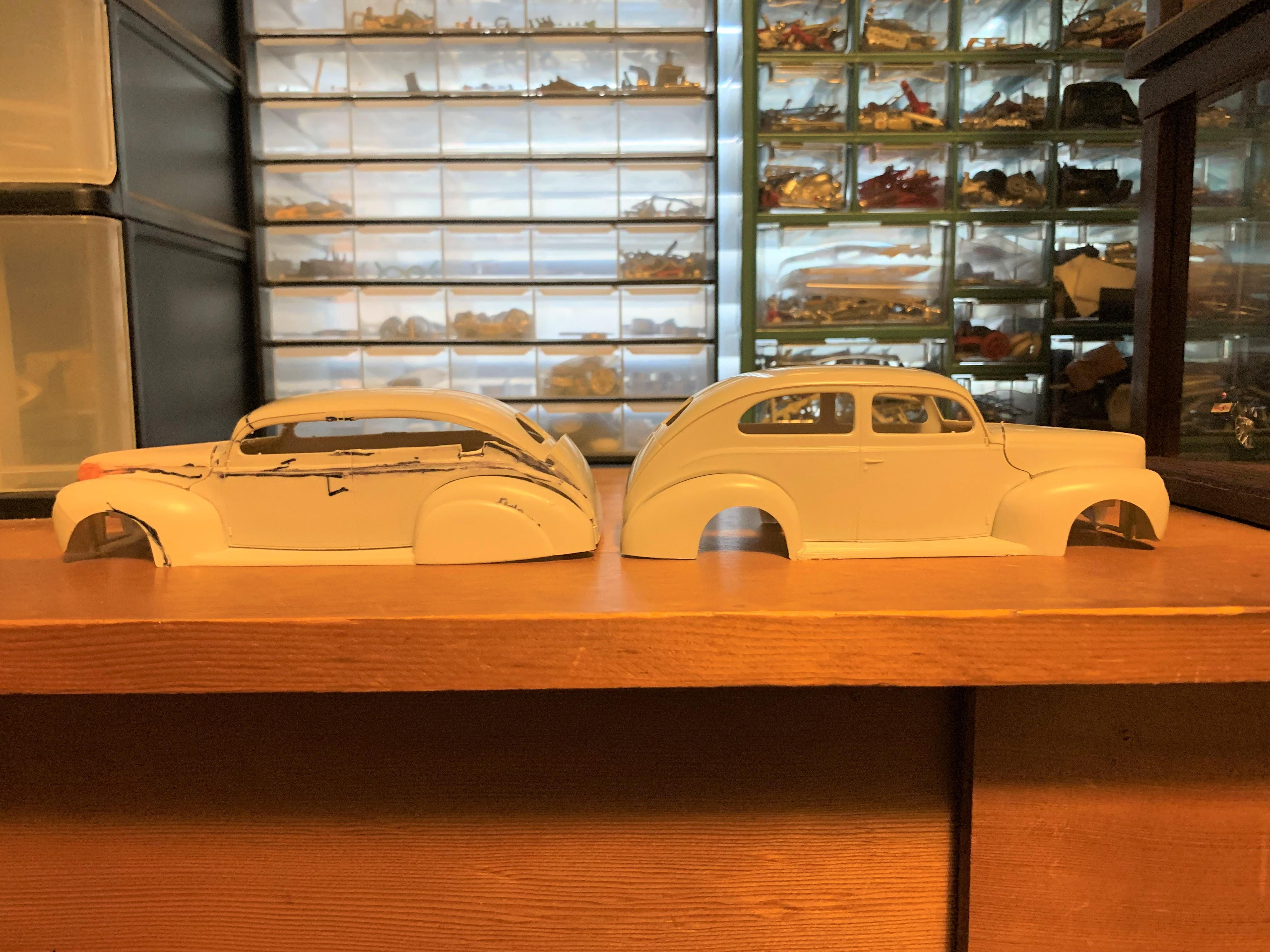

Paul Payne Posted February 22, 2024 Author Posted February 22, 2024 CHOPPED! Can't believe how well this turned out! The windshield area in particular is perfect on the first try, and the rear is square and level as well. The trunk, which was cut at the opening line to allow the top to lay down properly. This will take some thought and time to integrate properly, but still very promising. Everything tacked together with liquid styrene cement- after a final check I will start gluing my fingers, hopefully with some body parts, with super glue. BTW, the putty on the hood is because I sectioned the 40 hood instead of the 39 hood, so will recontour to match the 39 grille! 3

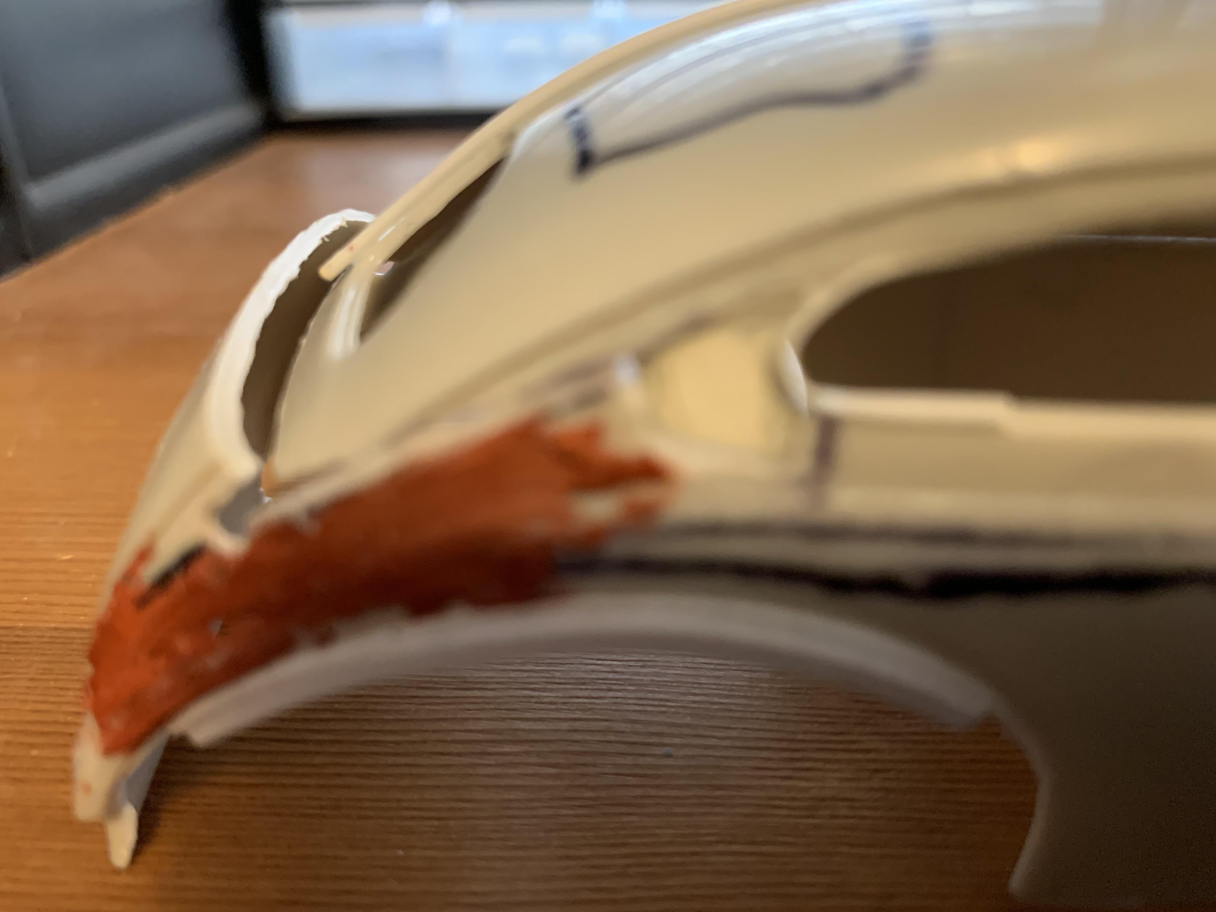

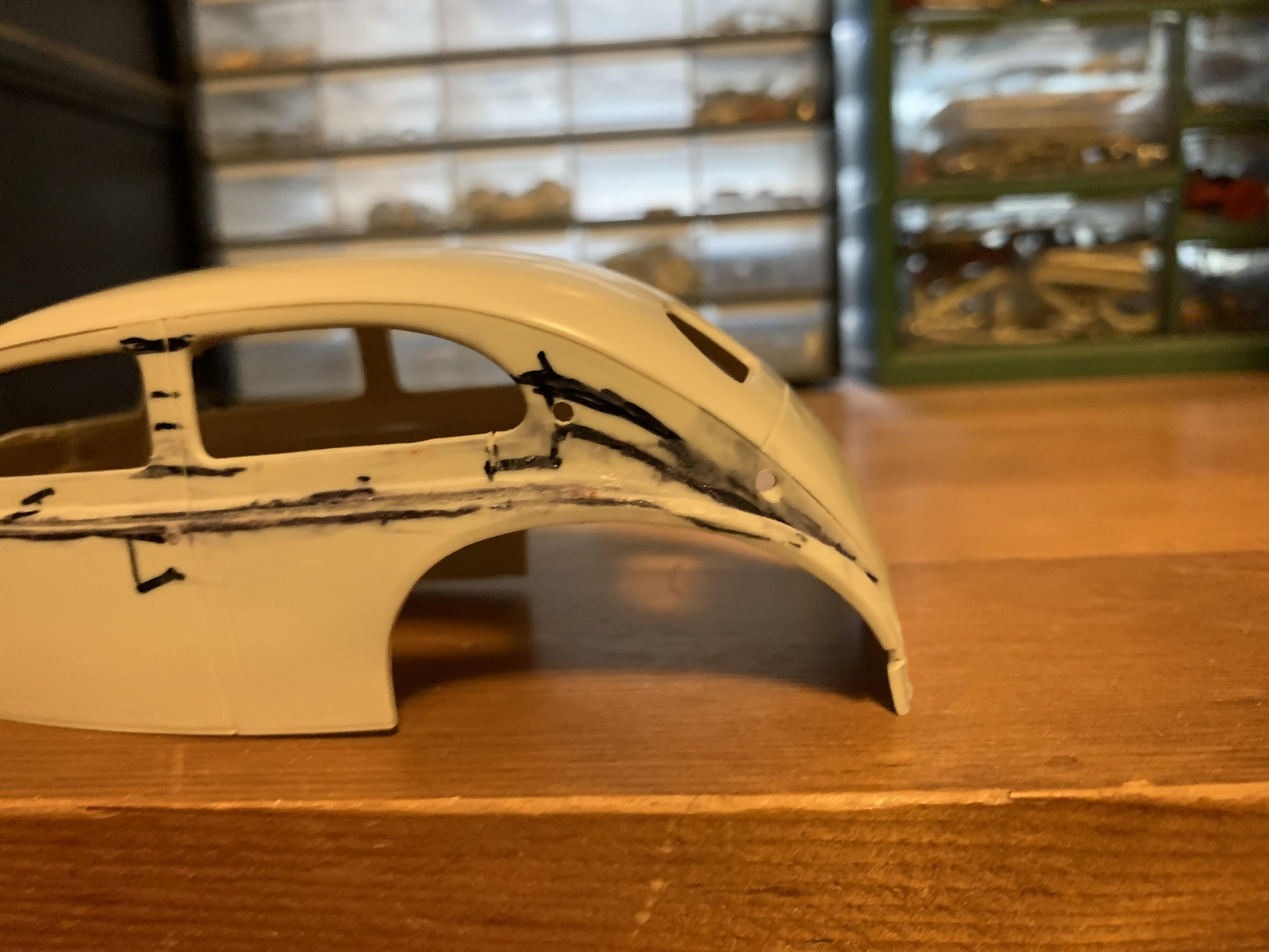

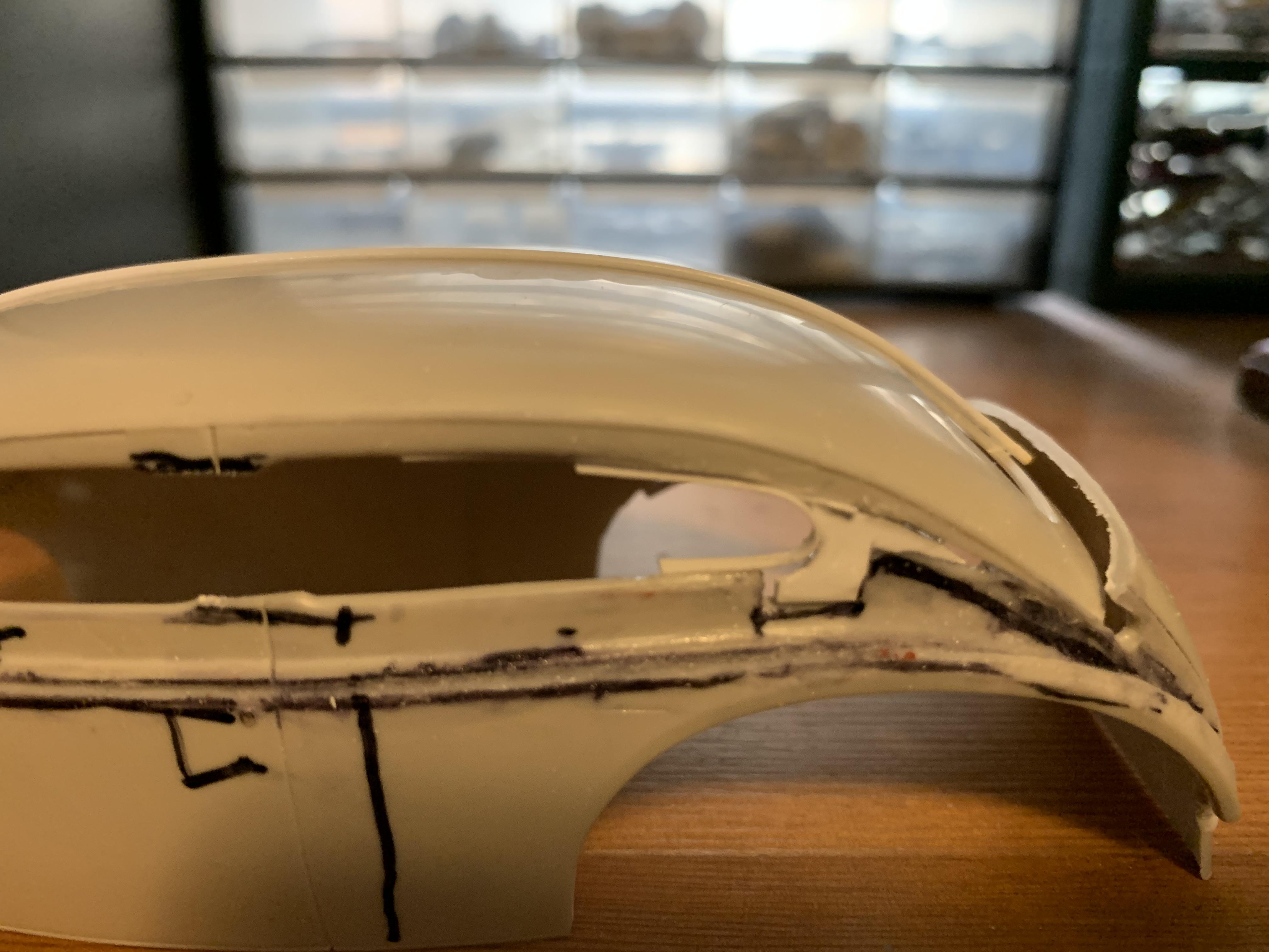

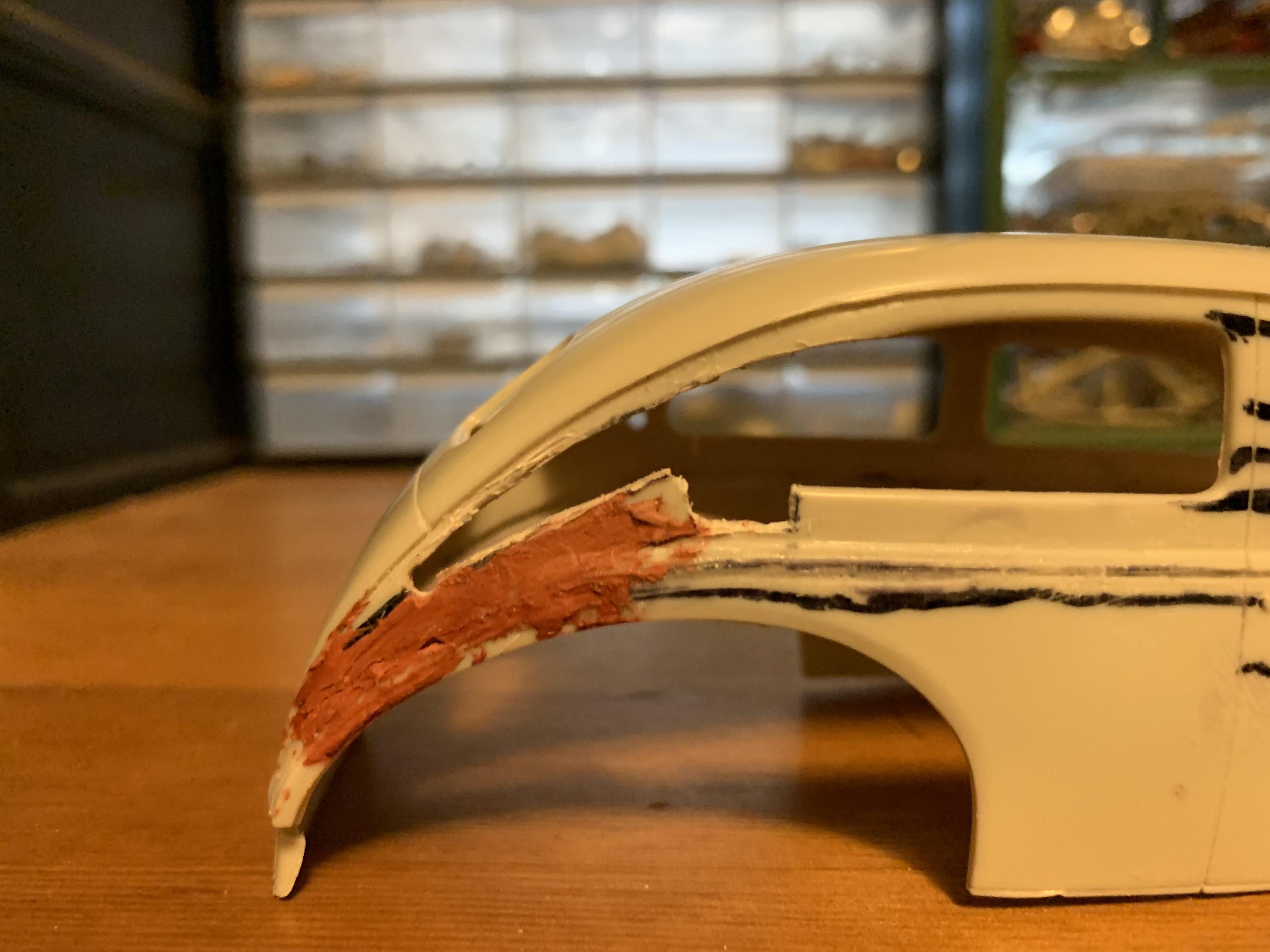

Paul Payne Posted February 25, 2024 Author Posted February 25, 2024 Made patch panels for the sail pillars after bending in the rear of the window openings using 0.010" x 0.060" stock. Lots of filling, blending and sculpting to do. Also laid in some stock in one wheel well- still needs sanding and blending- to cure a gap problem. Just for fun, decided to create a peak using 0.040 rod stock- this will be filled and blended and continued down the trunk lid. 1
