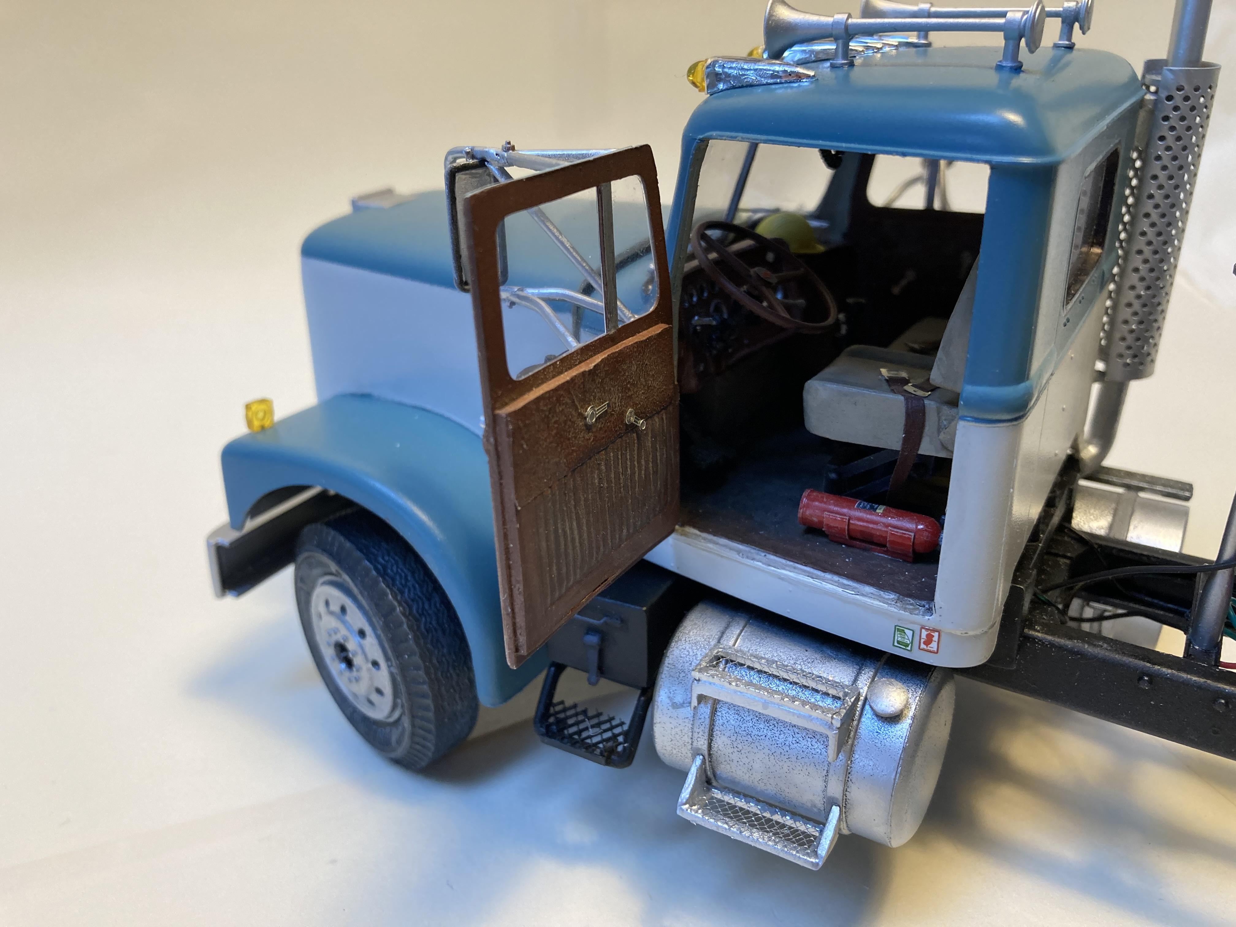

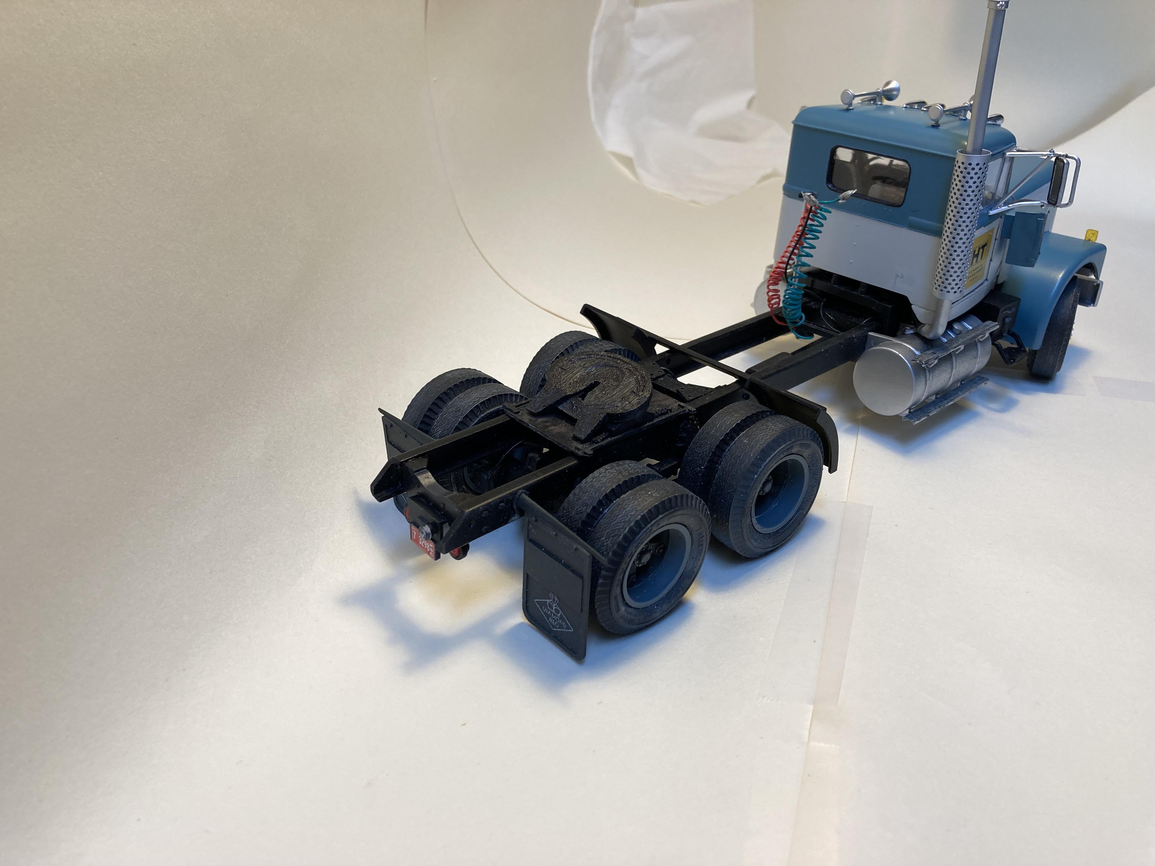

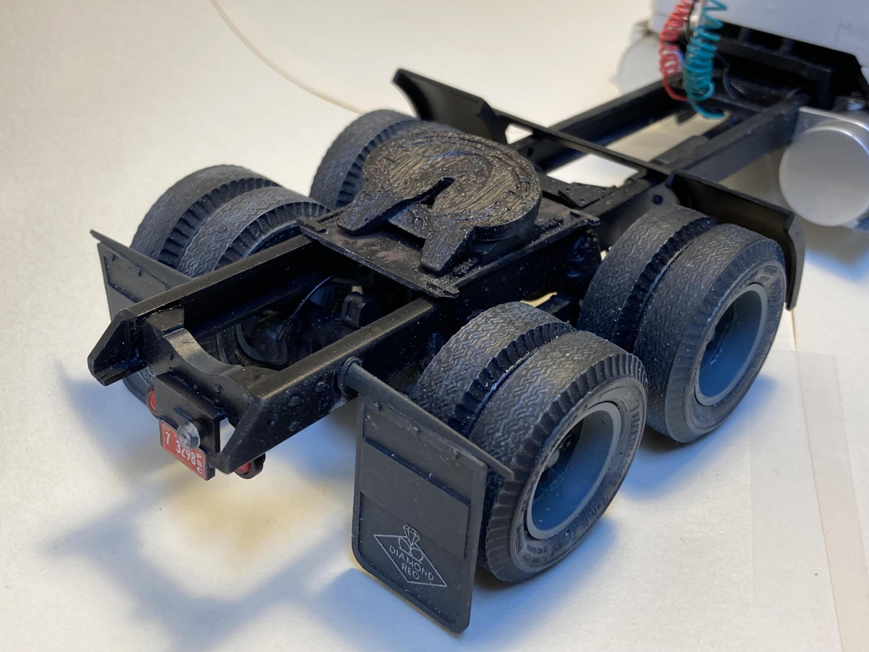

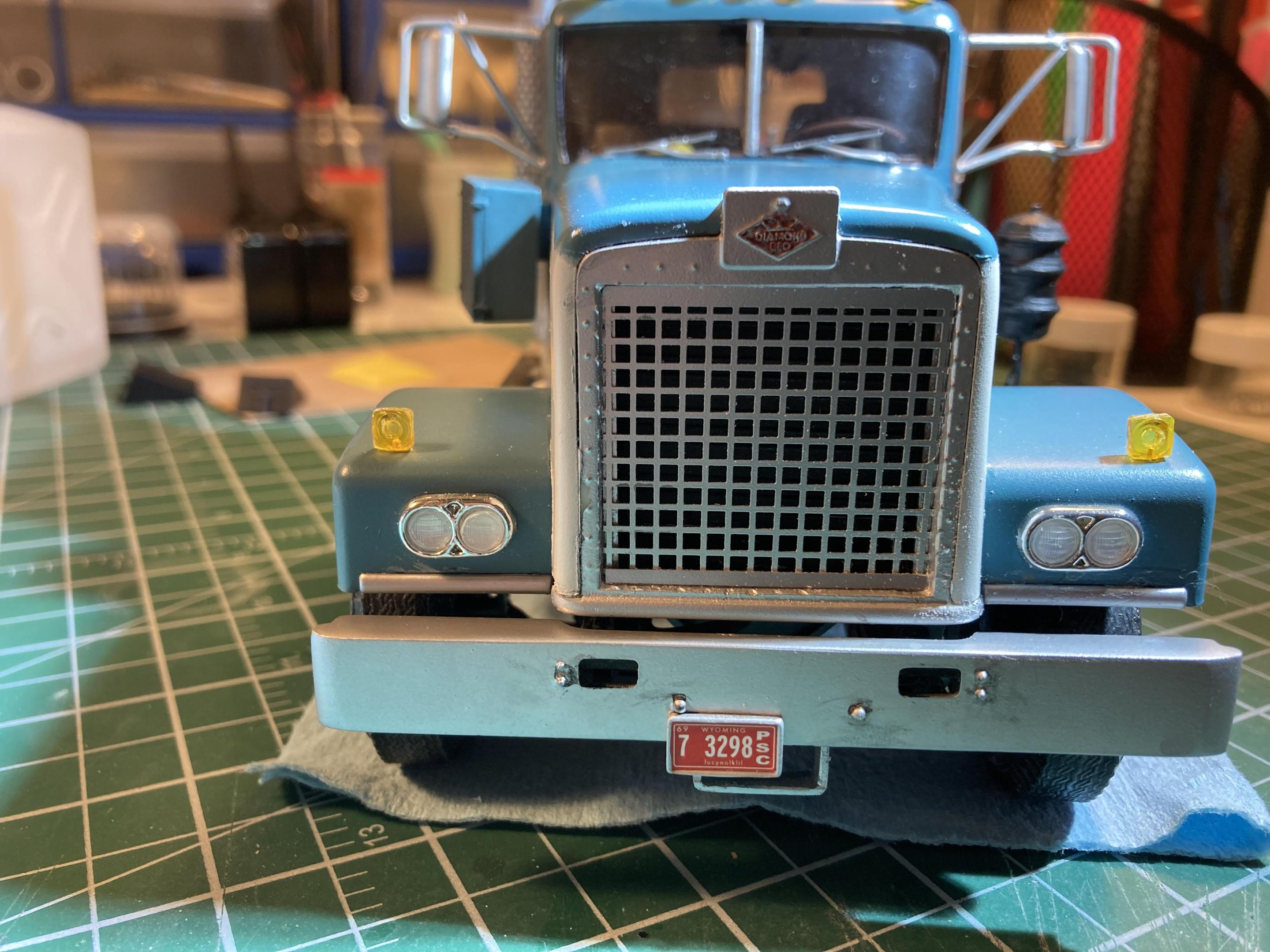

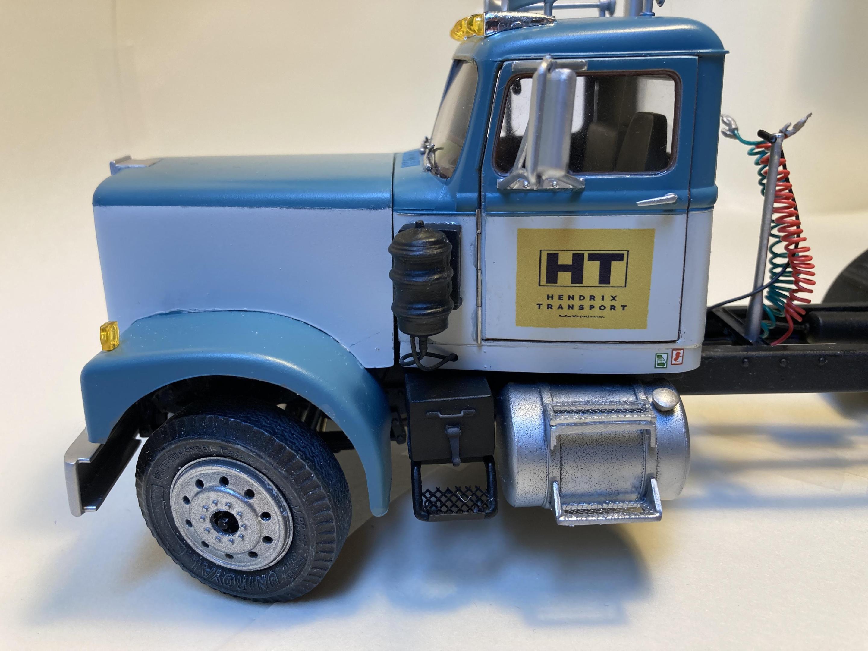

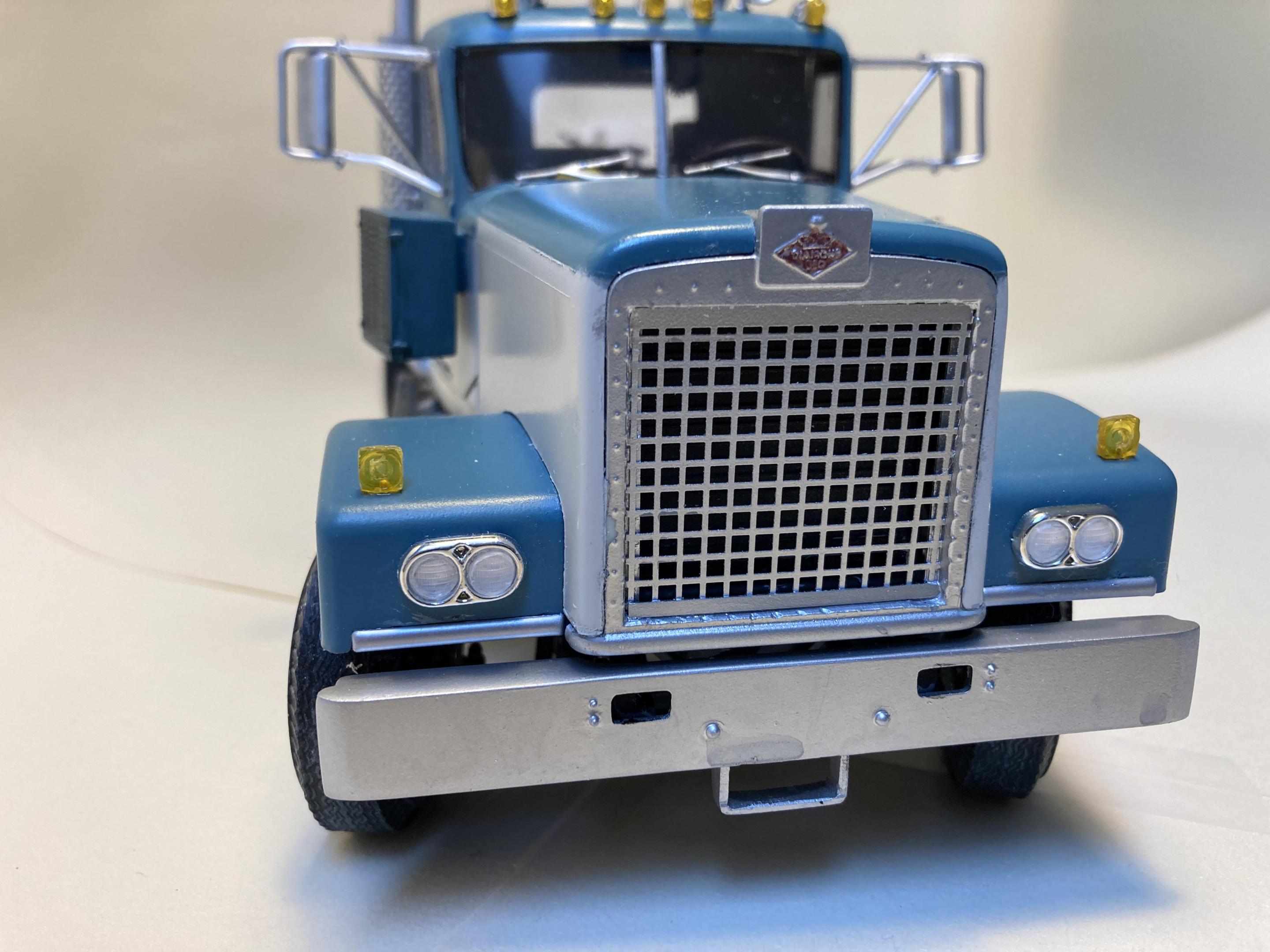

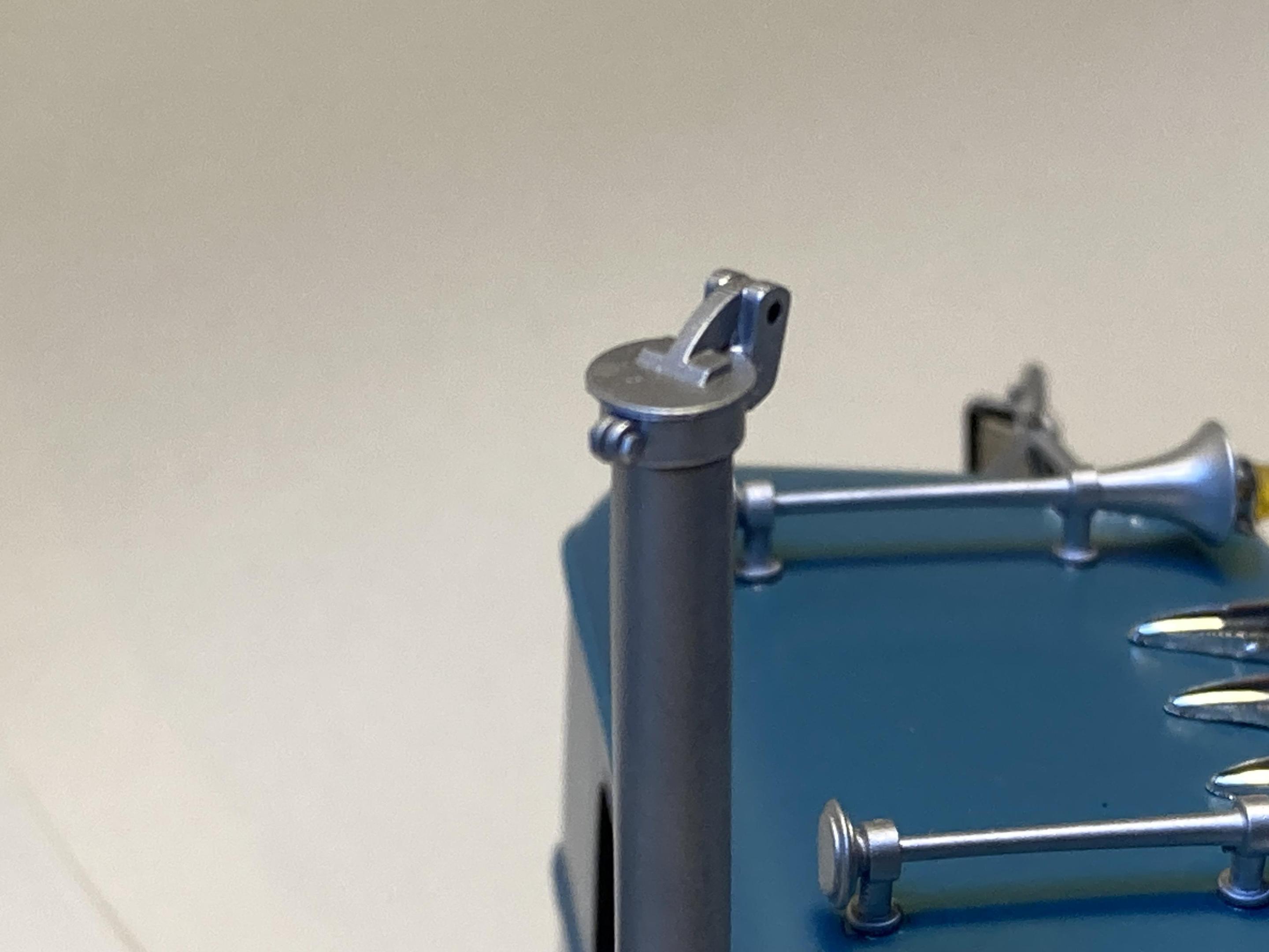

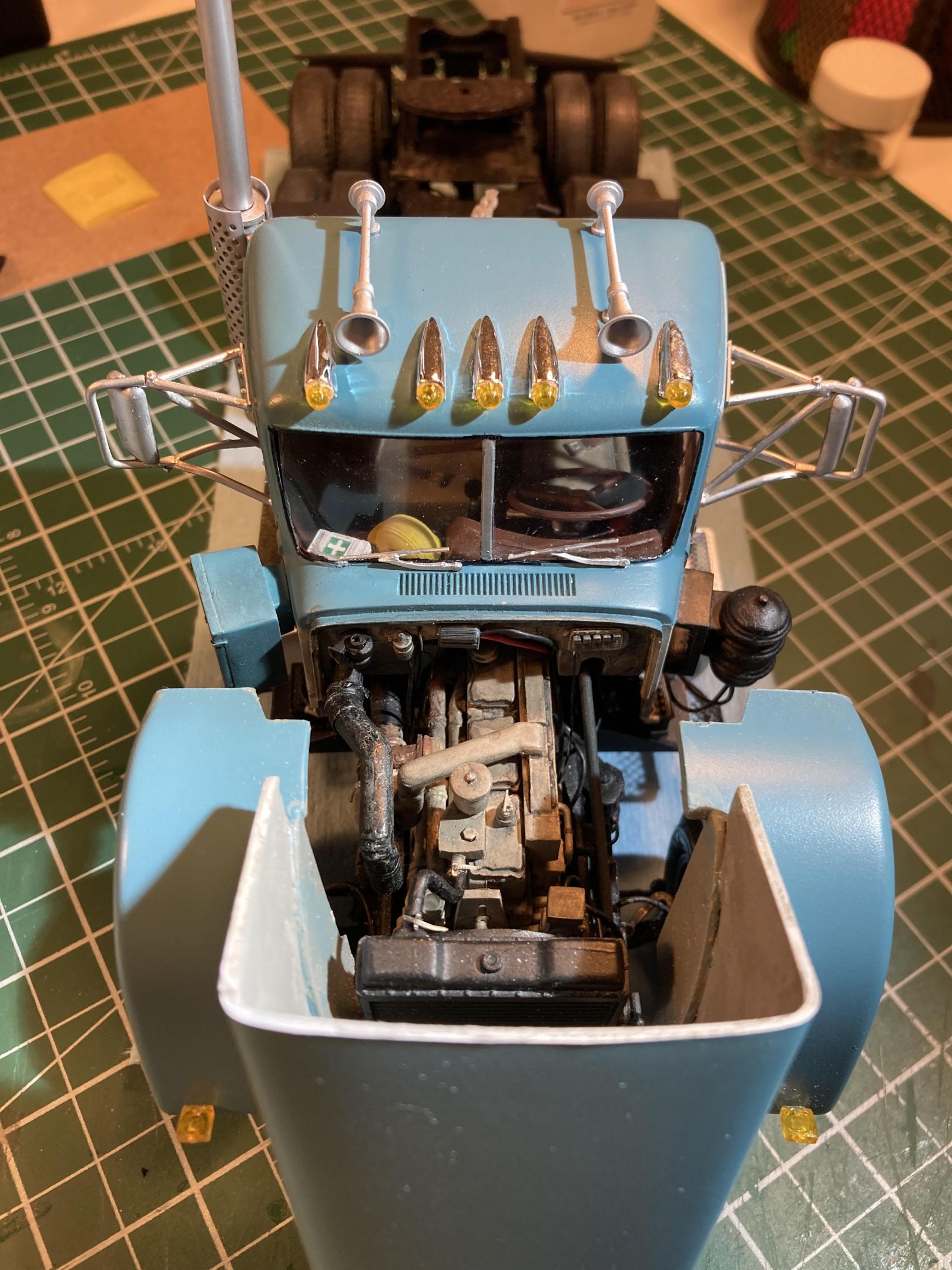

Bren Posted February 22, 2024 Posted February 22, 2024 (edited) This is my AMT Diamond Reo - I stretched the frame, opened the doors and swapped out front axle for a KFS/Auslowe steering one, and used photoetch for the front grill. Lots of 3D printed detail parts (exhaust, flapper valve, air/electrical connectors, interior details etc). Otherwise stock. Now onto the trailer....... Edited February 22, 2024 by Bren added truck type to header 13

Bren Posted February 23, 2024 Author Posted February 23, 2024 Yeah the exhaust turned out really well - I was happy with it. The flapper 3D file is on Cults, and the perforated heat shield 3D file is scaled down from a 1/14 King Hauler file on Thingiverse. I posted makes to each of those sites if you need more details. My user name there is Heavyhaul. 1

DRIPTROIT 71 Posted February 28, 2024 Posted February 28, 2024 Looks great! I really like the flapper cap!! Nice work!!
Biggu Posted April 9, 2024 Posted April 9, 2024 What a beauty !! That is top notch, what did you use for the door hinge? Love the attention to the details.... Take a bow for this one... it's spot on ! Jeff

Bren Posted April 17, 2024 Author Posted April 17, 2024 On 4/9/2024 at 11:55 AM, Biggu said: What a beauty !! That is top notch, what did you use for the door hinge? Love the attention to the details.... Take a bow for this one... it's spot on ! Jeff I used 22 gauge hypodermic needles (I'm a doctor so sourcing them is easy for me! :-)) with brass rod, cut into sections using a dremel cut off wheel 1
Biggu Posted April 19, 2024 Posted April 19, 2024 On 4/17/2024 at 3:17 PM, Bren said: I used 22 gauge hypodermic needles (I'm a doctor so sourcing them is easy for me! :-)) with brass rod, cut into sections using a dremel cut off wheel Thanks, Doc.... not sure I can source that, BUT I did find some possible hinges at Model Car Garage that might do the trick, maybe check them out for your next build, as it may save some time, they are called "Big Rig piano hinges"........... thanks and your build is wonderful ! Jeff
Bren Posted April 30, 2024 Author Posted April 30, 2024 On 4/19/2024 at 1:41 PM, Biggu said: Thanks, Doc.... not sure I can source that, BUT I did find some possible hinges at Model Car Garage that might do the trick, maybe check them out for your next build, as it may save some time, they are called "Big Rig piano hinges"........... thanks and your build is wonderful ! Jeff Yup - I tried those. They do work (there is a good youtube video on how to by Showtime studios) but I found them very fiddly and difficult to control. Mine wound up bending out of true easily. But they look good for sure. Thank you for your kind words on the build! 1
