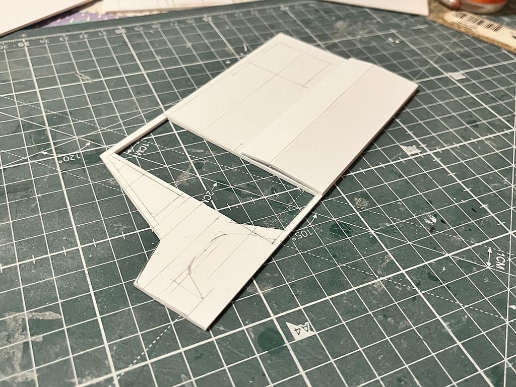

crowe-t Posted March 14, 2024 Posted March 14, 2024 (edited) I'm attempting to scratch build an International Harvester Metro Mite in 1/25 scale. A Metro Mite was used in the 1985 NBC TV series, Misfits Of Science as an Ice Cream truck. This is the version I want to build. The show is a favorite of mine. I picked up a Metro Mite Brochure on E-bay that had the specs and dimensional drawings. I started cutting out the sides using .060"(1.5mm) sheet styrene. The lower sides angle out so I'm experimenting with ways to replicate it. I would like to make the rear door roll up and I'm considering making the side doors slide open. However the doors curve out below the windows and I'd have to make the lower sides of the body curve out not only on the outside but the inside as well. The ice cream truck was only seen with the side doors closed in 2 shots in the pilot episode and the rest of the time they were open so I'm considering just making them in a fixed open position. This would solve some problems and make it easier. In the pilot the freezer unit on the roof was taller than the rest of the series so I might make it removable so I can use both. Does anyone have ideas on how to make the angled out lower body/sliding doors? I posted pictures of one test I did for the lower body. It will require cutting out the lower part of the side wall and gluing in the angled section. Another option would be to add an angled section on top of the side wall using thinner sheet styrene than I have in the picture. I appreciate any ideas and/or comments anyone can share. Thanks, Michael. Edited March 14, 2024 by crowe-t 2

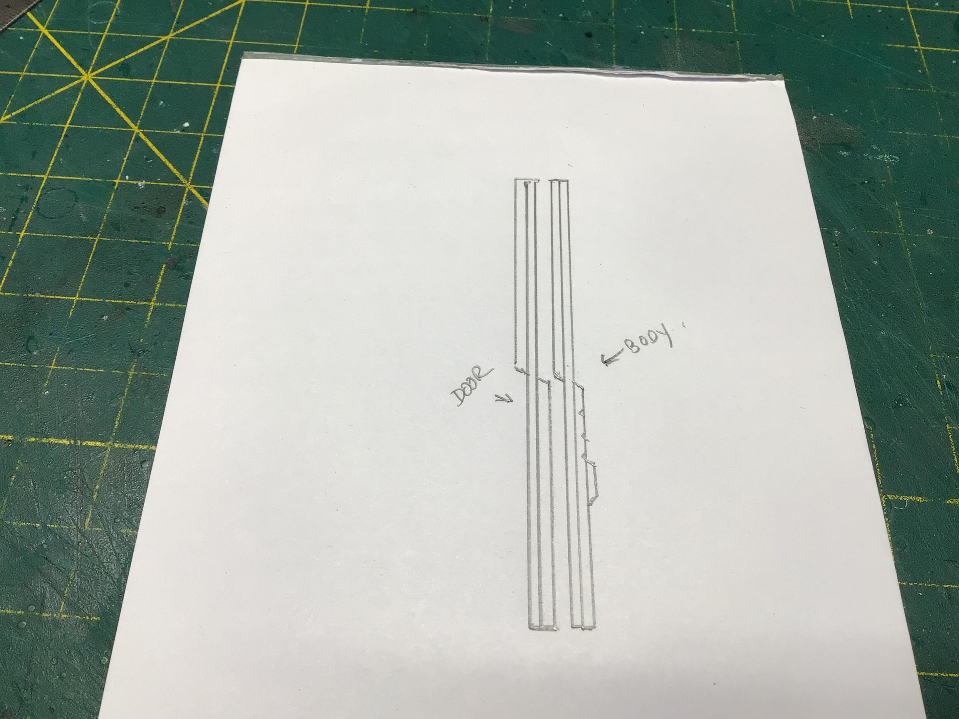

NOBLNG Posted March 14, 2024 Posted March 14, 2024 Hi Michael. Interesting project.? Maybe you could make the panels from 3 or more pieces laminated something like this? Good luck with it!? 1
crowe-t Posted March 15, 2024 Author Posted March 15, 2024 6 hours ago, NOBLNG said: Hi Michael. Interesting project.? Maybe you could make the panels from 3 or more pieces laminated something like this? Good luck with it!? Greg, Thanks for the drawing. I'm still brainstorming on this one. So far I'm liking what I came up with. I just have to test a few more ideas out.

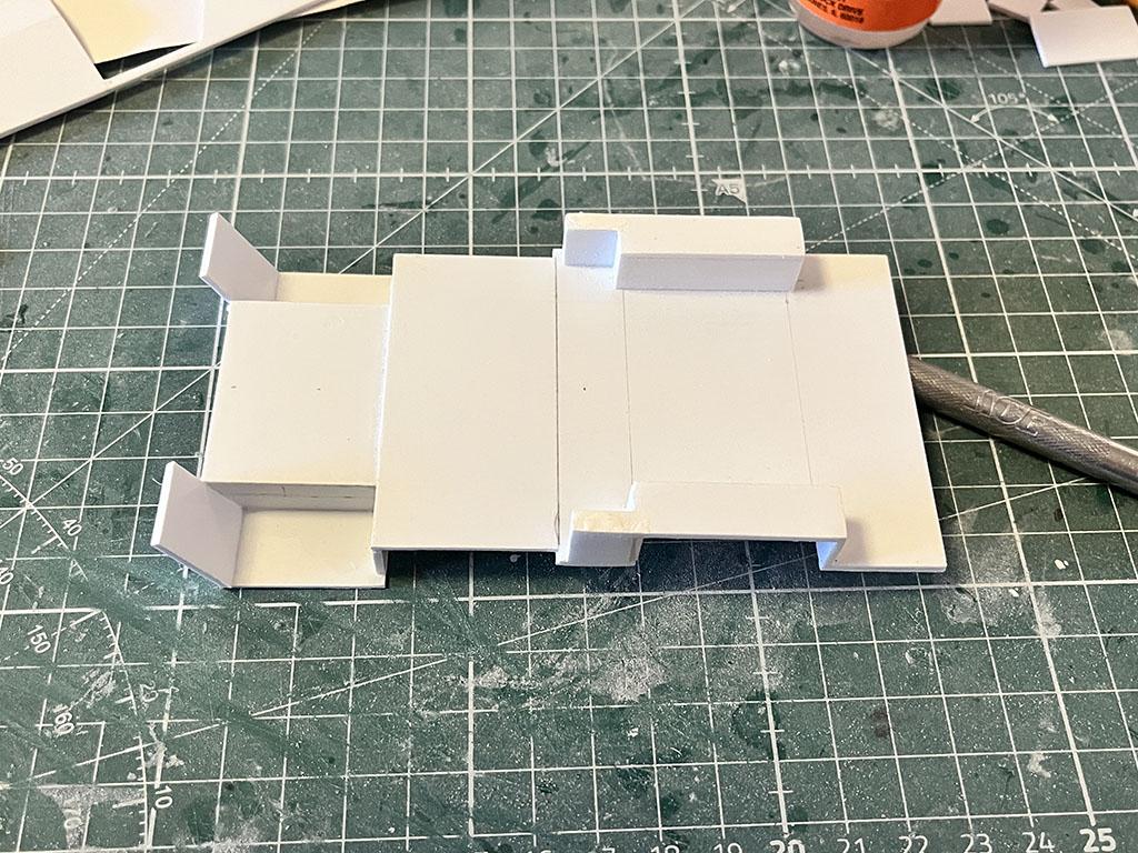

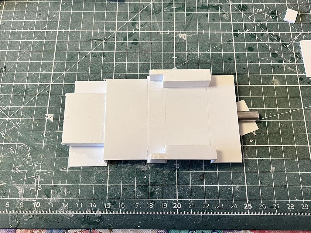

crowe-t Posted March 21, 2024 Author Posted March 21, 2024 I got some more work done on this. I used the angled side pieces I put together. Today I started on the floor.

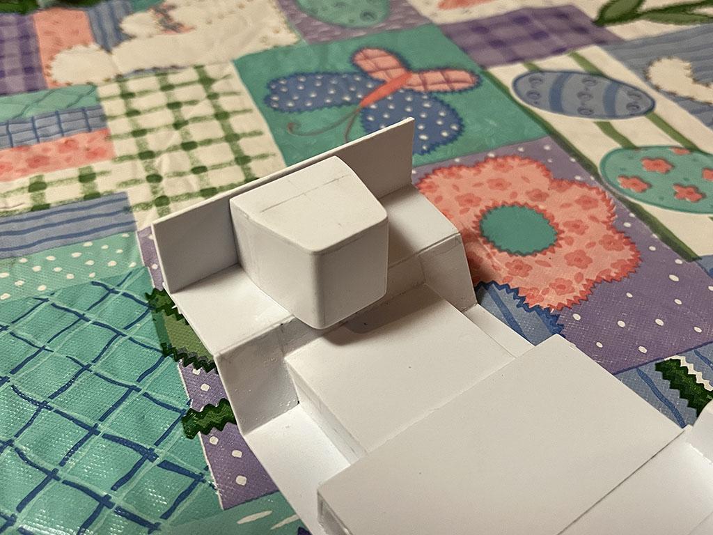

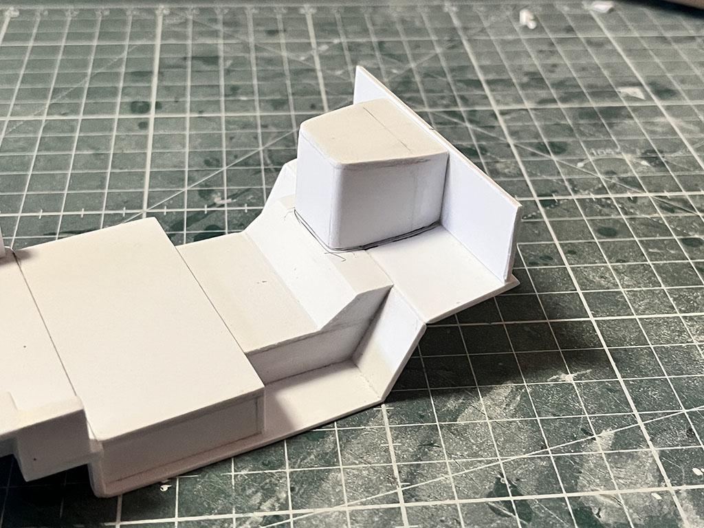

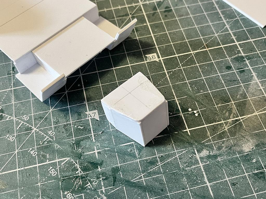

crowe-t Posted March 27, 2024 Author Posted March 27, 2024 Work continues on the floor. I made the doghouse using measurements a member of a group on Facebook sent me. To get the angle of the floor under the doghouse I placed the doghouse upside down under the floor after I glued it in place. It worked well. I then held the doghouse in place to support the firewall while the glue dried. I'll add the extended floor under the doghouse which is for the in line 6 cylinder engine I'm using. The 8 cylinder option had a shorter doghouse and didn't have the floor extension. 2

crowe-t Posted March 27, 2024 Author Posted March 27, 2024 Today I added the floor extension under the rear of the doghouse. 1
